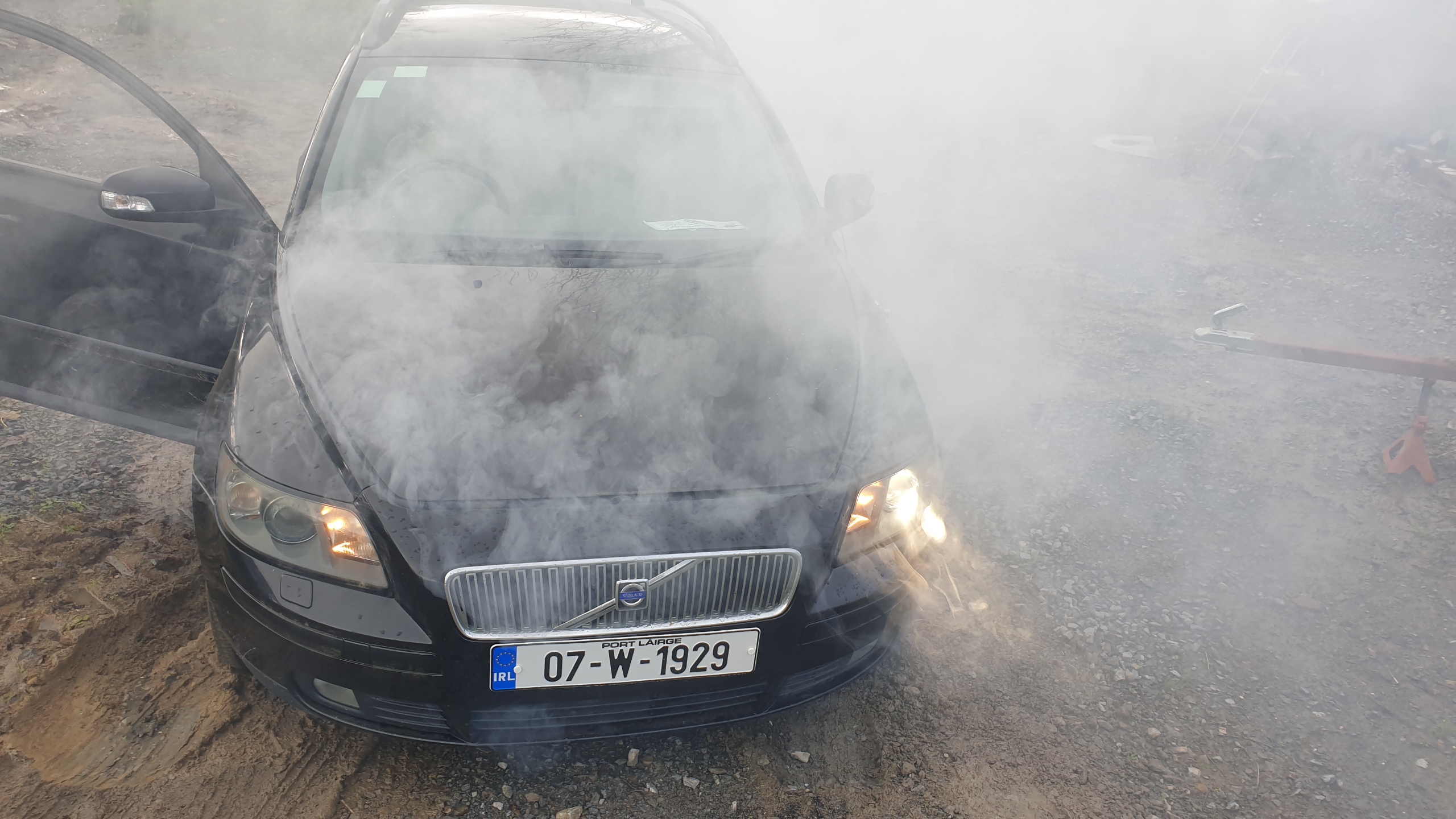

Volvo with the M3 moved for the first time today. Seized rear brakes were no match for throtcur 10. Initial impression is very smooth. Dave , I#m too dumb for my own good but could you remind me again of the oic command to save params to flash.

Sooo, I don't have any experience with driving a car with OI FOC firmware but what I can say is the V50 / M3 test vehicle that I call the T3RD is now the smoothest car I own to date. And thats just with my ham fisted attempt at tuning params that I do not understand. Sadly it's monsoon season in Ireland so not much traction just mud and burnouts in gravel.
I can make it trip desat by either A)maxing out all the kp params or B)slamming it into reverse at over 6k rpm.
Driveshafts are holding out so far.

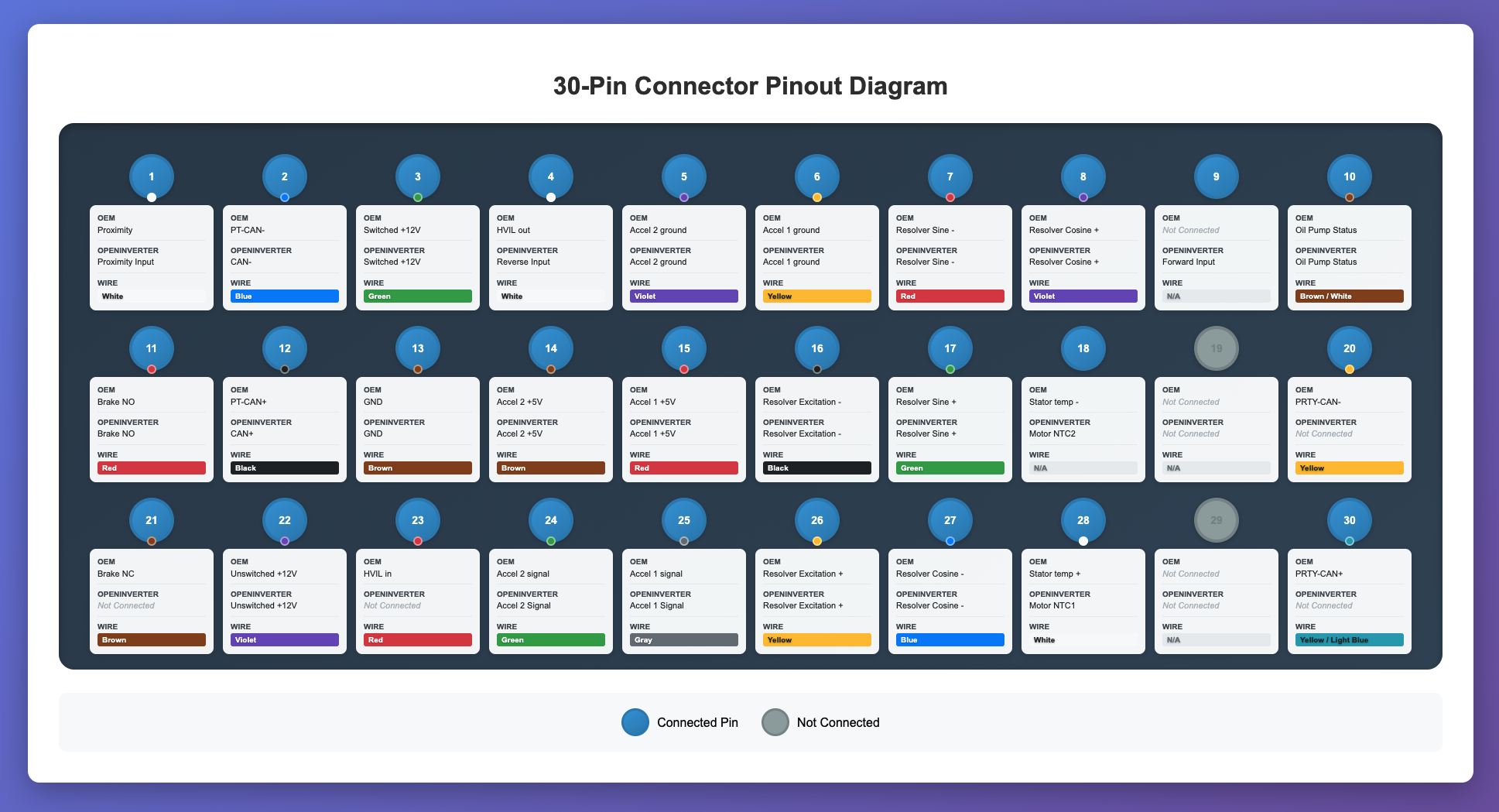

Here's the OEM to OpenInverter pin mapping if anyone needs it:
Pin 1 is the lower right from the outside of the inverter and the lower left of the housing facing towards the PCB.
Pins are ascending in each column - the bottoms pins are Pin 1 / Pin 11 / Pin 21
Got everything setup but unfortunately I'm getting two errors on my Phase C Hi Gate Driver: REGERRR | REGERRL that I'm currently investigating
Posts: 4000
Been thanked: 1116 times
That's a brilliant diagram. I have added it to the Github repo. The Reg errors are likely caused by a short dropping the Phase C hi isolated power rail. it wont cause any harm as each supply has its own current limiter.

Jack Bauer wrote: Tue Nov 18, 2025 9:48 am That's a brilliant diagram. I have added it to the Github repo. The Reg errors are likely caused by a short dropping the Phase C hi isolated power rail. it wont cause any harm as each supply has its own current limiter.
Thanks! I've updated the diagram in that post to account for a couple more OEM pin mappings.
