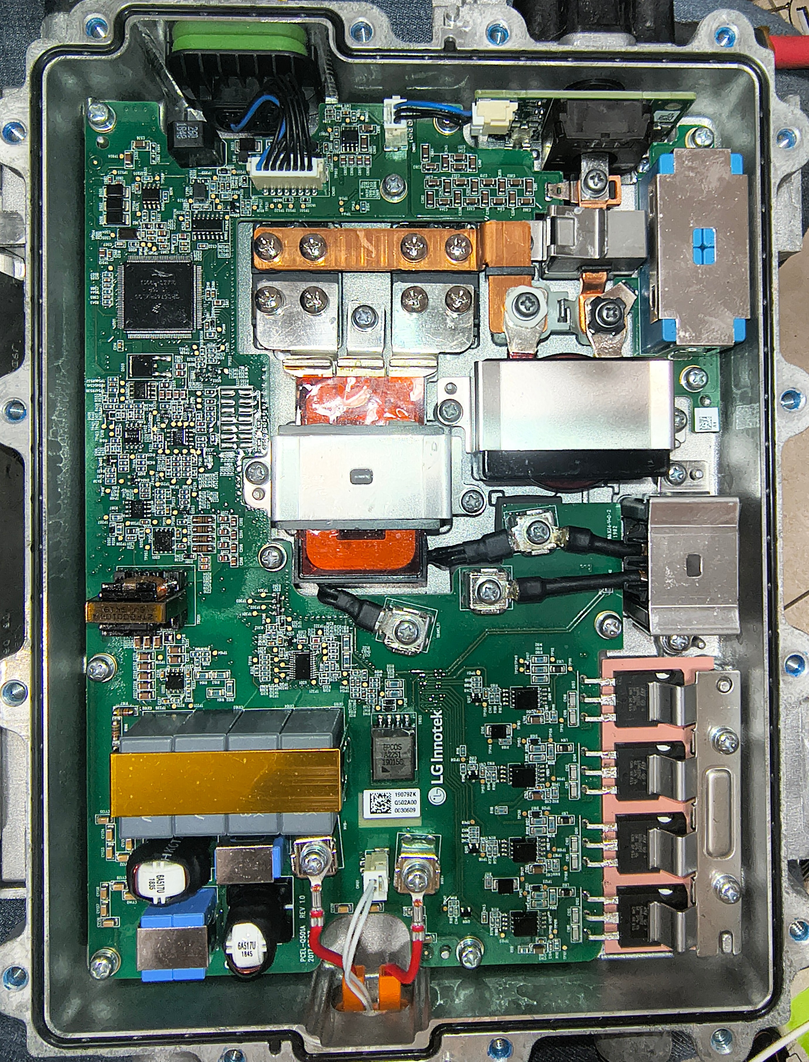

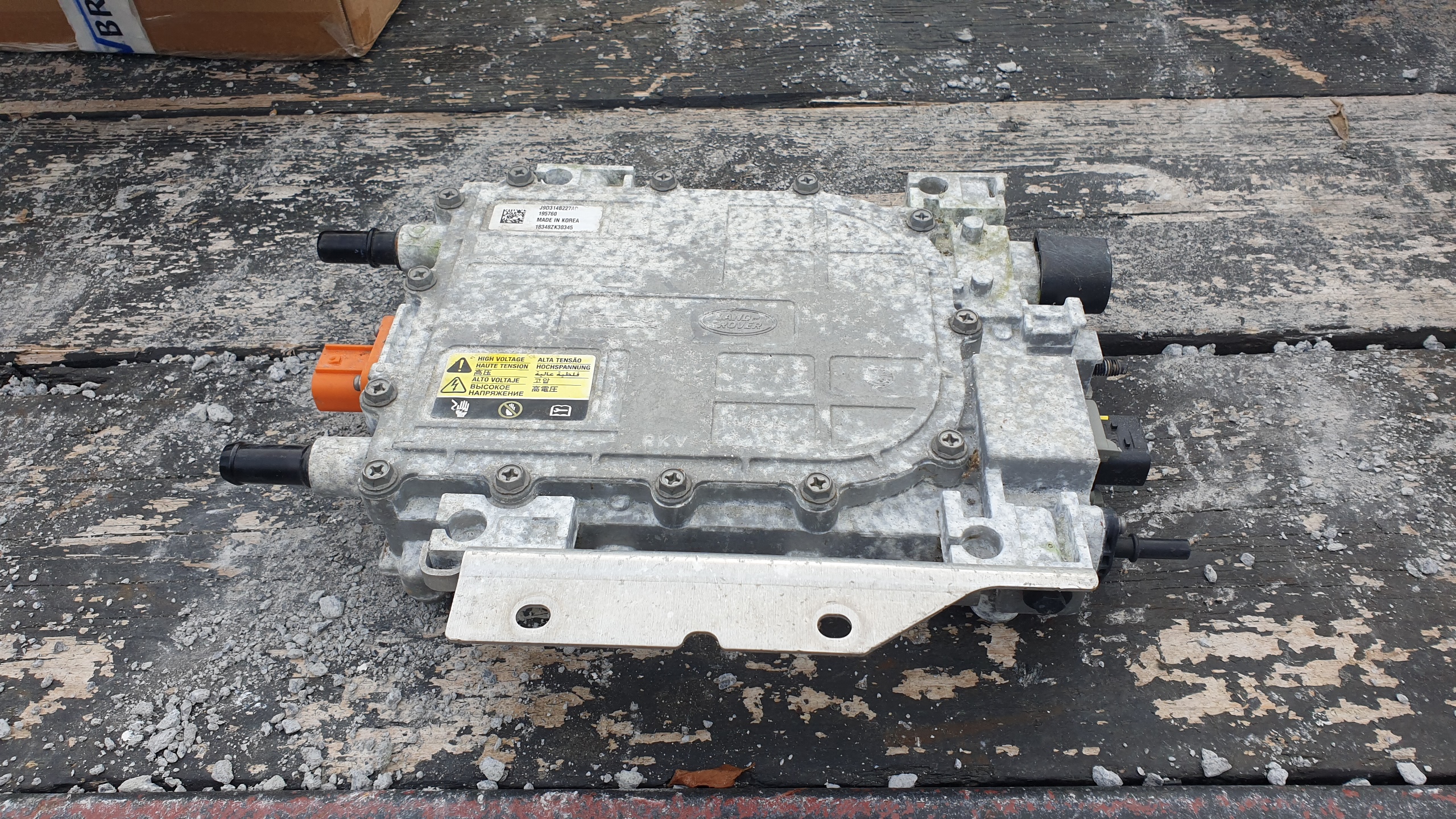

Unit is by LG Innotek.
J9D314B227AD is this example. Outward appearance seems identical for I-Pace and LR/RR Hybrids..
Internal Photo..
Anyone started to do anything with this? Input please.
I will start with figuring out the 8-pin connector.

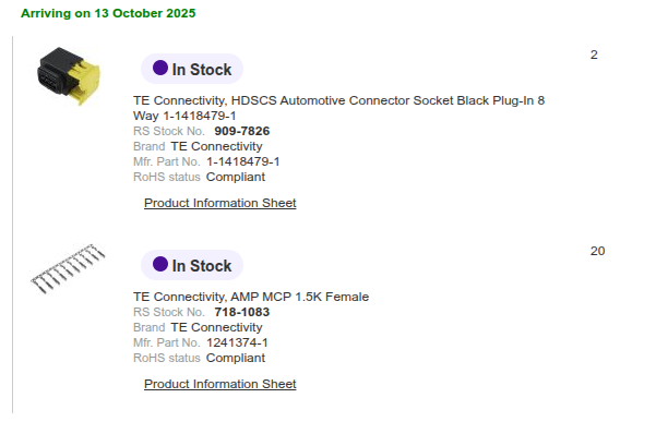

Connector.
https://uk.rs-online.com/web/p/automoti ... rs/9097826

Re: jlr DC/DC hacking
I have one on the way.
Posts: 4007
Been thanked: 1139 times

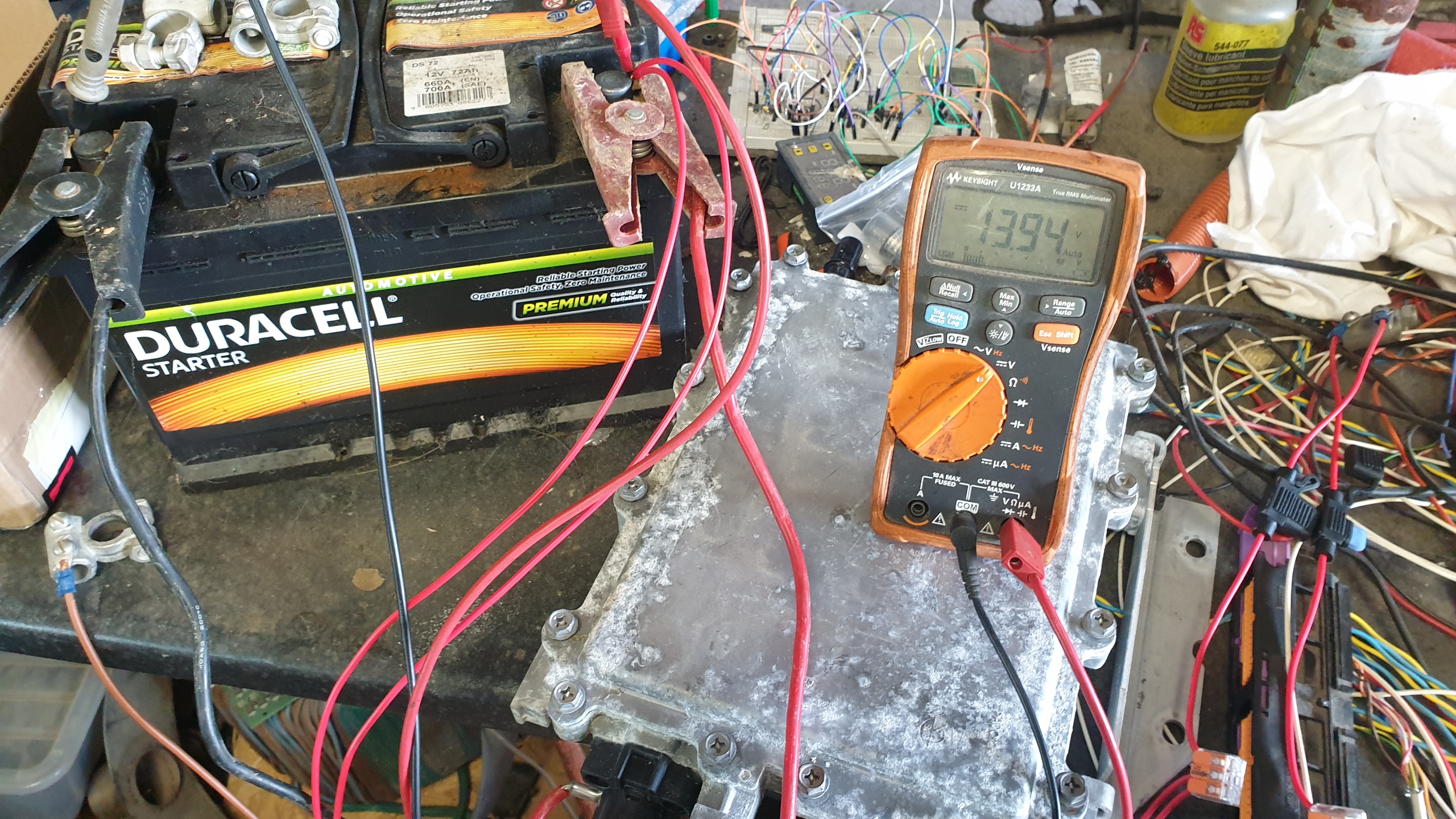

Mine arrived. Connectors ordered.
Posts: 4007
Pin 5 is CAN H. Powerup log attached.
Post by ganch »
I will try to make some sense of this..
How exactly was this powered? only on the 12V side? If HVDC was used, what voltage?
Just 12v. Hope to get some ipace logs soon.
