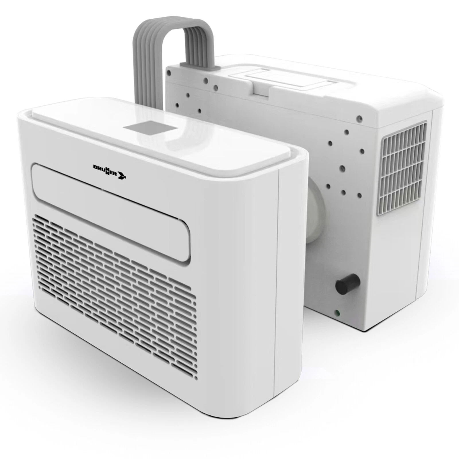

Have you had a look at Camper/Caravan heat pumps?

tom91 wrote: Fri Dec 05, 2025 10:47 am Have you had a look at Camper/Caravan heat pumps?

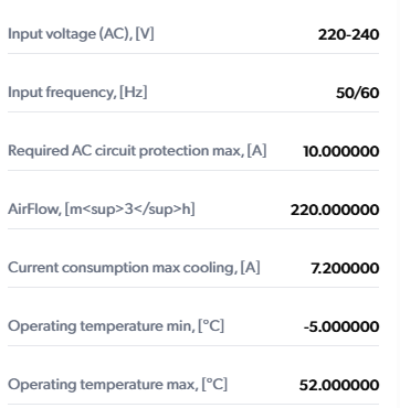

Yes I have. I found 3 models on ebay: https://www.ebay.de/sch/i.html?_nkw=sta ... &_osacat=0
Perhaps I could make them fit in the trunk but they are rather bulky.
There is also split versions:
I have space below the wheelwell because the muffler used to sit there. Just a whole lot of debris there

This can be likely reworked to run off HV DC. I've converter some of their other units to run off of HV DC. This is actually made by Midea. It uses a inverter driven variable speed compressor.
https://www.highseer.com/products/pione ... onditioner

Please correct me if I am wrong but are these pretty much the same as so called "mono block" heat pump heaters/air conditioners?
I am looking for things for my Triumph Spitfire project but I think this is too big and heavy...
Still, an interesting idea!

johu wrote: Thu Dec 04, 2025 6:26 pm Typical compact heatpumps output about 2.5 kW of heat and use like 500-800W of electricity. The slimmest one I found is 260mm. Also currently looking at caravan air-to-air heatpumps (e.g. https://www.dometic.com/de-de/produkt/d ... 9620013224) as they would skip the tiny heater matrix and losses in the engine compartment. Not sure if I can find one that fits though
Hm...
I have given this some thought and it seems you already have some components that were made for the car enviroment...
The DC to AC inverter which you can use to power climate module in your trunk
https://openinverter.org/forum/viewtopi ... 142#p86142
Yuo would have to be carefull as 7.2A fuse means about 1600W which is just out of range for that Mitsu unit... Maybe it can work with a little overhead...
I bet you can have a remote to switch the unit ON and set it to heating or cooling...
