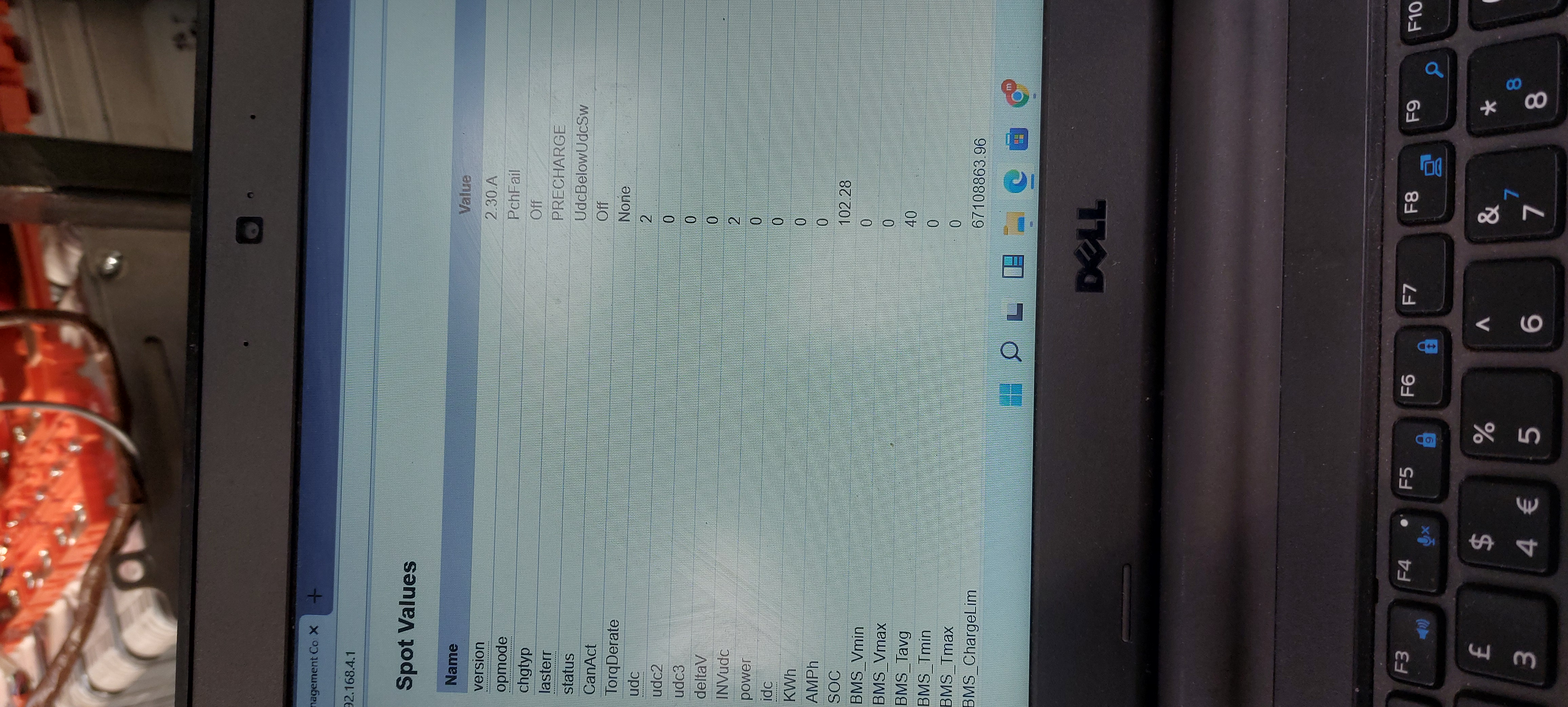

Hi I'm using a 2017 gen2 leafstack with the zombieverter and I'm getting a pre charge fail.
I have tested the pre charge fuse, the positive contacter let's out power but the negative contactor is not so not getting pre charge.
Been going around in circles and can't seem to find out why it's not working. Is the zombieverter ment to have a gen2 in the drop down list as mine hasn't.
Prams attached
Simon.json
(2.15 KiB) Downloaded 2 times

I'm only getting 2 - 4v on udc when I switch for precharge.

Sorry attached spot when I click pre charge
I got 380v going to the JB
And I think all the 12v is wired up correctly, I know it is to the bms and going to double check stuff to PDM and inverter
spot1.pdf
(166.78 KiB) Downloaded 4 times
spot2.pdf
(151.34 KiB) Downloaded 3 times
spot.pdf
(160.01 KiB) Downloaded 4 times

Your contactors cycling correctly? You need to have negative close first, then precharge. Voltage comes up and then positive closes. Precharge remains closed.
UDC2 should read your battery voltage from the BMS, spot value shows nothing. Your UDCsw will get set based off of this voltage.

When I toggle for precharge and measure voltage on contractors I get nothing from negative contactor but 190v on positive contactor, pre charge relay clicks.
I have 390v on the battery side of contactors
I traced all cables back to the vcu and all contactor cables are correct, in getting 12v to contactors
Could be 12v wiring going to pdm and inverter which will double check.

Measure the coil voltages that are driving the contactors.
If you are uncertain of the operation of the contactors DO NOT have HV connected.

Hi yes using the service plug all wired up with current sensor. Getting power to the contactors. Gonna test the contactors today make sure there working OK and the pre charge resistor.

Zombieverter pulls the contactors low to turn them on so the other side should be wired to 12V.
