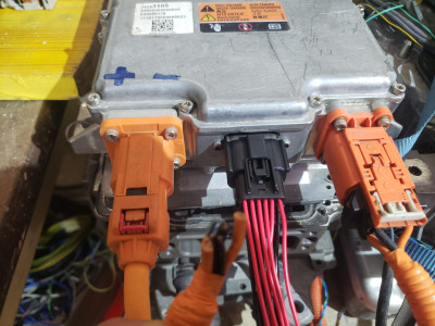

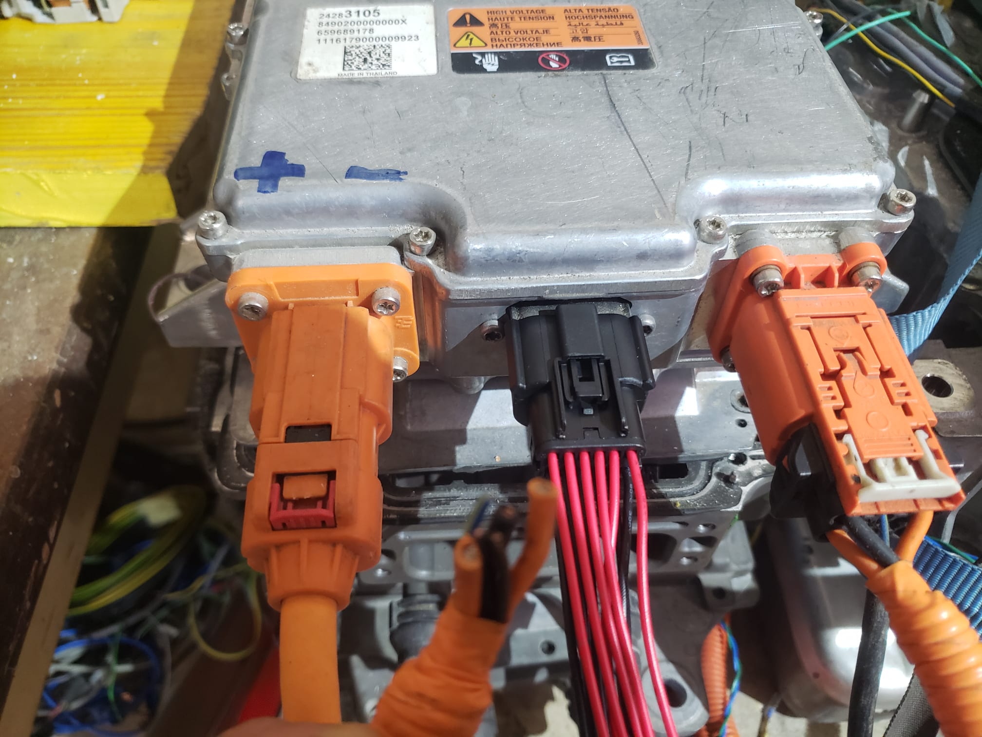

For anyone looking to use this, the output connector can be found on:
General Motors p/n 84024993
Tesla p/n 1100169-00-D, or 110900410-G (?)
Check the key of the connector, whatever part you buy. Only Key A will work!!!
I’m told theres also a volvo harness with this connector, but I don’t know the part number.

I have found that this connector works for the HV DC output on the charger: https://www.digikey.com/en/products/det ... -1/5423199
and this one for the control pins: https://www.digikey.com/en/products/det ... 01/1756779

Any idea what the AC input connector is?
Re: Chevy Volt Gen 2 charger 24281923
I am not sure…
Mine has less markings on the AC connector than it did on the DC one, just says “DELPHI”
But I have not spent much time looking for it yet.

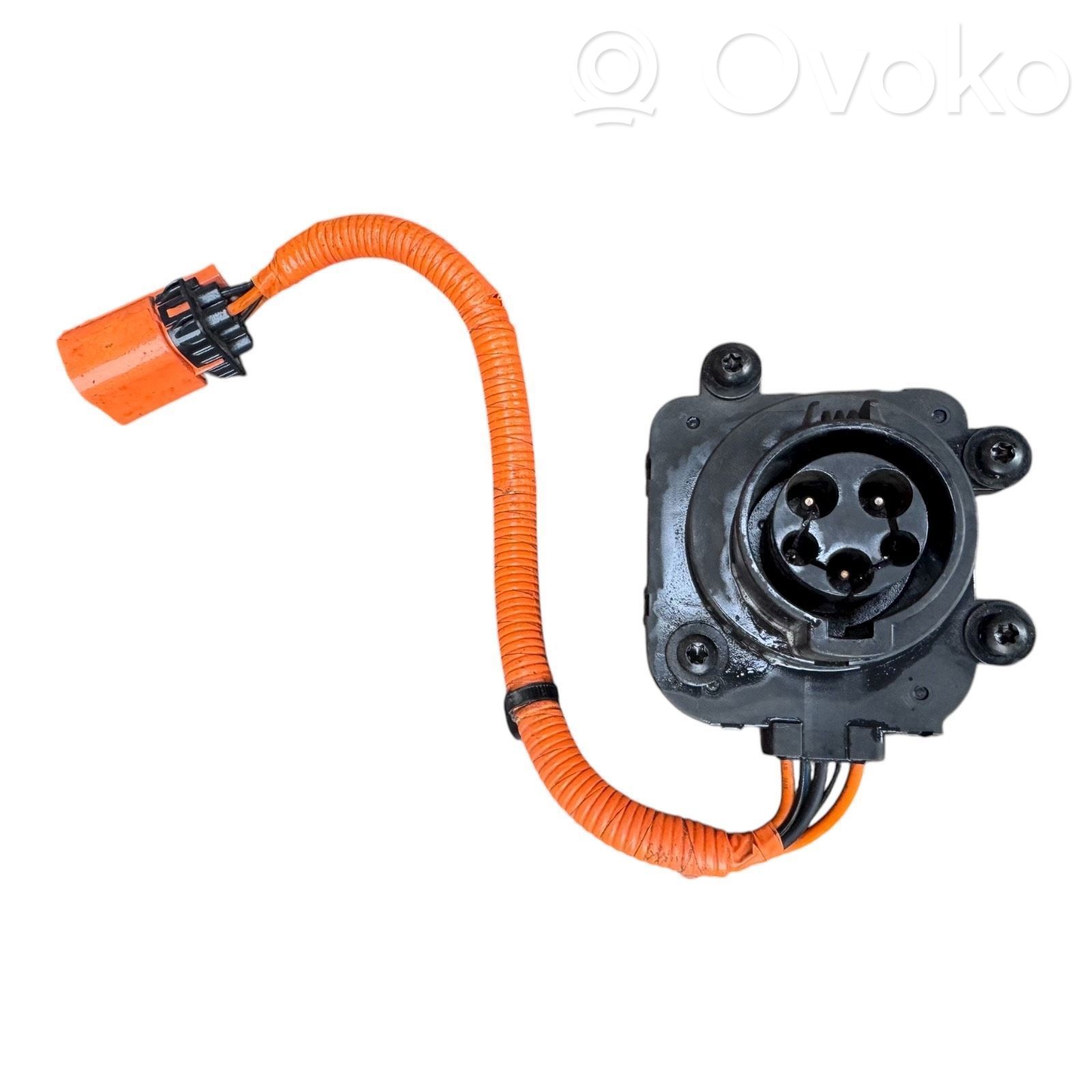

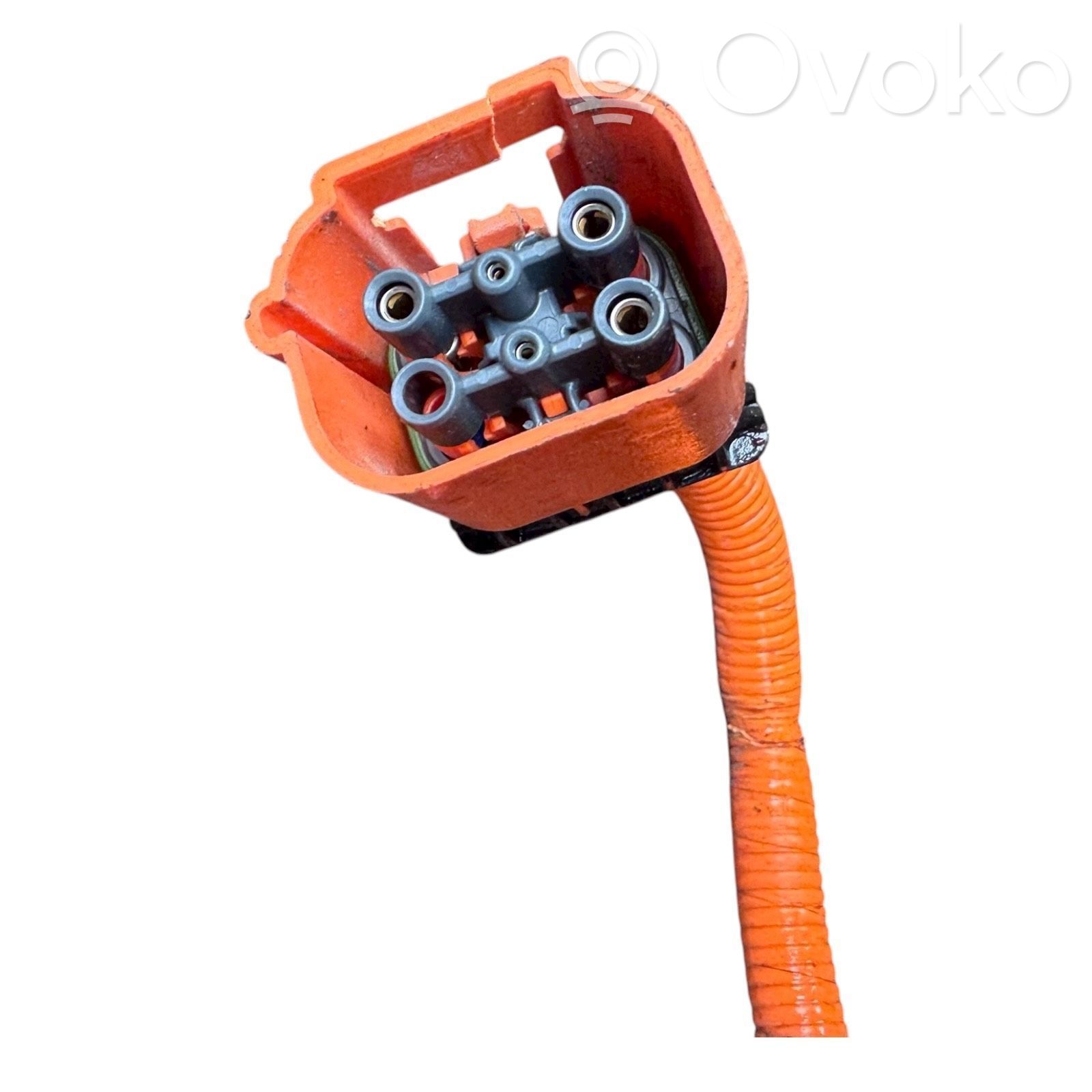

I just bought a Chevrolet Volt Gen 2 Charging Port 24278118
It was a gamble buy as i only saw a similarity between Gen2 charger AC connector and that made me think both the extension cable and Charging port use the same type of connectors.
It was proven to be the case YAY! It is the same on the charging port and the AC extension in the car...
