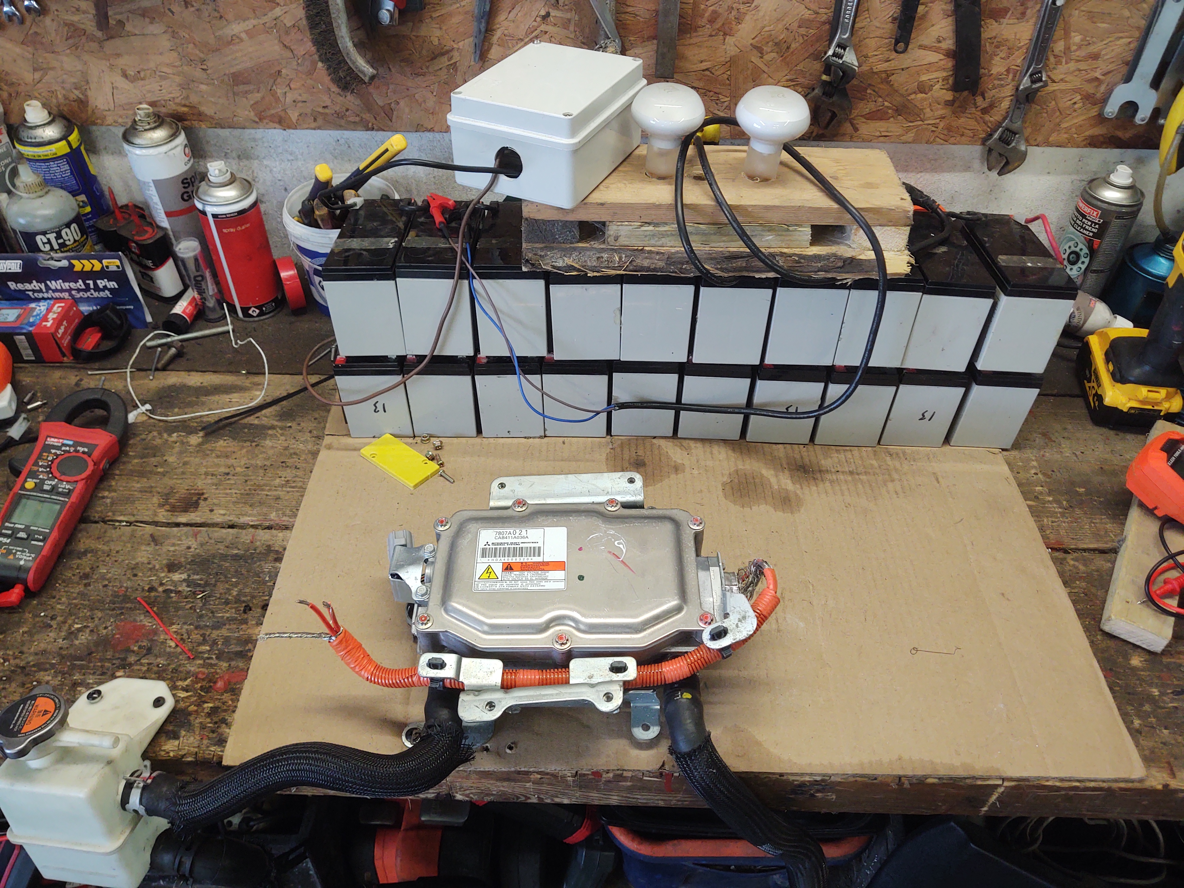

Got it working nicely now! Love the display output aswell - very useful!

It’s awesome and great work! I’d like to add a safety delay to switching off the water pump until the temp is back down to say 30 degrees C! Probably have to make it permantly live tho to ensure it runs even when the ignition is switched off. Either that or just get a delayed relay!

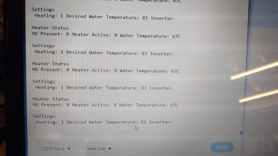

Interesting development today - the heater wouldnt start until the temperature got above -1 degrees C!

Turbopete wrote: Sat Jan 21, 2023 12:35 pm Interesting development today - the heater wouldnt start until the temperature got above -1 degrees C!
Not at computer at min, is the temp feedback unsigned, I made that mistake early on, might not have pushed the change?

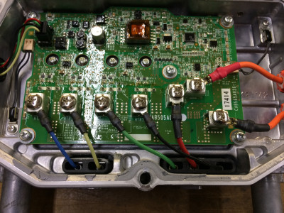

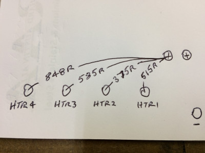

Hi Forum. For anyone interested I took the top off my PHEV heater.... cos I am nosey :-)
Pics reveal heater connections etc.

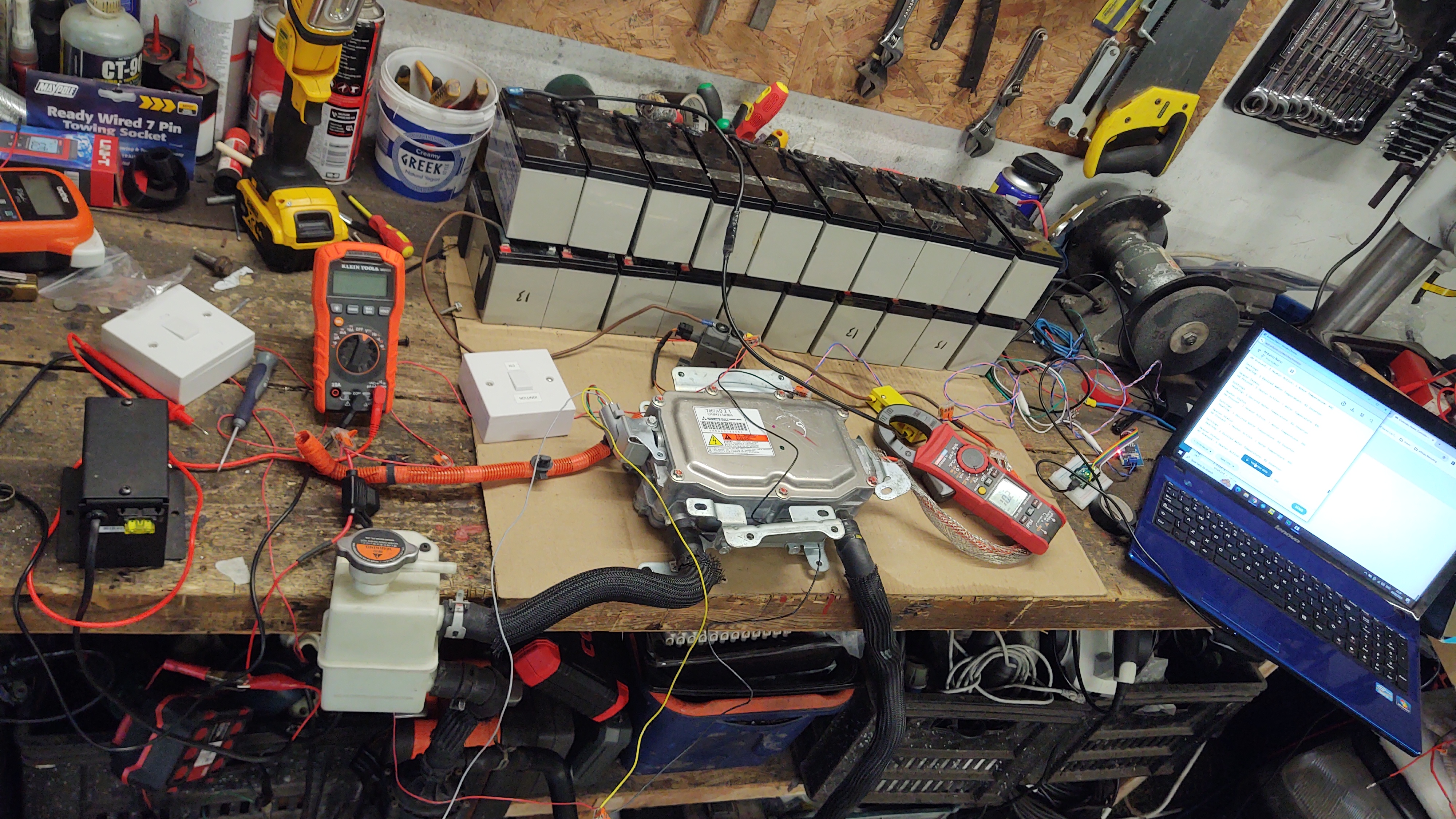

Hi guys
My heater has arrived and I'm setting up a test station to confirm I can control it before ripping the car apart.
But I need a little guidance with the Arduino side of things as I'm pretty clueless at programming. I have the sketch above from Turbopete on a nano and can see it sending 0285 message so hopefully that bit is OK.
This sketch seems to include control for a display but I cannot find any thread showing details of model or how it was connected.
Also can anyone please advise the resistance of the POT and how to connect it? It looks like the wiper of the POT is on A0 but where does the other side go? Is it just 5V?
EDIT: I did a search for Adafruit 128 x 32 OLED displays and found this. https://www.adafruit.com/product/4440
Is this the right one?
Thanks guys
Alibro
Posts: 1113
Location: Northern Ireland
Has thanked: 506 times
Been thanked: 325 times
Re: Mitsubishi Outlander PHEV heater
Post by Alibro »
I only managed an hour or so at it today but managed to get hot water pumping. :)
I could see 10A at 250V
I only had a 4k7 pot connected between ground and A0 so not sure if that is suitable as I think the heat requested was around 85C and it wouldn't drop below that. I think I could see a 10k pot in a previous photo from Jamie so I'll dig one out and give it a go. Does this sound correct?
Posts: 1884
Has thanked: 91 times
Been thanked: 517 times
Pot size irrelevant, connect one side to gnd, other to vcc and wiper to A0
Posts: 3796
Been thanked: 413 times
Alibro wrote: Sun Feb 04, 2024 5:07 pm I only had a 4k7 pot connected between ground and A0 so not sure if that is suitable as I think the heat requested was around 85C and it wouldn't drop below that. I think I could see a 10k pot in a previous photo from Jamie so I'll dig one out and give it a go. Does this sound correct?
I dont fuss with the pot. I simply use a digital input and internal CAN loop. I use this for the pump too. So when heater temp is lower than 50deg i request full power, when it is at 50deg i lower this to halfh and when heater reaches 55deg i terminate the request. This keeps heater output at 50deg in general which saves kWh acc to Q = m*c*dT. I may up the temp to 60deg if this will not be enough.
Alibro
Posts: 1113
Post by Alibro »
Thanks guys,
Doing family stuff atm but will have another look later.
Alibro
Posts: 1113
Post by Alibro »
It works a treat!!! :D
I connected the 4k7 pot as instructed and commented out the Openinverter precharge safety checks and it works perfectly with the water temp following the requested temp.
I already have a 12V circuit which only goes live after the main positive contactor kicks in so I'll use that to power the heater when it is installed.
I've also ordered a couple of OLED displays so I'll have a go at getting them to work.
Thanks again guys for your help with this as I'm very much standing on your shoulders here.
I was a little surprised at how hot the case of the heater got and couldn't help thinking it is a pity to loose all that heat but I suspect I'm too late trying to capture it as I would need to have custom designed some kind of enclosure with fans.
arber333 wrote: Sun Feb 04, 2024 5:31 pm I dont fuss with the pot. I simply use a digital input and internal CAN loop. I use this for the pump too. So when heater temp is lower than 50deg i request full power, when it is at 50deg i lower this to halfh and when heater reaches 55deg i terminate the request. This keeps heater output at 50deg in general which saves kWh acc to Q = m*c*dT. I may up the temp to 60deg if this will not be enough.
My coding skills are virtually zero so now I have it working I think I'll leave well alone. :P
Posts: 3796
Alibro wrote: Mon Feb 05, 2024 4:10 pm was a little surprised at how hot the case of the heater got and couldn't help thinking it is a pity to loose all that heat but I suspect I'm too late trying to capture it as I would need to have custom designed some kind of enclosure with fans.
Like i said heater wants to go all the way to 85deg if you let it. Thats a waste of power. I wanted to use a limit to lower this to 55 as the kj are less there = less kWh.
May i use your posted code to setup my loop instead of pot? It should work on any teensy...? Or do you use teensy?
Posts: 3796
I went through the code quickly and eliminated anything connected with pot.
I used Heater_pin which is the same pin as A0 analog, only digital side... i think it is D14
Then i removed reading of desired temperature as i find it unneccesary. I removed cconnected conditional as well.
The way this code works is to transmitt complete 0x188 telegram each 100ms. If we toggle the switch to GND(pullup) it will command heater to turn ON. It reads its own temperature and govern the loop by 5deg hysteresis if not turning OFF when reaching 55deg. You can of course set any temperature in code. You could even use the pot to set variable for desired temperature and use a different pin to start the process. I may go and write another code...
See if it works directly as you can load the pot directly to GND to activate the pin with the same circuit. But i would change to toggle switch soon.
