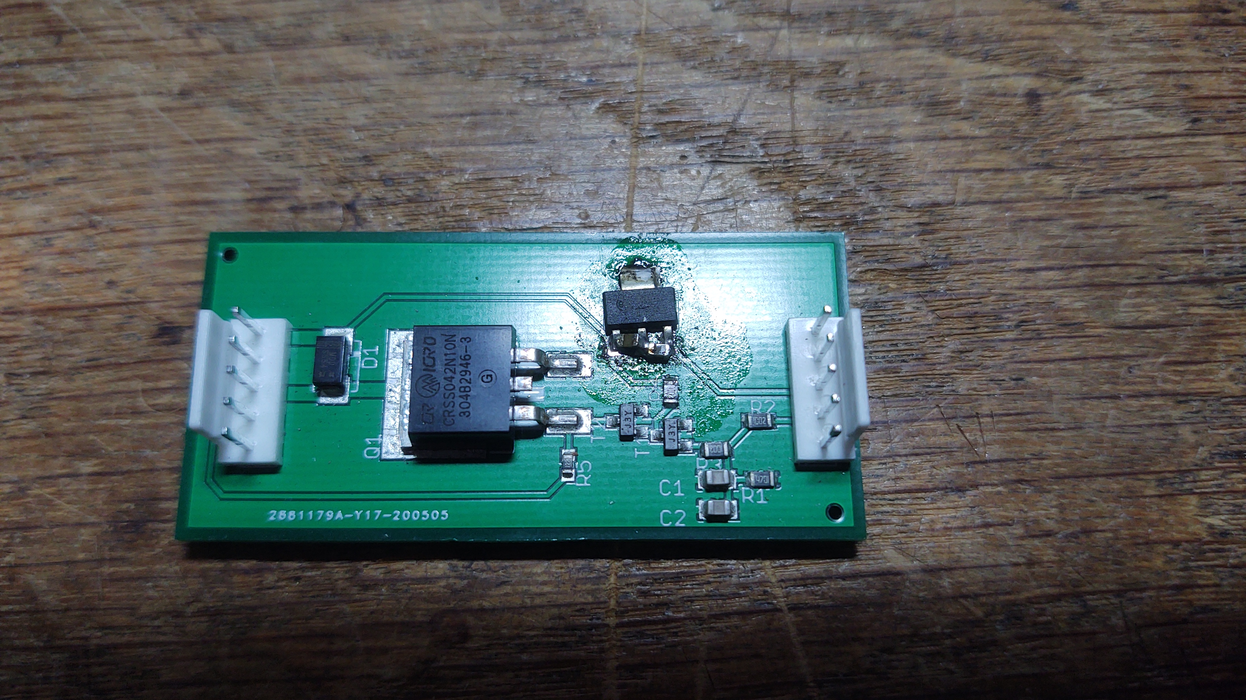

I've been sitting on this for a few months now but finally got round to replacing the voltage regulator and caps so hopefully it will be OK.
I haven't tested it yet and it ain't pretty but no shorts.
Apart from the terrible soldering does this look OK?

Should do. Meanwhile I added a 16V TVS diode across the 12V input to protect the regulator. You might want to do that.

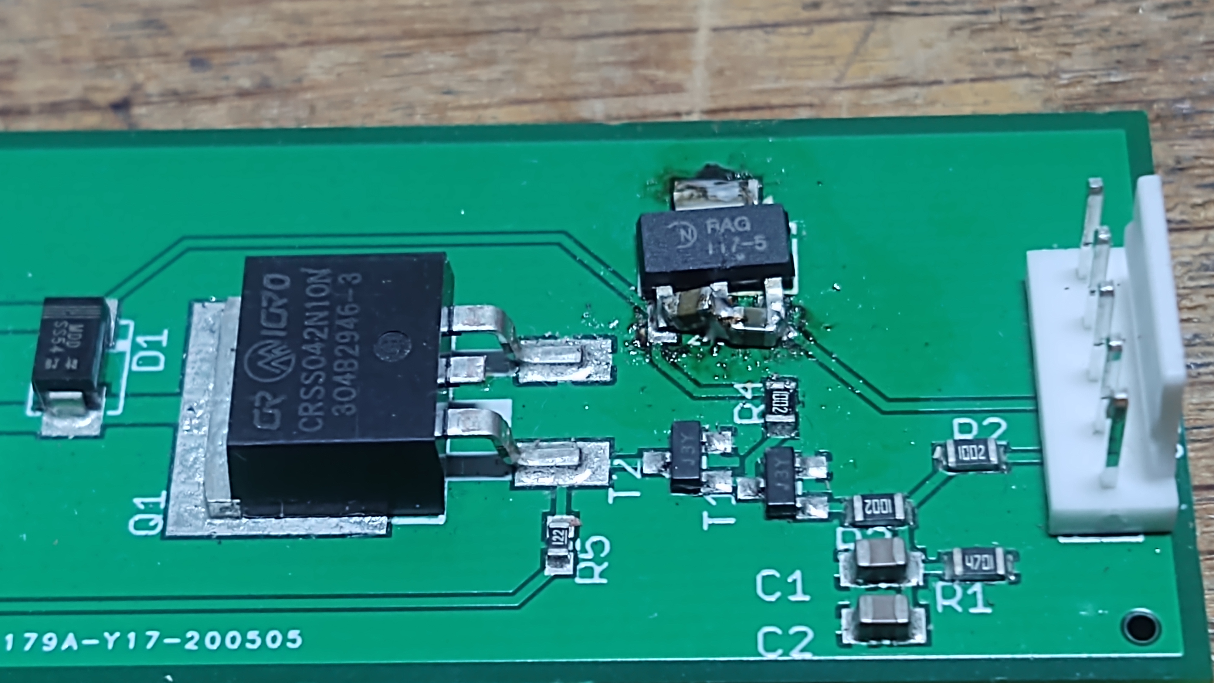

I'm having a few issues with the voltage regulator I installed as in I've replaced it a couple of times and it keeps going pop.
The component I ended up ordering was RAG117-5 as it came up as compatible but I can't find any info for it so I don't know if it is the correct part or not but suspect the pinouts are not correct.
After a bit more checking I'm even more confused though as all the voltage regulators I found when searching for NCP1117-5.0 (Replacment part suggested by Johu) have pin 1 as Gnd, pin 2 as output and pin 3 as input, and as far as I can see reading the circuit Johu has pin 1 - input, pin 2 is ground and pin 3 is output.
Can someone please advise where I'm going wrong.

So to see what would happen I decided to make a small daughter board for the 5V regulator and 2 caps and solder it in with the pins going where I think they should.
If you look carefully you can also see where I messed up the board by replacing the voltage regulator too many times and had to use a link wire. :o
And the good news is it now works. The bad news is I'm still confused about the circuit. :?
the worse news is I only get one press of the brake before the pump starts again. :(
I'm using a very small lead acid battery so that may be the reason or maybe I need to reconnect the vac hoses differently but the main thing is it works. :D

Seems you have the version without the TVS for protecting the regulator.
Otherwise the PCB design has pin 1 as GND, pin 2 (and the tab) as output and pin 3 as input.

johu wrote: Wed Jun 07, 2023 7:00 pm Seems you have the version without the TVS for protecting the regulator.
I think I got version 1.0
I was trying to get it working before putting the TVS diode in.
This is the same as mine.
Unless I'm not seeing it properly, in this PCB pin 1 is 12V, pin 2 is ground and pin 3 is output?
