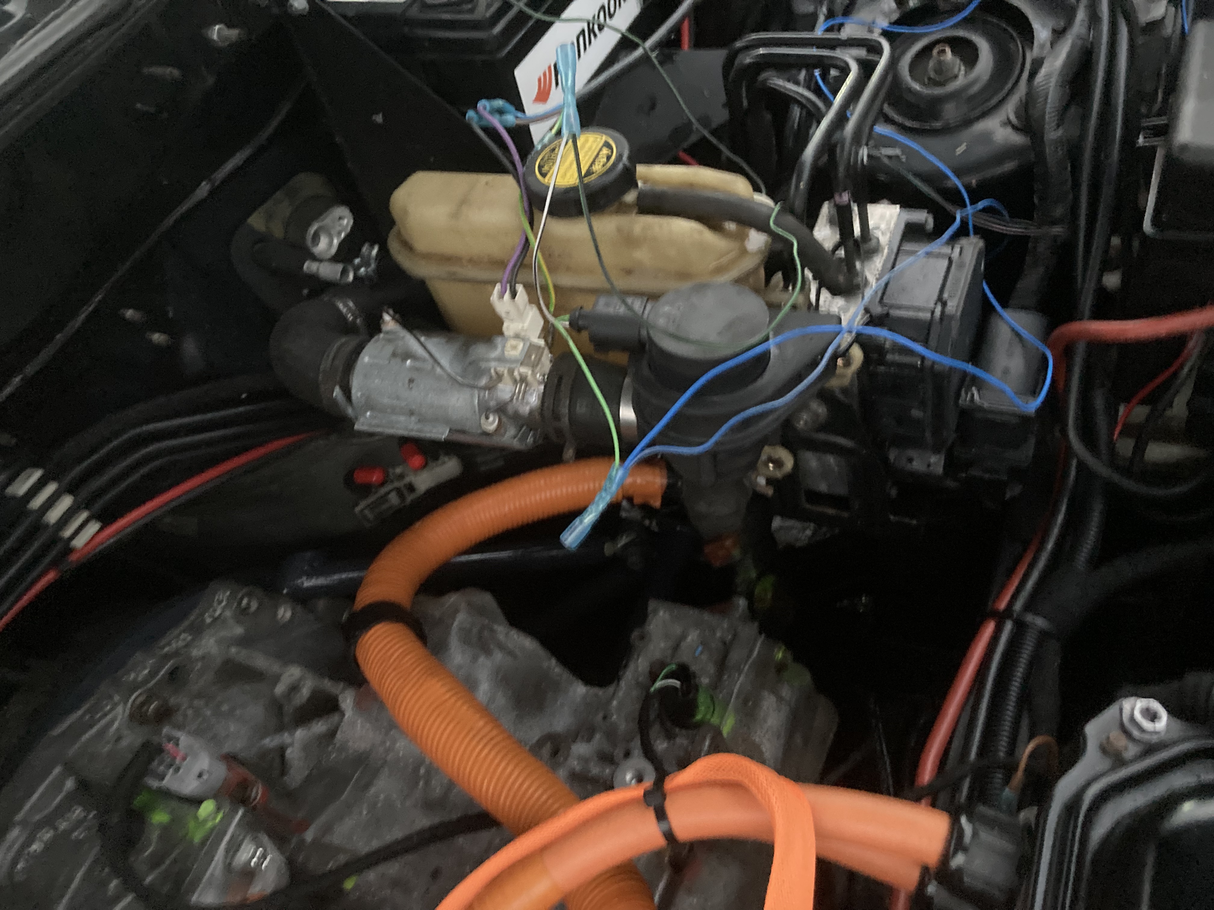

Well with a mostly drivable tune, the wiring tided up and finally finding the right can messages to convince the abs the engine ecu is still there I’m about ready for a fresh mot and some real testing.

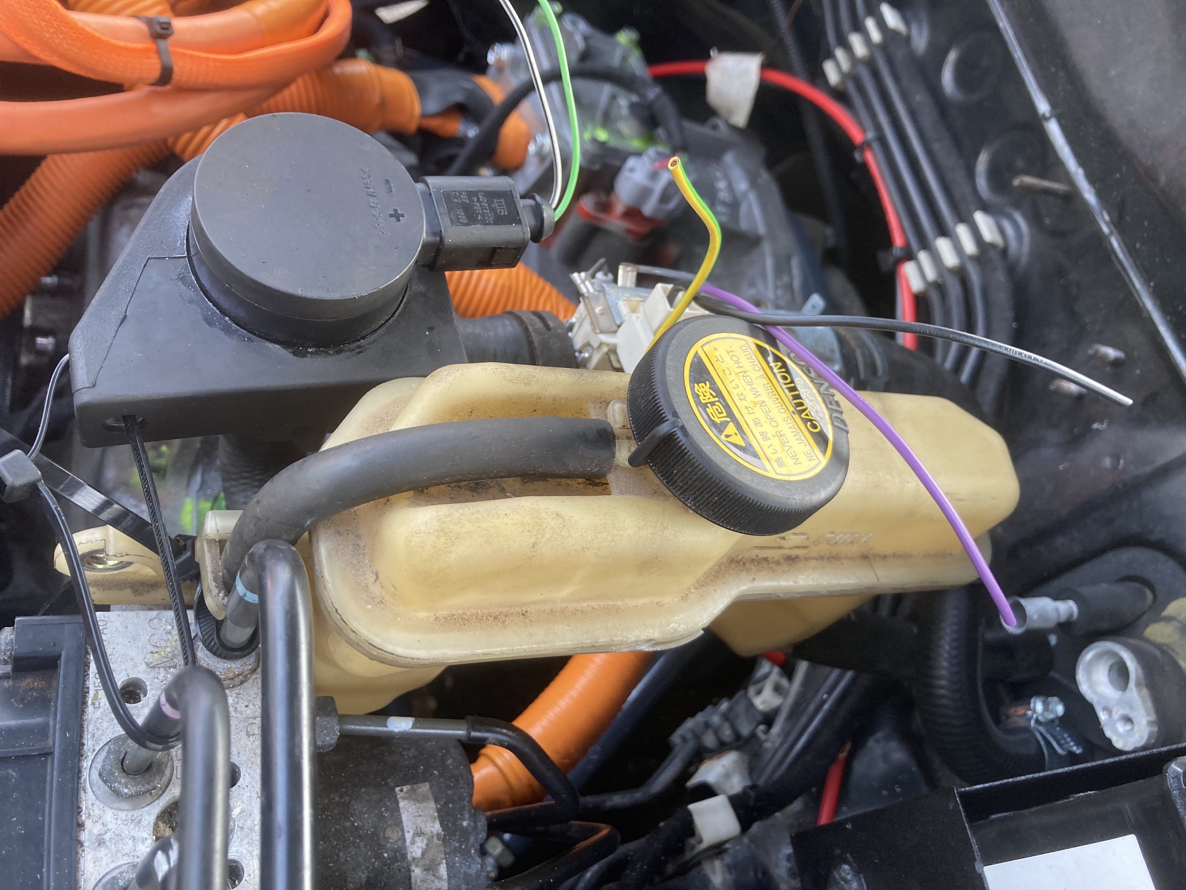

by Ev8
Nope no vacuum reservoir, I did on the previous setup that used a Saab pump and switch it needed one because of the lack of hysteresis, but the Audi pump and johu’s board works well without a reservoir,
Cooling is all plumbed into a fiat cinquecento rad behind the bumper,
And the auxiliary oil cooling pump which runs when the motor is turning has an oil cooler radiator beside the left fog light

Well it’s been a year off the road and a complete re engineer of the drive system, almost to the point I’ve basically converted 2 cars now, but I’m back on the road Mot passed and drove home, some interesting slow speed drivability kinks to sort out so lots of software tuning to do, but I’m happy to have made this milestone

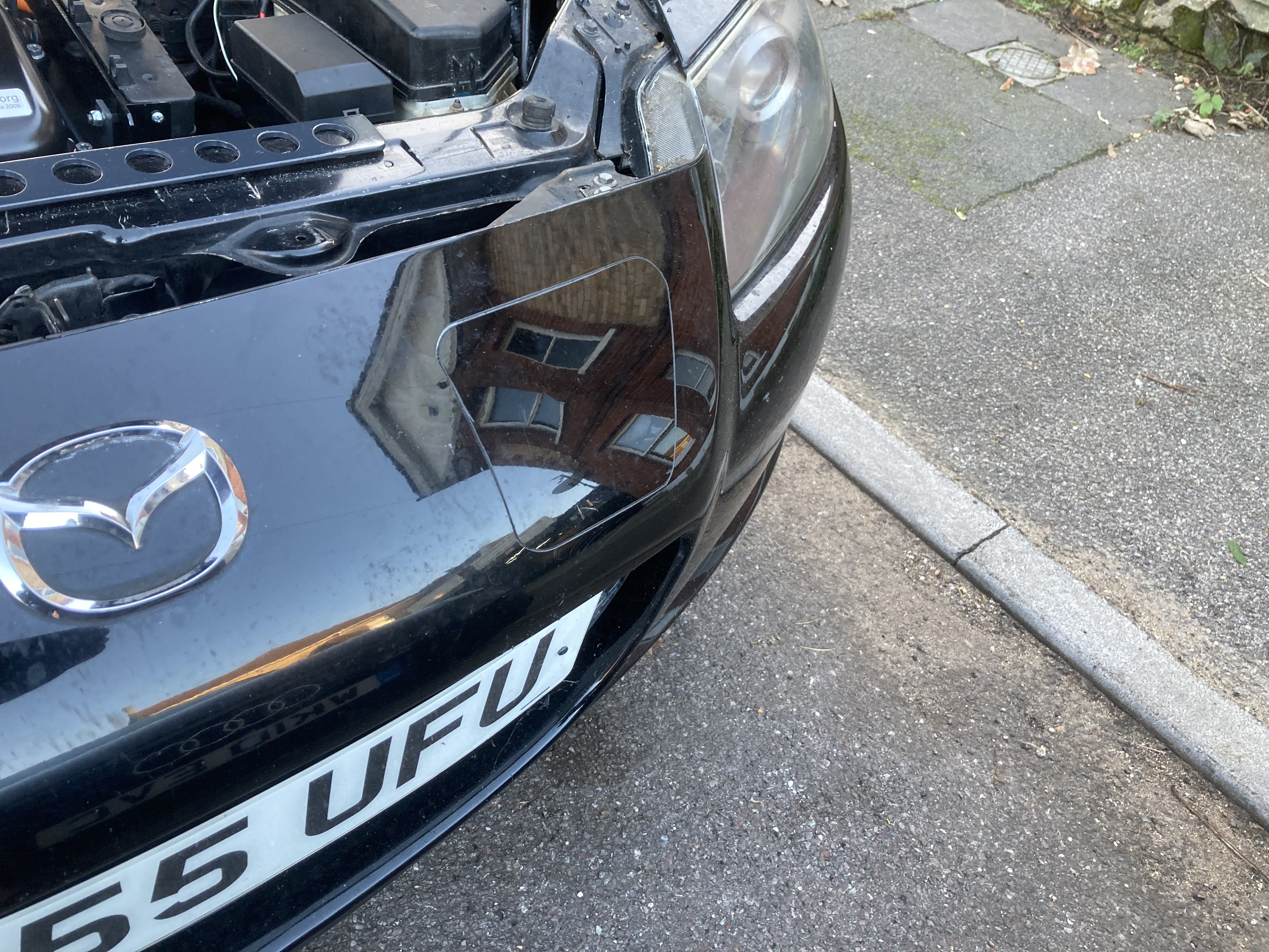

Ok so with the uk weather suddenly turning into 3c in only a couple of days things have changed priorities, I had started project chademo by cutting a hole in my bumper to make a flap to cover the charge port.

How on earth did you cut such a neat hole?
Re: Project RX8 , Prius gen2, Lexus transaxle to rwd
Posted: Thu Dec 01, 2022 6:36 pm
by m.art.y
Bigpie wrote: Thu Dec 01, 2022 5:26 pm How on earth did you cut such a neat hole?
That was my first reaction too. Must be high accuracy laser cutting for sure 😊

by Ev8
To cut the hole I used a fine toothed fretsaw blade, snapped the end of it off and heated it with a blow torch on the end to melt through the bumper to get started, I had masked it all up and drawn it out neatly so I had something to follow,
