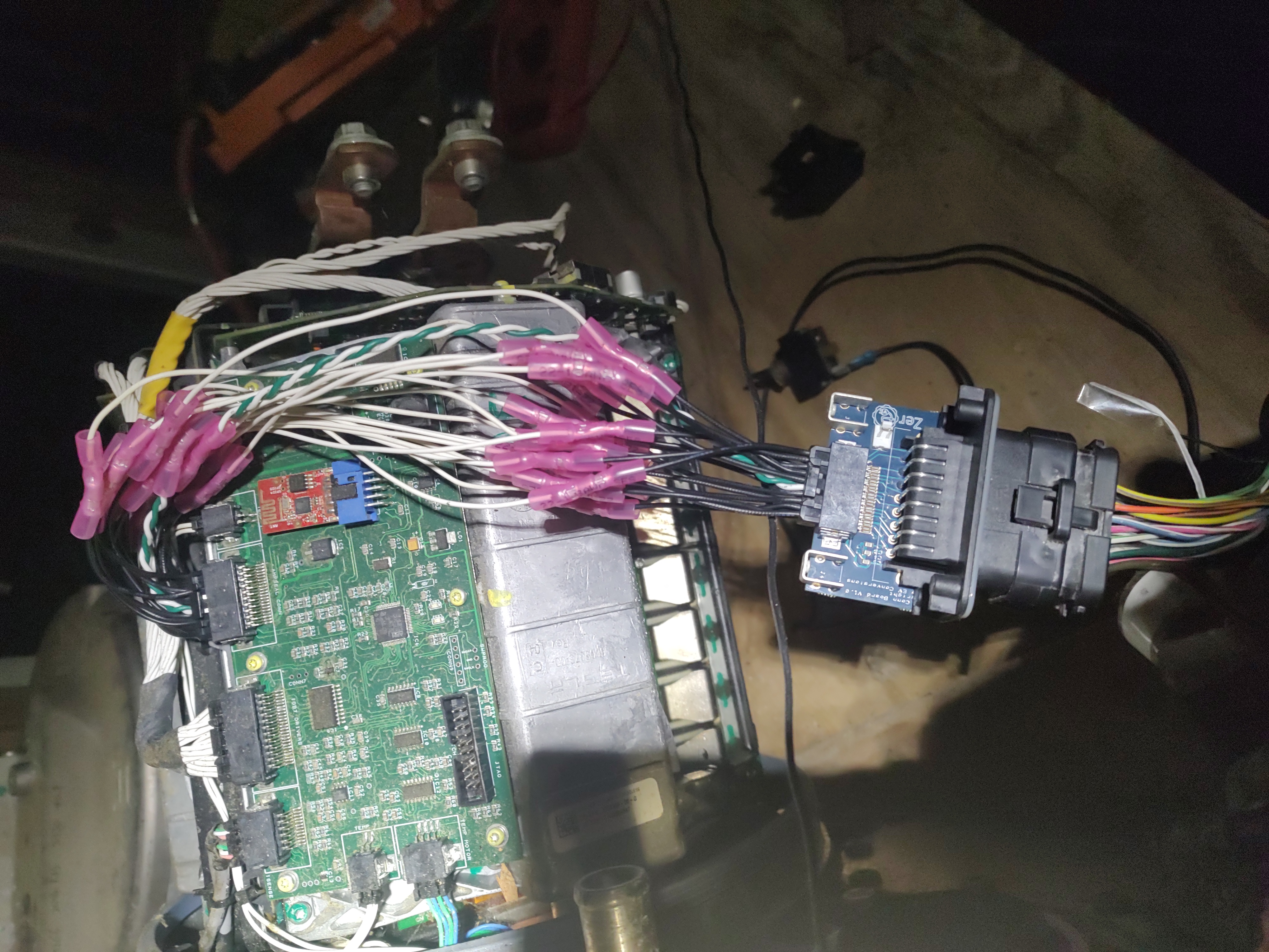

oh probably has to be twice as long of a harness as well to get the clocking right?

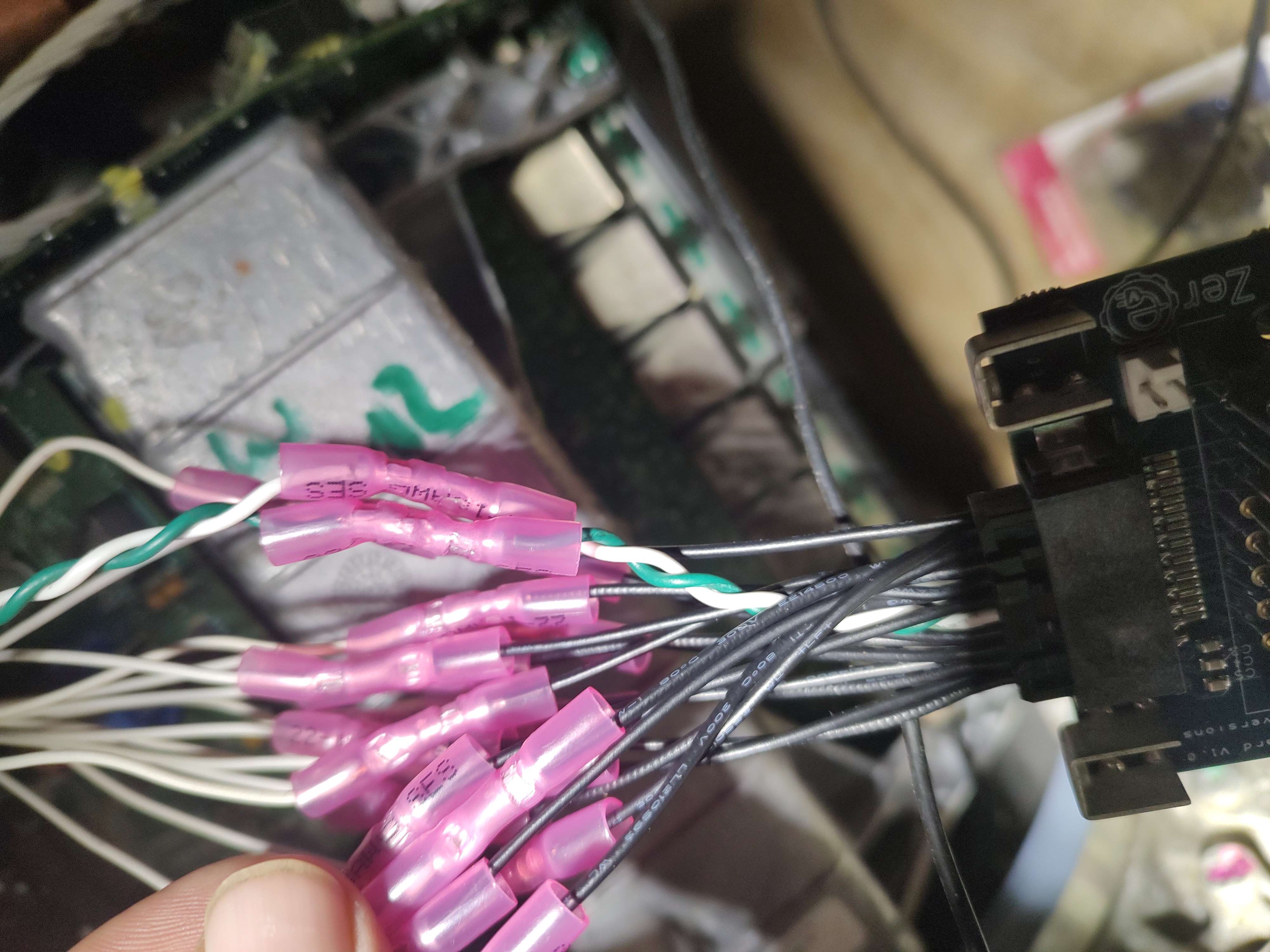

tom91 wrote: Tue Dec 24, 2019 11:59 am Yes and No.
Both do not fit from factory;
Connector: you need to modify the case a bit, not hard just tedious.
Cable: Current one in stock is too short, as the motor is clocked different it needs to be almost twice as long.
leman2112
Posts: 173
Joined: Sat Dec 21, 2019 10:30 am
Location: United States
Has thanked: 29 times
Re: Mercedes-Benz B Electric - motor support
Post by leman2112 »
I'll just cut the new harness in half when it gets here, one wire at a time, make it twice as long with crimp connectors and the original Mercedes wires, that way there is absolutely no guessing on my part on the pinout order.

Post by leman2112 »
here it is!
