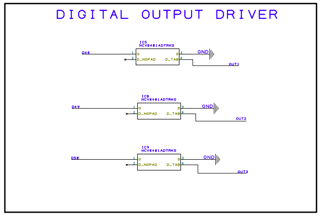

james@N52E01 wrote: Tue Apr 28, 2020 11:14 am So far not getting any output from either pin.
On which side of the NCV8401 driver are you measuring the output? The 3.3V logic side or the 12V load side? If the 12V load side then you need the contactor coil connected to 12V before you'll see any voltage with a multimeter.

Cookie6000 wrote: Wed Apr 29, 2020 8:56 pm Here you go Kevin.
Thanks, I think I see the problem...
You are using OUT3 as if it's a switched 12V power supply for the inverter. However, OUT3 does *not* supply 12V it's a switched ground (see circuit below). My guess is you should power the inverter with 12V from your ignition switch and ignore OUT3.
Also note that unlike your drawing the inverter has three 12V pins according to this document;
http://productions.8dromeda.net/c55-lea ... tocol.html
You also have a similar issue with OUT1 and OUT2 driving your contactors. You should connect the contactors to 12V and the OUT1/OUT2 pins. The ground is switched by the NCV8401A devices;
https://www.onsemi.com/pub/Collateral/NCV8401-D.PDF
Let me know if this makes no sense :)
Edit: how are you controlling the negative contactor?

Cookie6000 wrote: Thu Apr 30, 2020 11:44 am I think I have the inverter relay I added wrong. Should the gnd side I have in there actually be to 12v as do the contactors as the VCU controls switched ground?
You are correct, the inverter power relay should be connected to the 12V not ground. One word of caution, I do not know whether this feature is used by Damien in the current software so this may not work.
We also need to check in the software whether the OP1 used to drive the precharge and negative contactors is active during operation or just precharge. Just try it and see what happens (I recommend you use a bulb or heater element current limiter for the HV when testing contactor operations).
In the future we need to add a kill switch and impact switch to your 12V circuit. We can address that once your system is working :)
