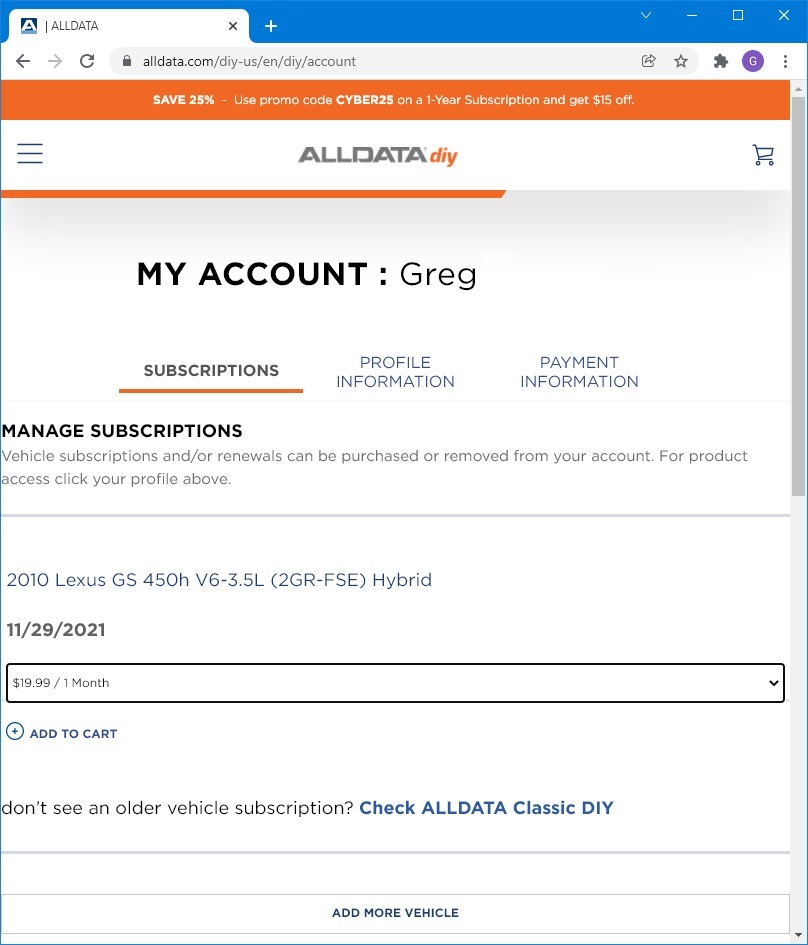

I am certain All Data the online car manual company will be refunding me my money for all the days I went to their website and it was down, ha ha

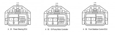

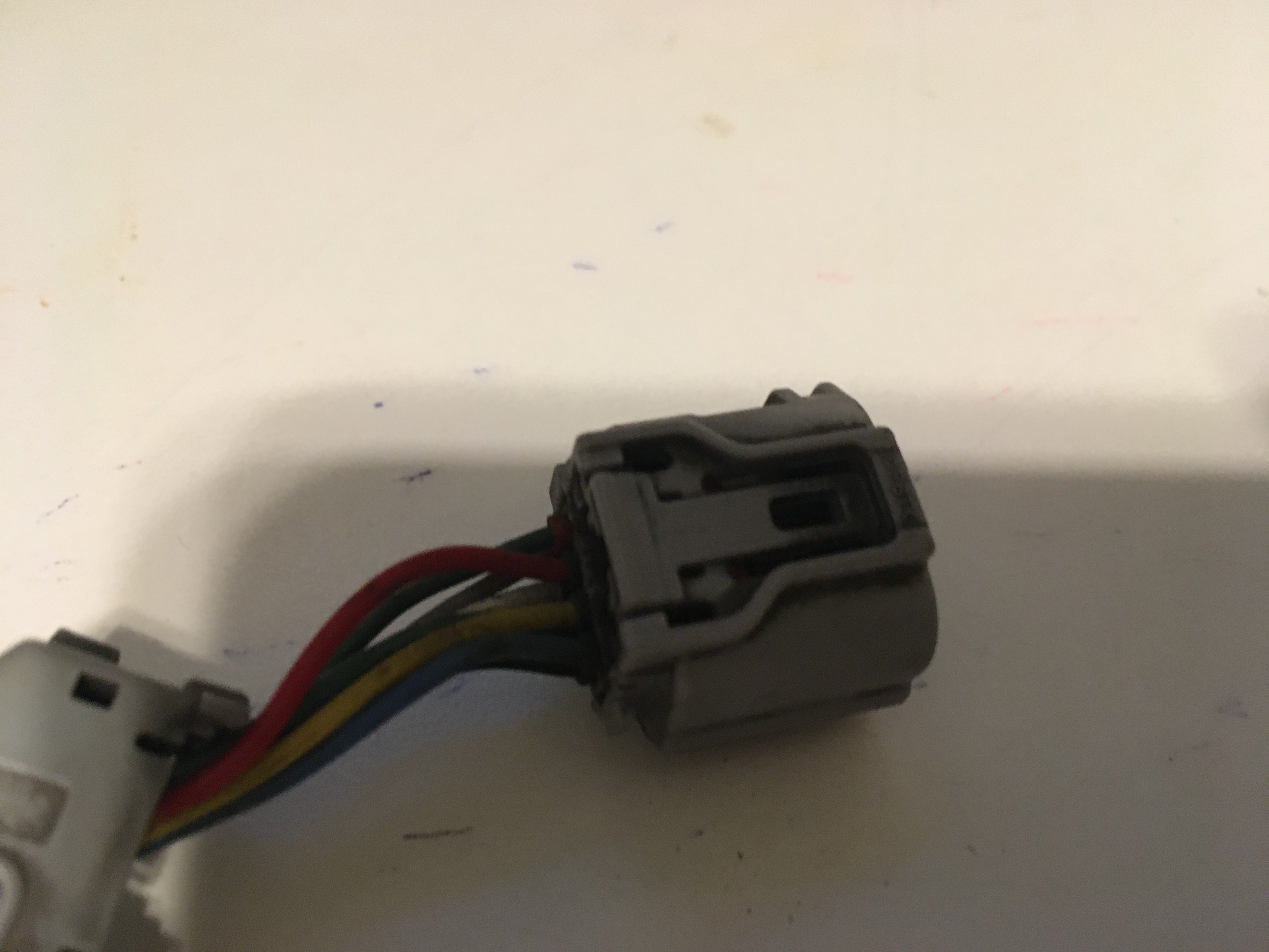

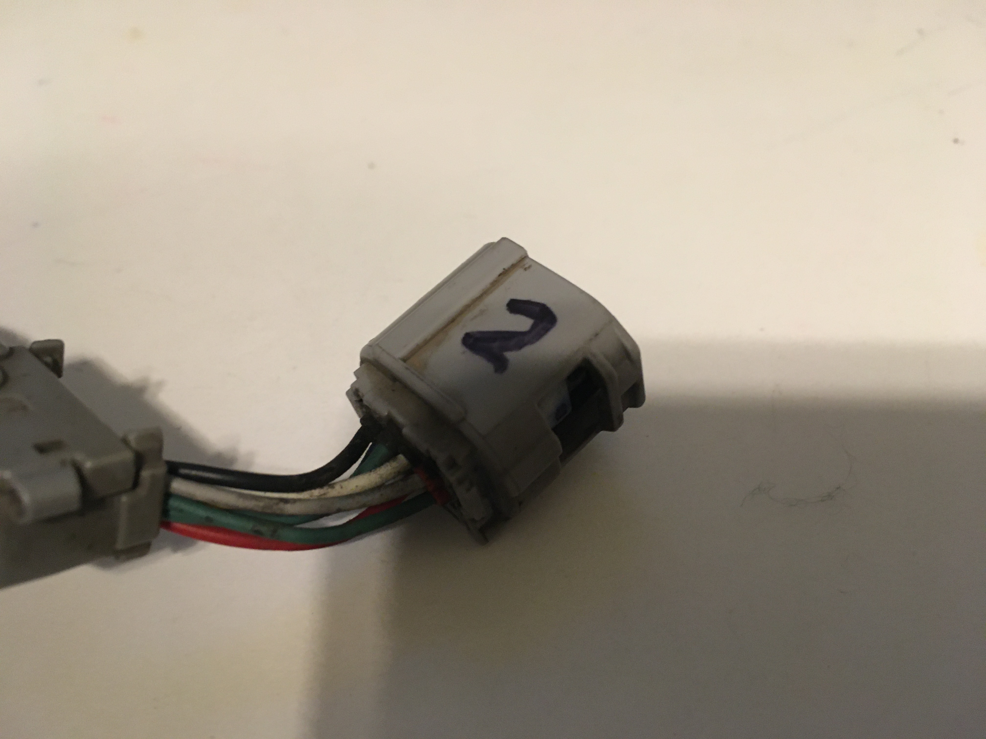

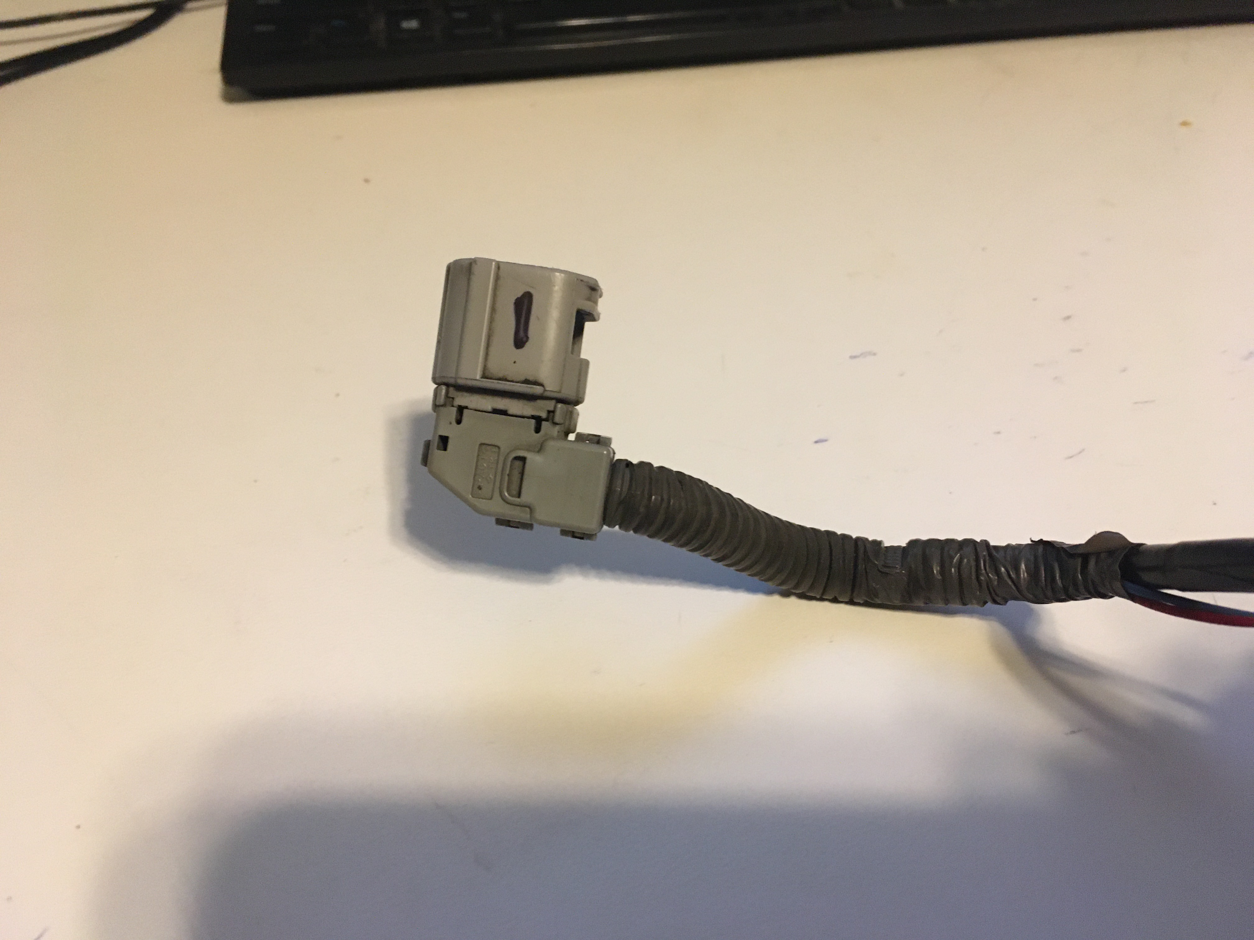

Fun Fact: among the 3,754 different and I mean completely different plugs and connectors on this vehicle (the Lexus GS450h) apparently their designers ran out of steam and decided to use three identical ones, and I mean absolutely samesies for the following three components, which mind you live within a foot of each other
  • Power Steering ECU
  • Oil Pump Motor Controller
  • Front Stabilizer Control ECU
no I am not taking the time to post this because I chased down and pulled the wrong harness [ahem] three times
Engine Compartment - Position Of Parts - ALLDATA diy.pdf
(2.35 MiB) Downloaded 444 times

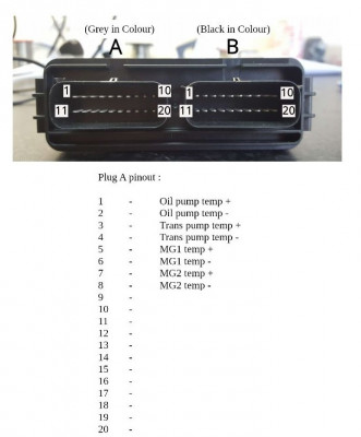

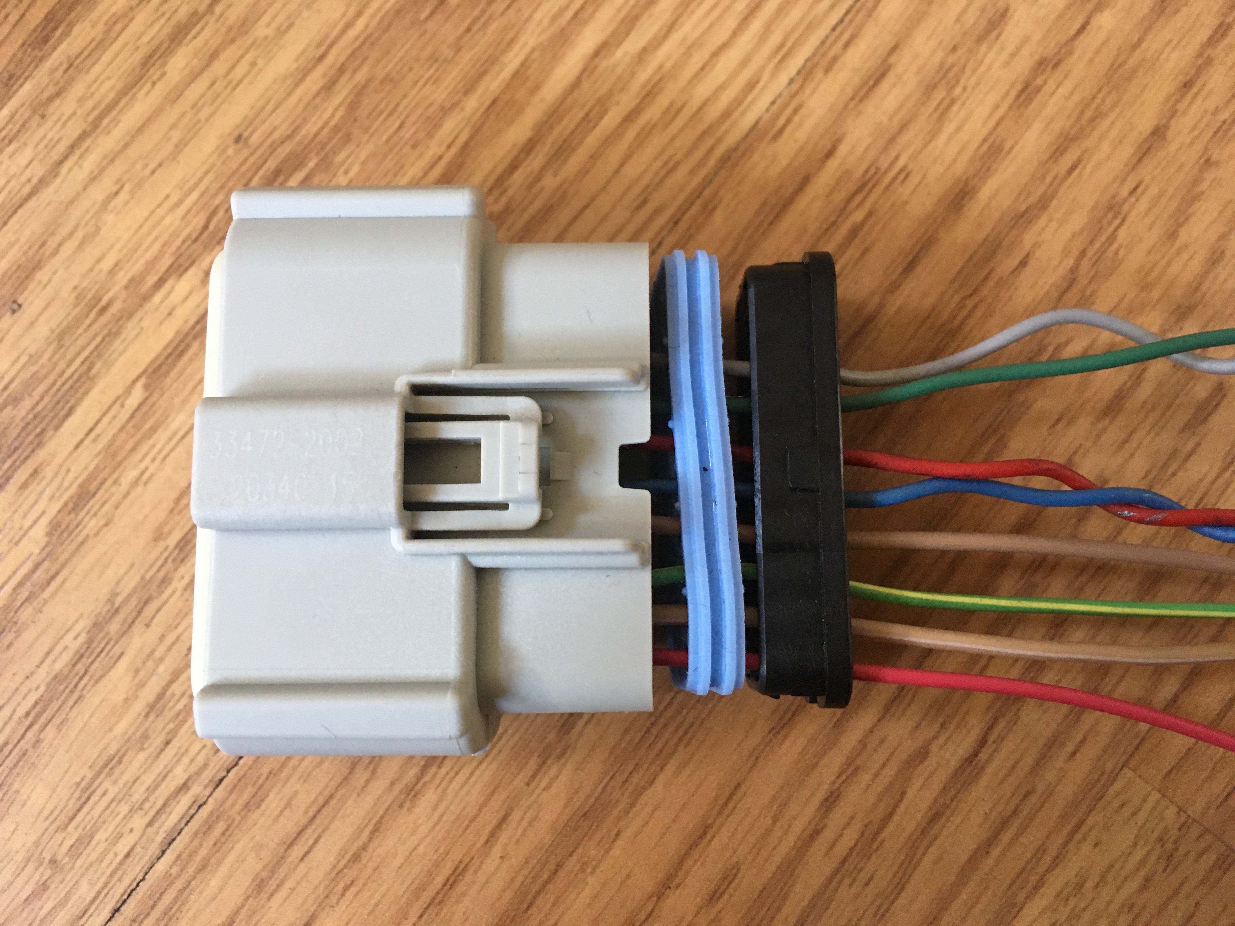

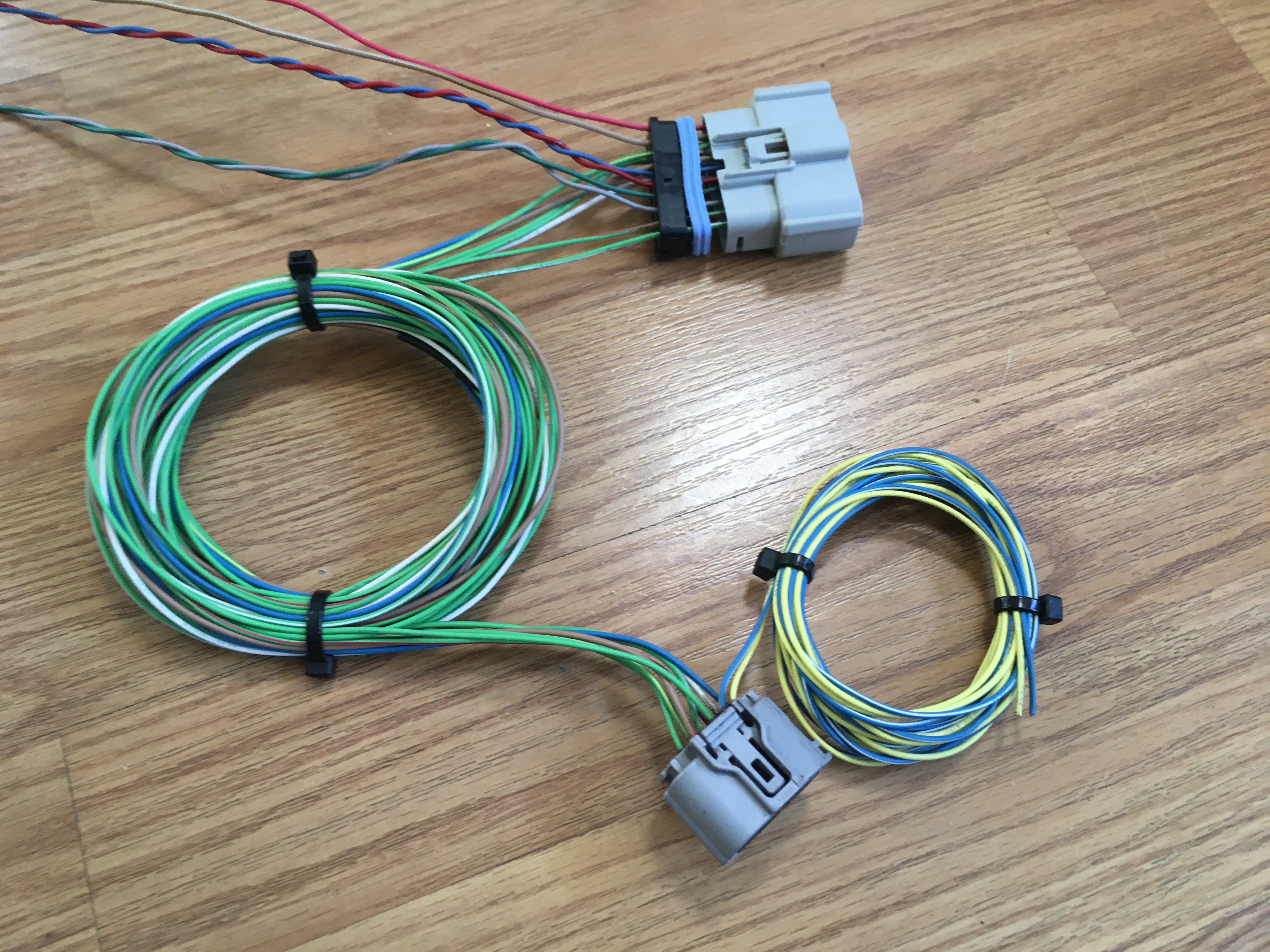

well I just wasted a couple days wiring the four temp sensors on the gray A Connector only to find out these don't work do to the wrong resistors on the PCB?
#define OilpumpTemp A7
#define TransTemp A4
#define MG1Temp A5
#define MG2Temp A6
so we totally do not need to run these 8 temp wires on Pins 1-8

slightly irked by this latest finding, I decided to unpin the unnecessary temp sensor wires from both resolver cables Sumitomo plugs for that clean slick look
Fun Level: -2
PatrcioEV-ATX
Posts: 192
Location: Austin, TX, USA
Has thanked: 42 times
Been thanked: 67 times
Post by PatrcioEV-ATX »
Since I completed my entire wire harness before I realized that none of those work, I've left it all. It's easier than undoing it and maybe someone will eventually work out the temp issues. I am considering removing PB1-3 however to use those as auxillary 5v inputs. Maybe for cruise control. I really don't think I'm going to bother with shifting gears and I pretty much ruined two of my four mosfets when trying to replace the incorrect ones on the board. The more I think about it, the entire transmission connector (SLs, PBs, etc) can probably be repurposed.

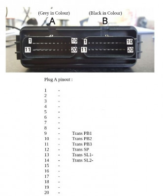

I hear you, that was the very next thing I did I ditched all the Transmission Shift Solenoid wires on Pins 9- 14 saying good by to that gray transmission plug all together
#define TransPB1 40
#define TransPB2 43
#define TransPB3 42
#define TransSL1 47
#define TransSL2 44
#define TransSP 45

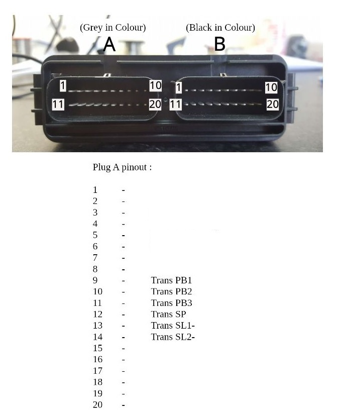

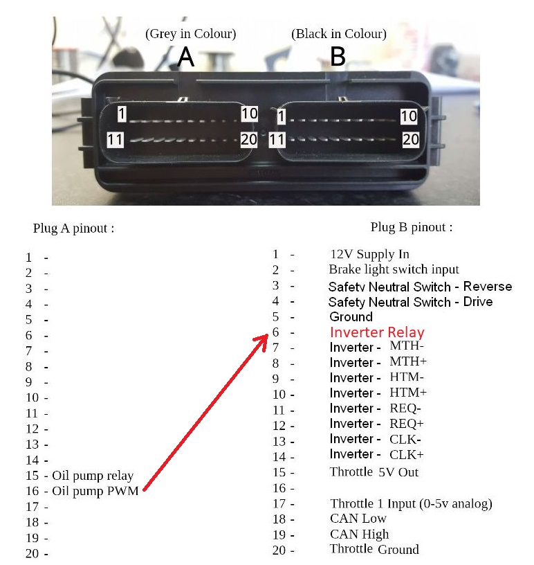

So my not doing continued and I was not doing anything just fine until I came across the Oil Pump wiring/pin out, I know I can ditch the Oil Pump relay on pin 15 on the gray A Connector, but as one forum member suggested, can I repurpose Pin #6 on the black B Connector for the Oil Pump PWM ? Thoughts and comments appreciated
#define OilPumpPower 33
#define OilPumpPWM 2
A COMMENT FROM MY FUTURE SELF:
Pin #15 is not OIL PUMP Power by any means it is the MOST IMPORTANT Pin in the whole setup it is the "Pre-Charge" circuit
PatrcioEV-ATX
Posts: 192
Gregski wrote: Wed Dec 08, 2021 10:10 am So my not doing continued and I was not doing anything just fine until I came across the Oil Pump wiring/pin out, I know I can ditch the Oil Pump relay on pin 15 on the gray A Connector, but as one forum member suggested, can I repurpose Pin #6 on the black B Connector for the Oil Pump PWM ? Thoughts and comments appreciated
Well as far as I know, the Inverter relay is a digital output (on/off) where the Oil Pump Pwm is an analog output (0-5v) so unless you want your pump running at 100% that won't work. I don't know how to interpret what the different microchip pins are capable of, however. I don't know if anyone is running the pump over 50%. Is it possible to re#Define the Inverter relay pin to a different analog pin? Maybe.
2012 Nissan Leaf (sold)
2016 Mercedes B250e (sold)
2023 Volvo C40
Gregski
Posts: 3158
Has thanked: 630 times
Been thanked: 1607 times
Post by Gregski »
PatrcioEV-ATX wrote: Wed Dec 08, 2021 2:21 pm
it is my understanding that PWM is a fake analog signal so it would make sense that it runs on a digital line
here is how they are defined in the code (they look similar just on different numbers):
#define InvPower 34
and here is how analog pins are defined:
int Throt1Pin = A0; //throttle pedal analog inputs
int Throt2Pin = A1;

alright moving down the list, next is Pin #17 on the gray A Connector, in the code aka Sketch it is defined like so on pin 50 (can someone explain to me how it can be on pin 50 out of 40 total pins between the two 20 pin connectors? ha ha)
#define Out1 50
this one controls the HV battery Main Contactor, and by controls I mean turns it off at startup (I really don't get it yet as no where in the code it turns it back on)
digitalWrite(Out1,LOW); //turn off at startup

Gregski wrote: Thu Dec 09, 2021 4:06 pm alright moving down the list, next is Pin #17 on the gray A Connector, in the code aka Sketch it is defined like so on pin 50 (can someone explain to me how it can be on pin 50 out of 40 total pins between the two 20 pin connectors? ha ha)
#define Out1 50
The pin numbers in firmware don't relate to the pin numbers on the connectors. They map the signals in firmware to the correct port pin on the microcontroller (there are way more than 50 pins on the MCU). Also it looks to me like pin #17 on that connector is "IN1" when I read the schematic.
Are you using a V1 or a V2 board?

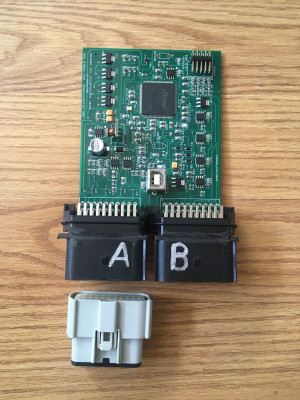

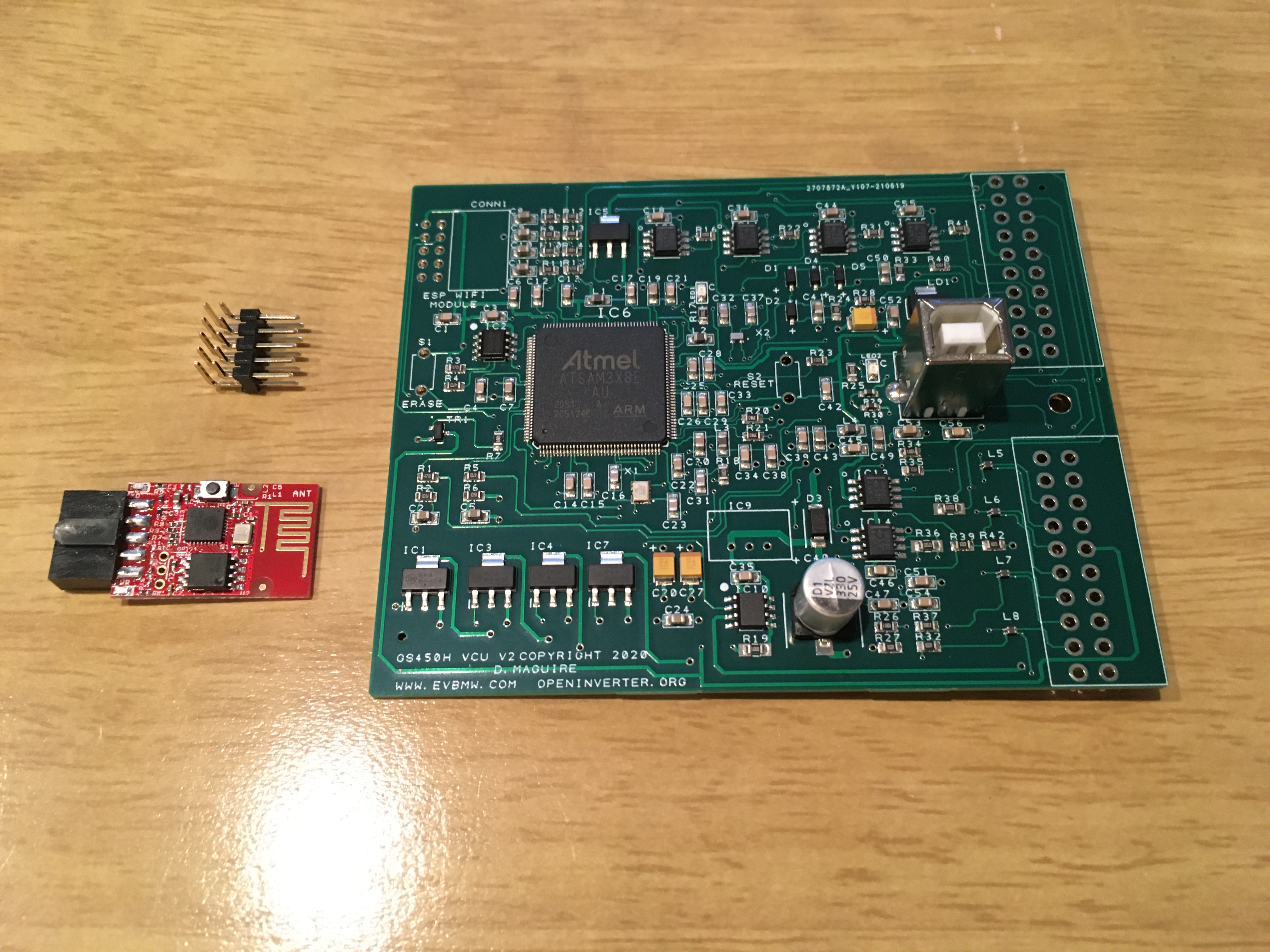

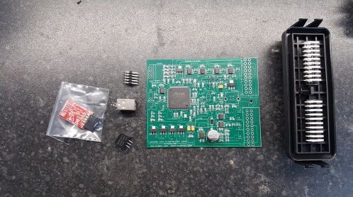

First thank you so much for your help, you are offering a lot of good information so let me respond to you and address your points one by one.
mayes8229 wrote: Thu Dec 09, 2021 4:40 pmAre you using a V1 or a V2 board?
Honestly I am still a little bit confused by this, I think I bought V2, I got it from here Lexus GS450H VCU
When I say I am confused, it is because in one place it reads: "V2 controller for the Lexus GS450H inverter" and then you click the link and it reads: "Product Code: gs450h_v1_built" so which is it? ha ha and then on Damien's GitHub he actually has a V3 folder with a HARDWARE sub folder, what ever that is?
as listed
and actual (I understand there is a parts shortage, absolutely no complaints here)
as listed
Your board has V2 in silkscreen, so there's your answer. Because it's a V2 there's a different power switch and a BJT rather than a FET, but that doesn't change the previous comment about not being able to PWM that signal.
