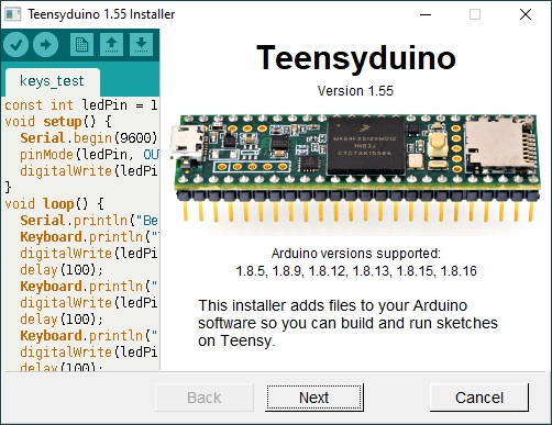

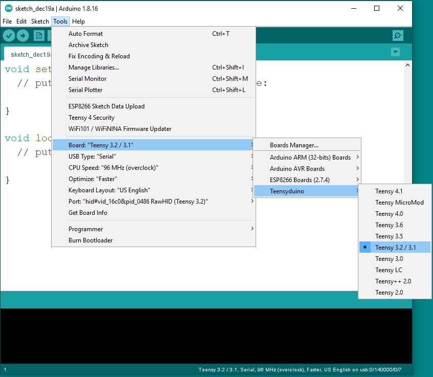

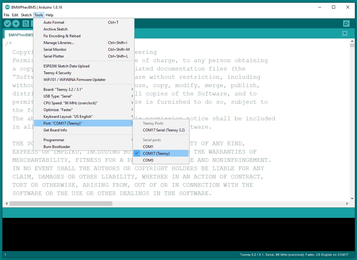

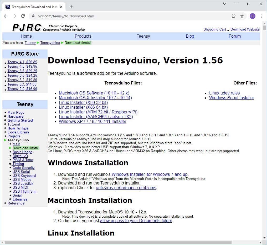

Just a thought, have you got Teensyduino installed? (The Arduino IDE that's been "teensyfied")
Gregski
Posts: 3164
Has thanked: 633 times
Been thanked: 1610 times
Re: I bought a Chevy Volt Gen1 DC-DC Converter - Now What?
Post by Gregski »
mjc506 wrote: Fri Mar 18, 2022 2:15 pm Ah, good to have a working system to compare against :)
this is actually worthy of a discussion or comment, I feel like to really make it headache free you need a dedicated computer or laptop just to a platform because all these microcontroller boards and Arduino sketches totally conflict with one another, I am constantly pulling this library out and putting this one in when going between Damien Maguire's Lexus GS450h VCU (which I luv by the way) and my UNO to talk to my ISA current shunt, to the DUE for CAN Busing and the Teensy for SimpBMSing, anyone else experienced this? I think I saw Damien with multiple laptops in a couple of his videos.
mjc506 wrote: Fri Mar 18, 2022 2:15 pm Just a thought, have you got Teensyduino installed? (The Arduino IDE that's been "teensyfied")
yes and got it working with Tom de Bree's SimpBMS

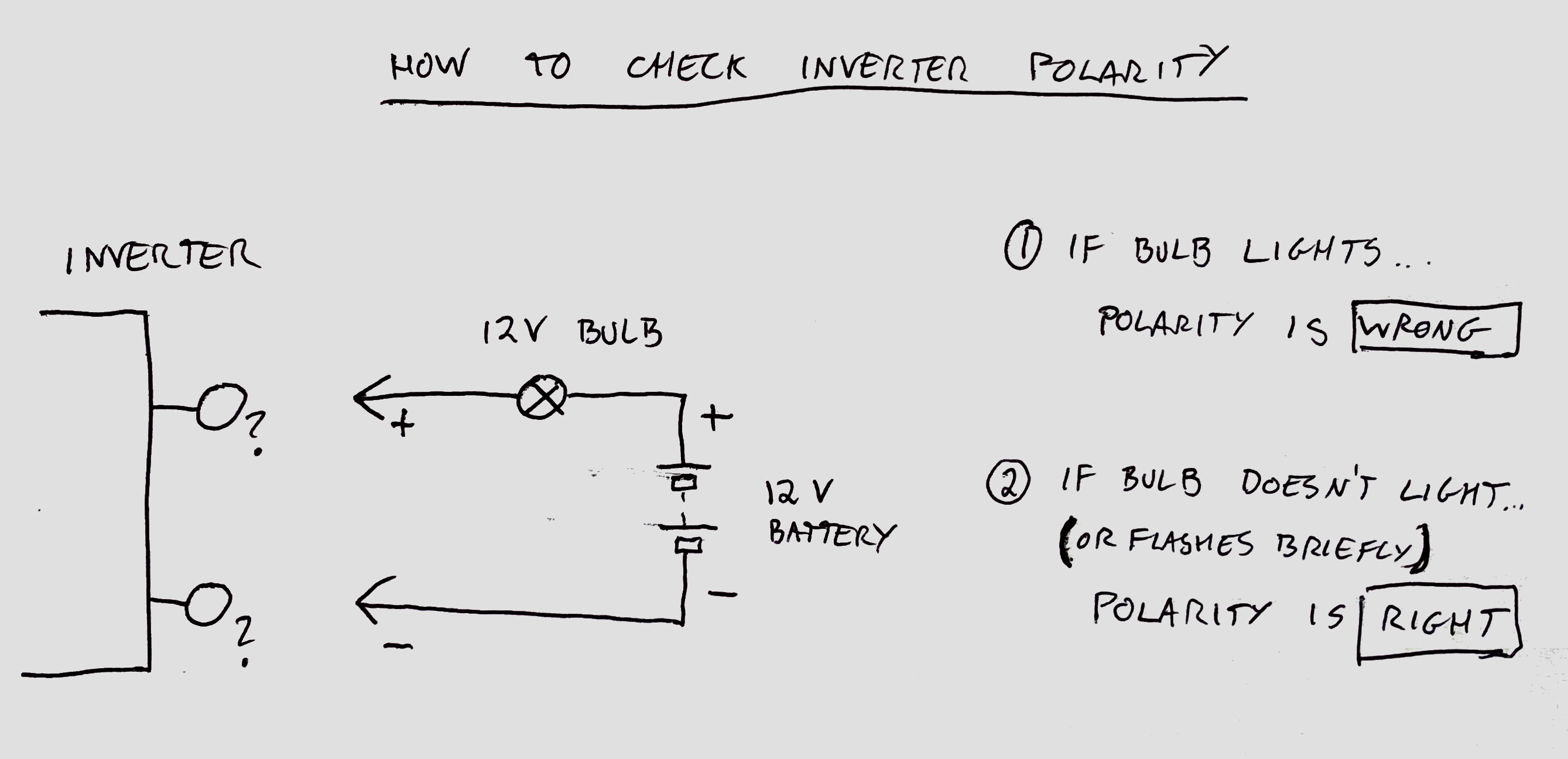

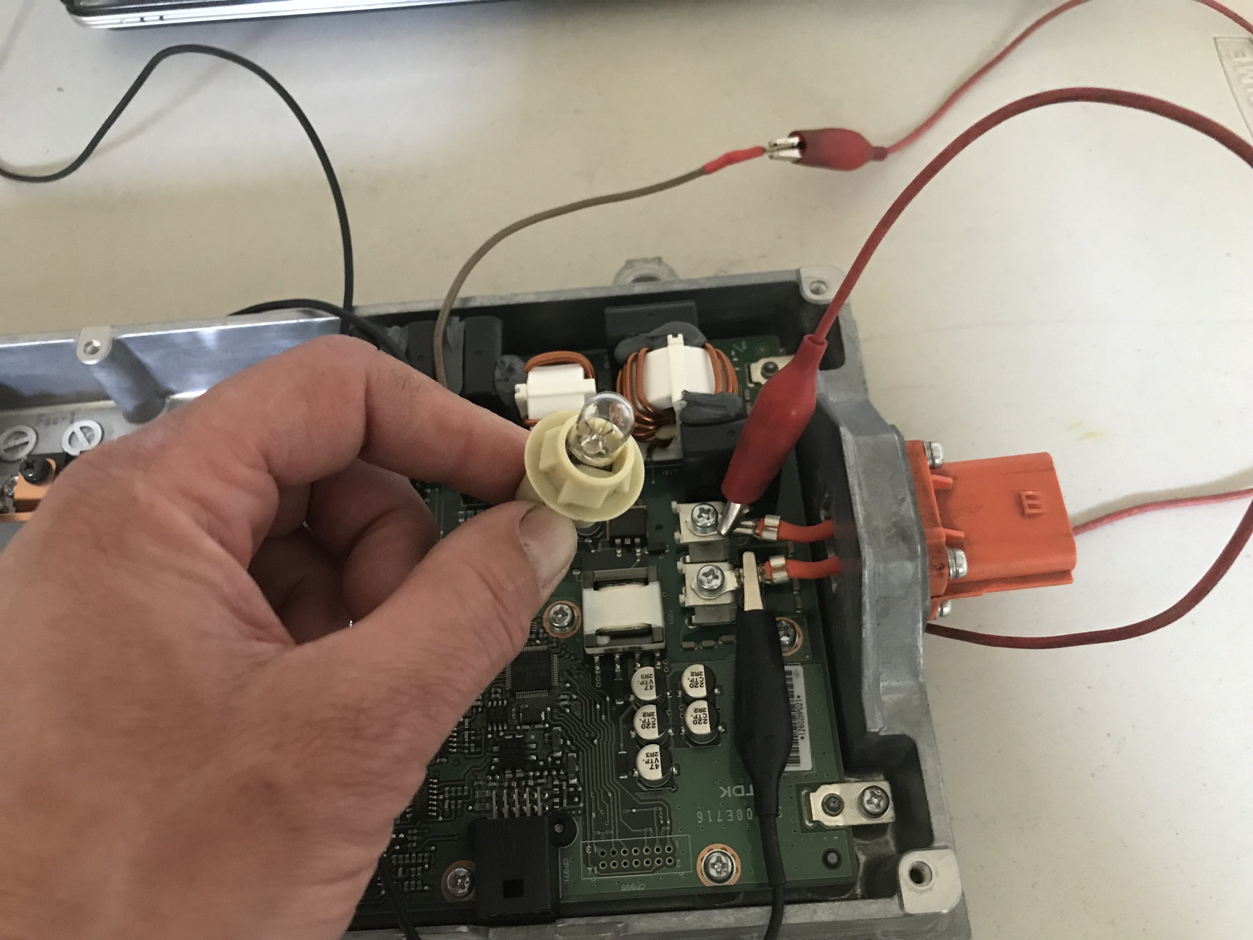

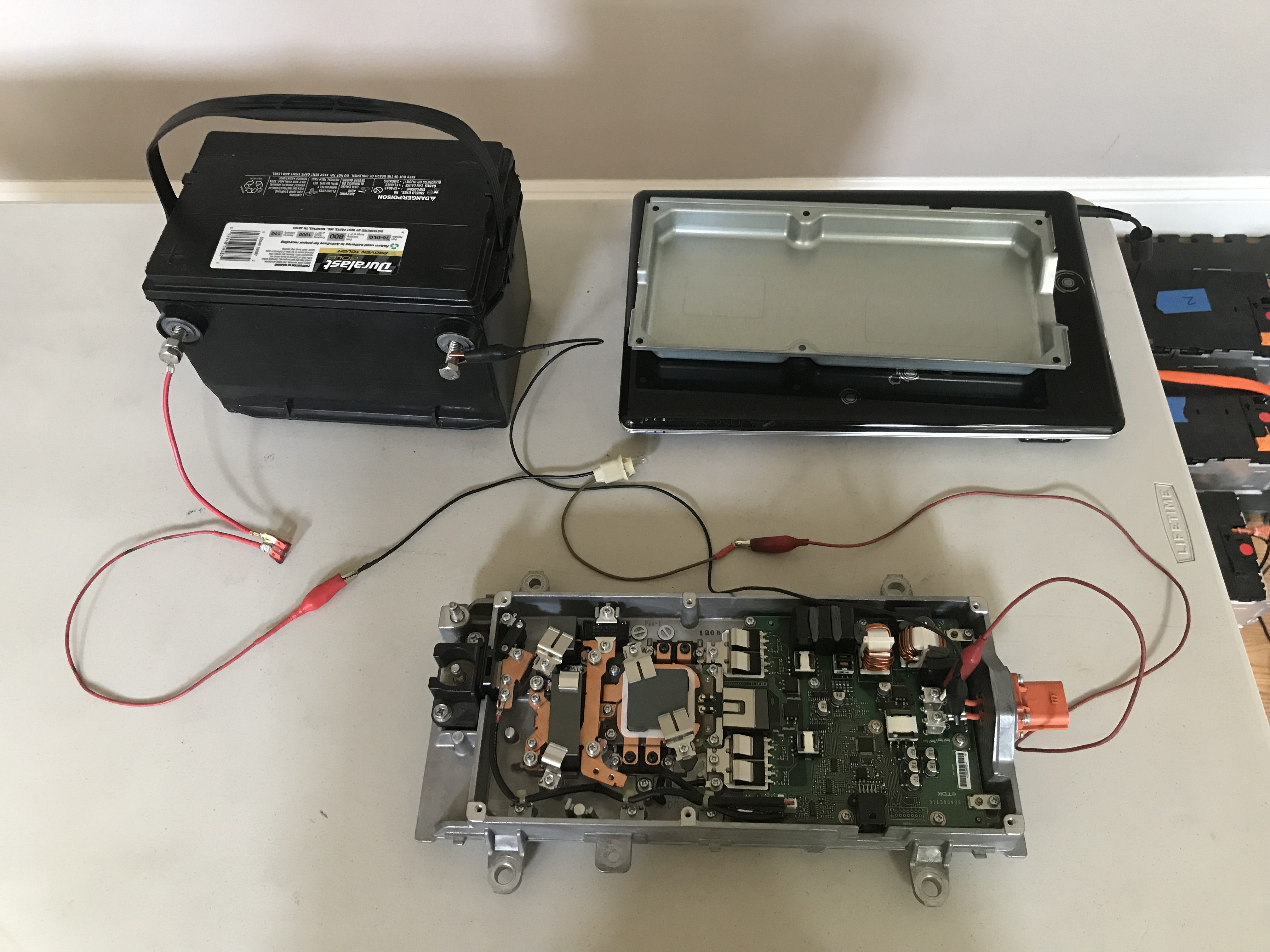

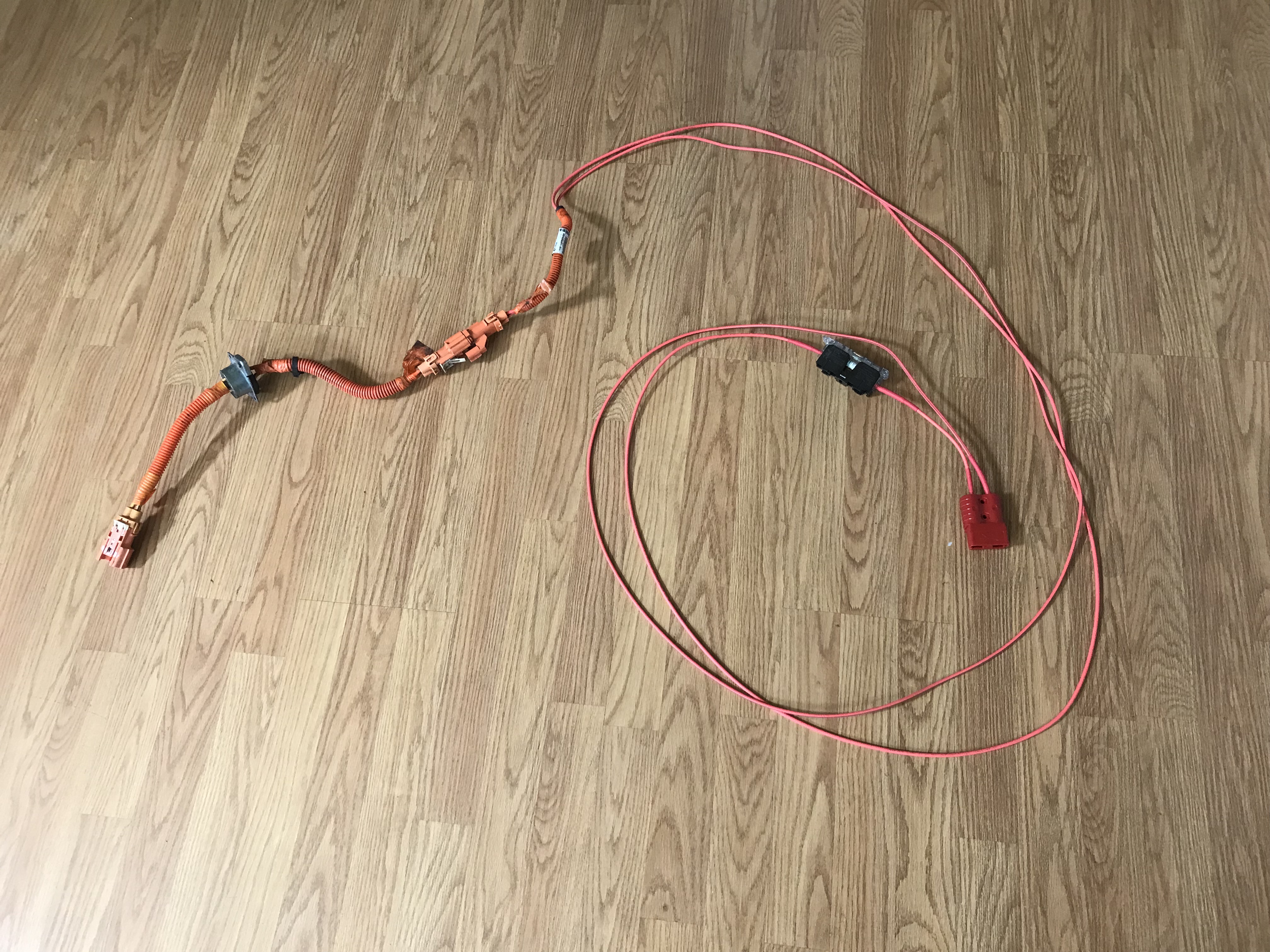

so I've been beating up on the Chevy Volt first gen DC-DC converter in a companion thread called: I think I CAN, I think I CAN... but I want to share some highlights in here as well from what I learned
first here is how to check the polarity ie figure out which wire is positive which one is negative
no light so polarity is correct

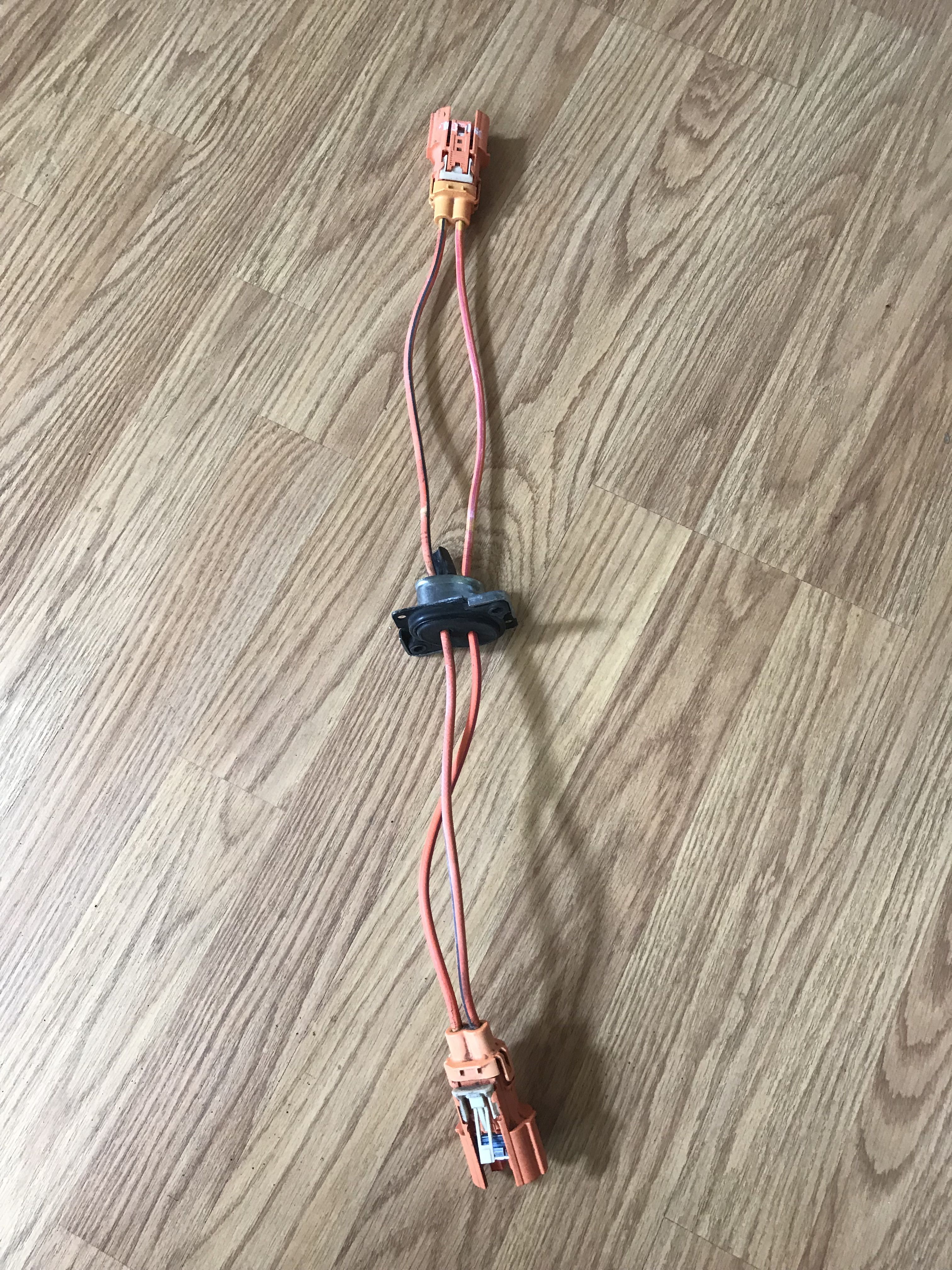

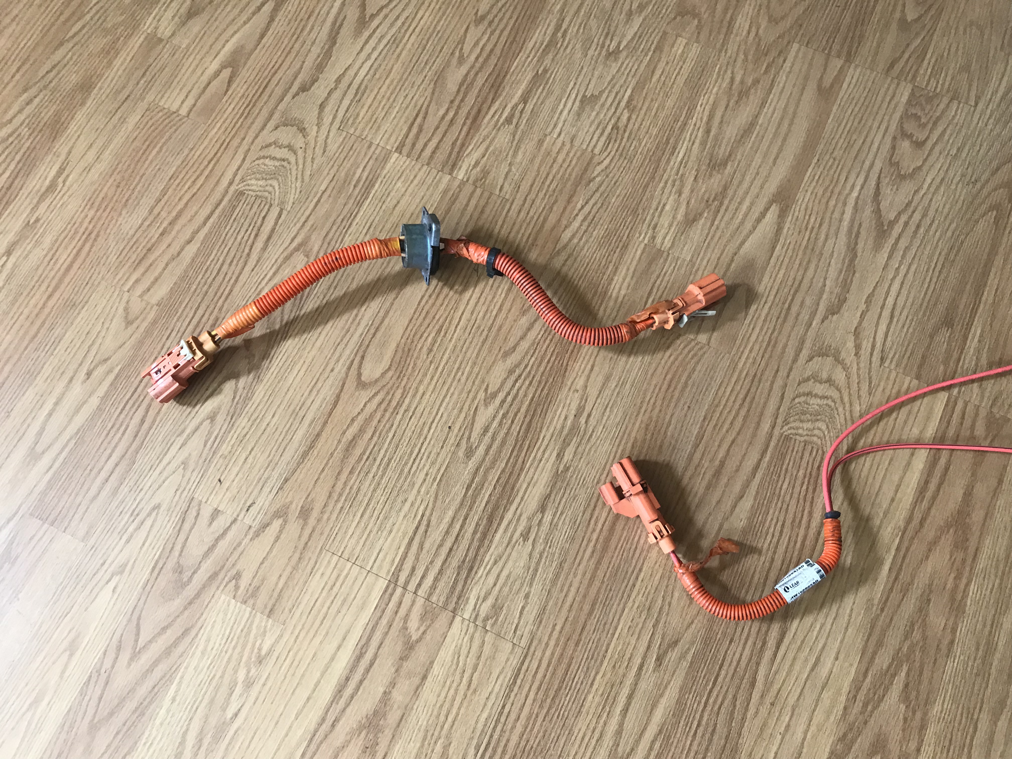

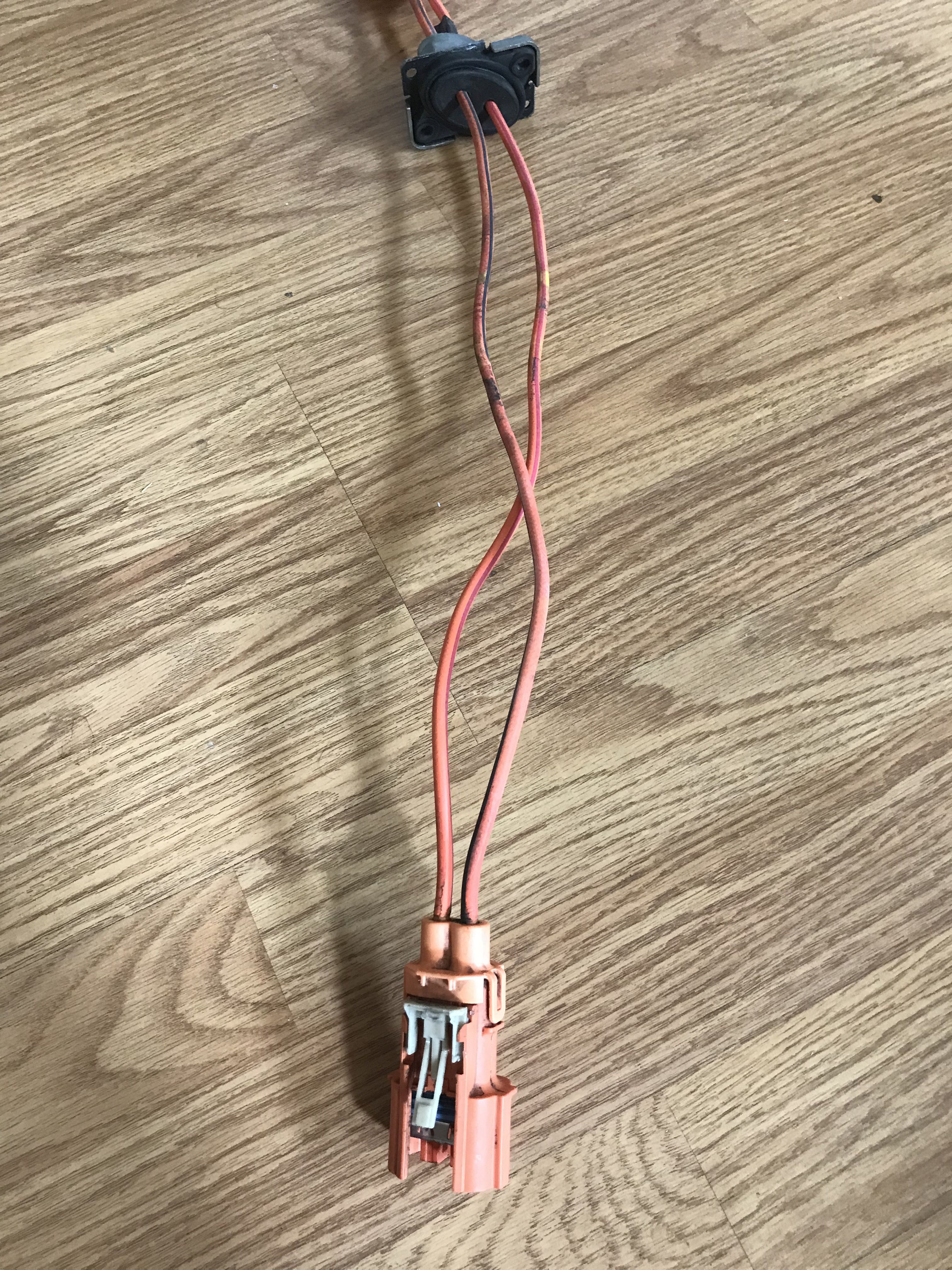

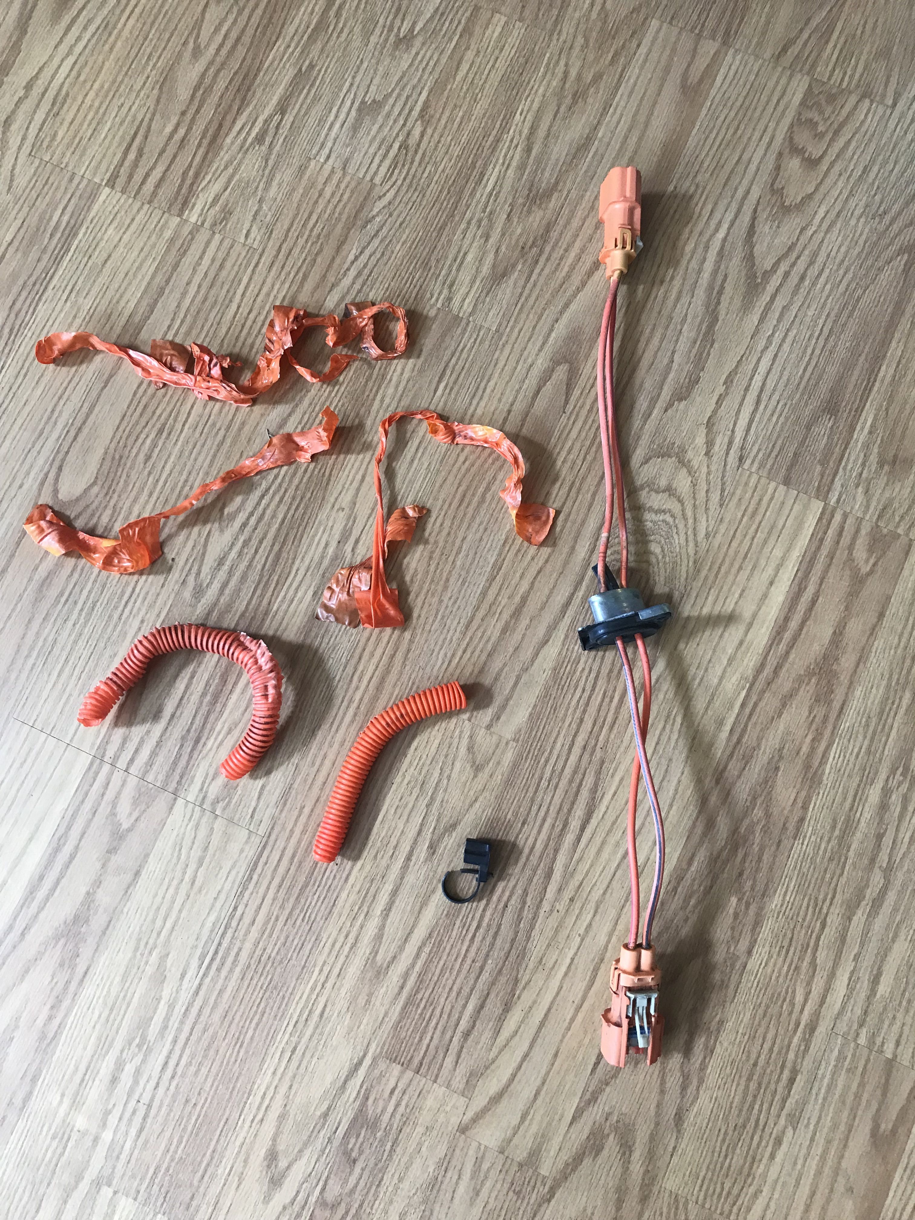

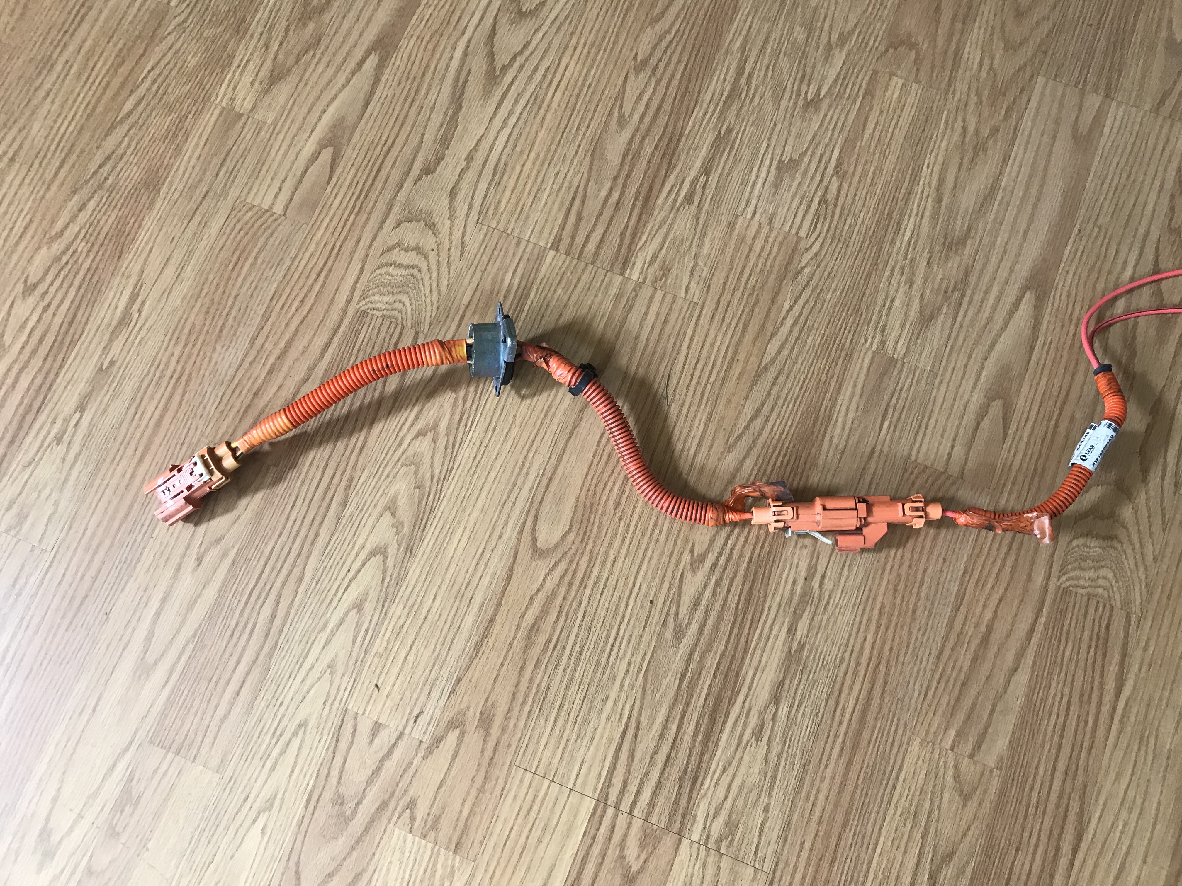

and here is something I learned, GM crossed the wires in the intermediate cable running from the converter to the battery pack
Gregski
Posts: 3164
Post by Gregski »

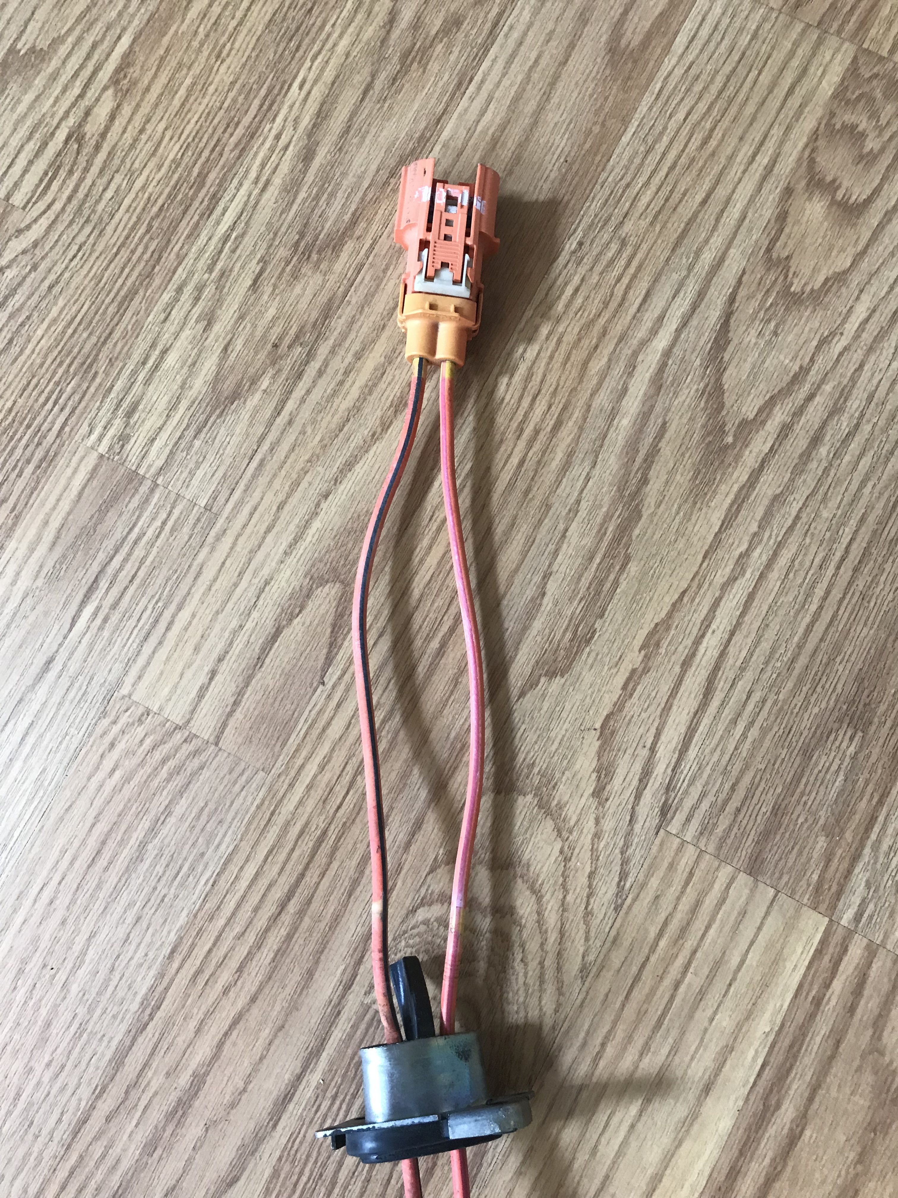

here's a close up
