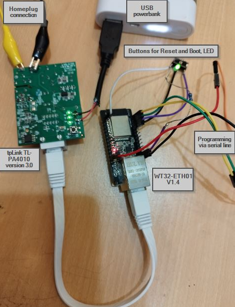

Open source CCS using AR7420
- uhi22
- Posts: 1117
- Has thanked: 206 times
- Been thanked: 617 times
Besides the Python variant for Raspberry and Notebook, I was searching for a more compact variant. I found the ESP32-based WT32-ETH01, which is perfectly supported by Arduino IDE, starts up very fast and draws much less current than a Raspberry. I gave a try and was able to do some basic HomePlug communication, reading out the software versions of the connected tpLink modems. This looks quite promising. Of course, the porting of the existing python solution to C is some effort, but I think it's well invested time if we think into the direction that finally it may run on any controller which has a C compiler...
https://github.com/uhi22/ccs32
Stored the first experimental sources here: Github: http://github.com/uhi22 --- Patreon: https://www.patreon.com/uhi22

Well, the preconditions for this activity are quite good:
- For the homeplug ethernet stuff and the SLAC state machine, the python code was written in a way that it was easy portable from python to C. This is finished, SLAC is working (at least with simulated EVSE on the other end).
- For the SDP.UDP.IPv6: also here the python is a good basis. Porting is nearly finished.
- For the TCP.IPv6: That's the harder part, need to find either an existing TCP or, as an exercise, re-invent the wheel and create a (minimal) TCP. Does not look too complicated.
- For the EXI decoder/encoder: The code from https://github.com/Martin-P/OpenV2G is normal C code, it compiles in the Arduino IDE. No need anymore for the complicated command line interface which I created in https://github.com/uhi22/OpenV2Gx to make it usable from Python.
- The PEV charging state machine can be easyly ported from python to C.
- The hardware-interface does not need to use serial communication and a second controller to switch the StateC and the relay, it can just use two digital output pins of the WT32-ETH01. Easy doing.
Summarized: Yes, some effort, but no real hurdles.

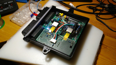

I'm going to attempt installing a version of the Python implementation on my car. Wish me luck. I've so far crammed all the logic boards I need inside this enclosure.
I still need to port all the stuff onto this. The Python code and OpenV2Gx should run easily, but I'll have to redo the hardware integration. Then I'll have to somehow cram the CCS connector, CCS contactors and high voltage connections into the car which doesn't really have room for them.
I expect this to be become obsolete in a couple of months as the esp32 C implementation is made, but I am likely to end up having the world's first open source CCS equipped vehicle, no matter how crude this is.
- uhi22
- Posts: 1117
Really great
What controller board is this? And where did you find this housing/connector/PCB assembly?
- celeron55
- Posts: 804
- Has thanked: 38 times
- Been thanked: 136 times
The base board is my https://github.com/celeron55/ipdm56 (I do have a pile of them for sale if someone wants one, but haven't had time to post about that yet)
This is a helpful but not a plug and play board for this purpose. I have done quite some customization by hand for this, mainly removing resistors to reroute the PP and CP lines onto the breadboard and to get the UART to connect to the Orange Pi instead of external USB. Also added a more powerful 5V regulator. With these customizations, the AVR is acting as a host processor for the Linux board, being able to power it up and down based on PP/CP/CAN status, but the Linux board can still flash the AVR on the fly.
It uses the same chinese enclosure as Damien's ZombieVerter.
The Linux board is Orange Pi Zero

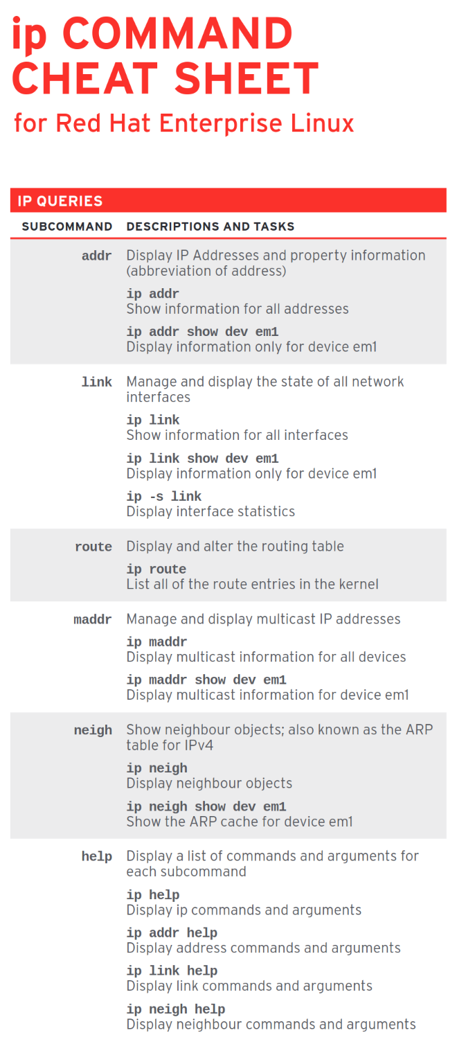

ifconfig is very deprecated and often fails to show IPs. If at all possible, use the "ip addr" command from iproute2.

This is very much not my wheelhouse, but from the light reading I did, prompted by Charlie's post above, I think I learned that one of the reasons that ipconfig (circa 1999) is out of favour is specifically because it does not deal reliably with IPv6. iproute2's 'ip' command replaces ifconfig. Handy cheat sheet (one of many available) is at https://access.redhat.com/sites/default/files/attachments/rh_ip_command_cheatsheet_1214_jcs_print.pdf
This is linux-specific (ie Windoze, Unix, etc. still largely seem to prefer ipconfig). I'm sure someone more knowledgeable will come by and correct my misapprehension any minute. Cunninham's Law and all . . .

Found out two issues in the implementation:celeron55 wrote: ↑Tue Mar 21, 2023 7:02 pm
Nothing wrong on the charger side, but pyPLC receives nothing.
fe80::9bc5fc41:d268 matches the link-local address that pyPLC prints at startup. However, I'm starting to think the address can change after startup by the time SDP is attempted. Maybe it should be checked again then? Thoughts?
The network interface didn't have any IPv6 address when I ran ifconfig after the session, so my suspicion is that if the address was re-checked when SDP was initiated, the interface wouldn't have had any address, or it might have had a different address.
1. When the modem is not connected or not powered, the ip addr does not report an IPv6 for the ethernet. But, the pyPlc uses the deprecated ifconfig, and wrongly uses the IPv6 address of the WLAN interface. This is for sure wrong.
2. Similar for the MAC. If we have multiple interfaces, the pyPlc may take the wrong one. It chose the WLAN MAC in my case, instead of the Ethernet MAC. This leads to the fact, that the low-level-communication (HomePlug, SDP) uses the wrong MAC as source address. Could be an explanation, when the SDP did not work. The charger will sent the SDP response to the WLAN MAC, but the ethernet driver of the car sorts this out, because it is neigther a broadcast MAC nor the physical MAC of the Ethernet. In the end the SDP response does not reach the pyPlc.
I pushed an update, with the following improvements: use "ip addr" instead of ifconfig. Filter out the other interfaces, only take real ethernet related addresses. And stop the script, if no IPv6 address is found.

I just had a look at the code here and I have a couple of suggestions on the IP address side of things since I have a fair bit of experience with Linux networking:
1) Consider passing the interface name when starting the application, or configure it. This piece of information is essential. Filtering in the first interface called "eth" might work for the Pi, but I think it's reasonable to make this configurable.
2) You can probably dramatically simplify the process for fetching the addresses. Consider the following commands, with easily parsed output:
Next, I'm really not sure why you need the local MAC and IP address, but perhaps you don't really need them at all? Consider the following flow instead:
1) Get a hardware identifier using uuid.getnode() - This may not be the MAC address of your interface, but if you're using it as an identifier in an upper layer protocol, it likely doesn't matter.
2) Initially don't worry about the local IP address. Instead just blinding send multicast requests to the desired interface and wait for replies. If and when the replies arrive, they will contain your IP address (that the OS automatically selected) anyway.
3) If you don't get a reply, just keep trying, once you have a local address and you're connected to something, you should get a reply.
As an example, here's the (ruby) code I use to discover an EVSE. Note that the only piece of information required is the interface name. When a reply arrives, the IP can easily be derived from the metadata attached to the reply.
Sorry if I'm way off the mark and you need this data for some other purpose, but thought I'd mention this in case it makes things simpler, more reliable, and more portable across operating systems.
charlie@charlie-ThinkPad-T14:~$ ip --brief -6 link show dev wlp0s20f3
wlp0s20f3 UP e0:d4:e8:ba:d7:4a <BROADCAST,MULTICAST,UP,LOWER_UP>
charlie@charlie-ThinkPad-T14:~$ ip --brief -6 address show dev wlp0s20f3
wlp0s20f3 UP 2001:470:1f09:123::99/64 fe80::de87:e22e:919c:ae8a/64
require 'socket'
datagram = [1, 0xFE, 0x9000, 2, 0x10, 0x00].pack('ccnNcc')
socket = UDPSocket.new(Socket::AF_INET6)
socket.send(datagram, 0, 'ff02::1%enp0s31f6', 15118)
message, server = socket.recvfrom(1500)
