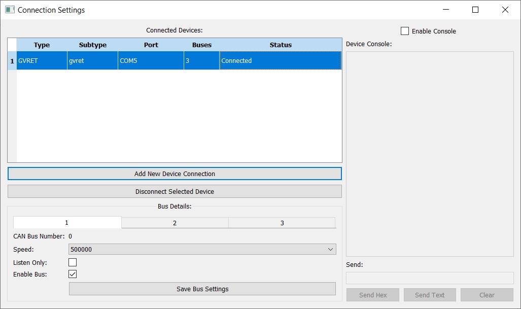

Pete9008 wrote: Sat May 07, 2022 4:22 pm Bad news, mine works fine. Erased it to blank and reprogrammed over the native port no problem.
Guessing it might be a Windows driver issue. Long shot but it might be worth trying it on a different PC USB port (it sometimes re-installs the USB driver)??
OH my lord after a little due_can-master (good library) swap for due_can (bad library) duplicate libraries it COMPILED on the PC !!!!
and just like that we are GVRETing...

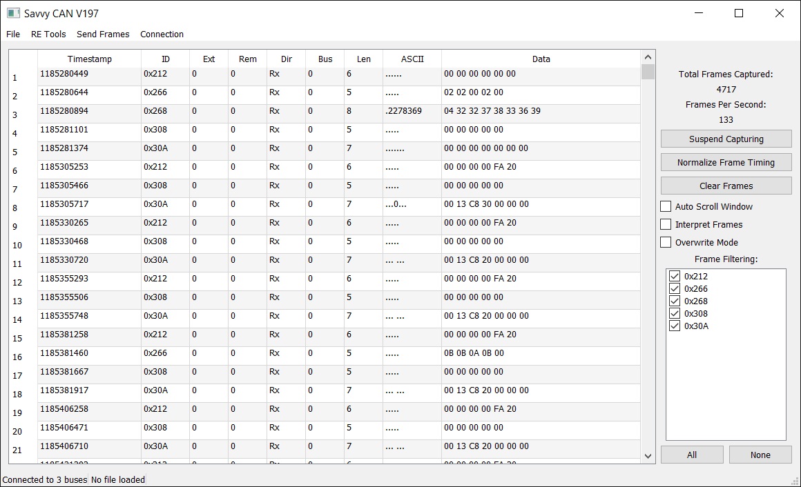

and now we can make a connection in SaavyCAN, so progress
and we can read the CAN messages from the Chevy Volt first gen onboard charger

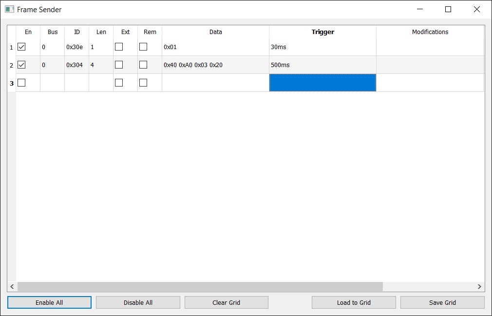

and we can send frames successfully using the Frame Sender in SaavyCAN
and we can confirm with a frame Capture that the first message is being sent every 30 milliseconds and the second one every 500 milliseconds

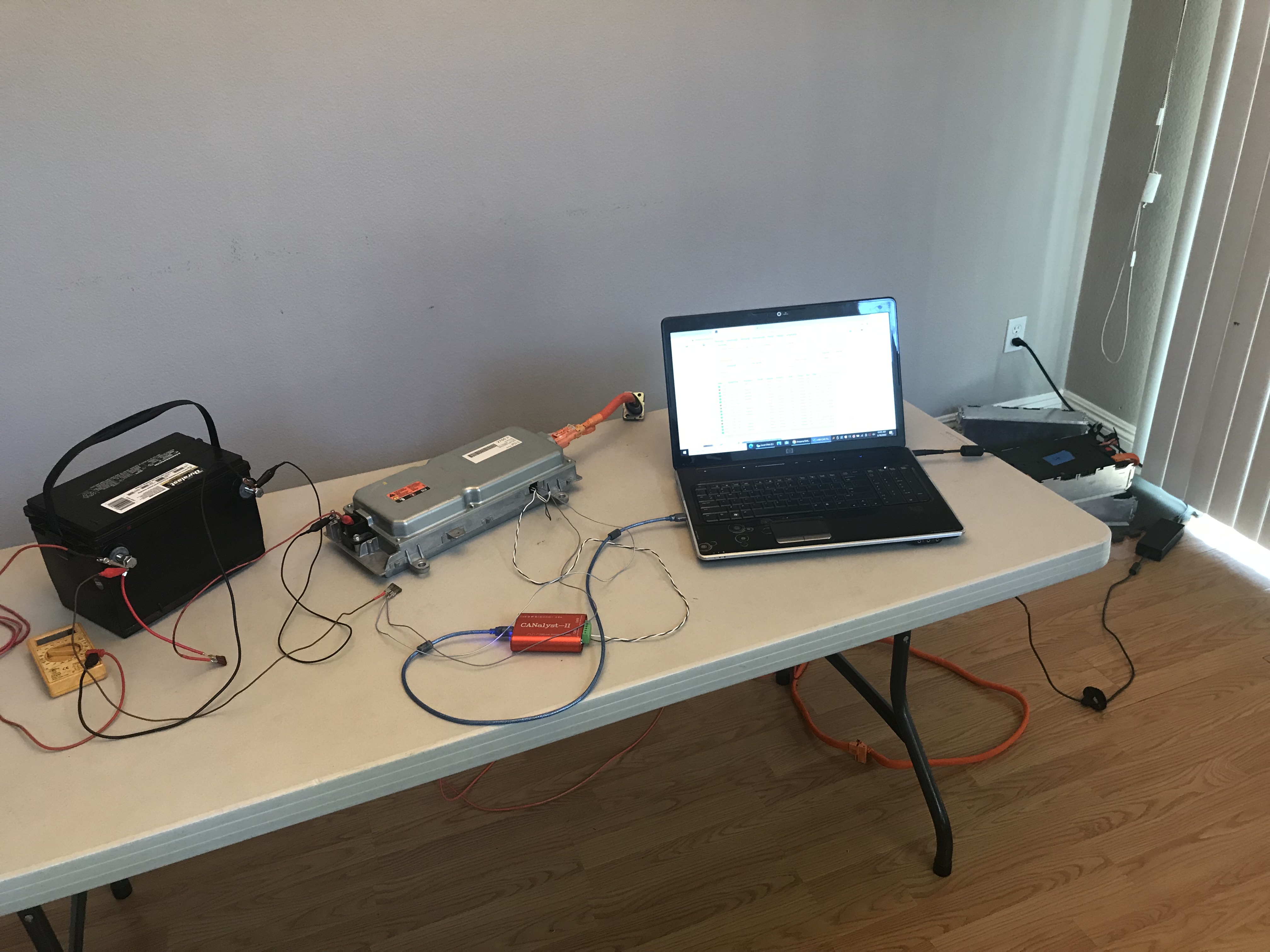

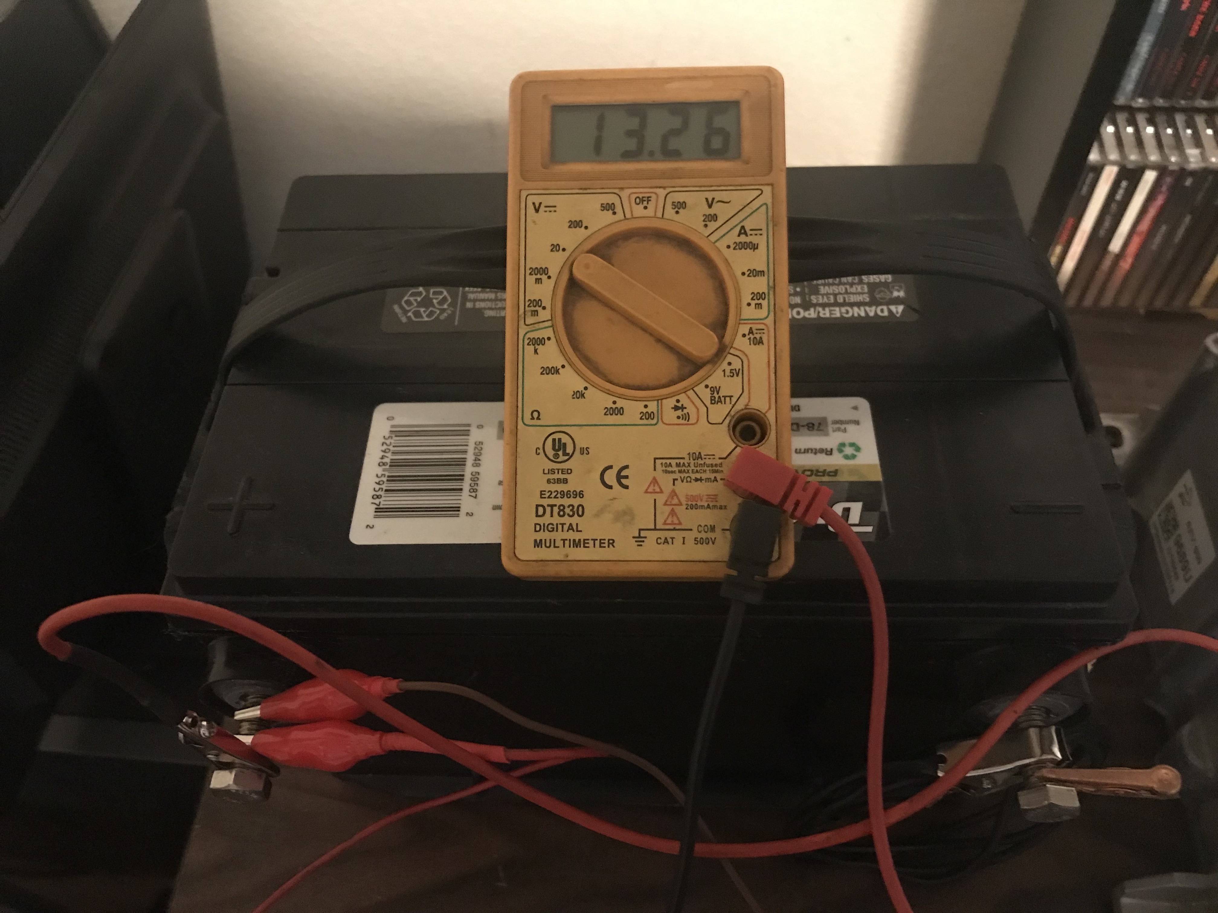

and here I confirm with a multimeter that indeed my trusty ol' lead acid battery is charging at 13.3 volts cause it drops to 12.5 when not charging
man I really like this Chevy Volt first gen charger, you can test with just the 12 volt battery and not get dead

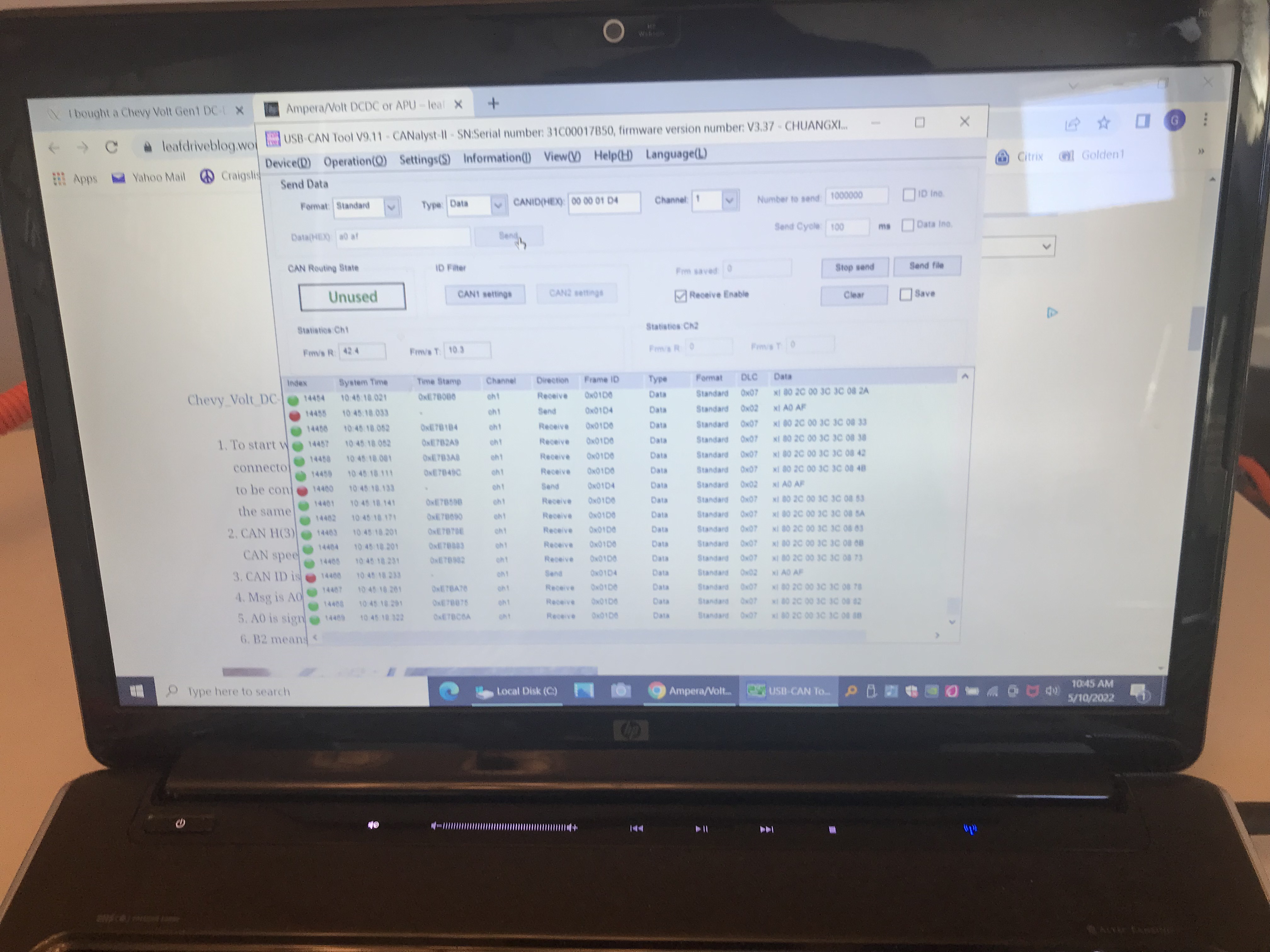

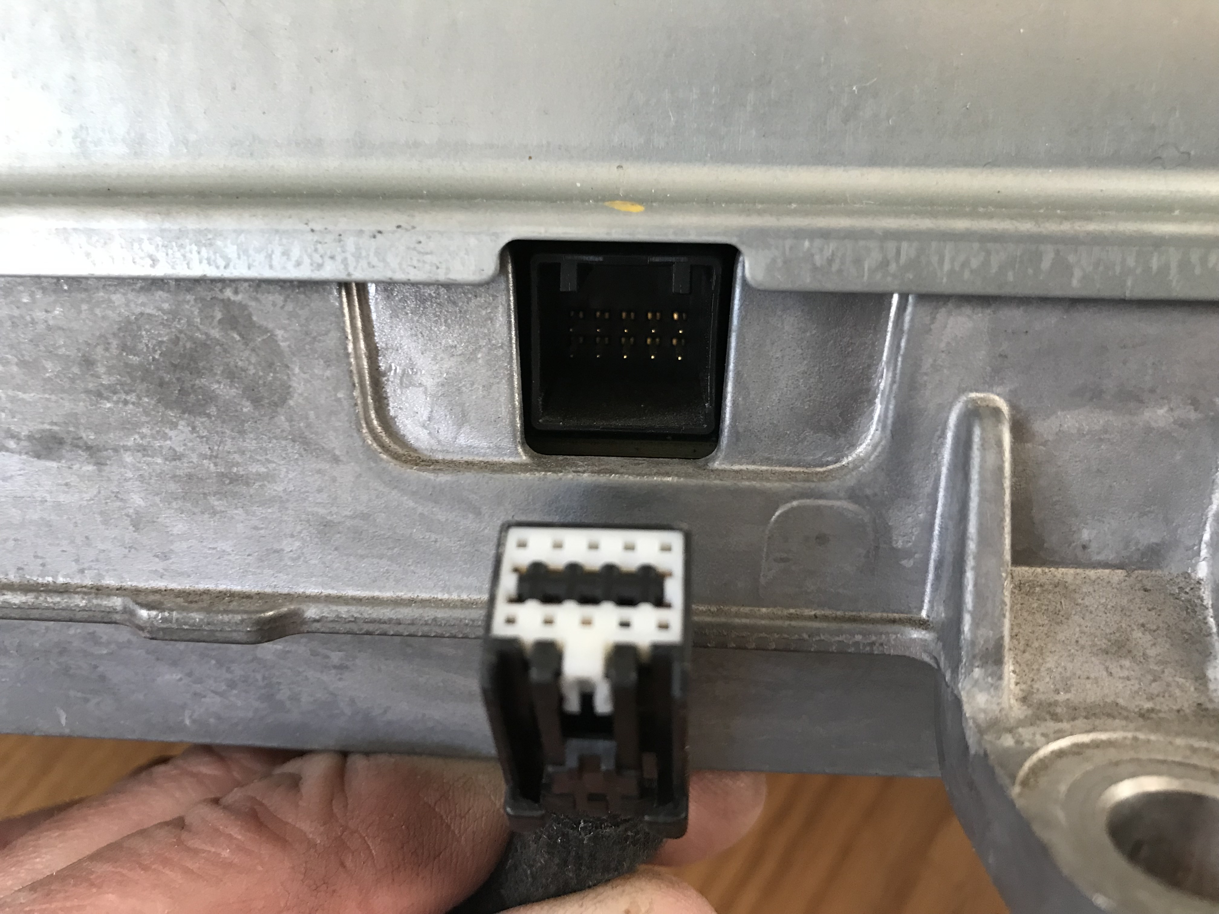

Just so you don't think I'm Mr. One n Done here I am having a go at the first gen Chevy Volt DC-DC Converter once again with the CANalyst-II
if you enjoy a fun read: I bought a Chevy Volt Gen1 DC-DC Converter - Now What?
the DC-DC Converter only requires one command to dance, so I thought this one ought to do it and that's how Mr. Kramar beat it into submission on LEAFDRIVEBLOG Ampera/Volt DCDC or APU , but no dice for The Greg
CAN ID is 01 D4
Length is 2
Msg is A0 B2 send every 100ms (B2= 14 volt output)
OR
Msg is A0 AF send every 100ms (AF= 13.8 volt output)
A0 means Start
send 00 to Stop
Pinout Info
Pin 2 (second top left) CAN Low
Pin 3 (third top left) CAN High
Pin 5 (last one top right) Ignition (so to battery positive)
Pin 10 (last one bottom right) Accessory (so to battery positive)
Posts: 3796
Been thanked: 413 times
Re: I think I CAN, I think I CAN...
In all fairness you need to play with canalyst some to get communication going. Also termination resistor configuration is important.
I got best results when i opened a bridge between can1 and can2...
collin80
Posts: 118
Been thanked: 15 times
Post by collin80 »
Sorry the EVTV board came un-programmed. They shouldn't have sent it like that. Over at savvycan.com there is a binary "updater" which actually just flashes precompiled firmware to the board -> https://www.savvycan.com/GVRETupdate.zip you can use that on basically any Arduino Due based board but as has already been mentioned, the compiled version does expect EEPROM which the Due did not have unless you got the EVTVDue that they sell which does have EEPROM on it.
And, I am aware that perhaps getting all the tools working and getting SavvyCAN connected might not all be the simplest thing ever. Compiling it all yourself is probably quite the adventure. It's tough for me to get a good baseline of where all the pinch points are because I can compile it all in my sleep at this point. ;) But, even I get frustrated sometimes when trying to get various devices hooked up and working. I obviously have a lot of EVTV boards but I also use PeakCAN and Kvaser tools, I have the Microchip black box thing too. I have lots of CAN adapters, the PeakCAN and Kvaser are the easiest to use but the most expensive too. Really, for me the coolest one is either an EVTV ESP32 or the related Macchina A0 - both of which can connect to SavvyCAN over wifi. The A0 is especially cool in a car where you can slap it onto an OBDII port and away you go.
And, SavvyCAN is probably quite the mountain to climb because it started out as a tool for me (and a way to learn QT programming) and just kind of evolved over the course of years into having everything including the kitchen sink. There's probably like 4 ways to send CAN traffic for instance. You can use the fuzzing window, the frame sending window, you can write scripts in the script window, you can replay captured traffic. Some of them overlap but everything exists because me or someone else wanted to do something it didn't do yet. I wish I had more time to work on all the CAN tools but recently I just haven't been able to. Still, there is some progress. Be sure to check the "continuous" build if you want all the newest toys. It's automatically compiled for all three operating systems supported. Technically people compile SavvyCAN for Raspberry Pi too. But, I don't have compiled binaries for that.
Posts: 3796
Gregski wrote: Tue May 10, 2022 8:45 pm
Pinout Info
Pin 10 (last one bottome right) Accessory (so to battery positive)
Sorry i missed this...
Pin 5 is ignition and also signal for dcdc to wake up
Pin 10 is actually an output. That one becomes live when you provide ignition. I think it is used to turn the cooling fan on.
Gregski
Posts: 3171
Has thanked: 635 times
Been thanked: 1611 times
Post by Gregski »
arber333 wrote: Wed May 11, 2022 4:36 am
Pinout Info
so are you saying we don't need to worry about ie connect Pin 10 to get the converter to convert?
Posts: 3796
Gregski wrote: Wed May 11, 2022 7:43 am
Pinout Info
No that one will work by itself. You only need CANH, CANL and Enable signal. You can use aux contact to run some indication LED so you are aware it is working...
Also i belive CAN is not terminated here. You have CAN input and CAN output lines. So if DCDC does not work reliably you might put 120R across second pair of CAN wires.

Gregski wrote: Wed May 11, 2022 3:00 pm Would it be safe to assume termination is fine if we can capture ie read CAN traffic just fine, or would these CAN analyzer tools still read unterminated CAN bus traffic?
Yes in general you should be fine if Canalyst is blinking its leds. That means it is receiving CAN traffic. Can you post a screenshot of your send/receive screen? I dont have that DCDC with me anymore, but i can still help...
EDIT: that got me thinking... when you post ID into Canalyst you have to make it in 4 byte length for "standard" length (not extended).
So for ID 0x1D4 you would put it like 00 00 01 D4. Try it...
