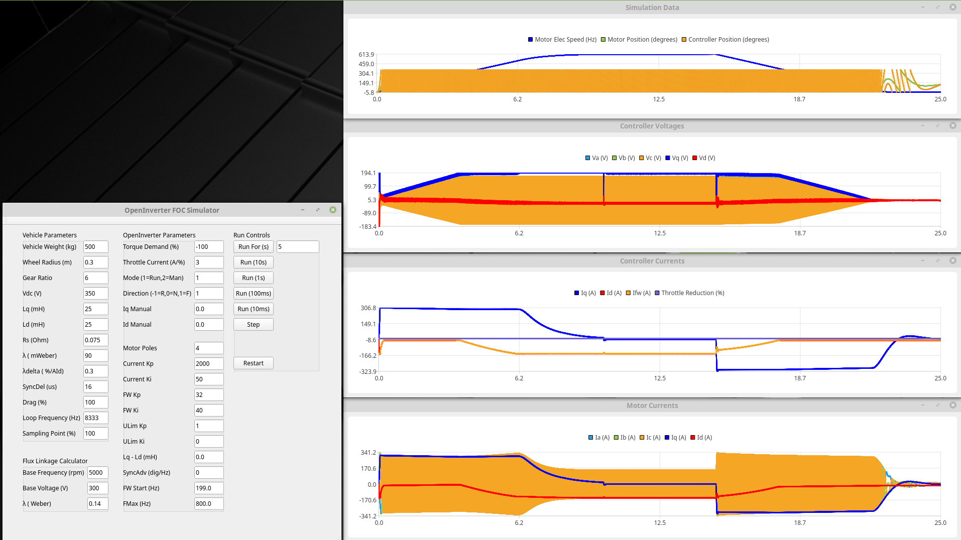

Next set of plots using the revised code to see if that still behaves. First a simple run using all the same PI parameters as before:
Looks OK so one with SyncDel dropped from 167us to 16us and ScynAdv dropped to 0:
Looks unchanged which is correct. Finally a 100% run to above base speed followed by a coast and then 100% deceleration:
Again looks good.
Based on that I'm going to conclude that fixing the error hasn't significantly affected any of the results/conclusions made so far. That is also a relief :-)
And one more new plot - what happens if we move the sampling point for the currents and angle to the midpoint of the period to more accurately reflect the way sampling is actually done on the real hardware?
This one is interesting. Effectively all that has changed is the sampling point, nothing else. This means that the motor currents are actually changing by about twice as much as the OpenInverter code sees. Acceleration is fairly similar but it continues to accelerate to a higher speed. The field weakening current also seems to be brought in much more gradually. Overall I would have to say it improves things although not sure why!

And here is the downside wit hthe 50% sampling position, if the model is run for 20seconds this happens:
And if you try to coast after accelerating for 10sec:
We're back to the unwanted deceleration due, I think, to the control loops running out of headroom due to the under-reported currents. :(
Options I can think of to fix are are either leave more headroom on the ud and uq calculations to allow for it, but this will reduce max power too, or move the sampling points to later in the period. Any other ideas?

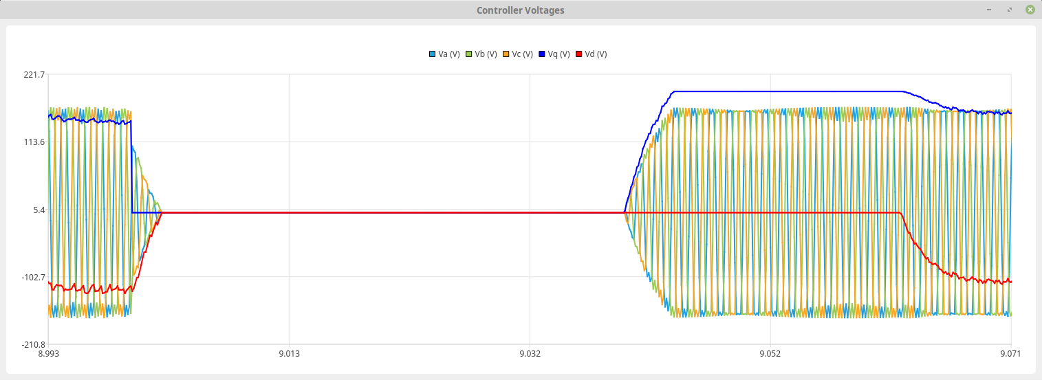

And one last plot showing what is happening at the point where control is lost:
You can see in the controller voltages where it it cuts the Iq in response to the throttle cut. It also seems to reduce the -Id which doesn't quite make sense. These seem to recover pretty quickly but it's already too late and they have caused a slight drop in -Id and the loops never recover. Motor currents peak at around 2000A but the controller only sees around half this.
@johu - I would strongly suggest that you don't do ANY testing above base speed for the time being!

Final thoughts for the evening-
The root cause now seems to be the relatively long time between the measurement and the point where the new duty-cyles take effect. There would appear to be two approaches to take here:
1) Try and fix the root cause - reduce the time between sample and action. Is there time between the existing angle/current measurement point and the next timer reload to execute the ISR, This could potentially reduce the delay to 30% or what it is at the moment.
2) Try to mask the effect. For example could we slug the -Id control so that it can't back it off so quickly and ride out the delay till the new duty cycles takes effect? Or have some feed forward from the Iq controller to the Id controller?
Note - the above are with MTPA disabled. Enabling it will add throttle dependant -Id which is highly likely to make the problem worse
Posted: Wed Aug 31, 2022 9:19 pm
by Pete9008
And one final plot showing the controller's requested Ifw and Id in more detail:
You can see the Id controller backs off because Id initially increases- and how it never quite recovers. It's not helped by the reducing Ifw that occurs at the same time. Maybe slugging the controllers would work but it is likely to cause other control loop stability problems as well.
Edit - just noticed the phase reversal on the controller voltages caused by Vd briefly going positive. Just checked and the Id controller is allowed to request positive Vd. Question - should it be allowed to?
Edit2 - A zero limit on Vd actually seems to make things worse:
