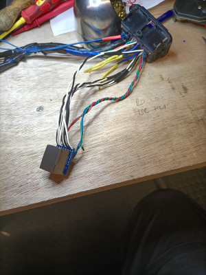

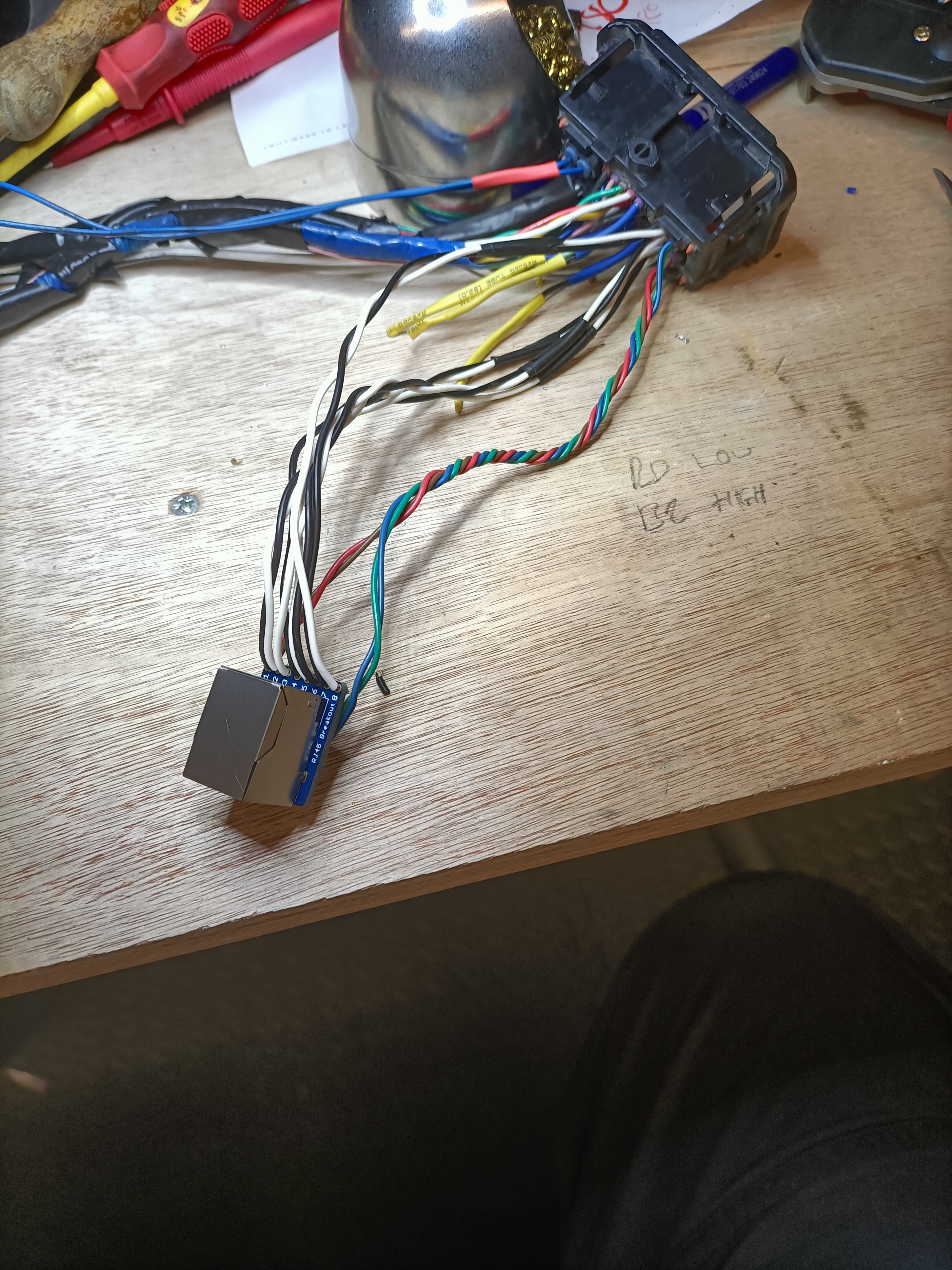

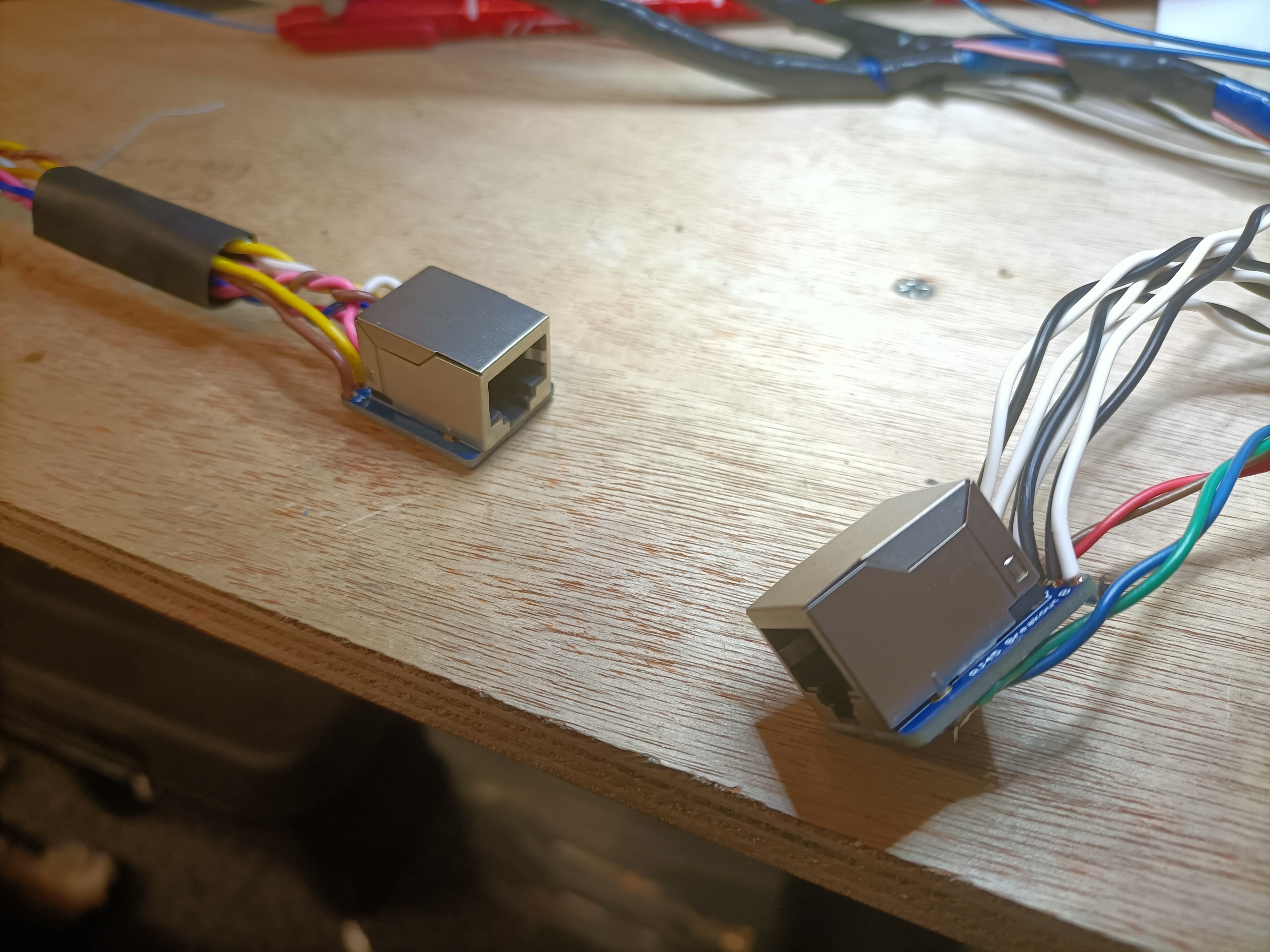

This is how I'm connecting the lexus serial cables between the Zombie and the inverter as I don't have any individually screened twisted pair cable
an rj45 socket at each end and cat7 patch cable in the middle as cat 7 is individually screened
midway
Posts: 92
Location: Ural
Has thanked: 14 times
Been thanked: 14 times
Re: [WIP] BMW Z3
Post by midway »
xtremely unreliable connectors; I do not recommend using them for important connections. It is better to use sealed automotive connectors.
andybpowell
Posts: 333
Location: Southend,essex,uk
Has thanked: 217 times
Been thanked: 257 times
Re: [WIP] BMW Z3
Post by andybpowell »
midway wrote: Wed Dec 06, 2023 8:30 am xtremely unreliable connectors; I do not recommend using them for important connections. It is better to use sealed automotive connectors.
you are correct not ideal for an automotive enviroment but I should have explained that this is temporary until my cable arrives but that's not until the end of december and I want to get on so I used what I had available :)

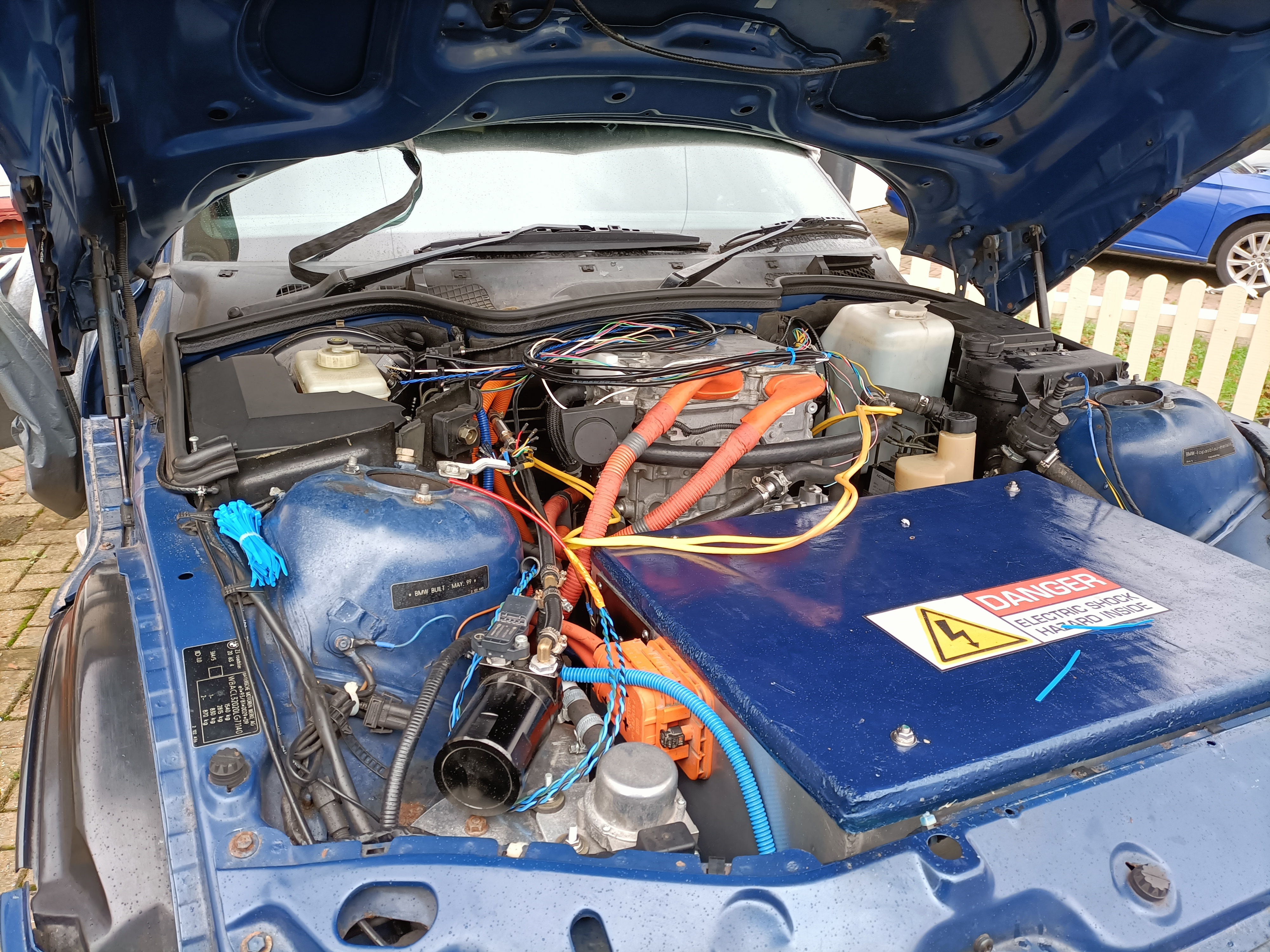

The project is still progressing but very slowly due to the poor weather,everything is all in and all of the plumbing is done, I have got to finish running the BMS cables to the rear battery pack then start connecting the resolvers, inverter, Zombieverter, front battery pack and contactors together, re-connect the power steering, brake booster, gear lever and rewire and connect the accelerator pedal that’s a lot of wiring and I’m not doing it in the pissing rain

Hi, Nice installation and progress..
am still trying to get a handle on the limitations which maybe holding the Bmwagon back, and not having a Gs300h inverter to try, very keen to see your system running.
hopefully the gs300h inverter will be better matched to the L210 trans, than the Prius gen3 inverter, and the FW more effective.
Do you know your Differential ratio? And what is your battery nominal voltage?

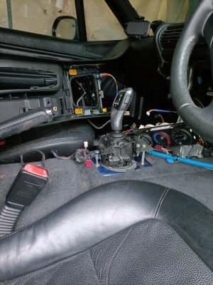

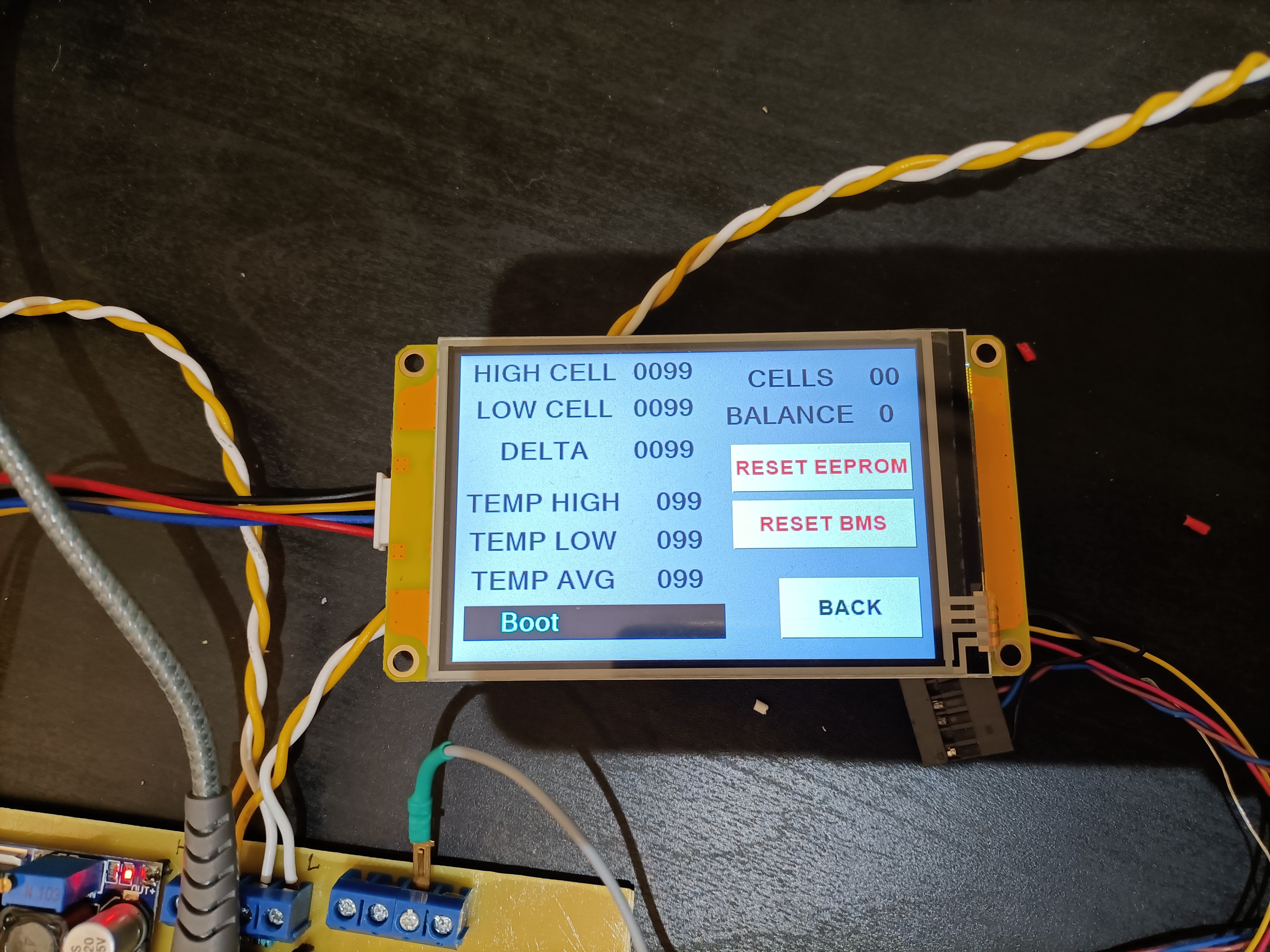

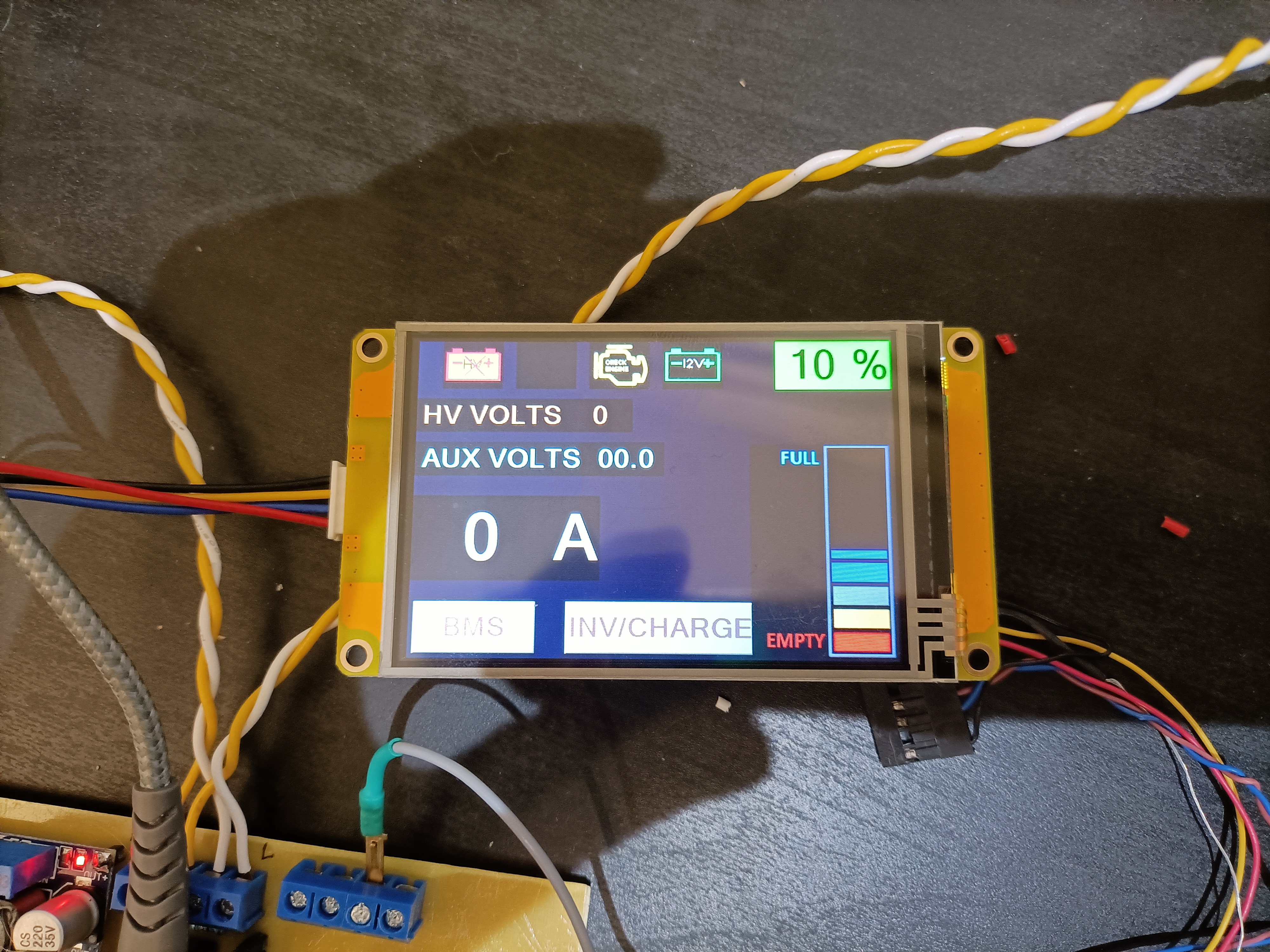

It's been really slow going with the project lately but I'm still chipping away

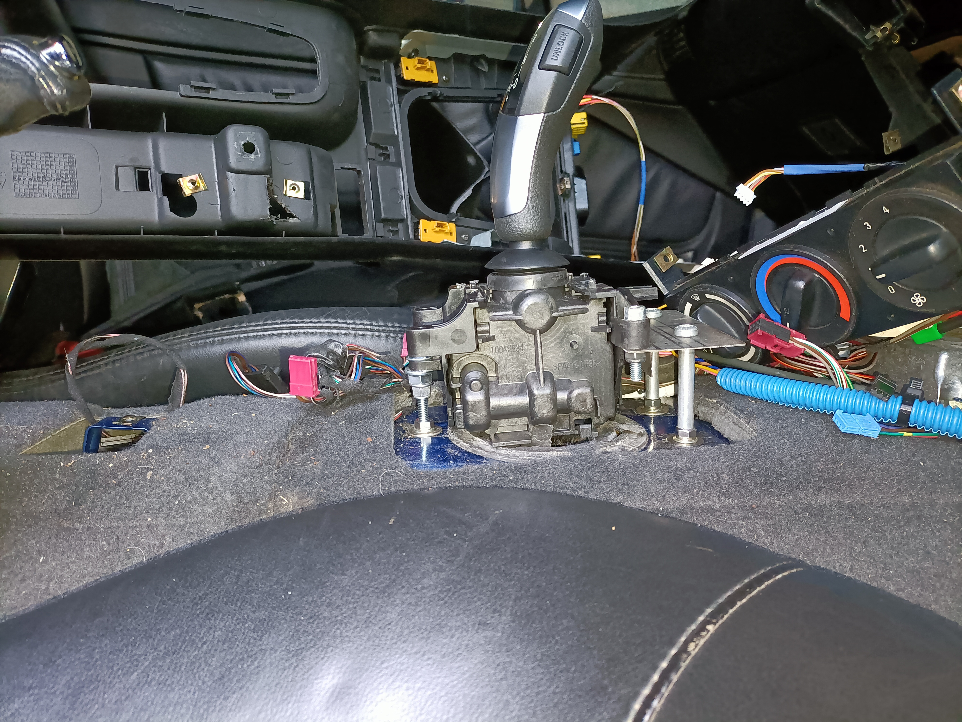

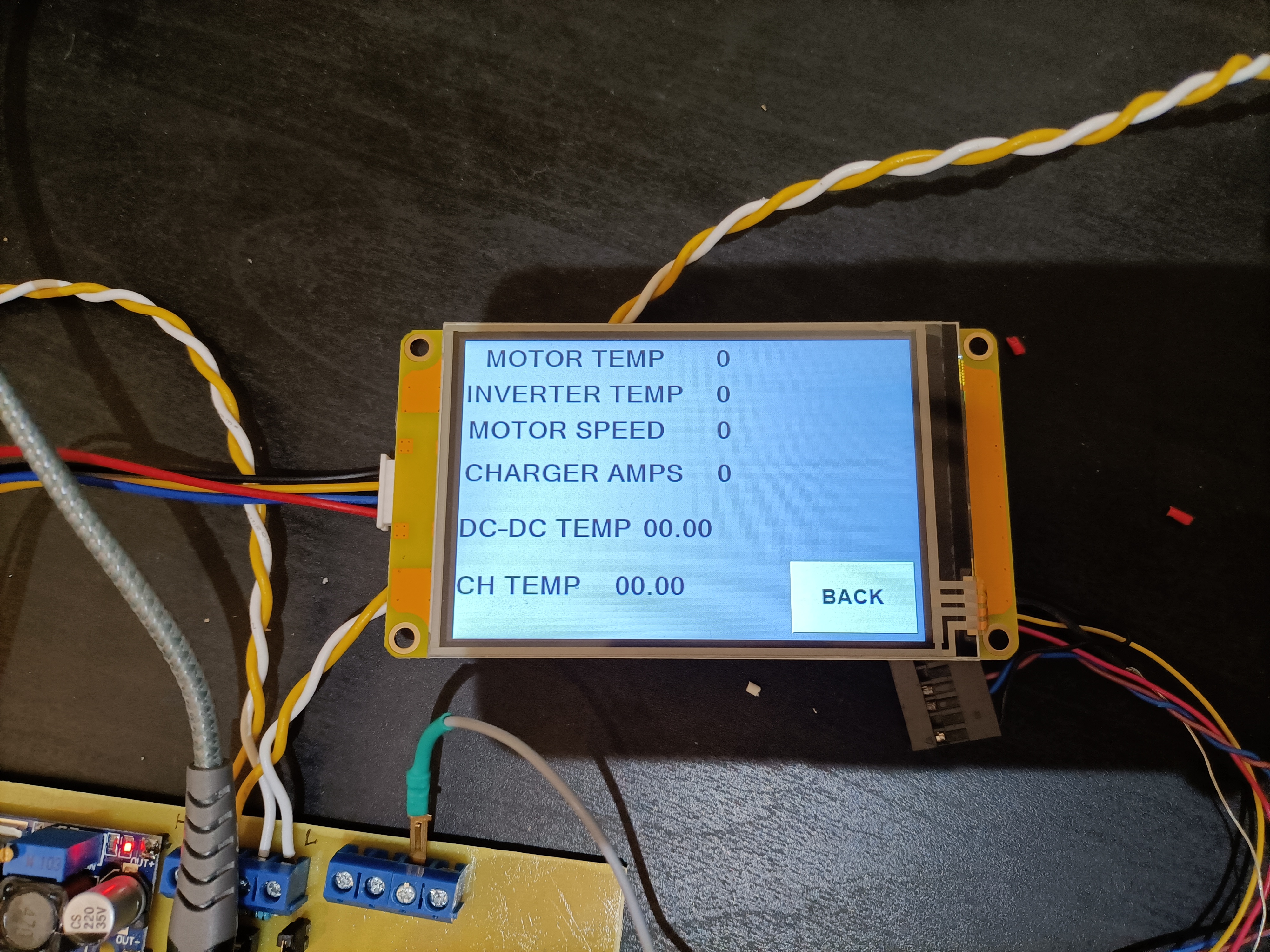

I built my own controller to control the outlander charger, dc to dc, BMW f30 gear lever, brake booster, power steering and the cars canbus systems, power the Zombie as it has no standby mode and control my Nextion display but between Jamie and Damien I can now hand over half of that to the Zombie to deal with :lol: ok maybe not half of it but the vehicle canbus, Gear lever and brake booster at least and maybe the charger
I've also been updating my Nextion display to suit the lexus setup

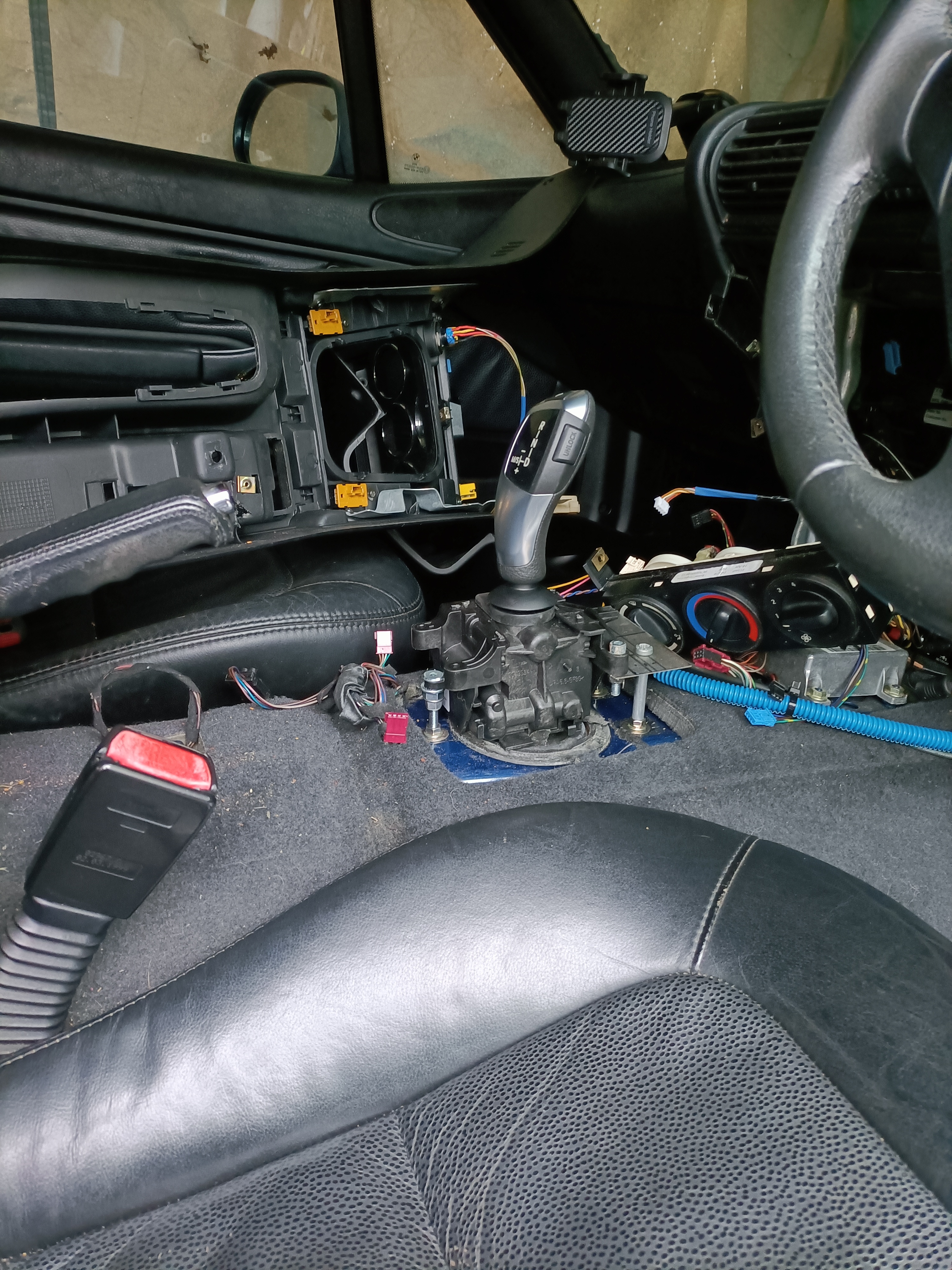

And I've fitted the f30 gear lever into the Z3
The mounting holes which I presume were for the automatic shifter were almost ideal just fitted them with some m6 rivnuts, made up a bracket and some spacers only took 30 minutes, shame it took me 2hrs to get the centre console out before I could do that
