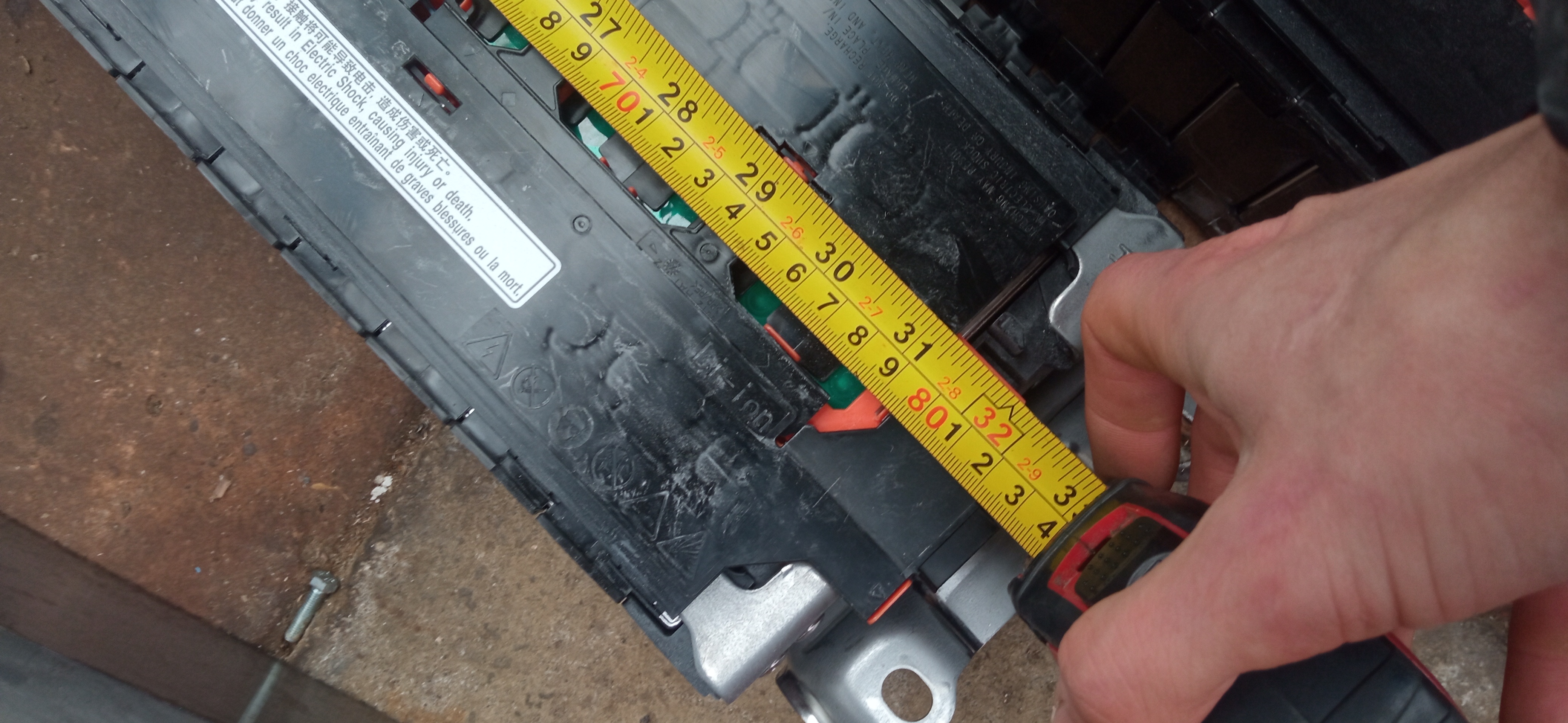

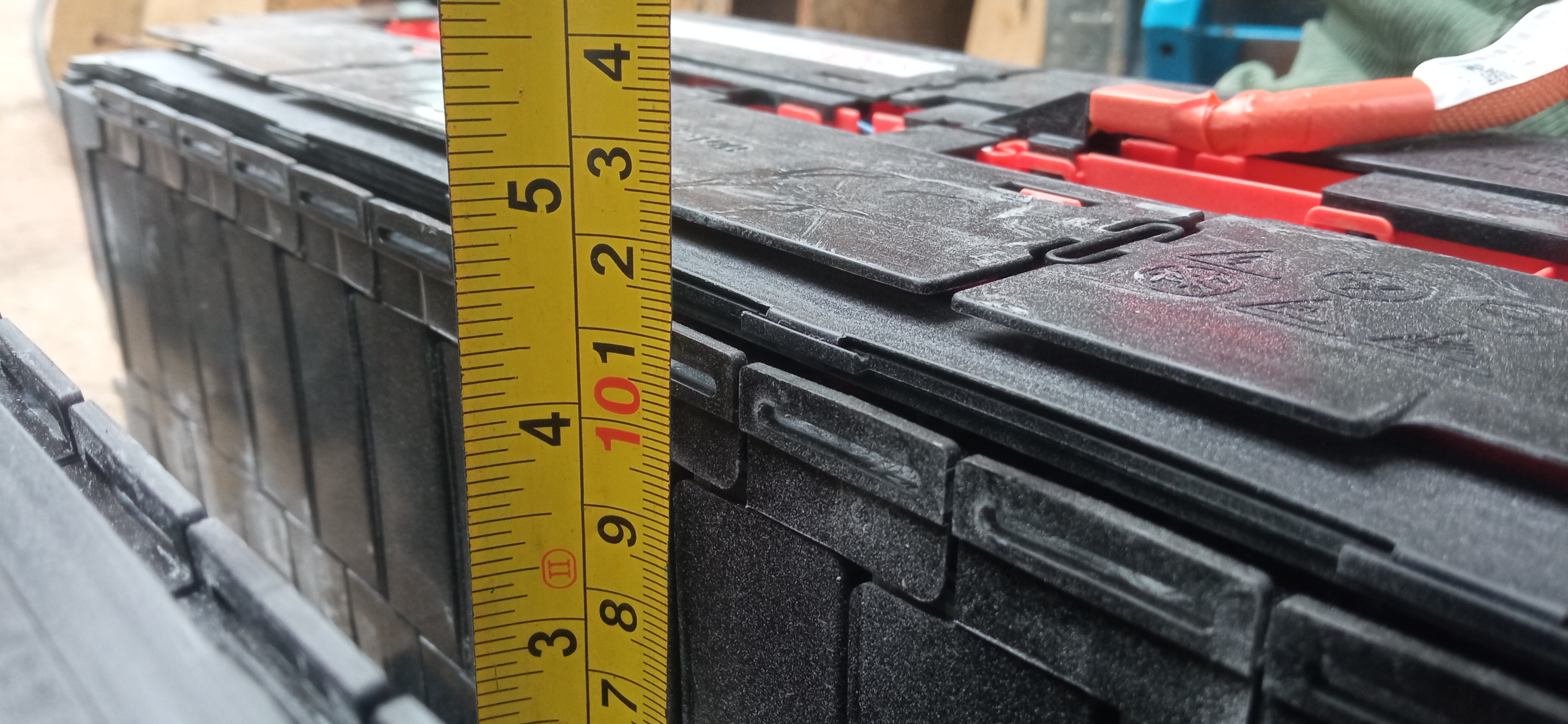

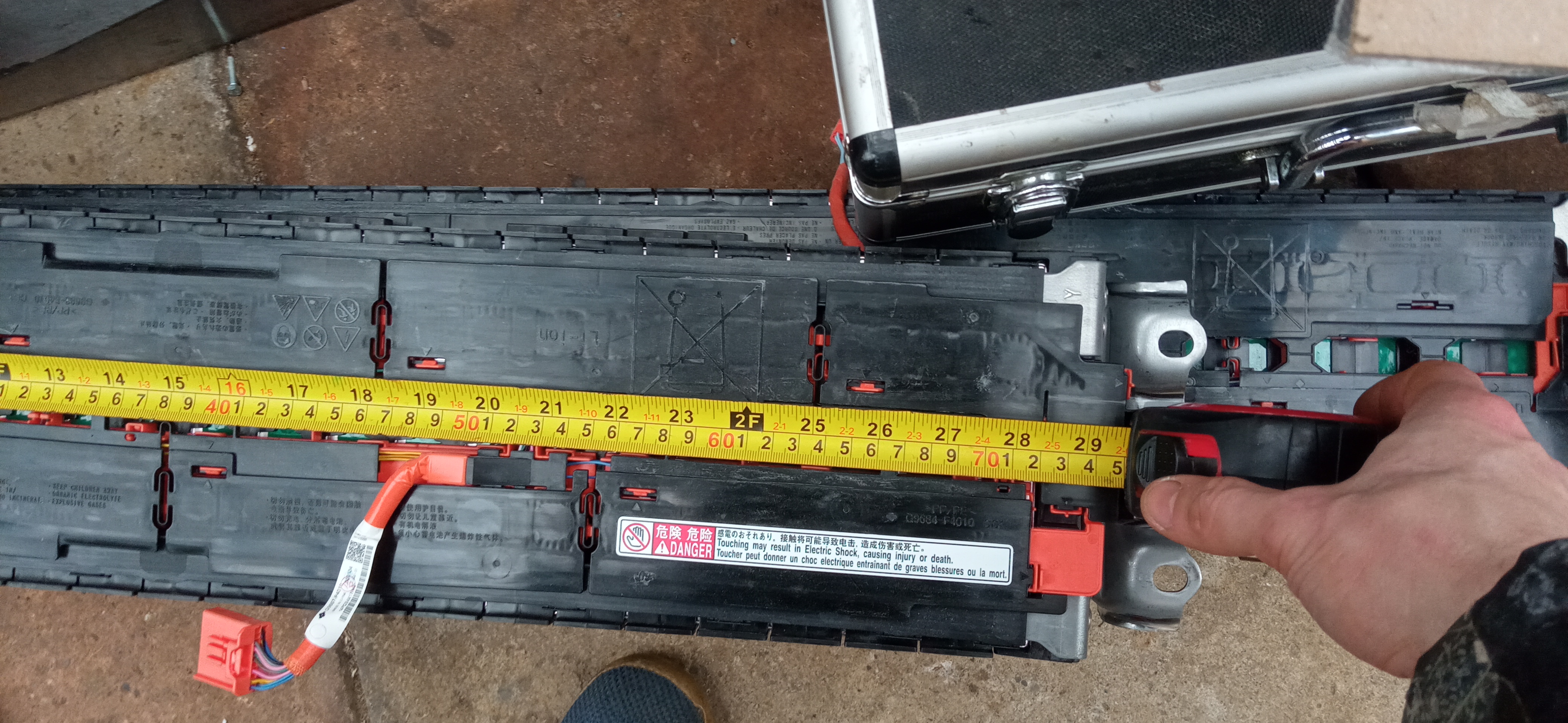

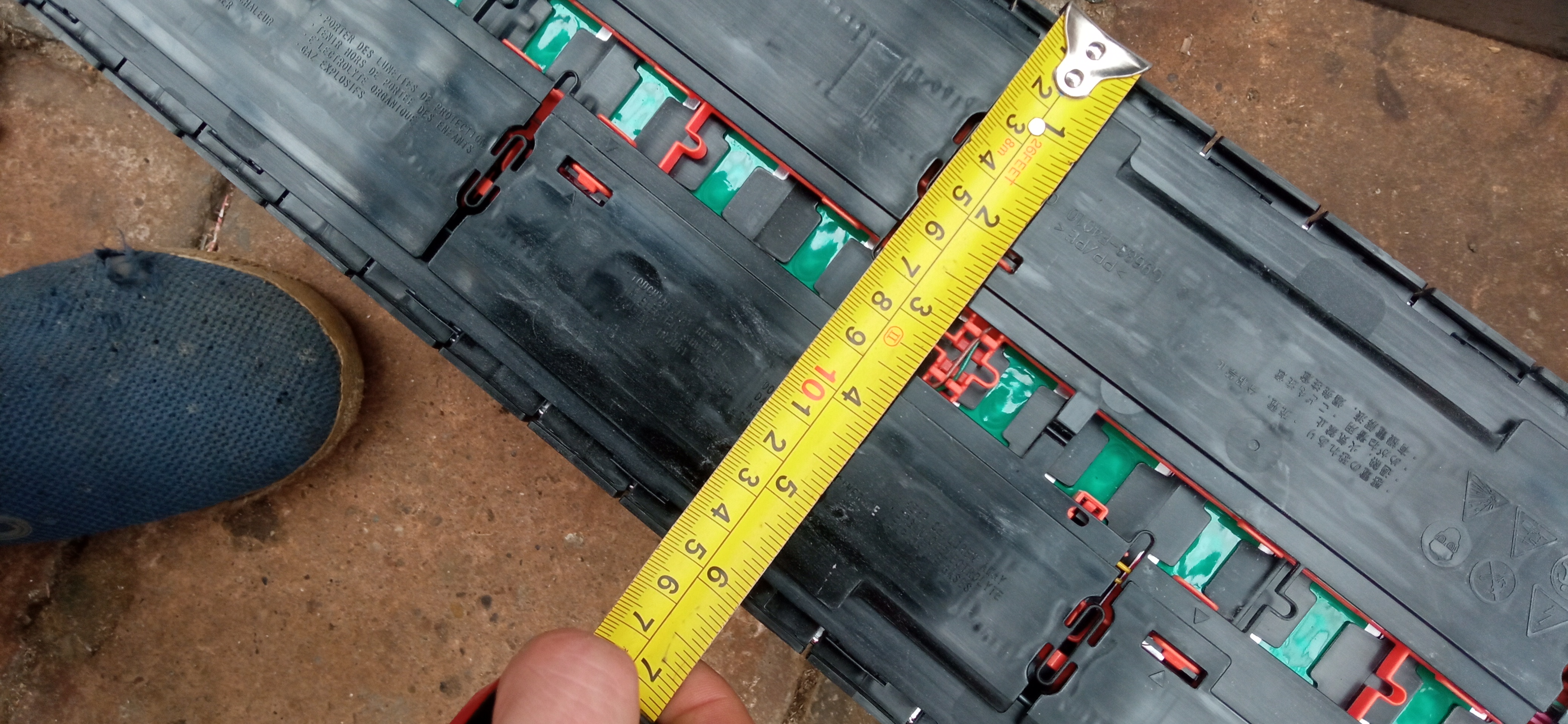

And some pics of the module dimensions...

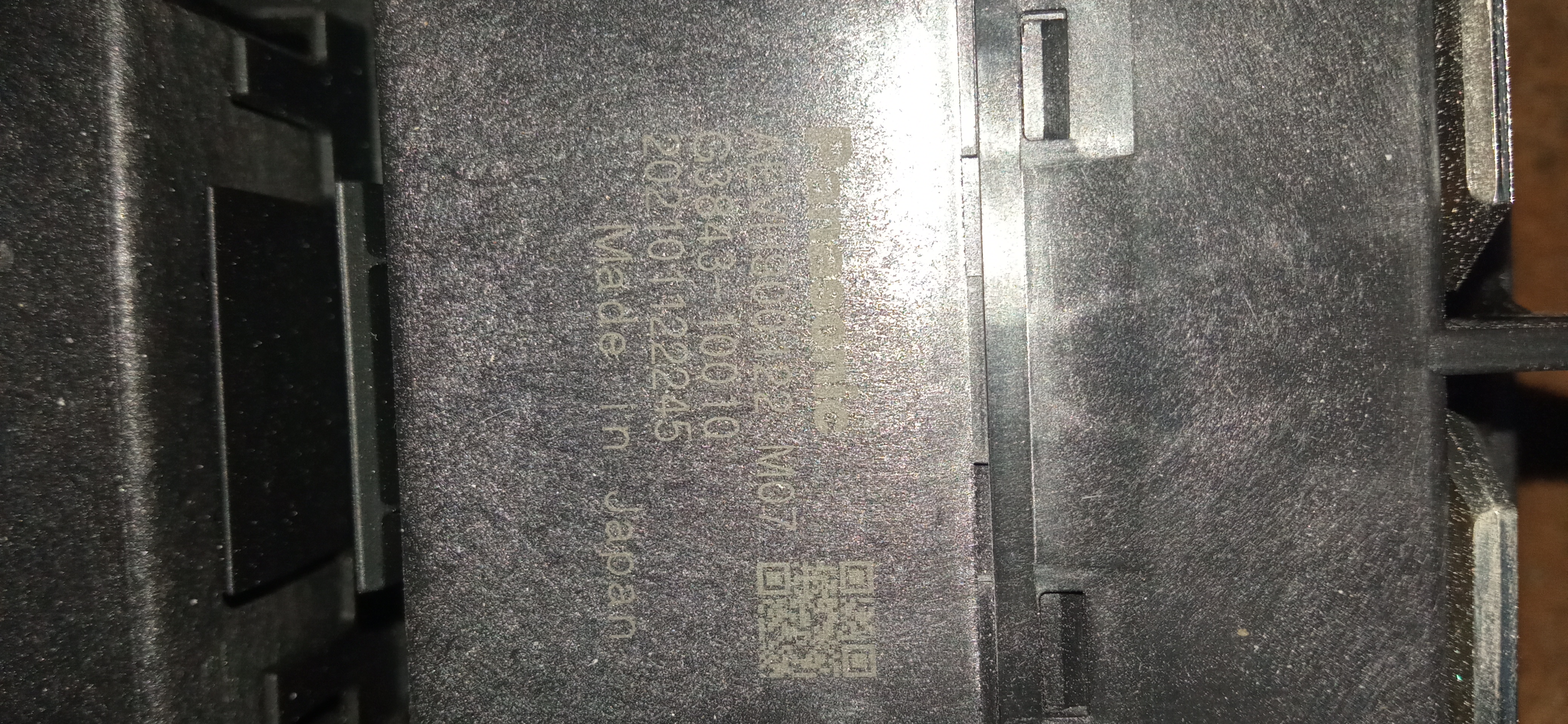

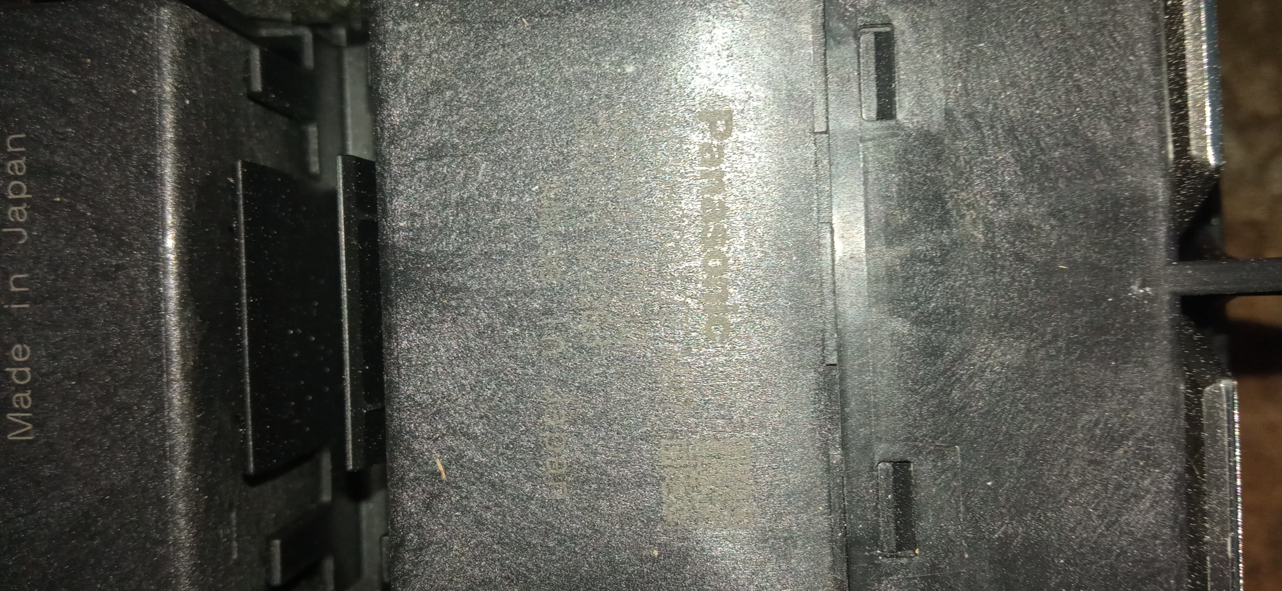

Re: [WIP] Mercedes 310E (310D campervan) - GS450H/GS300H
A few more details to confirm.
Big modules are 9S3P (27 cells) and weigh 27.5kg 8 per pack
Small modules are 8S3P (24 cells) and weigh 24.7kg 3 per pack
Cells are Panasonic prismatic and are 51ah each according to spec.
So large module is around 5kWh and small module 4.5kWh.

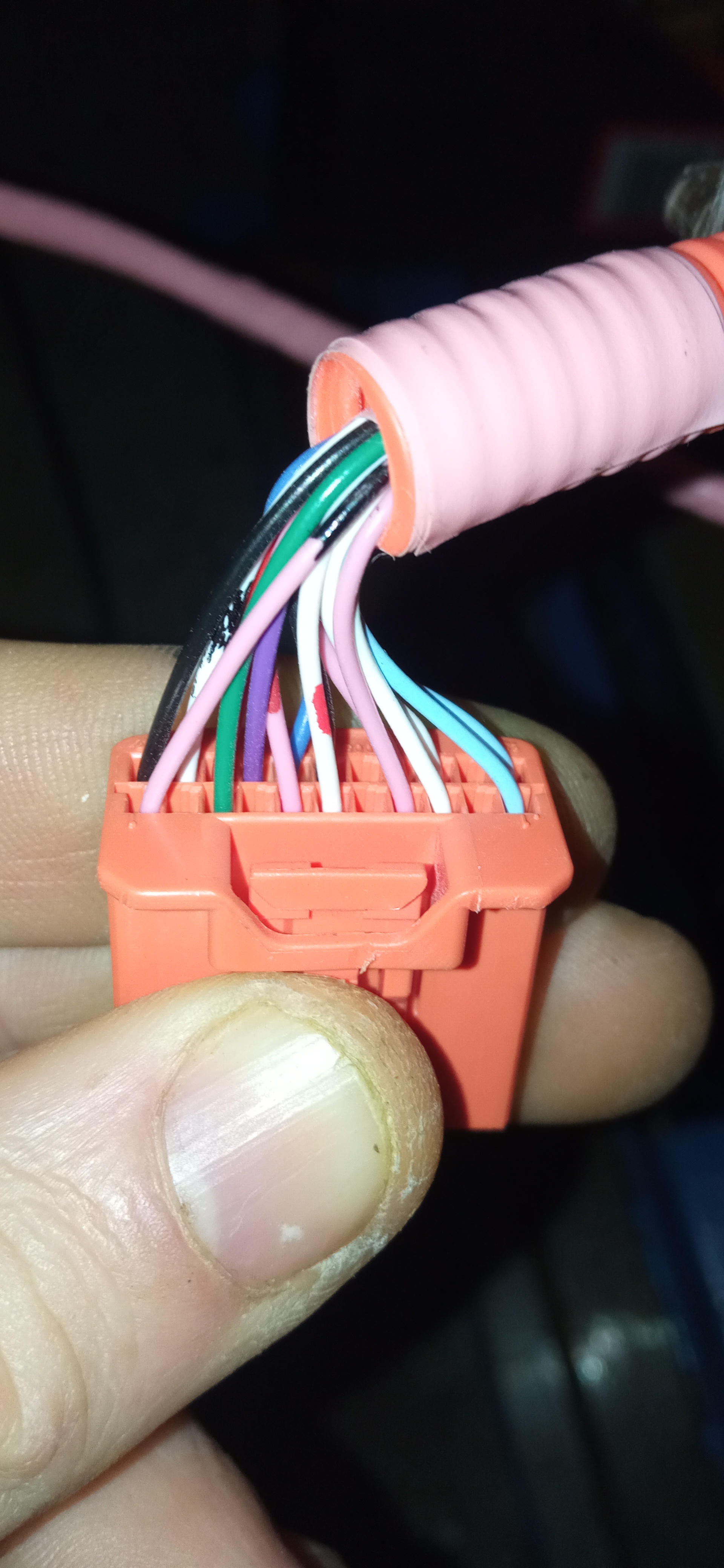

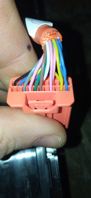

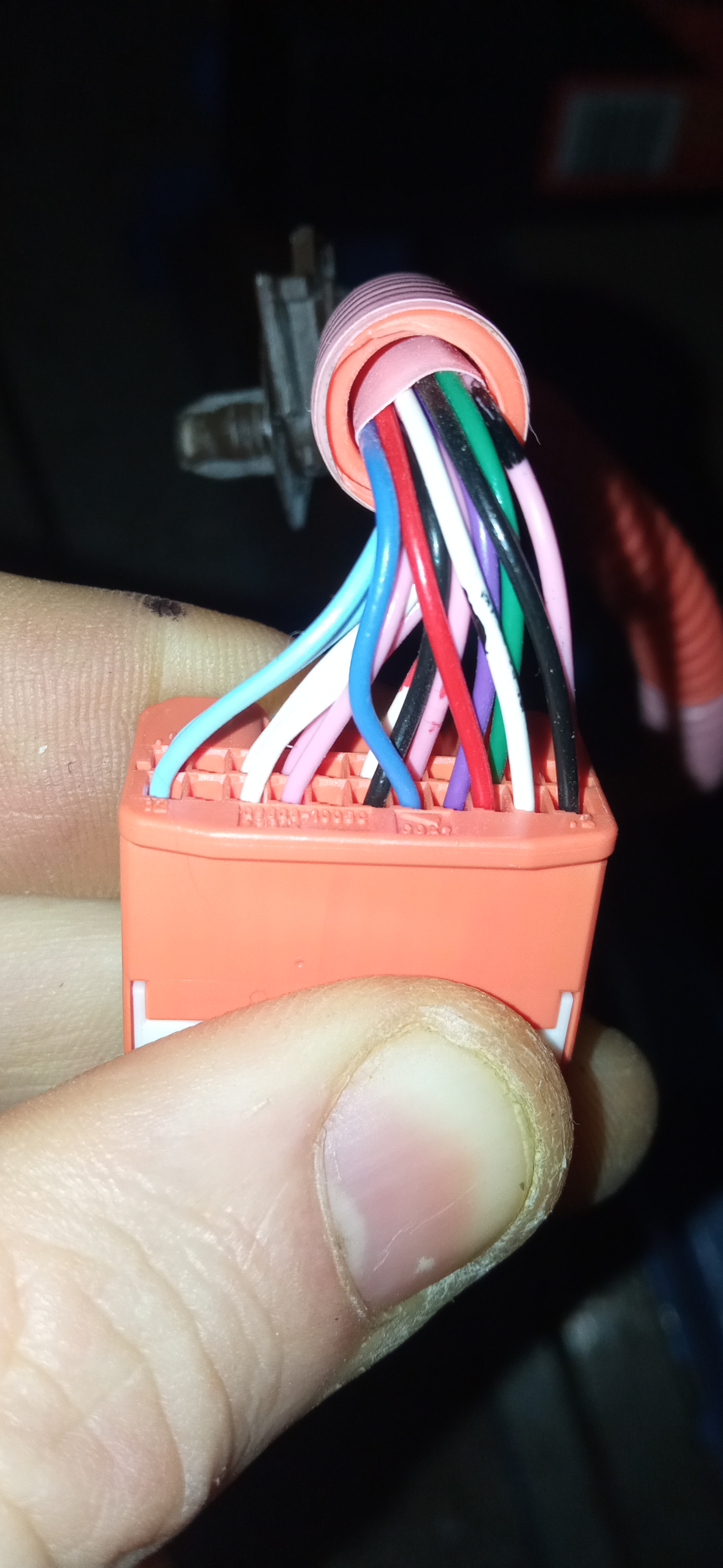

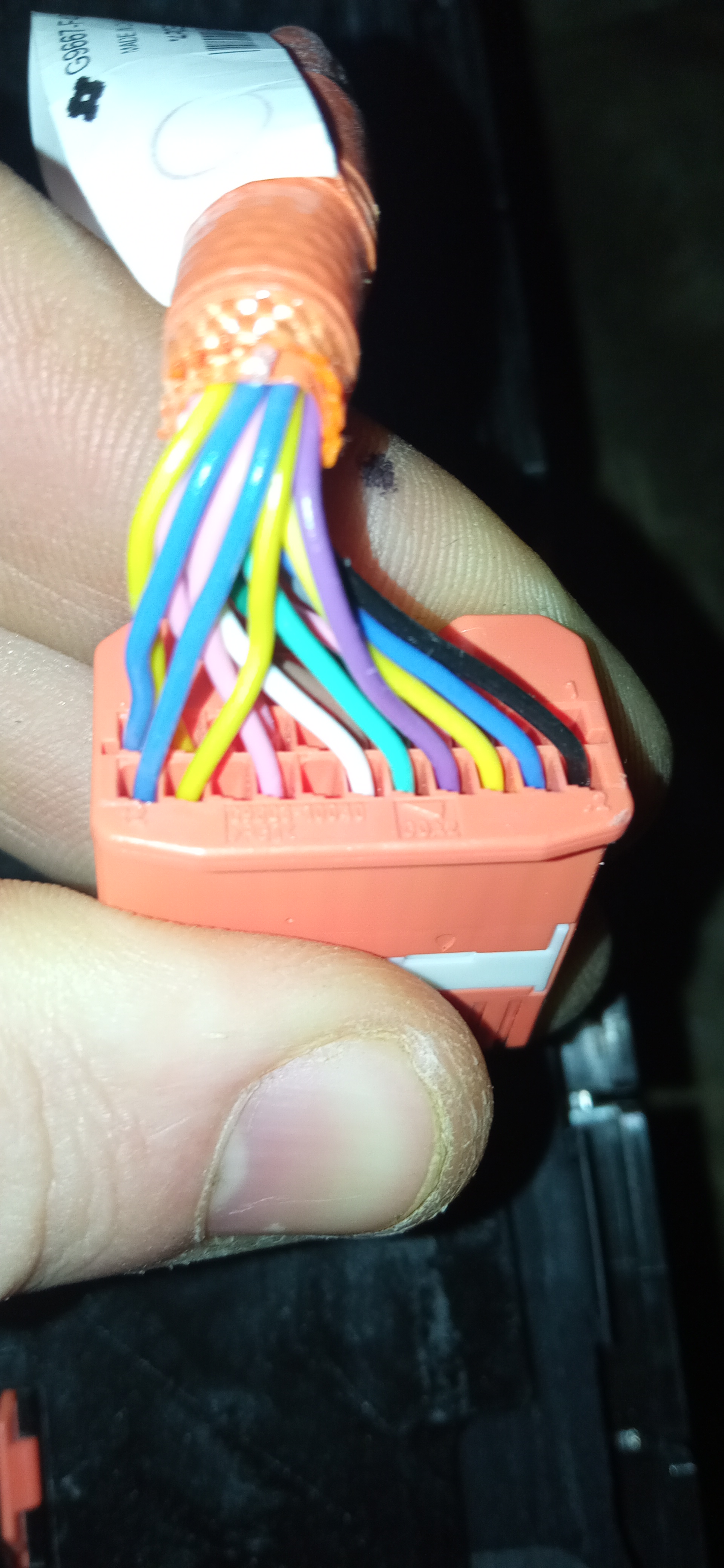

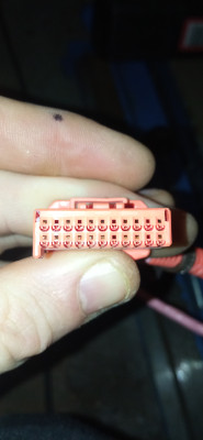

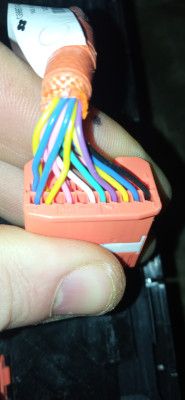

Battery module connectors
Large modules seem to have different wiring colours but same pins used in connectors.
Small modules are the same wiring colours and same pinouts by the looks of things (yet to confirm on all modules)

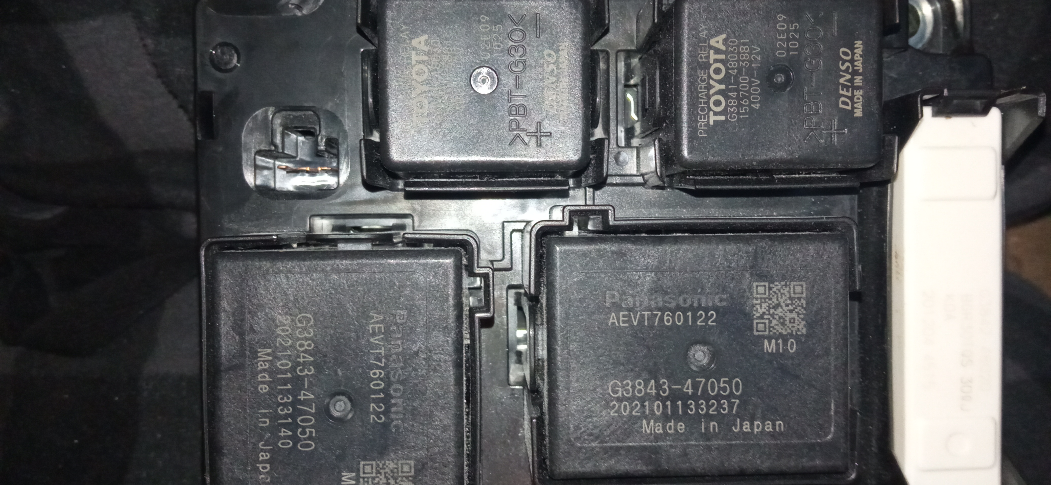

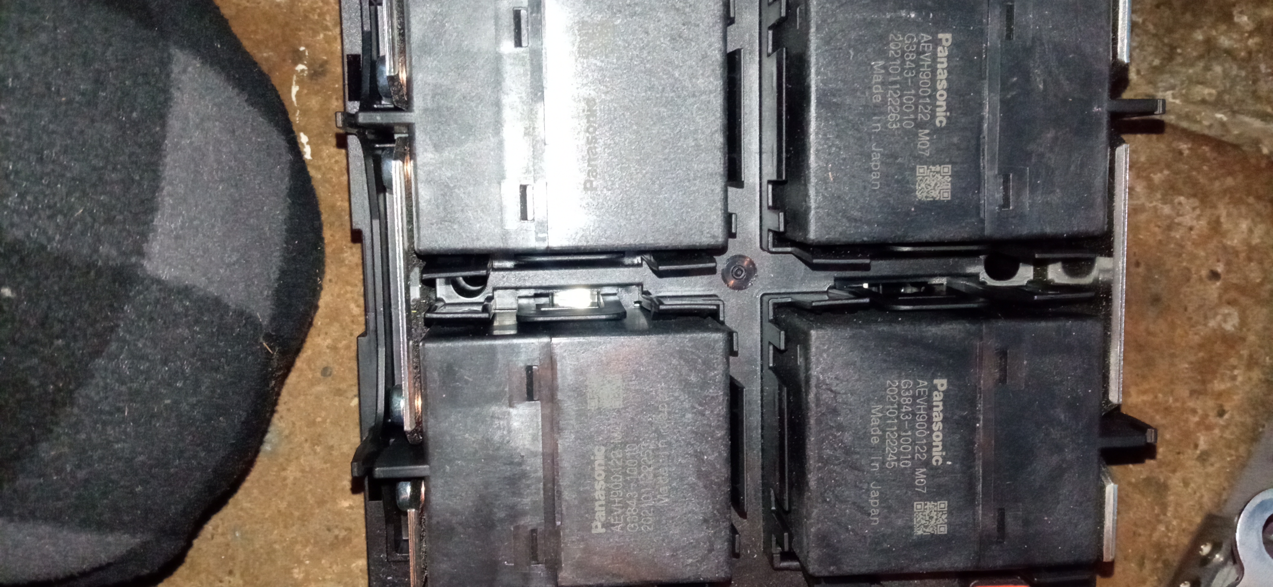

Contactors, eight of them. One board with two small precharge contactors (G3841-48030) and two larger ones (AEVT760122)
Then a larger board with four large contactors doing positive and negative connections. They are all AEVH900122M07.

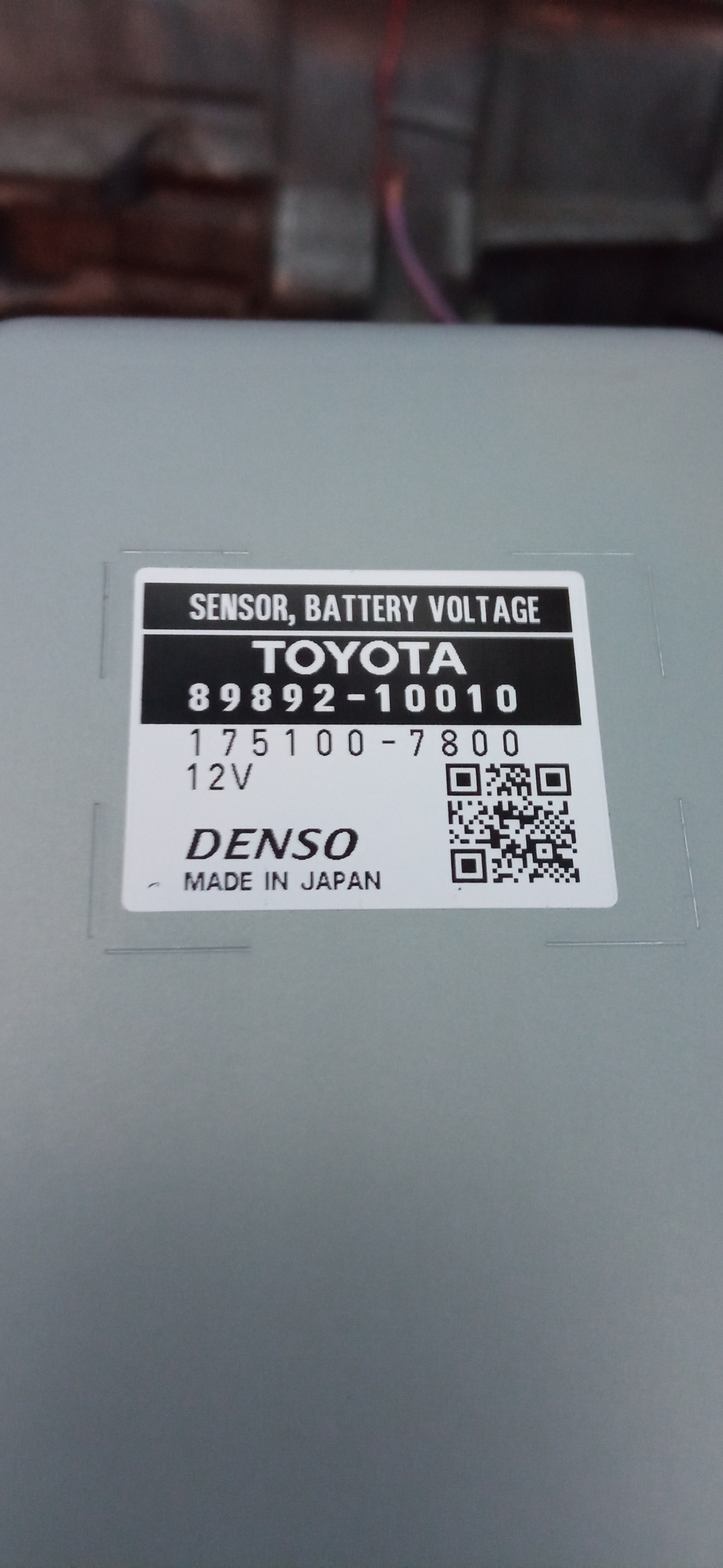

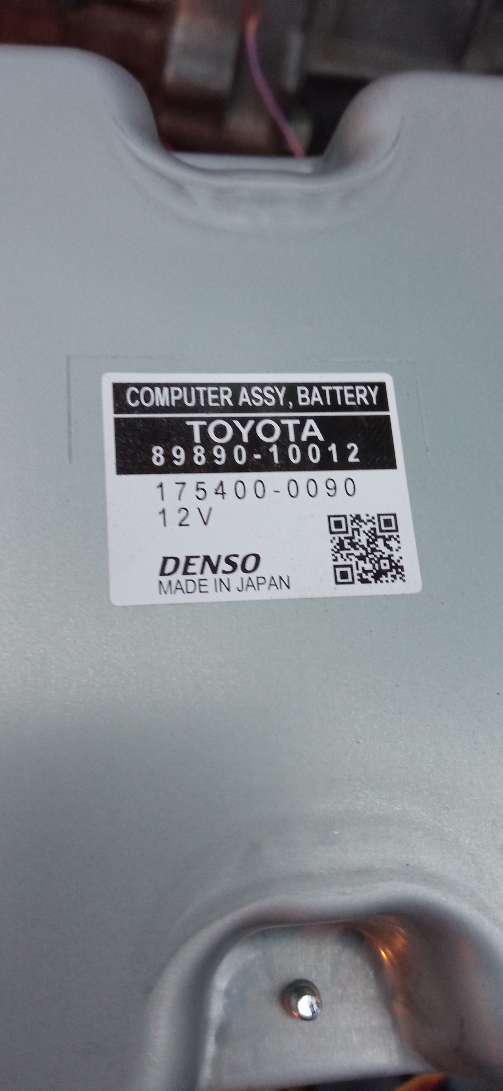

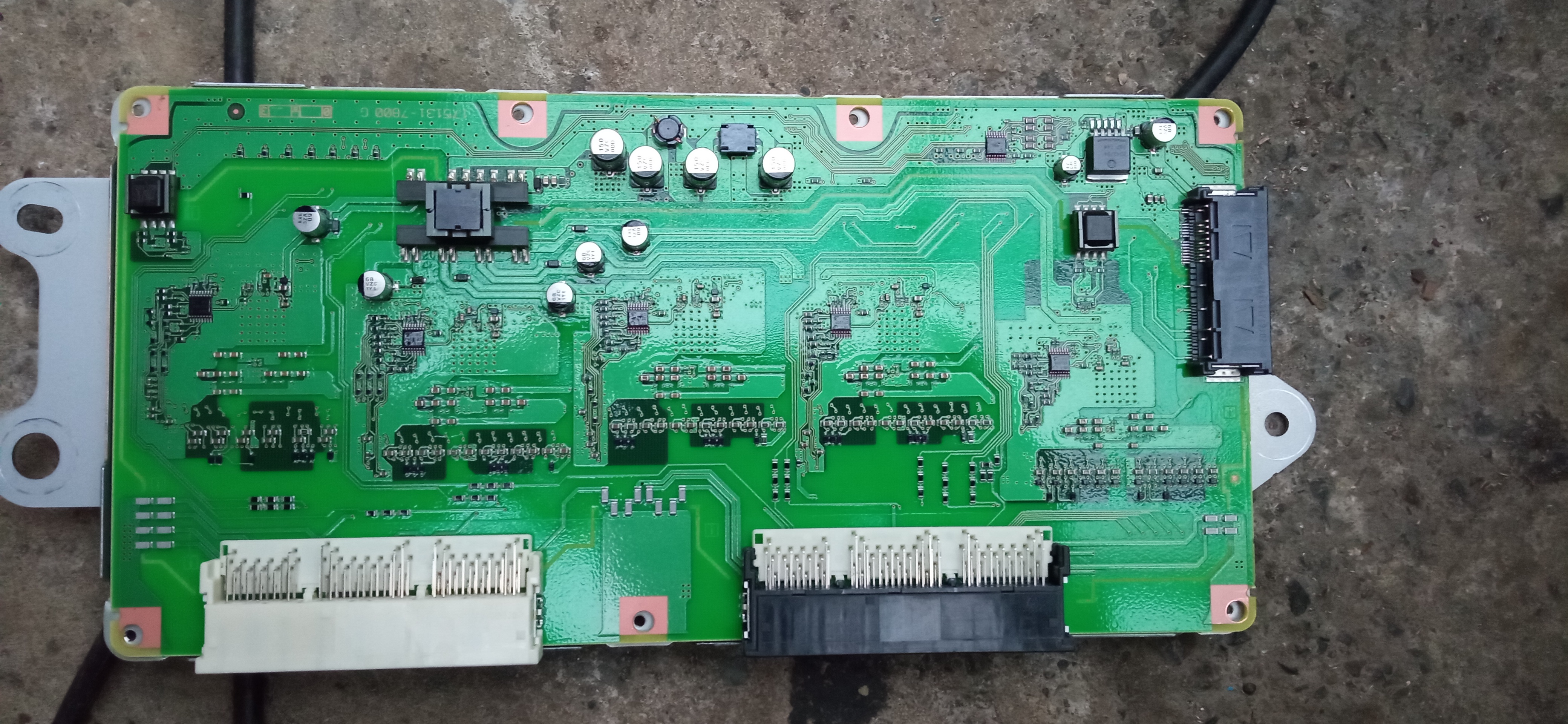

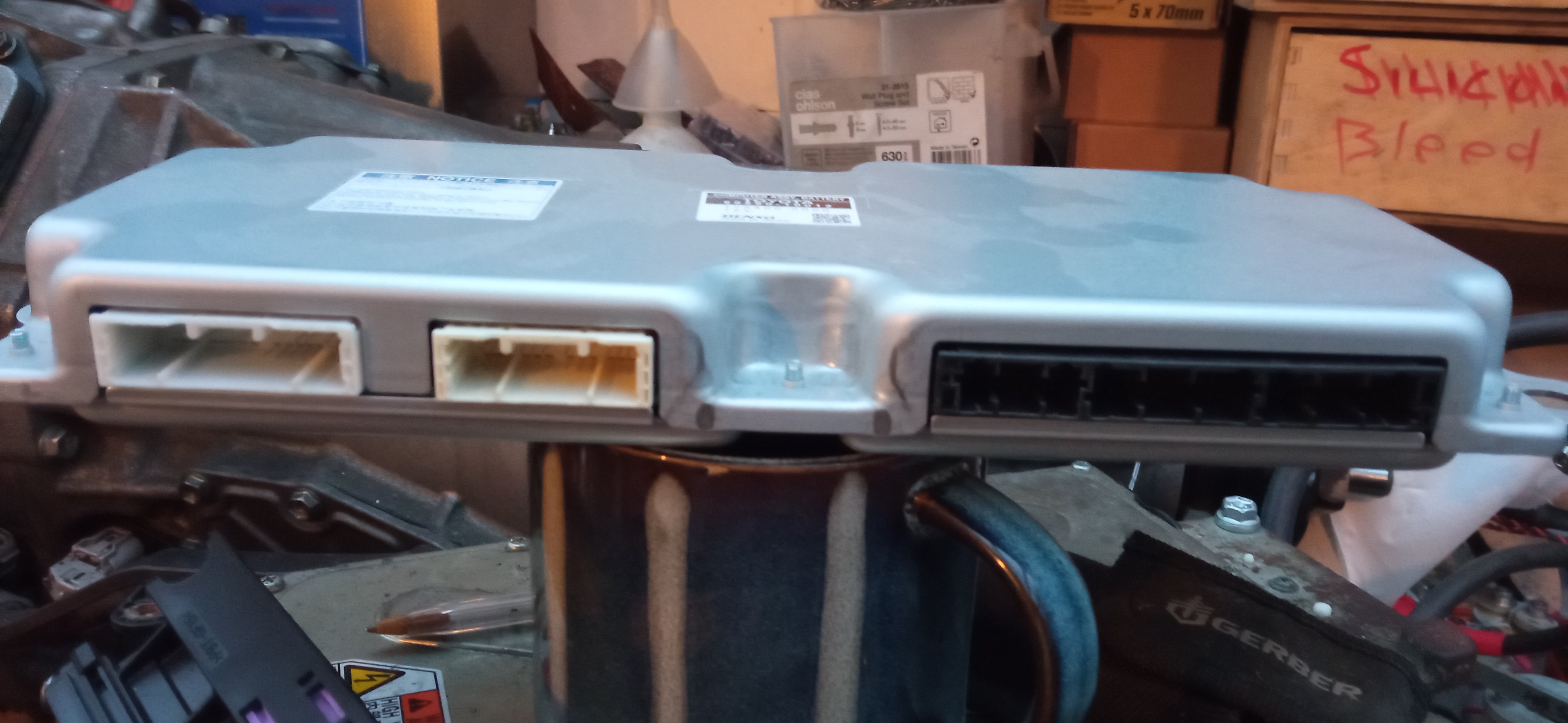

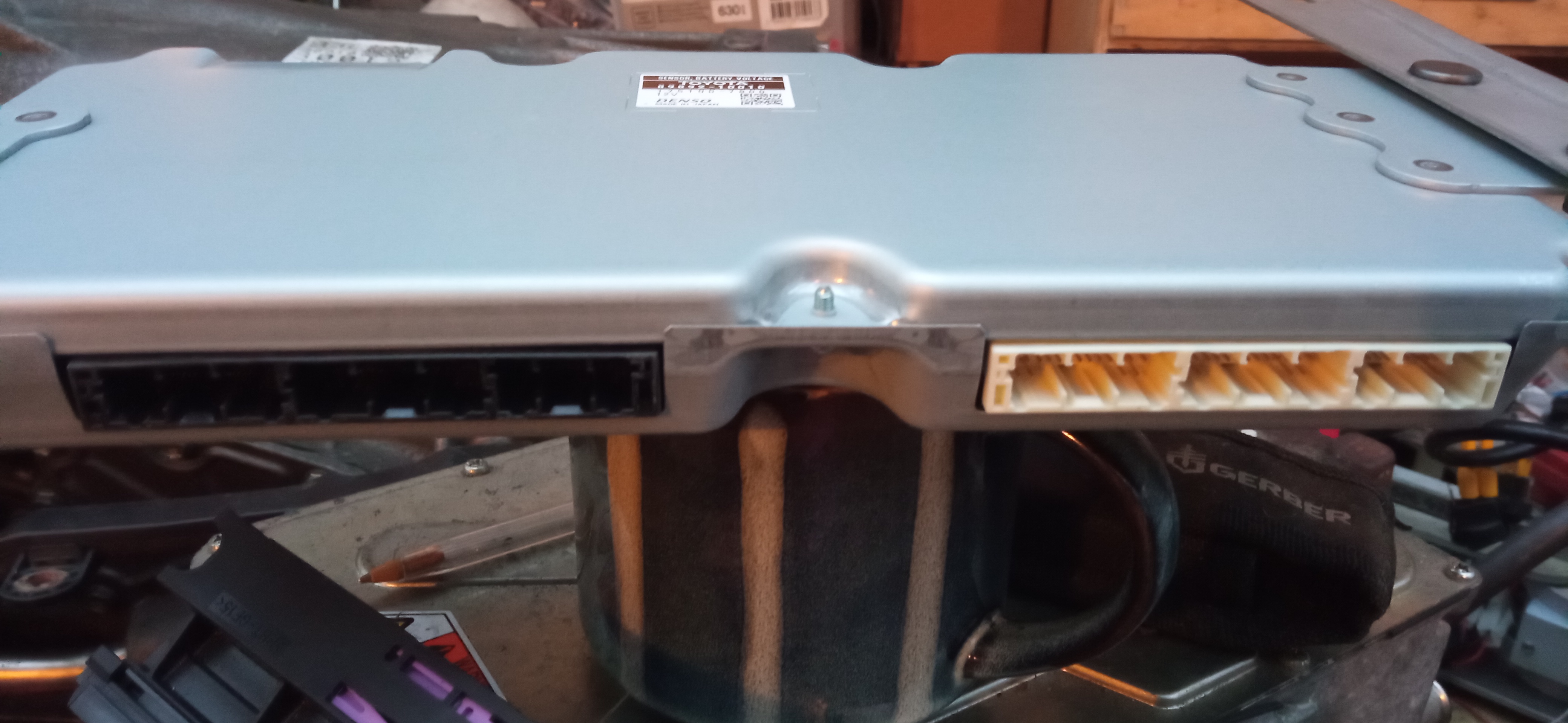

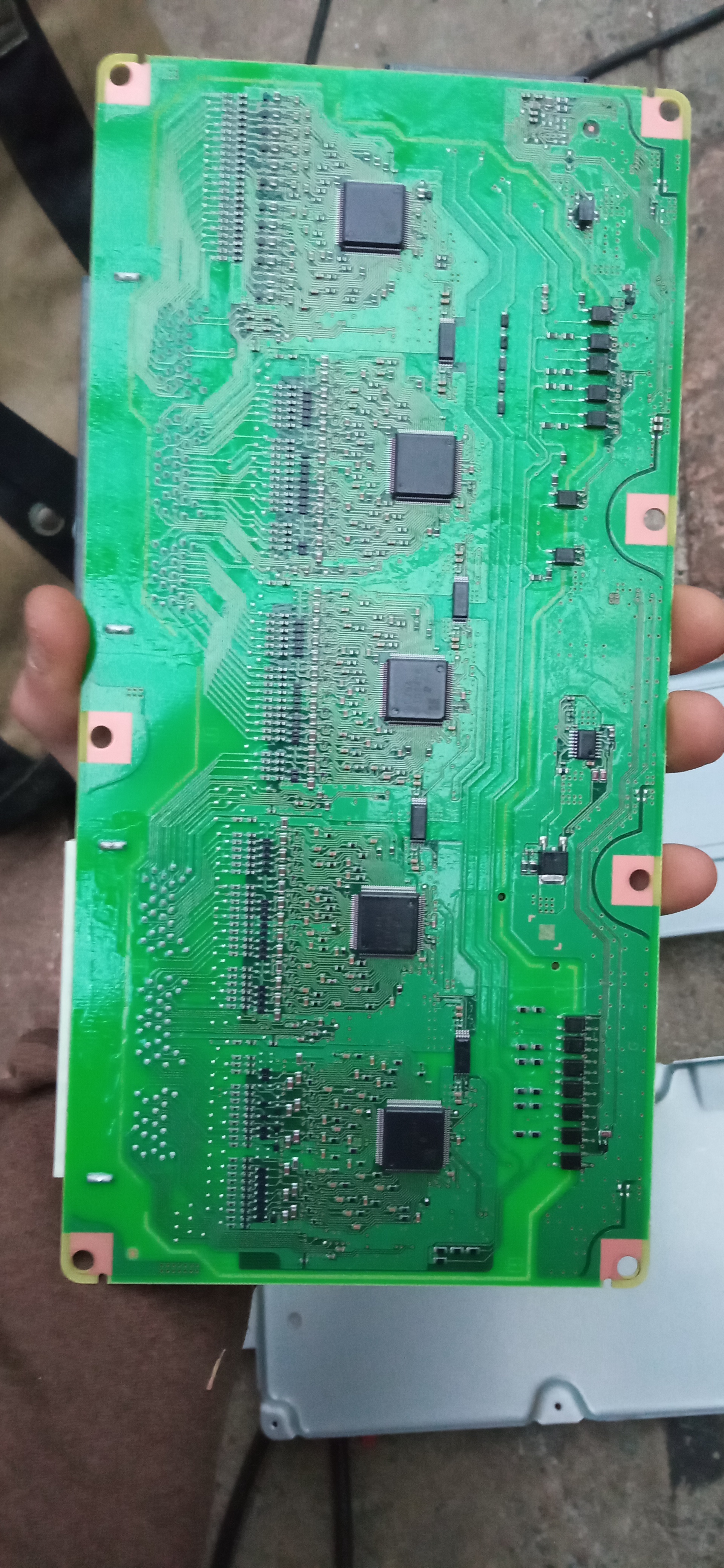

Battery computer assembly (BMS?) And Battery voltage sensor... (Other BMS?)
- Posts: 768
- Location: Uk
- Has thanked: 430 times
- Been thanked: 124 times

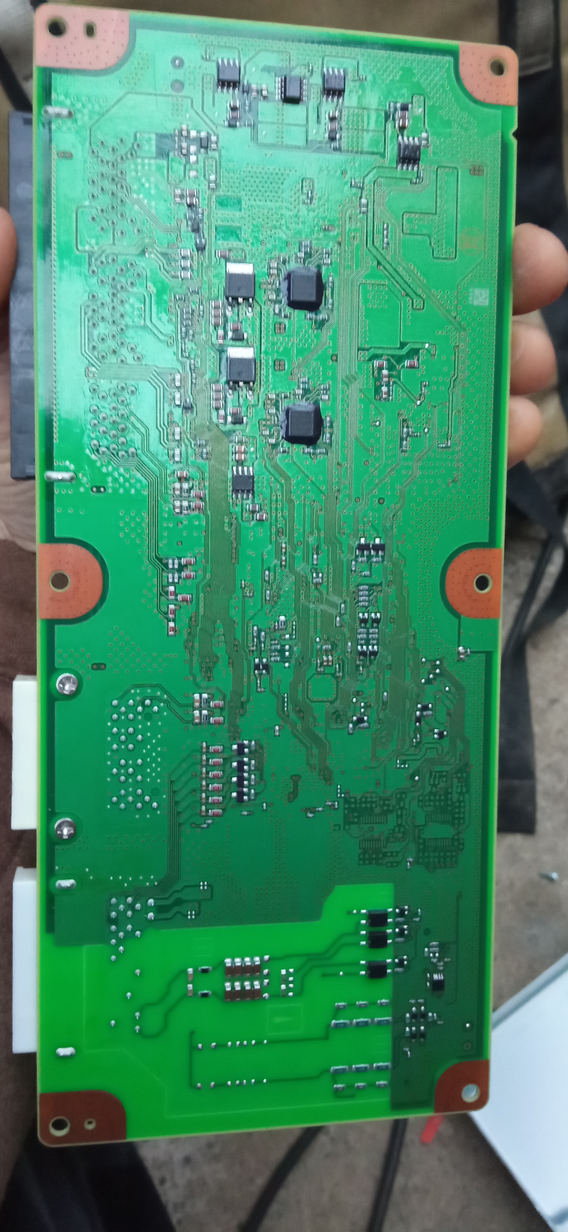

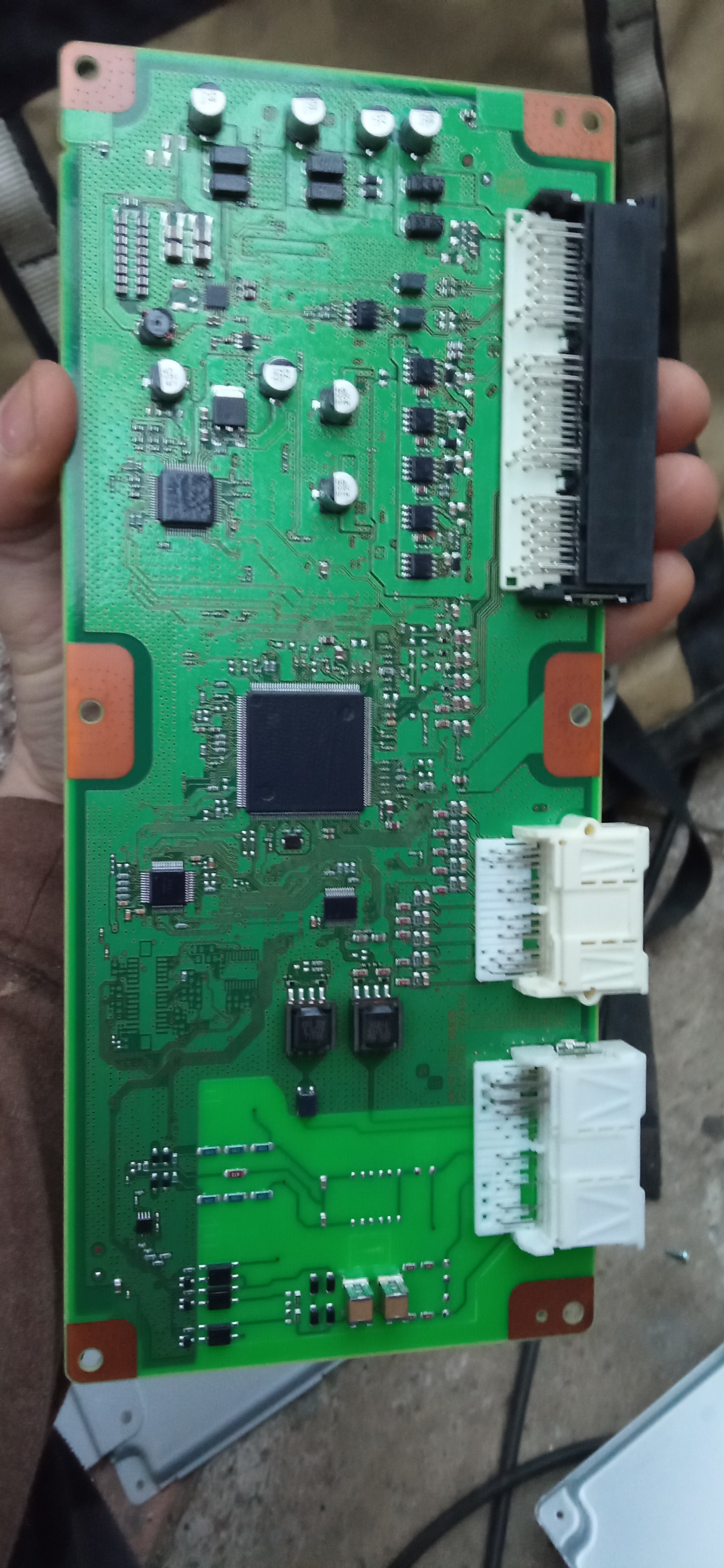

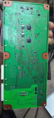

Innards if BMS Battery computer thingies
- Posts: 2467
- Location: Bristol
- Has thanked: 217 times
- Been thanked: 610 times
The one with the 5Ics looks to be a "dumb slave" board. 5x the same BMS front end chip with no higher level controller.
The one with the big IC is the "battery controller" I would say or the brains of the operation.
What are the part numbers on the 5 ICs on the "dumb slave" board?
This one?
- Posts: 2467
- Location: Bristol
yes that one, the one with the repeating circuit layout.
- Posts: 768
- Location: Uk

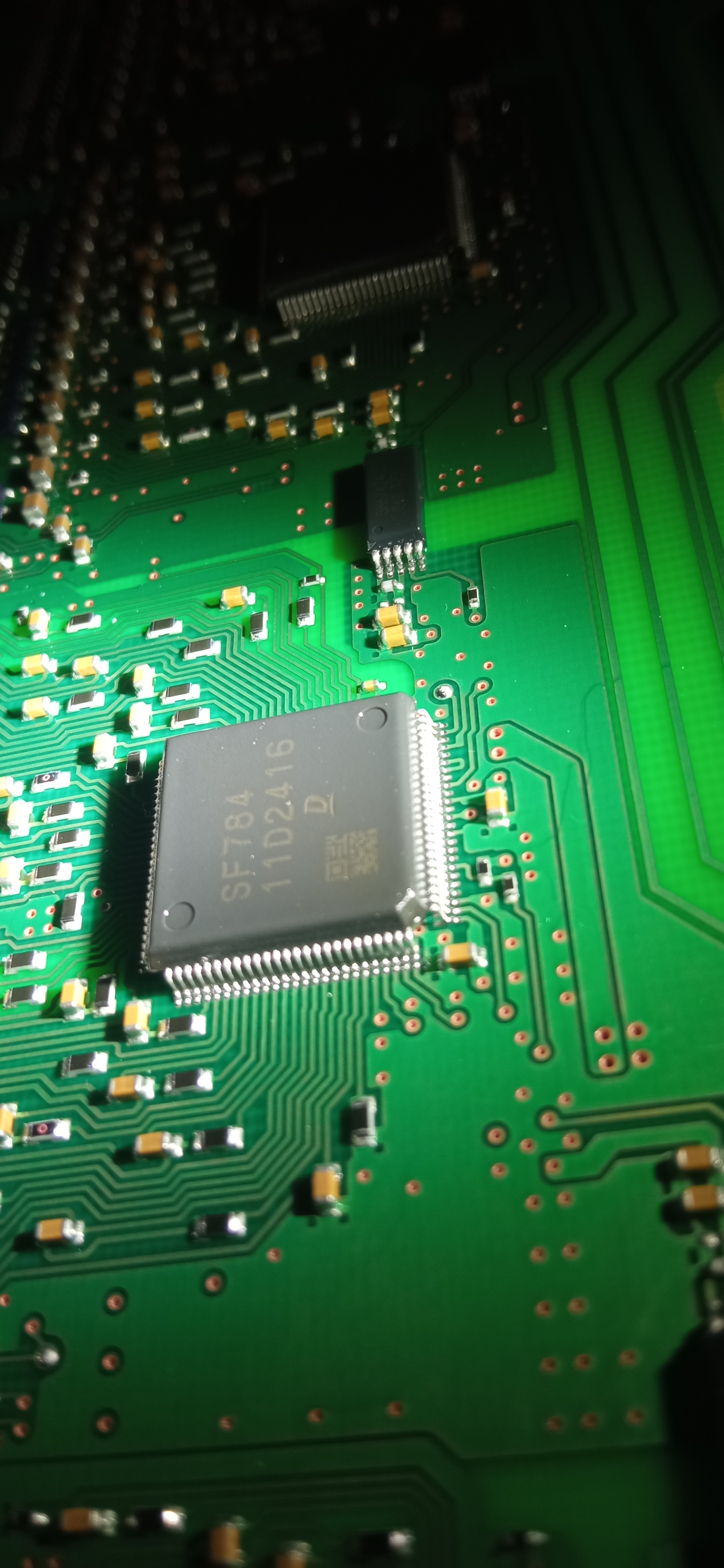

SF784
11D2416
Google doesn't turn up anything for me....
Tried scanning the QR but can't get my camera to focus on it well enough
- Posts: 768
- Location: Uk
HC4051AS 050 on the other side x5 much smaller so assume you meant the larger previous ones
- Posts: 768
- Location: Uk
9176J F61J6 14 of these on the side with the big ICs
- Posts: 2467
- Location: Bristol
Shit is fuly custom spun Denso chip that is why the "D" logo at the bottom.
https://www.denso.com/global/en/news/ne ... 01013-g01/
Yes I read that, the image they have has a similar number but not the same. So not usable at all? Would it be possible to swap them out for something not custom or is there a way of reusing the BMS in anyway?tom91 wrote: ↑Sun Feb 04, 2024 12:22 pm Shit is fuly custom spun Denso chip that is why the "D" logo at the bottom.
- Posts: 2467
- Location: Bristol
For you the best bet and more cost and time effective is replacing the BMS.
More electronically and programming inclined could attempt to reverse engineer parts of the BMS or try talking to the whole thing over CAN.

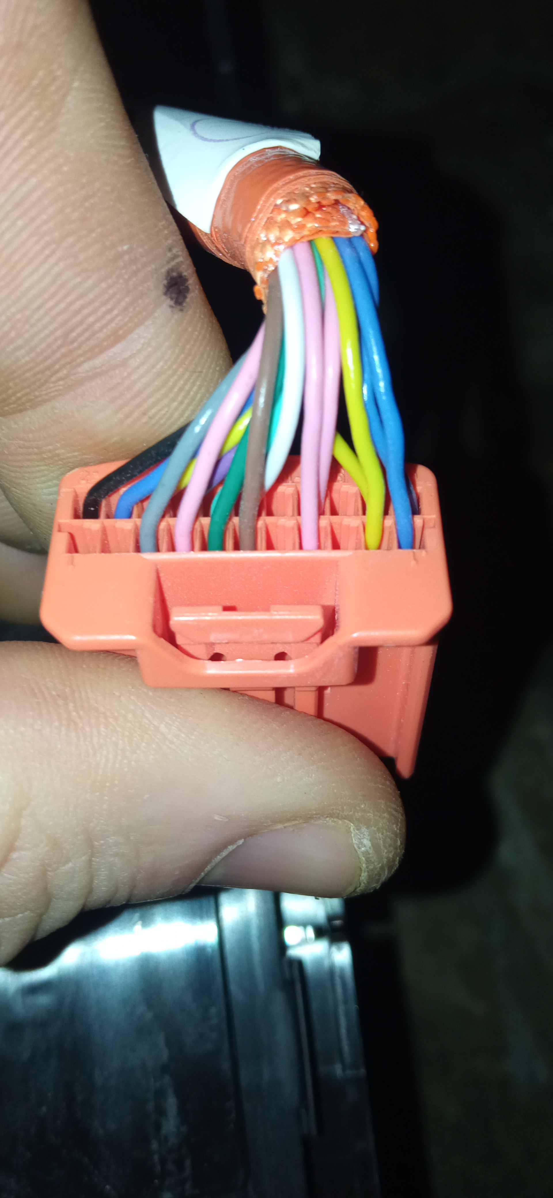

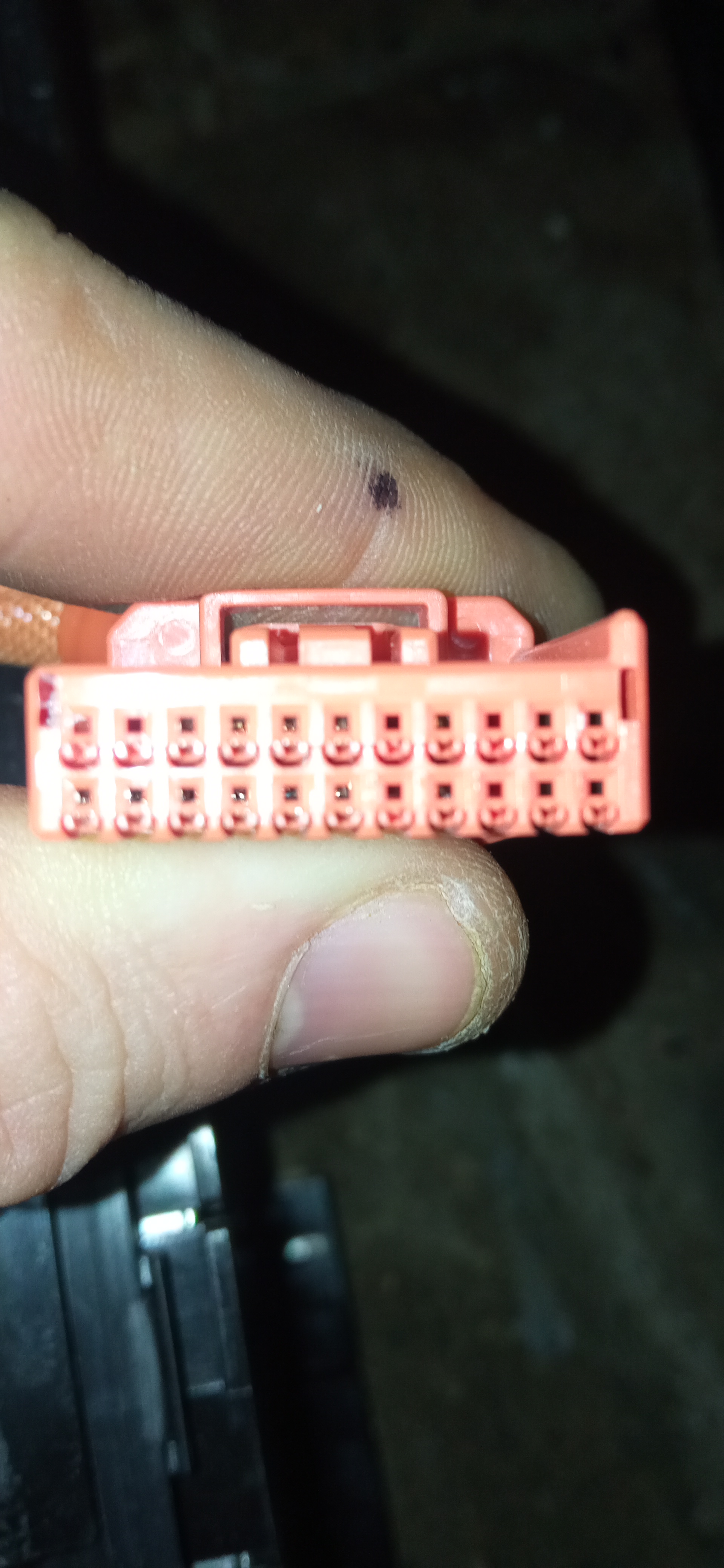

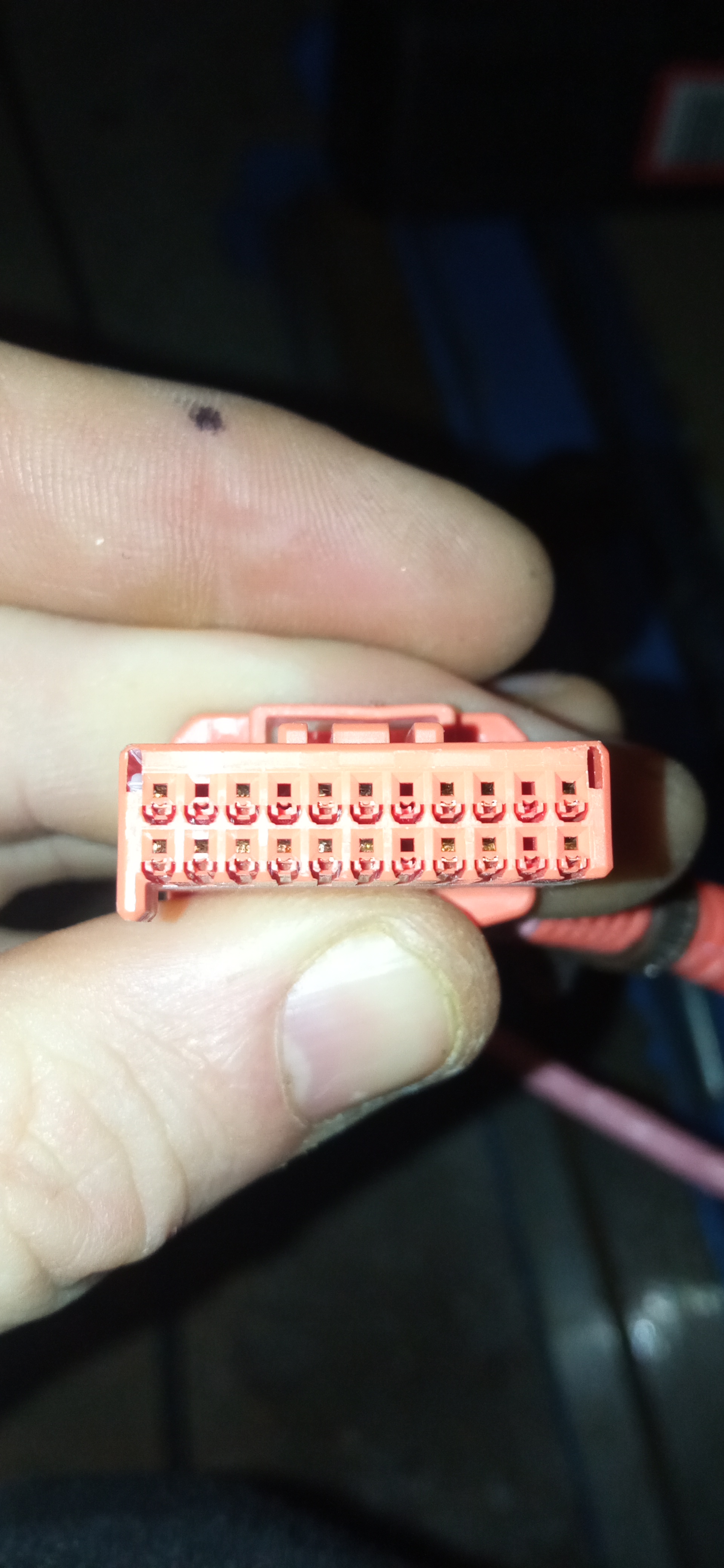

I had some more time to look at these modules today and I'm a little confused.
I've been trying to rematch the wiring harness with the module (silky me for not taking photos whilst dismantling!)
Anyway,
The modules seem to have 17 wires to their terminals, however, the connectors on the BMS harness only has 16, so there is one unused cell tap.
Each module has 3 temp sensors, with two wires each, then 9 (on the 8S3P module) or 10 (on the 9S3P module) cell taps on the positive and 1 on the negative. Is this normal BMS architecture?
Anyway,

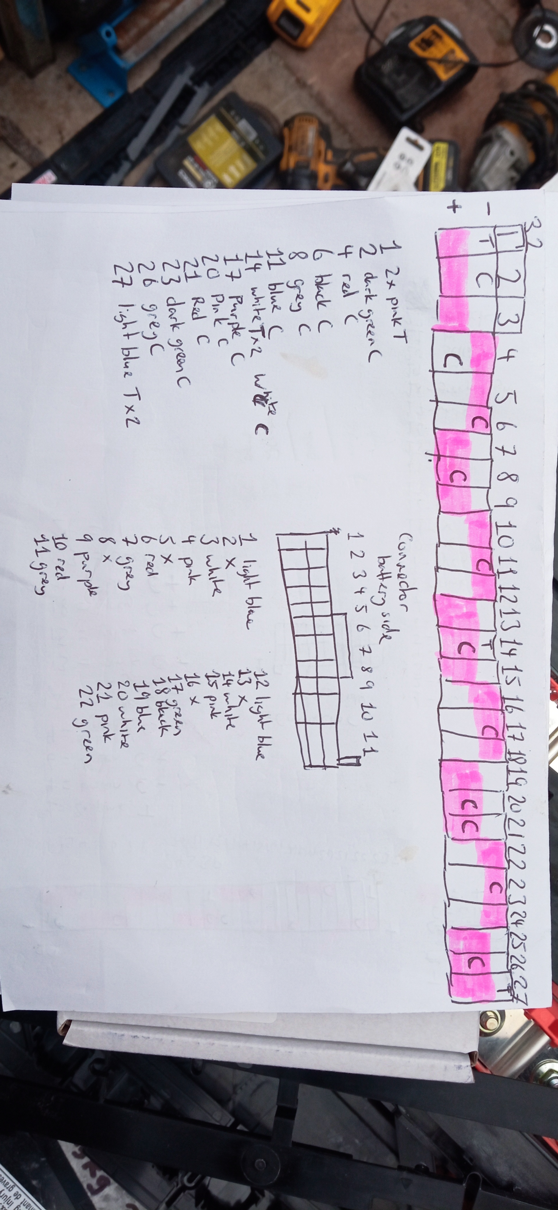

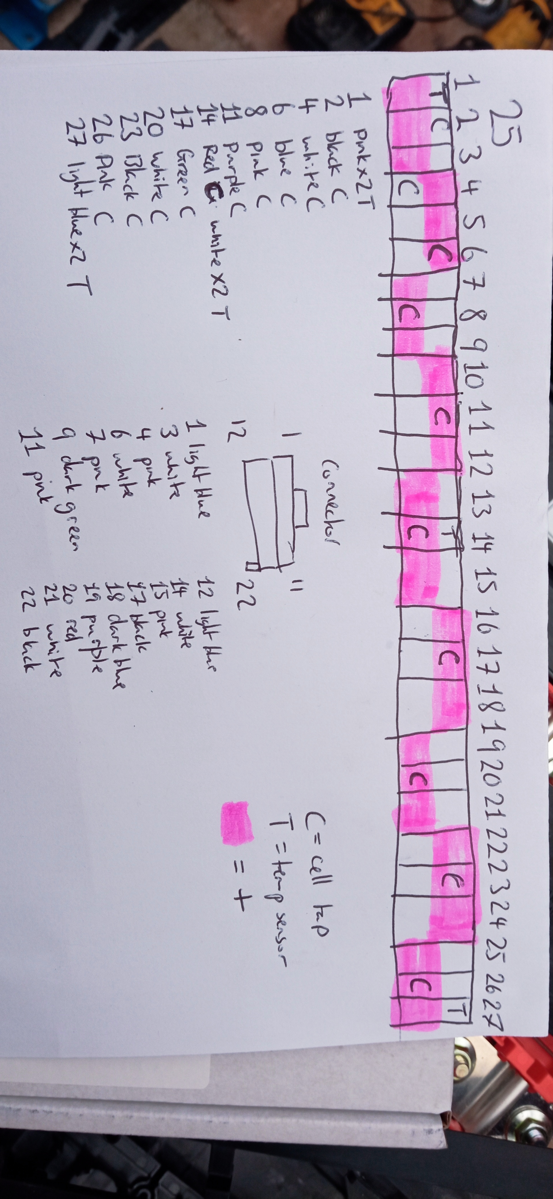

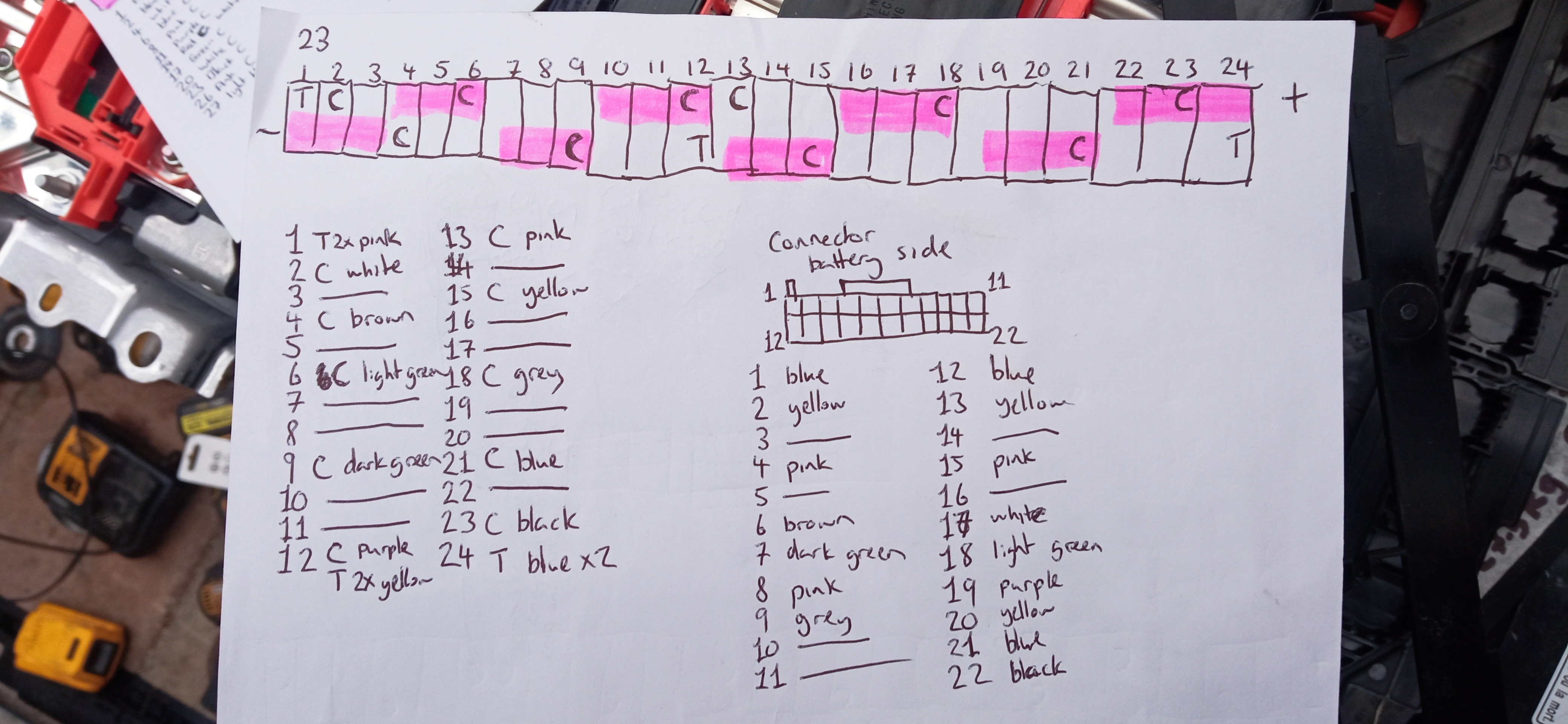

- Posts: 768
- Location: Uk
Some scribbled diagrams of the wiring. Most seem to have a repeating pattern, I've still got to check the others.
C = cell tap
T = thermistor
Pink highlight = positive terminal
The connectors are drawn from the wires from the battery side.
As can be seen, some have 17 wires, some 16. It seems on the BMS side, only 16 wires, with one of the 17 cell taps remaining unconnected.
Any insight is appreciated, I'll type this all up in a more readable format later on...
C = cell tap
T = thermistor
It doesnt really matter wether the tap is on the positive or negative, they're joined together. The tap sits between each parallel block. They surely must all reach the BMS??
You will need to map out the exact order of the cell taps vs the connector. Colors alone are not enough as there appear to be duplicates.
You appear to have an extra cell tap on certain modules on the bottom two drawings but not the first?
Also, I plan to map them out later on also but the thermistor wires seem consistent with their colouring (paired white, yellow and pink)
Yes that's the confusing thing. Some 9s3p modules have 11 taps some have 10.
And yes it seems some duplicated taps (where a group of 3 have two taps) don't make it to the BMS
