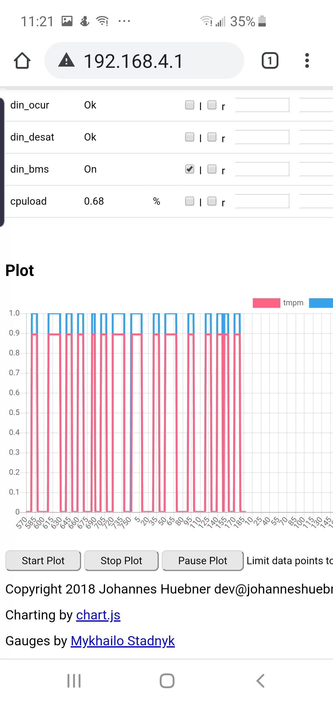

I'm getting strange Input values. Board is fully connected except for HV and running V4.57. Digital inputs - start/forward/reverse read okay. Pot value reads okay, but potnom reads 0 regardless of potmin/potmax values. Voltage (uaux) reads a constant 16.43 volts which is incorrect - actual voltage is 12.7. Tmphs reads okay, but tmpm alternately reads the correct value and 0. Interesting thing is digital input din_BMS alternately reads 0/1 at exactly the same frequency as tmpm.
Posts: 3666
Has thanked: 12 times
Been thanked: 351 times
Uaux is not implemented on the Tesla boards.
One of the motor temp sensors is not implemented hence the jumping value.
The bms pin is used to switch between the motor temp sensors hence the pattern you observed.
Potnom will not change until you are in run mode.

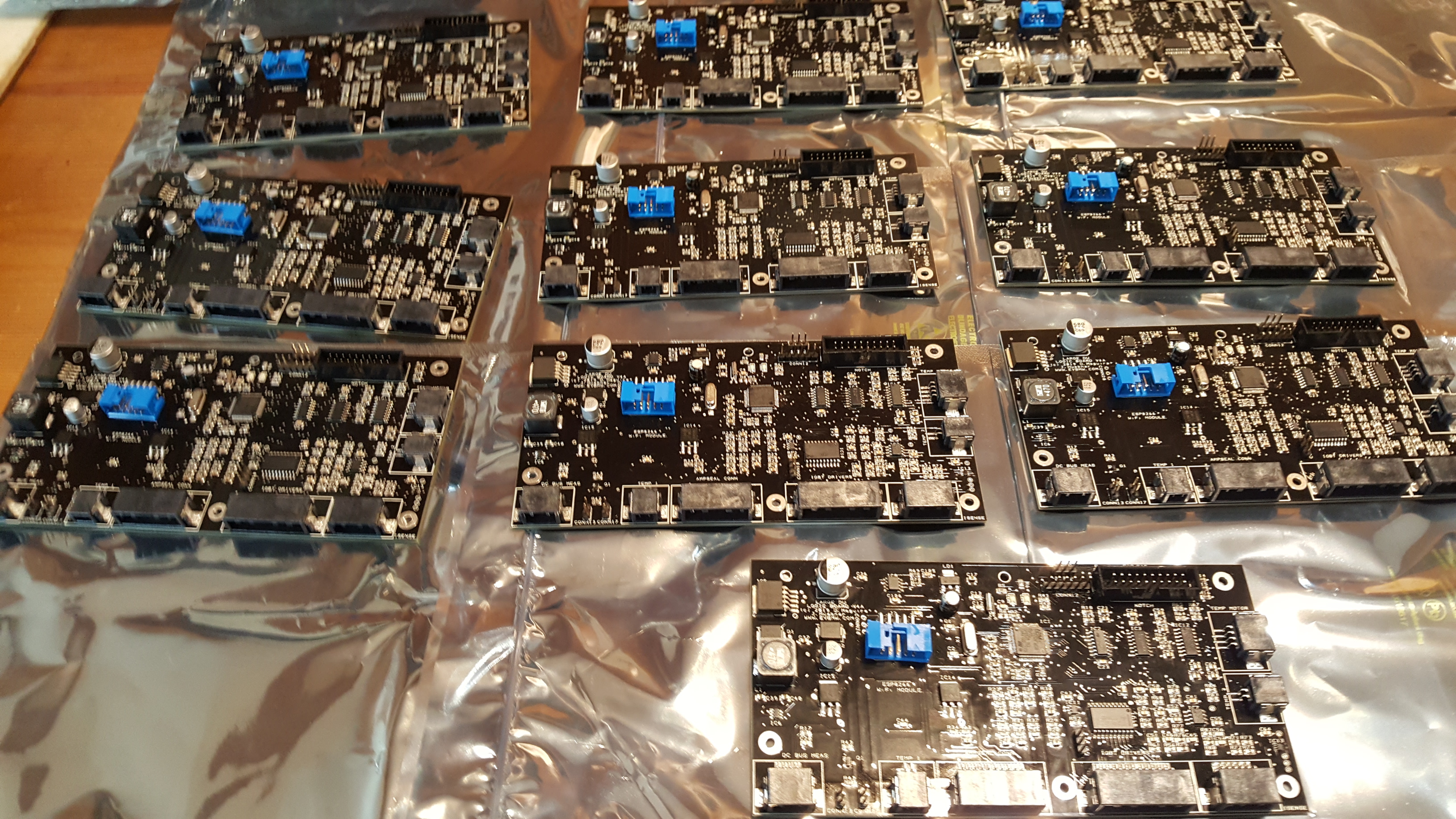

Some good news on board supply. I have now acquired a much more reliable pcb manufacturer here in Ireland and boards will be in stock for immediate dispatch. No more silly delays and boards are being built on an automated smd line so quality is much improved.
