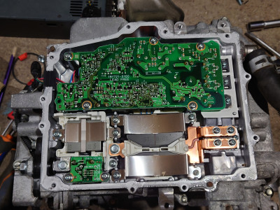

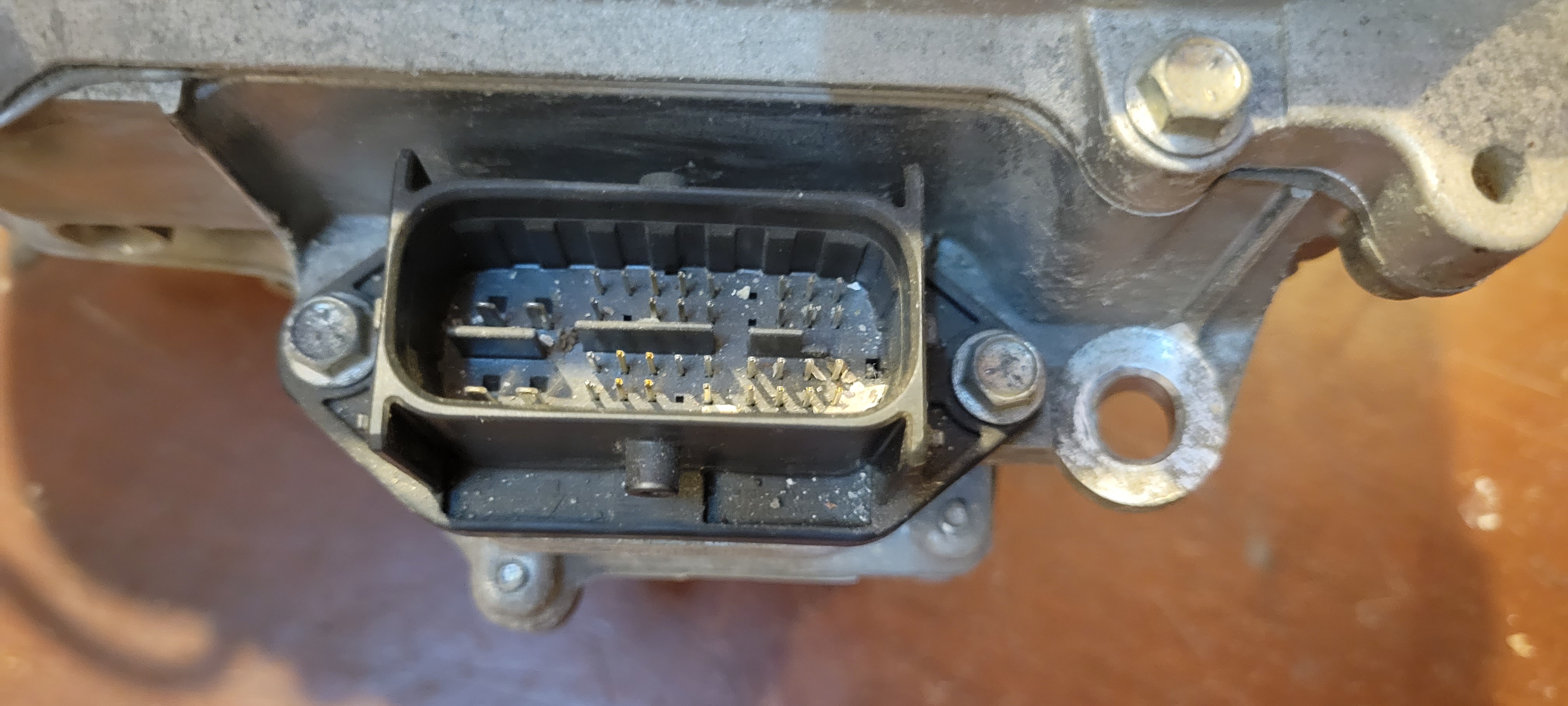

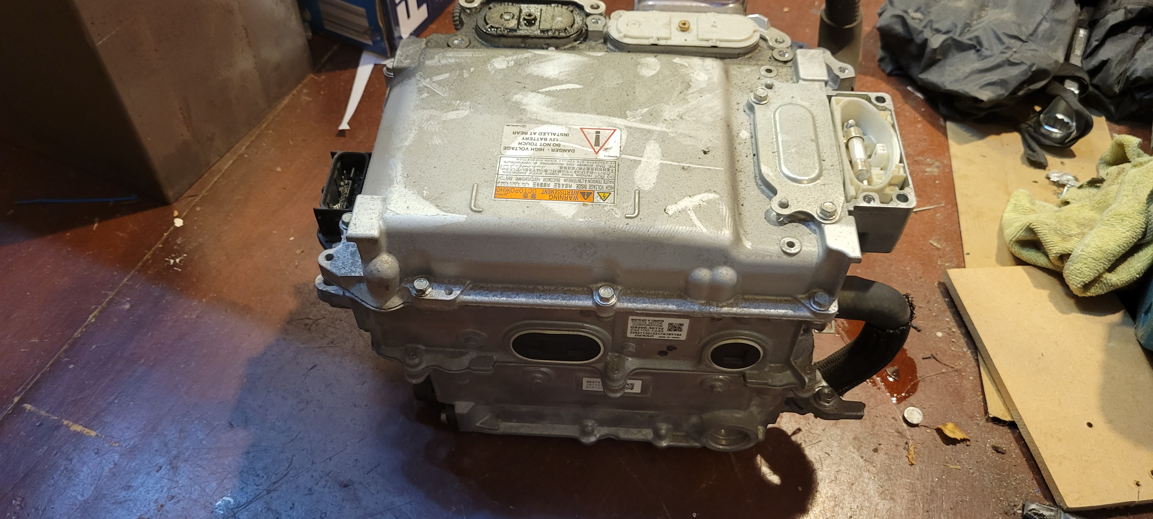

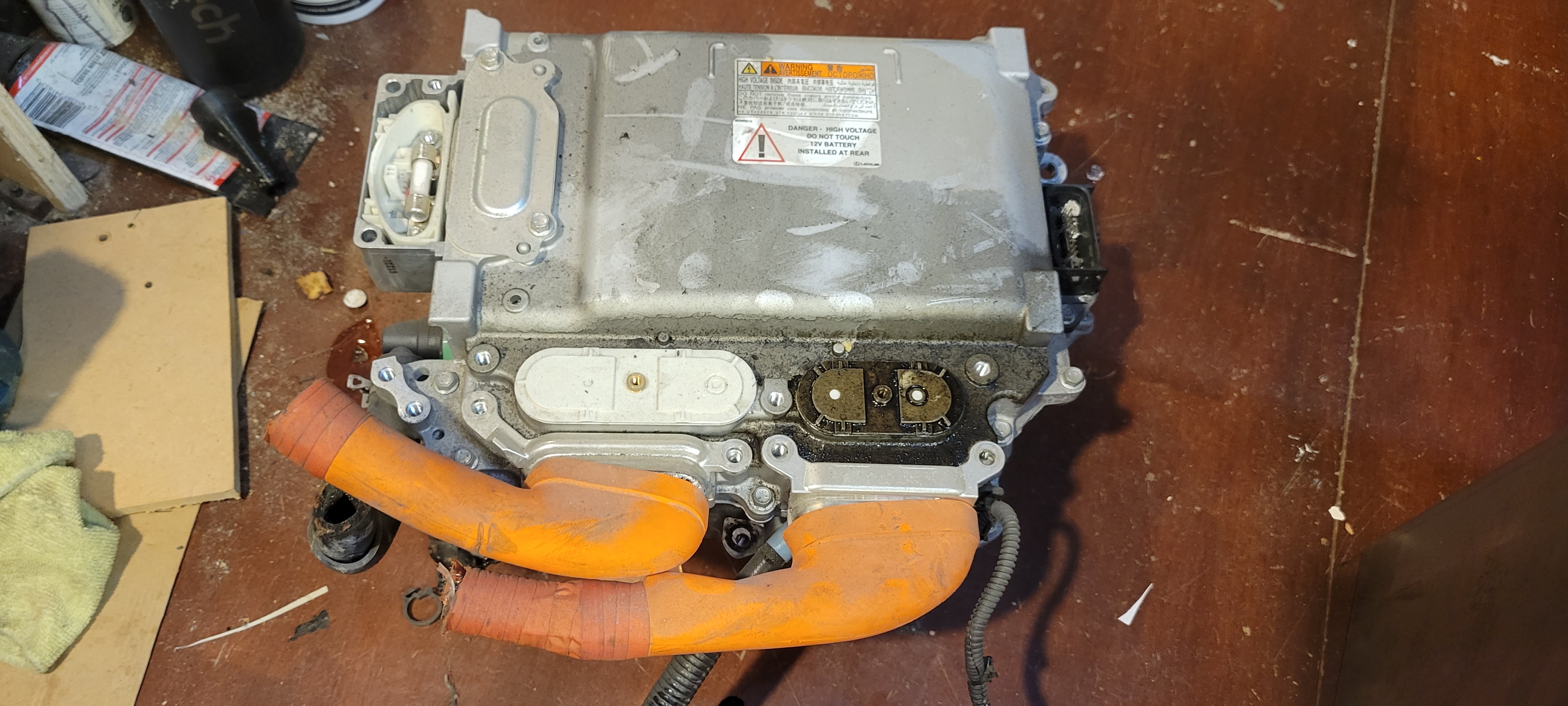

Can you post up a picture of the inverter. Will help me recognise.
bobby_come_lately
Posts: 486
Location: Manchester, UK
Has thanked: 56 times
Been thanked: 63 times
Re: L210 gearbox
Post by bobby_come_lately »
Thanks - here you go.

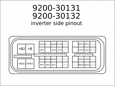

Hi. I've got the same connector on my G9200-30131 inverter. I havn't try it with the Zombieverter yet.
I draw the pinout diagram from the Toyota EWD database, but I can't find it right now. I'll try to find it tomorrow.

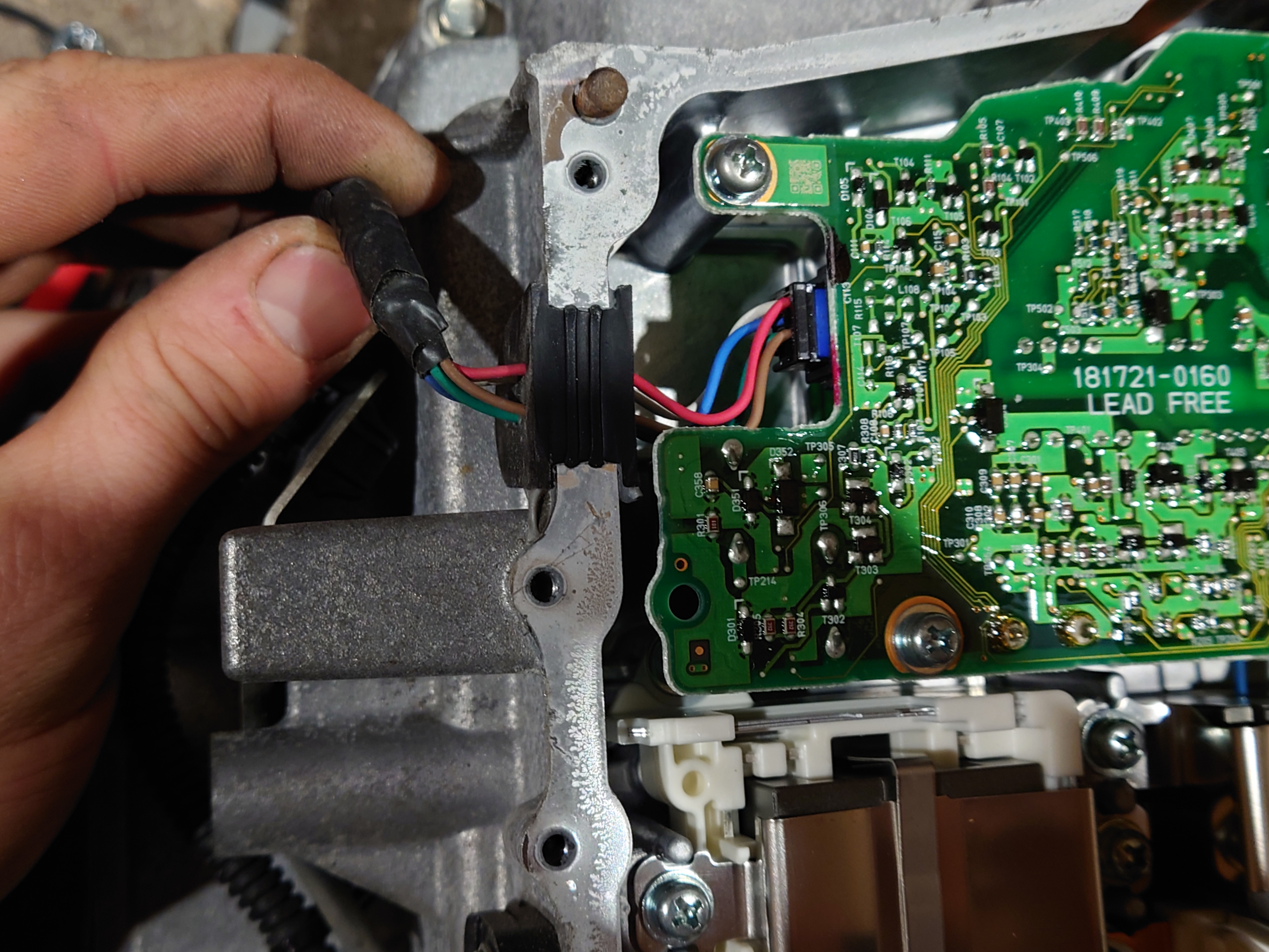

I also found out that my inverter (and yours) has a DC/DC converter and a separate connector to control it.

chuuux wrote: Wed Jan 19, 2022 8:22 pm Hi. I've got the same connector on my G9200-30131 inverter. I havn't try it with the Zombieverter yet.
Magic - thank you.
I figured the chunky 12v connection must be for DC-DC. I may end up using the one on the charger (Outlander) as I have with my first car. But good to have the option.

Here it is.
Please, let us known if Zombie communicate to inverter. As far as I understand, folks havn't yet hacked MTH/HMTH packages of 2013+ inverters (not Prius).

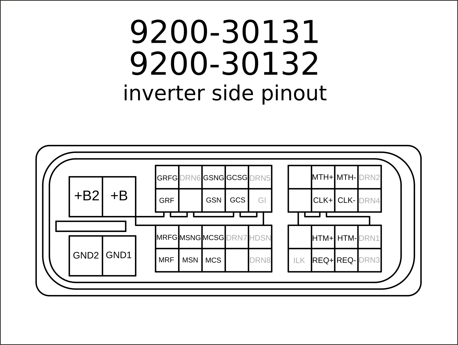

I think I should draw one more pinout picture (for resolver connector - motor side).

chuuux
Posts: 68
Joined: Fri Mar 12, 2021 5:11 am
Location: Ural
Re: L210 gearbox
Post by chuuux »
That's the pinout for the both of motors.

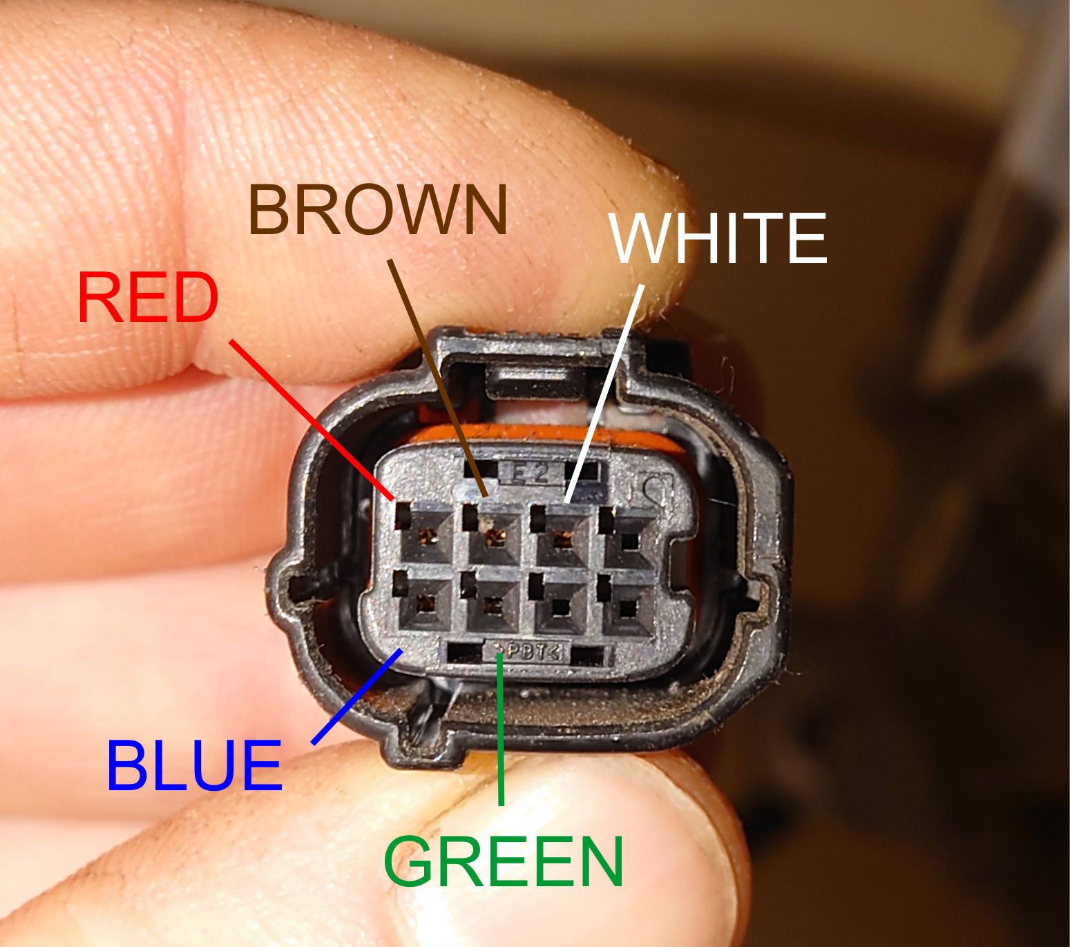

Last connector question @chuuux - do you know what the connector is for the DC-DC on that inverter?
chuuux
Posts: 68
Location: Ural
Re: L210 gearbox
Post by chuuux »
Inverter's side of DC-DC connector is the same 90980-12520 8 pin female.
So you need 90980-12519 8 pin male connector.
I've opened bottom side of camry's 3Gen invertor with the same connector. Colors of control wires and equal with Prius Gen3 internal wires. So we should try the same logic of control.

Looks very like the IS300 inverter.
