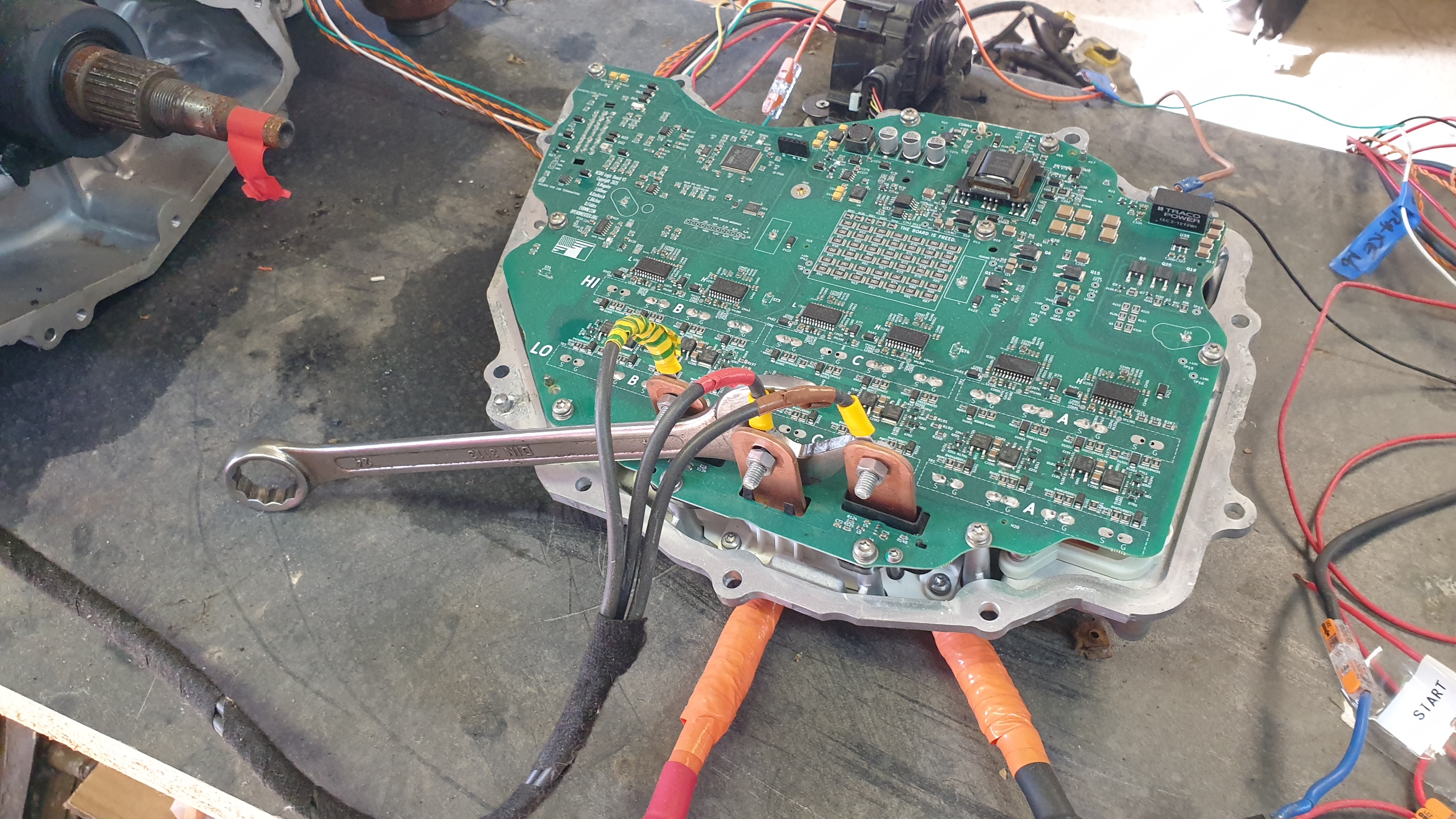

Posts: 4000
Been thanked: 1116 times

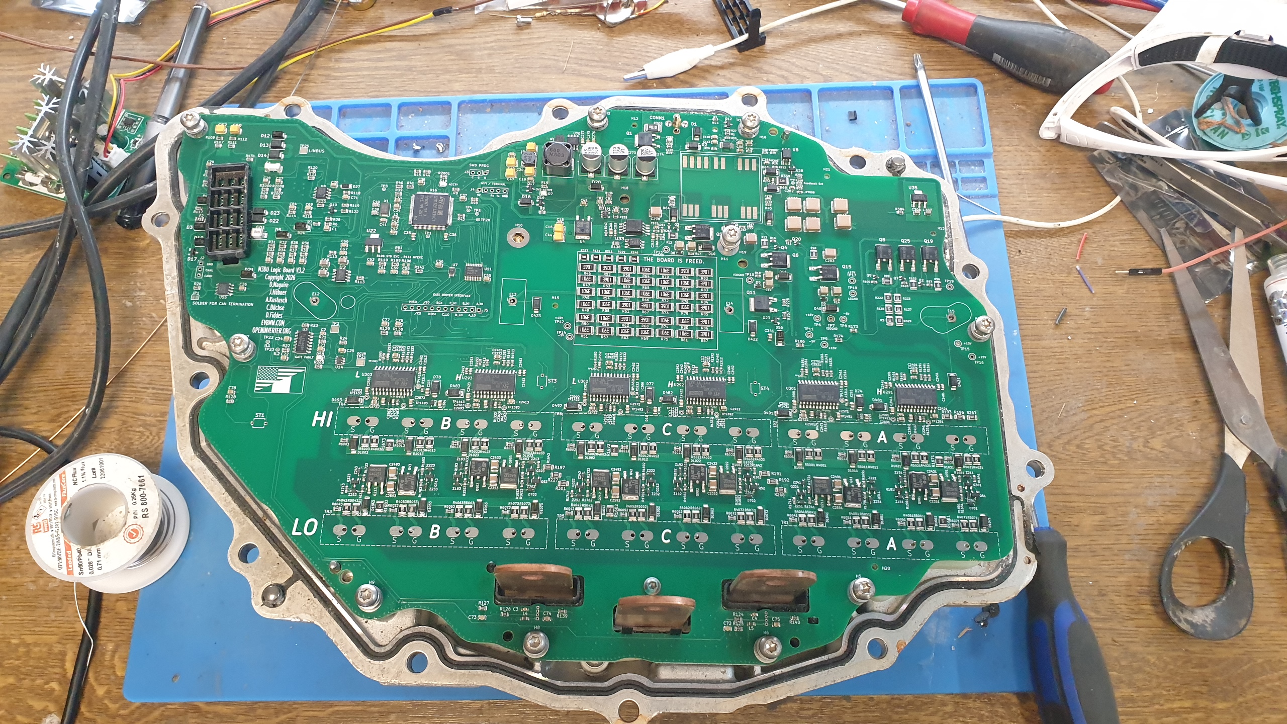

V3.2 board test fitting in the front inverter. Current sensor block is now a perfect fit as are dowels and all but one of the mounting holes! Sorry folks Still need to move H10 a mm left. Other that that the physical fit is great. I should have current sensors and 6R2 resistors early in the week and then we are good to go.

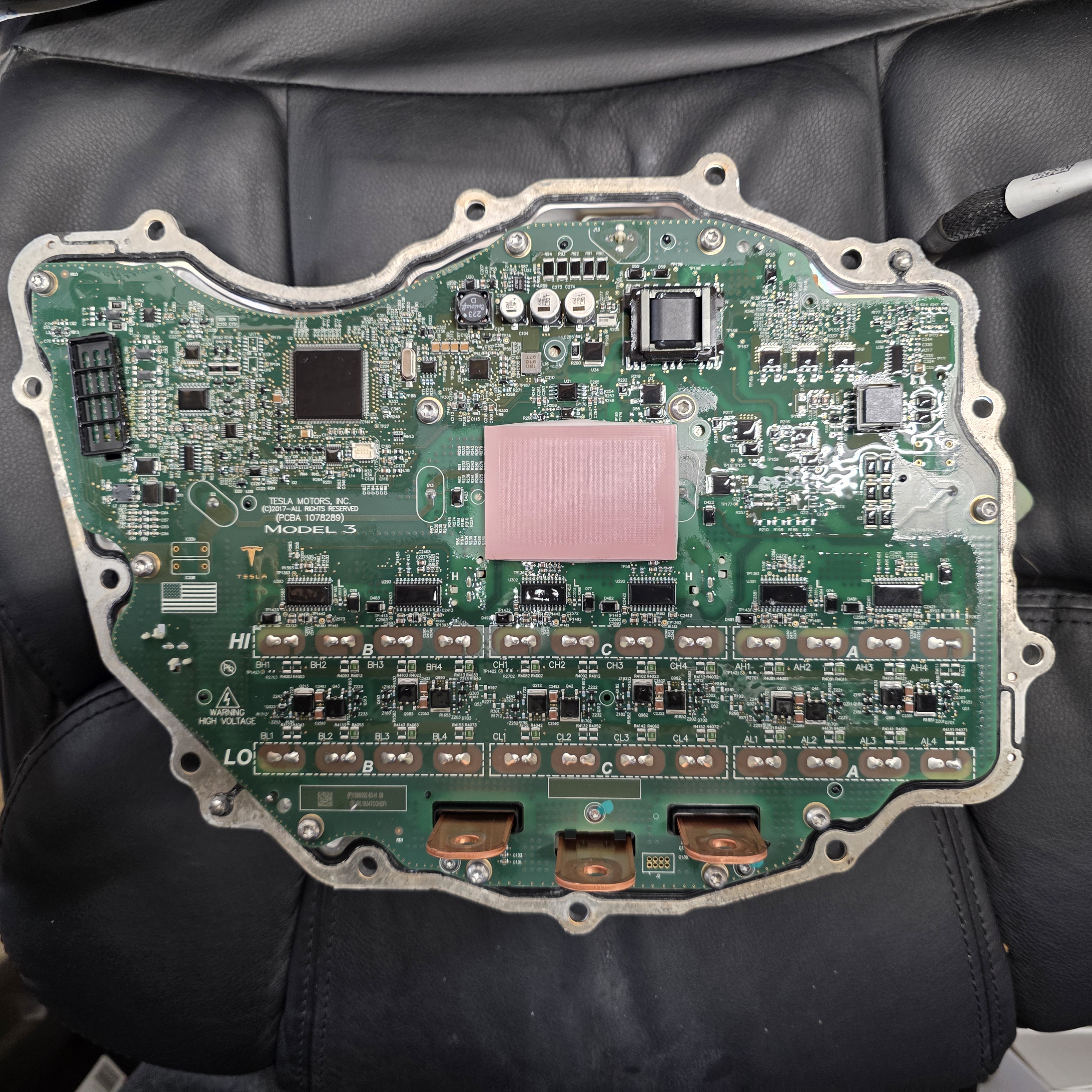

I just picked up a FDU is there a model # or board revision number I can look for to see if it is the one you guys need information from?

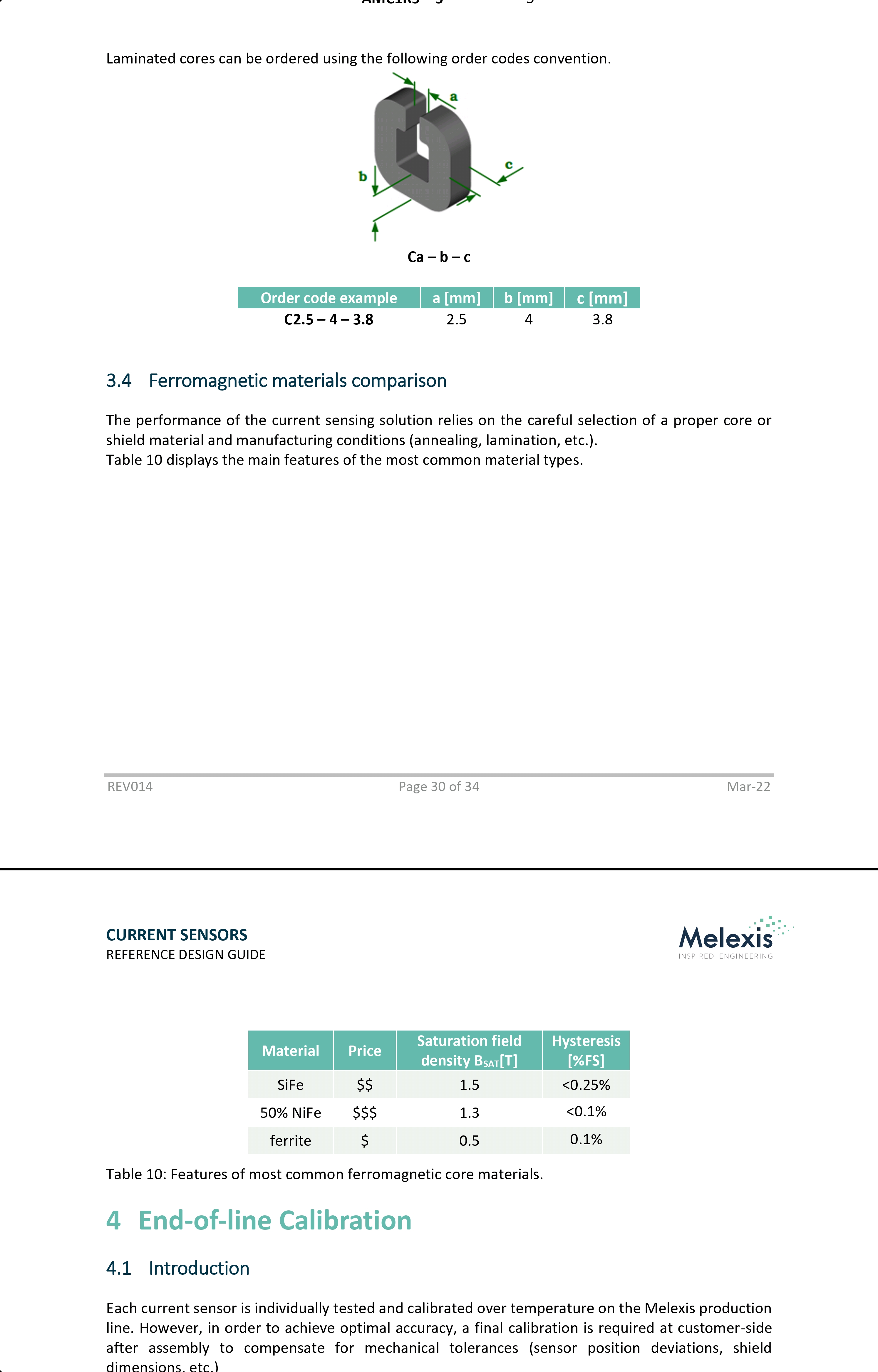

I also found this for the toroid search,
I'll try to use this to figure out a part number and see if there's anything off the shelf available. I'll make a stock current sensor housing and I'll consider doing a modified version if theres something else close size wise that works properly for current sensing.
Sounds like I may need to destroy the current sensor housing to get the toroid out to measure it. if someone has a toroid out or one in a broken housing and can share accurate toroid measurements it would help me work through this piece.

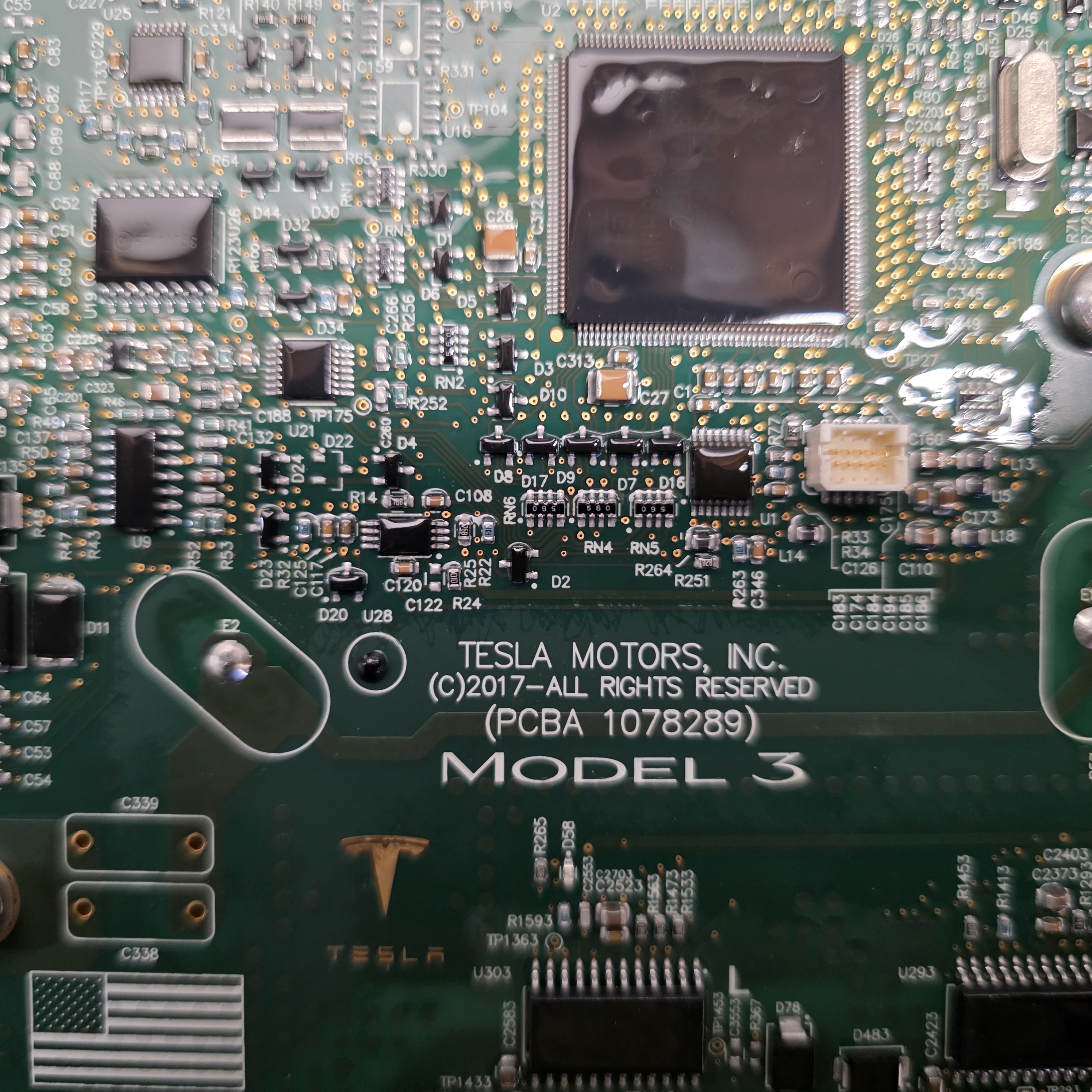

r1ckyb0nd wrote: Sun Mar 01, 2026 2:12 pm I just picked up a FDU is there a model # or board revision number I can look for to see if it is the one you guys need information from?
I'd need to see a picture of the inverter pcb.

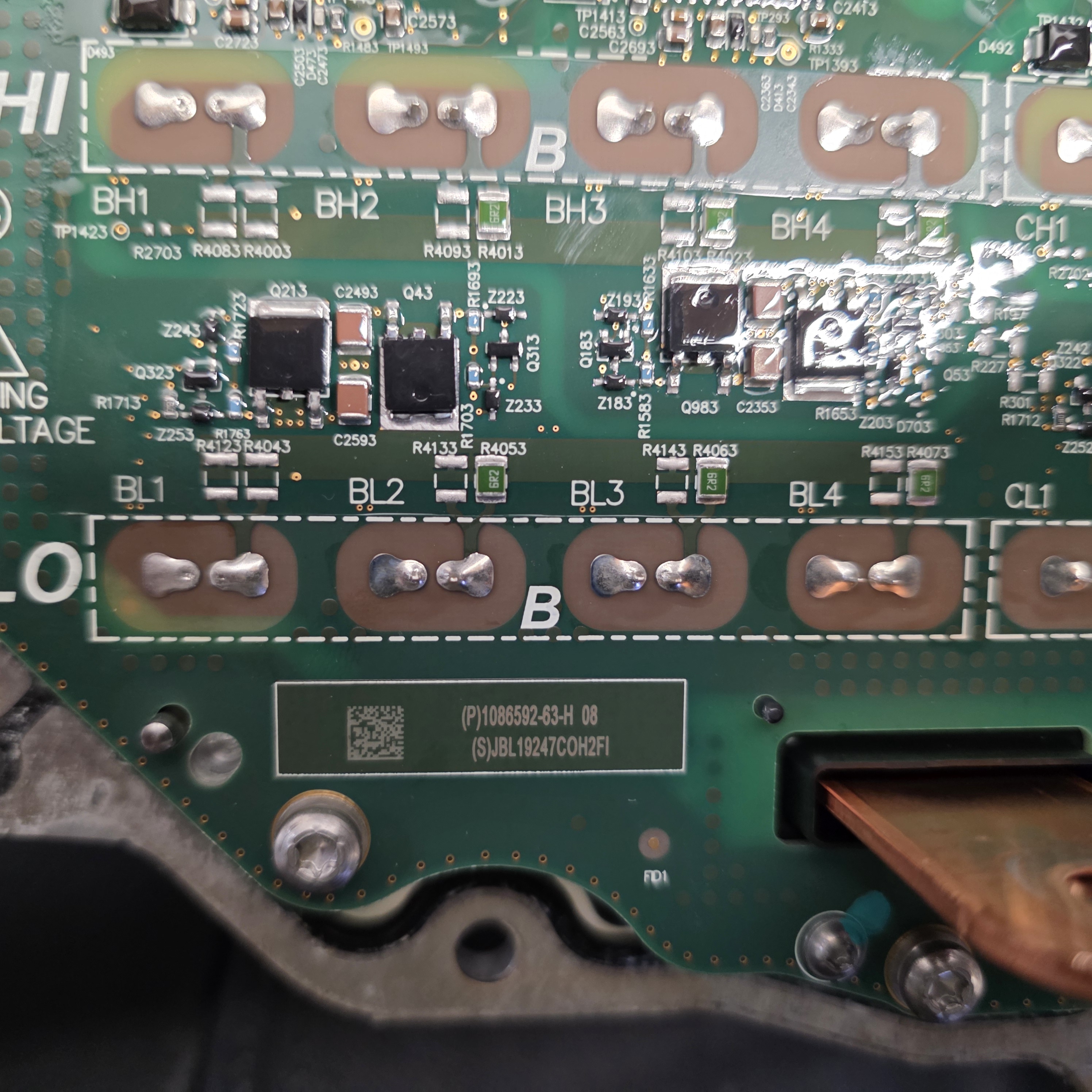

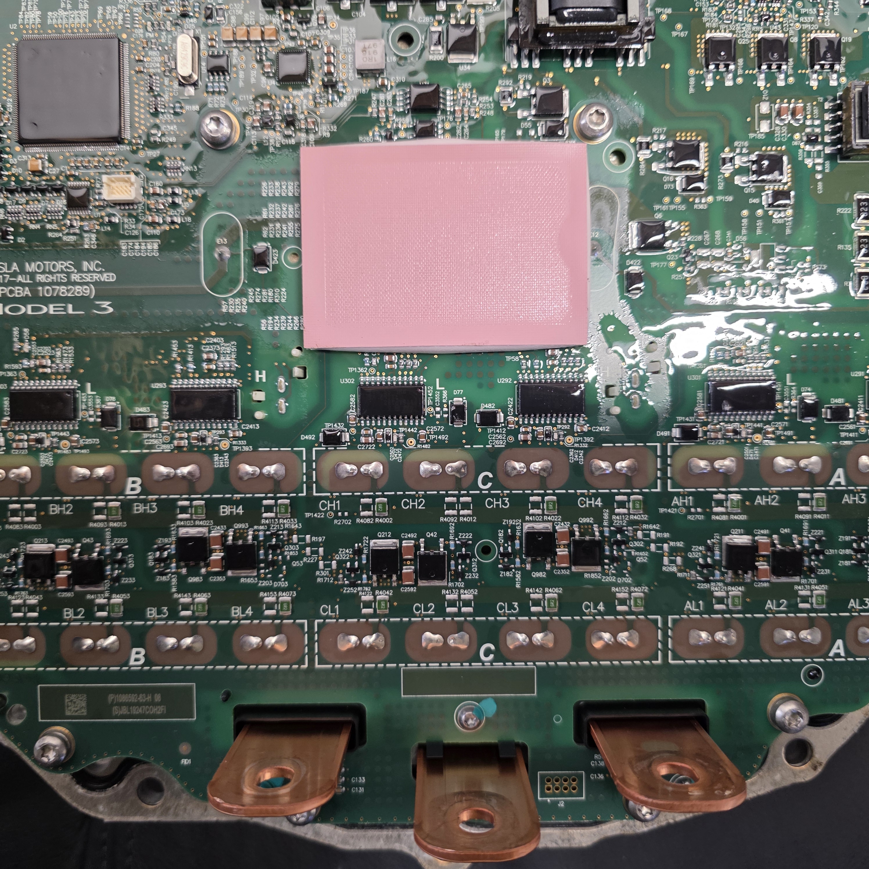

Jack Bauer wrote: Sun Mar 01, 2026 8:35 pm I'd need to see a picture of the inverter pcb.
Please let me know if you need better pictures of anywhere else on the board.
Posts: 4000
Thanks. Looks like the inverter version I already have but who know what software is on it so yeah an oil pump LIN log would be great start.

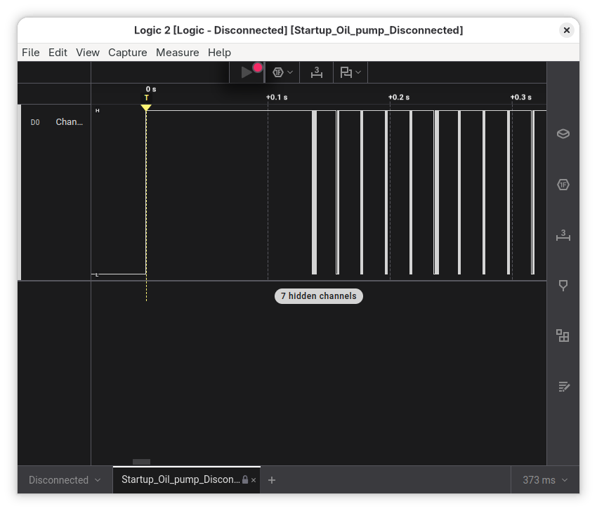

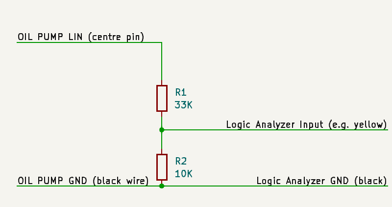

To get a LIN capture we can use:
  • Grab a USB logic analyzer like: https://www.amazon.com/DKARDU-Analyzer- ... B09BPV5QNQ
  • Download the Saleae Logic 2 software from https://www.saleae.com/downloads
  • Connect up the inverter permanent and switched 12V to a PSU and verify the activity LED flashes
  • Back probe the oil pump with some long pins (proper back probes are nice but long dress pins will do). Hook up to the Black GND and Yellow LIN signals. Winding hookup wire around the pins is fine, alligator clips are better.
  • Make a potential divider with a 33k and 10k resistors. Connect the logic analyzer GND to the inverter GND and one of the channels across the 10k resistor. The 33k should go to the yellow central pin of the oil pump.
  • Start a capture using Logic 2
  • Power on the inverter
A newer SPI gate driver initialisation capture would be useful too. This needs some soldering to the inverter PCB. To do this you'll need to hook up SDI (pin 3), /CS (pin 4) and CK (pin 5) from U303 and SDO (pin 2) from U291. Pin 1 of either chip is GND. To capture configure Logic 2 to trigger on /CS going low and then capture 30 seconds of data then power on.
If anything isn't clear or you need more detail let me know.

The wiring should look something like this:
The potential divider reduces the 12V LIN signal to something that won't blow up the logic analyzer.
To test it's working you don't need to hook up to the oil pump. You should see something like this:
Once you get that going you can try hooking up to the oil pump in the main motor. To do this you'll need a good solid 12V PSU or battery as the pump is quite happy to draw 10A!

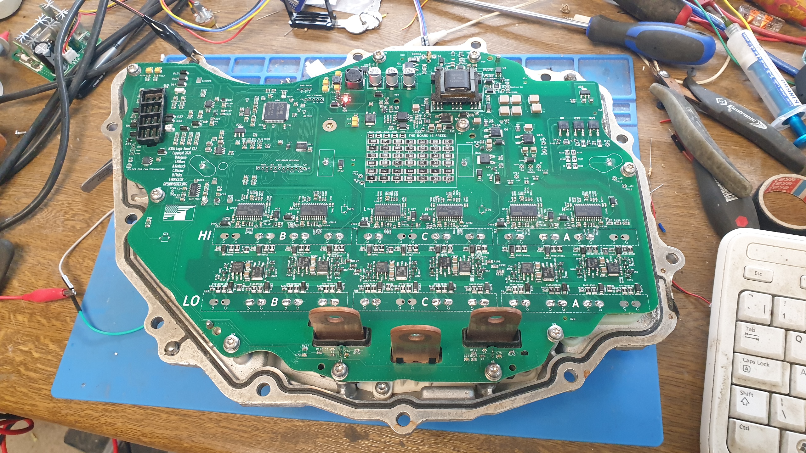

Posts: 4000
V3.2 board installed in a front drive unit inverter. So far all works so seems the problem was on the oem board and not the actual igbts.

Posts: 4000
No rush Dave. Just fitted the board to make a video and be ready.
