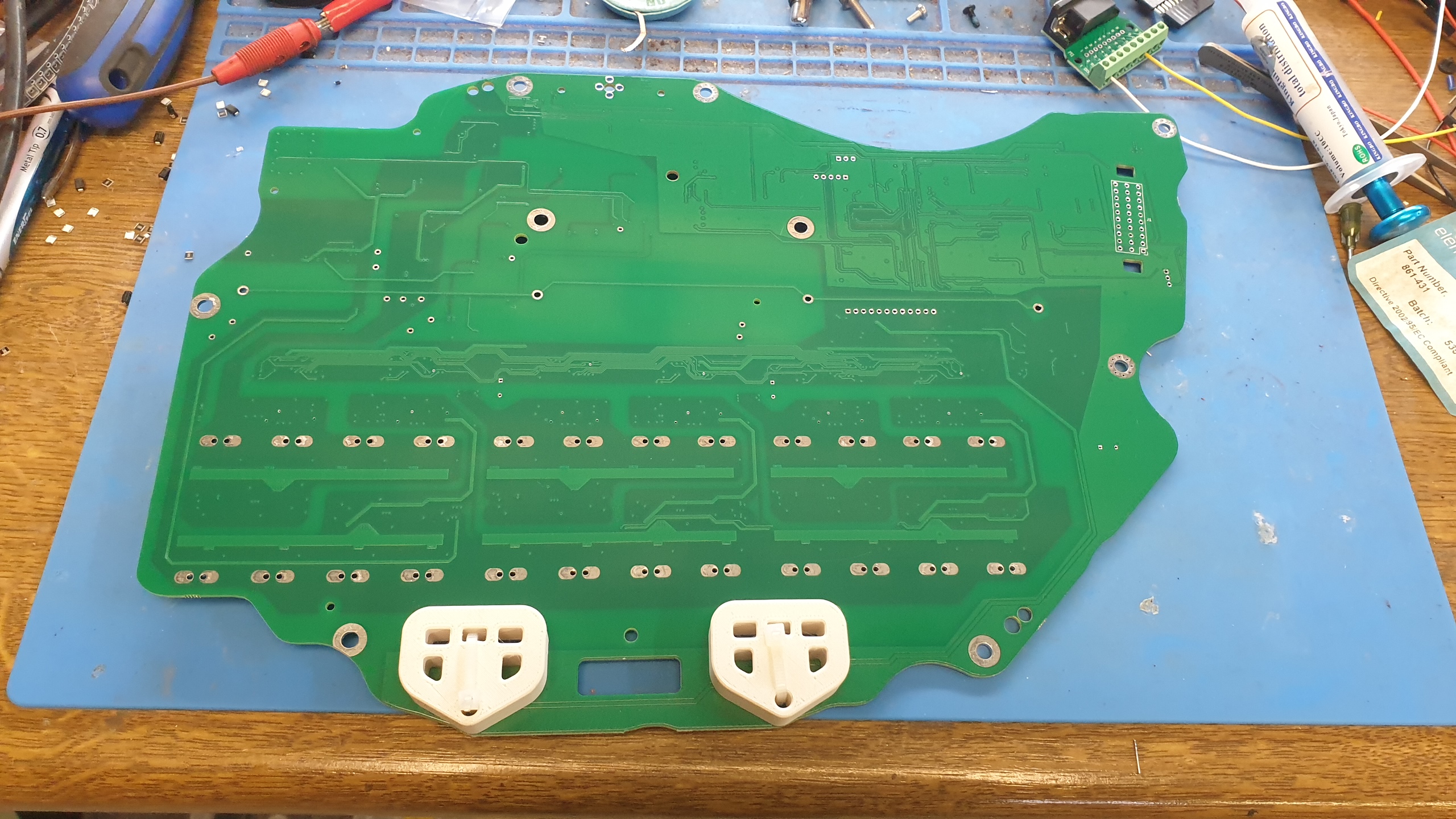

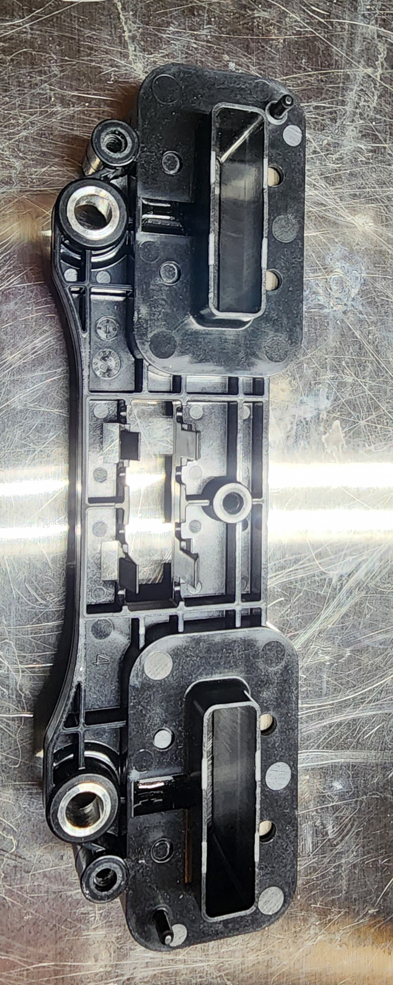

Any luck with the 3d printed current sensor cover?

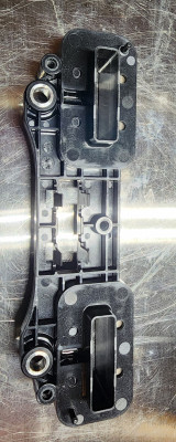

Does the OEM inverter have one I can copy? I can do a photomery a copy and convert it to an STL no problem I just need a starting point?...

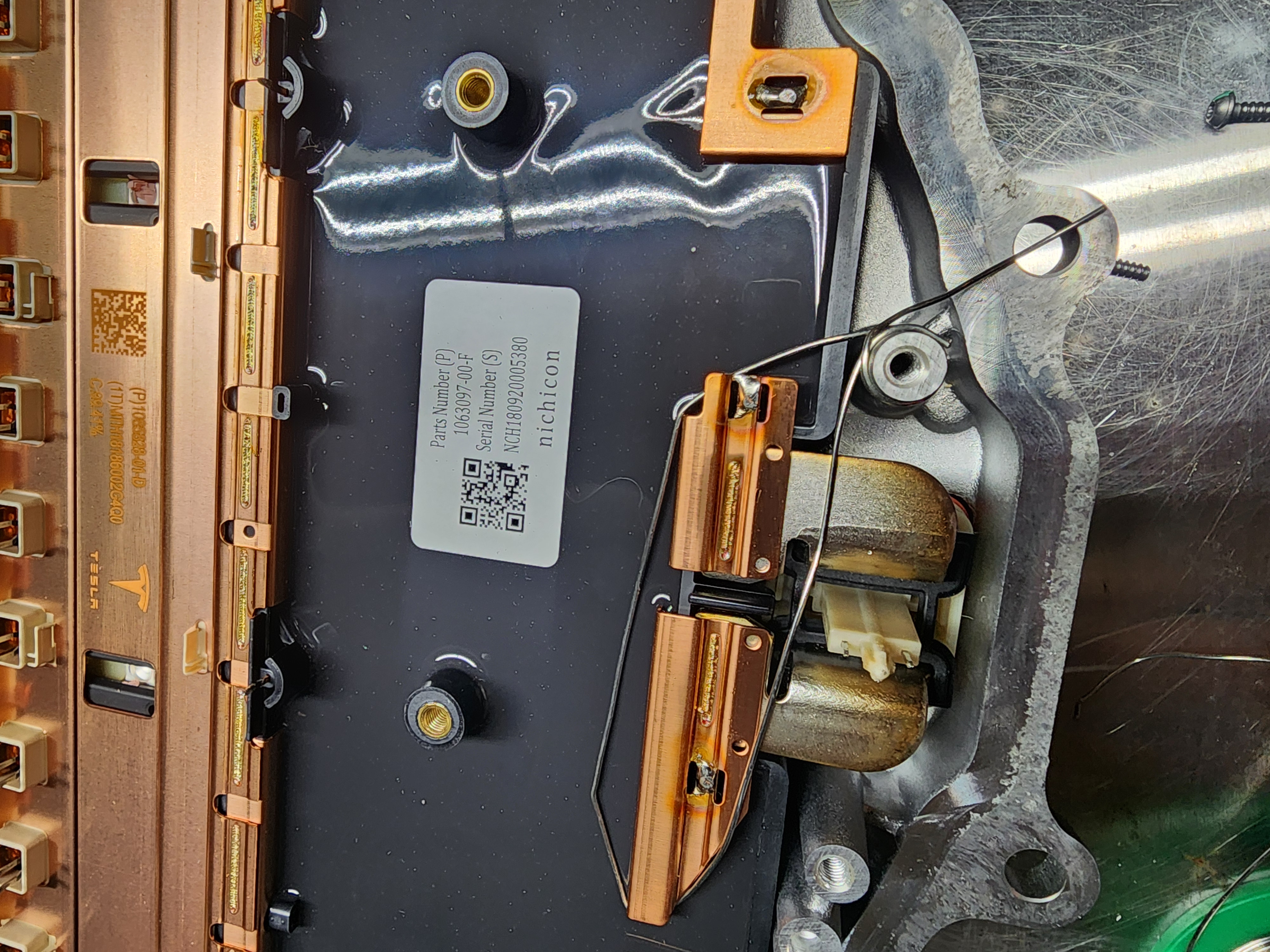

I haven't made progress yet. 3D scanning spray arrived but I didn't realize the desoldering efforts required here to get it apart. 2 pieces here:
The shipping cover I drew up is a bit deeper than the current sensor toroid housing to protect the sensor / ic during shipping. I realized you may try to use them to set the sensor heights, they would end up too deep if you did.

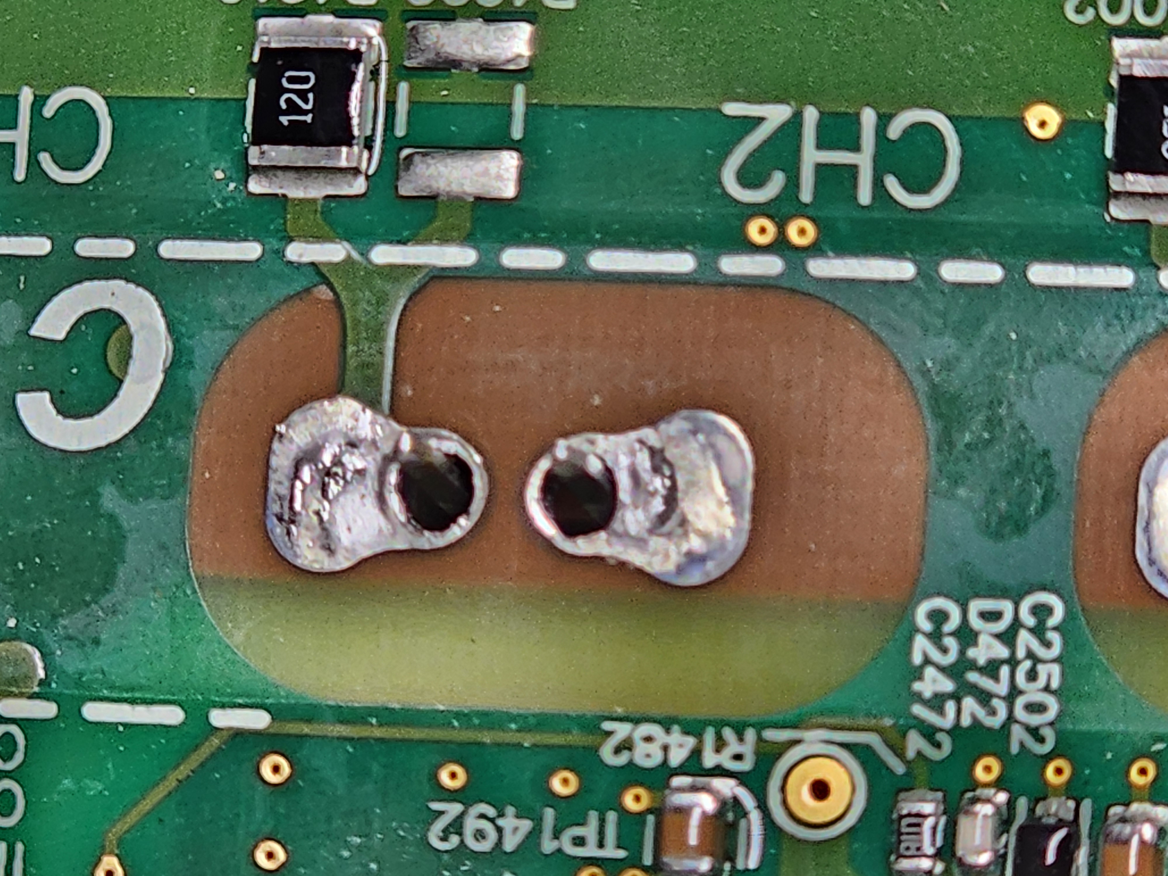

How many watts is your desoldering gun? I just found your video on desoldering the assembly. I need to get a desoldering gun first. The high power iron I thought I had is missing.

My desolder station is a el cheapo special which is why I use it with the soldering iron , flux and adding some leaded solder.

I have the same desoldering gun. I find that you need to keep it meticulously clean to ensure it generates sufficient vacuum. That done it had no problems removing my Tesla board.

Thank you both for the response. I ordered this for the desoldering part,davefiddes wrote: ↑Mon Mar 09, 2026 12:28 pm I have the same desoldering gun. I find that you need to keep it meticulously clean to ensure it generates sufficient vacuum. That done it had no problems removing my Tesla board.
YIHUA 948D III Soldering Iron Desoldering Station Kit with Upgraded Desolder Tool, 110W EVO Solder Iron
https://www.amazon.com/dp/B0CGWQRHSR?re ... asin_title
I'm aiming to have the current sensor toroid housing drawn up by next monday.

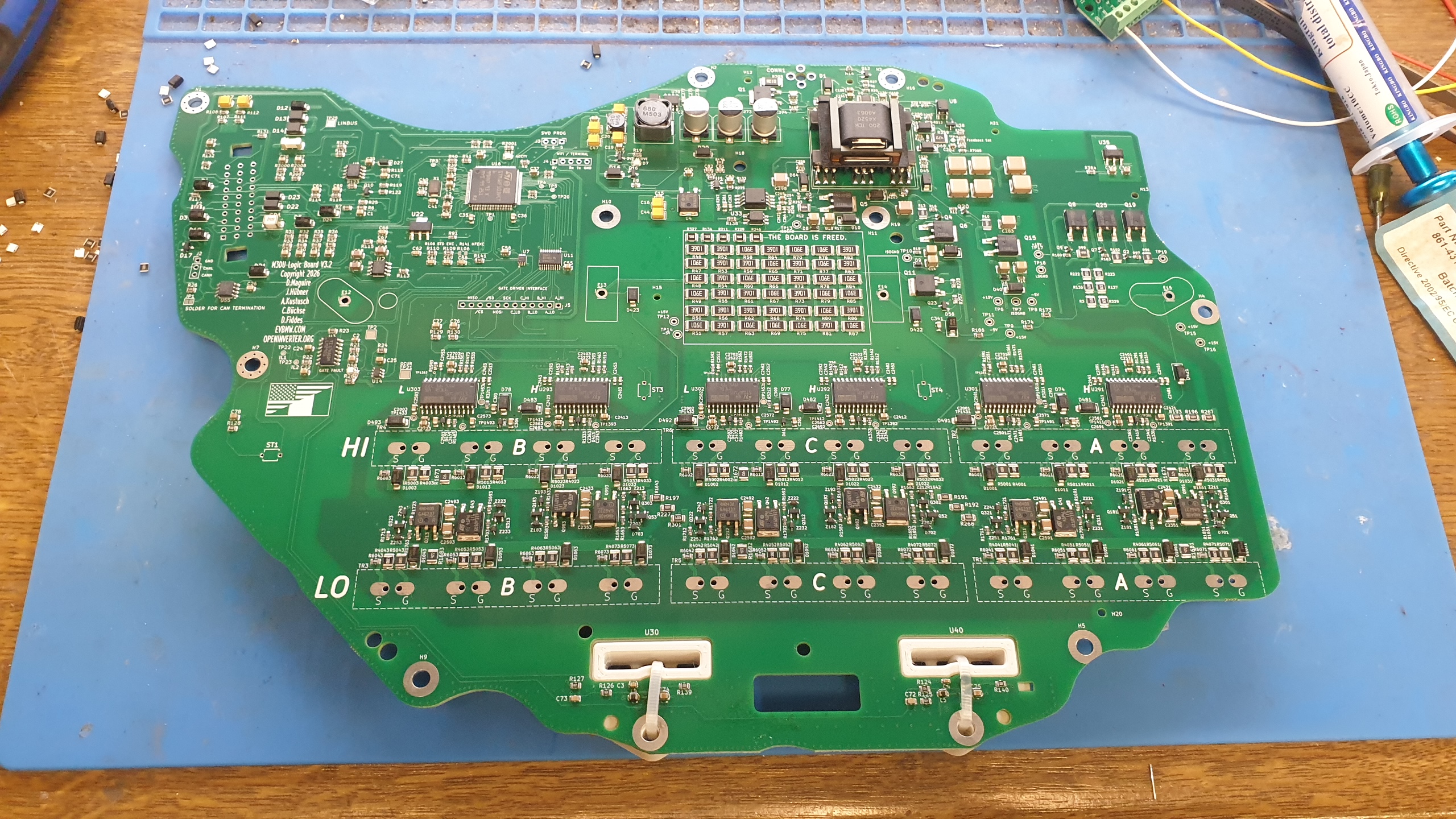

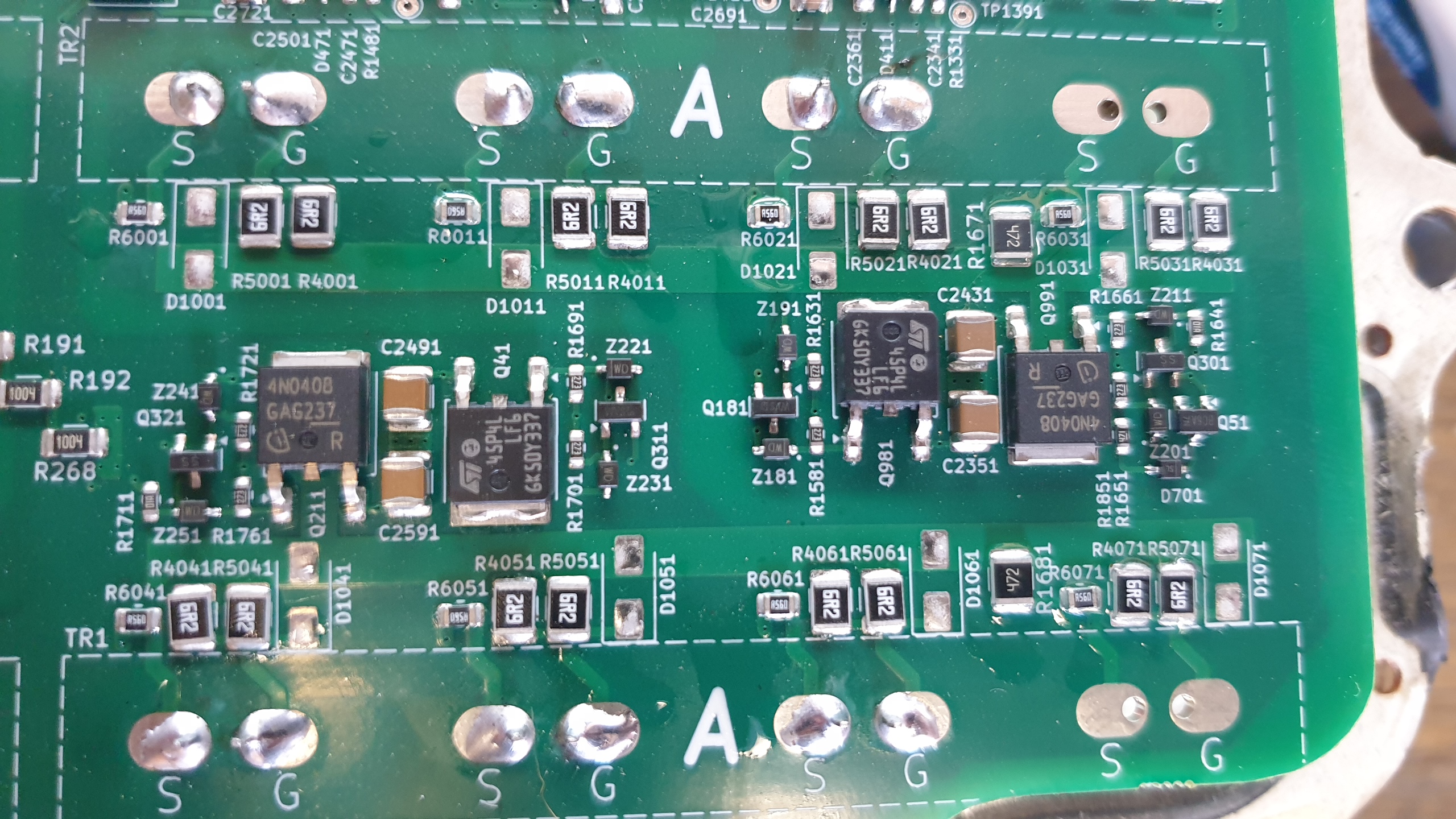

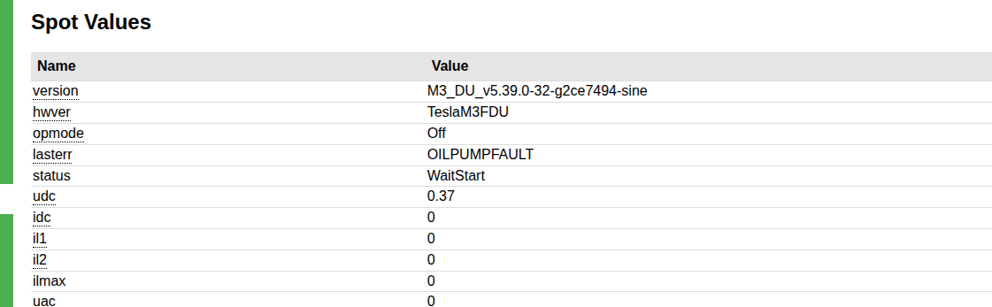

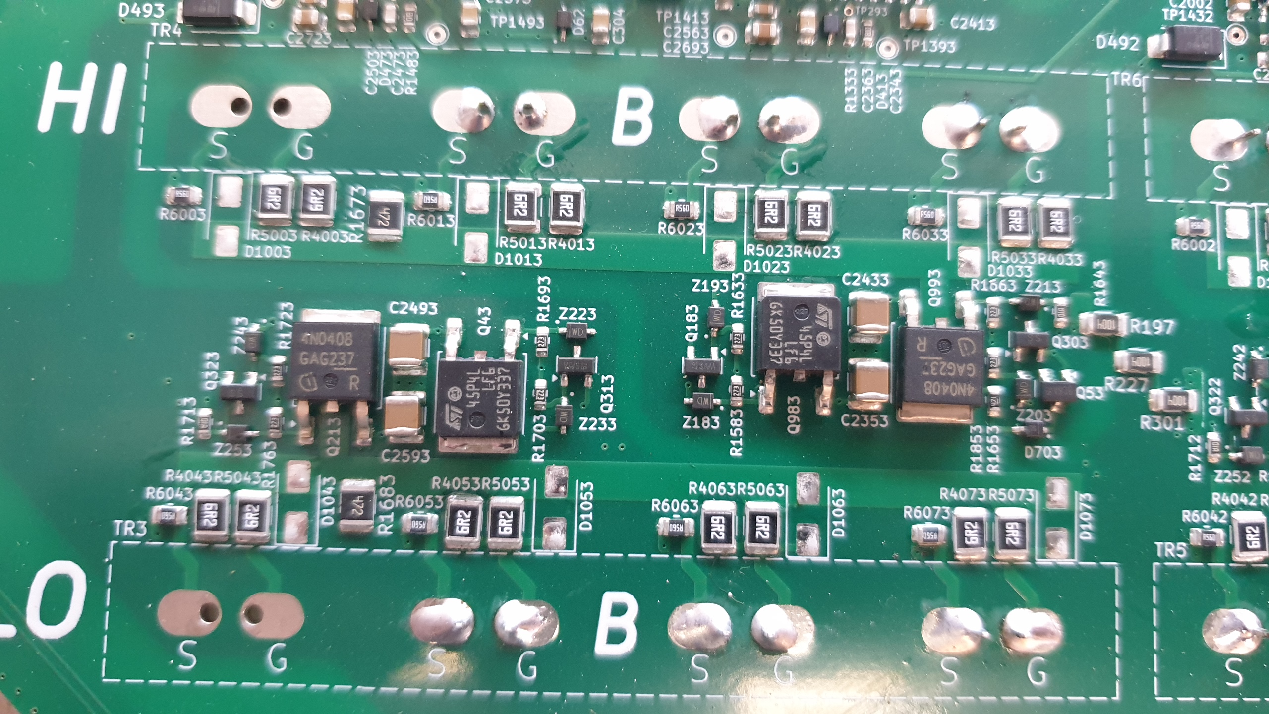

That's the FDU gate driver changes ready. With R45 on the PCB set to 3K3 it will now report hwver as TeslaM3RDU. With R45 set to 5K6 it now reports hwver as TeslaM3FDU. The gate driver initialisation for the FDU now matches that reconstructed from the FDU SPI traces. The operation of RDU boards are unchanged.
Latest binaries can be found here:
https://github.com/davefiddes/stm32-sin ... 2952255826
Thank to jrbe for highlight some potential issues with variant detection which have now been fixed.

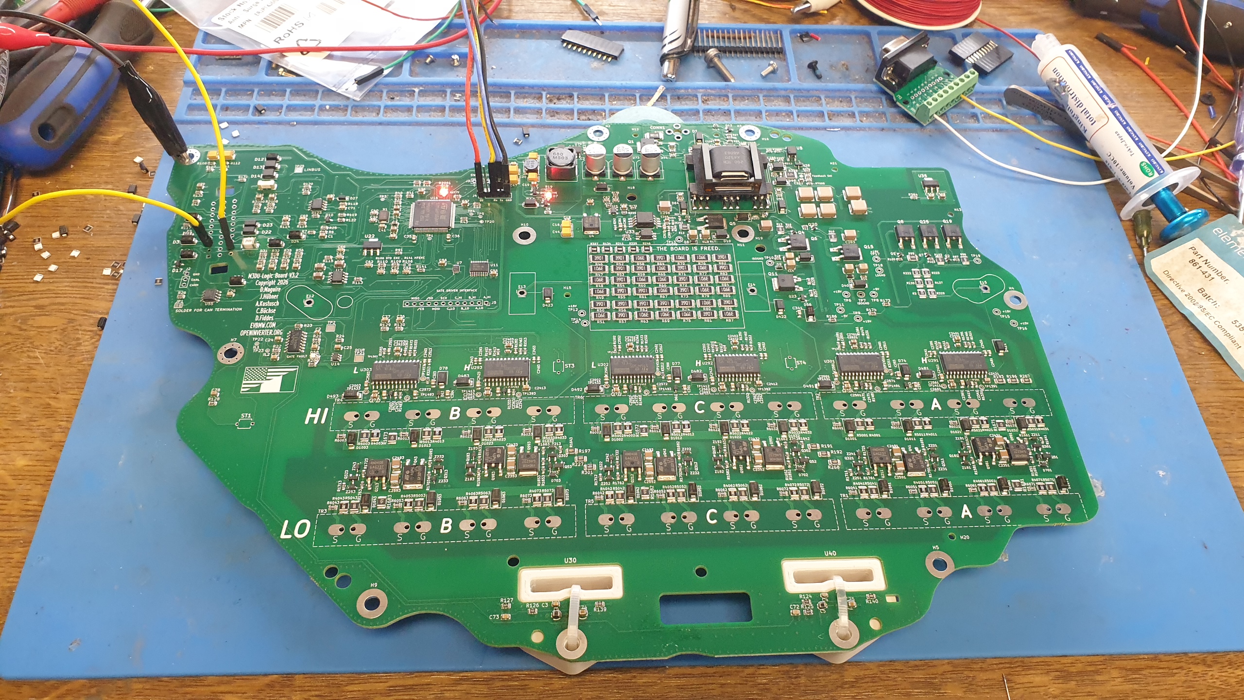

Latest firmware installed in the front inverter, Gate drive resistors and steering diodes changed, variant detect resistor changed and we are looking good. No faults.

Desoldering unit arrived but has no vacuum response. I should be able to get a replacement tomorrow at some point, but may push this out of the time I had to do this (weekend). I know there's no real rush on this, just sharing the delay.jrbe wrote: ↑Mon Mar 09, 2026 1:26 pm I ordered this for the desoldering part,

So my "old" FDU and inverter are now gone to a friend in the UK for his project. I'll be picking up the newer variant at EVBreakers next week so we can get the gate spi and oil pump lin out of it.

This desoldering iron is one of my new favorite tools. 5 seconds of moving in little circles of screechy noises then vacuum and it works better than expected.
It did plug up 4x doing this but was pretty easy to clean out.

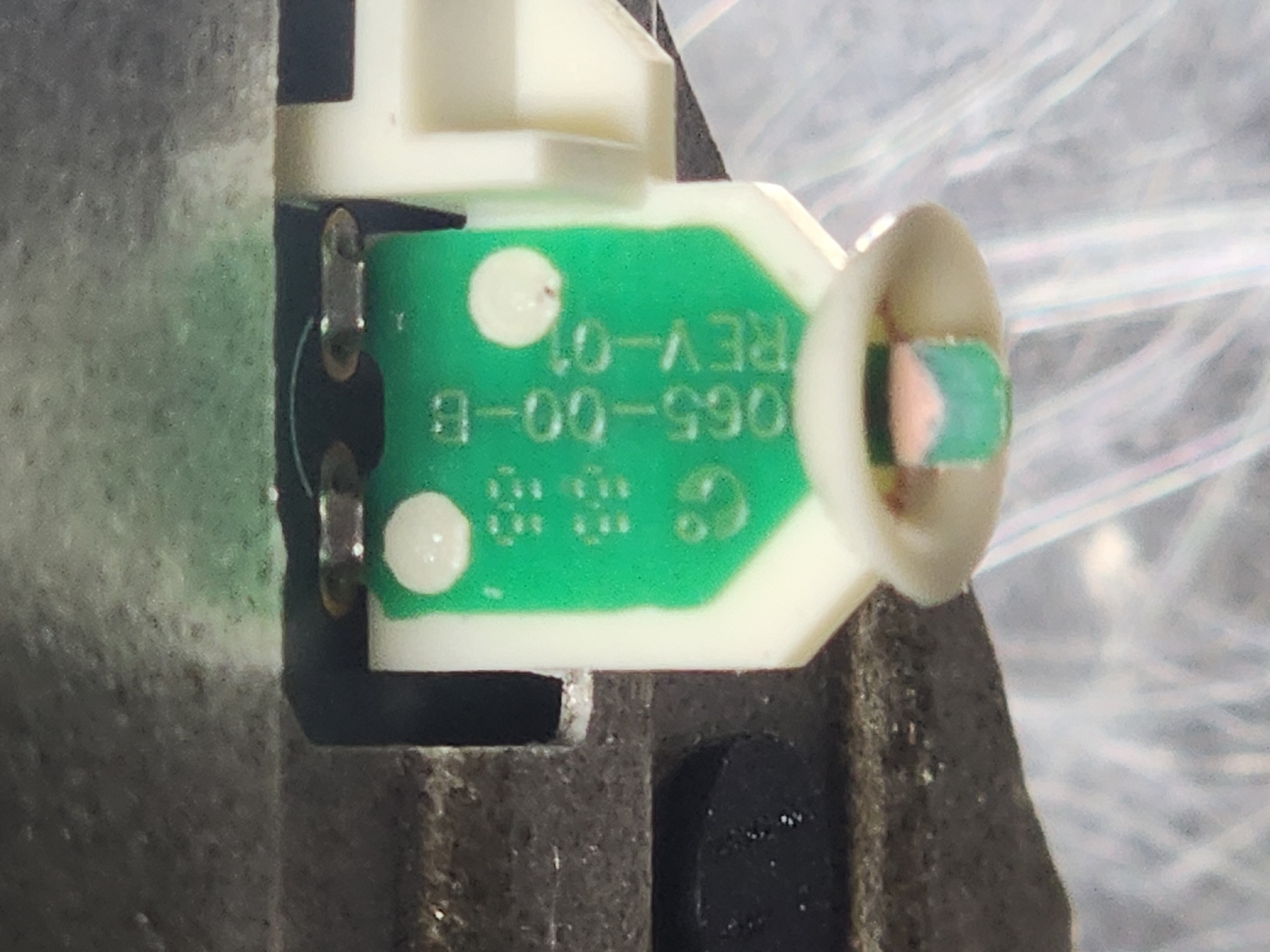

Damien, you're looking for something a bit different for the temp sensors, right? More like an led standoff? Not sure all the boards have mini PC board temp sensors but this is what's in r1ckyb0nd's 980 inverter,
I also wrapped some solder around the capacitor to keep it discharged. Probably unnecessary but id rather not take chances. I got the toroid housing off but popped the heads off the factory current sensors, they are very potted in this inverter and popped with minimal pressure, I think this will be a struggle area - to dig out vs desolder, try to align and try to reuse. I think finding the toroids is the next issue. I'll draw the housing up as is stock then do a version to work with replacement toroids. The oe housing is not trapped in place with the screws, I'll look at flipping that in the reworked version.

Great work. No need to worry about the temp sensors. Using an off the shelf ntc thermistor.

@jrbe do you have a link to the current sensor shipping block stl?
jrbe
- Posts: 766
- Has thanked: 360 times
- Been thanked: 249 times
Currently just here,Jack Bauer wrote: ↑Tue Mar 17, 2026 10:28 am @jrbe do you have a link to the current sensor shipping block stl?
https://openinverter.org/forum/viewtopi ... Zip#p90101
I'll add it to GitHub or somewhere soon.

First customer boards going out today with current sensors fitted and shipping blocks.
Only temp senors (supplied) and 30 way header (harvest from OEM board) will require to be soldered.
