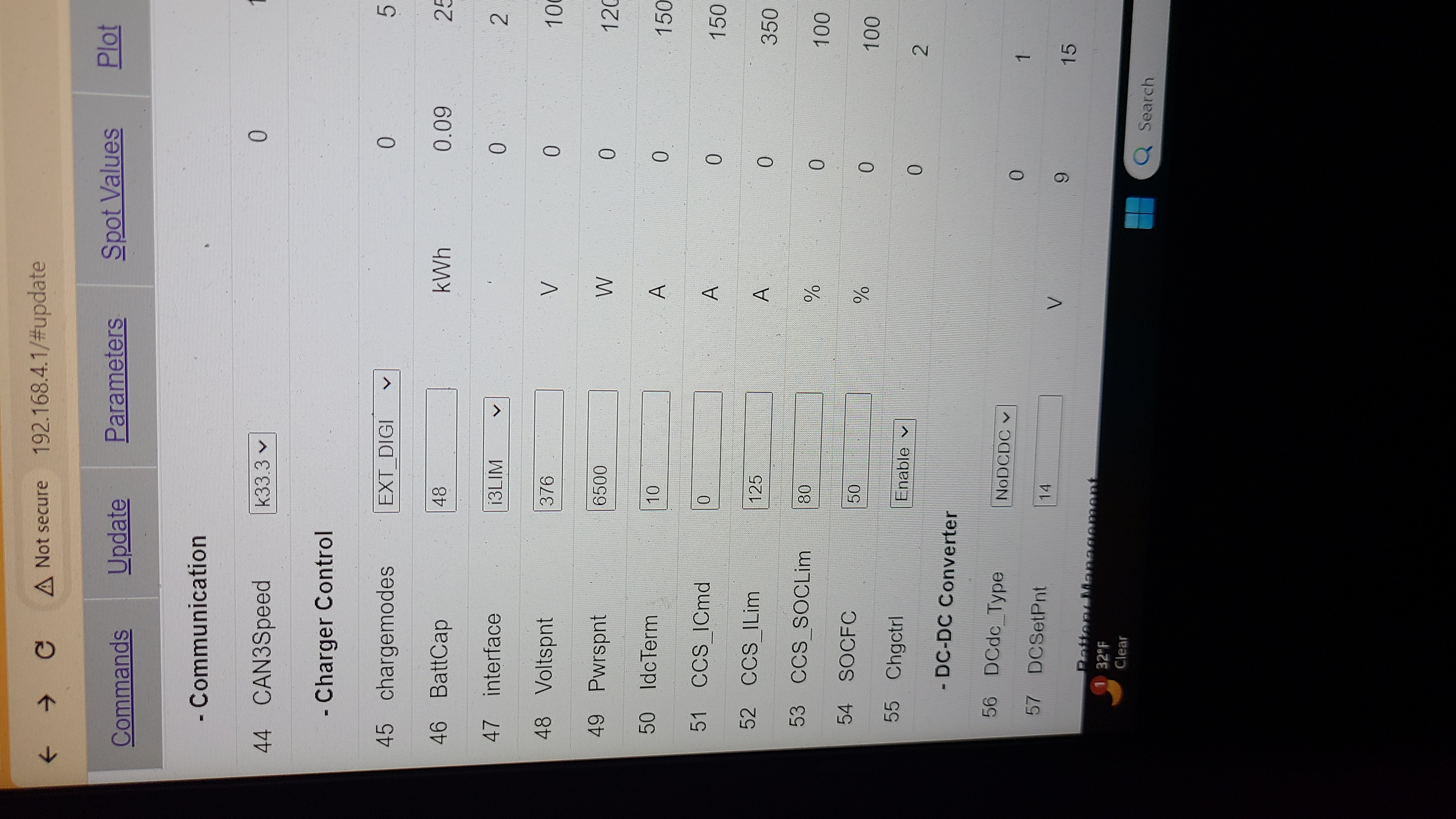

I did go and record a successful charge and we can compare to the one that failed at state 6.
But I did get the problem charger to work.
I changed charge mode to EXT_DIGI on a hunch.
Than drove across town to the problem charger and it worked.
Attached.
Failed at state 6
Successful charge
Photo of settings that worked

Replying to my own previous post.
I was wrong about the heater causing the issue.
The cause of the problem was with the settings in the web interface.
At any other charger it didn't matter if I had Interface set to i3LIM.
But at this charger it needed to be set as unused.
All the other chargers also work with interface set to unused, so I won't need to change it back and forth.
I also tested this "problem charger" with both the 2 second wait and the 1 second wait versions
It only works with the 1 second wait version.
Also only works with interface set to unused, cannot have interface set to i3LIM.
Other chargers were ok with interface set to i3LIM.
As a bonus, having the interface set to unused, makes clearing a weld fault as simple as closing the charger port door.

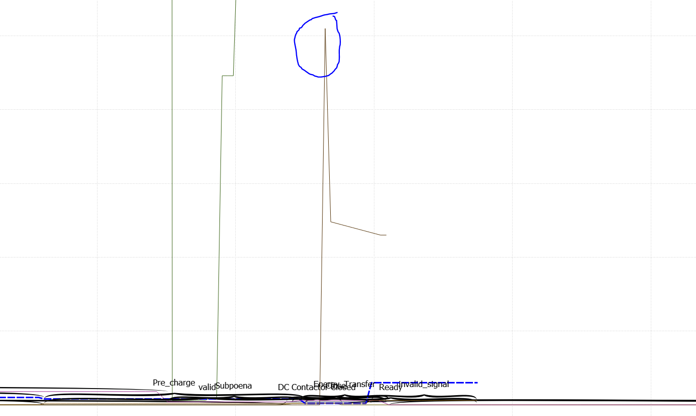

The saga continues.
The problem i thought I had solved, isn't completely solved.
All the chargers in my area worked, accept one. It appeared like the charger was waiting to long for the both voltages to be within 20 volts of each other. With a revised file Version 2.03a it solved the problem. The wait time was changed from 2 seconds to 1 second.
It worked. That charger now works perfectly.
Until today, someone was on the one side of that charger, so I used the other side. It's actually 2 separate chargers.
Guess what? The other charger is behaving the same way. (even though I am running the 1 second delay file, it acts like even 1 second wait is too long)
Btw at the moment the charger goes into fail,I hear the contactors clicking, and the logs say "failed to complete contactor test.
It's at this point I need to close the charge port door, and I'll here the contactors clicking and the weld test fault clears.
I wonder if I now need to try revising the 1 second wait to .5 second wait and try that?
I attached log file here.
54061 failed t15stat on.csv
(2.32 MiB) Downloaded 913 times

The contactors actually close, the request arrives and the LIM responds the contactors are shut.
There is an issue, unsure why the log reads a current request of 255 which does not seem right.
And yes the contactor info changes to weld test cannot be carried out, this is true as we are charging thus cannot influence the voltage at charge port for checking. This may not actually be what is causing the faults.
From your testing and comments it sounds like there might be some wiring issues.

I think I understand a little better.
Before the issue was waiting too long and it never tried to close the contactors, when it had a close enough voltage match.
This was fixed by changing it to not wait as long.
This issue is different because it is actually closing the contactors soon enough but than it believes something is wrong and wants to do a weld check.
I have tested the original issue charger with and without the faster contactor close and that charger only works with the faster close setting.
I'm gonna have to go to this 2nd issue charger and see if it works with the original slower close timing setting.(the 2 second wait file)
I'll also try a few other options with the web interface.

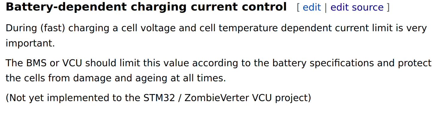

Is there a relationship between the BMS (whatever BMS is in use) and the LIM/ZV? If so, how are the existing users implementing this relationship?
The Wiki currently mentions this only in simple terms:
WIki entry for BMW i3 LIM: BMS
Al Savage

BMS communicates limits...these limits are forwarded/applied to charger.

Please expand on this.
The BMS communicates limits . . . via CAN? To the ZV -> LIM (via CAN) -> DCFC EVSE (via PLC)?
If the BMS is communicating limits to the ZV, does the ZV have preset or user-defined communication profiles for various BMSs?
Al Savage
2014 RAV4 EV
NissanDiesel
Posts: 2962
Has thanked: 328 times
Been thanked: 847 times
asavage wrote: Sun Jan 21, 2024 8:46 pm The BMS communicates limits . . . via CAN? To the ZV -> LIM (via CAN) -> DCFC EVSE (via PLC)?
Nope, the Zombie currently follows the limits from the Web Interface for the DC fastcharging. It does not change the current limit or voltage limits on its own.

Tom, that's what I was remembering, but EV_Builder seems to have a different setup, or knows someone how does.
At a minimum, I would want to restrict the charge rate at very low or very high pack temperatures, and this -- as well as other limiting factors -- is best communicated from the BMS, I would think. But I have a very simplistic view of what the BMS does and the factors that limit charge rate, and I'm hoping that others who are already using the LIM/ZV for DCFC can describe what they're doing.
