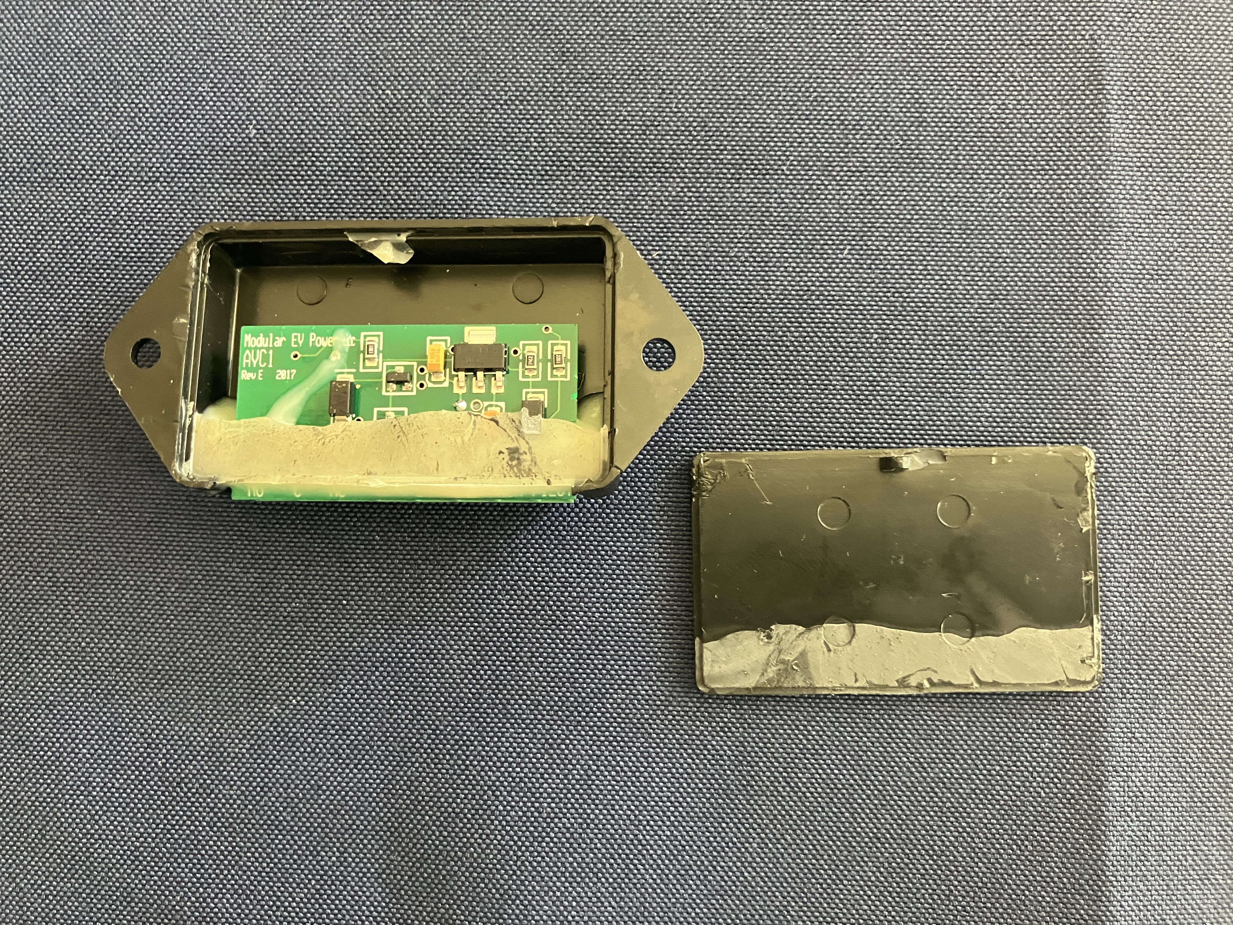

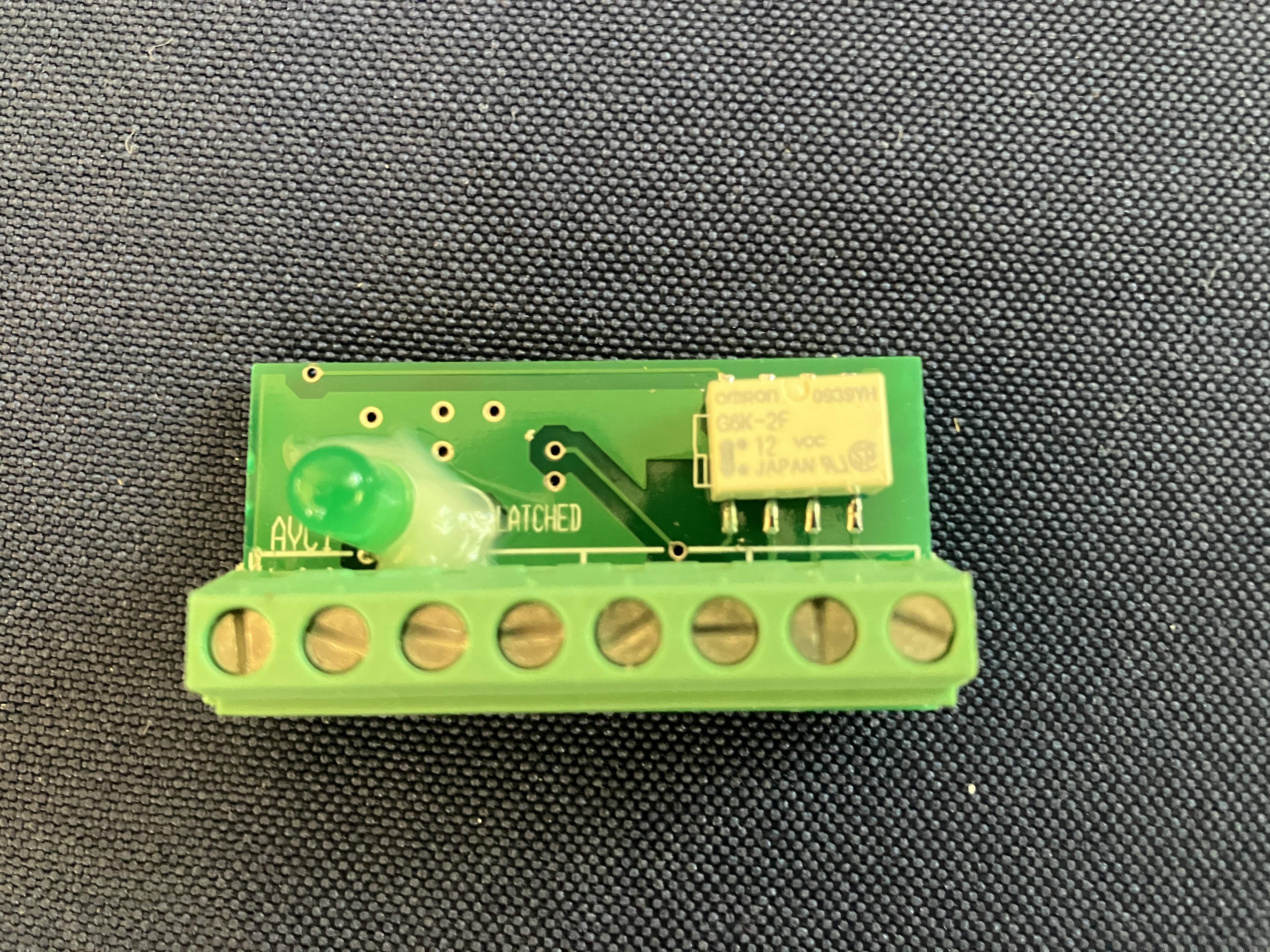

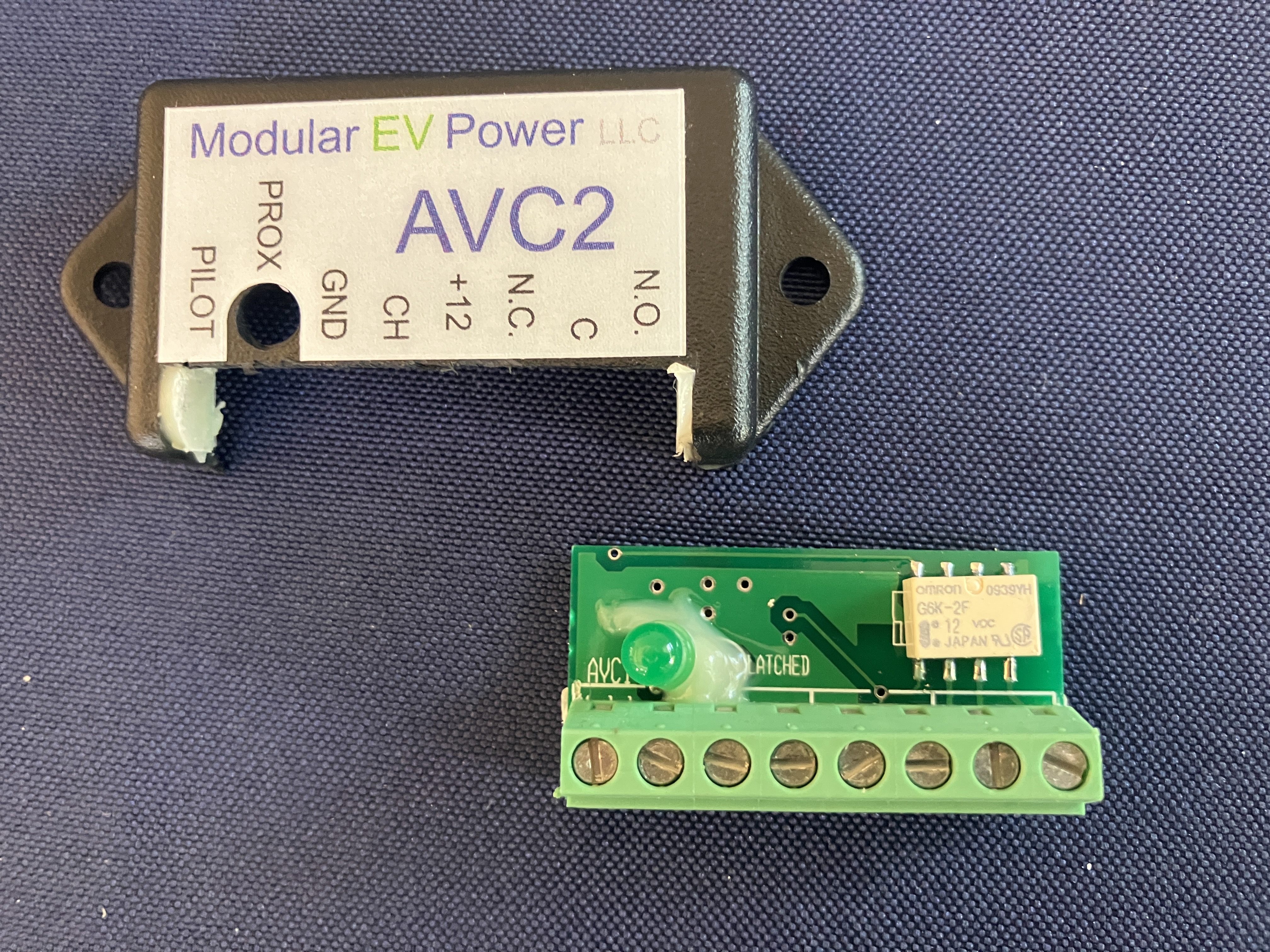

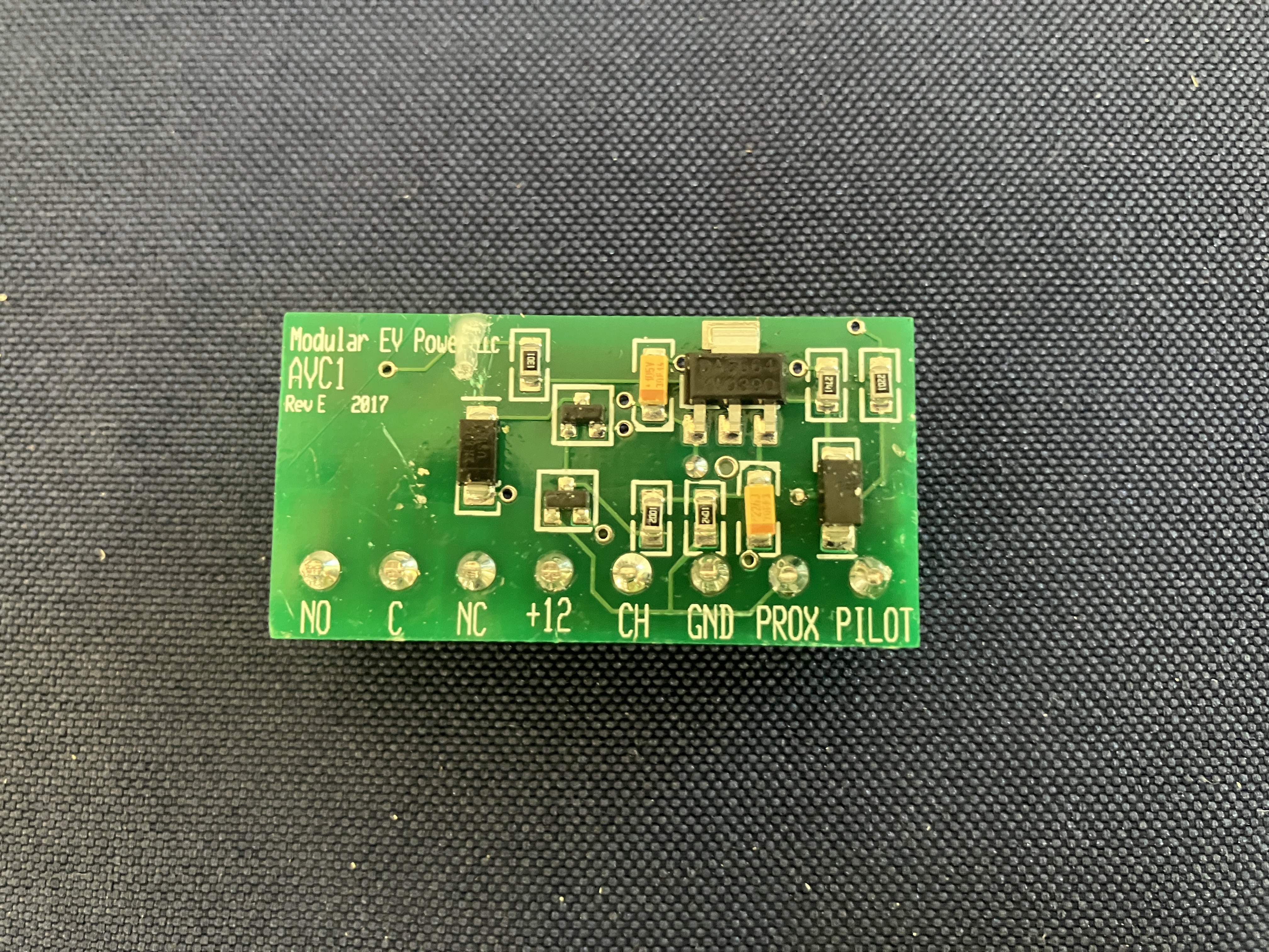

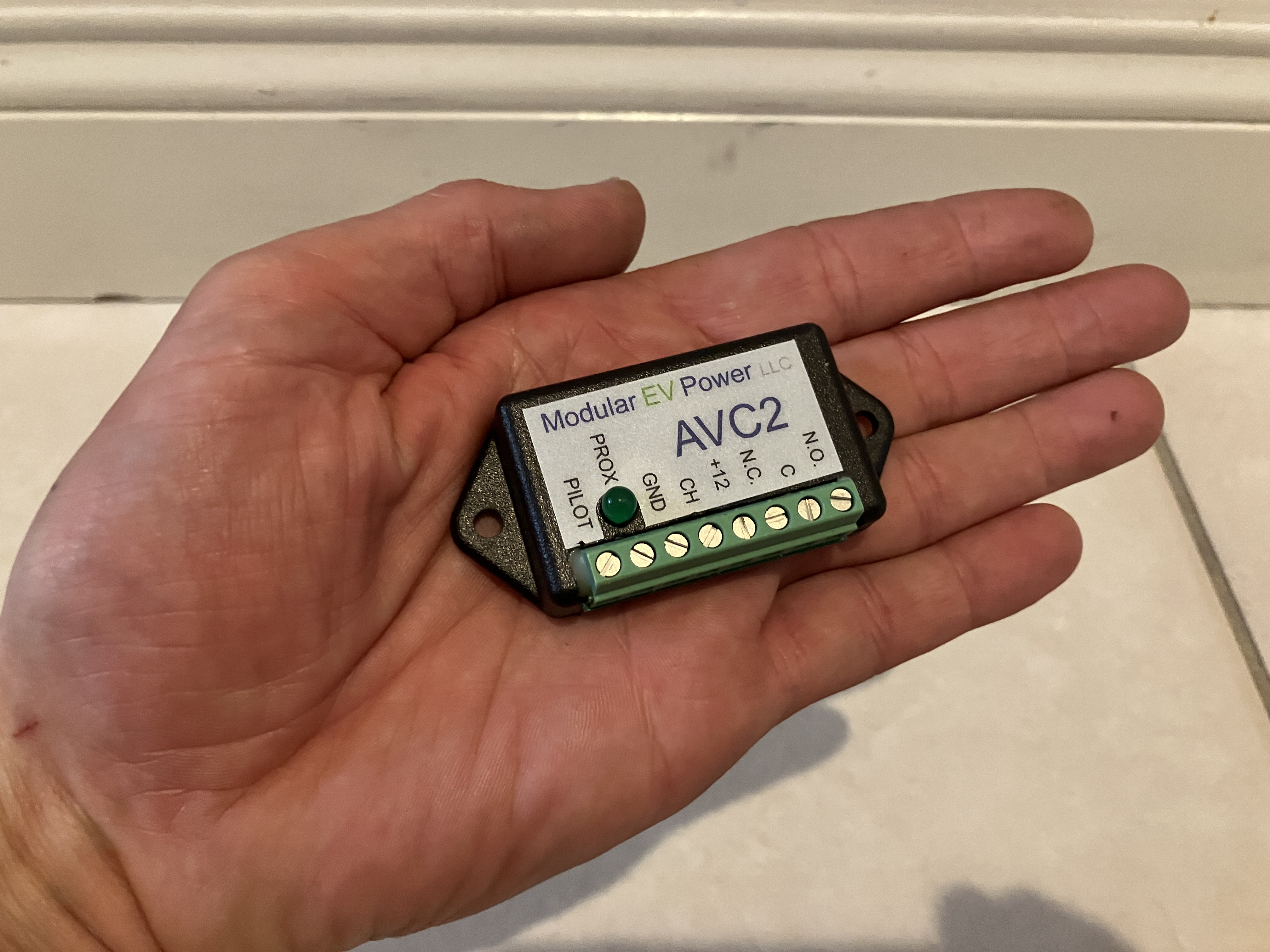

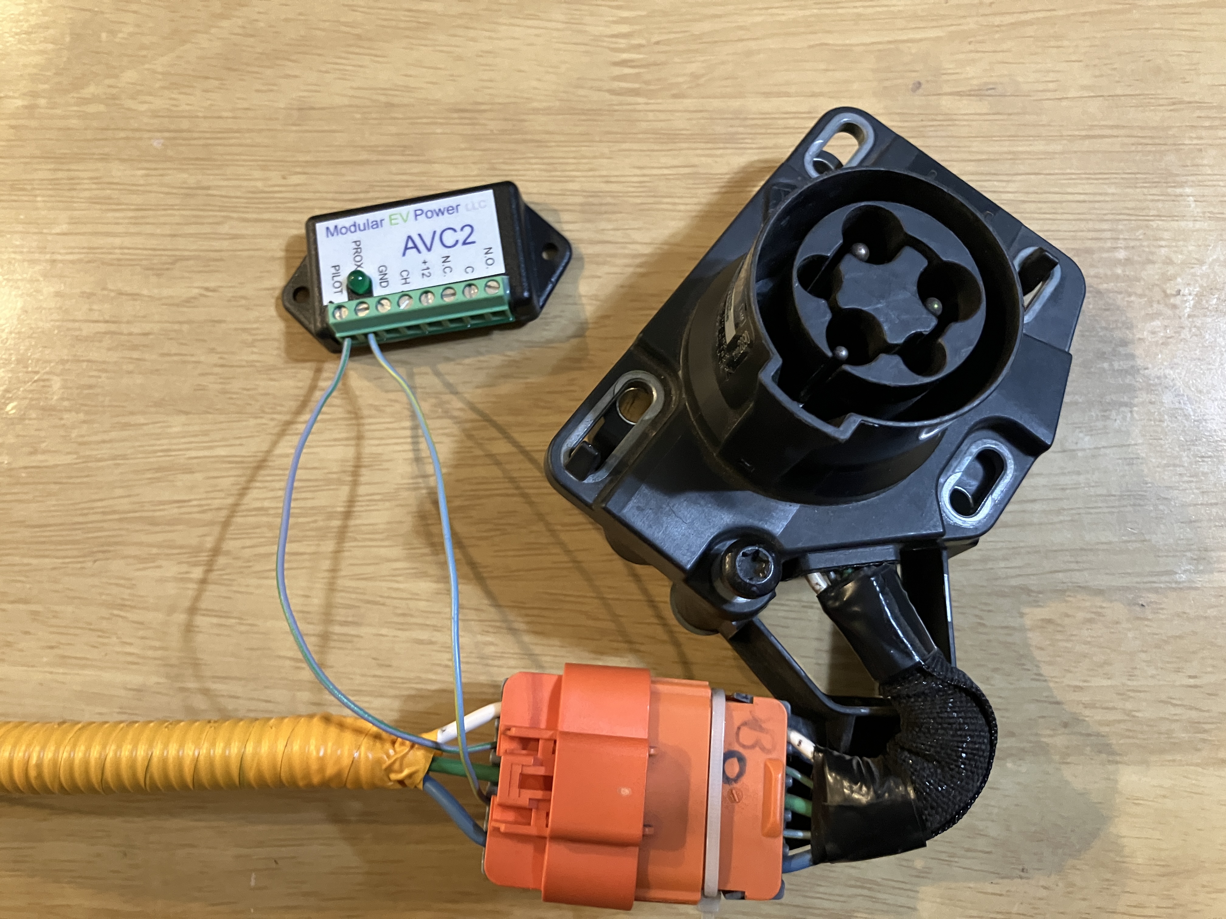

First Impressions of the: Active Vehicle Control board
This appears to be just a wimpy 5 Pin Relay with two additional pins, one for Proximity and the other for Control. The reason I say 5 Pin Relay is that they are a bit different than the 4 Pin in that they start off with something enabled/connected and when powered up disconnect that connection and can but doesn't have to enable something else so I call them Off Relays,
So I am guessing that you can have your VCU connected to the Always On Pin (for driving) and have your Charger connected to the Other Pin, that way it would prevent you from driving off with the charge cord plugged in type of thing.
But to start and for easability and simplicity I am not even going to use those pins as they are optional for safety, in other words I don't plan on using that built in little relay, I will simply test this gizmo like this:
1. First plug the J1772 plug into the vehicle
2. Turn my key counter clock wise in the ignition switch aka to the left (Accessory position)
- this turns on my 1st Gen Chevy Charger
- and now this will also turn on this EVSE control gizmo

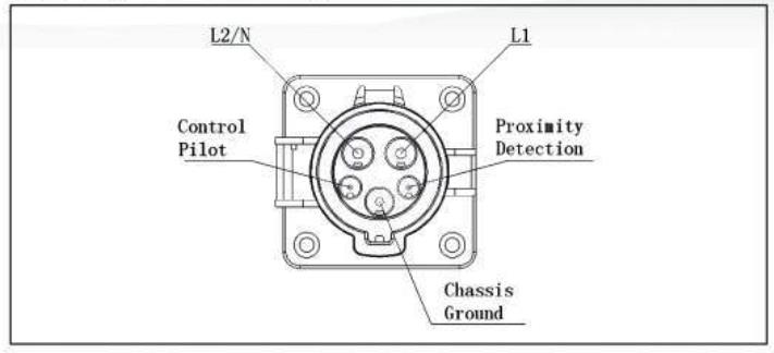

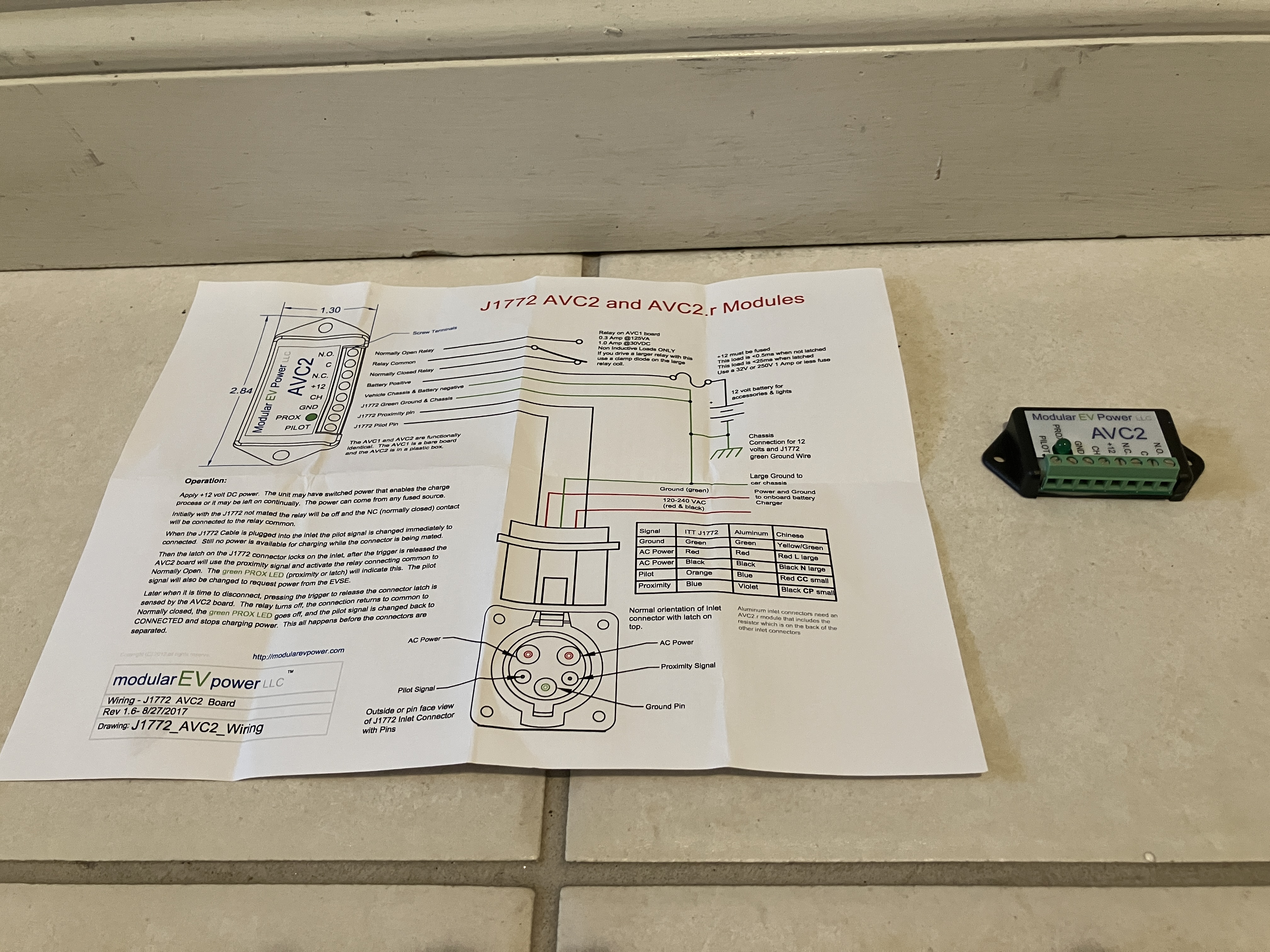

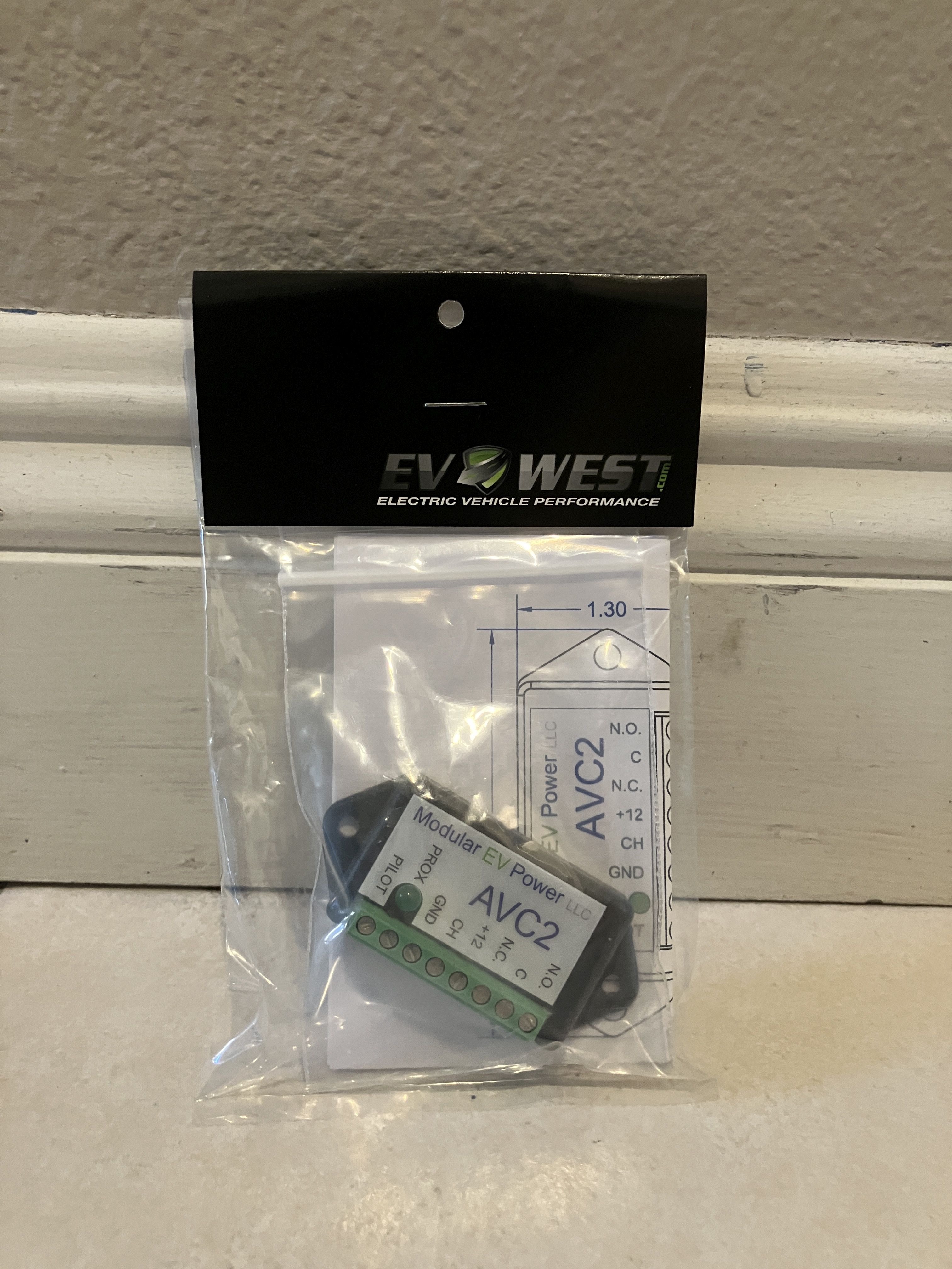

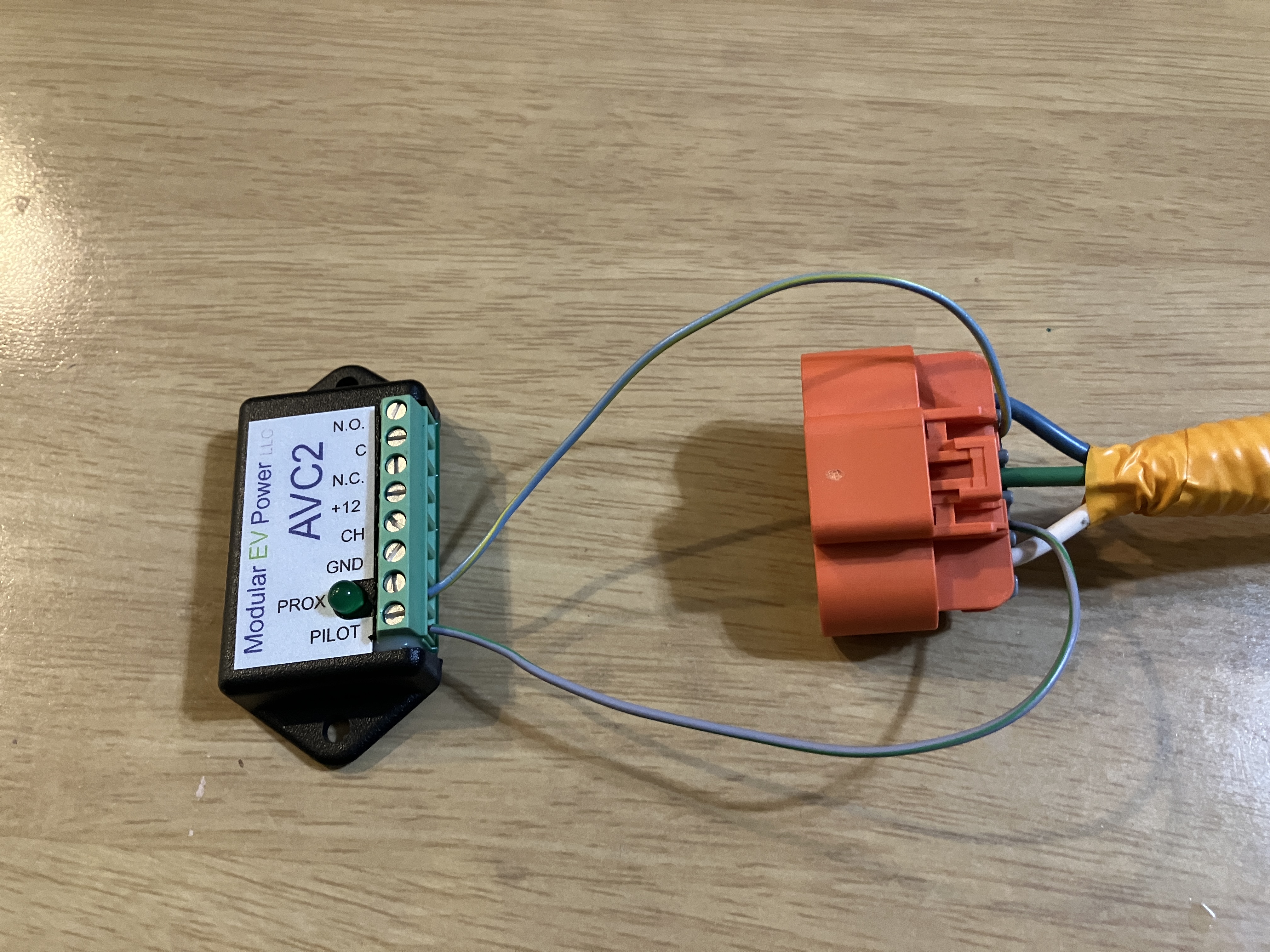

EVSE J1772 Controller Fun Facts:
so after I bought it I learned they make two different kinds of this gizmo:
We are supposed to "Measure the resistance from the PROX pin to the GND pin on the inlet connector before it is connected. If it measures 2740 ohms you have the resistor already and you need an AVC2. It it measure Open Circuit then you need an AVC2.r that includes the resistor."
- AVC2
- AVC2.r
- Posts: 605
- Has thanked: 225 times
- Been thanked: 178 times
If only they included a resistor enable switch, would have simplified things a lot.

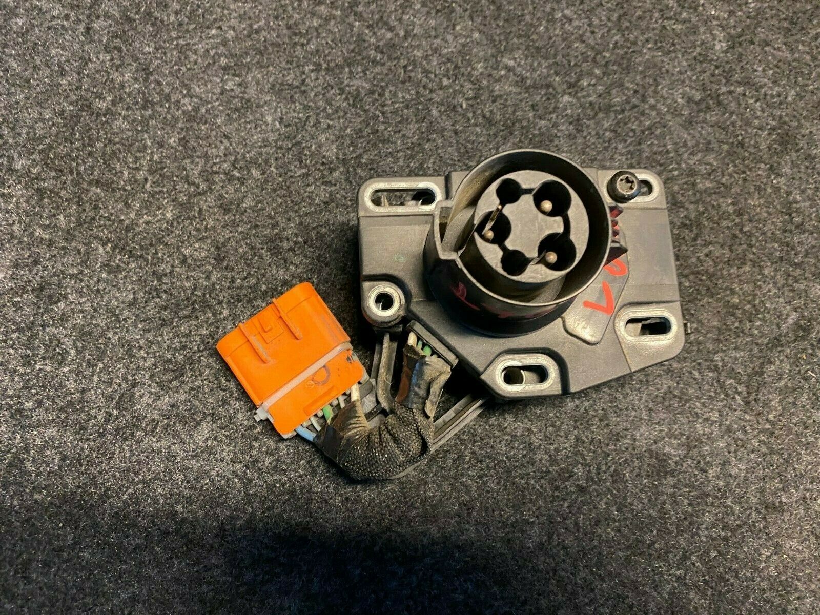

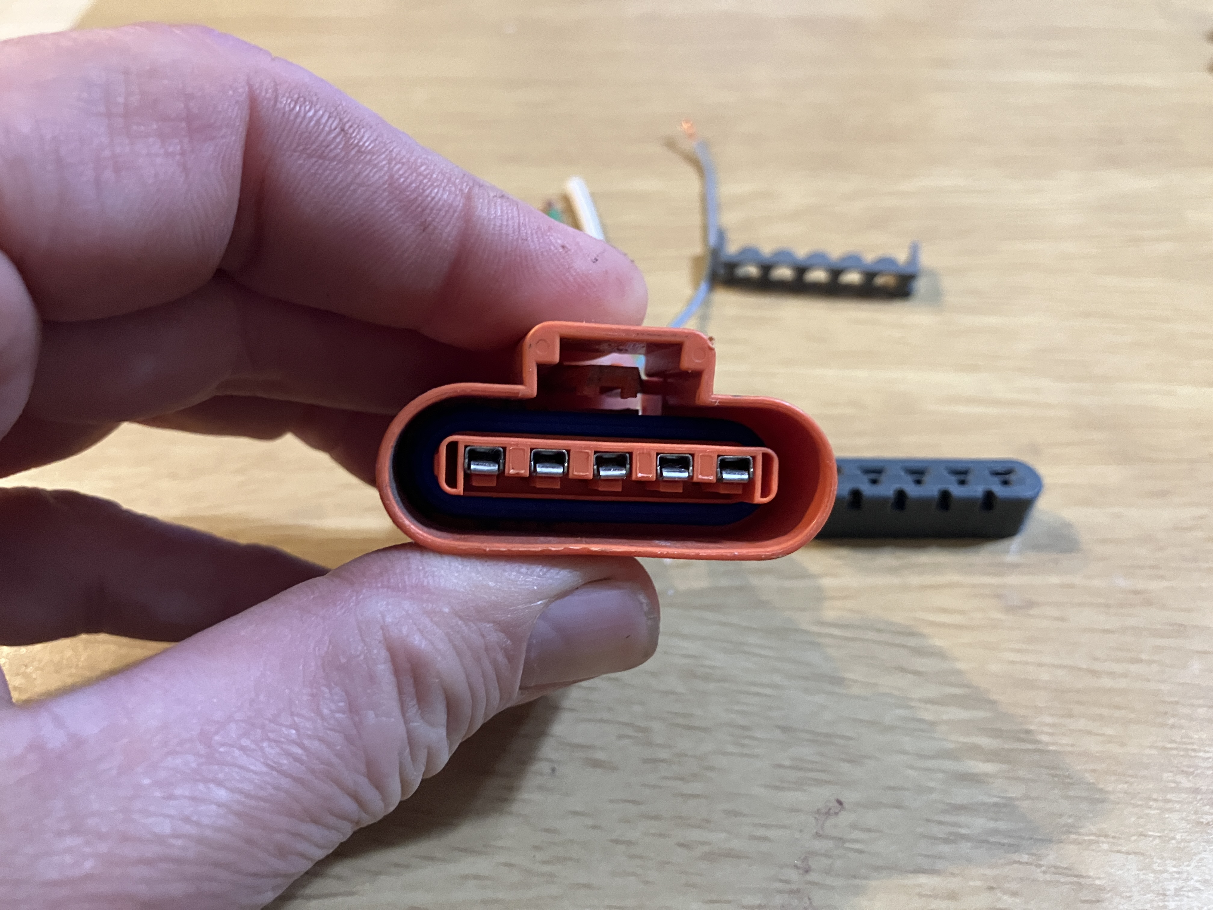

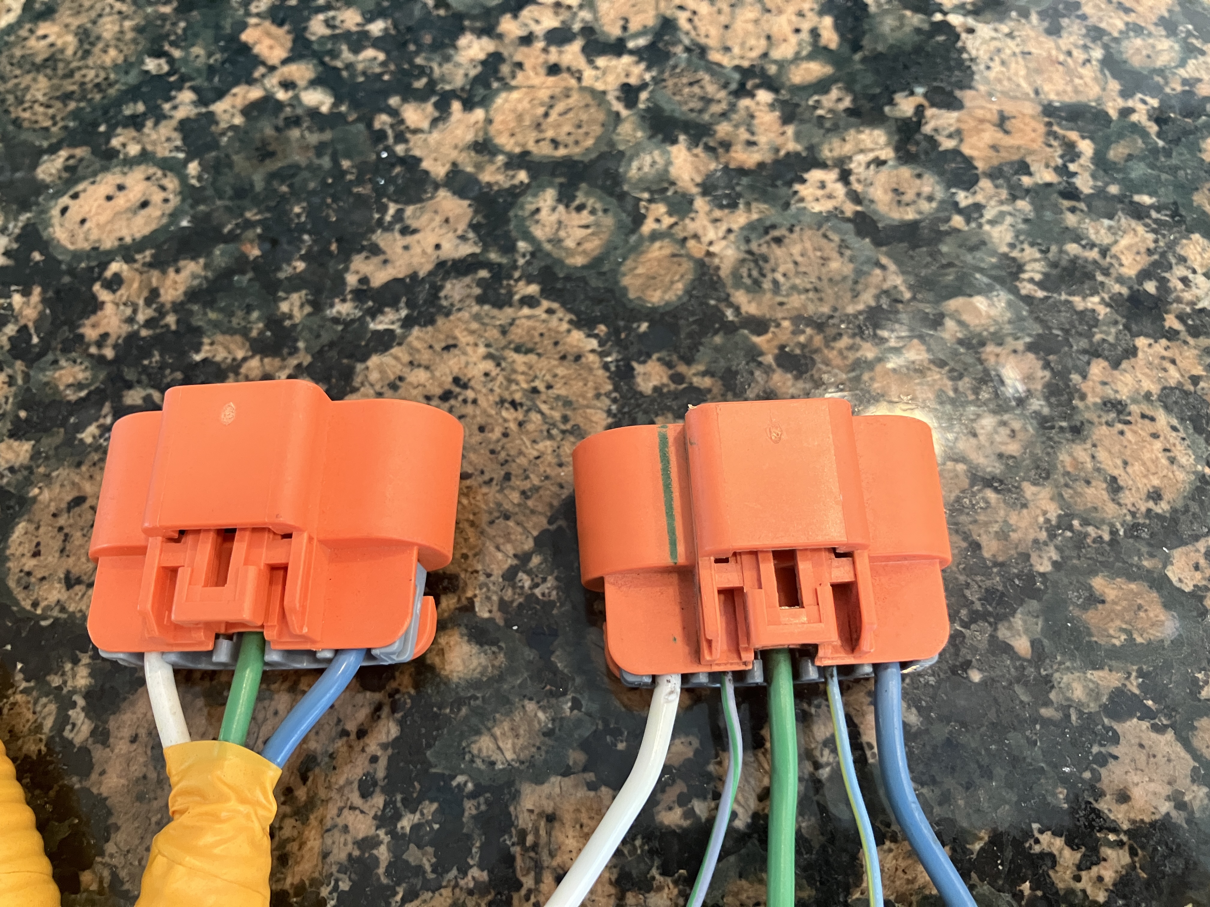

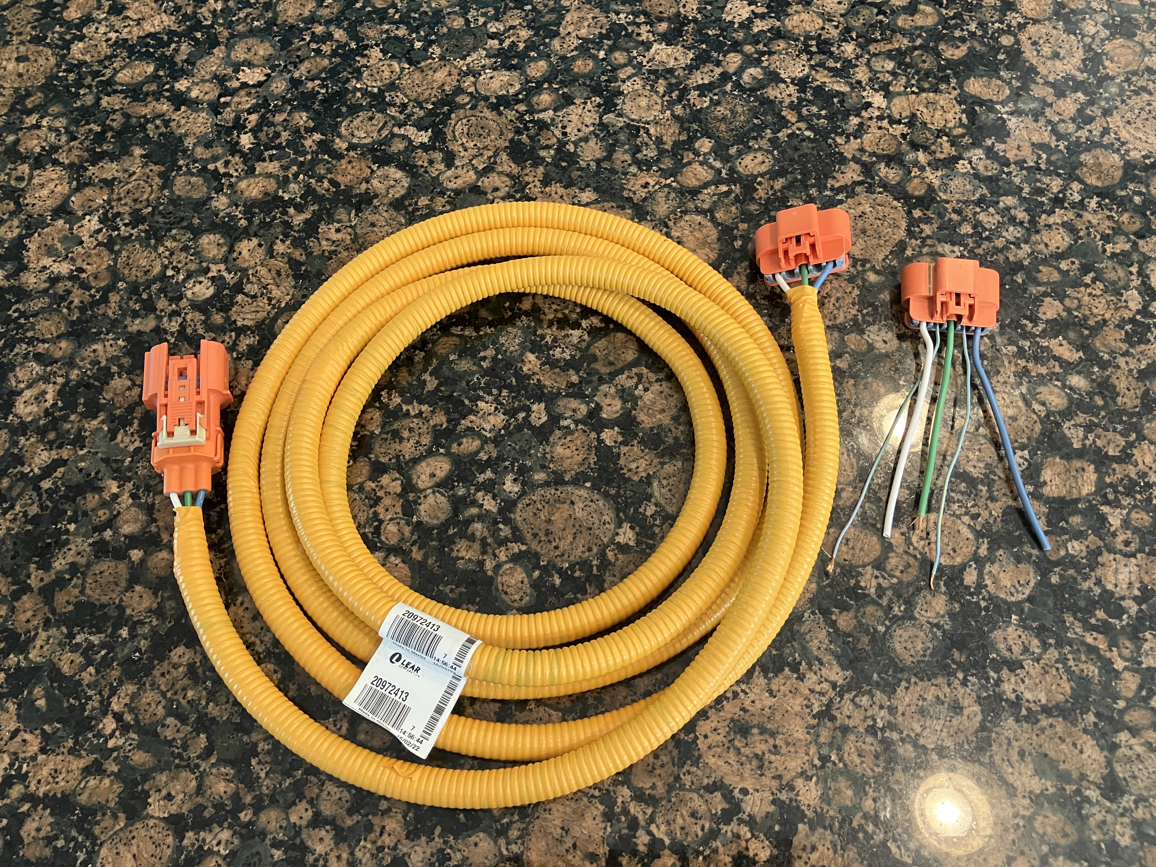

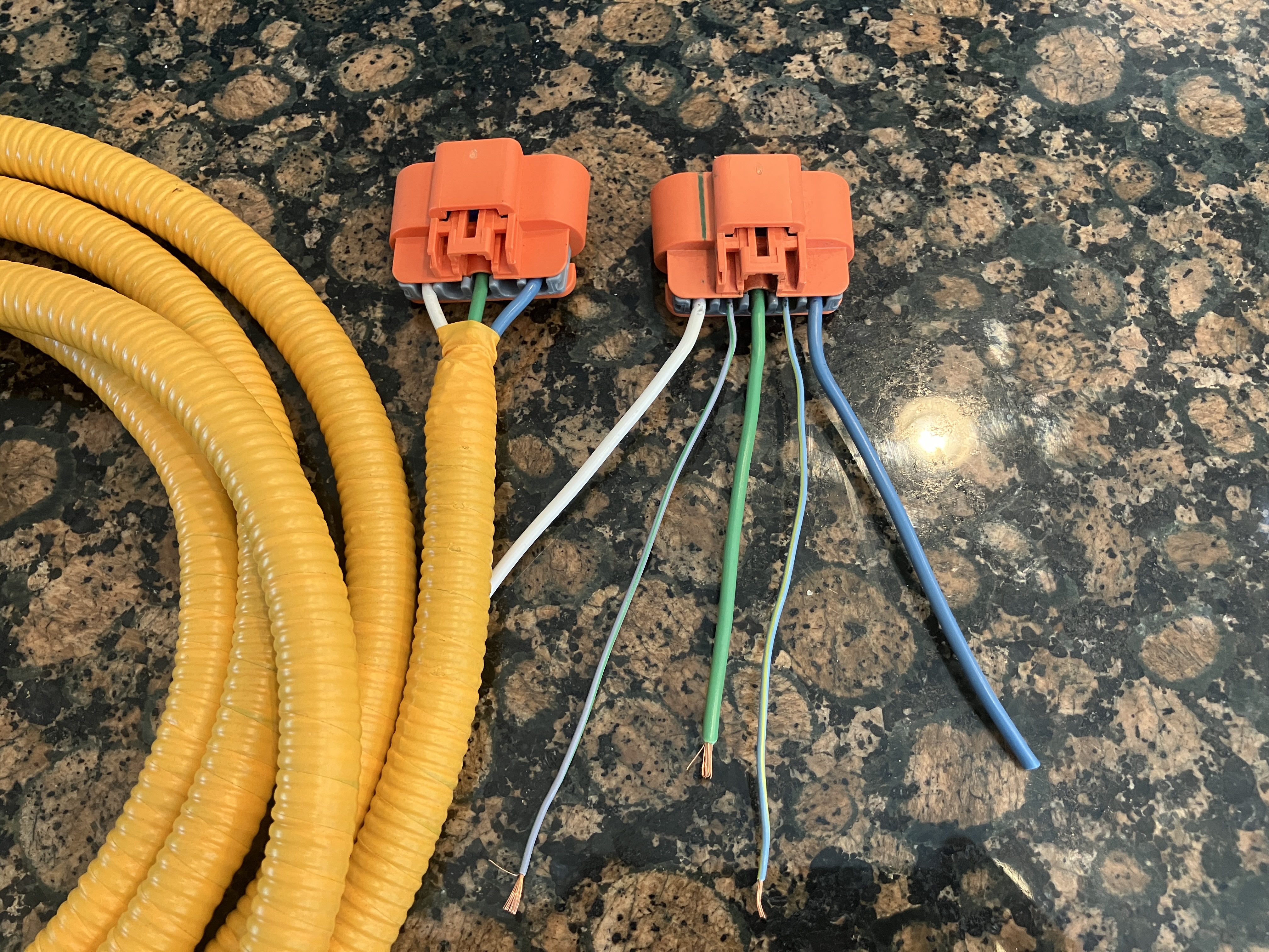

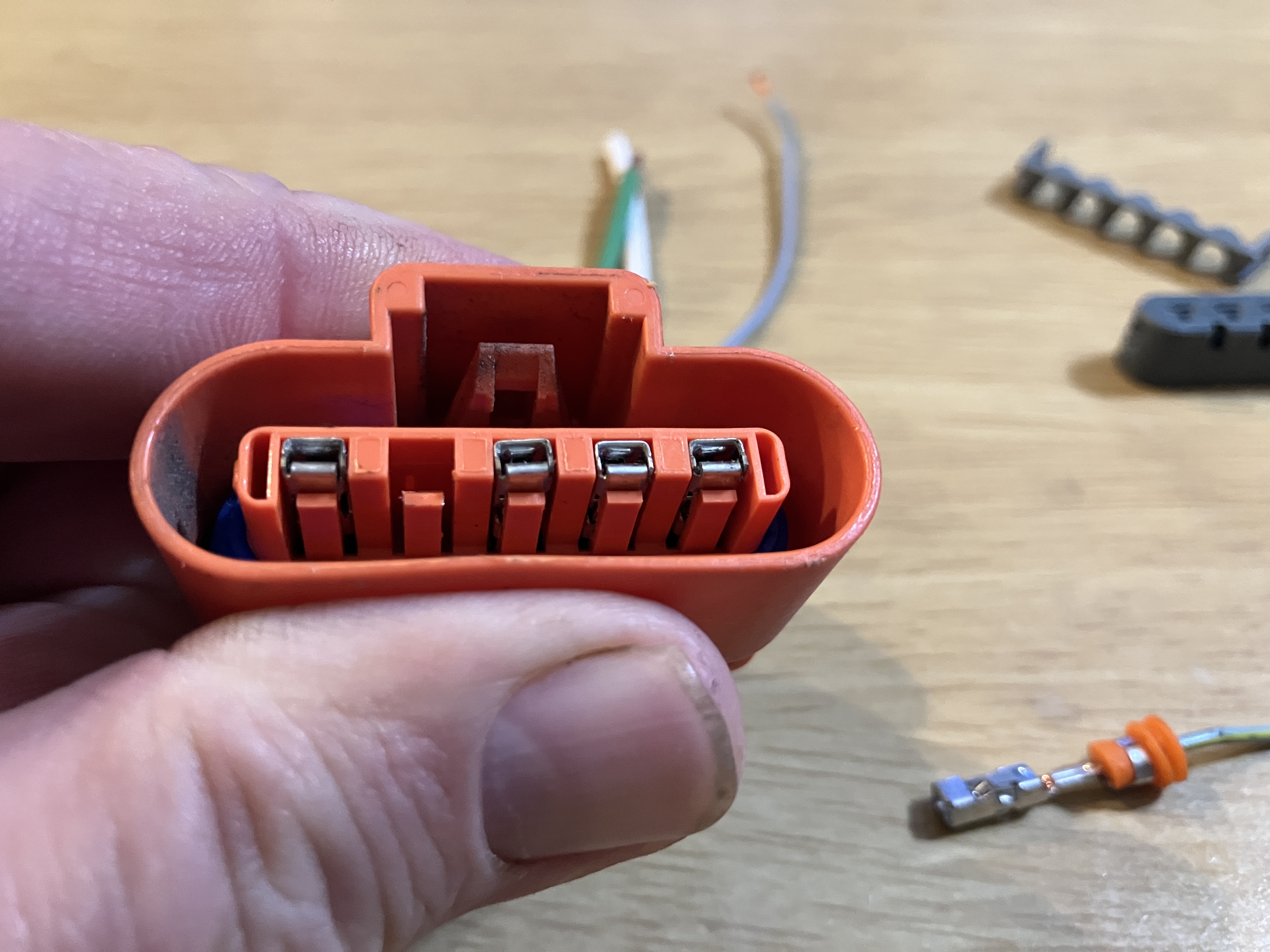

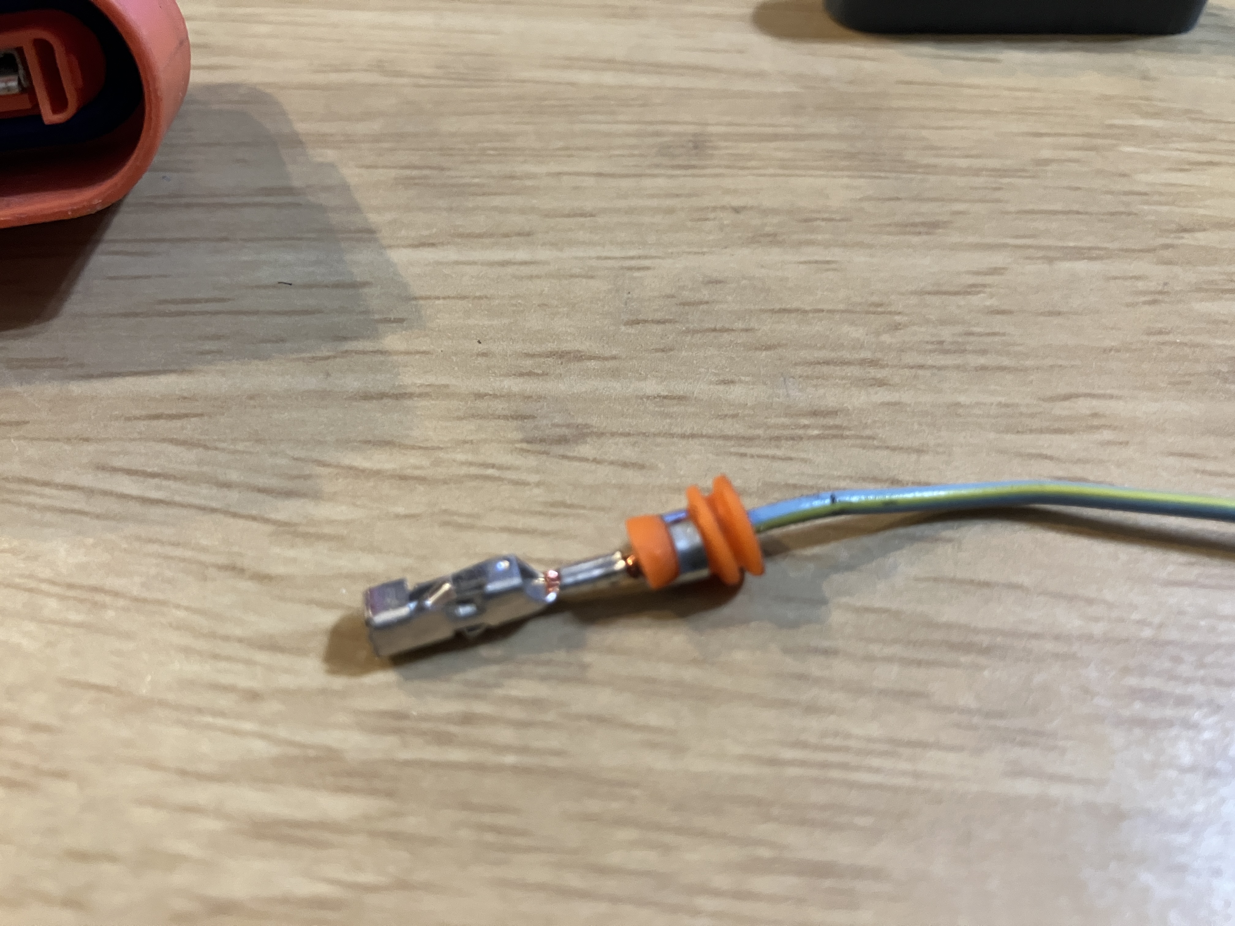

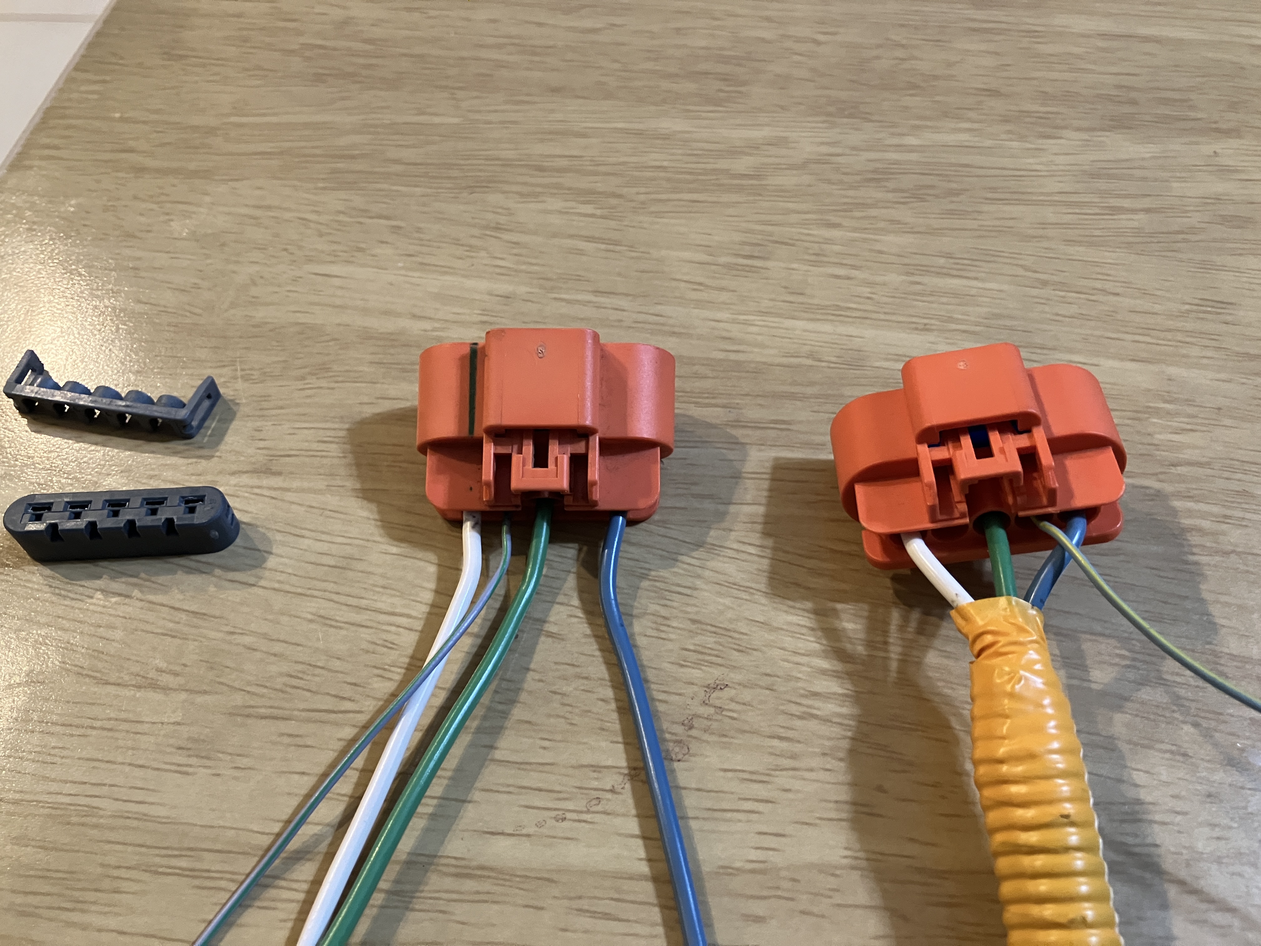

so a year or so ago when I knew even less than what I know now, I picked up this 1st Gen Chevy Volt charge port cable, or as the General calls it: Drive Motor Battery Charger Cable - GM (20972413)
Can the Eagle Eyed amongst you spot the situation here?
as compared to the pig tail from the OEM cord
- Posts: 1021
- Has thanked: 409 times
- Been thanked: 261 times
I spy with my little eye, two umm... wifi antennas. Isn't that convenient. Boy, sure would suck if those were wires and needed to be run through that whole cable braid...
- Gregski
- Posts: 2755
- Has thanked: 508 times
- Been thanked: 1069 times
yeah, it makes me wonder how that aftermarket cable was supposed to work in the first place, I guess we will find outMattsAwesomeStuff wrote: ↑Sat Oct 07, 2023 9:35 pm I spy with my little eye, two umm... wifi antennas. Isn't that convenient. Boy, sure would suck if those were wires and needed to be run through that whole cable braid...

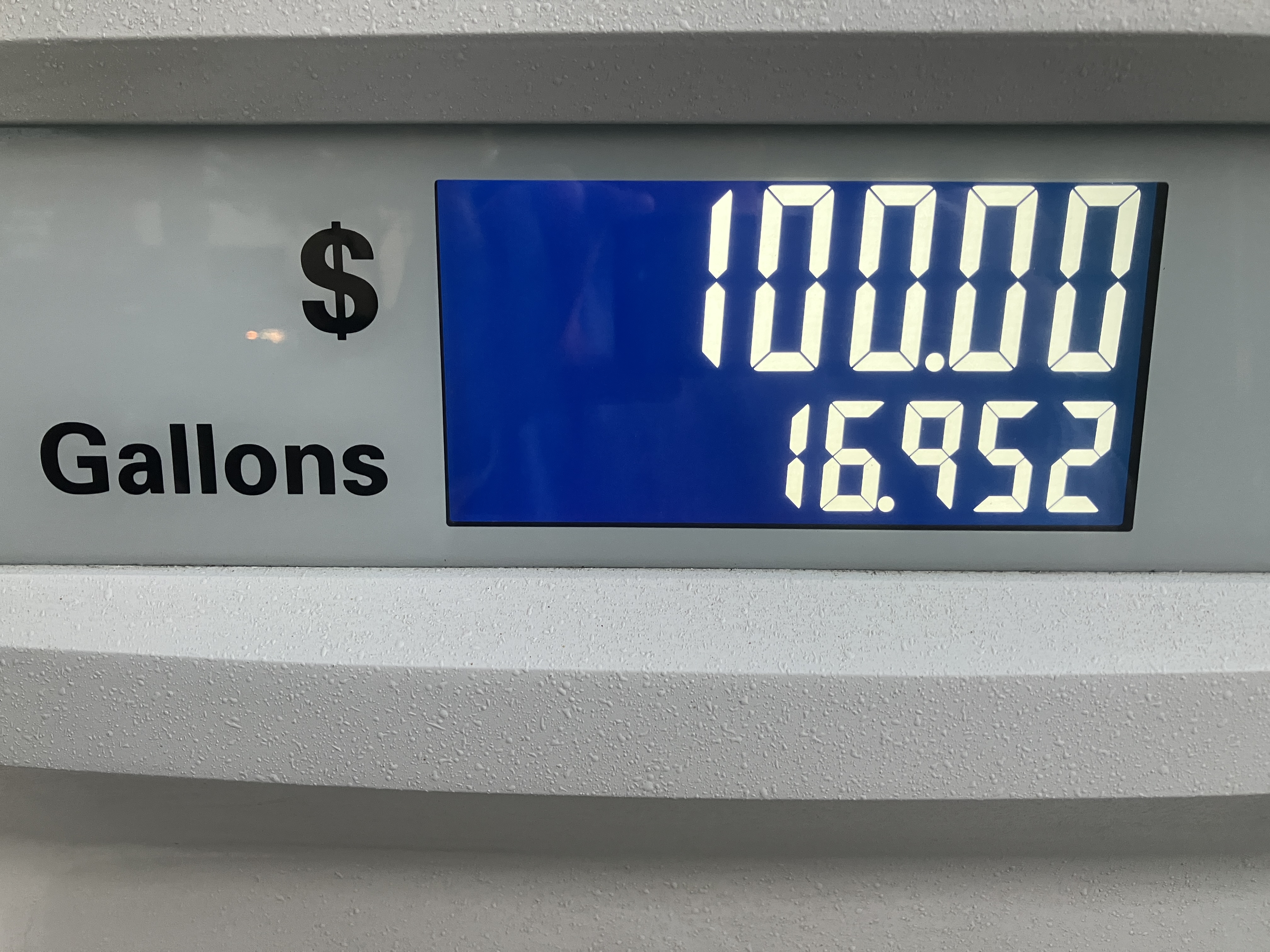

$100 bucks did not fill up our 2010 Honda Pilot 21 gallon fuel tank, the pumps are designed to STOP for security reasons at a $100 in case someone steals your card, had it kept going we would have ended up paying $124 to fill up

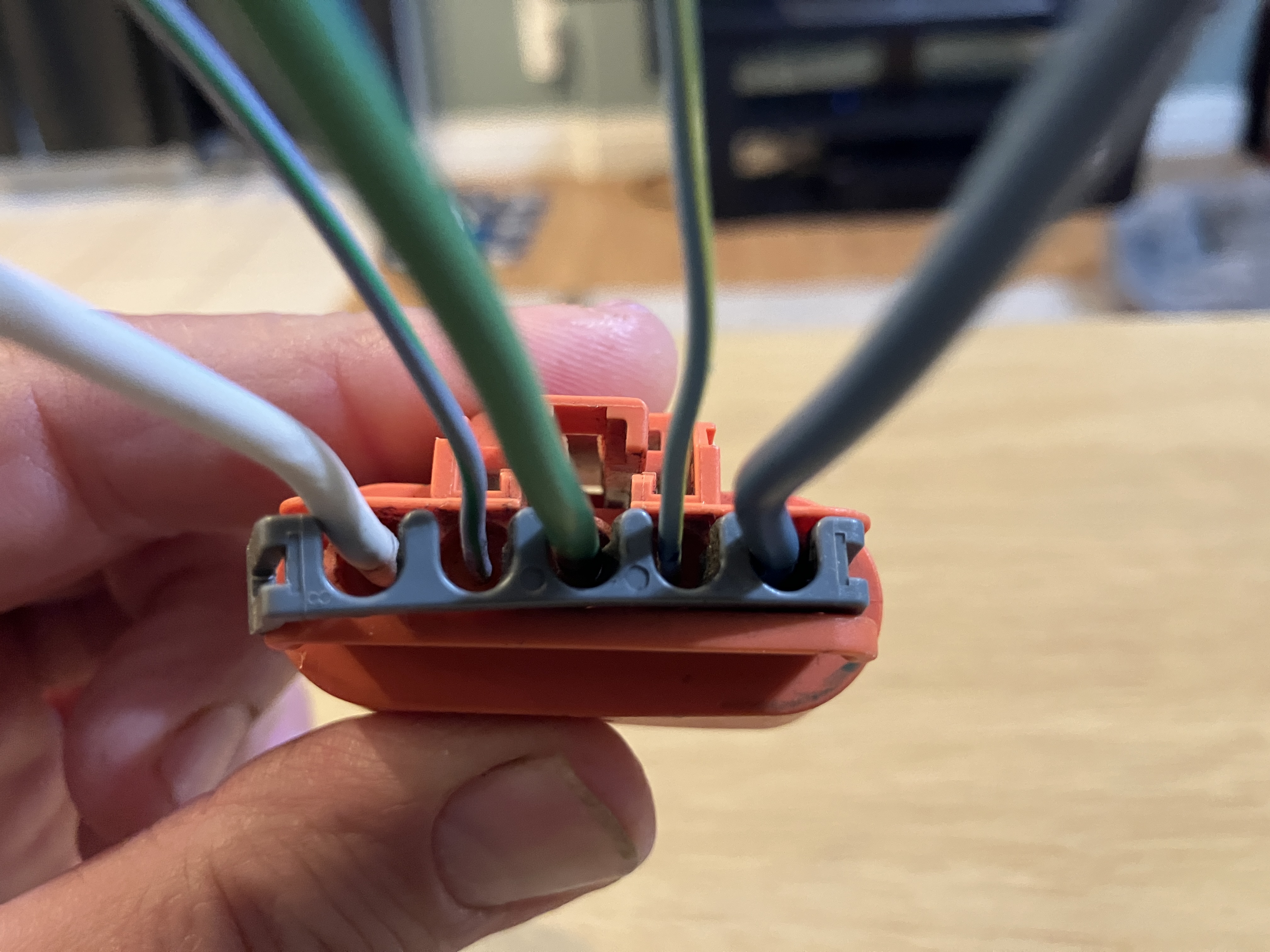

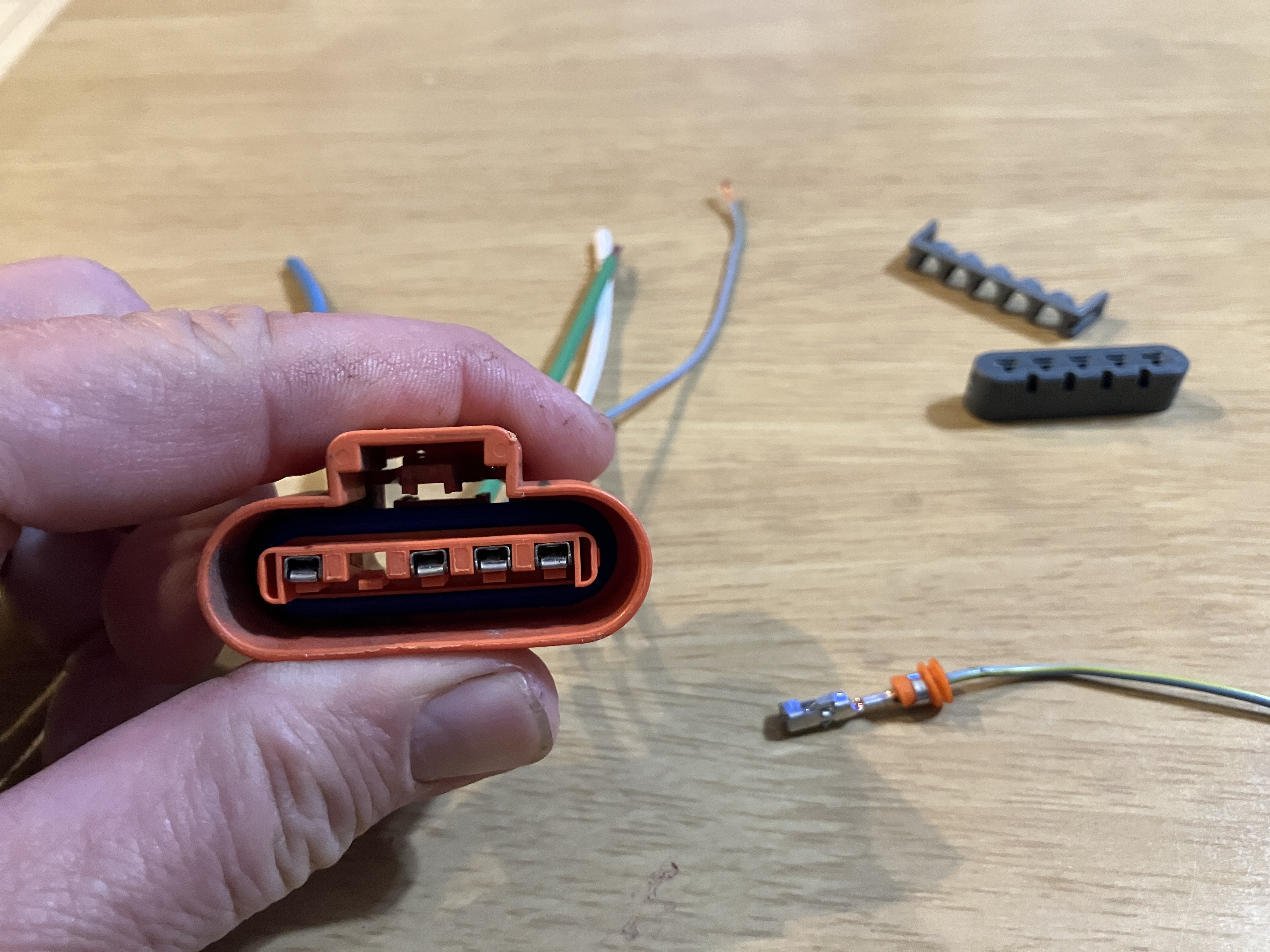

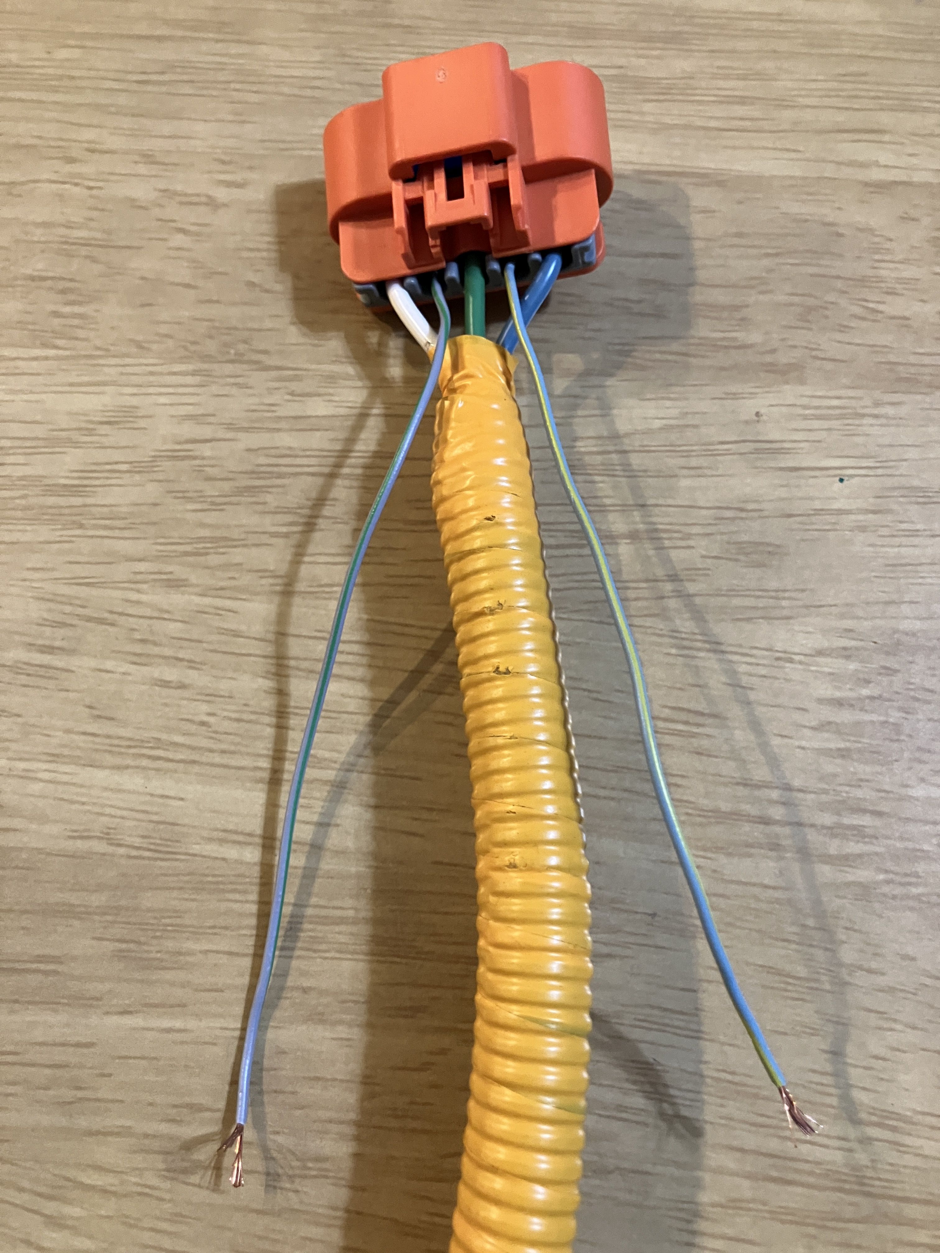

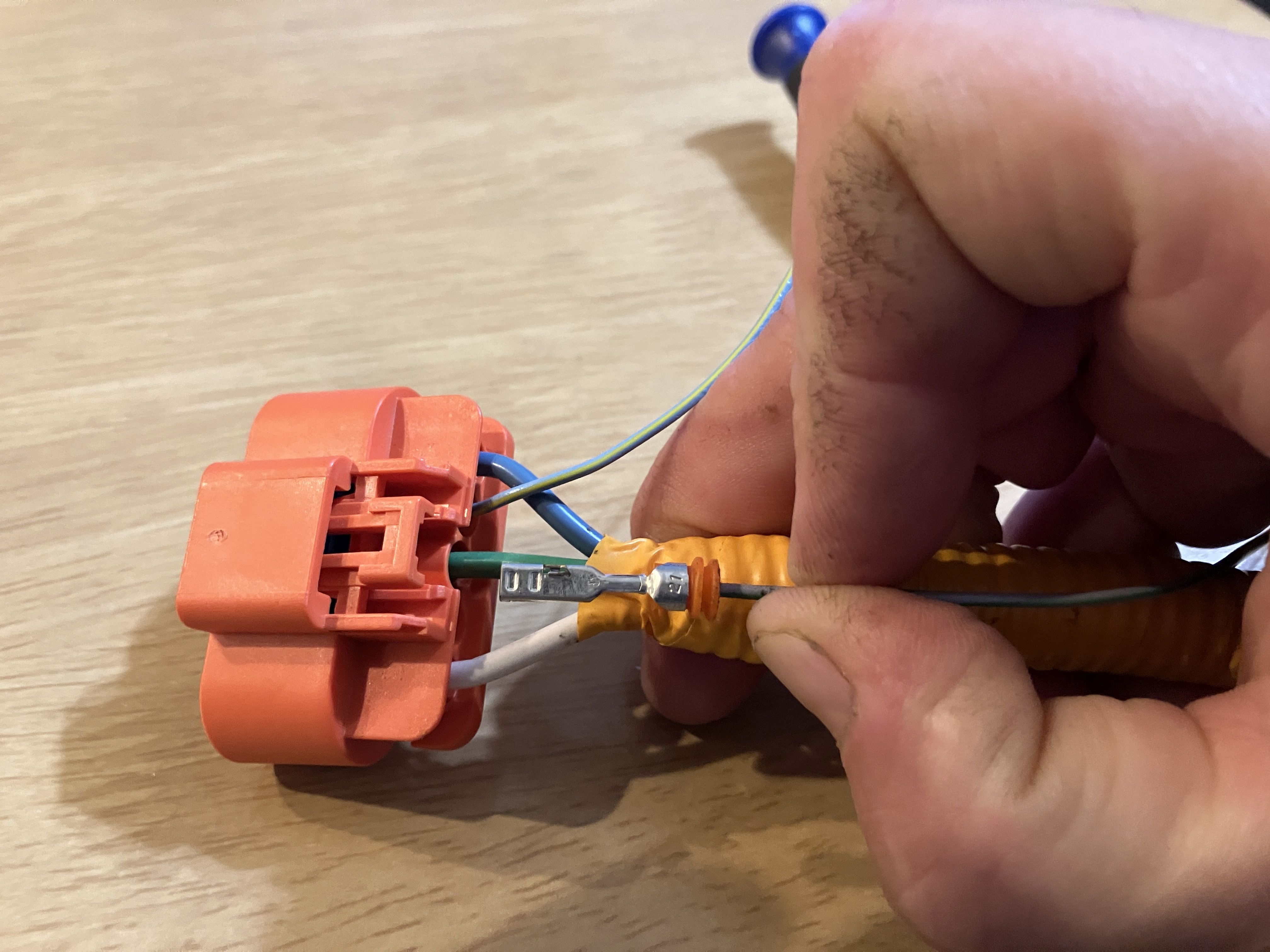

so after attempting to charge with the aftermarket three wire fire wire harness to prove to myself that it wouldn't work it couldn't possibly work, and by the way it didn't work, it was time to swapatize the proximity and control wires from the little OEM pig tail to the aftermarket wire harness
either I have seen my share of plugs and connectors by now and have gotten extremely good at taking them apart (highly unlikely) or this one wasn't designed and made in Germany at all l0l
- Gregski
- Posts: 2755
first time in history of Gregotronics have I repluged a plug without as much as reaching for the curse jar
- Gregski
- Posts: 2755
I am 72% sure there's a 50/50 chance I got these right

You know the 50/50 rule?
If there is a 50/50 chance you'll get it right.
90% of the time you get it wrong!
- Gregski
- Posts: 2755
I might could be in the 10% then on this one, cause it worked

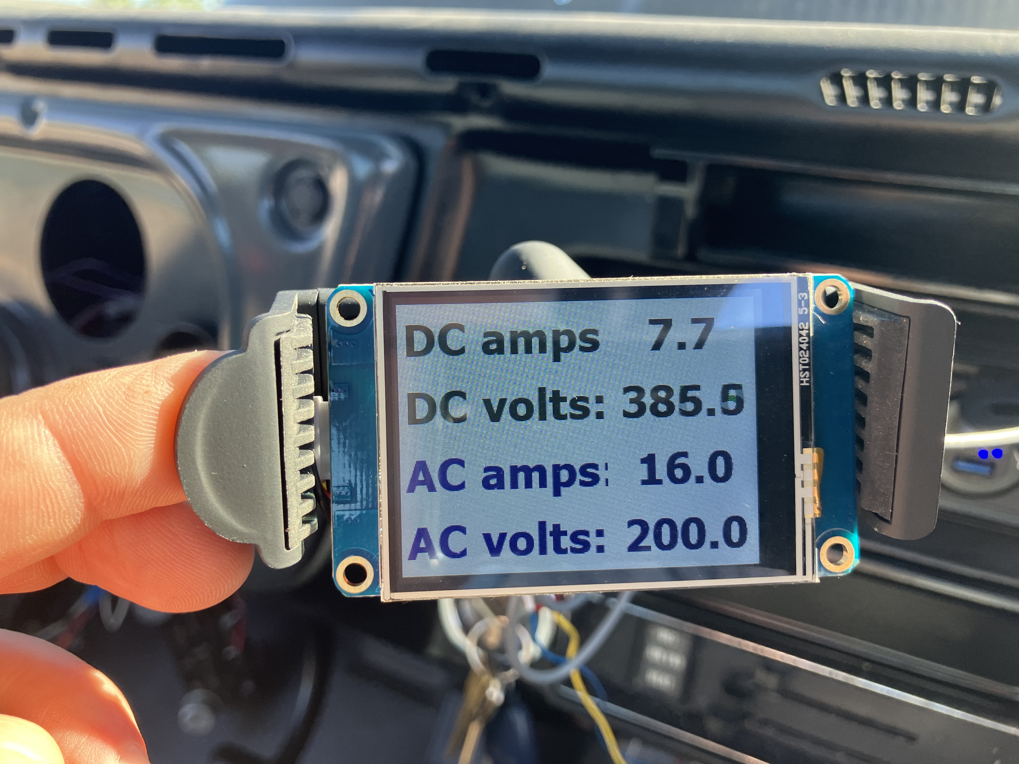

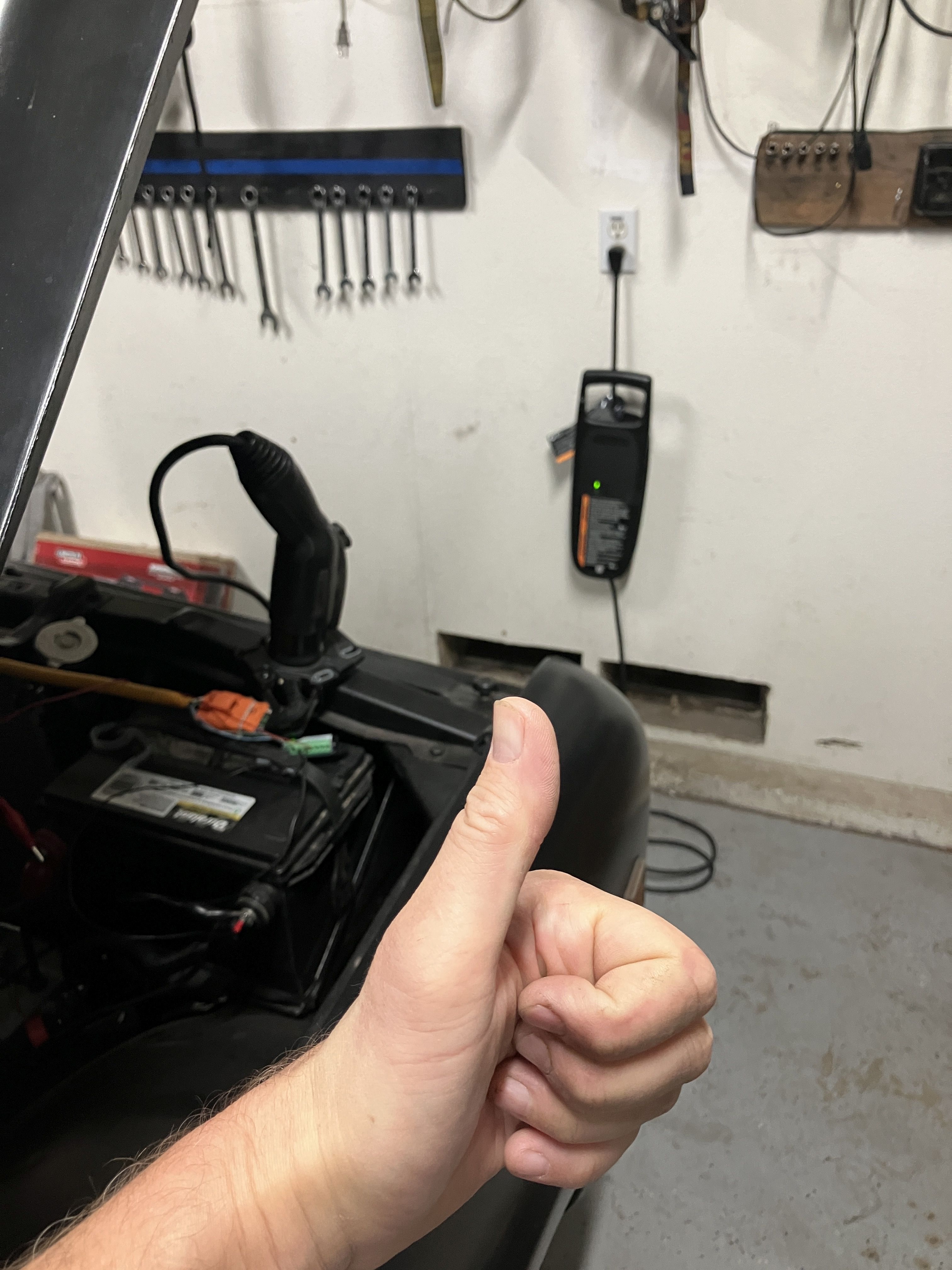

Baby Steps: so got the Level 1 charging at home working using an OEM 1st Gen Chevy Volt smart cord thingie
DISCLAIMER: The charge cord normally does not hang like this just from the outlet, I cleared all the clutter for the video, normally I use a tie down strap to ratchet it up to a hook above by it's handle !

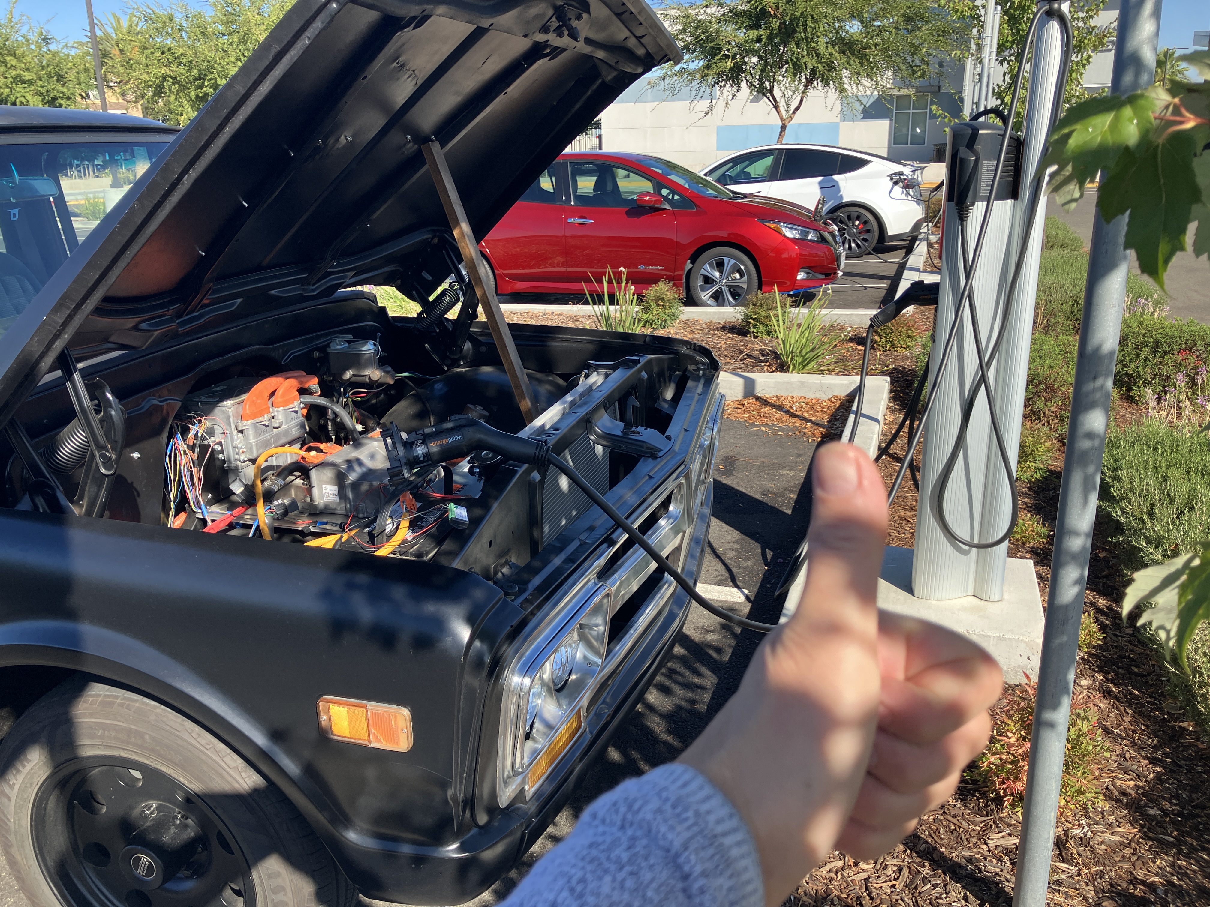

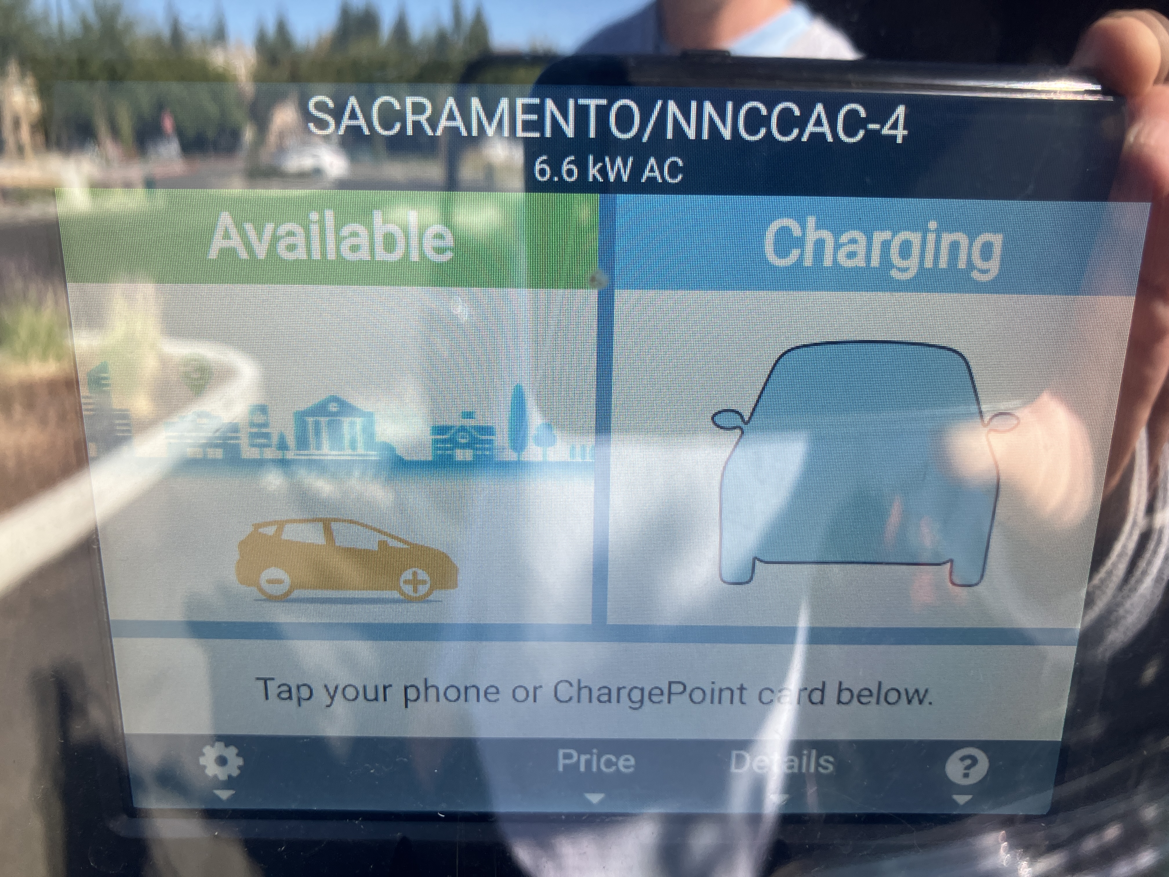

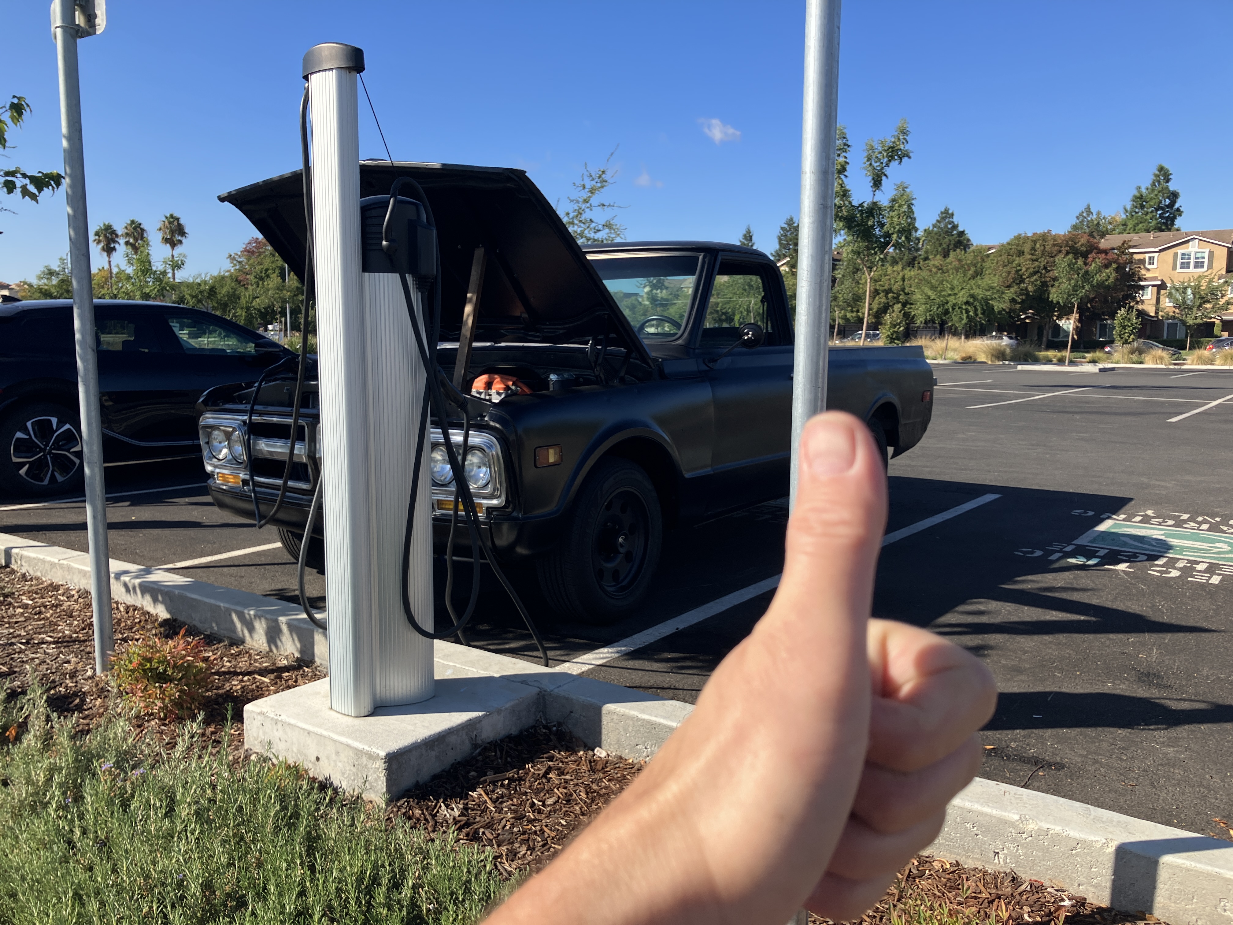

so next it was off to a public charging station, and we just had a brand new one pop up right next to a brand new aquatic center I've been meaning to visit for always to get back into shape, The Greg luvs to swim!
so I pulled up right next to a Chevy Volt, skipped a few stalls [using that urinal etiquette] and was welcomed by a slew of standard public charging station errors, ah yes, good times
the first pole greeted me with a No Network Connectivity error
the second a couple stalls over made me feel like a dead beat with a: Card rejected error

Level 2 Charging at a Public Charging Station
“We shall charge till the end. We shall... charge with growing confidence and growing strength in the air, we shall regen our battery, whatever the cost may be. We shall ... charge in the fields and in the streets, we shall charge in the hills; we shall never …”
we shall read a book that's what we shall do ... while charging of course

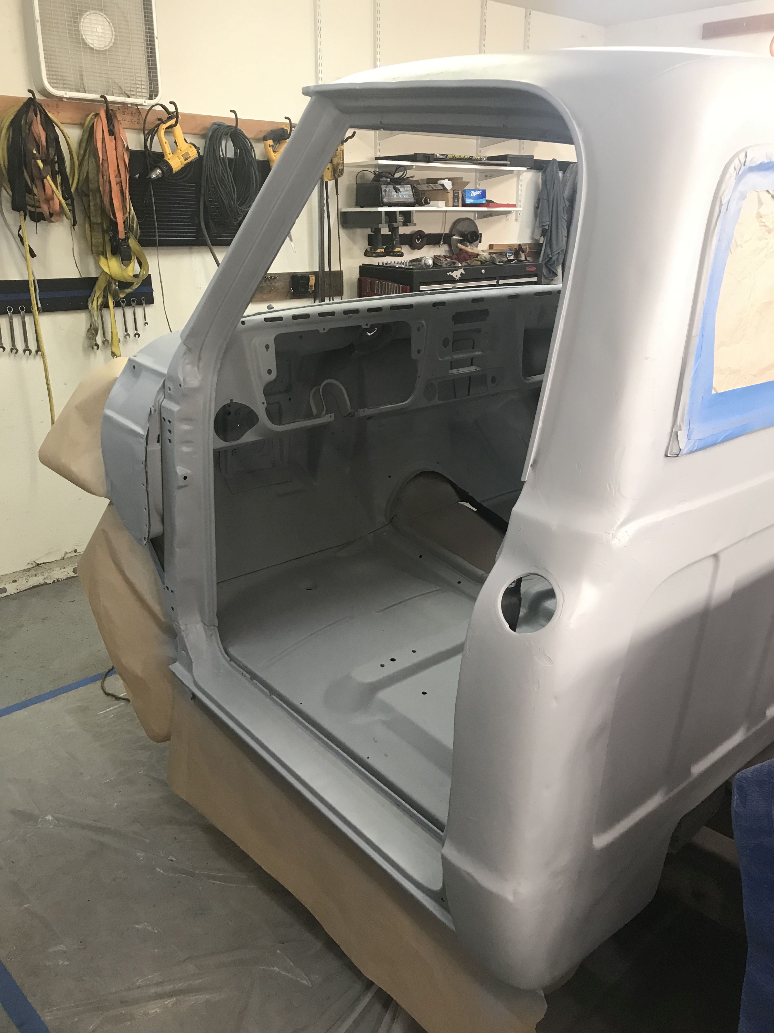

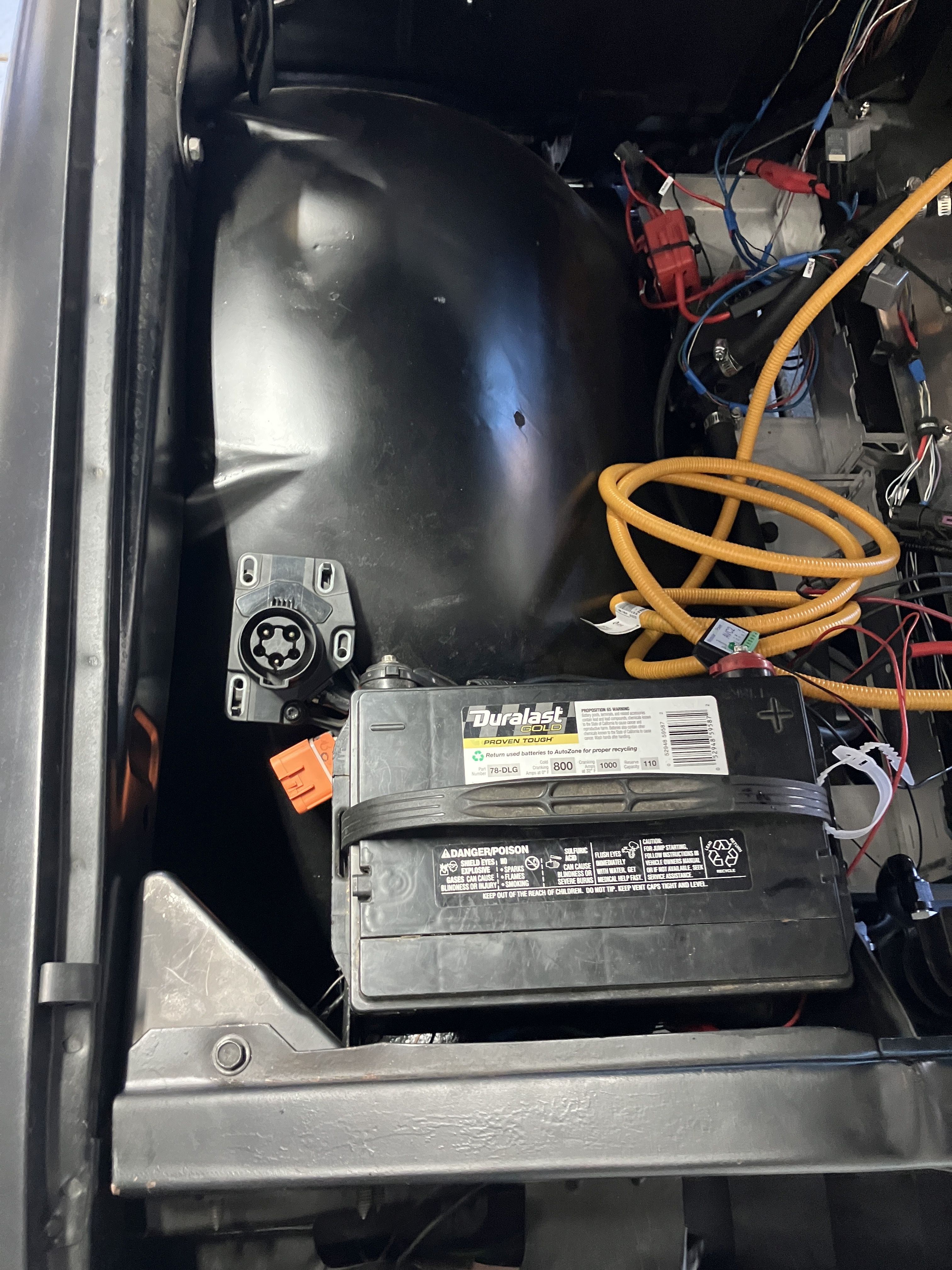

and here's where I decided to mount the charge port on this 1971 Chevy truck, no it's not in the most ideal location, these trucks came with fuel tanks inside the cab, right behind the bench seat, and a lot of EV Conversions repurpose the OEM fuel tank inlet for the charge port, but I did not want to drag high voltage wires inside the cab

- Posts: 1021
Too much vandalism potential to me by leaving your hood open.
I'd be tempted to take your license place and install a flip-down on it instead. That's probably what I'll end up doing to mine. The gascap on it is centered on the top of the tail of the car. I've got lots of room under the non-grill too, so, a few choices.
- Gregski
- Posts: 2755
that is always a concern, however these trucks never came with a hood latch release inside the cab, they predate that cutting edge technology, all I have is a single manual lever at the nose of my hood easily accessible by anyone with opposing thumbs, so it makes no difference to a nefarious thiefMattsAwesomeStuff wrote: ↑Sun Oct 15, 2023 12:35 am Too much vandalism potential to me by leaving your hood open.
