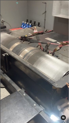

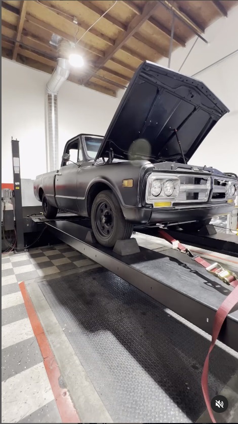

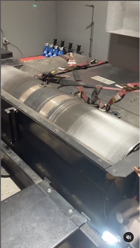

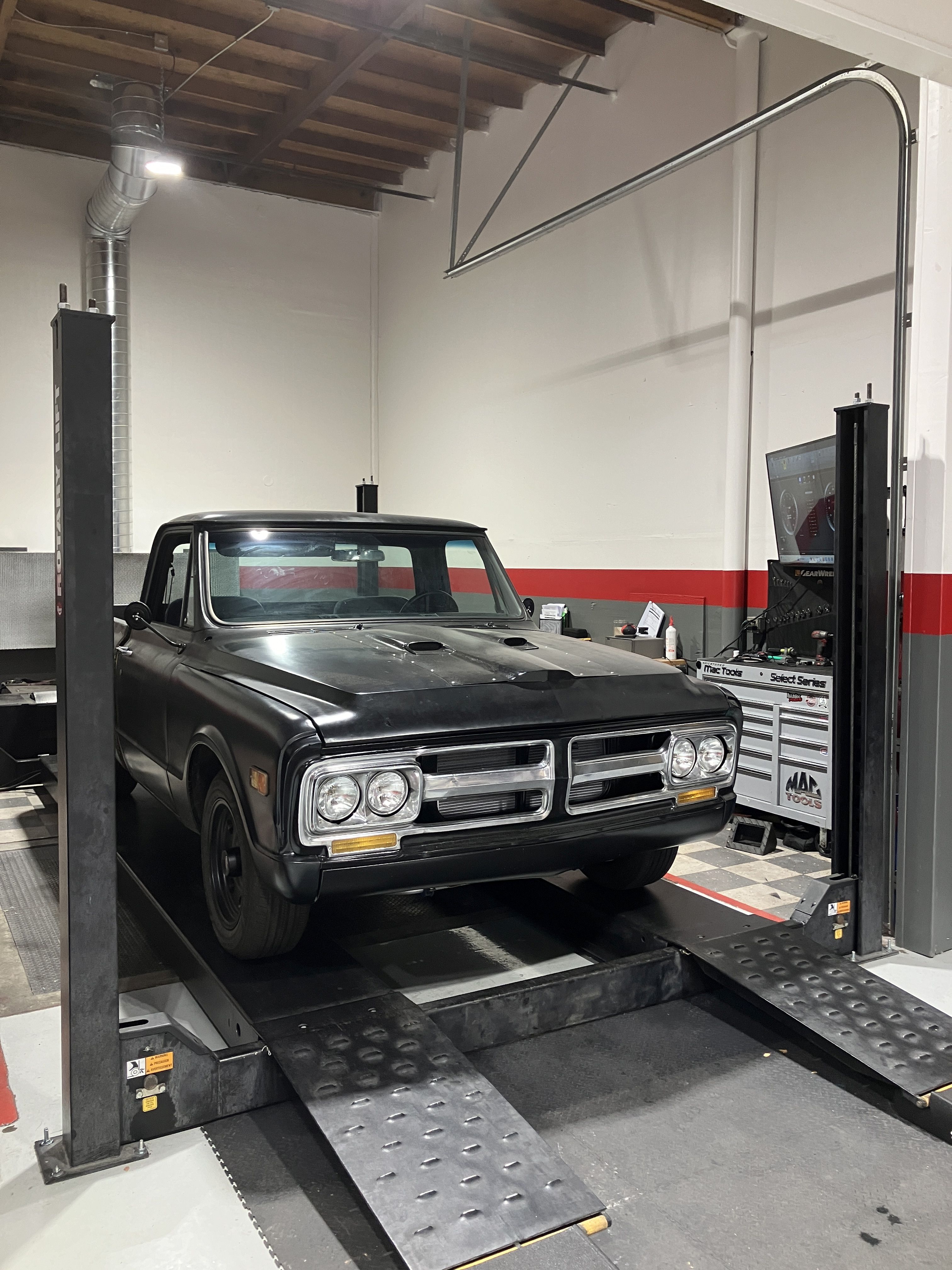

more vertical dyno videos (I think YouTube limits us to 60 seconds so I tend to post a bit longer ones, 90 seconds on the_gregski Instagram) a longer format video is being edited as we speak, or I type and you read (you get the idea, lol)
Gregski
Posts: 3160
Has thanked: 631 times
Been thanked: 1607 times

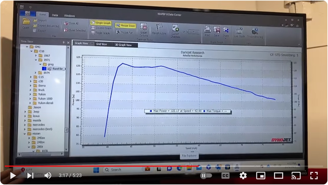

Post by Gregski »

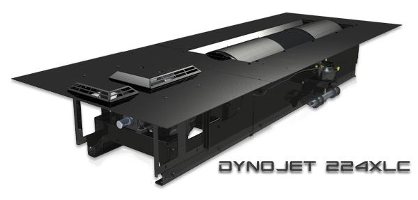

122 hp @ 42 mph using only one motor not both (on a 60% charged battery pack)
219 ft-lbs torque (this was estimated since we had no useable RPM signal)
CAR SPECS
  • 3,200 lbs vehicle weight
  • 1.9 CVT Transmission gear reduction
  • GM 12 bolt rear end 3.73 gears
  • 7.087 total gear reduction
  • 215/65 R17 tires (28" tire diameter)
LESSONS LEARNED
  • at this time Electric Vehicles can not provide a tach RPM signal output to the dynos, not even the OEMs like Tesla and Rivian (their sh!et is locked down)
we used a Dyno Jet 223 XLC

Post by jrbe »
Gregski wrote: Sun Dec 10, 2023 2:13 pm 122 hp @ 42 mph using only one motor not both (on a 60% charged battery pack)
LESSONS LEARNED

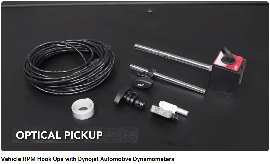

The dyno should be able to calculate rpm if you input the gear ratio. But if the tires slip or it shifts gear it's thrown off of course.
Are you shifting the transmission or just fixed?
Ev8
Posts: 835
Has thanked: 44 times
Been thanked: 172 times
Post by Ev8 »
Would be interesting to compare to a higher state of charge run, see if the Toyota derates current at higher Soc to provide a constant power level throughout state of charge, pretty sure the leaf inverter does this when controlled via can,
Those of us running oi controller boards certainly gain power with higher Soc
Out of interest what was your peak current and voltage during the run? How many kw electrical became 122 hp?

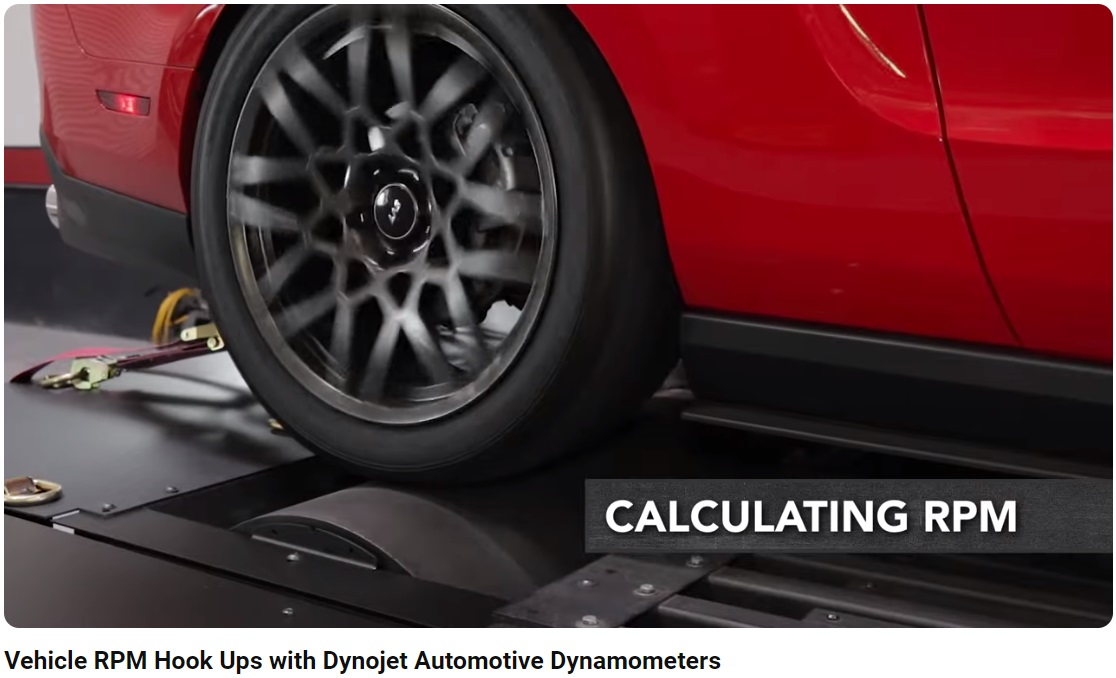

Vehicle RPM Hook Ups with Dynojet Automotive Dynamometers
this video goes over the five different ways you can send RPM signal from the vehicle to the dynamometer (maybe two of these could work for the EV, what do you think?)
  1. Inductive Pickups (this is the method we already tried and it did NOT work)
  2. Optical Pickup
  3. EZ-RPM Module
  4. OBDII Data Link
  5. Calculating RPM

Doesn't really... tell you anything. You have a small battery pack, and it was discharged. Stupid Costco.
That's equivalent to dynoing a car and not pushing the gas pedal all the way. You get an answer, but the answer doesn't mean much.
Should've asked them to hop in a truck with a tow rope and tow you around for 10 or 15 minutes while you hold the regen down.
Actually, you don't have any BMS or thermal knowledge of your battery pack so, really pushing your vehicle at all at this point isn't a smart idea. Last person that did that burned his Miata down on a spirited hill climb.

jrbe wrote: Sun Dec 10, 2023 3:40 pm The dyno should be able to calculate rpm if you input the gear ratio. But if the tires slip or it shifts gear it's thrown off of course.
I am not sure if you mean shifting shifting as in through the 6 "fake" gears like in this video, or shifting between High and Low gears, either way no I am not doing either, it's just hard coded to High Gear in the VCU and we put it in Drive and let it rip potato chip !!!

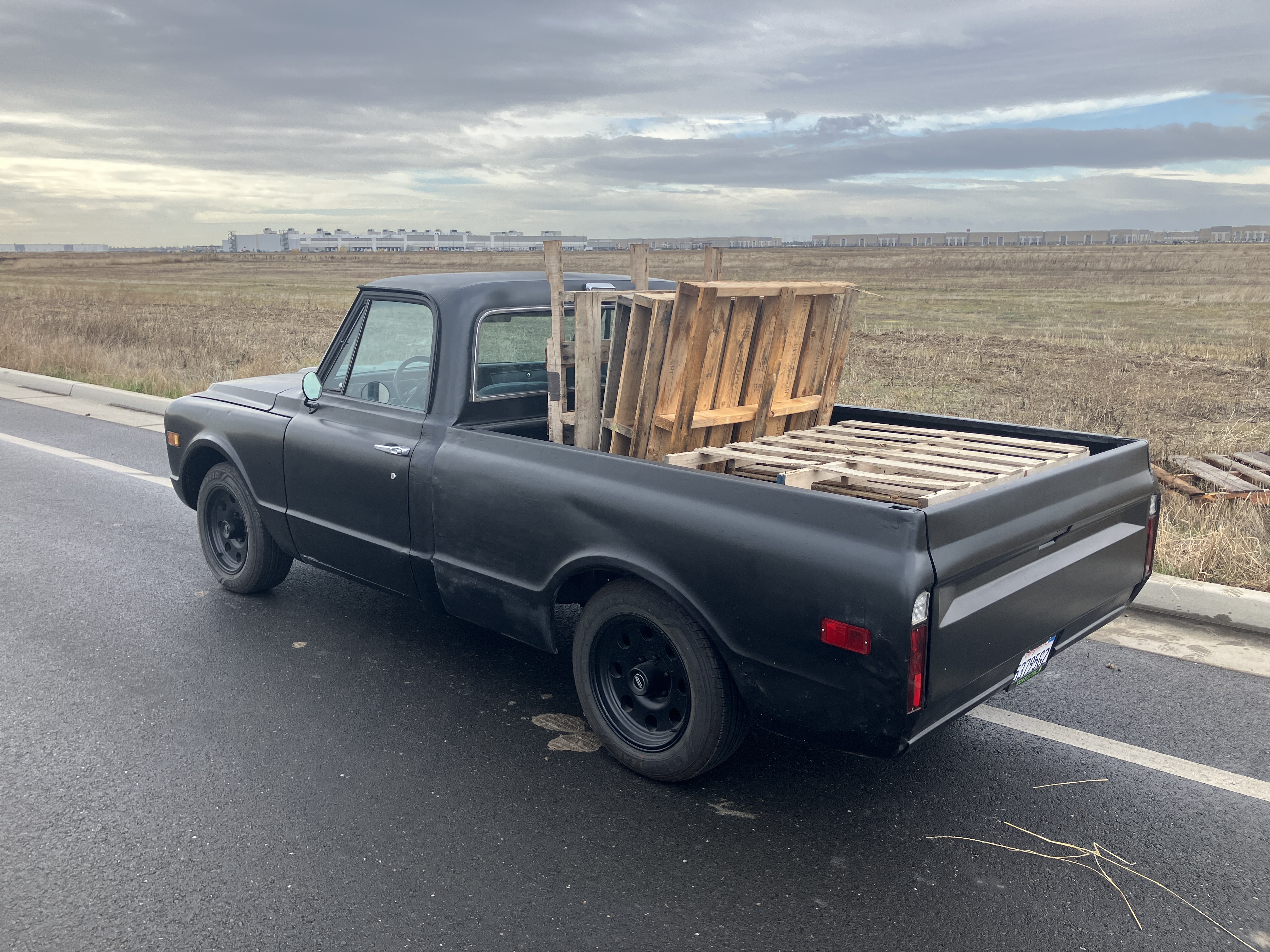

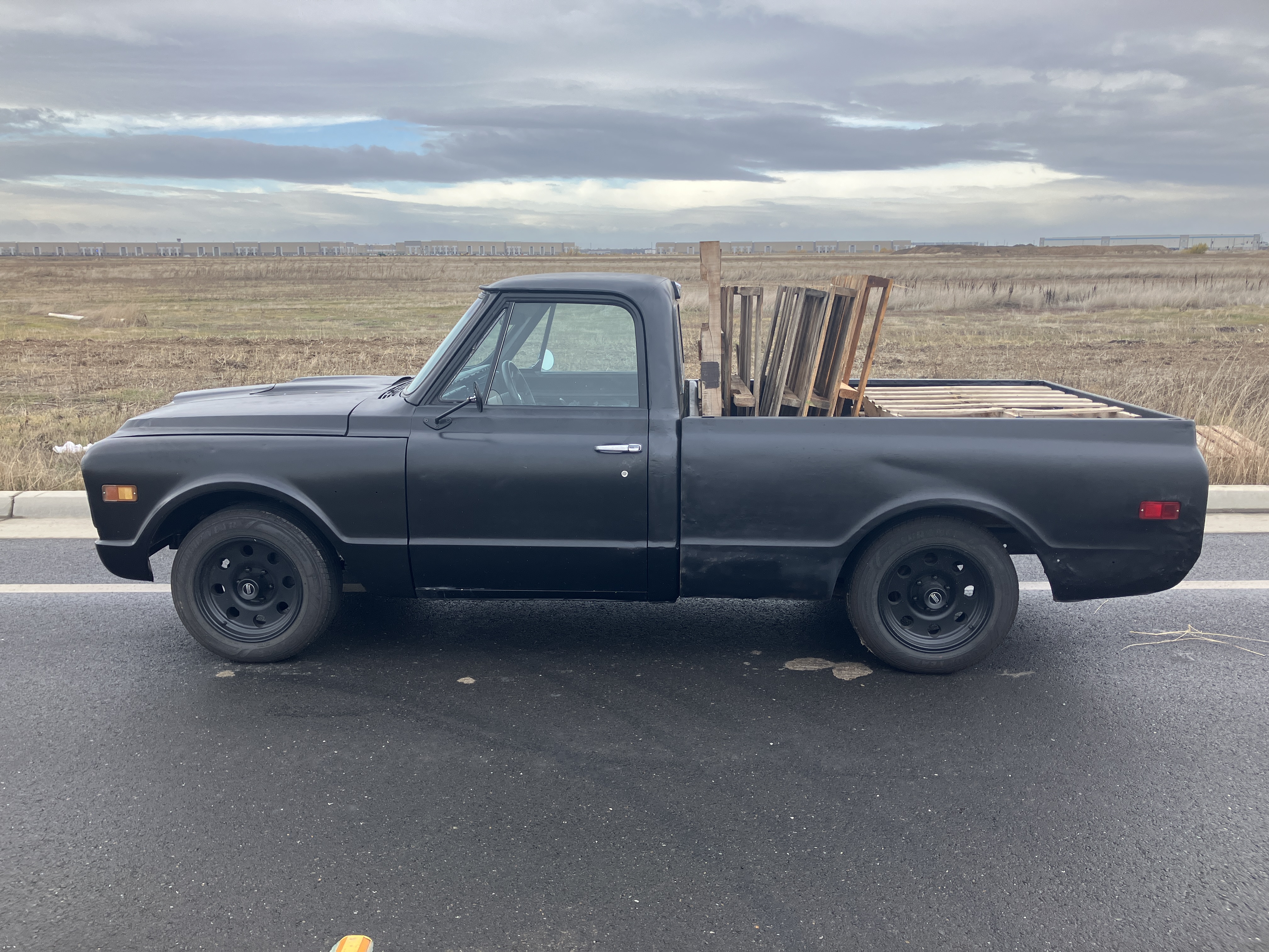

just an electric truck doin' truck things
overcast is a wonderful time to shoot sum fotos, wouldn't you agree (watch out the Internet might implode if you do)

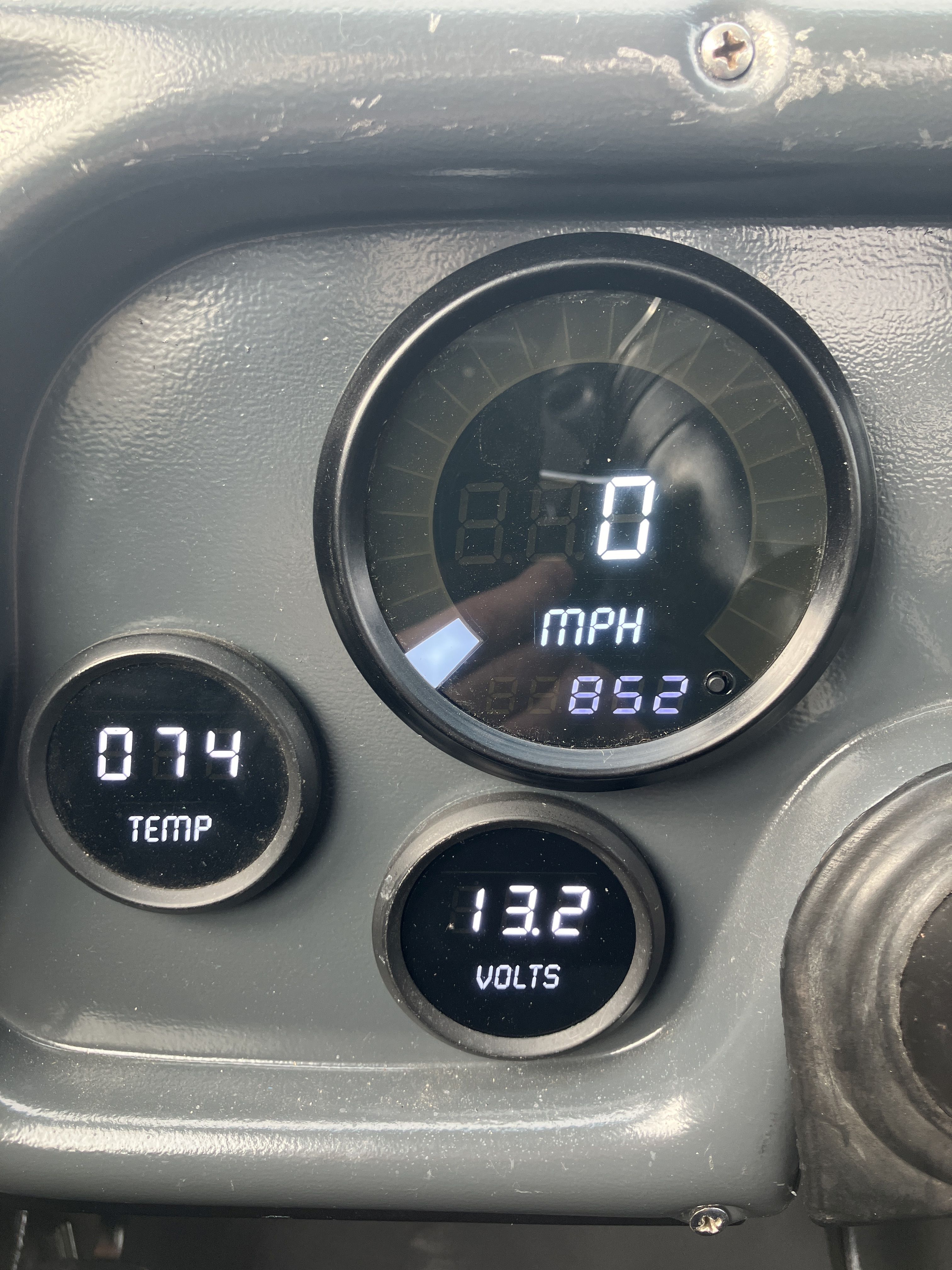

so... Final Goal of 2023:
put on 1,000 Shake Down Miles on the truck !
about 150 more to go (been driving it since August so 5 months ago)

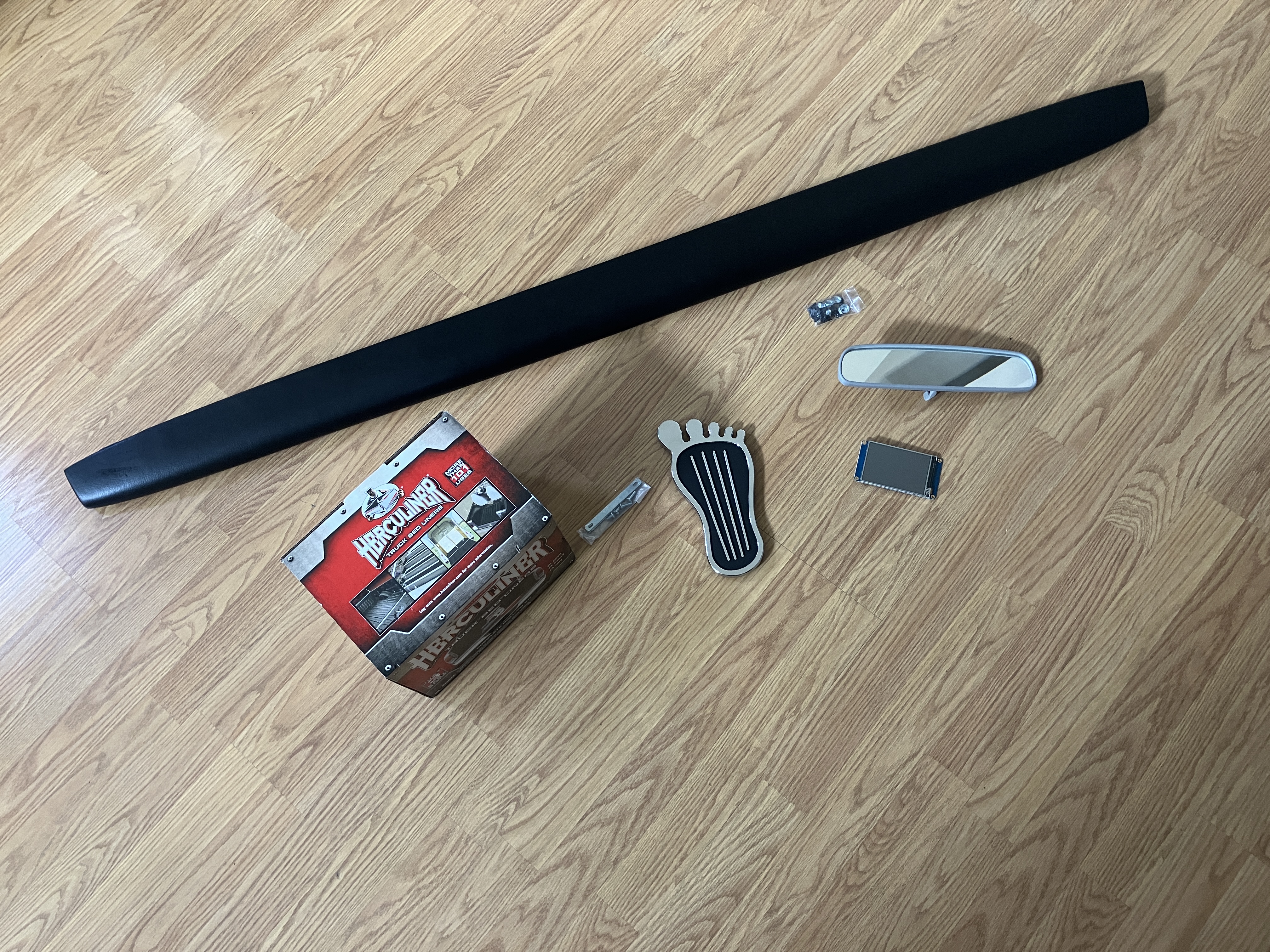

Post by Gregski »
Dusty made out like a bandit this Christmas, thank you Santa !

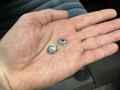

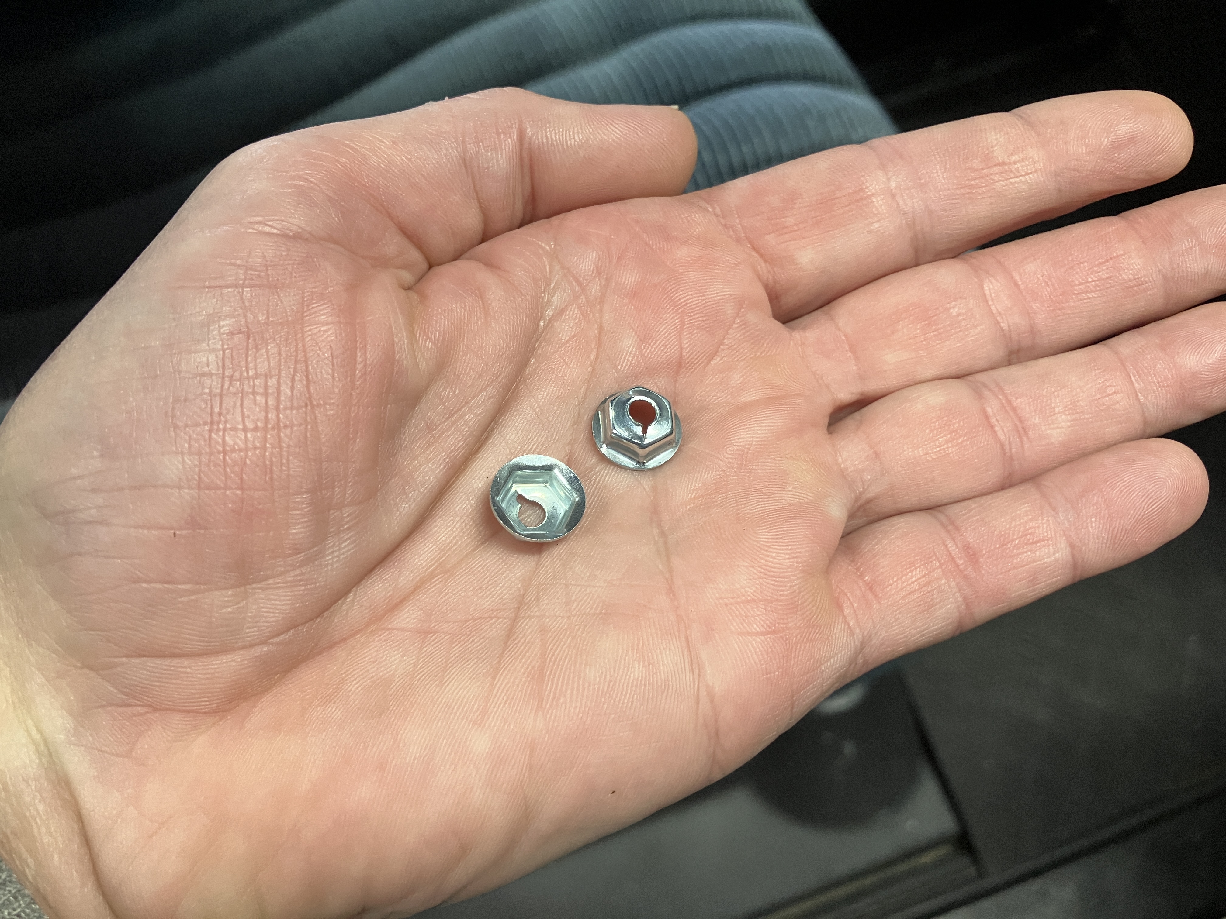

Post by Gregski »
well that is lookin' smart
and may the inventor of these hollow dished nuts burn in ___________ !!!

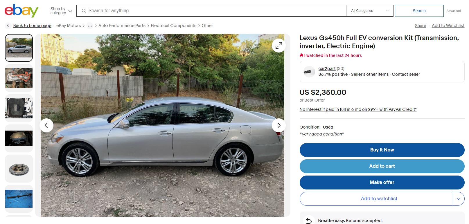

Post by Gregski »

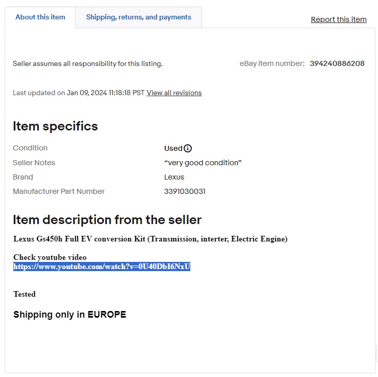

well sh!t, I guess now I'm an influencer, check out the link in the description:
Check youtube video
https://www.youtube.com/watch?v=0U40DbI6NxU
