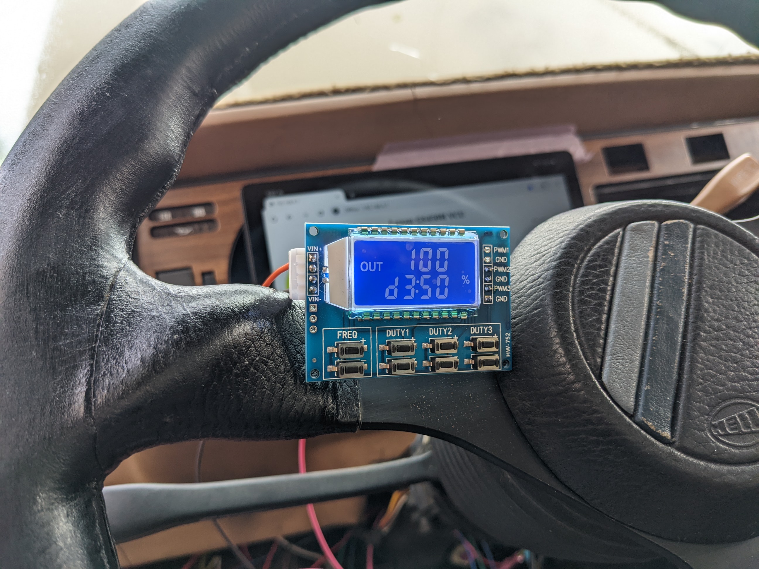

L1 charging at 1300W!
Volt charger being controlled by a simple pwm generator

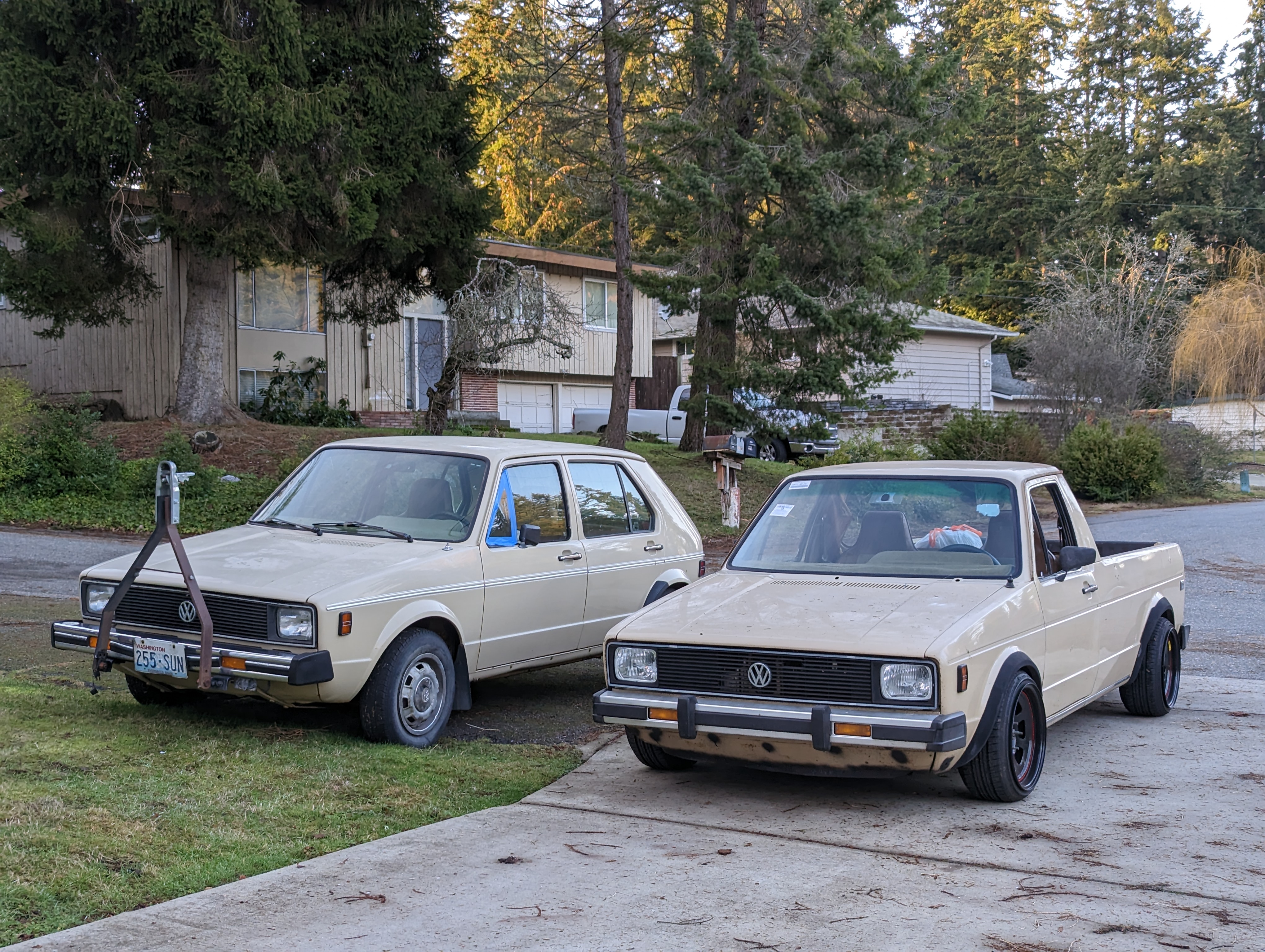

I picked up a matching 1980 4dr Rabbit, that will be getting a model 3 drive unit.

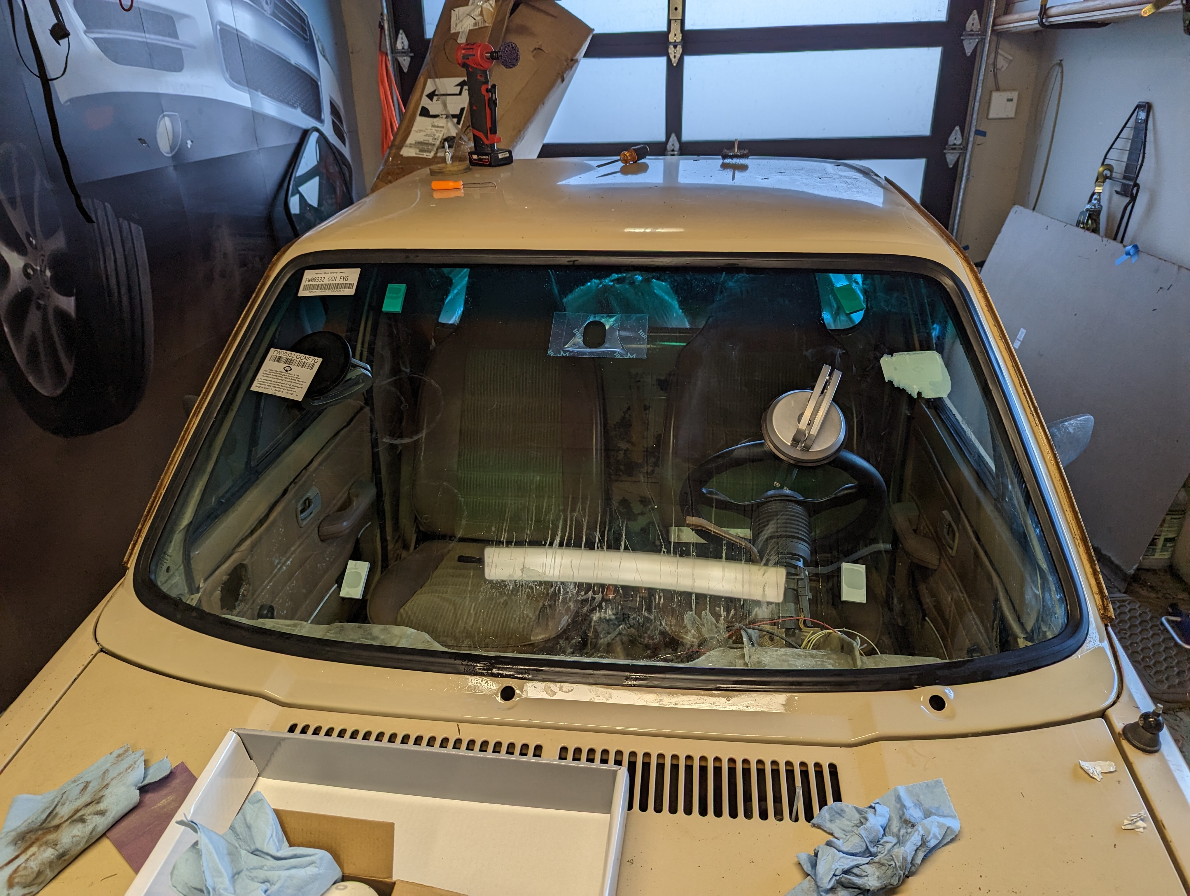

replaced the windshield and back glass along with some minor rust repair

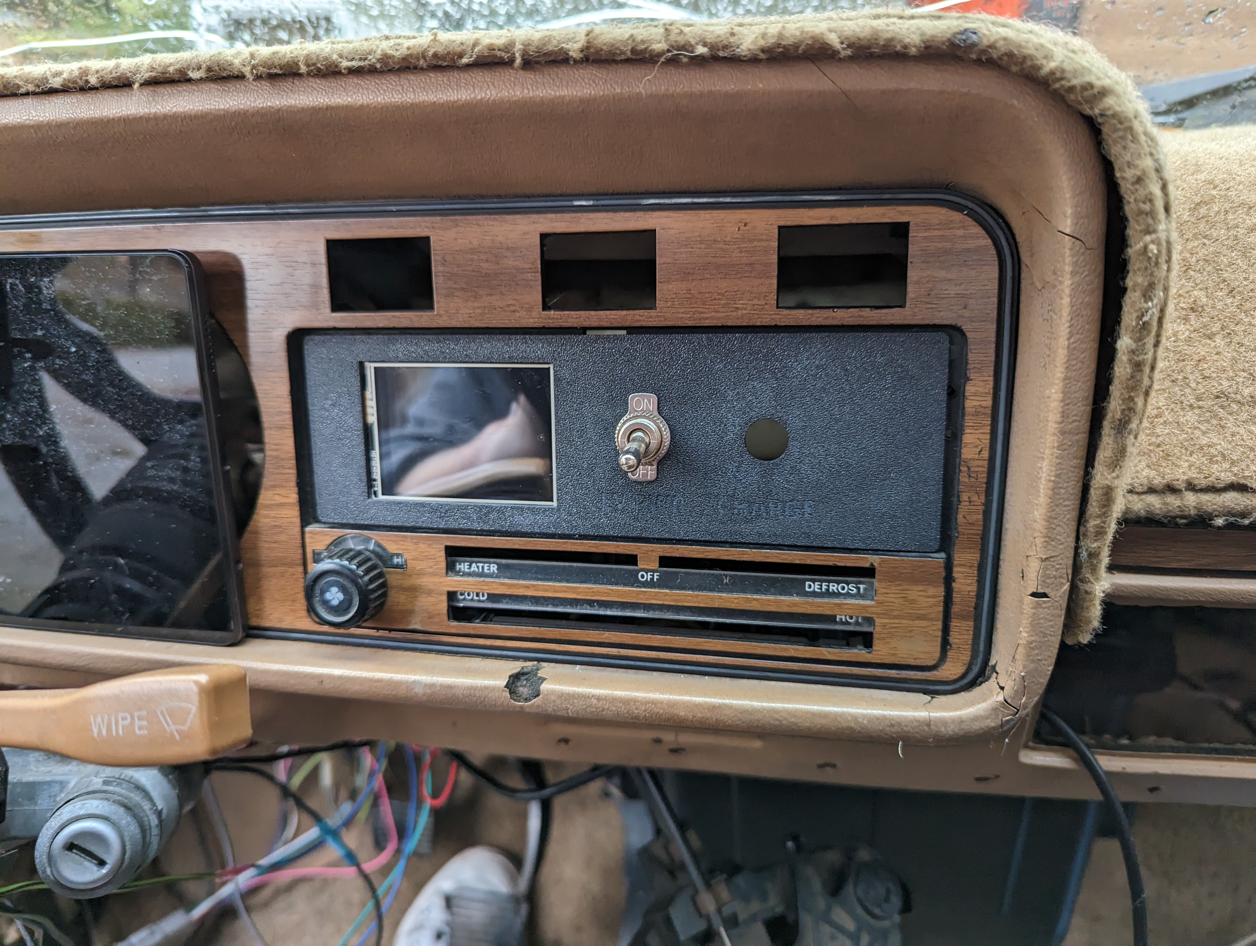

moved the simp BMS display to the dash, but have yet to get it to control the charger

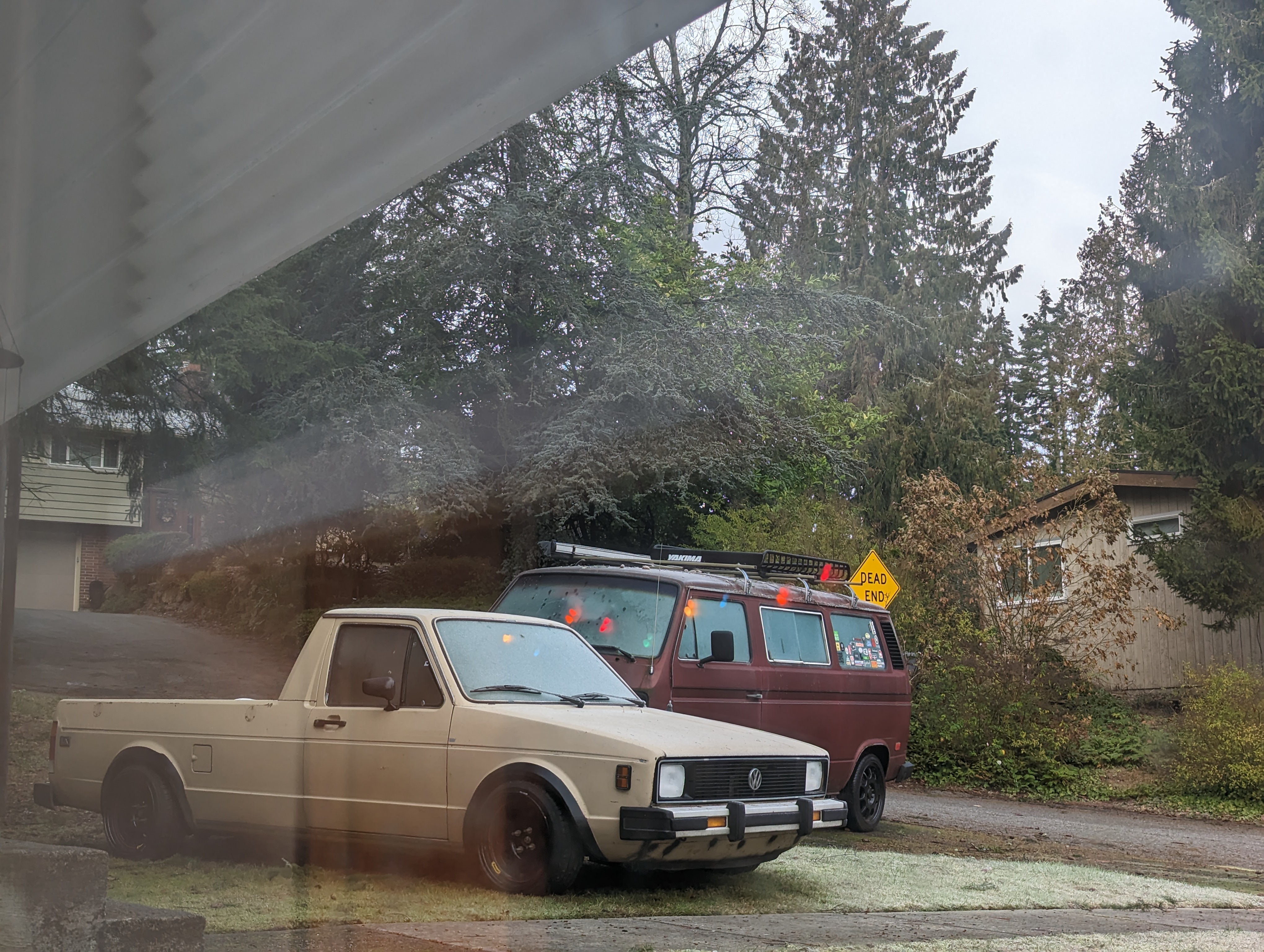

I have other EV conversions in mind that I'll be slowly collecting parts for. Until then, Here are some of the rabbit pickups adventures:
