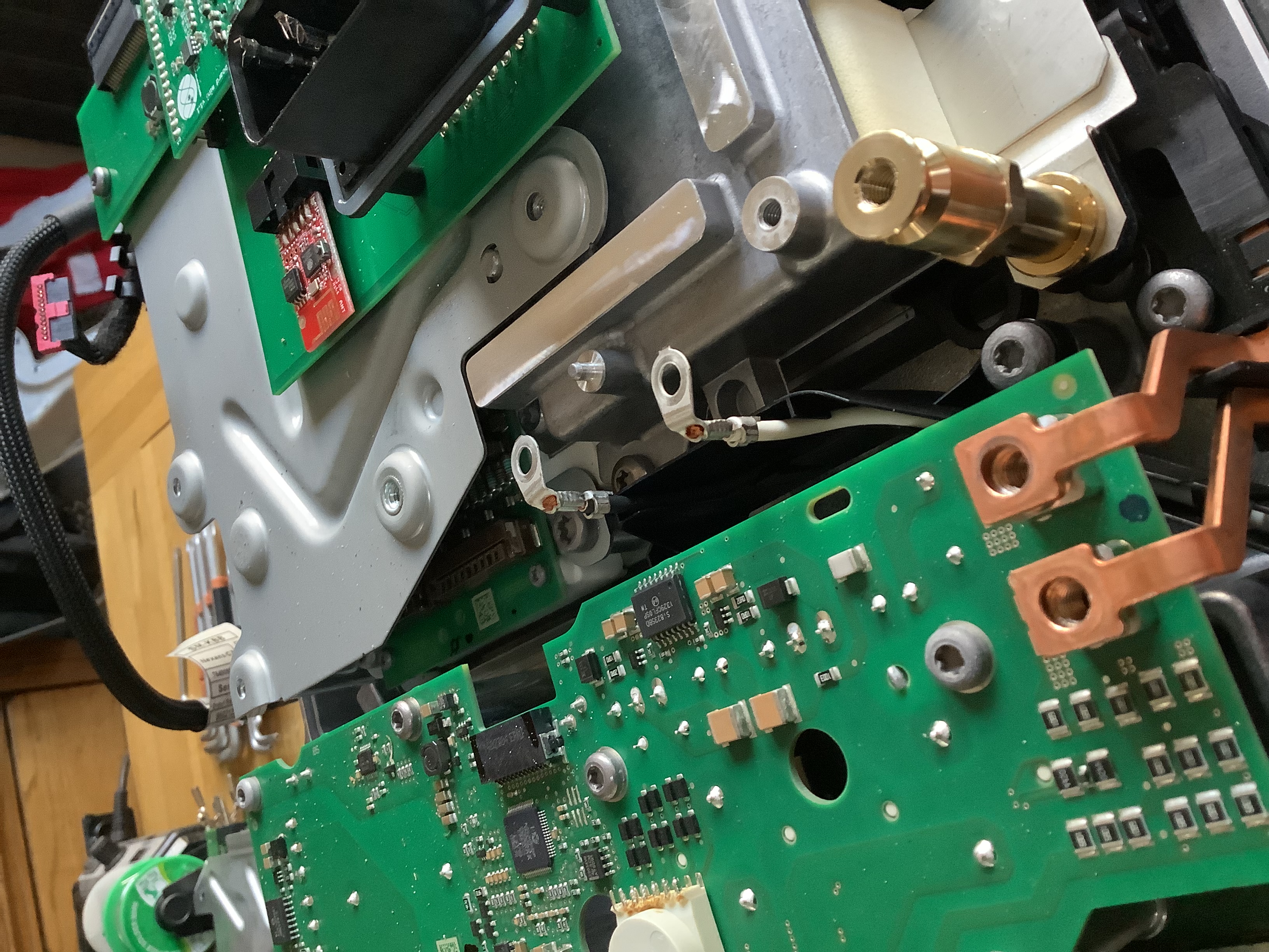

Does anyone know what the black an white wires do?
Is it power and earth to the old board?

Ok thanks

Ok, thanks, I thought it looked like it had got hot.

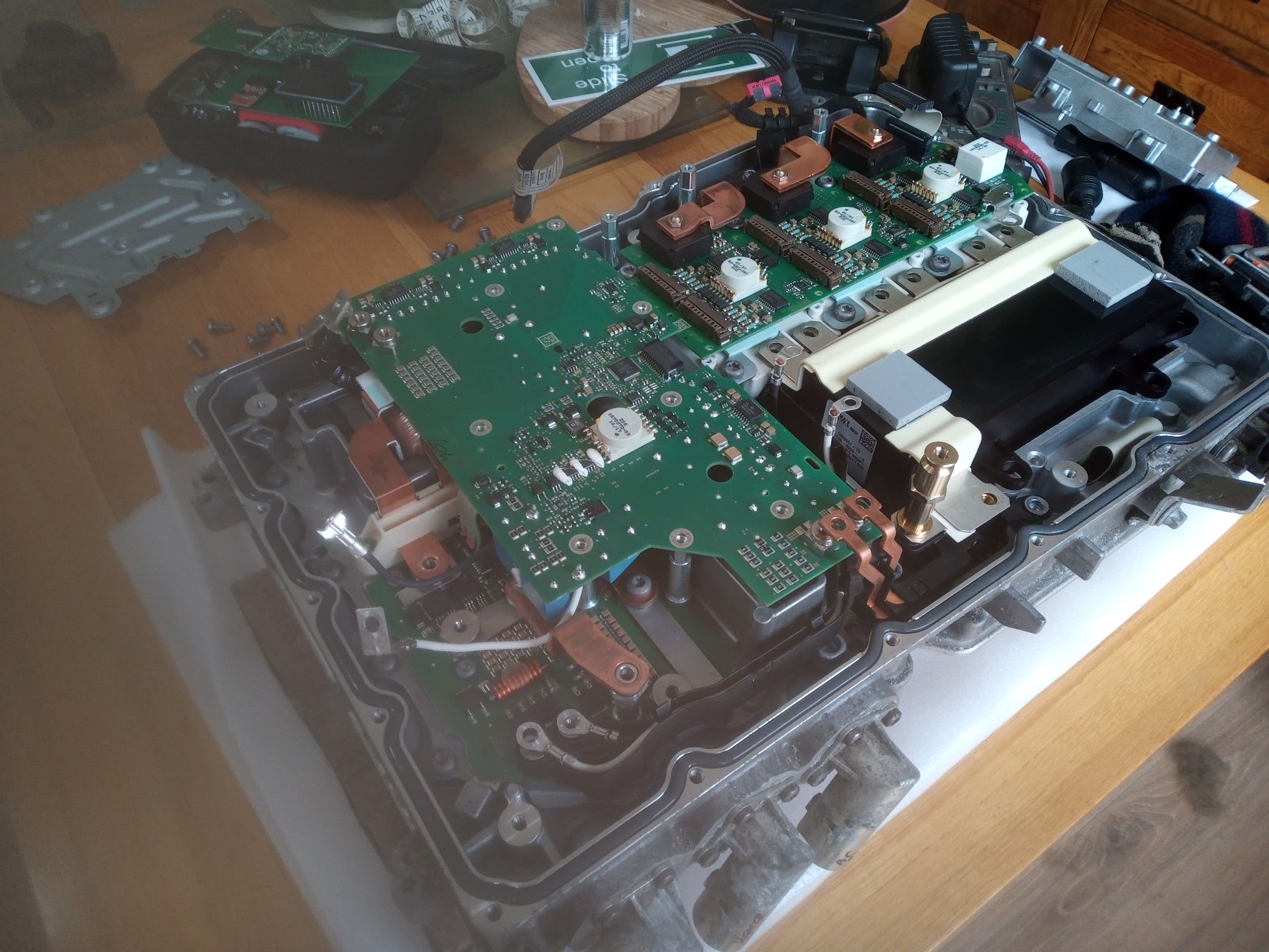

Re: i3 controller hacking from diyelectriccar.com
Wow!
How did you guys get the dc-dc converter out?
It looks like I'm going to have to go in from the other side to get to the bolt beneath the capacitor

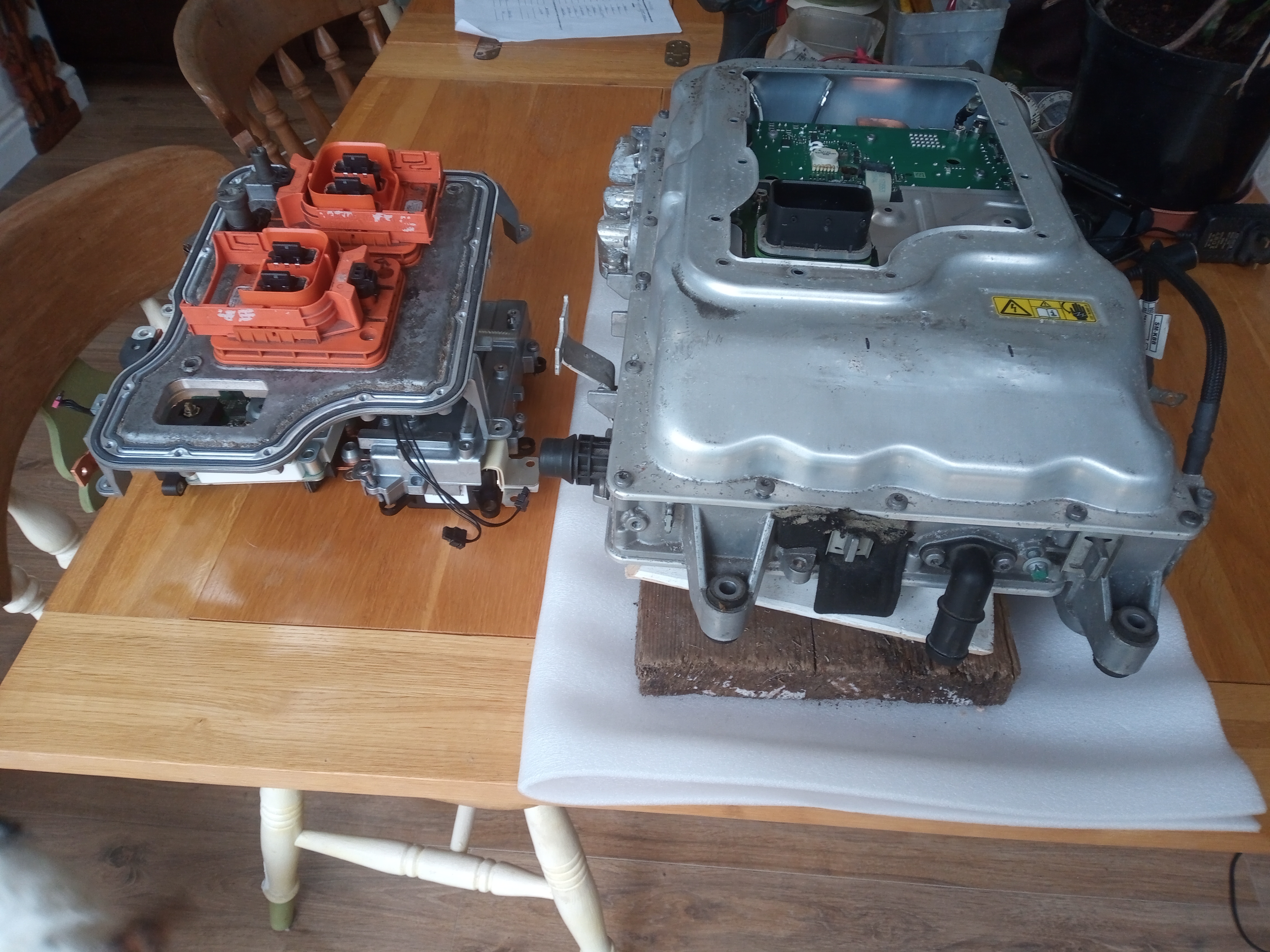

So I've been having a bit of a think and due to the size of the mIni engine bay I am thinking of separating out the inverter parts from the inverter casing and finding something more suitable to house them. I'll probably then go for a separate dc-dc converter and charger in the back of the car.
That sounds very sane. The chances of that DC-DC converter and charger getting hacked are minimal

Just popped a new vid up on my channel for anyone that hasn't stripped their EME yet.
Restoring and converting a Classic Mini, I have mad ideas, semi sensible ideas and NO idea if I’ll ever get it done
- EV_Builder
- Posts: 1205
- Location: The Netherlands
- Been thanked: 37 times
Just saw it and will comment the same here. Why not cut it up and close with alloy sheet. I think it will be TIG weldable.
If you want to explore the option check the housing for the alloy markings.

With this in mind what is the plan for the HV filter?EV_Builder wrote: ↑Sun Mar 20, 2022 8:45 pm Just saw it and will comment the same here. Why not cut it up and close with alloy sheet. I think it will be TIG weldable.
Is the HV filter needed?
How is the top plate going to line up and connect to the bottom plate?
Can you post pictures?
The top plate will be cut to. So its matching part can be reused then.
Maybe best way forward is by cutting out a piece of the case.
Then you get (ideally) one weld to make in both parts and they fit again.
If you post pictures it would help.
Import step is knowing if the alloy is weldable. Is there are marking on it? like AlSiMnMg etc.?
Second step is: build everything in the case what needs to stay there and take out whats not needed. Same for the top plate.
Third step: Cirgury; Mark where to cut and measure if the side wall piece would fit (welding) the casing again.
Fourth step: check the car for room of the dimension ed part;
Fifth step: do the cutting and welding and cleaning up of the welds.

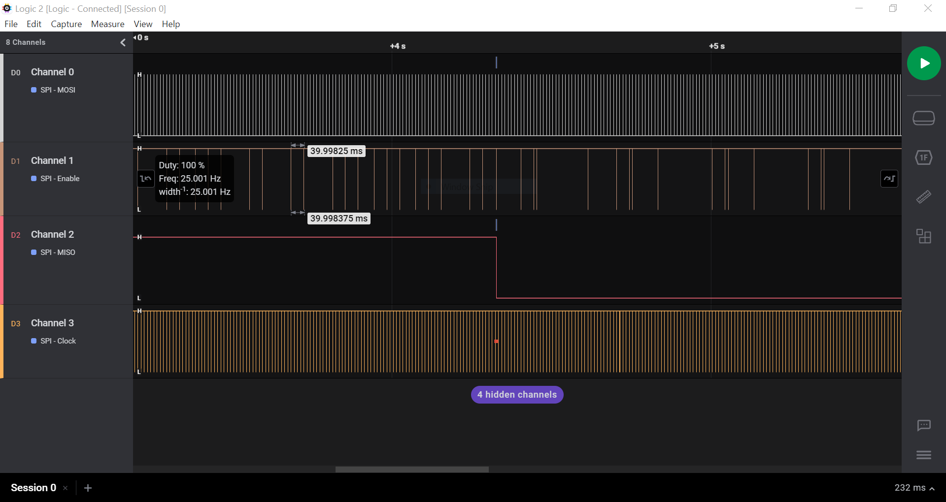

Hello all,
Been a while since I was last here, I haven't made significant progress myself. However, I seem to be chasing an issue where I have no bus voltage sense comms on my board. Has anyone else got to the point where they have an inverter operational and where they could check that the board is reading voltages? I don't believe the issue is the SPI bus, as I can communicate to the inverter via the ESP WiFi comms just fine. If everyone else is getting bus voltage fine then I might have to start digging on my own gatedrive PCB... This is the only thing stopping me from getting a motor spinning at this point!
I can recommend the SimpBMS for this, I have had one running the comms to the BMW i3 cell monitoring units already. Tom's code is solid and just works out of the box when programmed to talk to the i3 modules. Just don't forget the CAN Transceiver between SimpBMS and modules like I did!!!
- EV_Builder
- Posts: 1205
SPI is a separate thing as ESP / serial comms.MrX wrote: ↑Mon Apr 25, 2022 12:13 pm Hello all,
So I would start with measurements on the PCB.
From Chip to BMW part.
- Been thanked: 1913 times
Also, did you check the solder jumper? viewtopic.php?p=36365#p36365
Yep, solder jumper checked. Just in case this helps at all Johannes, I have confirmed 32V reg, and I’m supplying 30V to the DC bus. It seems to have around 1W of consumption on the DC bus side, I’m guessing from the isolated gate drive power.johu wrote: ↑Mon Apr 25, 2022 4:55 pm Also, did you check the solder jumper? viewtopic.php?p=36365#p36365
Going to get a logic analyser from my mate and see what’s going on…
Well that's strange. MOSI and *CLK cycling together, with no data. Garbage on SCK, and nothing on MISO. I'm also only seeing pulses at 1kHz intervals, so I suspect I need to get an oscilloscope on the thing.
Note there is one transition on MISO, which is when I turn on 30V to the DC bus to power the isolated side.
