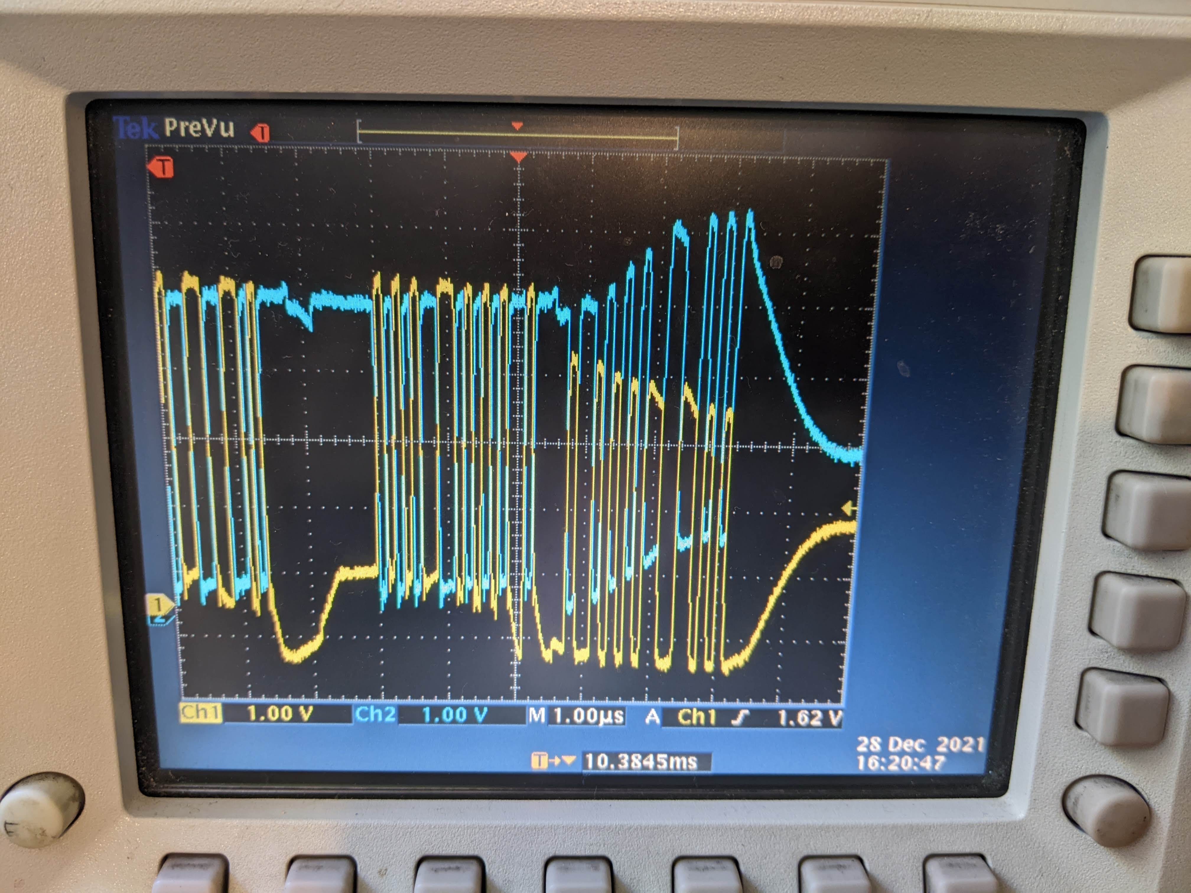

Waveforms as promised. Here's a capture of a multi-byte transmission followed by a single byte reception as seen at the differential receiver. The second capture is a close up of a received byte. The transforrmer is definitely making the pull resistors a lot more impactful, almost to the point where at the end of the byte the differential voltage is pretty small.

catphish wrote: Sat Jul 09, 2022 12:24 pm Waveforms as promised. Here's a capture of a multi-byte transmission followed by a single byte reception as seen at the differential receiver. The second capture is a close up of a received byte. The transforrmer is definitely making the pull resistors a lot more impactful, almost to the point where at the end of the byte the differential voltage is pretty small.
Curious what it's like at the far end, with the smaller capacitors it could be worse.

Pete9008 wrote: Sat Jul 09, 2022 12:35 pm Curious what it's like at the far end, with the smaller capacitors it could be worse.
It actually seems that a lot of this was my scope. Switched to 10x scope probe and the waveform looks somewhat different (notice 2V rather than 1V scale), and with twice as much differential voltage. 2V isn't nearly the desirable 10V but good enough for communication to work reliably it seems.

Re: New BMS for bq76PL455A based batteries
Posted: Sat Jul 09, 2022 1:00 pm
by Pete9008
Well spotted. Much better!
Can't see a good reason why it would be better on the battery side though??
I try to never use 1x on a scope probe. Generally the only time I ever switch mine to 1x is if I'm using them backwards to feed a signal in from a sig gen (not recommended practise but often convenient!). Too much capacitance, you get the scope input capacitance, plus the lead capacitance, plus the probe capacitance, it can be as much as 100pF on a cheap probe - it can do a lot of damage on a high frequency high impedance signal!
Edit - just worked it out ~800R impedance on a 2MHz signal!

Pete9008 wrote: Sat Jul 09, 2022 1:00 pm Well spotted. Much better!
My probes are certainly cheap, and when I was testing previously, lots of configurations didn't work at all when probes were connected.
Just made up the inline boards. They seem pretty secure. I'll coat the back in hot glue then heatstrink. Hopefully the cables still reach!
