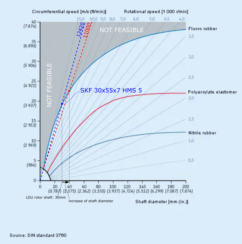

You had a question previously following your conversation with a seal supplier - I was just trying to help.

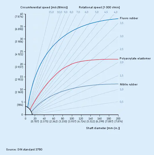

A 30mm seal at;
10,000 rpm has a surface speed of 15.7m/s
15,000 rpm has a surface speed of 23.5m/s
18,000 rpm has a surface speed of 28.3m/s
Limit the LDU to 10k and just looking at m/s it looks like a good Fluoro rubber seal is suitable.
However it gets more 'complicated' as I would think 1,2 & 4 conditions below also apply to the LDU;
The values obtained from the diagram 4 should be reduced if:
1; radial shaft seals with an auxiliary, contacting lip are used
2; lubrication is inadequate or grease lubrication is used, i.e. when underlip temperatures increase due to poor heat dissipation
3; the counterface does not meet surface finish or running accuracy requirements
4; there is a pressure differential across the seal
from here:
https://www.skf.com/group/products/indu ... ble-speeds

@SuperV8: Thanks for that graph!
Increase of the shaft diameter is probably not a solution in this case. Here's why: Start with the requirement that the LDU must sustain a continuous maximum speed of for example 100 mph (161 km/h). This corresponds to 11479 RPM, given an assumed tire diameter of 724mm and a given fixed LDU gear box reduction factor of 9.73. The graph below shows that at a given shaft diameter of 30mm, a fluoro rubber seal results in a maximum of 12420 RPM* (blue dashed line), so the 100 mph requirement is satisfied. Next, the graph shows that an increase of the shaft diameter to 40mm results in a reduction of the maximum RPM value from 12420 to ~11000 (red dashed line), so now the requirement is not met anymore. Also the addition of a sleeve introduces a thermal contact resistance between shaft and sleeve, which would lower thermal conductivity in shaft radial direction, which is not what you want.
*assuming oil or grease lubricant, which we do not have; equals the spec of HMS 5 seal
Disclaimer: Despite all efforts, all (which I write) should be conservatively interpreted as a poorly informed, error-prone, non-expert opinion that is subject to continuous change, especially in this age of hyper-specialization and newly gained insights.

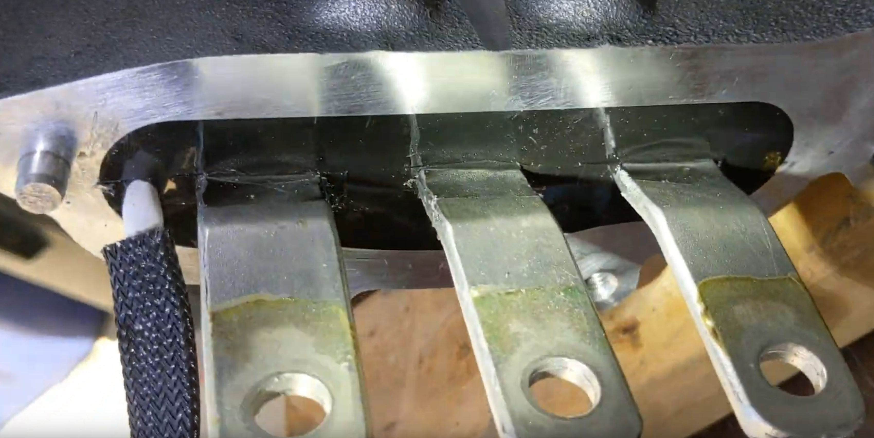

There are several layers of defence we can apply to the overall coolant leak issue. Replacing the seal et al will (usually, supposedly, temporarily?) stop coolant ingress. Great, problem solved . . . for now.
Based on historic trends, we're making a reasonable assumption that the rotor seal will leak again. We can put in place protective measures to slow the damage caused by a repeat incident.
I think that the mods that Johan performed on his repair are fine, and I like that he walked us through his assumptions and reasoning. Most of the screengrabs below are from one of his excellent YT vids on this topic.
Possible defensive measures that could be incorporated into a seal repair process include:
1) Seal off the rotor side from the inverter side.

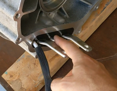

Alex @ QCP says that he installs a silicone gasket there to replace a paper gasket (not clear to me what that means) and then uses Form-A-Gasket (a Permatex-branded RTV [Room Temperature Vulcanize] silicone-based sealant), to fill that cavity. I think RTV would work as well as Johan's two-part potting compound, though it might not look quite as nice ;)
The separate 4-wire bundle needs its own, separate application of sealant as well, I think.

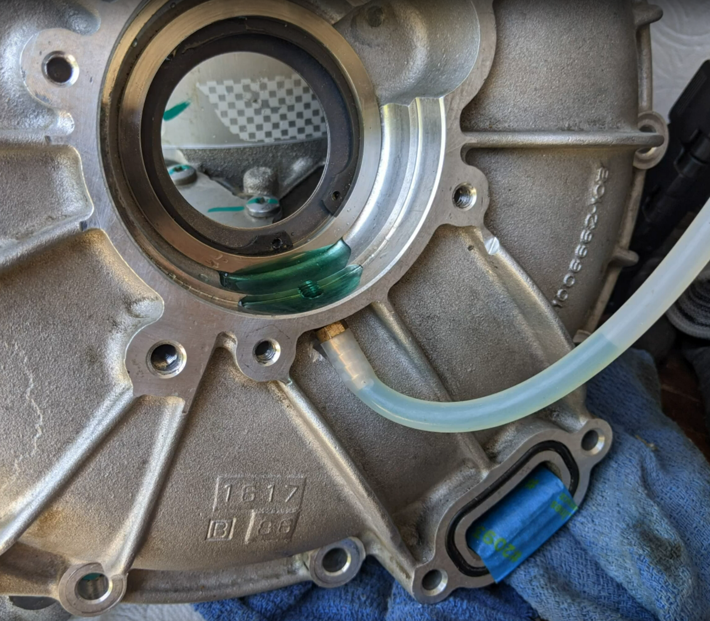

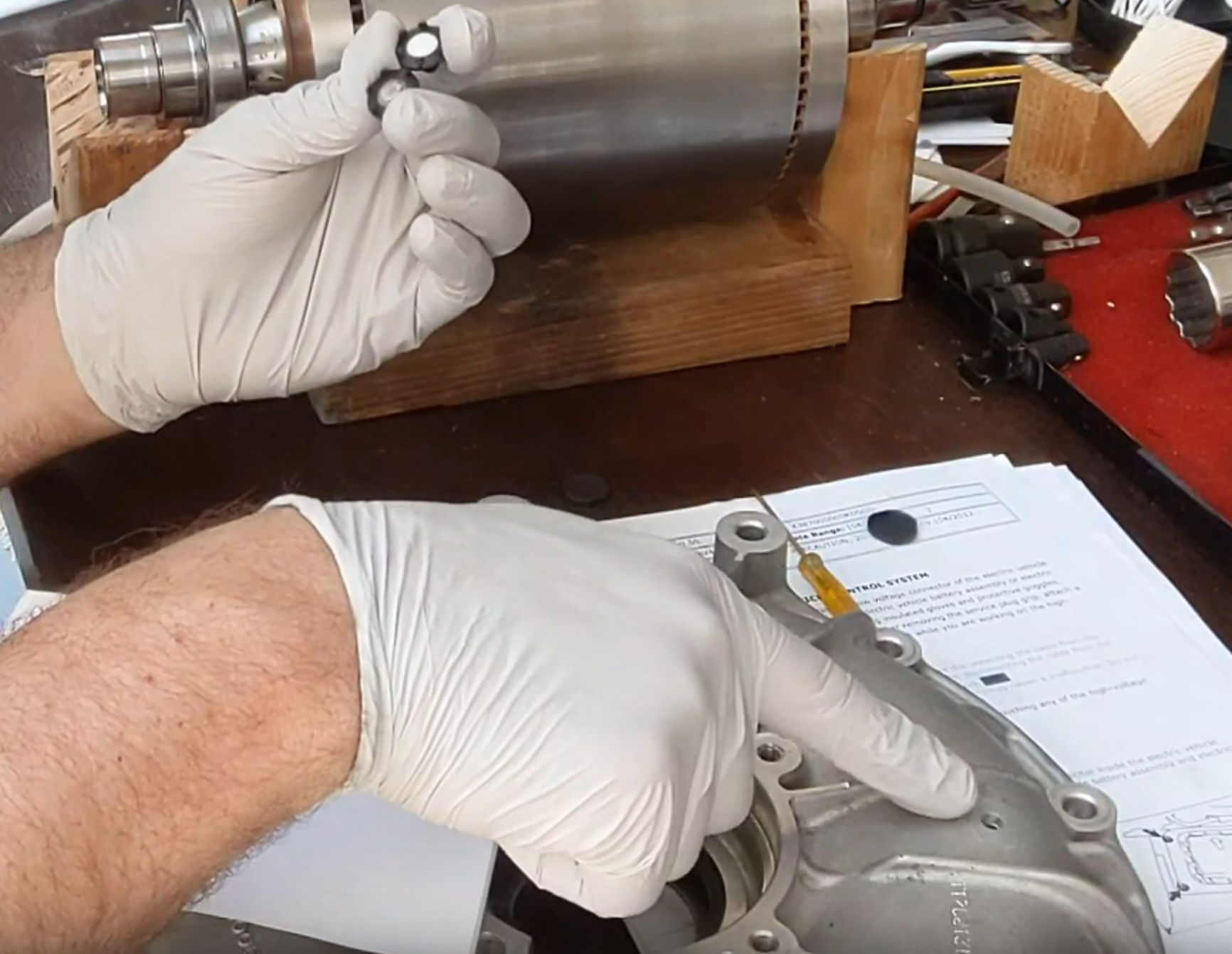

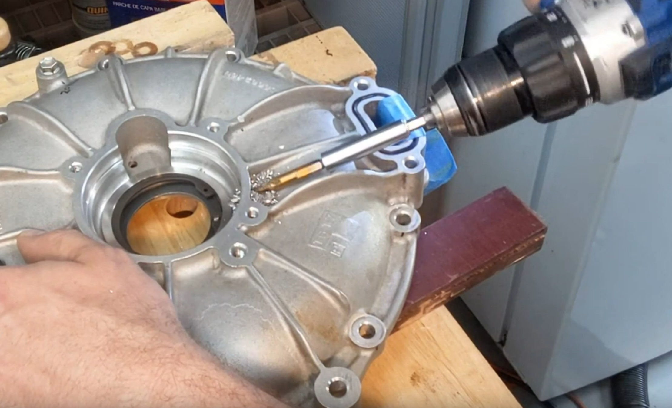

2) Create a weep hole under the seal, to dump overboard seal leakage right at the first leak point.
Funny, back in the day, every automotive water pump had a weep hole between the coolant seal and the pump shaft bearing.
On the Tesla LDU, installing a weep hole is a well-trod path that others have done successfully. Drain line or not -- and if so, the type of fitting -- are a preference/optional item, but just providing a safer place for leakage to exit is a very good start:

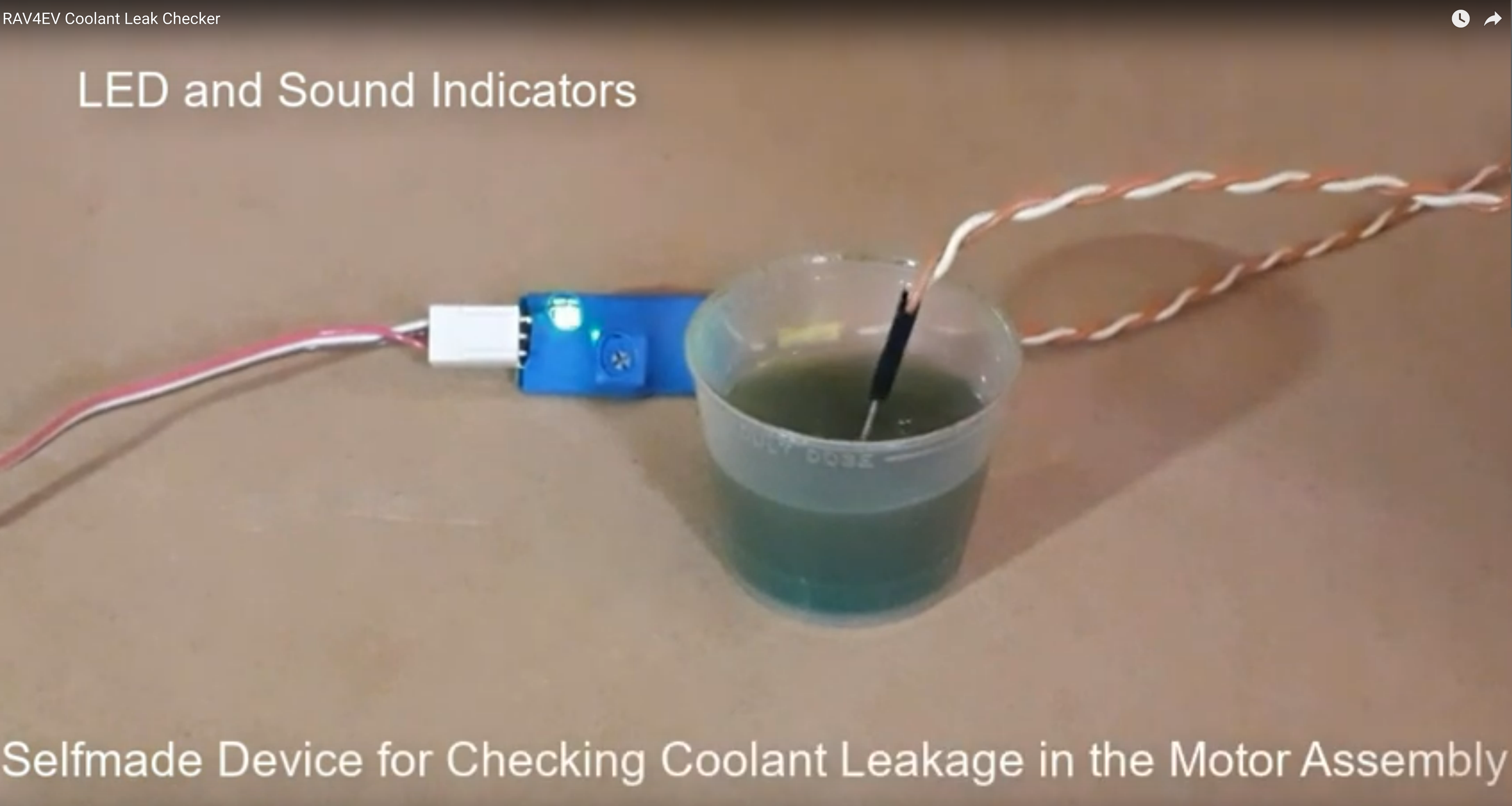

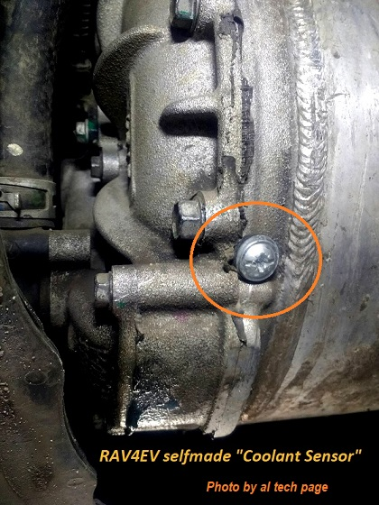

3) Create a weep hole/inspection hole/sensor hole in the bottom of the stator housing.

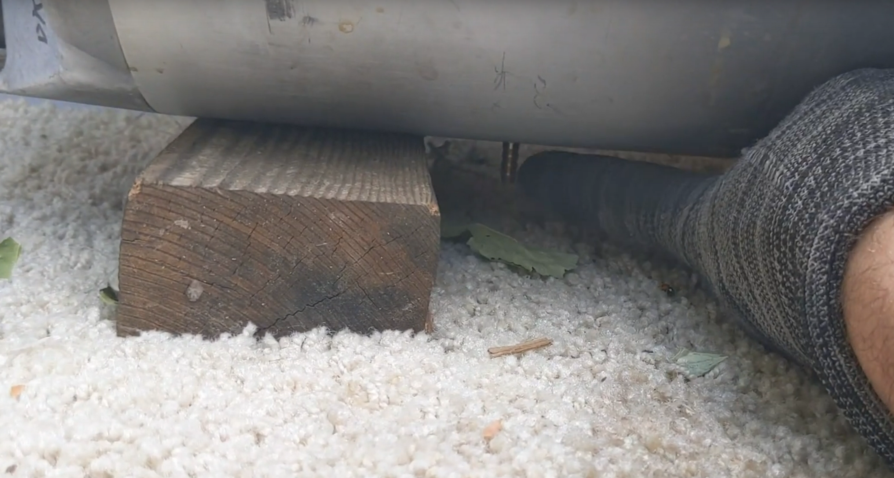

This is a hole at a low point in the rotor cavity, where a one-wire sensor can be installed in a eg 5mm hole, to provide an in-car warning annunciator (light, buzzer, SMS msg, etc.); or, it can be used as an additional drain point.
AFAIK, this was the first documented drain location/method for an LDU.
https://www.myrav4ev.com/forum/viewtopi ... 419#p29419
https://www.youtube.com/watch?v=ps2gha4w5YE[url]

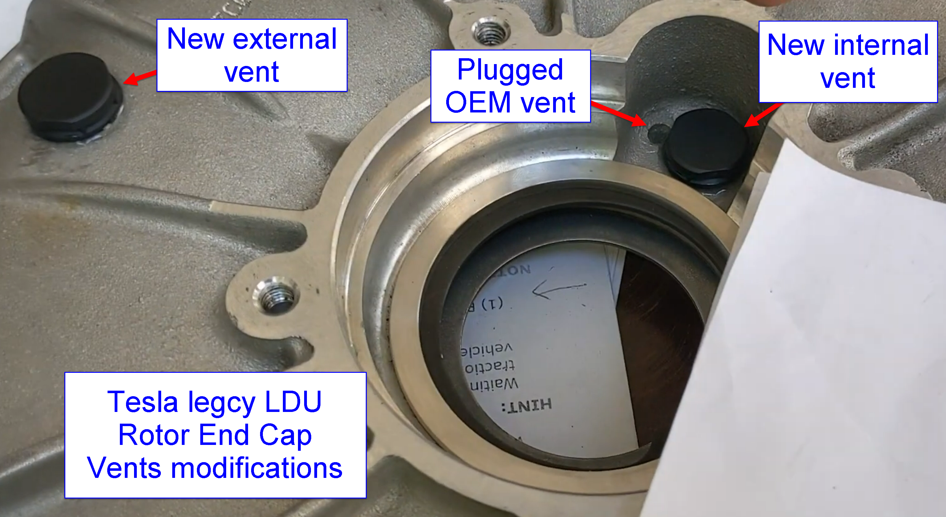

4) Seal the existing vent balance hole on the rotor end support (between reluctor chamber and rotor cavity), and install a second external vent, Toyota 33197-0R010 (USD$8 ea.). Aerosolized coolant that being whipped about by the reluctor is thus slowed from moving through the OEM vent hole to the rotor cavity, giving it time to find its way to the weep hole that was installed:
5) Add a third external vent to rotor end support, between rotor cavity and outside:

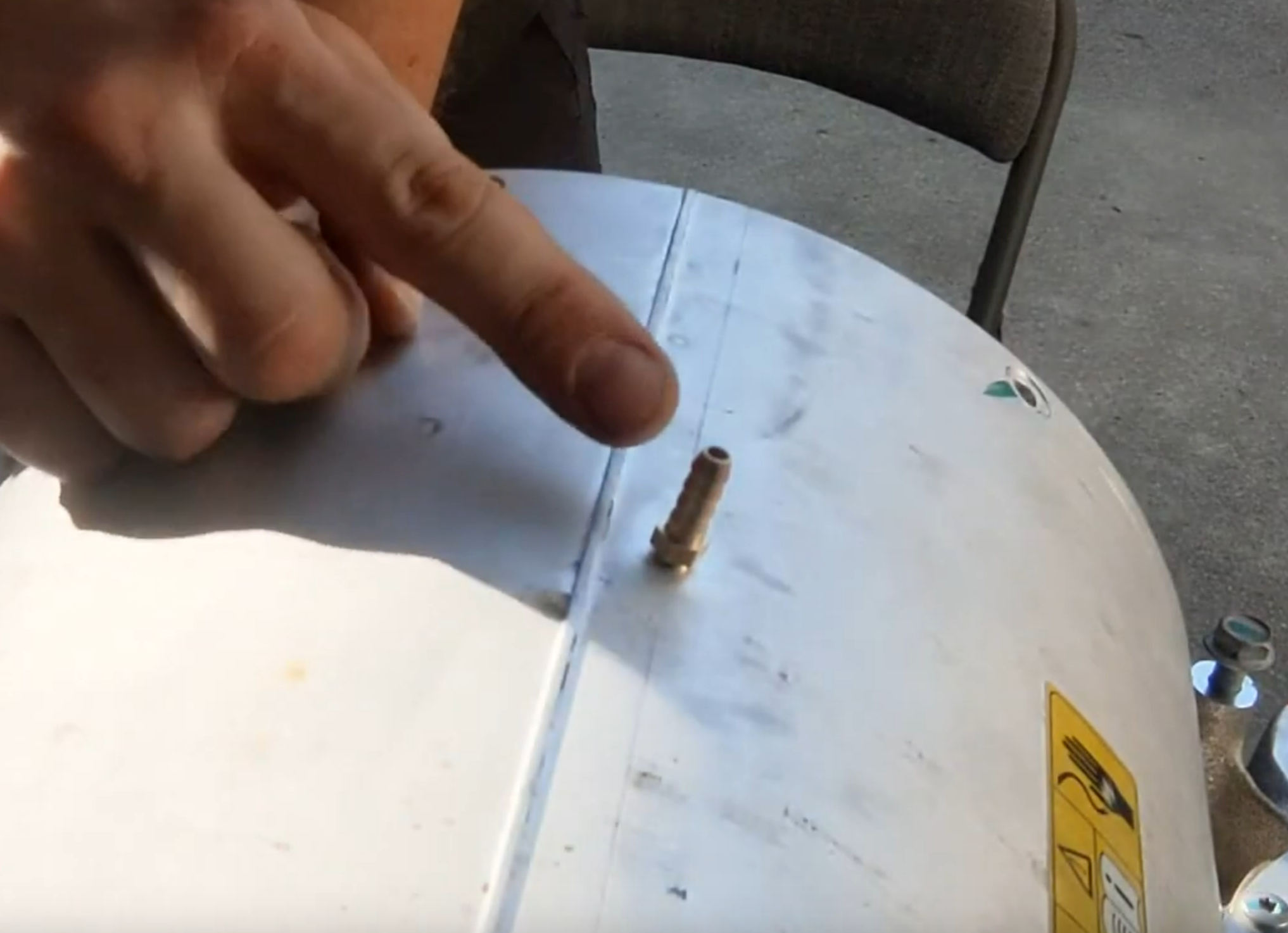

6) Add an inverter-side drain.
I'm of two minds on inverter drains.
QCP is selling their "drain kit" that taps the inverter side. But, I've read no evidence that coolant leaks have ever started on the inverter side, but there seems to be at least one instance where the gearbox lubricant escaped to the inverter. So, while I'm not particularly worried about monitoring the inverter side for coolant, coolant in the inverter isn't the only thing that needs external validation ;)

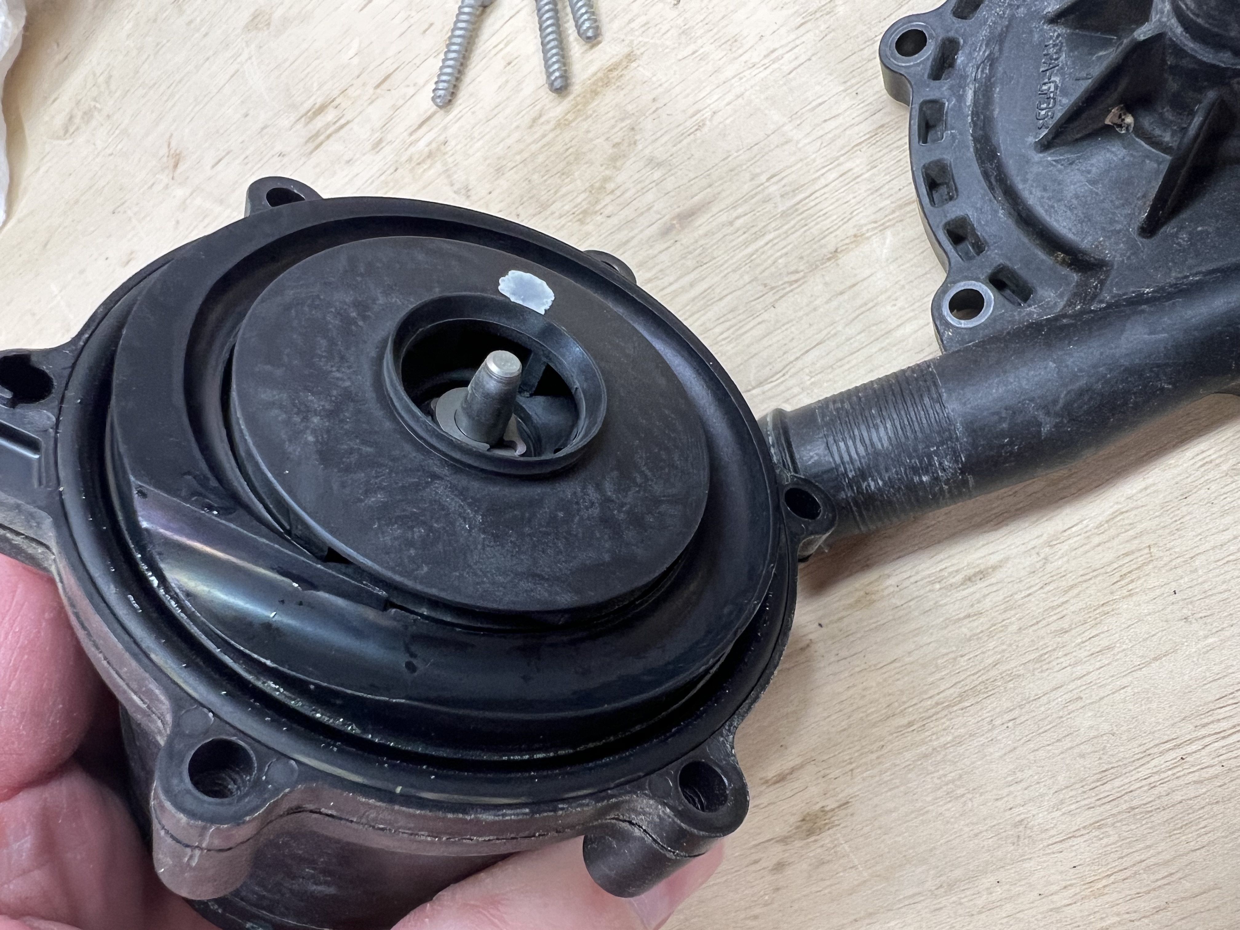

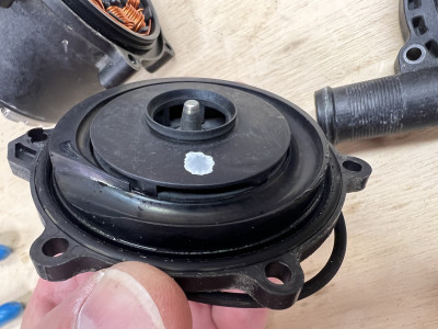

I ordered a single gallon of Evans waterless coolant, which will arrive early next week. The PWM doo-dad will arrive . . . today, Amazon says . . . [goes out and checks mailbox] . . . yup, got it.
I wonder where I put that Tesla coolant pump . . . found it, in the "RAV4 EV" tote.
[Unscrews cover]
Ugh. I should have pulled the impeller cover off before: the impeller is hard plastic, no chance of this being adversely affected by high-viscosity coolant.

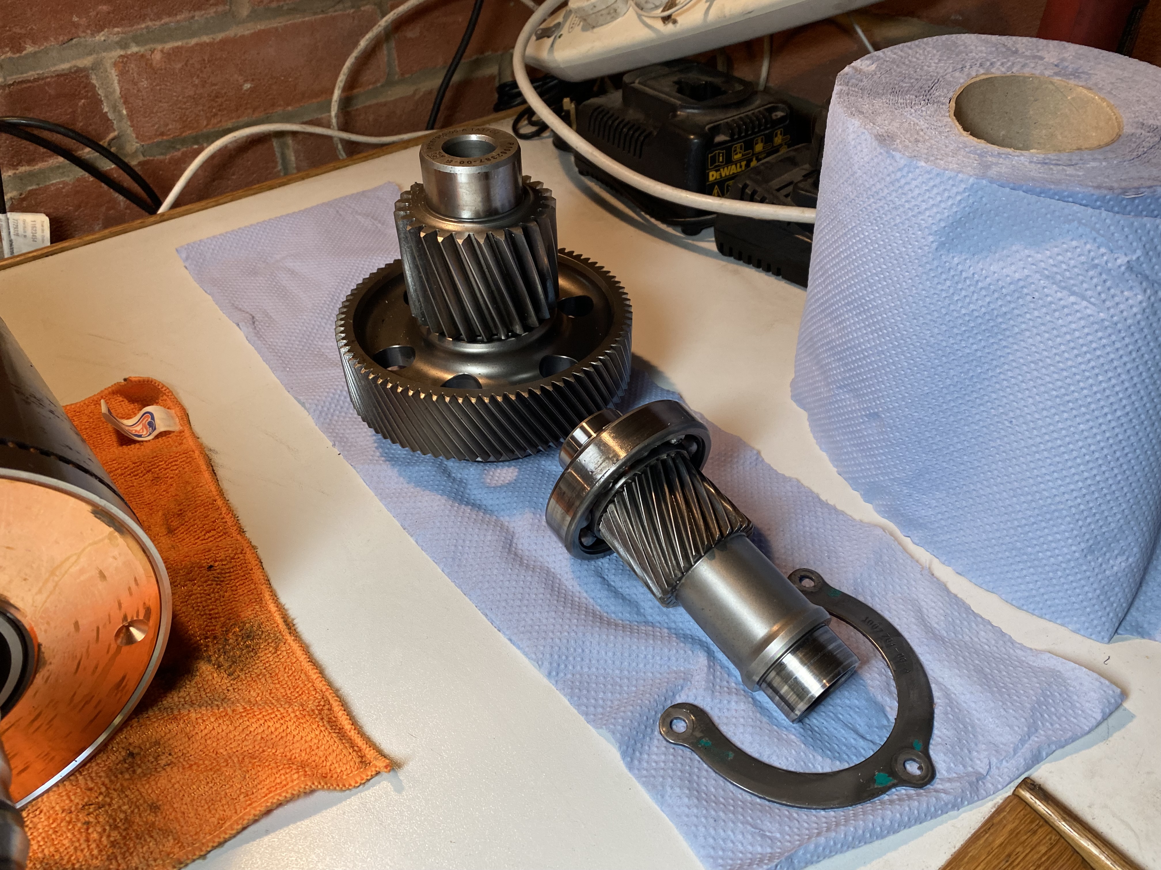

howardc64 wrote: Wed Sep 21, 2022 6:40 pm This gearbox has 10:1 ratio. Starting with high RPM motor all the way to driving the half shafts. Its a wide range to trade off efficiency (thinner ATF) to high wear protection (multi weight gear oil for rear diffs such as 80w-90) LDU also has no damper for the applied torque (ICE's gradual torque curve, torque converter/clutch/clutch packs) Tesla went with thin ATF for efficiency on a 10x ratio gear box. Seems like less wear protection is the required tradeoff.
For reference, FWD ICE automatics are usually 0.5+ to 3-4x ratio and motor RPM at 1/2 to 1/3 of Tesla LDU at highway speeds. Much less aggressive ratio to use ATF. Some automatic gear boxes use thick multi weight gear oil for final diff gears (which change speeds at every turn)
I think this suggest a higher gearbox oil change frequency. Since its only 1.5 qt of Dex6 ATF and there is ample mud at 32k on my reman RevQ. Probably worth changing it annually along with speed sensor and inverter B+ B- port checks for coolant leaks. However, the big magnet next to oil pickup tube captures so much mud that ATF change probably doesn't get any of that out. Only cracking open the gearbox can do that.
Not sure I understand your point here regarding ratios?
The Tesla 9.7344:1 gear reduction is total gear reduction including differential reduction gear ratio.
The 3-4:1 you mention for the ICE auto transmission is NOT including any final drive gear reduction. Many ICE drivetrains can have 10-15:1 total gear reduction in the 1st & 2nd gears.
ATF is/can be a very high quality oil - generally much more expensive than any MTF made from better quality oil base stocks.
