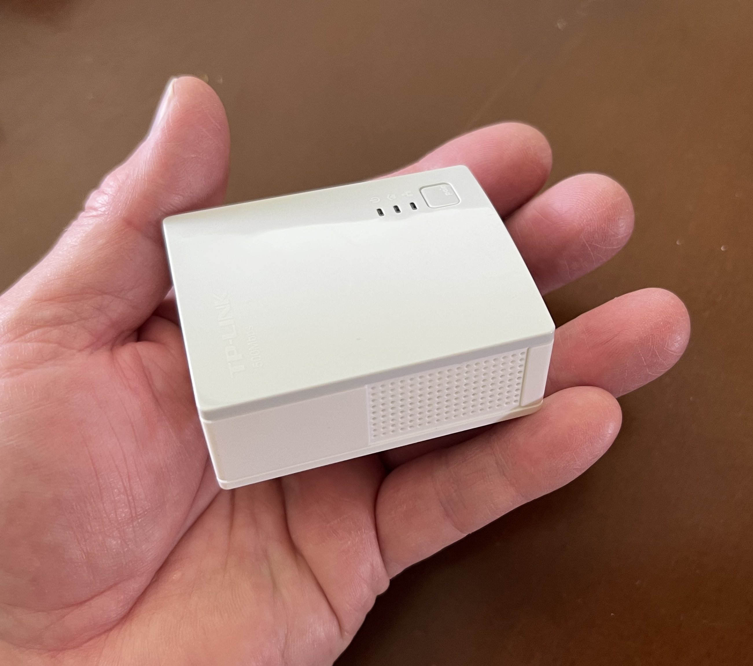

by asavage
USD$12, eBay, 8 days to arrive . . .
TL-PA4010 (without passthrough)
For a while, a couple of careers ago, I used to repair laptops for a living, but this thing does not disassemble gracefully. I leaned on it hard.

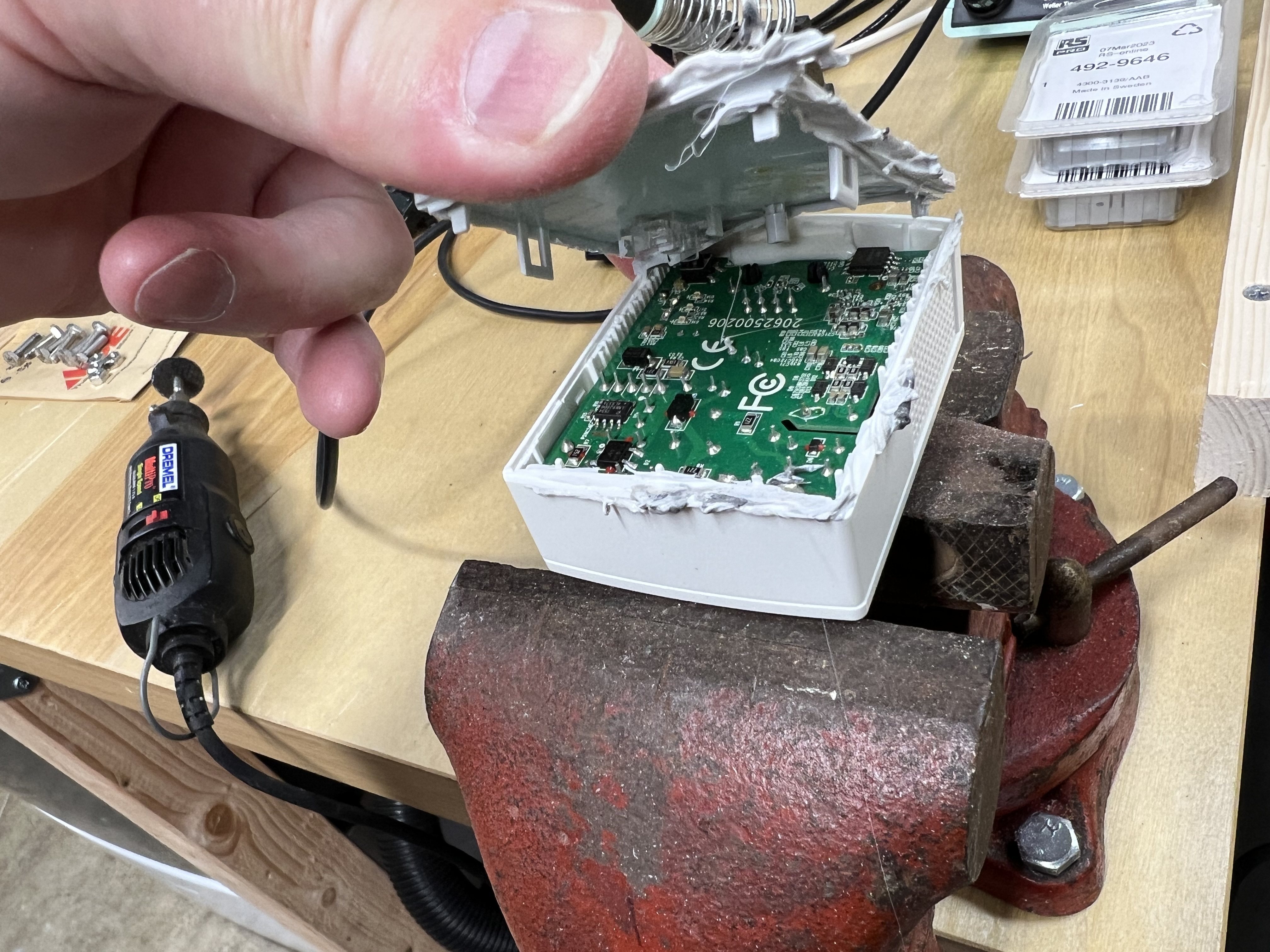

Well, in my other careers, I found few things can't be opened up by a judicious application of a Dremel (carbide burr, or #426 reinforced fibreglas cutoff wheel on a 420 mandrel). I sliced a couple of inches around a corner, very shallow, then pried a bit back . . .
That revealed where I had room for more slicing . . .

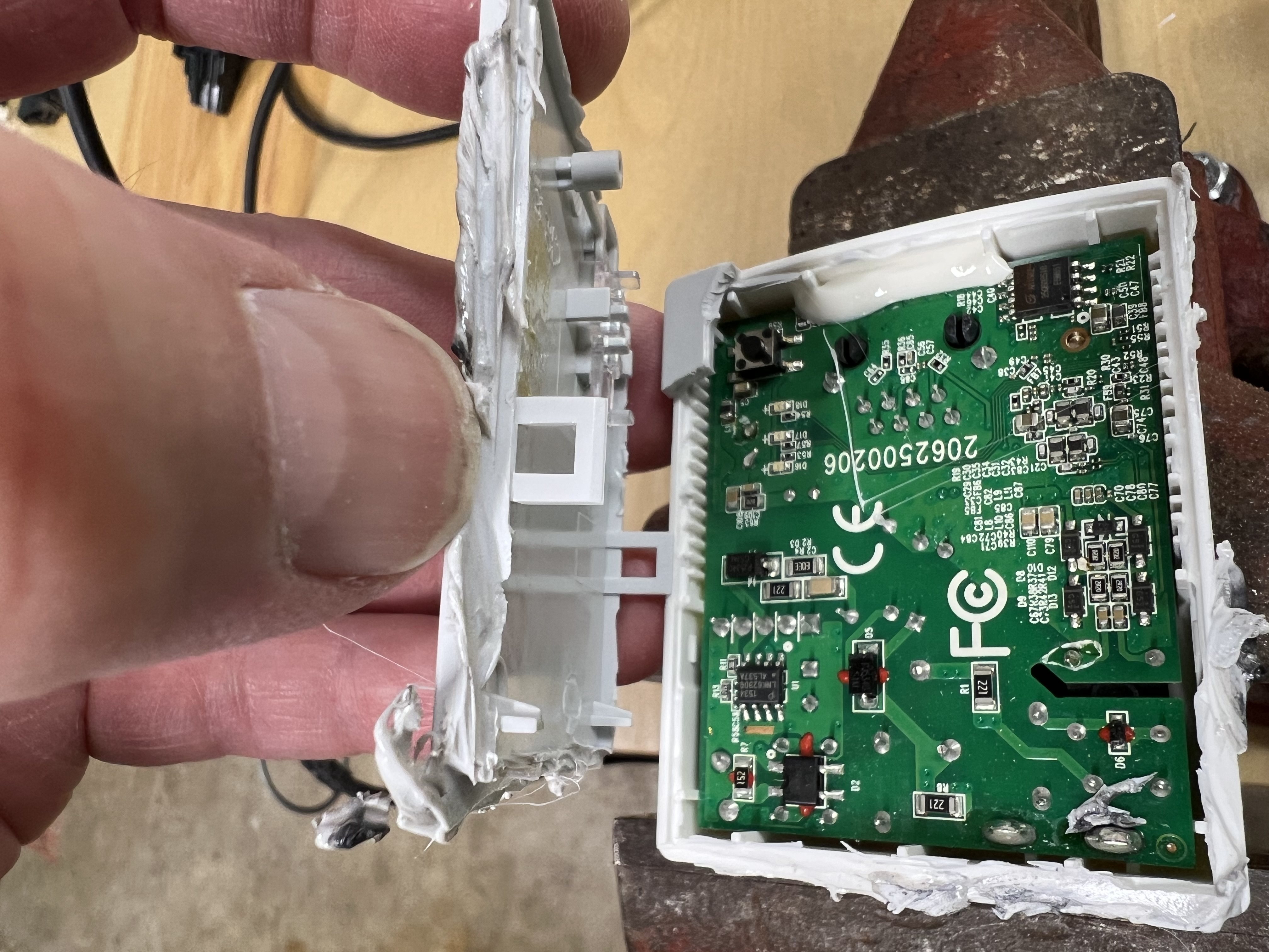

There are cover catches, but I could not flex the sides enough to disengage them. I display these pics in case one of you wants to try to do better than I.

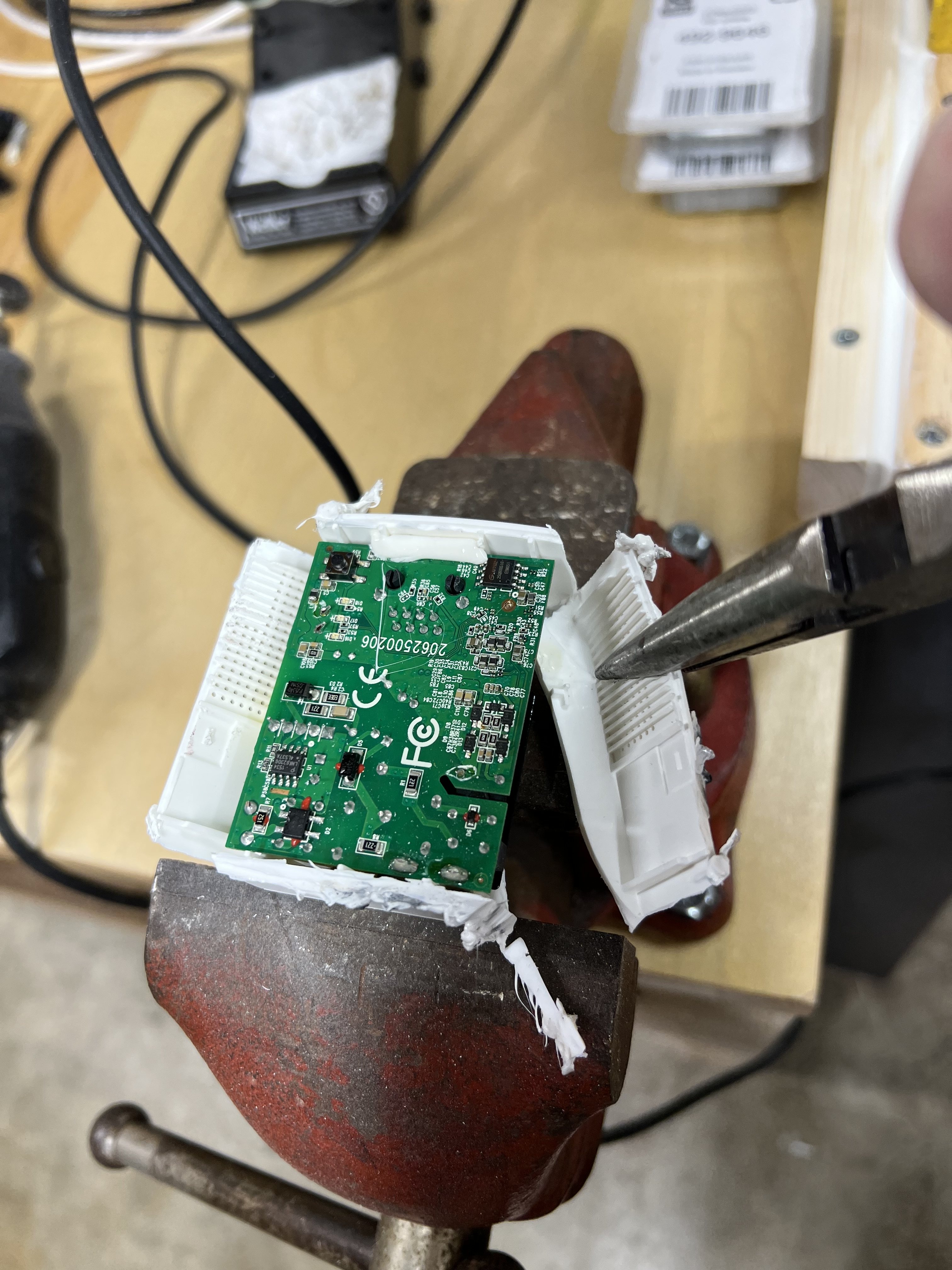

Dislodge a bit of glue . . .
Slice off the corners, then break off the sides . . .
