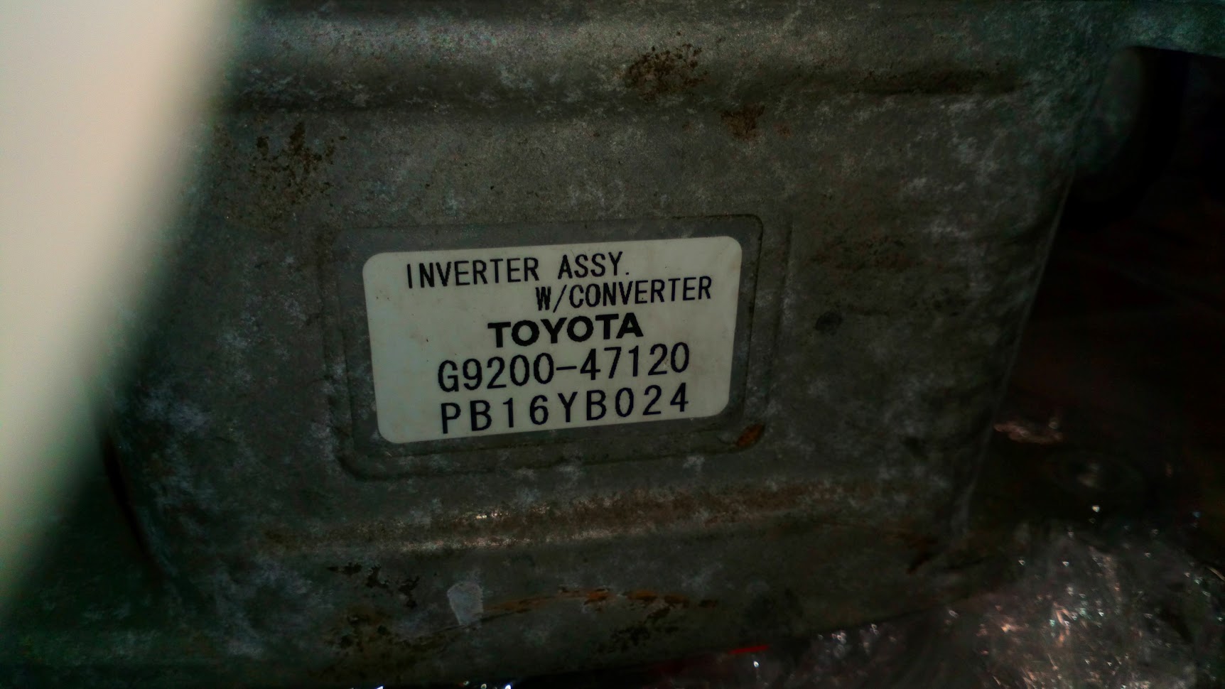

Alexstarex wrote: Sat Jan 25, 2020 10:45 pmin the picture is 1st generation. Need an inverter 2 generation
Hmm. It matches my picture of a Gen 2, not a Gen 1. But I'm far from knowledgeable about all models sold and what years:

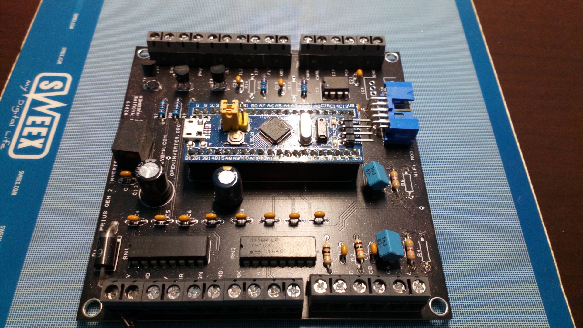

Design of prius Gen3 board as well as Main board V3 utilises STM32F103RBT6 chip, vhich uses P$54(PD2) pin as out for resolver exciter.
And then signal from resolver goes in thrue pins P$22(PA6) and P$23(PA7).
Bluepill equipped with STM32F103C8T6 chip that has got no P$54(PD2).
Is it possible to utilise any of its free pins as exc_out, or I need separate board, like a crop out of gen 3 one, to simulate signal for resolver?
Or maybe Main Board V3 capable of handle prius inverter? I'm not an electronics engineer or hobbyist, I'm mechanics engineer and building my DIY electric car from scratch and looking for a cheapiest way possible=)
I believe software for gen2 also need to be changed for resolver input?
Been thanked: 1914 times
Re: Toyota Prius Gen 2 Inverter Controller
The V3 main board is so generic that it supports any inverter 8-)
Seriously, all you need to do is make a little adapter board that passes the 3 high-side PWM signals through a ULN2003 or discrete transistors. If you so wish you can also level shift the current sensor signals to 0-3.3V and pass the remaining IO signals to a meaningful outside-world connector. Actually an adapter board is on my todo list.
The firmware also detects when it's running on a Blue Pill and re-assigns the pins like so: viewtopic.php?f=3&t=220&start=20#p2623
But given the cheap assembly option I don't think there is much future need for the Blue Pill.

I have a Blue Pill set up on breadboard as a minimum system. First of all I had it communicating via USB-TTL to a terminal, but I couldn't get the PWM active. Looking for the various pin statuses was tedious via the terminal, so I set up a D1 mini and added a wireless adaptor to my PC.
For the last couple of days I've been chasing errors on mprot & emcystop. No matter what state I tied PB12 to, the web interface seemed to indicate a floating input. After scratching my head for a while, I went to the source code and found the pin definitions.
#define DIG_IO_BLUEPILL \
DIG_IO_ENTRY(brake_in, GPIOB, GPIO9, PinMode::INPUT_FLT) \
DIG_IO_ENTRY(rev_in, GPIOB, GPIO8, PinMode::INPUT_FLT) \
DIG_IO_ENTRY(fwd_in, GPIOB, GPIO7, PinMode::INPUT_FLT) \
DIG_IO_ENTRY(start_in, GPIOB, GPIO6, PinMode::INPUT_FLT) \
DIG_IO_ENTRY(cruise_in, GPIOB, GPIO5, PinMode::INPUT_FLT) \
DIG_IO_ENTRY(mprot_in, GPIOB, GPIO1, PinMode::INPUT_FLT) \
DIG_IO_ENTRY(emcystop_in, GPIOB, GPIO1, PinMode::INPUT_FLT) \
DIG_IO_ENTRY(bk_in, GPIOB, GPIO12, PinMode::INPUT_PU) \
DIG_IO_ENTRY(bms_in, GPIOD, GPIO15, PinMode::INPUT_FLT) /* non-existant */ \
DIG_IO_ENTRY(ocur_in, GPIOD, GPIO15, PinMode::INPUT_FLT) /* non-existant */ \
DIG_IO_ENTRY(desat_in, GPIOD, GPIO15, PinMode::INPUT_FLT) /* non-existant */ \
DIG_IO_ENTRY(dcsw_out, GPIOC, GPIO15, PinMode::OUTPUT) \
DIG_IO_ENTRY(vtg_out, GPIOD, GPIO14, PinMode::OUTPUT) /* non-existant */ \
DIG_IO_ENTRY(prec_out, GPIOB, GPIO4, PinMode::OUTPUT) \
DIG_IO_ENTRY(led_out, GPIOC, GPIO13, PinMode::OUTPUT) \
DIG_IO_ENTRY(err_out, GPIOD, GPIO14, PinMode::OUTPUT) /* non-existant */ \
DIG_IO_ENTRY(temp0_out, GPIOD, GPIO14, PinMode::OUTPUT) /* non-existant */ \
DIG_IO_ENTRY(speed_out, GPIOD, GPIO14, PinMode::OUTPUT) /* non-existant */ \
DIG_IO_ENTRY(brk_out, GPIOD, GPIO14, PinMode::OUTPUT) /* non-existant */ \
This doesn't match up with Damien's schematic; Both mprot_in and emcystop_in are mapped to PB1 in the definitions, whilst Damien has the MG2 inverter fault line routed to PB12.
Tying PB1 to 3V3 got rid of the errors, which ties up with the definitions, but Damien has PB1 as the uaux (12v supply monitor).
With PB12 now unconnected, I was getting ocur errors, which is confusing since ocur_in is mapped to a non existent port on a Blue Pill. I've yet to delve far enough into the code to find out what bk_in is!

Bye bye Blue Pill.
No way to start PWM without tripping the overcurrent/brk-in on either of my two examples.
Swapped to a board with the higher pin count STM32F103RBC6; https://www.aliexpress.com/item/3263291 ... 4c4dm9lPyn
Now we're cooking with electrons!

So, youre saying, Damien's blue pill based board is "no go" for traction? Or it just me, who got it wrong?
SciroccoEV
Posts: 370
Location: Luton UK
Been thanked: 16 times
Post by SciroccoEV »
It's worth reading this thread; viewtopic.php?f=3&t=220
It looks like a workaround was found, but it definitely doesn't work on either of my boards. I had the other boards right from the start, but used the BP because it's easier to fit them on a breadboard.

It seems you didn't read the thread I referenced. I'll paste some relevant bits of it here.
Johu wrote:bk_in is on PB12 and it must be because it's the hardware break input of the timer. It seems there is a problem with it, Damien and me are currently investigating.
Johu wrote:Well, it would seem the Blue Pill has a little layout problem. So no matter if you set the break input active high or low it trips out as soon as the PWM runs, even though the break input is tied to ground or VCC, respectively. If the break function is disabled per timer register, all runs ok.
Now, I disabled the PWM1N output which is adjacent to the break input. Et voila: no trip.
There was a code version associated with the last post, which I assume was one that worked despite the board layout. It didn't work on mine, so I switched to the other board. All the boards are using STM branded uProcessors, but with the CHN marking showing the die was packaged by STATS ChipPAC Shanghai Co. Ltd.
Damien and Johu have effectively abandoned using these cheap development boards now that full SMD assembly is so cost effective direct from JLC-PCB. I still see some merit in using them; Damien's PCB didn't incorporate level shifters for the bipolar current sensor output of the Gen 2 intelligent power module, so |'m testing a circuit out on the breadboard.
The higher pin count board didn't cost that much more, but it has dual row headers, so it can't just be plugged into a breadboard. I now have a 'hairball' of flying leads from the dev board to the breadboard, but I do now have PWM and can do some further testing.
You could try installing a strong pull-up (say, 1k) directly at the STM32 pin for bk_in. Still agree the Blue Pill has many issues. I think the existing hardware out there can be made to work but reading all this I wouldn't base a new design on it.

johu wrote: Tue Mar 10, 2020 6:32 am You could try installing a strong pull-up (say, 1k) directly at the STM32 pin for bk_in. Still agree the Blue Pill has many issues. I think the existing hardware out there can be made to work but reading all this I wouldn't base a new design on it.
Connecting the pin directly to the power rail didn't make any difference!
Anyway, I have things working with the other board;
Neat, I'll need to copy that if I end up sticking with my Blue Pill board.

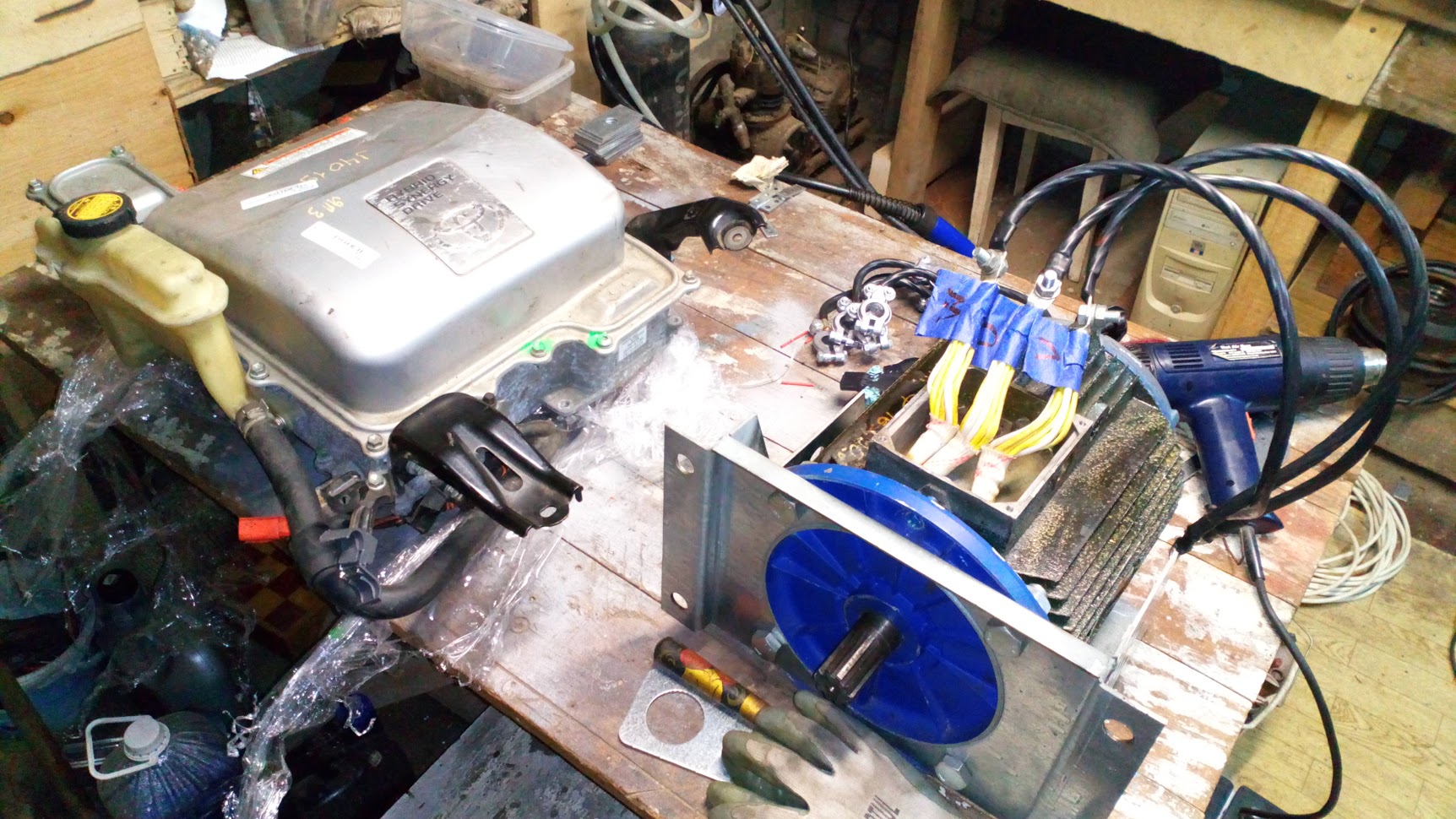

My board has arrived :D Thank you, Damien! Now just need to wait when contactors make it to Belarus, as they seems to stuck in Israel for over two weeks already...
