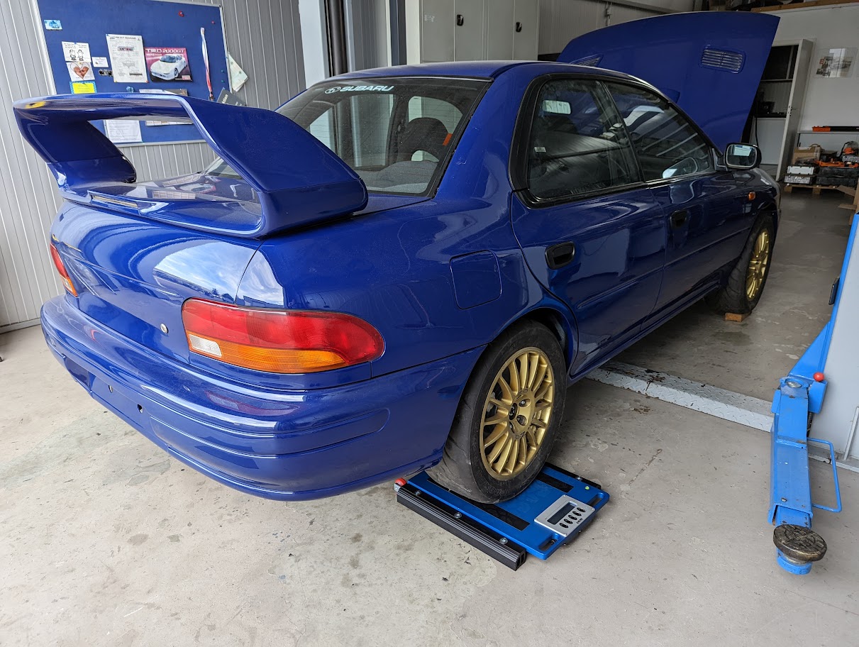

I weighed the car yesterday to know how much more weight i can put in the car, especially how much weight there is left for the battery cells and how to distribute the batteries.
The german TÜV calculates 75Kg for each person and 5Kg of luggage for each person. That means i have 5 seats in my papers, so it would be 5*80Kg = 400 Kg. The maximum legal weight for the car is 1750 Kg, according to its papers. so my maximum weight would be 1350 Kg. But i don't need the fifth seat, so i'm calculating 320Kg. That means my max weight would be 1430Kg. Actual weight without the batteries but everything else except the Tesla Charger is 999Kg. I'm very happy with that! The Subaru will be around 130Kg heavier then before though.
But the weight distribution seems to be a perfect 50/50 after the conversion, according to the calculations:
My friend is a self employed TÜV engineer who borrowed me these two very neat 3000€ expensive scales to weigh the car:
I then put the drive shafts in and filled oil in the gearbox
Re: Subaru e-mpreza (Impreza) 96 - AWD with 2 Outlander rear motors
Posted: Thu Sep 01, 2022 8:20 am
by Alibro
Great work on the cooling plates, they look totally professional.
For weighing my car I bought four sets of bathroom scales for £10 each, put a large plank across them and lowered the car on the plank weighing one corner at a time.
It was a bit more hassle and probably not as accurate but worked well enough.
