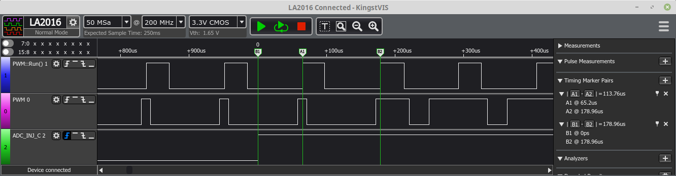

Post by Pete9008 »

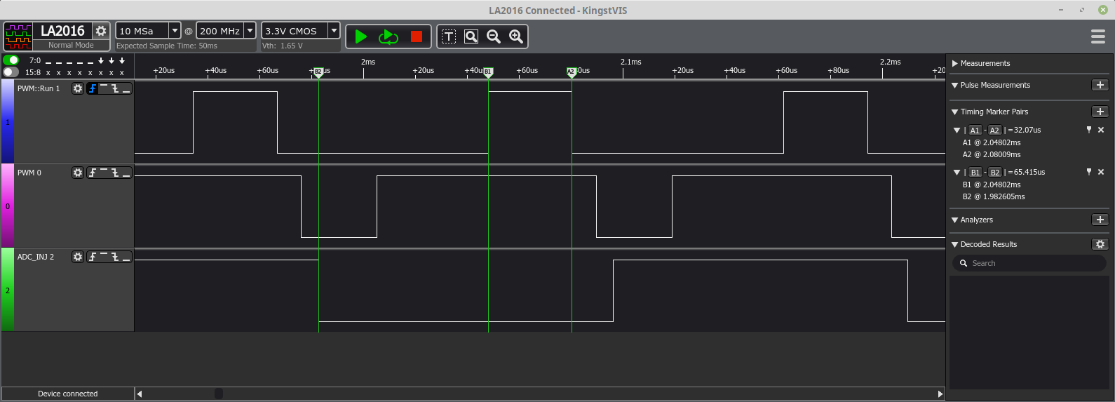

Got the Nucleo board working and added some extra output pin writes to the standard code and hooked up the logic analyser to capture the data:
The three plots are:
  • PWM::Run - Goes high at the start of the PwmGeneration::Run() function and low once the new dutycyle values have been calculated and written.
  • PWM - Channel 1 of the PWM output - note this is fixed in the code to 75% to keep the plot stable as it is running open loop and the nurmal dutycycles are all over the place.
  • ADC_INJ - This line is toggled when the injected ADC conversions complete (I've added a ISR on the injected conversion completion and added the IO write in there)
So results.
  • First the Run() function does start at the centre of the PWM pulse so this agrees with johu's results and gives me confidence I've set it up right!
  • The time needed for the Run() function to execute is 32us. It should be possible to optimise this a bit more too.
  • The injected conversion completes 64us before the centre of the PWM pulse (49us into the period) as expected.
From this it looks like there is plenty of time to execute the PwmGeneration::Run() before the PWM timer reload if it is started from the ADC injected conversion complete ISR. This will give us a measurement to output latency of under 70us. It would also appear that with a little optimisation it should be possible to get the latency down to nearer 30us, or possibly even less if we trade a little code readability for speed.

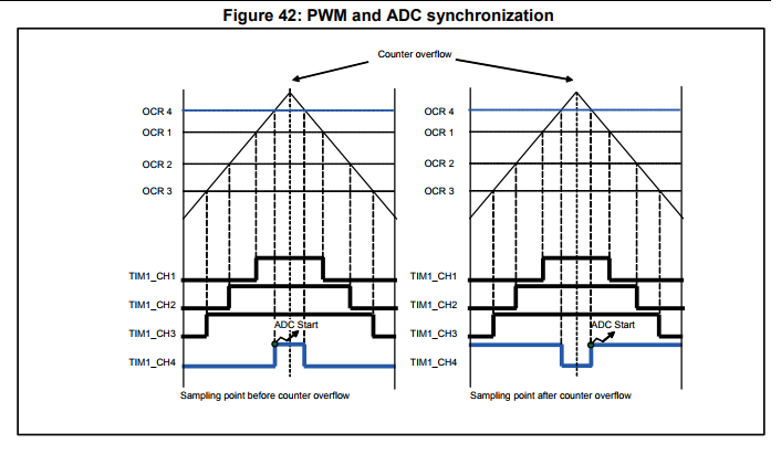

On the repetition counter thats the issue. Need to have a read of the stm32f1 data sheet to see what might be possible (wondering whether the spare timer channel could be used to trigger the isr at different positions in the pwm period for the different freqs).

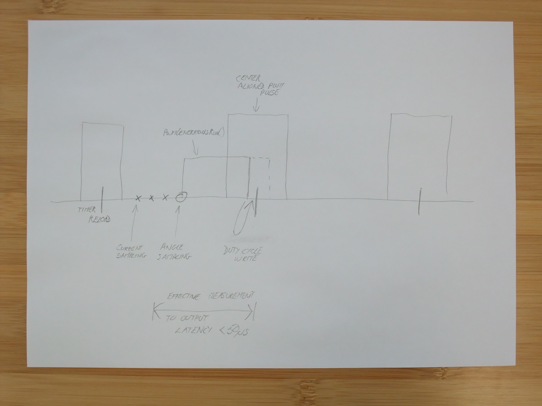

Re the hand drawn isr timing sketches above, are you happy with aiming for the second one?

Ok, bit of a brain dump to try and get thoughts in order. First, this is what I think we should be aiming for:
To achieve this the PwnGeneration::Run() function needs to be called earlier than it currently is so that it can have the new dutycyles calculated prior to the timer reload at the mid pulse point. Testing so far indicates that there is a 64us window in which this can be done.
I'm not comfortable running the PwmGeneration::Run() function from the ADC injected conversion complete ISR. This is already slaved from another ISR in code, would add too much dependence on other modules and would also need the resolver timer to be running in all other encoder modes.
There is a spare capture/compare unit on the PWM timer. It should be possible to use this to generate another interrupt at whatever point in the PWM period that we want (and then use this to call PwmGeneration::Run()). The problem is that at higher PWM frequencies there would be multiple interrupts for each control loop execution. I think we can get round this by reading the repetition counter in the ISR to decide whether to call PwmGeneration::Run() to execute the control loop. This still leaves one problem, the Run() function would need to complete within a single PWM period at the highest frequency, or 56us (in order to ensure that we do not start to miss interrupts). This should be possible if some of the slower bits (such as Mtpa()) are moved to the 1/10/100ms tasks.
If done this should get the measurement to output latency down from 180us to around 60us, a factor of three improvement, which will make a big improvement to control loop stability but it's a lot of changes to the codebase.

I've realised that the hardware test setup I have can be used to measure the latencies fairly easily. If I use the line that is being toggled in the ADC injected conversion complete ISR as an input and check it to decide whether to output a large or small dutycycle in the PwmGeneration::Run() function I'll be able to measure the latency on the lines already bought out to the scope.
So the plan is:
  1. Measure the latencies in the standard code.
  2. See what can be done in the firmware to improve them.
  3. Once I know what can be achieved update the PC simulator to accurately model it.
  4. Use the simulator with the new latencies to see if the control loops can be adjusted to keep things stable under all conditions.
Pete9008
Posts: 1801
Has thanked: 102 times
Been thanked: 350 times
Post by Pete9008 »

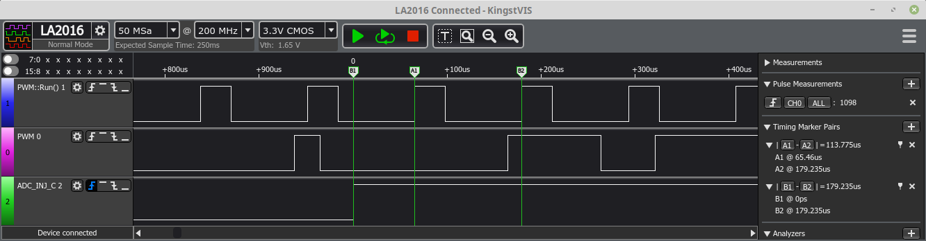

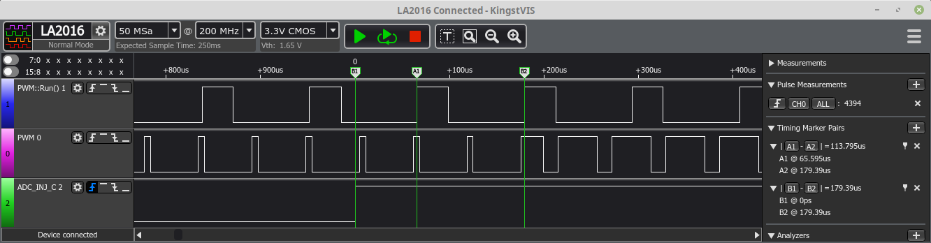

Measurements of the latencies on the original code - not quite what I expected:
17.6kHz PWM:
8.8kHz PWM:
4.4kHz PWM:
The 4.4 and 8.8 match calculations but the 17.6kHz is slower - actually the same 180us as the other two. Looks like the timer double update mode is only used at 4.4kHz.
The PwmGeneration::Run() period remains unchanged throughout as expected.
Posts: 6768
Has thanked: 383 times
Been thanked: 1589 times
Actually I'm very glad to see this because it is what I expected. The "repetition counter" is set in a way that the ISR frequency stays constant at the 3 selectable PWM frequencies. 0 repetitions mean running the ISR before downcounting AND upcounting (done at 4.4 kHz), 1 repetition means running ISR only before downcounting and 3 repetitions runs one full period and a half without calling the ISR.
So B1 is where the resolver is sampled, A1 is start of ISR and B2 is supposedly the start of the next PWM period. But it isn't because it is center aligned. So it actually starts midway between the negedge of the last period and the posedge of the next. So I'm assuming the real latency is exactly one PWM period.
I'd summarize the following learnings:
  • ISR is called in the middle of the period
  • When currents are sampled right at the start of the period they should be mostly noise-free because in most cases no switching takes place here
  • As expected delay between sampling resolver and calling ISR is 113-40=73us.
  • Taking too many current samples from the past increases latency and probably affects control loop stability
  • syncadv needs to compensate delay between resolver sampling and current sampling, so something less than 73us
  • field weakening current should be determined from distance of total amplitude to maximum possible amplitude
  • User current request must be limited to allow field weakening - also determined like FW current?
I'd try to throw this into the software, the last 2 points into SetTorquePercent() which runs every 10ms

johu wrote: Mon Sep 05, 2022 9:22 am So B1 is where the resolver is sampled, A1 is start of ISR and B2 is supposedly the start of the next PWM period.
Should have said that A2 and B2 are on top of each other on the plot which hides A2. A1 - A2 is the ISR period.
B2 is the equivalent of A1 (start of the ISR) but for the next cycle.

You've lost me there, could you explain a little more?
I'm treating latency as from the measurement to the point where the output action actually takes affect, isn't that at B2?
Posts: 6768
Pete9008 wrote: Mon Sep 05, 2022 9:39 am You've lost me there, could you explain a little more?
Yes, look here:
So one period isn't just "on" and then "off" but "off", "on", "off". Since the trailing "off" continues into the leading "off" of the next period you can't determine the start of the period from the edge off the PWM signal, unless you set it to a very high duty cycle.
