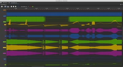

Just been checking everything here and all seems to work fine. Have found a bug in the STM code though which causes a corruption in the json header sent as part of the log file (it didn't allow time for the UART DMA to complete before sending data) but this wouldn't have caused your problem (it only showed up when trying to decode logged data). I'll push the changes onto github this evening.
Also tried decoding some longer data files and might need to optimise the decode program a bit, it takes around 10sec per minute of data at the moment, it's also generating some pretty big csv files (0.5GB for ten minutes of data)!
Pulseview does seem to have loaded this file OK though, it's surprisingly quick to load (so quick I thought it hadn't done it at first) and then a bit laggy, but it's not bad at all :) 10min of data is probably about its limit though.
Probably ought to change the ESP code at some point to close the file and open a new one every 10minutes.
Edit - It's not that fast to load, I was just zoomed in while it did it so only saw the first few seconds data load. If you are fully zoomed out then the whole 10min of data takes a little over 20sec.

Edit3 - Pulseview is pretty slow to save the files but can do it, the resulting file is around 86MB (down from 464MB for the csv, the SD card file this was generated from was 118MB). The .sr format is probably worth looking into longer term.
Edit4 - github updated (esp and stm code)

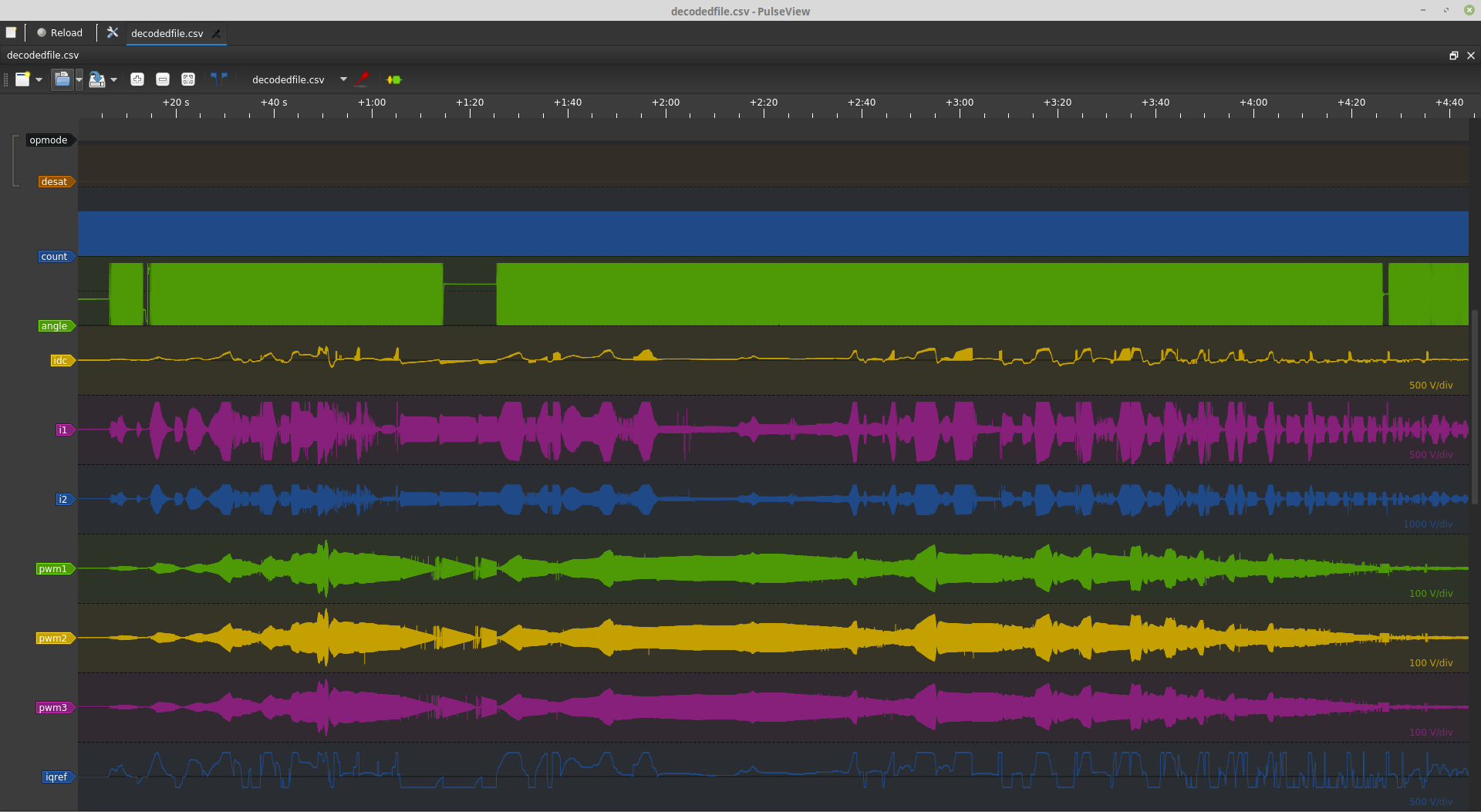

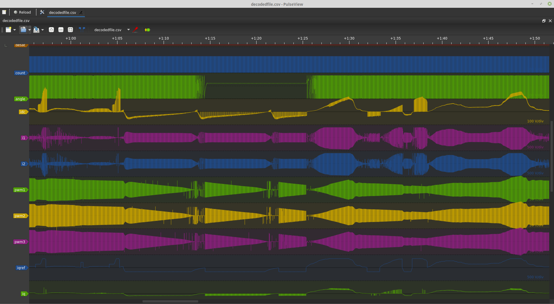

Here's your logged data, opened no problem at all :)
Not looked at it in detail yet but initial impressions are good.

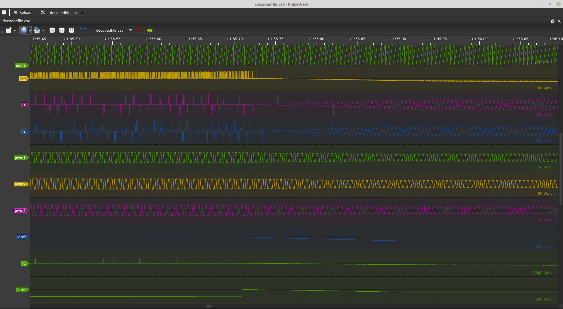

Edit - there are some odd things going on though:

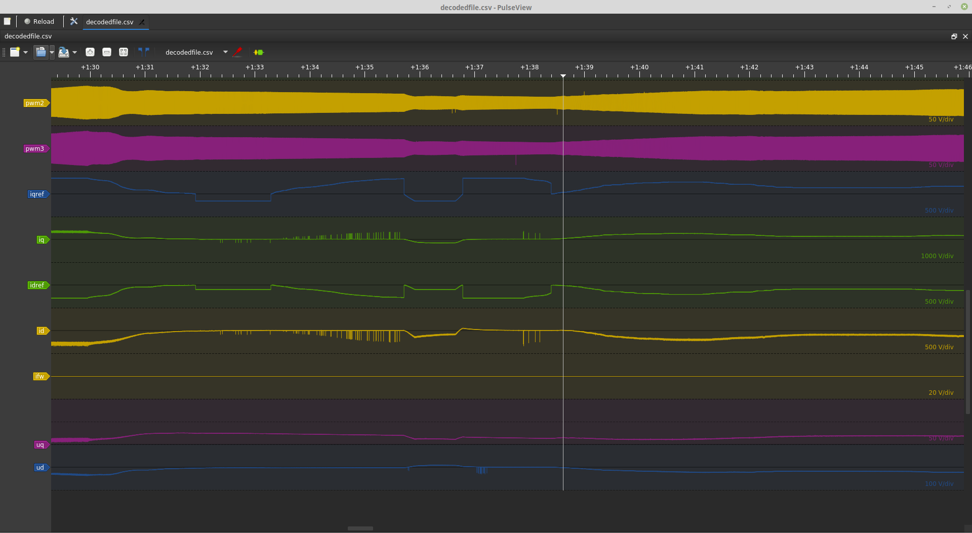

There is something odd on the currents il1 and il2, there is a distinct difference between when accelerating (LHS of plot) and decelerating (RHS). The decel data is what I'd expect. Not sure what to make of the left hand acceleration side??
Edit2 - Also something not right in Id and Iq, they should follow IdRef and IqRef.
Not sure whether this is a real problem or a logger problem.
It looks like it is just when you are pushing on a bit more so wondering whether this is the throttle limiter which is in the latest code, might be worth commenting out the following lines in SetTorquePercent to disable it and trying it again (but don't push too hard as the control loops will then be able to go into saturation)?

Wow, cool to see some live data. Left hand currents are super strange indeed

Another strange bit in the center of the plot. The angle is unchanging so stationary but there is negative DC currents being recorded (-40A):
Could this be energy stored in the motor being returned to the battery, can it really last for 5sec, stop and then start again!?
@Bigpie - any idea what what happening here?
Posts: 1783
Has thanked: 83 times
Been thanked: 430 times
Re: ESP32 Based Web Interface & Data Logger
I dont, I did have to stop at some lights for a few seconds. I was driving pretty erratically trying to get it to cut out. I'll have a go at loading it up in PulseView. I'll get some more logs tomorrow and see if I can get it to cut out.
Pete9008
Posts: 1801
Has thanked: 102 times
Been thanked: 350 times
Post by Pete9008 »
Bigpie wrote: Sat Oct 22, 2022 3:52 pm I dont, I did have to stop at some lights for a few seconds. I was driving pretty erratically trying to get it to cut out. I'll have a go at loading it up in PulseView. I'll get some more logs tomorrow and see if I can get it to cut out.
Thinking the cut-outs were the PWM overflow, the symptoms would be right. Good if it's fixed :)
