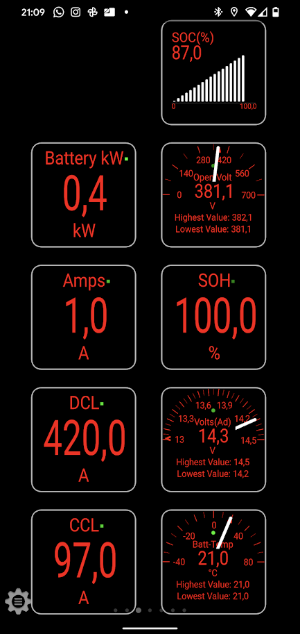

Great to see projects featured in car magazines.
Is the smartphone app from Orion BMS?
Re: Toyota GT86 with Nissan Leaf Motor
Posted: Mon Aug 24, 2020 3:59 pm
by Isaac96
Looks like Torque to me.

JaniK wrote: ↑Mon Aug 24, 2020 1:32 pm
That codes come though the Canbus by the Orion BMS

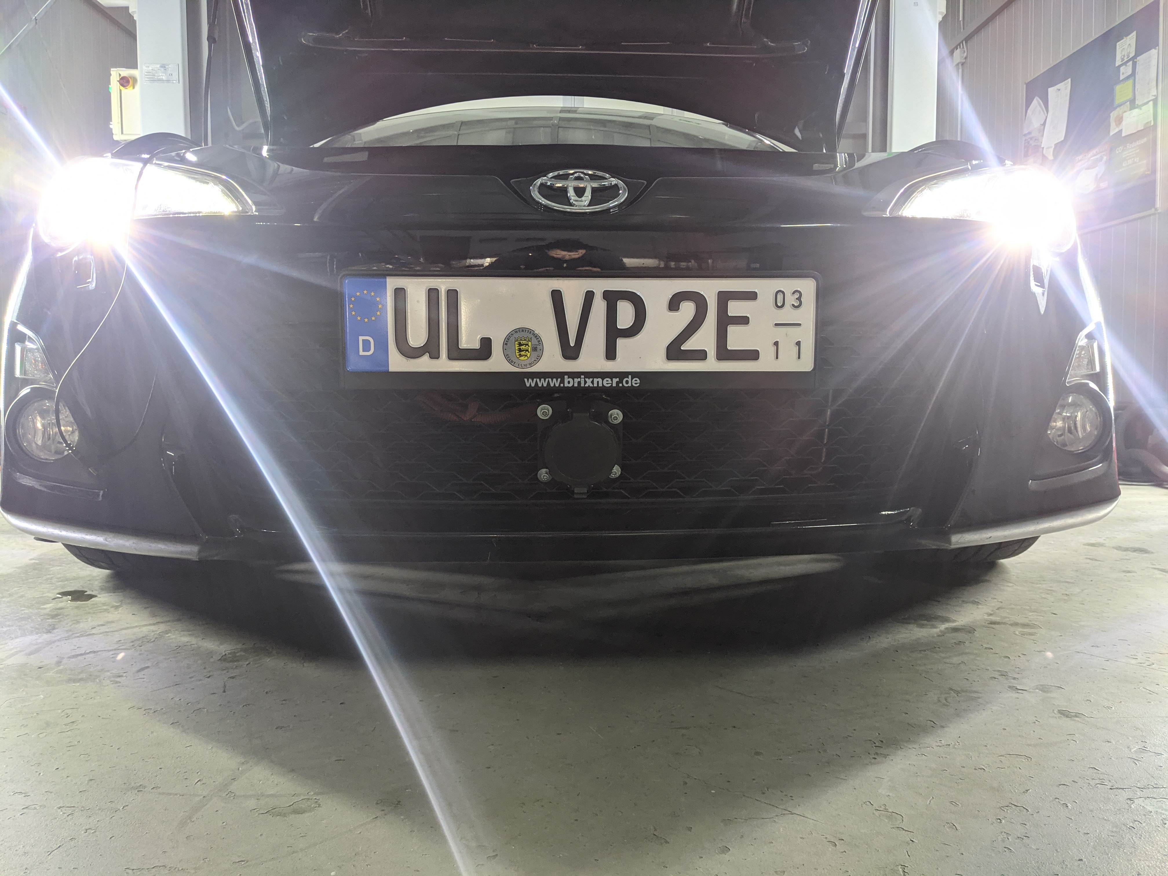

- CHAdeMO Fast charging Socket and control box. Controlled by Orion BMS 2. Priximity is inverted in software - they told me appearently no one befor used the proximity detect feature! Had to fix the inverted byte in my own ECU.
I found a neat place to install my CHAdeMO box: Under the front bumper. It's still slightly behind the crash bar so won't be the first thing to smash in case of a crash. Also it's a very rubust metal box.
And here's my charging port. After thinking for weeks about where to install it, this was the best option. Still not very happy with it!

That's a tidy contactor box!
I think the CHAdeMO port needs some additional moisture and dirt protection. Otherwise if you drive through rain the EVSE could detect an isolation problem. Or worse, the contact area for high current is reduced by dirt or corrosion.

johu wrote: ↑Fri Feb 19, 2021 10:10 am
I was thinking to get a 3D print that inserts into the socket and simulates a plug with a gasket around. in the middle there is a grip to pull it out. And it still should fit under the lid, of course.

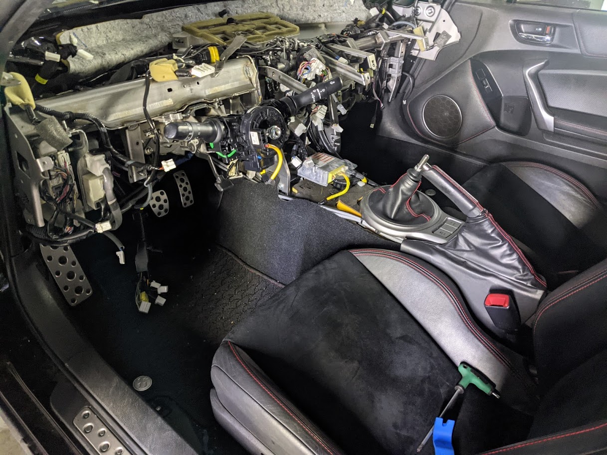

I installed the heater, which was a real pain in the ass!
I had to take the whole dashboard out and the pedals also as the complete electric power steering and steering column.
In the pictures i already had the pedals and the steering column reinstalled, so it looks less worse than it actually was
Took me a whole day of 12 hours to complete the job. And still i have to wire it up.
It is connected to a microswitch that i mounted on the heater matrix actuator. It also can only turn on when the blower is on.
As it runs on 12V this is very important. I decided for 12V because of its simplicity. The heater is out of a Subaru forester and fits nicely with my self made glass fiber adaptor in the place where the heat exchanger has been before.
I only drive the car in the warmer month's of the year, so all i need is decent amount of heating to clear fog or very little ice of the windshield in the cold mornings. 1200Watts should be enough to do the job!

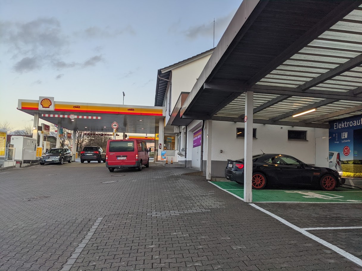

Here's my feedback to the ptc heating element: More than i expected! I just drove the car at 4 degrees celcius outside temperature, today was a bit of a snowy day. And still, there is a warm breeze blowing out of the vents. It's not like super hot, but satisfying warm. With the blower set to full power 1200W just aren't enough to blow warm air out of the vents. But if i set the blower to medium or less power it works very well. So yes, 12V heating is possible, but don't expect it to be exremely hot like with a combustion engine. The Tesla DC DC converter pulls more kWh out of my high voltage battery pack as soon as i turn it on. 100 amperes out of 12 volt are quite a bit so i decided to crimp it to a 35mm² cable that leads to a relay that is controlled by the OEM actuator and ignition 12V. The cables do not get warm, even after 30 minutes of having the PTC turned on.
Posted: Mon Mar 15, 2021 8:15 pm
by Zapatero
Updates:
Airconditioning is now working! Nice!
HVAC Systems all functional and no extra switches are needed, everything is controlled by the OEM controls. I'm all about the OEM-Feeling!
My rev counter shows me the SoC when the Charge-Interlock-Bit is set. Nice feature, so you can literally watch your car fill up - and it just looks so cool! Works with j1772 and CHAdeMO.
// CAR IS CHARGING
if (BMS_Charge_Interlock) {
RPM_Charging = (((BMS_SoC/2)*100)-RPM);
RPM_2 = RPM + RPM_Charging;
else
RPM_2 = RPM;
// CAR IS CHARGING END
Today i did my first longer range trip in the car. 220 Km at a outside temperature of 3C° to 6C°.
Start: 100% SoC, 398V, 4.15V per cell / Batt Temp 12C°
Total Km: 115Km / 86Km Highway with max 120 Km/h / 29Km country roads with Max 100Km/h
Stop: 4% SoC, 337V, 3.52V per cell
Charged: 18,4 kWh in 30 Minutes
Start: 95,5% SoC, 384V, 4,00V per cell / Batt Temp 28C°
Total km : 65km / 65Km Highway with constant 130 Km/h
Stop: 16,5% SoC, 336V, 3,5V per cell
Charged: 18,6 kwH in 37 Minutes
Start: 94,5% SoC, 386V, 4,02V per cell/ / Batt Temp 46C°
Total km: 40Km / 25km Highway with constant 130 Km/h / 15 Km country road
Arrived at home - didn't recharge there so no information gathered. Temperature was still 46C°
Conclusions:
- When my temperature had risen above 35 degrees at the second charge temperature derating kicked in and it took longer to charge the car.
- I stuffed the thermistors far in the inner of the cell, which is pretty easy as they are not very big. On the leaf they are more on the surface. I have to change the position. If i measure the core cell temperature my charging curve gets's worse. Sure i could adjust it in the Orion BMS, but i think the utilisation of the OEM measurement point makes more sense here.
- When i charge on CHAdeMO my SoC rises faster than my battery cell voltage. This means it starts derating earlier than necessary.
Not sure yet where to adjust here to get a safe and proper but fast way of charging. Obviousely i'm missing about 3 kWh to 80%.
- Is my 4% Limit appropriate for the leaf cells? Are there any experience from your cars out there?
Stop 1
Stop 2
