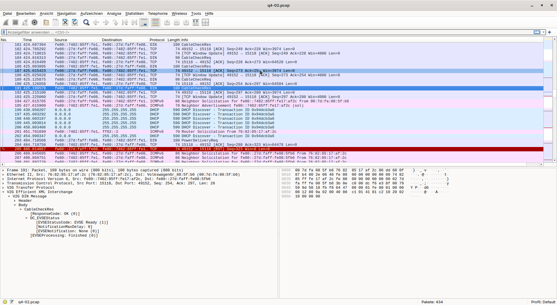

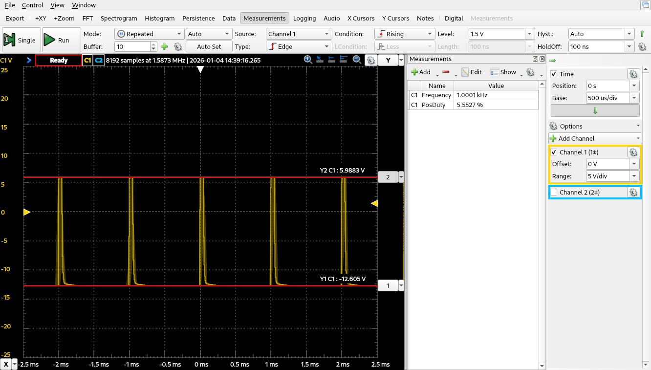

Hello guys, yesterday. I perform a drawing power testing on my car(n7) when I plug the evse in with a ccs1 plug. But it end up stuck on sdp2. It seems like when evse sends sdp response back to pev. PEV did not continue to make TCP Negotiation.
When I try other brand's ev truck(not yes release). It went through right away and started drawing power from PEV with 2 lightbulbs.
The things that make the difference may have the following reasons.
  1. My car(n7) does not have the right config with ipv6 address?
[addressManager] Local IPv6 is fe80::2aae:949b:8102:4099%23
[addressManager] pev has IP fe80:0000:0000:0000:f2fd:ddff:fe00:688d
  • As far as I can know. EV truck is running on din 70121 with CCS1 only. Does it have a way to identify my n7 is running on 70121 or 15118? My projection is also running with 70121. But I don't know how n7 doesn't connect tcp to my win10 laptop.
Here are the logs(n7):
V2GTP (10bytes) = 01 FE 90 00 00 00 00 02 10 00
Ok, this was a valid SDP request. We are the SECC. Sending SDP response.
SDP payload (20bytes) = FE 80 00 00 00 00 00 00 2A AE 94 9B 81 02 40 99 3B 0E 10 00
V2Gframe (28bytes) = 01 FE 90 01 00 00 00 14 FE 80 00 00 00 00 00 00 2A AE 94 9B 81 02 40 99 3B 0E 10 00
V2GTP (28bytes) = 01 FE 90 01 00 00 00 14 FE 80 00 00 00 00 00 00 2A AE 94 9B 81 02 40 99 3B 0E 10 00

First I found I had used the wrong output resistors for 5% PWM, 10k instead of 1k. With that I didn't even get past SLAC. So I corrected the resistor but then didn't get past CableCheck. It simply stops sending requests after the 4th request.
Possible reasons:
- My PWM is not going down to -12V, just 0V
- On chargers put 500V on the charge port during CableCheck, I can't do that (only 300V)
I was hoping it would go to PreCharge so I could test my little DC-DC converter but no luck. Anything sticking out from the log?

I have no real idea. You could try to see what happens if we send the "cable check finished" already at the second loop. By decreasing the number here https://github.com/uhi22/pyPLC/blob/761 ... se.py#L250
And maybe check the PP resistance. And yes, the minus 12V.

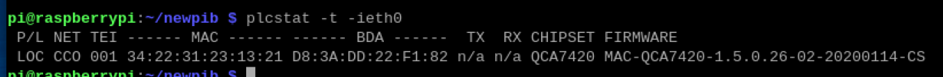

Any ideas why? I don't have another EV to test right now. Also, I am not sure about what I was missing. I think it is possible that every EV has some small different to wake up EVCC via PWM?
Here are my PLC modem version:

p477d343 wrote: Sun Apr 13, 2025 8:59 am Hello guys, last time I was testing with n7. It stuck the SDP stage. And I forgot to record the packet with Wireshark. The next time, I try to test with miniEVSE. Somehow, the PWM doesn't work anymore. And the problem would be the inferior quality of LF355N. So I purchased a new one from STMicroelectronics. Test with oscilloscope, I am sure that it produces 1 kHz 5% PWM signal when I plug into EV. It seems like it did not wake up the EVCC with PWM signal. I have to test to different plug. One from j1772 plug with custom wire. And one that 3 small metal pipe connect with wire. Both are not getting any SLAC startup request from EV.

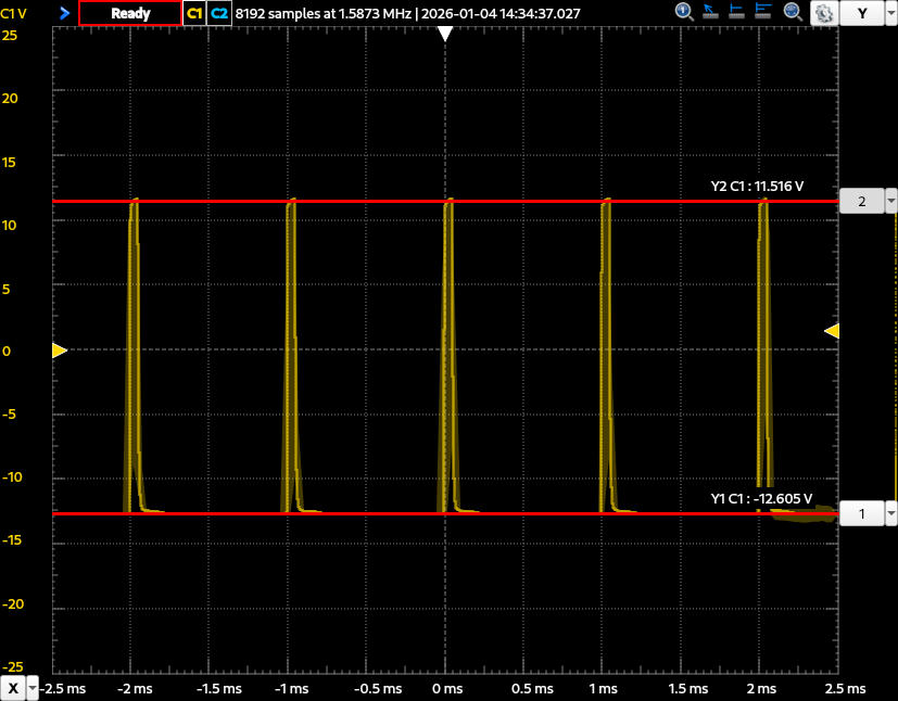

Hi guys, after testing another EV truck, I confirmed that MiniEVSE didn't break. It works well and draws out the EV truck's energy. But the only problem is that the CP voltage is too low. Before plugging it into the EV, its CP voltage was 10.7V. I was suspecting that the reason why MiniEVSE can't wake N7's EVCC up is that my CP Voltage(10.7V) is not included in the right CP range. I am guessing it is 12V with a deviation +-1V.
I am now using STMicroelectronics's LF355N. Its datasheet said its typical output range should be between +-12V and +-13V with input +15.1V and -12V. Right now, I have +12.8V and -12.8V input. Will it be the difference that my positive input is too low?
Another thing that I test is LF353P(refer to the image from this:https://github.com/uhi22/pyPLC/blob/mas ... d#hardware)
After replacing the LF353P with LF355N. I can measure the pin 1 output voltage to be 12V. And pin7 output is -11.4V.
But after connecting to the PEV. It did now generate the PWM signal while using the Oscilloscope to observe it.
  • PWM signal from Arduino to pin 3.
  • +12V to pin 8.
  • -12V to pin 4.
  • 5v and GND with 2*120k to pin 2.
How do you connect to CP with only positive output 12V that can generate a PWM signal while using LF353P?
Has anyone similar problem or encountered things like EVCC will check restrict CP range(For eample:11.5V~12.5V)?

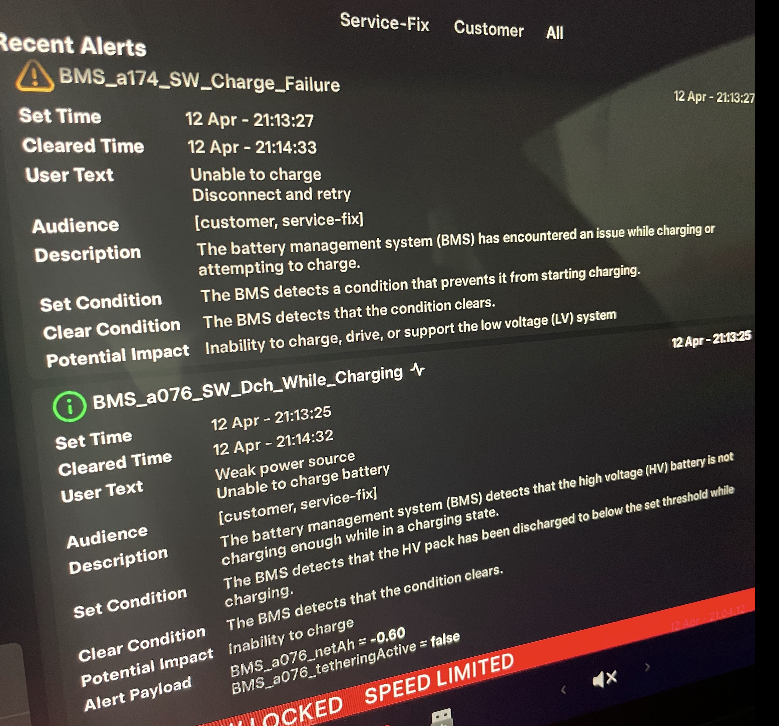

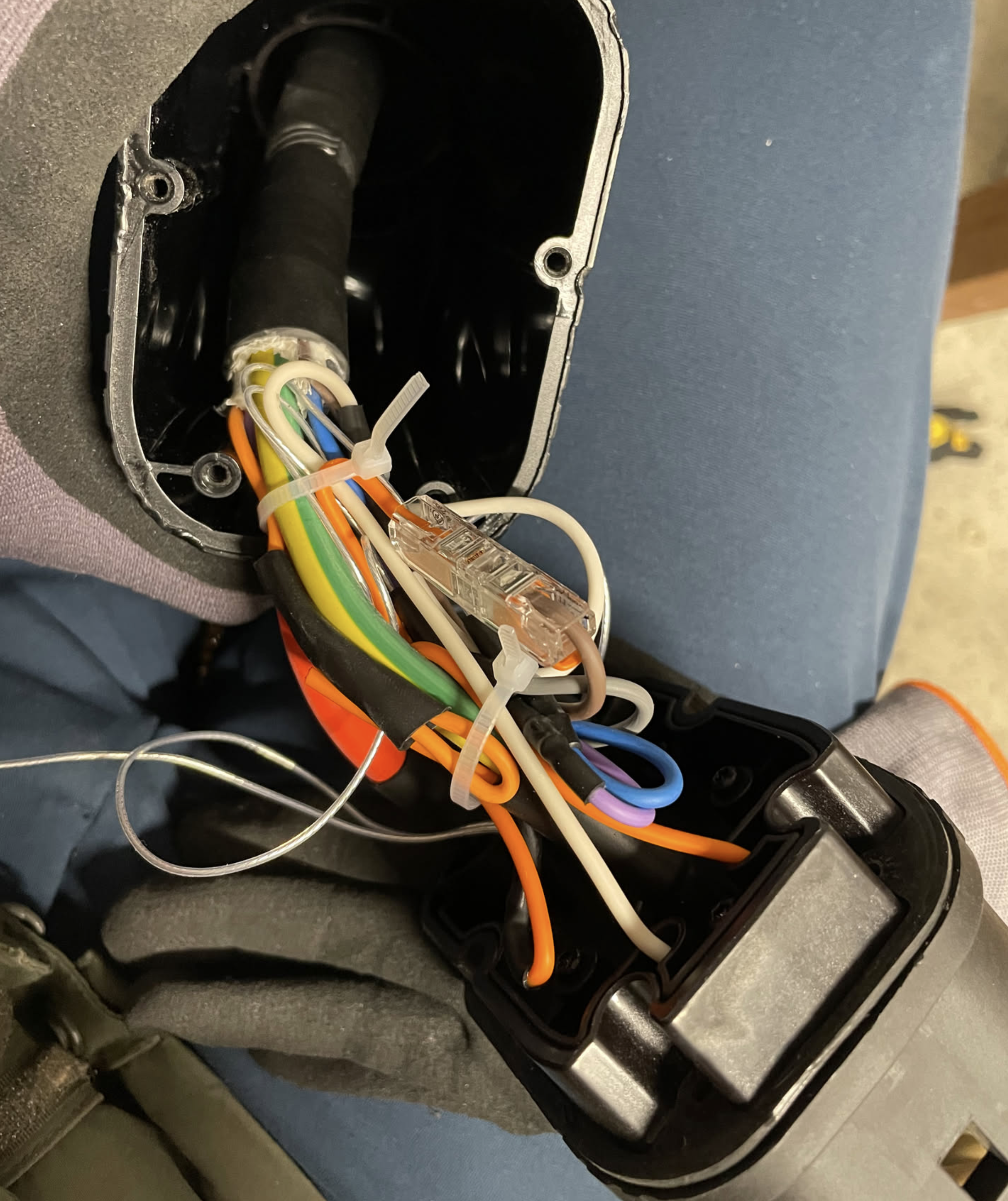

Update from my side: I managed to open the CCS enclosure without breaking it, and used on of the wires of PT1000 sensors to pipe PP back to the wallbox (I'm not using the temp sensors anyways, not going on much with 13A...). That means I have PP attached to a relay, and can simulate an "unplugging event". Cutting PP for a few seconds (together with CP, otherwise the car is not happy) is enough to clear the 15Ah limit. Also note: Really only do a few seconds, otherwise the car tries to close the lid, and that doesn't sound too nice when the CCS plug is still there... :)
In practice that means that when the 15Ah limit is hit, I have a 2min downtime (because I'm also restarting the Pi) and then everything is back to business, without me doing anything manual. wohoo! :mrgreen:
The not so great news is that I somehow summoned a new foe aka. the 0.6Ah limit. I haven't figured out yet how to summon it, but I get it 2-3 times a week. I started to think that I noticed a pattern, but that was invalided last week. By now I believe some Tesla engineer is just trolling me or so :D Alas the same trick as for clearing the 15Ah limit does not work. However if I get the car to sleep that does clear it, which is a bit of a convoluted Home Assistant automation and takes around 15min downtime. That is, stop charging and wait until I see via the Tesla API if the car is sleeping (~10min), let it sleep for a few minutes and then start charging again. Not great, not terrible :D

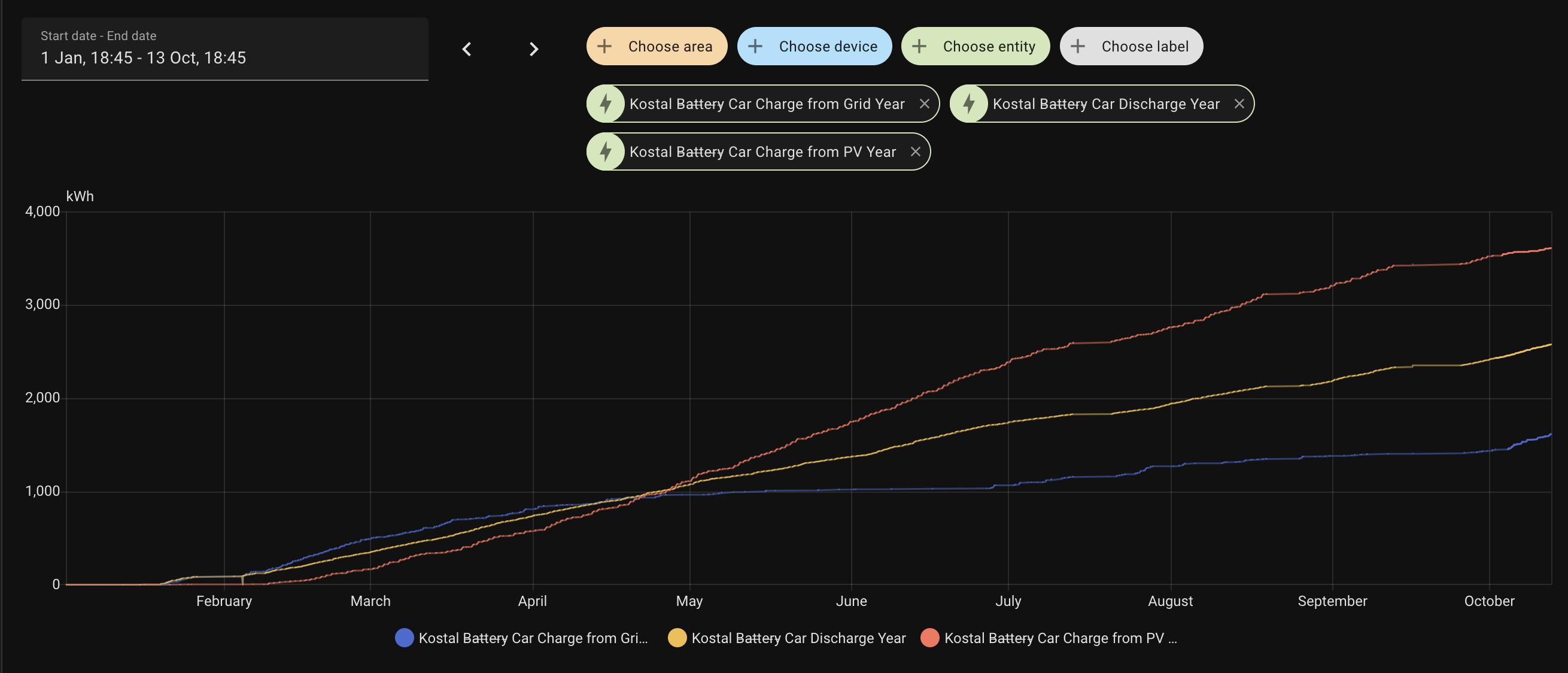

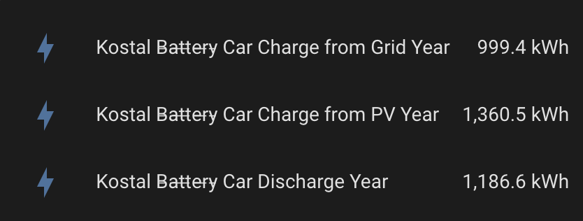

I haven't touched the AC charger since Feburary, stats so far:
Started to write together some stuff, but I suck at it. Sorry ;) At least I updated my pyPLC fork: https://github.com/lewurm/pyPLC/commits/diy-dc-wallbox
Although I'm very happy with my setup, it's also a bit convoluted as there are many components involved to make it actually comfortable to use. Apart from the Raspberry Pi I have also a Home Assistant instance running that e.g. has a zigbee button hooked up in the garage to stop the charging session and unlock the charge port; the latter using an esp32 running esphome-tesla-ble to talk to the car via bluetooth. My point being: The setup is somewhat hard to reproduce. I'll still try to have a single document that at least contains all the right pointers, but it won't be something like OpenEVSE for an AC charger alas.

hycm0000 wrote: Thu Jul 03, 2025 5:30 am Hello, regarding whether Tesla will cut off your power supply and report a fault, are there any new updates? I heard that entering the maintenance mode can avoid such issues. Maybe you can give it a try.
Good luck! :)
Thanks, that's worth an experiment. However service mode (I guess that's what you mean by "maintenance mode") doesn't let the car sleep, and also in terms of usability it's not exactly nice (you can drive with it, but it's kind of degraded in many ways). Disabling/enabling every time before/after driving wouldn't satisify my UX tester (wife) :mrgreen:
Cutting PP as described in my previous post works great to get around the 15Ah limit. The 0.6Ah limit is more annoying. I thought I found a reliable way (descirbed in my previous post) by letting the car sleep, but that does not work every time. My current theory is that it has something to do with driver presence, for example I never had this issue if I wait in the car after starting until I'm past the discharging of 0.6Ah (takes <3min with 13A). Or it could be that my phone (used as a BLE key for the car), is close enough to the car to be within reach, which is sometimes the case from within the house. But in any case, I can't even reliably trigger the issue, so it's just guessing at this point.
I haven't seen it in the early days where I was always next to the car in the garage when conducting experiments. That's another hint that this could be related to driver presence.

On my side, I'm still daily using my DIY DC Wallbox. Except for a two week downtime in September: The box died, I didn't have time to investigate right away. I initially suspected the SSD dying, reconstructed some backup on a SD card, but in the end it was just a faulty power supply for the Raspberry Pi. Oh well. Other than that there is still the 0.6Ah limit hitting every now and then, I still cannot see a pattern.
But those are really just nit picks. Overall I'm pretty happy with the setup. Here are the stats:
Or as graph
if you look closely you can tell which two weeks we were on vacation during the summer :) and the two weeks downtime in September.

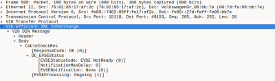

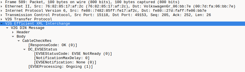

To simplify the analysis it would be helpful to record the IP traffic into a pcap file, this would allow to interpret the message content and the timing in wireshark.
Feeding the above EXI data into pyPLCs decoder, by filling it into RawExiLog.txt in the following way
DD 809A02004080C1014181C210200200000080
DD 809A02004080C1014181C211302080168800
DD 809A02004080C1014181C211400420400000
DD 809A02004080C1014181C21210400B40
DD 809A02004080C1014181C212200200000030500000
DD 809A02004080C1014181C211F0
DD 809A02004080C1014181C2120000
we get the following:
C:\pyPlc>python exiConnector.py
Testing exiConnector...
Trying to read from ExiLogFile RawExiLog.txt
DD 809A02004080C1014181C210200200000080 means:
"msgName": "CableCheckRes",
"info": "18 bytes to convert",
"error": "",
"result": "",
"schema": "DIN",
"g_errn": "0",
"header.SessionID": "0102030405060708",
"header.Notification_isUsed": "0",
"header.Signature_isUsed": "0",
"ResponseCode": "OK",
"DC_EVSEStatus.EVSEIsolationStatus": "0",
"DC_EVSEStatus.EVSEIsolationStatus_isUsed": "0",
"DC_EVSEStatus.EVSEStatusCode": "0",
"EVSEStatusCode_text": "EVSE_NotReady",
"DC_EVSEStatus.NotificationMaxDelay": "0",
"DC_EVSEStatus.EVSENotification": "0",
"EVSEProcessing": "Ongoing",
"debug": "Line370"
DD 809A02004080C1014181C211302080168800 means:
"msgName": "PowerDeliveryReq",
"error": "",
"result": "",
"schema": "DIN",
"g_errn": "0",
"ReadyToChargeState": "0",
"ReadyToChargeState_Text": "false",
"ChargingProfile_isUsed": "0",
"EVPowerDeliveryParameter_isUsed": "0",
"DC_EVPowerDeliveryParameter_isUsed": "1",
"EVReady": "0",
"EVErrorCode": "0",
"DC_EVErrorCodeText": "NO_ERROR",
"EVRESSSOC": "45",
"BulkChargingComplete_isUsed": "0",
"ChargingComplete": "0",
"EVCabinConditioning_isUsed": "0",
"EVRESSConditioning_isUsed": "0",
"debug": "Gram118Line5615Gram119Line5651Line3032Line9057Line9260Line3075Gram4Line472"
DD 809A02004080C1014181C211400420400000 means:
"msgName": "PowerDeliveryRes",
"error": "",
"result": "",
"schema": "DIN",
"g_errn": "0",
"DC_EVSEStatus.EVSEIsolationStatus": "1",
"DC_EVSEStatus.EVSEIsolationStatus_isUsed": "1",
"DC_EVSEStatus.EVSEStatusCode": "1",
"EVSEStatusCode_text": "EVSE_Ready",
"debug": "Line478"
DD 809A02004080C1014181C21210400B40 means:
"msgName": "WeldingDetectionReq",
"info": "16 bytes to convert",
"error": "",
"result": "",
"schema": "DIN",
"g_errn": "0",
"DC_EVStatus.EVReady": "0",
"DC_EVStatus.EVErrorCode": "0",
"DC_EVStatus.EVRESSSOC": "45",
"debug": "Line9057Line9260Line556"
DD 809A02004080C1014181C212200200000030500000 means:
"msgName": "WeldingDetectionRes",
"info": "21 bytes to convert",
"error": "",
"result": "",
"schema": "DIN",
"g_errn": "0",
"EVSEPresentVoltage.Multiplier": "0",
"EVSEPresentVoltage.Value": "0",
"EVSEPresentVoltage.Unit": "V",
"debug": "Line562"
DD 809A02004080C1014181C211F0 means:
"msgName": "SessionStopReq",
"info": "13 bytes to convert",
"error": "",
"result": "",
"schema": "DIN",
"g_errn": "0",
"debug": "Line544"
DD 809A02004080C1014181C2120000 means:
"msgName": "SessionStopRes",
"info": "14 bytes to convert",
"error": "",
"result": "",
"schema": "DIN",
"g_errn": "0",
"debug": "Line550"
The cableCheck does not finish. It says "OnGoing". Normally the car should repeat the cable check requests until the EVSE reports "CableCheck finished". So it seems that the car finds out during cableCheck, that there is something wrong, and terminates the sequence.

What are the levels of the CP PWM? Is the PP resistor correct? Is the plug mechanically correct, so that the cars lock bolt fits and drives to the correct position?
Been thanked: 1913 times
Re: Drawing power out of CCS port (V2x, inverse charging, bidirectional CCS)
So I went to check.
stateA
stateB
stateC
and PP resistance measured at CCS plug:
The plug is a proper one and the lock latched successfully, i.e. we couldn't get it out and it wasn't reporting an error after locking by red LED or something

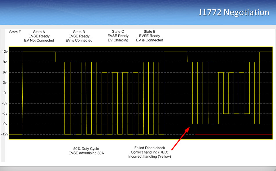

Maybe it checks the PWM duty with different voltage thresholds e.g. 3V and -9V and finds too much deviation. I know, unlikely, but who knows what German high-safety overengineering looks like...
Can try again when the next board revision arrives, with comparator.
Would be really silly if this was it and would just make the car fragile for no reason. Agreed that a proper German could pull this off ;)
Oh by the way, I said last time I found the PWM reversed, i.e. 95%. But really it was the probe that I reversed :| (differential DuPont pair from Analog Discovery)
If this isn't it what else could it be?
mhpev
Posts: 39
Joined: Fri Jul 28, 2023 2:18 pm
Has thanked: 50 times
Been thanked: 14 times
Post by mhpev »
johu wrote: Sun Jan 04, 2026 1:49 pm So I went to check.
stateA
stateB
stateC
Seems your state A is not correct it should be +12V DC only no PWM when in state A, then in B once you detect the 3V drop and down to 9V start the 1KHz PWM with 5% duty cycle. Once you start your PWM EV will enter state B and start DC comm as it sees the charger advertising 5%... I've got it to work with multiple EVs now some are more stringent like Teslas that give a very small timer once entering state B and if they send out requests and we don't respond they will timeout.
