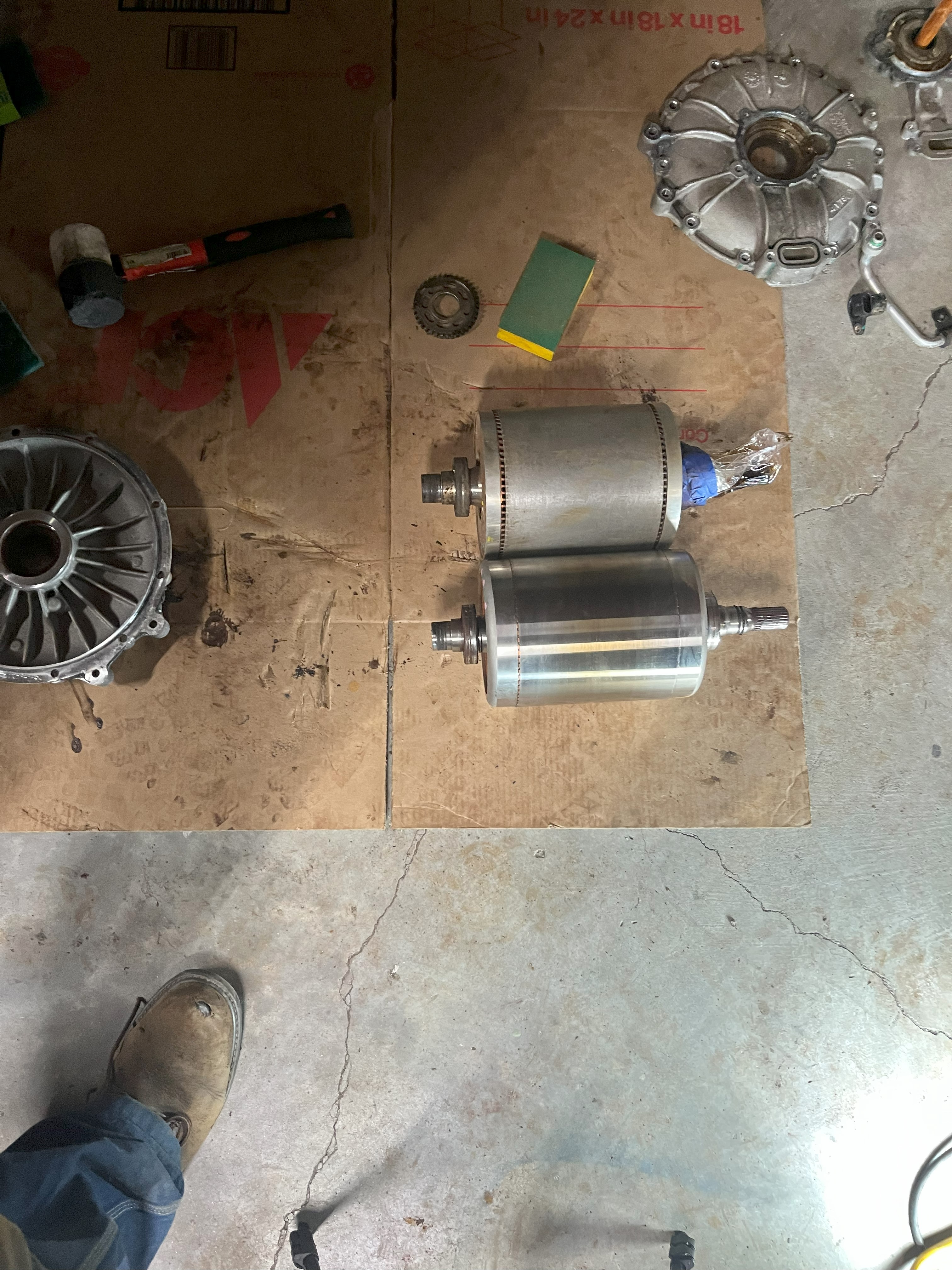

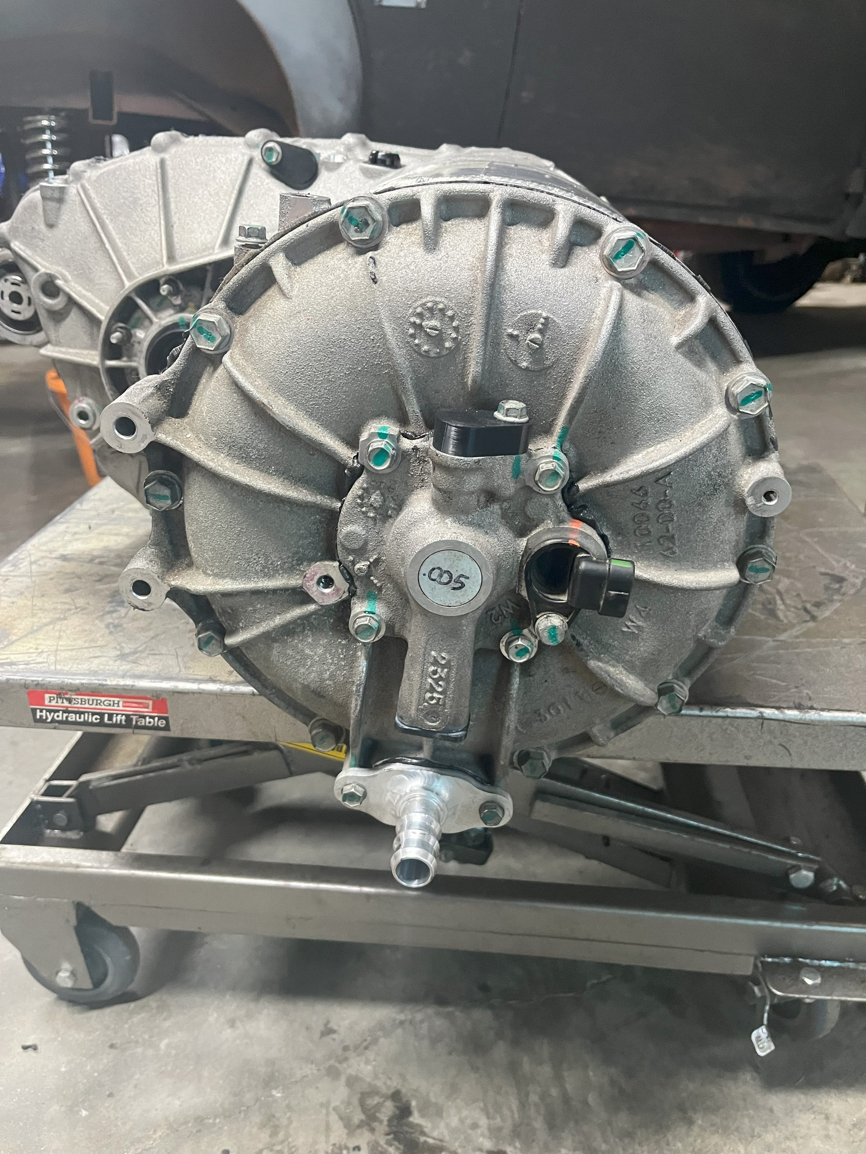

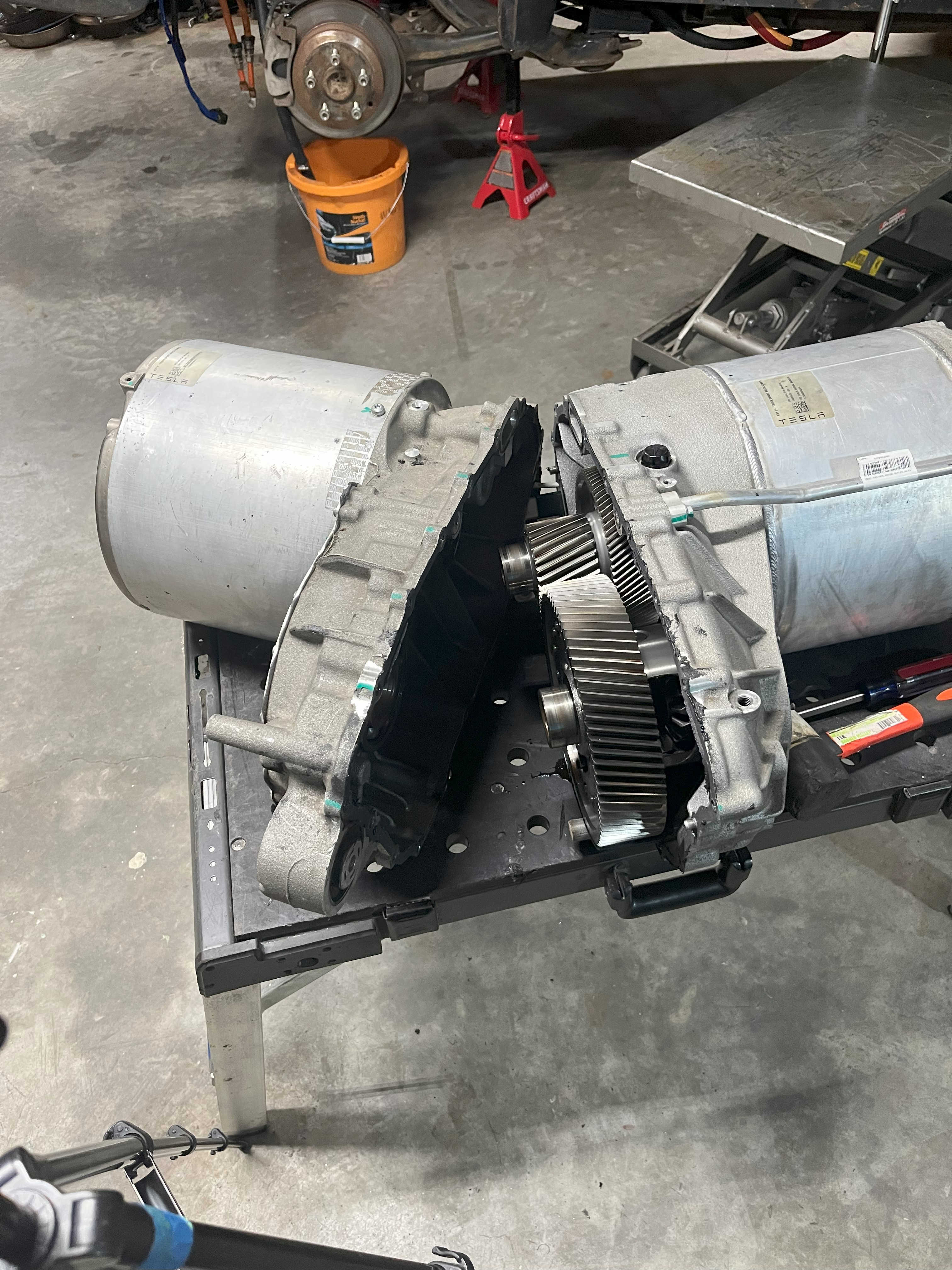

Well the Base unit is fighting just about as hard as it can to avoid me installing the Sport unit.
I got it out of the car relatively easily, though I did realize halfway through that I needed to raise the car another 3 notches on the jack stands to get my hydraulic table under the front of the unit. Then began the issues.
The adapter plates do not want to come out of the unit. No amount of pry bars or slide hammers, or swearing would get them to move. Even managed to pinch my hand in the slide hammer, that was real fun. Saturday, I did some Google-ing, and the only solution I hadn't yet tried was an axle popper fork (actual name) so I found one Amazon said they could overnight to me, arriving before 11am on Easter Sunday. Fantastic! Except its now Monday and I still have not gotten it. Less fantastic!
On the Sport unit there's better news. I opened up the gear box andddddddd its fine. No broken gears, fairly clean oil, I've got no idea why this unit was pulled. Unfortunately, while reassembling, I managed to snap the very last bolt I tightened. Of course it was one that could not be reached with any tools unless the unit was disassembled again. So I did that yesterday, got the bolt out, and replaced it with one off the base unit.
I also removed the inverter from the base unit, partially out of curiosity, partially to facilitate its eventual repair, and partially to keep it protected. In doing so, I don't see clear signs of coolant entering from the motor bus bars, so I wonder if part of the inverter cooling cracked when the unit was ripped out of the car at the end of DW. I need to do more investigation there.
Long story short: If I can get the damn adapter plates out of the base unit, I can get the sport one in the car and hopefully driving again in short order. Hopefully.

Small update:
I didn't have much time to work on the car this weekend, but I did get to do a few things.
The adapters remain in the base unit - I'm very close to just buying replacements, but I'm trying to avoid that.
I did a very brief test spin of the Sport unit, and it spun up perfectly fine. I'm excited to get it in the car, but I think I'm going to go ahead and do the LSD install now, so I don't have to fight axle adapters again in the future.

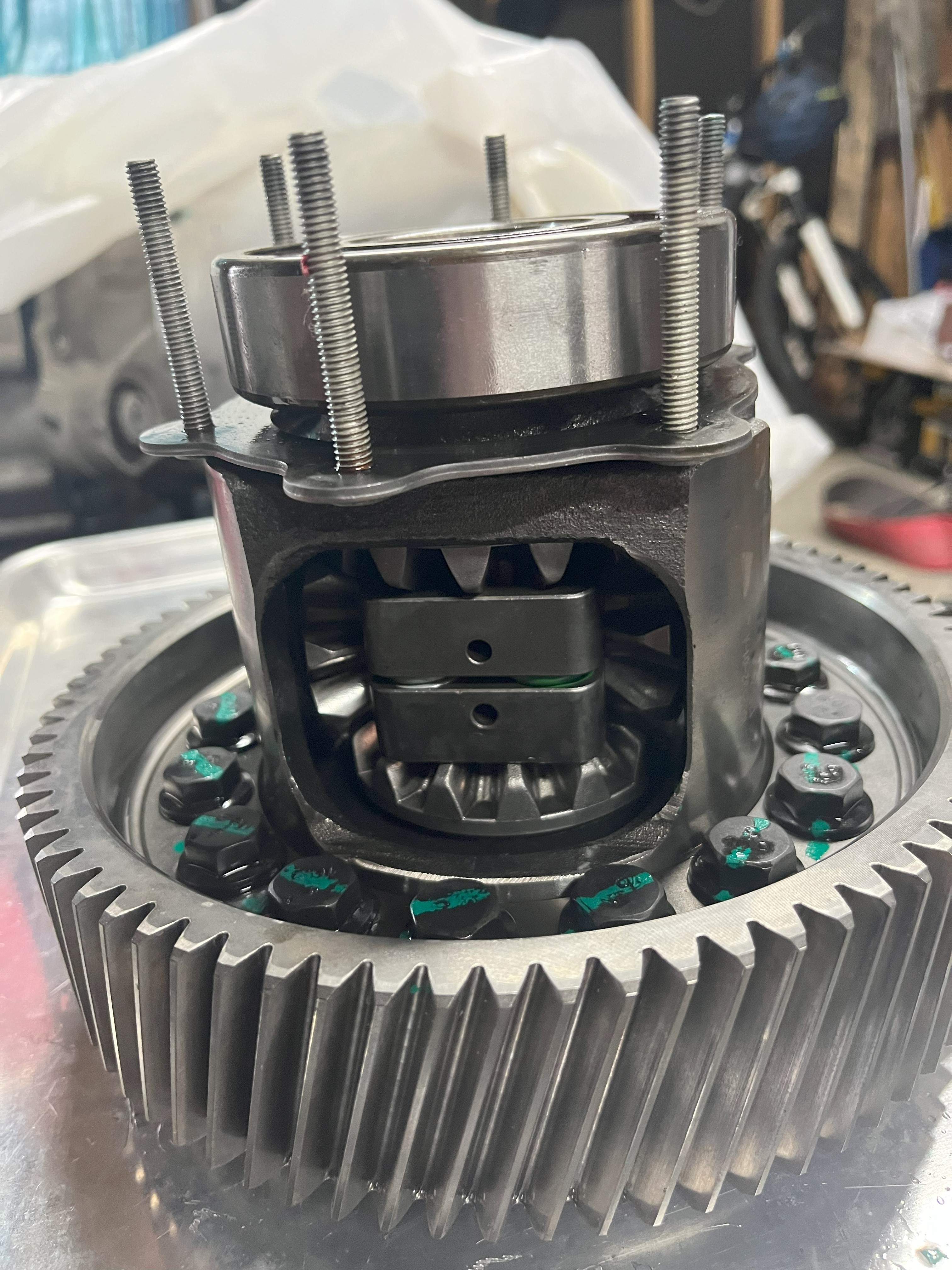

Finally some positive updates!
I have a new set of adapters on the way from AmpRevolt; huge thanks to Brandon for helping out with getting those.
I have finished installing a limited slip conversion kit from Traction Concepts. This uses the stock open diff and adds limited slip components. It took longer to prep and install than I thought it would, but I'm happy with the fitment. Looking forward to testing it soon. I also installed a rotor coolant delete kit from EV Muscle Cars (aka Kevin Erikson, aka Electrolite guy). Rather than the full billet pieces from Revolt or QC Charge, this modifies the existing coolant manifold to eliminate the rotor cooling and then block off the rotor cooling passageways. It includes a nice TIG welded hose barb/flange, and 3D printed block off pieces. As you can probably gather, I'm trying to find the most cost effective (read: cheap) ways to get the car back and the road but also improve it.
I have some suspension fixes/updates also on their way, so the hope is the car will be back on the road next weekend, and back at the track later this month. I'm really hoping to get some track testing done before I talk about the car at SOC24.

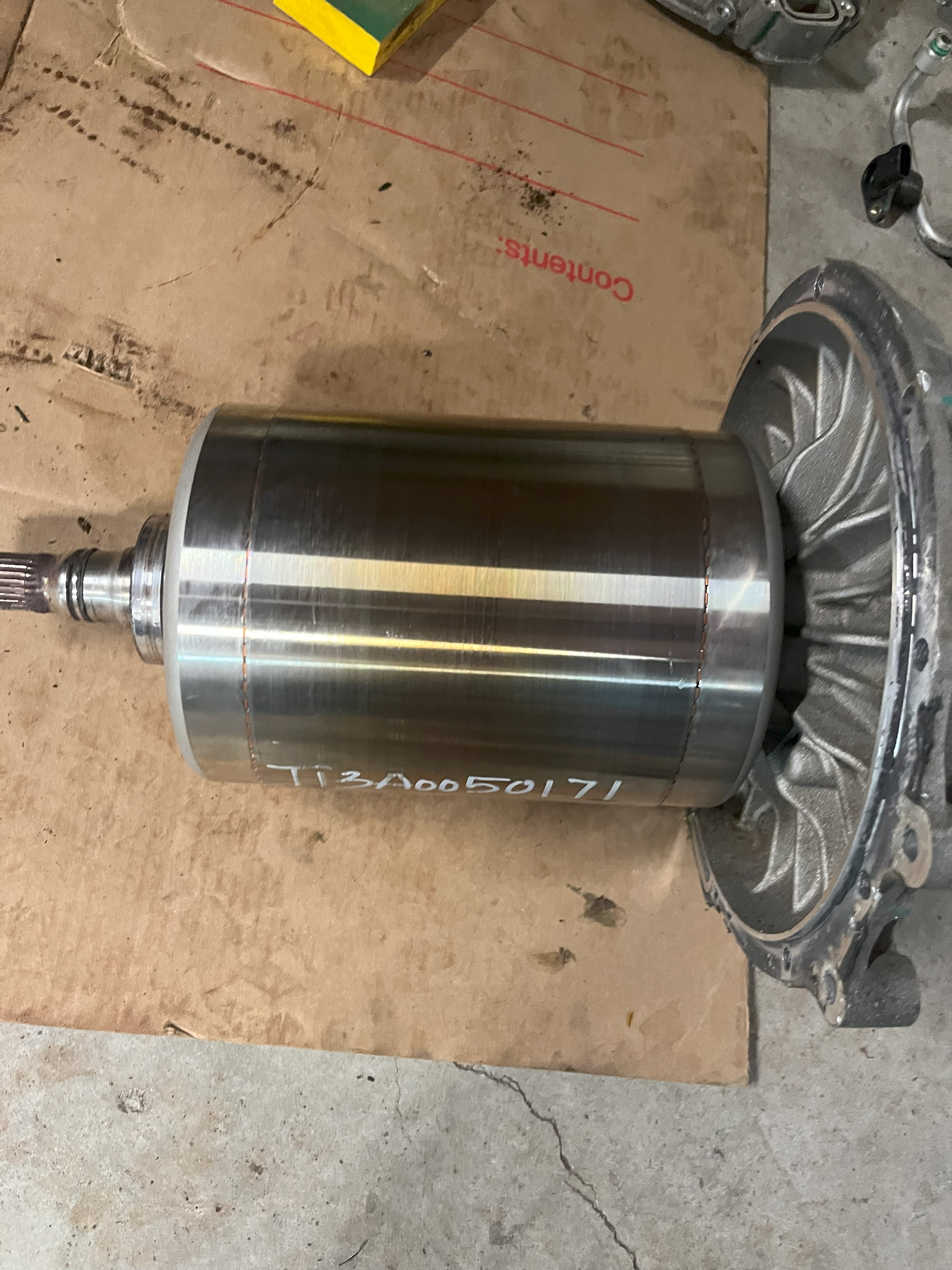

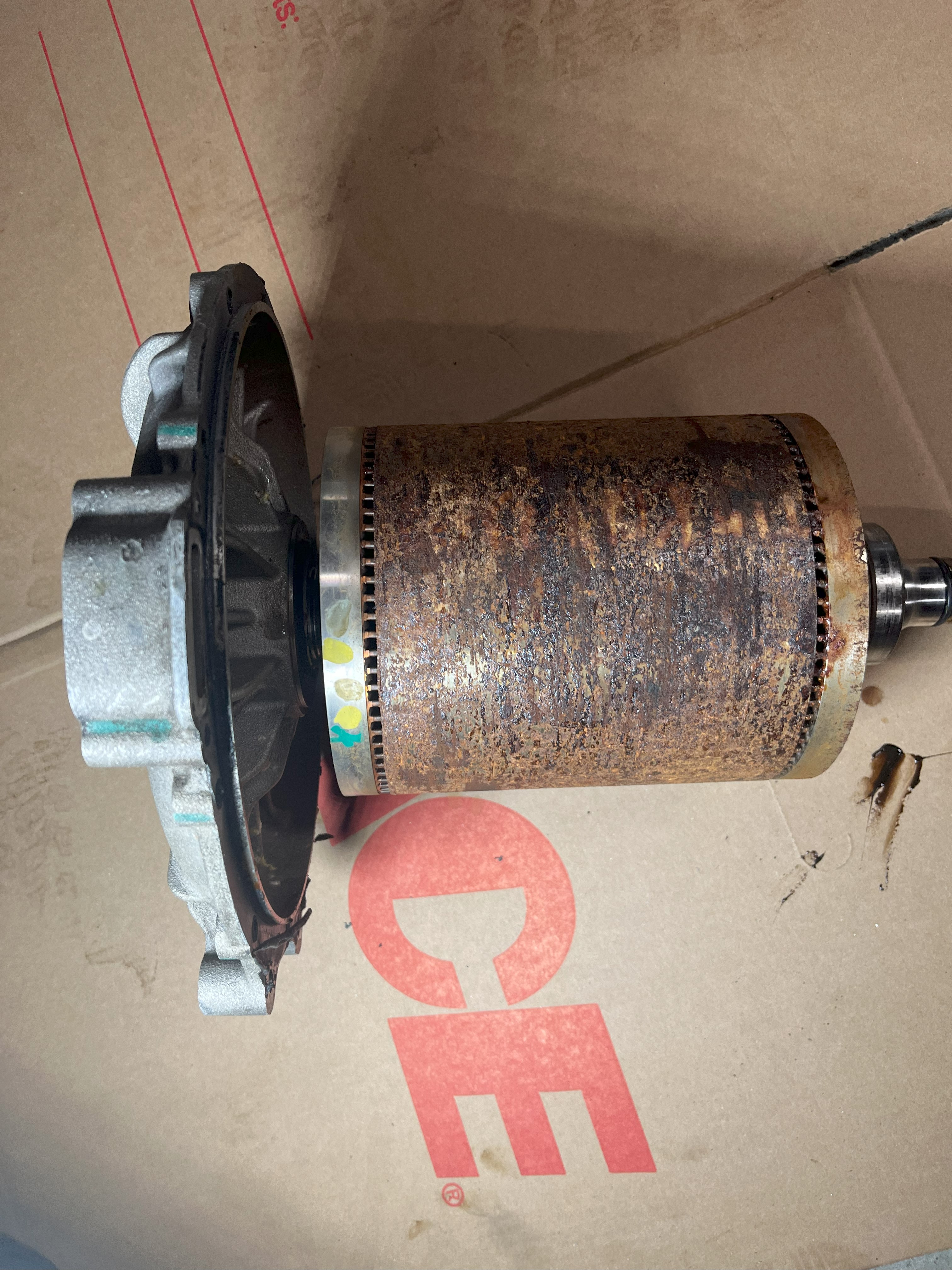

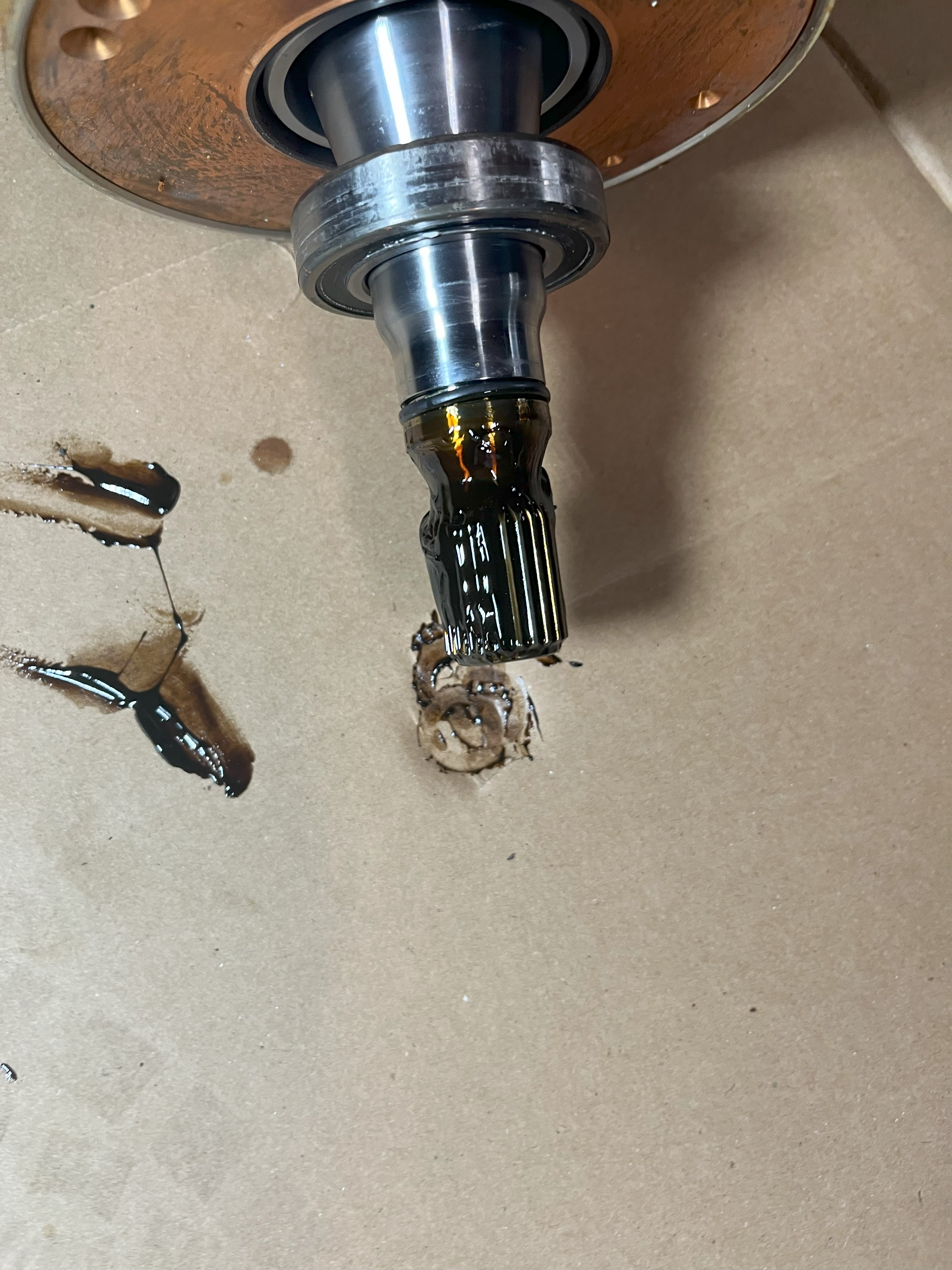

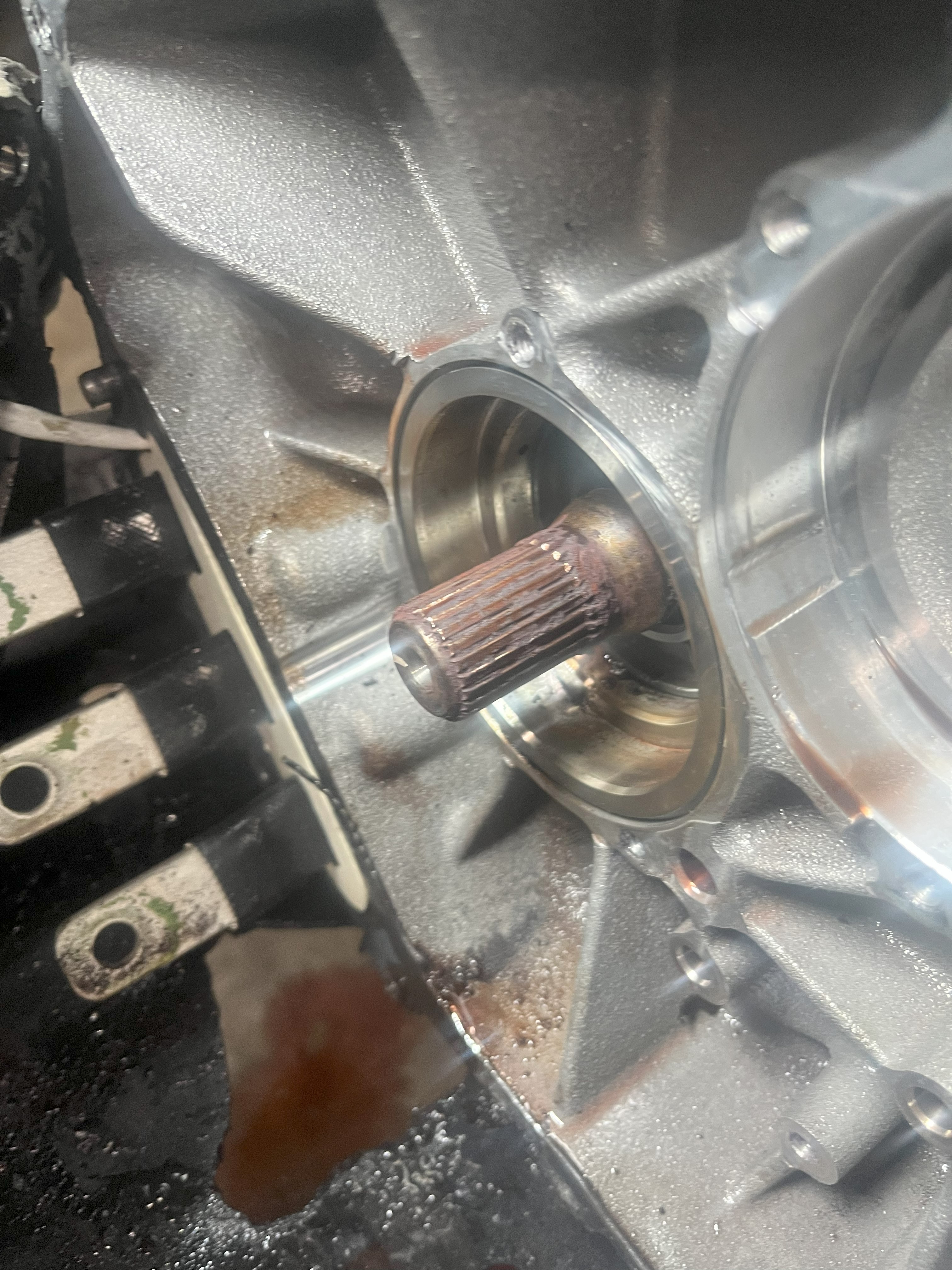

Well I was really hoping to be posting this evening about driving the car for the first time in months, and how great the Sport LDU is, and how I'm taking it to cars and coffee in the morning. But alas, the car continues to fight me.
When I bought the sport LDU last summer, I was told it was pulled from the guy's Model S because something failed in the gear box. He could hear the motor trying to turn but no forward motion. So when I went to put it in the car this spring, I opened the gear box, found no gear damage, then tested with just a axle stub, and everything turned, so I went ahead with installing the LSD and coolant delete, and then installing the unit in the car. Today, after finishing the install, I went to drive it, and the motor spun but the car didn't move. Clearly the test with the axle stub was not enough load to show the damage.
After removing it from the car and tearing down the gear box completely this time, I found what I'd feared - the splines on the rotor shaft and its accompanying gear have stripped.
Fortunately, I have the old base unit sitting in the garage half torn apart. Unfortunately, the old adapter plates are still stuck in it, so I can't get into the case. I'm not going to just swap the sport inverter into the base LDU, because the base case has some damage, the thermistor wires are damaged, and I really want the LSD.
My tentative plan (which I am going to sleep on and decide in the morning) is that I will cut one of the old adapters in half so that I can open the base case, then take the first gear and rotor out of the base, and install them in the sport. Then put everything back together and back into the car. I don't like the idea of destroying the adapter, but I've run out of ways to try to remove them, and the parts I need to fix the new unit are sitting right there - buying new parts would be ridiculous.
In better news, I did find a Bolt charger for an utter song on Ebay, and it should arrive here Monday. Assuming that I get the car drivable, then I will begin testing on the Bolt charger. When I do, I'll start a new thread for reverse engineering that charger. It may be delayed a bit as I have to travel for a family event next weekend, but I may have some gaps in real world work this week that would allow me to go test during the week. I also remembered that a good car friend locally has a Bolt, so if the Volt Gen2 controls don't work, I can probably cajole him into letting me data log or at least investigate using his car.

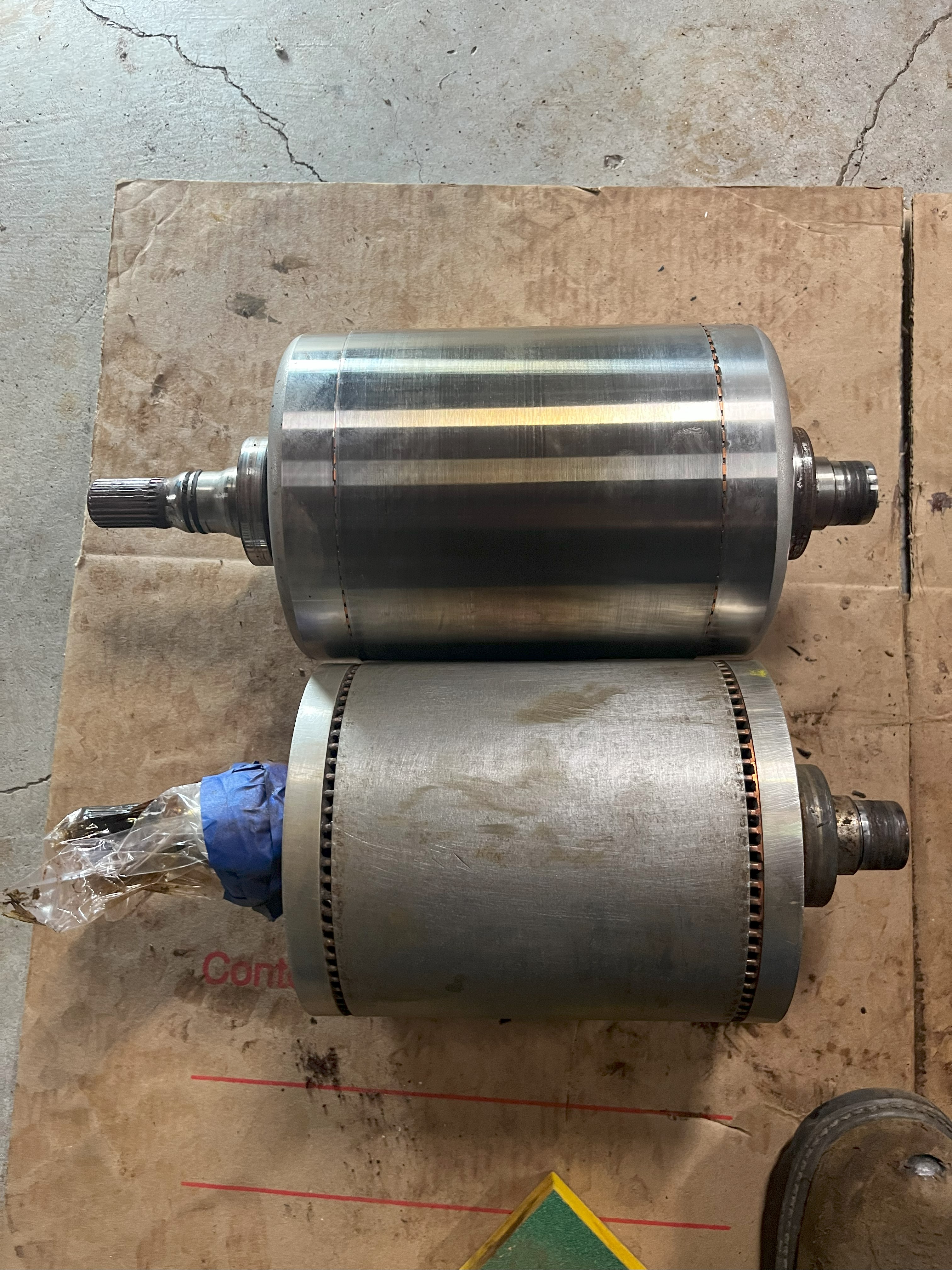

Quick update:
Made good progress on building the Franken-driveunit. Have the rotor with good splines into the Sport unit, still working on getting into the bad gear box to grab the first gear. Interesting differences between the two rotors, will share more later.
Also good news on the Bolt charger. It arrived yesterday, and today I paid for 3 days access to the GM service manuals. Confirmed that the pinout is the same as Volt Gen2 for the control, and also that the control and battery connectors are the same. Unfortunately, the AC connector is different. After a lot of searching around, I figured out it is Aptiv part # 35197127. Which appears to not be readily available, unless you want hundreds of units. I'll figure out a way to test without it, and will likely pick up a Bolt CCS port to get the connector and a CCS port for use with FOCCI.
More details to come.

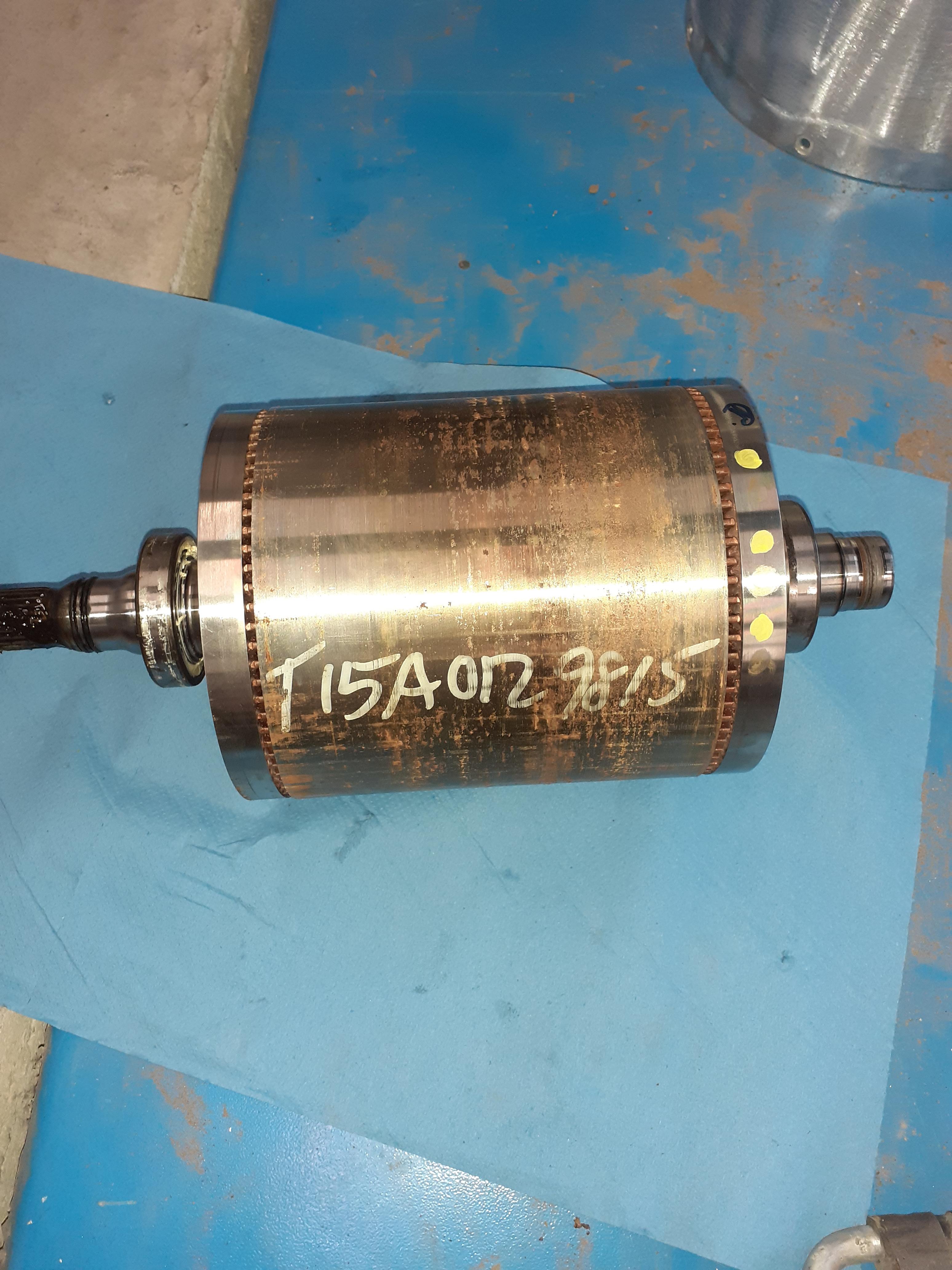

More detail on the above posts:

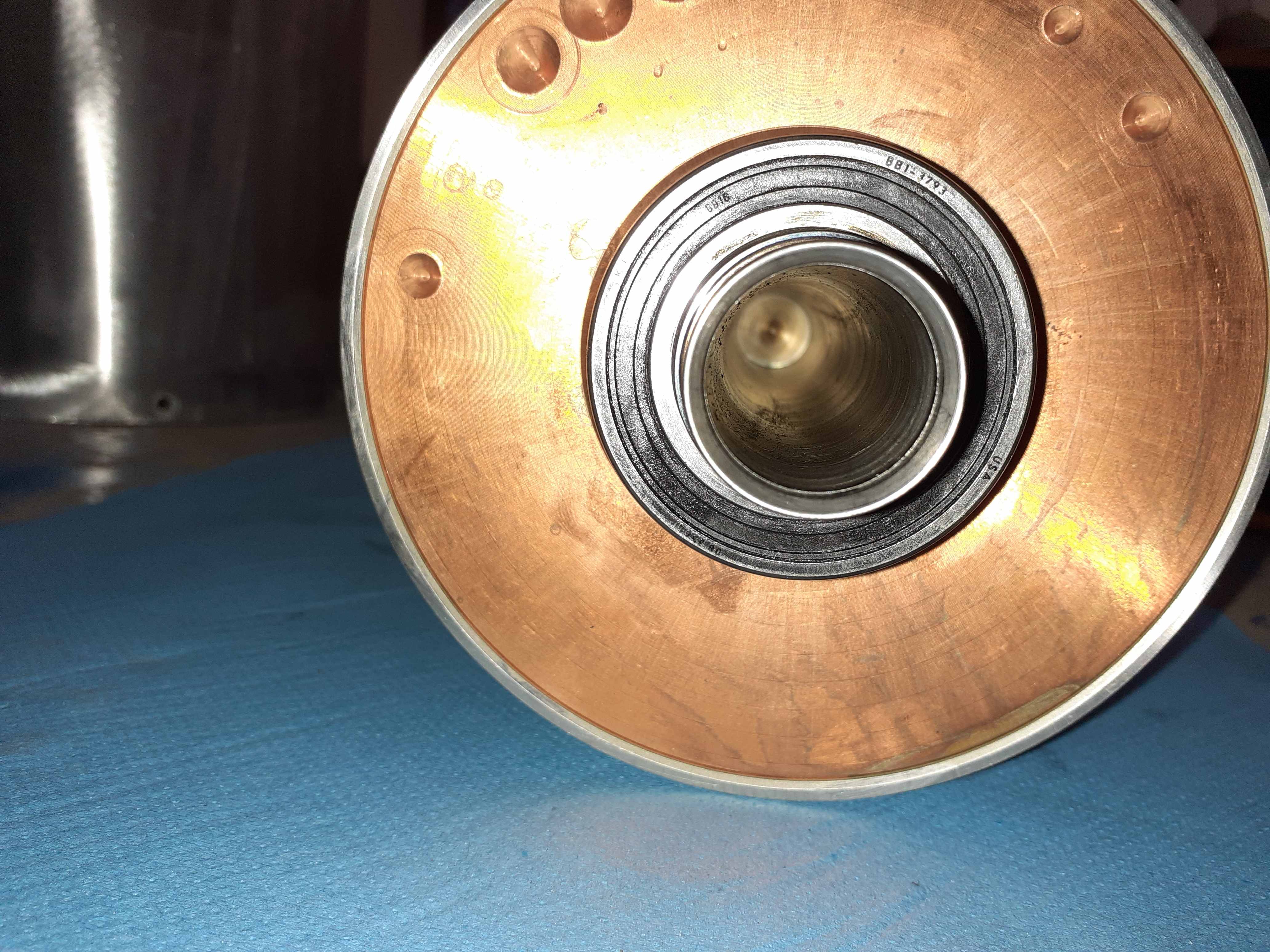

Here's what the rotor shaft of the Sport drive unit looked like: And the shaft of the Base rotor, in much better shape. The Base clearly had a coolant leak for longer than I thought. It cleaned up pretty quickly with sand paper and a kitchen scrubbing pad. The Sport rotor was in much better shape (apart from the stripped shaft. Two comparisons of the two rotors. In my mildly educated opinion, the differences represent design updates more than a Sport vs Base difference. The center section of the rotors appear identical, the ends are different. The Sport moves the mass to the outside, allowing easier access for a bearing puller (I had to modify my puller to get it behind the bearing on the Base rotor). I am still working on cutting through the old adapters on the base unit so that I can open the case and get to the gear I need. I'm also not entirely sure the rotor bearing seated correctly when I installed the base rotor into the Sport case. Not a bearing or case issue, just a factor of me rushing. I'll check that before I finish putting things together. Speaking of bearings, both rotors had less than good encoder-end bearings, so I pulled the gearbox-end bearing from the Sport rotor and put it on the Base rotor encoder-end. This will be truly a Dr. Frankenstein's monster of a drive unit, but it will get me back on the road (I hope).
I am wondering if there is any way to swap the shafts between the rotors, but I have so much to do on the car and so little time that slapping it back together is going to have to be enough.
- muehlpower
- Posts: 807
- Been thanked: 188 times
Re: [DRIVING] 1940 Chevrolet with Tesla Motor
I think you're right. the rotor on my sport unit looks like your base.
P.S.Mangelsdorf
- Posts: 1230
- Location: Raleigh, NC, USA
- Has thanked: 323 times
- Been thanked: 352 times
Good to know!
