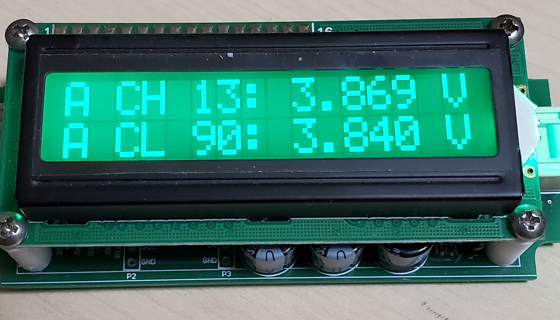

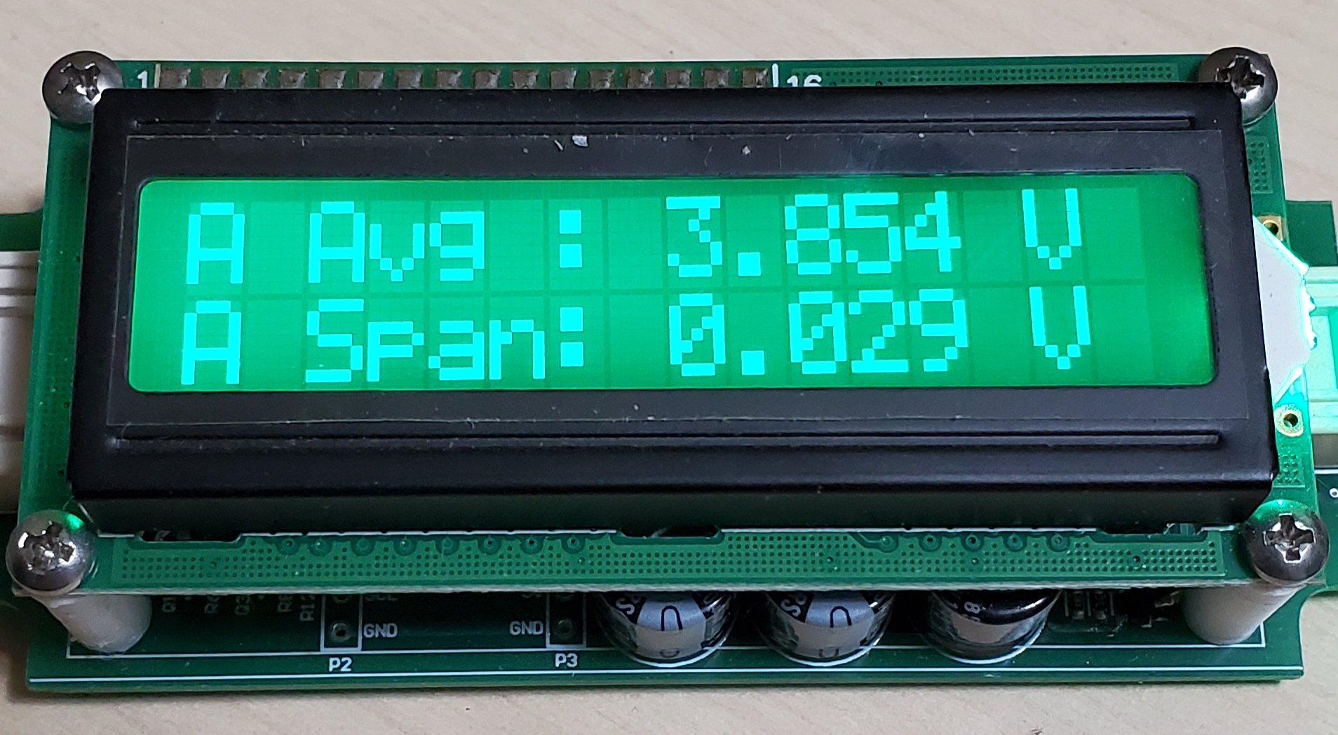

viewtopic.php?t=2085Cookie6000 wrote: ↑Sun Apr 23, 2023 8:01 am ... I found 2 of the 96 voltage taps in the wrong connector position. Success! ...
Might be just too late for you now, but I made a gizmo to help you with finding issues like that. Linking here for future readers.
