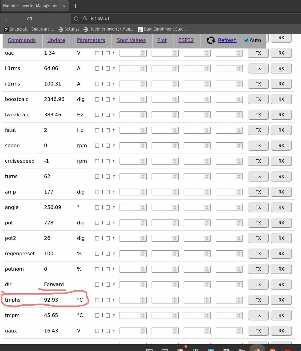

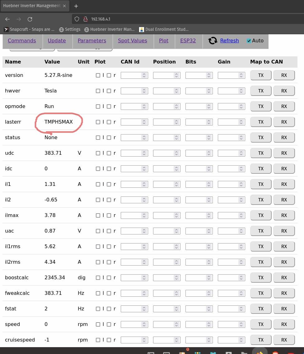

I think I successfully replaced the mosfets and the motor is spinning. Issue is that I can only drive for about a second and tmphs temp goes to 100C and motor stops.
Water pump works and stops too. I checked the voltage and it always has 12v.
Even when the water pump works the inverter gives the over-temperature error TMPHMAX
Tomorrow is another fun day.

In the best case it's just an air pocket. In the worst case some inverter damage. Have you made sure coolant circulates bubble free?

It was air in the system.
Now I am in the same place I was last year in November. Car is running but still cannot accelerate too much. Last year I only had few minutes to test until the car caught on fire and I thought it was some settings that did no let me pull too much power.
Now I get the same. In the video, after I was turning back the power cut out and you can hear that violent sound when the power cuts out. Wheels still spin while the electric motor stops.
From the water pump I am splitting the water hose between the inverter and the motor. Should I push all the cold water through the inverter first and from the inverter to the motor? as is now that flow is split. Might the inverter need more cooling?

Yes common practise is to loop inverter -> motor -> radiator -> pump. That way inverter gets the coolest water. With parallel pipes you might get different flow rates in the parallel paths.
The temperature cutout in the inverter software is way too sudden for the SDU temperature slew rate. Must be improved.

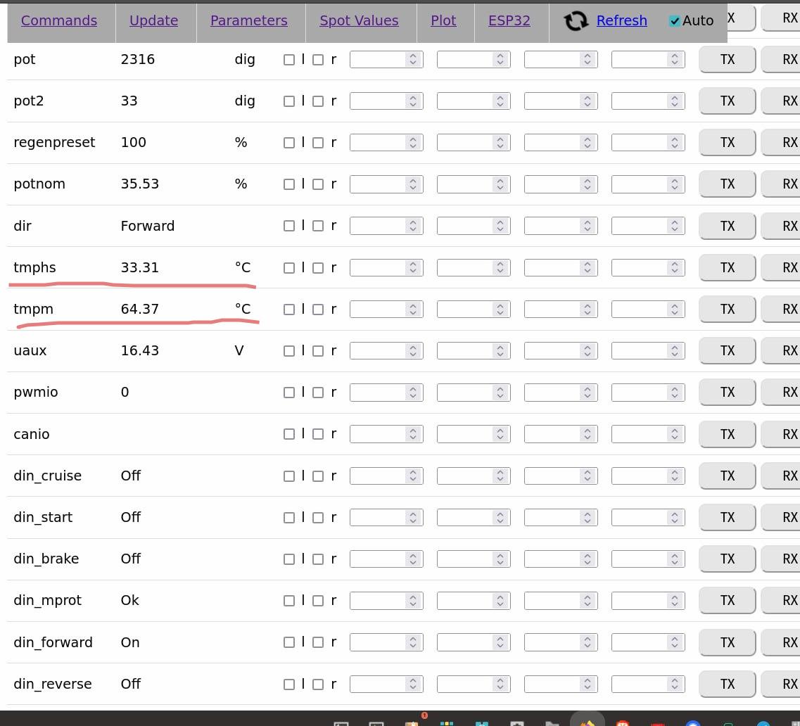

I was able to connect the laptop and get some screenshots while driving. Temperature is under control but the behavior is the same. The error I am showing is: CURRENTLIMIT

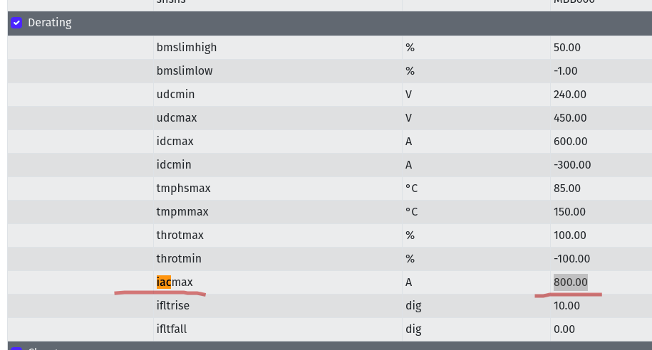

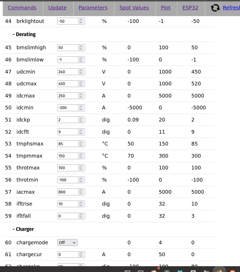

What is the value of iacmax?

Can the Tesla buddies chime in? What is a good value for iacmax?

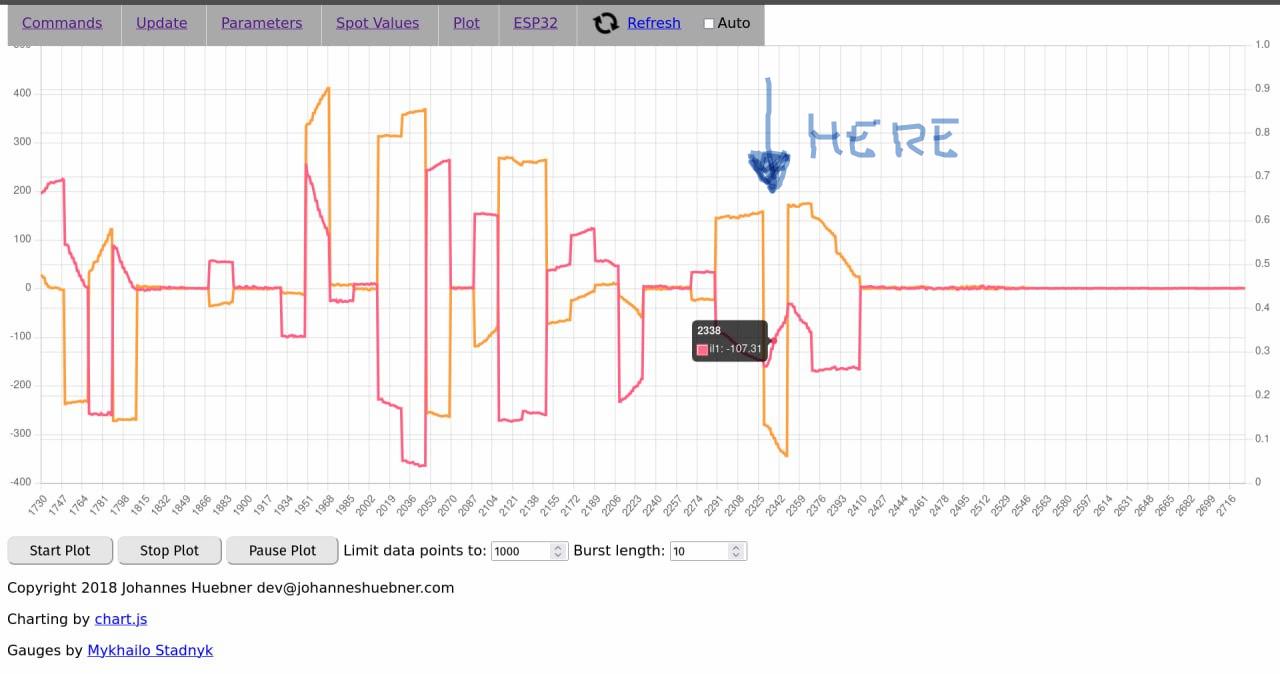

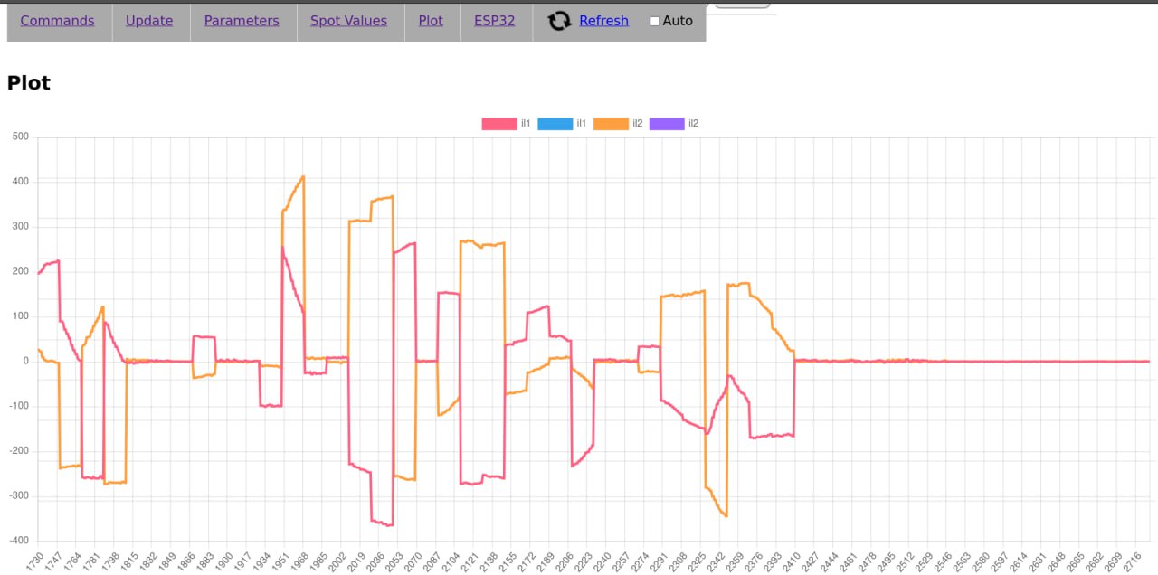

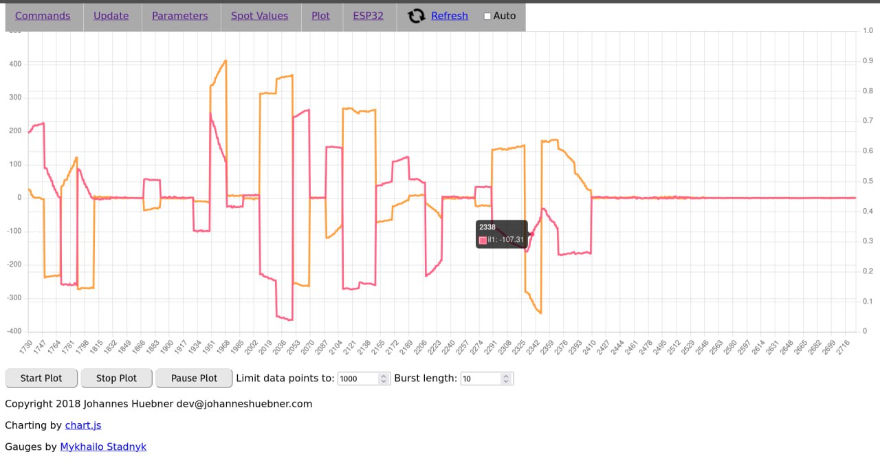

Were do driving hard or just slowly? 800A sounds like a lot to surpass if it's real. Can you plot il1/il2 with 1000/1000 plot configuration

Driving very slowly.
I tried to plot few times in the past but nothing shows up on the graph. Maybe I do not know how to use it.
I will try again afternoon.

Put a checkmark on il1 and il2 then press Start Plot below

I got both, a screenshot and a log file. Not sure which one is better.

So while you recorded this plot you still got juddering?
You can try disabling the iaclim by setting it to 0 and don't punch too hard until someone confirmed it's wise to do so.

Yes, If I recall right I have placed an arrow in the screenshot for one of the stops.

I changed IACMAX to 0 and same thing happened. In the beginning I can go forward slowly for few seconds but after it stops I have to wait longer and longer time to move forward for few seconds. Then I realized that if I go backwards it is not happening and started to go only backwards and works with no interruptions. as soon as I change to forward and try to accelerate it stops. if it is flat or downhill I can go longer forward.
Backwards I even accelerated harder and still works.

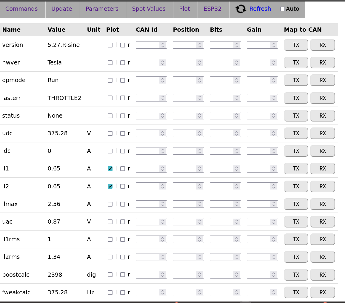

Also the error I got today was "THROTTLE2"

Could it be something mechanical?
You are using potmode=DualChannel and maybe the second channel is not connected?

For the throttle error, indeed I am not using 2nd channel.
Did not know there I a setting for that. I will correct that and see what error I get next. If therebins going to be an error.

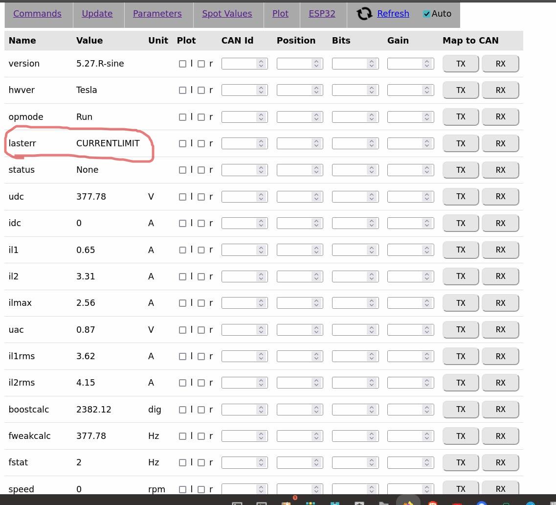

OK, another test-drive on the road and Video.
There is any setting that would limit the Motor spinning backwards?
I am still getting the CURRENTLIMIT error.

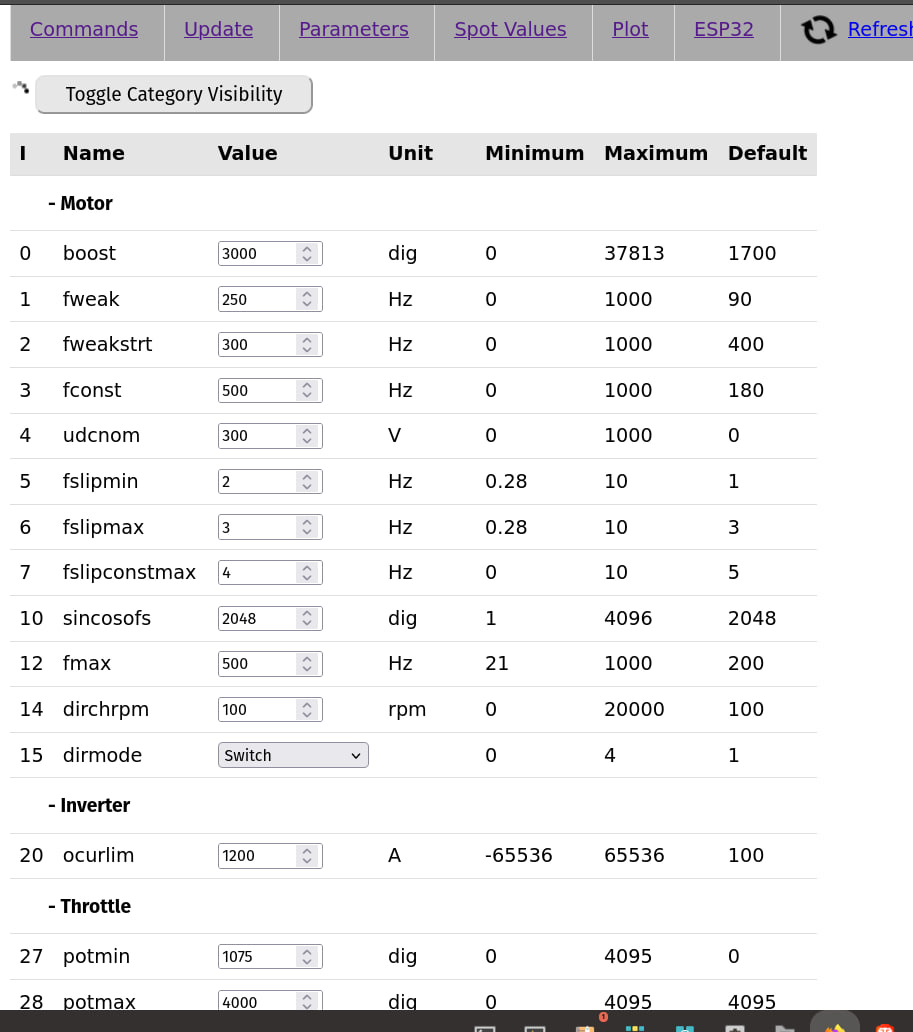

The settings I have I are from here:
https://openinverter.org/parameters/ It shows as experimental, but that is all I found there to start with.

I tried to use this firmware before but the car does not start. I do not have a wire from the brakes. I installed it again today but I cannot figure out how to start. is there any setting I can change to run without pushing the brake pedal until I install that wire?
And there are any parameters you suggest that you know should work on SDU? I tried already few of them I found on this forum like
this one : https://openinverter.org/parameters/view.html?id=27

These are known good, yes.
Set cruisemode to off, that will skip the brake check
