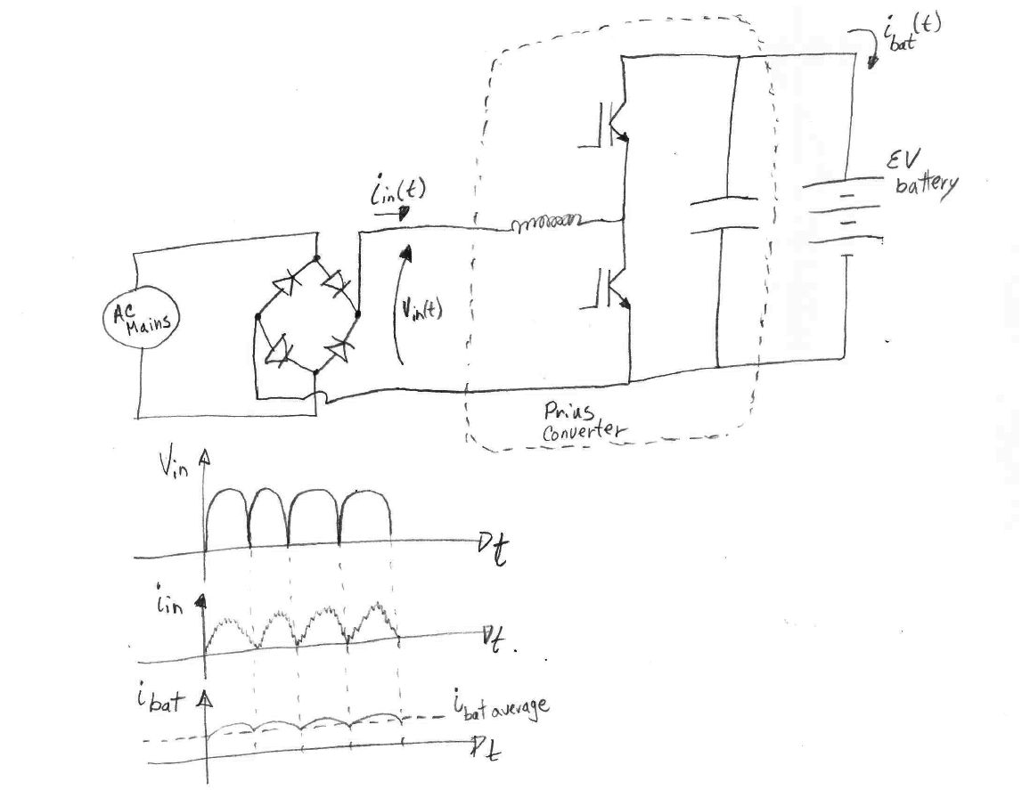

Hello everyone. This is my first post on the forum. I am an electrical engineer, although my experience is mostly in software, but I can still get by on the hardware side. I converted my first vehicle to electric drive back in 2011 and I am still driving it every day. It is a Subaru Forester, with a Warp 9 DC motor, a Soliton 1 controller and Thundersky 160Ah cells.
EV technology continues to progress and the quality of the components continues to improve while the prices of salvage EV parts continues to drop. I am very excited about using the Prius Inverter in future projects.
I have been thinking about how to use the Prius converter as a battery charger and I wonder if I am thinking about this the right way.
The rectified mains voltage would come in to the inverter converter where the battery would normally connect in a Prius, then the battery of the EV would connect in parallel to the main capacitors on the DC bus inside the inverter converter - right? (see sketch).
To get the most power into the battery from a current limited AC mains source (say 15A, 240V breaker) the power factor becomes a 'factor' (how much so, it not really clear to me).
The good news is that the power switching architecture of the converter looks like it is suitable for power factor corrected current draw. By pulling current from the mains 'in synch' with the waveform of the voltage, you can pull maximum power from the mains (for a given mains current limit). The amplitude of the current waveform draw can be chosen so that the desired average battery current is pushed into the battery.
However, the Atmel micro that is controlling the converter in Jack Bauer's design needs to be aware of the mains voltage phase. Looking at the schematic, I don't see there is this capability. I am not sure how to include it, but this may be a feature that could increase the capability of the charger with limited number of added components on the logic board.
What do you guys think? Is this how it works, or am I out to lunch?

That's exactly the idea and you are correct that the micro currently does not have any mains voltage phase sense. My plan was/ is to see if it will work at all and then upgrade the hardware to correct the pf. I hope to get back to this soon but I've sold out of boards and have an insane project load going on:)

Yes well my idea is more of a powerhouse.
I would connect in opposite. First i would connect 3phase lines directly to transistor bridge where diodes would serve as rectifiers. That is how i would get 600Vdc on input.
Then i would connect main EV battery of 380Vdc downstream of inductor and pushpull block. You are correct there should be current control with output voltage control implemented. BUT If we already know what the input voltage would be - say 580Vdc at maximum strain we could just calculate correct buck function to output say 45A to get 20kW from EVSE. Control could then be much simpler.
What is the working frq of the inductor, anyone knows? I would like it to be some 16kHz so i wouldnt have to listen it whine.

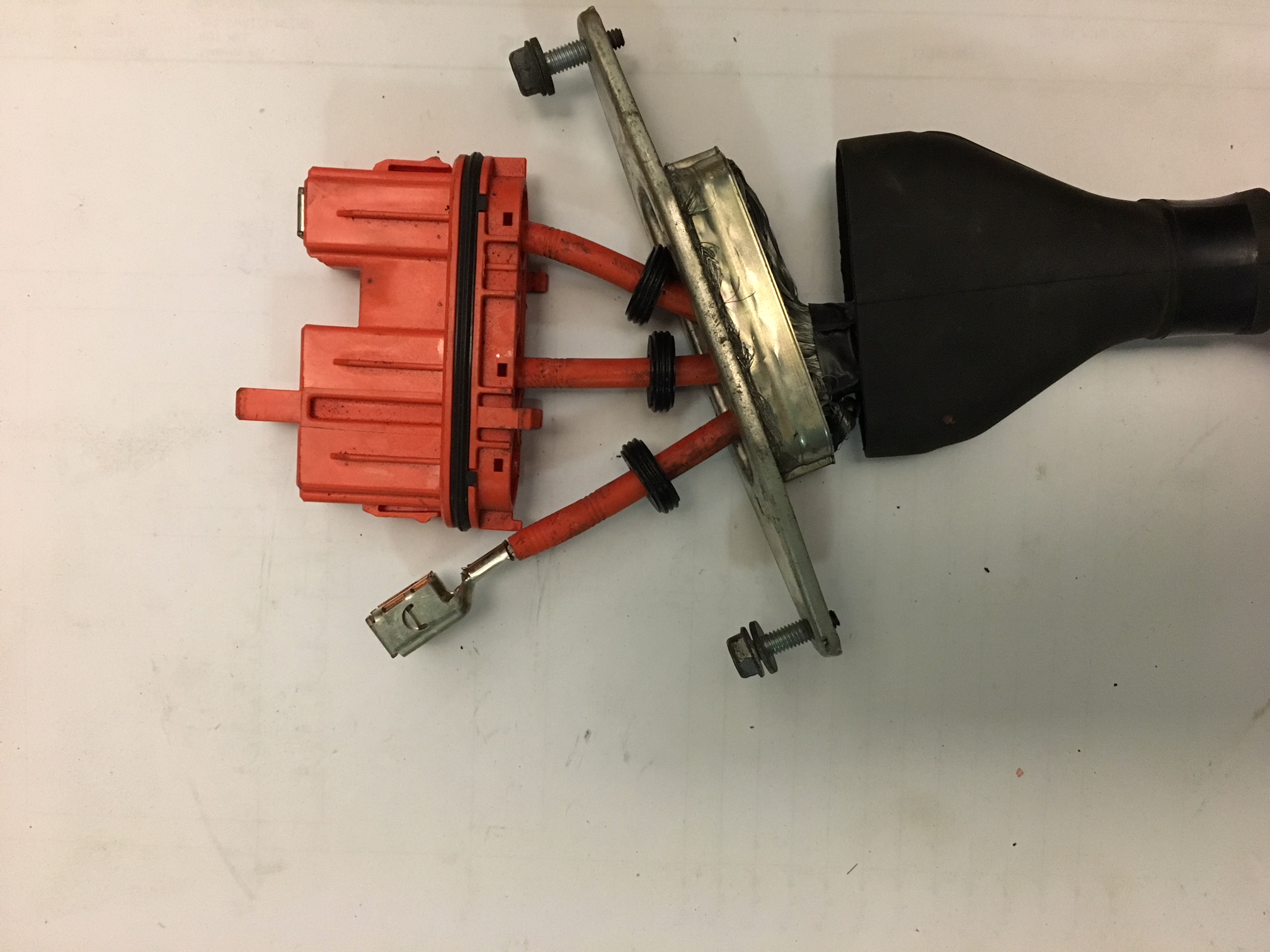

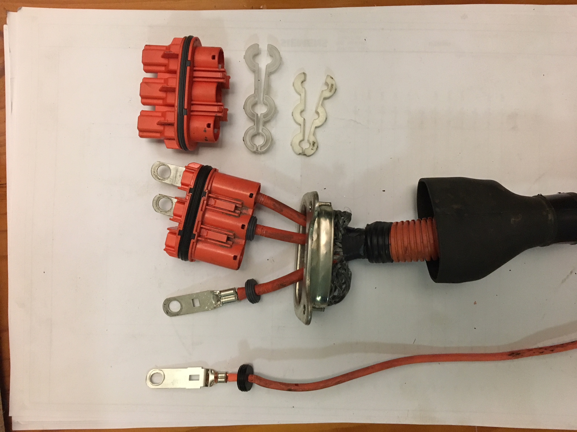

I have been able to get one of the Prius Gen 2 3 phase motor connectors to fit a Prius Gen 3 inverter connector by shaving a bit off of the sides of the flat connector. This took about 15 mins work.
At the moment, I have not been able how to work out how to convert the second Prius Gen 2 cable to Prius Gen 3 inverter connector.
Interestingly, the silicone gland diameter for the Gen 3 connector is the same diameter as for the Gen 2 connector gland.
Only tools i needed were a vice, file, and small screwdriver to pop out the white plastic inserts, -and of course the original Gen 2 and Gen 3 orange connector housing.

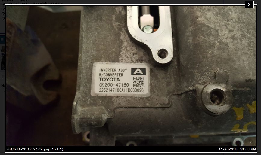

Have been hunting around, looking for a Prius inverter that is the same as you have. I found this website:
http://www.toyodiy.com/parts/xref and they provide cross referencing / compatibility for Toyota parts as installed in the cars.
I found your inverter label on the DIY electric car forum: When I put your part number in the website above I don't get a match.
Can you provide the VIN number of the car that your Prius inverter was taken from? That can be put into the website to see what other inverter part numbers are 'compatible'.

We have a number of these inverters. All taken from N. American market Prius. They all have the same number.
https://photos.app.goo.gl/p5QvGvCi7bQTgFiA7
