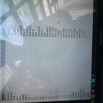

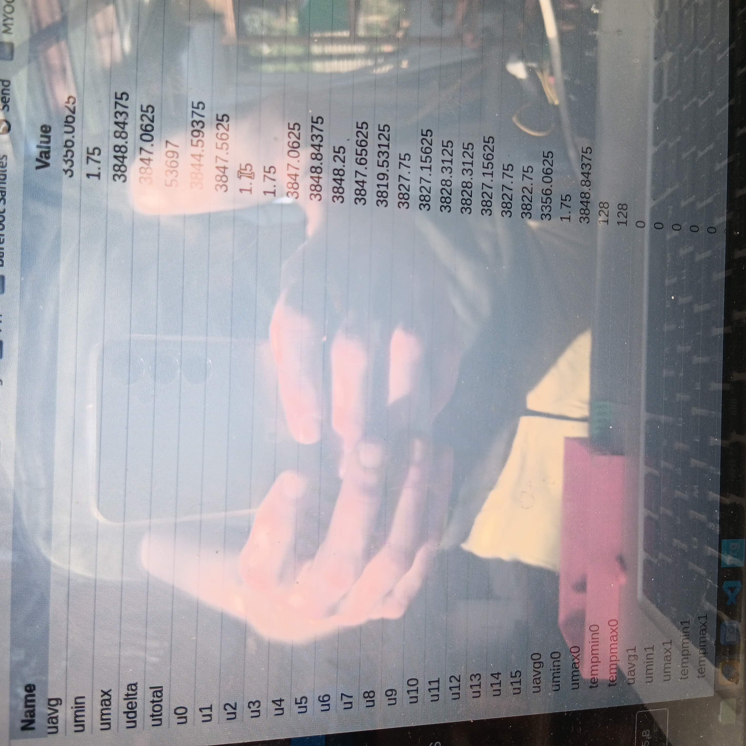

I've got a possibly FET related issue,
On 3 of my boards I have odd voltage readings.
U5-U8
U2-U3
U2, U6, U10-U11
Would the first port of call be to check the voltage between the drain and source on all the FETs?
On a board with correct voltage readings I get around 0.6V in diode mode on a few of the FETs but I've not checked them all.
I did swap the headers and may have damaged the solder pad in doing so but I still get continuity from the header pin to the resistor so assume all is OK there.

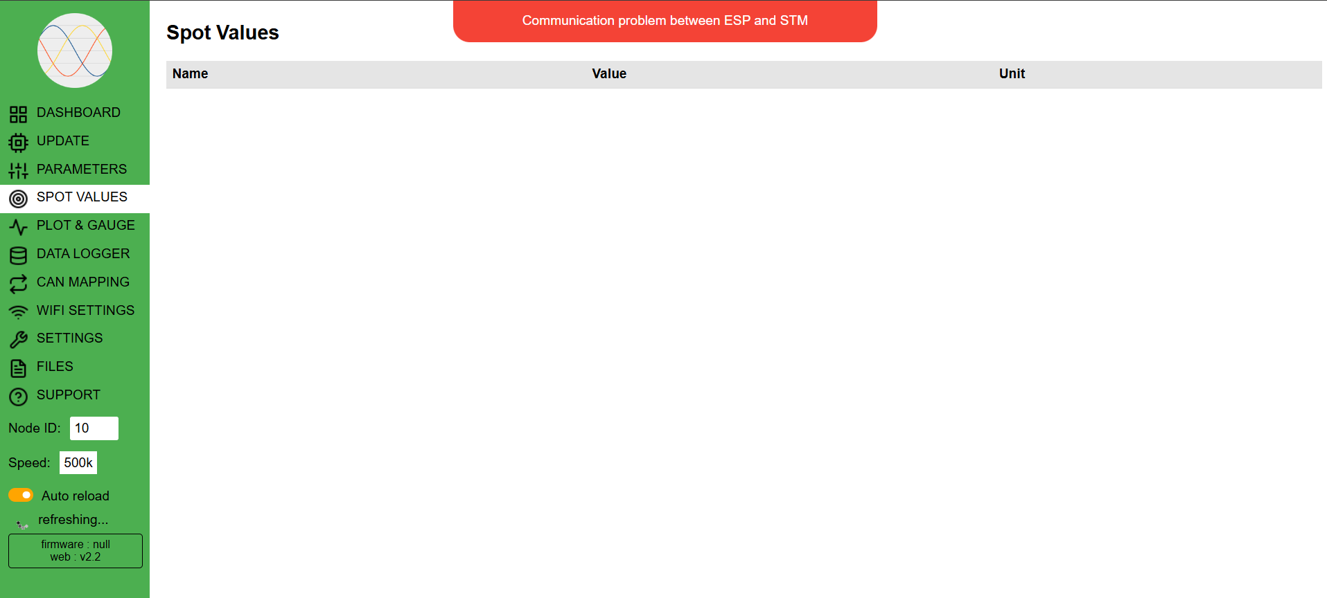

I recently received six ADC16 BMS boards and an ESP32 board from the OpenInverter shop. For testing, I connected one BMS board following the instructions on the wiki:
ENAL_IN and 12V connected to a 12V power supply
GND to GND
BMS CANL to ESP32 CANL
BMS CANH to ESP32 CANH
I successfully connected to the ESP32 via Wi-Fi, accessed the web interface, and updated the Node ID to 10. However, I’m encountering the following error:
"Communication problem between ESP and STM"
Could you please assist me in resolving this issue?
Thank you!
Been thanked: 1913 times
Re: Flying ADC 16 channel BMS 96S test
By default there is no termination resistor. Close the solder jumper JP1 on the wifi module to enable one.
maiks
Posts: 96
Joined: Thu May 11, 2023 9:20 am
Has thanked: 7 times
Post by maiks »
johu wrote: Tue May 06, 2025 2:56 pm By default there is no termination resistor. Close the solder jumper JP1 on the wifi module to enable one.
it has worked .thank you

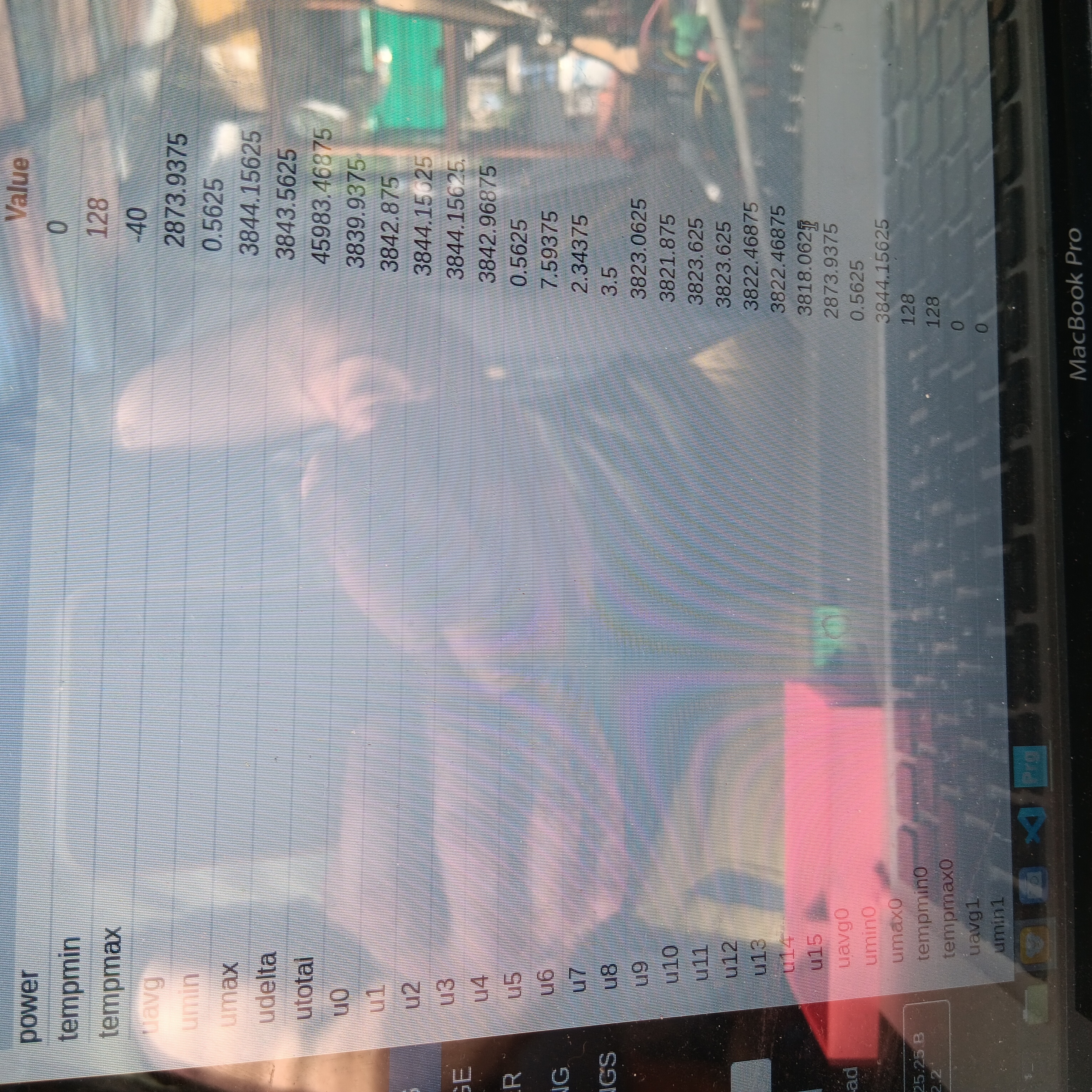

Post by PetersonOctavius »
i had 6 boards working just fine. after upgrading to .25.25B two of them randomly got the muxshort.
so far not sure why the random muxshort. i upgraded all the other boards, they are working fine. some i unplugged the battery before updating, some i left the batteries connected. all where fine.

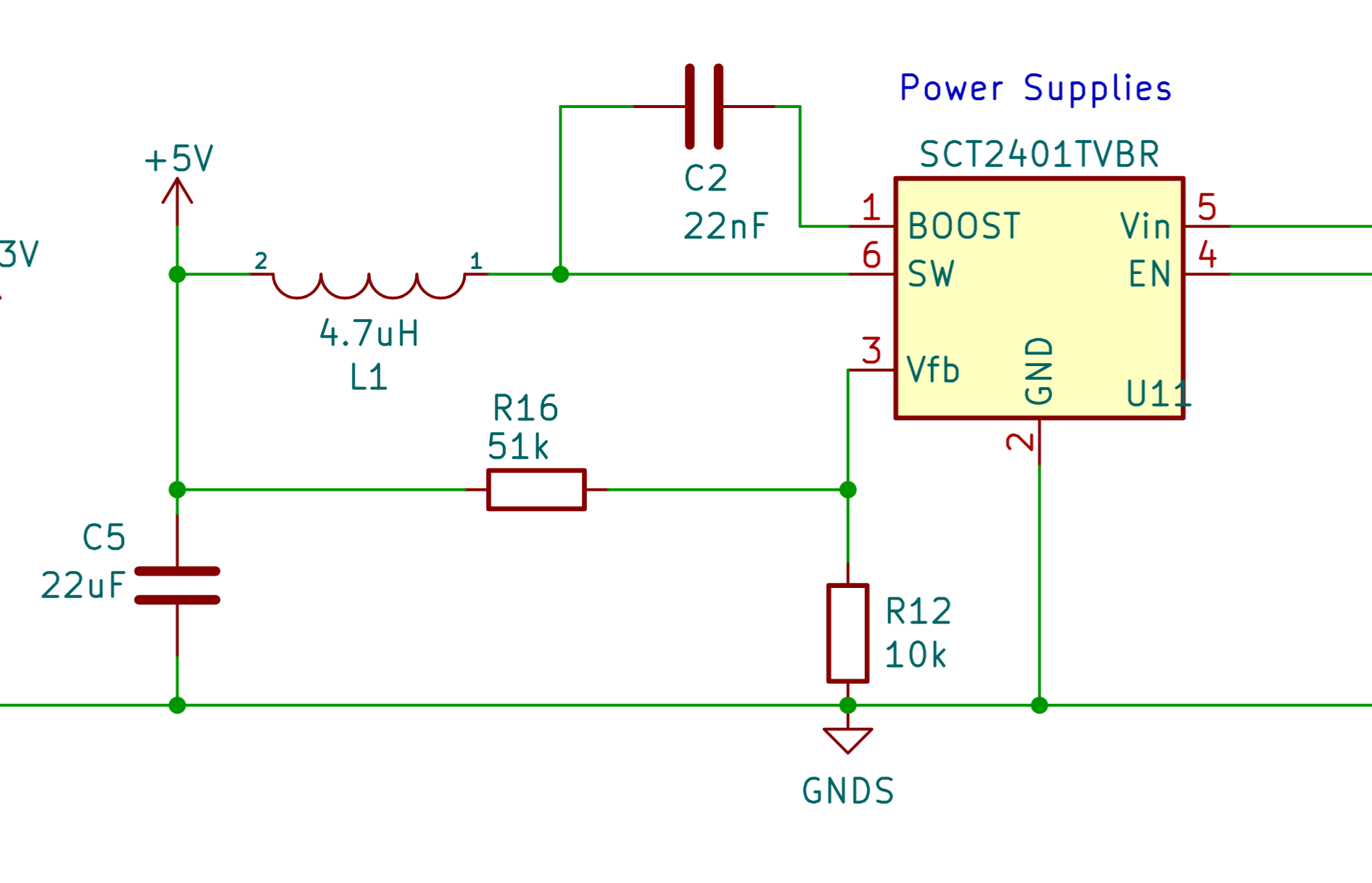

i found 5 fets not giving the 0.5 when i did the diode test with a multimeter. i removed them from the on board and put it on the other one.
couldnt test it cause my 5v regulator got damaged. (dumb of me for swapping 12+ and ground).
is there a replacement regulator of mouser maybe?

lm2734 (LM2734YMK/NOPB) or other PNs in same package could maybe work. Please compare LM2734 12V->5V bom and the above BMS switcher bom if actually compatible, pins seem to be compatbile.

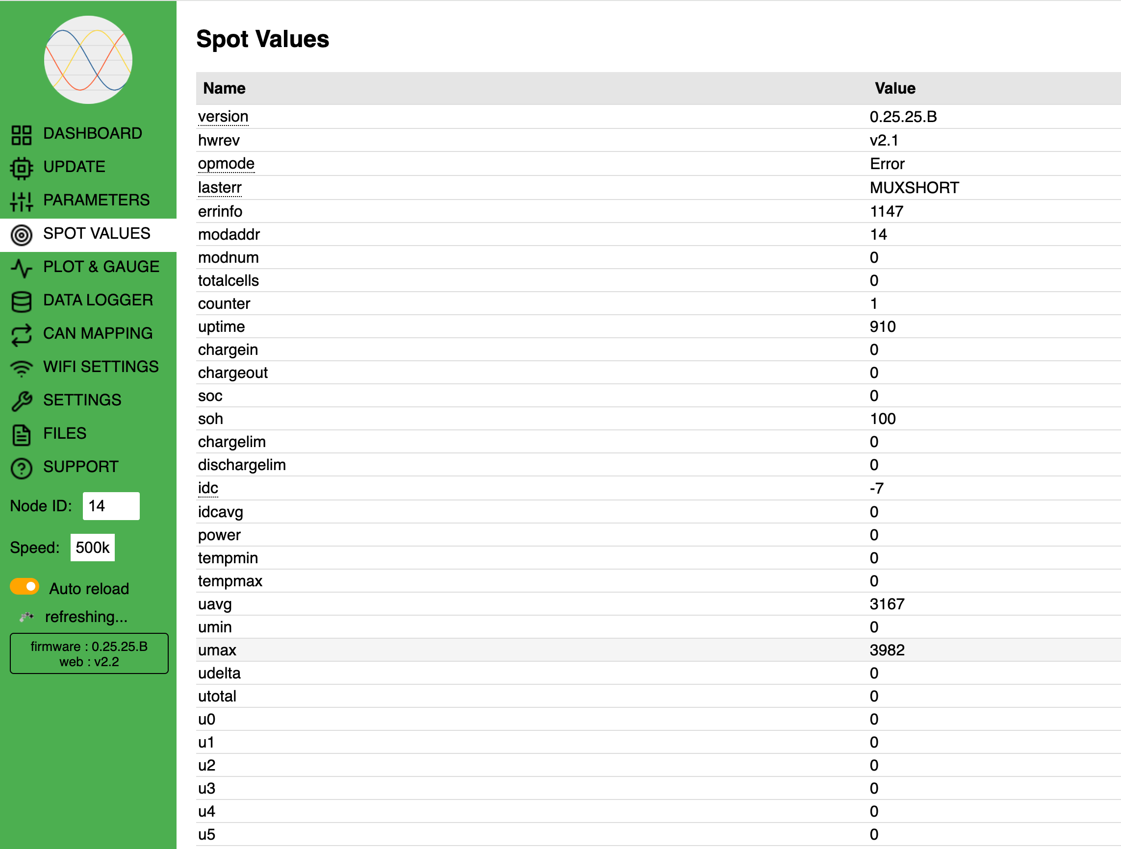

i did not see that coming...

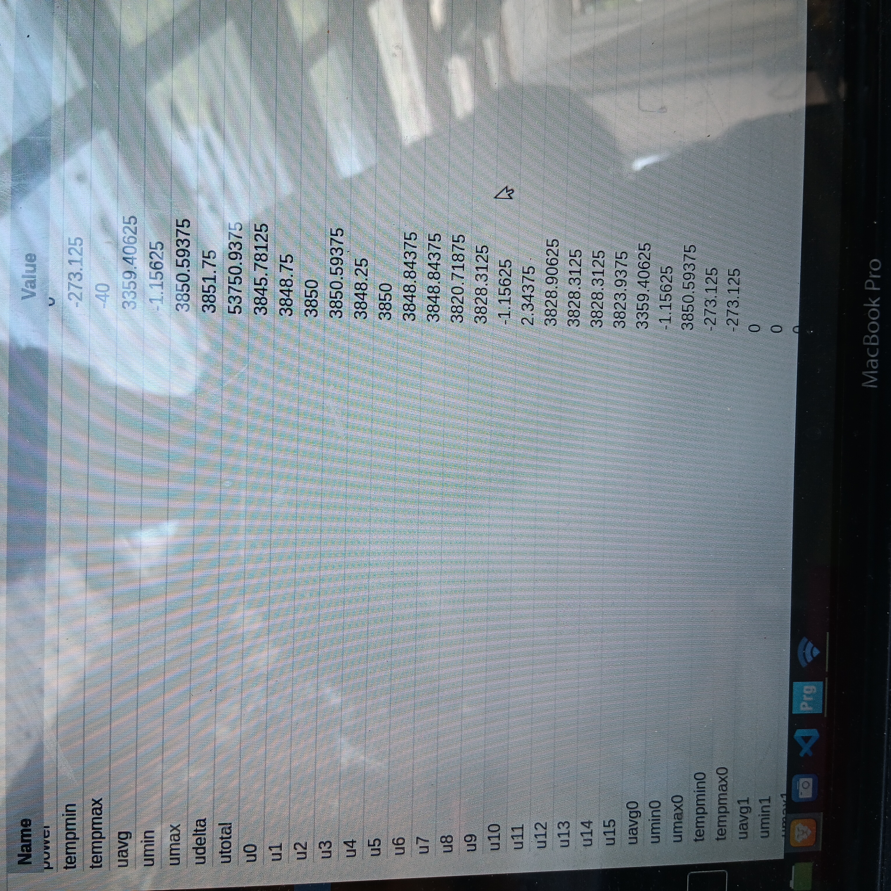

i ve been running 5 bms boards, for 3 days, no issue, just balancing away.
to my surprise, randomly got a MUXSHORT error today.
the car was charging at the time.

I am now at the point where I should connect them to my LG MEB modules, but seeing the random muxshort current destroying polyfuses by BMS taps, I am not very keen on angle grinding all of the modules open at a rate one per day. Probly going a different route for the time being. :/
That sucks. Even modules that worked fine for days go bad and even the v2.3 ones with various precautions don't last and even at only 12S, i.e. half the blocking voltage of the FETs.
So far it still seems contained to stacked modules, right? No single module ever broke as far as I'm aware.
