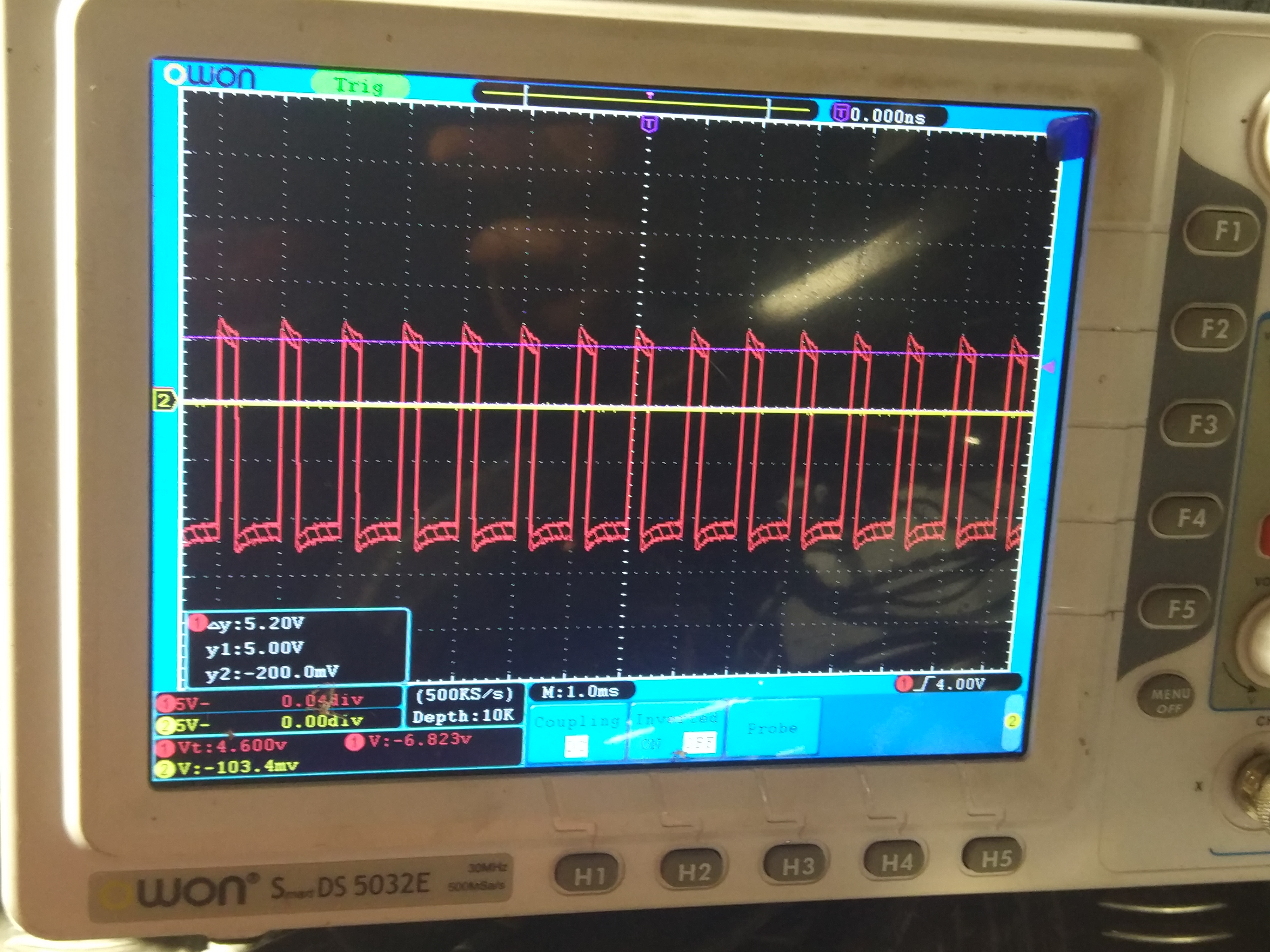

Damn... it wont work no matter how i set my CAN MSG. And to think i tried it dry a week ago and it gave me 8A!
I am begginning to think its my EVSE CP signal. Yet it is no different than a week ago...
I will try to expand it a bit.
EDIT: It was CP signal. When i tested it with my scope it seemed awfull small duty. I verified this when i opened my EVSE. Inside a resistor broke off. It was the same resistor that fixes your EVSE current limit. Of course without this resistor it was set to "ventilate" at 6Aac.
Now that i set this straight i get good 16A from both chargers. I will observe a bit just to be absolutely sure :).

But after some time my EVSE dropped the contactor. I cant connect anything to it anymore.
I am now thinking poor Simple EVSE couldnt supply enough CP signal to TWO chargers and its DCDC released its magic smoke. I will try what happens on my desk...
EDIT: Nope, EVSE is fine. It looks like the first charger shut itself down and wouldnt pull the EVSE in. The second one could do the job, but not in paralell with the first one. Maybe some CAN msg collision?
I also pulled the rest of wires out and repositioned the EVSE plug. Yes the first charger started to react and would feed 8A.
I will experiment some more what happens. It seems like two chargers online start to pull CP but something happens and they release it.
I may make a copy of CP signal with some transistor pair and feed both chargers the amplified version. Of course CP resistors will be pulled in through my circuit.
EDIT2: Yes that is exactly the case. Once the first charger pulls EVSE in voltage on the line falls to some 6V and after the second one pulls it further voltage falls down to 2,5V and at that point both chargers release EVSE because they think it is an error.

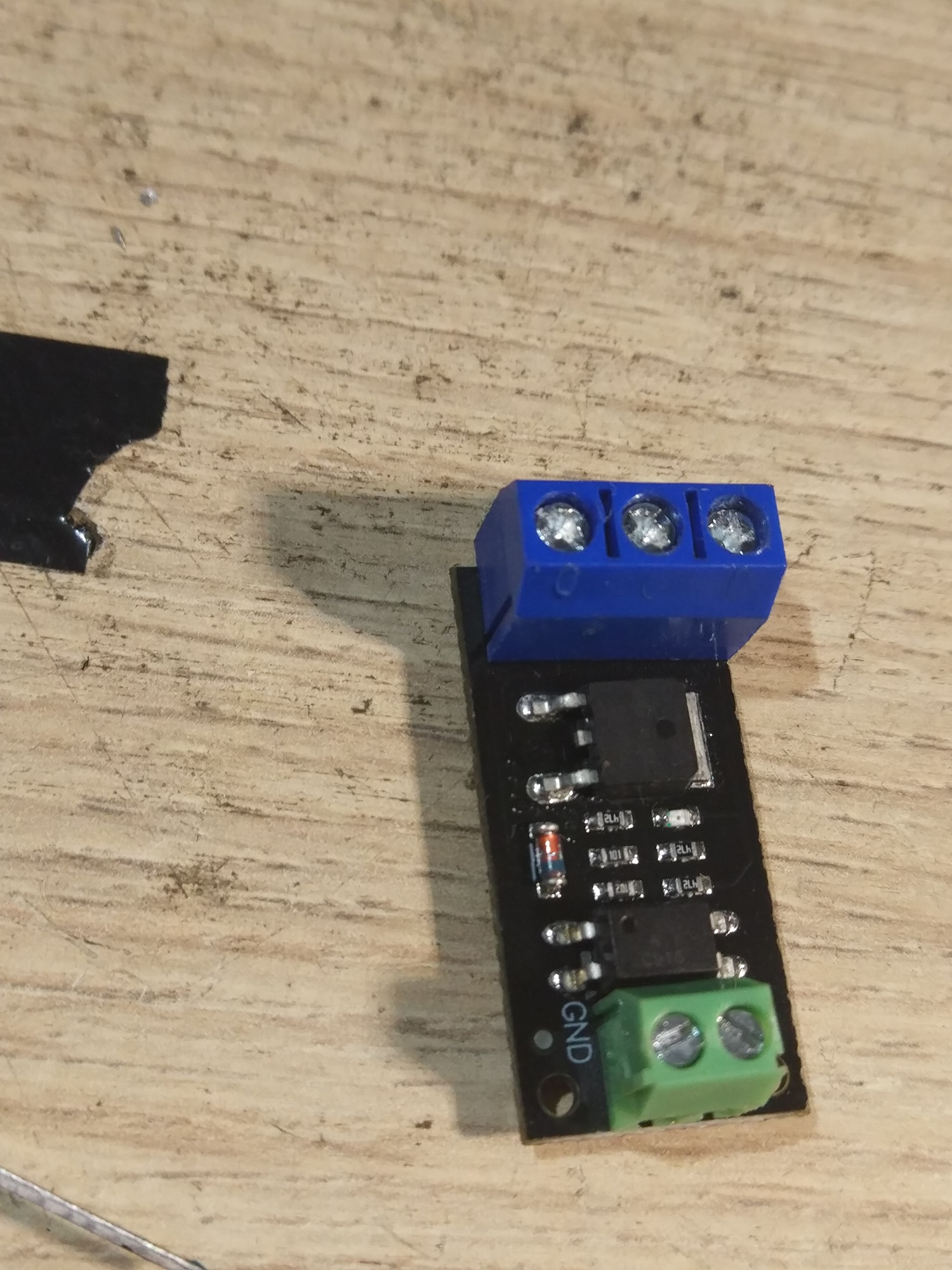

Next i took my pulse generator and first made 12V peak to peak function. I got both of the chargers ON! Good. Then i adapted the weave form so it was 5V to 0V PWM as it would be with signal from transistor. If i kept signal at 5V second charger would work good. But if i would lower this to 4V charger would release CP.
I will really have to make a transistor circuit to repeat CP signal from inside my junction box.

I used simple opto isolated mosfet module with 1K pullup to 12V and it worked immediately. I could vary the power through EVSE button setting and both chargers responded to varrying CP signal.
What is more i also connected Eltek charger on the first phase and together i got 21A which is a little less that usual due to the high SOC value at 390Vdc.

Now my second problem is i get 4V peak CP signal on connection. My DIY EVSE is not picky, but i guess OEM EVSE needs 6V and is waiting for connection at 4V.
I Will try to get CP signal into my DUE board and then replicate it for two chargers using 12V and couple of mosfets.
Anyone has any idea how would i replicate CP signal with Arduino? Do i just interrupt sense the PWM and use some digital pins to output the same signal to both chargers? Would that leave enough of computing power for CAN bus and other stuff on DUE?

I figured charger works good with simple 12V square PWM signal. So i just need to send CP signal into DUE and sense the square weave to output two identical square weaves on two PWM pins. How hard can that be?
EDIT: Or i can just sense PP pin, pull CP in and just bang away with PWM analog write. Not possible to listen to EVSE changing its pace, but it will work :).
EDIT2: Yes, on CP pull in I simply start analogwrite() on PWM pin 2 and with 3V signal i can get the charger with mosfet module to charge at whatever i select for it as duty. Next should be to install two mosfet modules on both chargers and charge using that.
Last i will prepare CP duty reading on my DUE. This should make a fairly simple amps reduction in case EVSE changes its state.

Well, there was a fair bit of modification required. I spent a lot of time trying to get chargers to accept fake CP signal.
First of all i used some mosfet power boards. But mosfet really wouldnt do. I tried all sorts of pullups and signals etc...
But then i accidentaly burned that mosfet element. What to do...? I havent had any mosfets to replace it. I took one MJD122G NPN darlington transistor that i had here and replaced the burned mosfet. To my surprise NPN module worked the first time with pullup 220R and both chargers started on my fake CP signal while DUE board was pulling the real CP signal down with 880R combined resistance.
I took pin D2 which is PWM output and used analogwrite() function to create 1kHz PWM with duty as should be on CP. Of course i got inverted signal because of NPN and pullup. But all i had to do is invert my duty from 30% to 70% and i get good 30% function.
I put both transistor modules down in the box with the chargers. PWM signal is fed on a single line and then transistors split the signal to each charger.
Then i closed up everything and went to test charge on one OEM EVSE to be sure.
