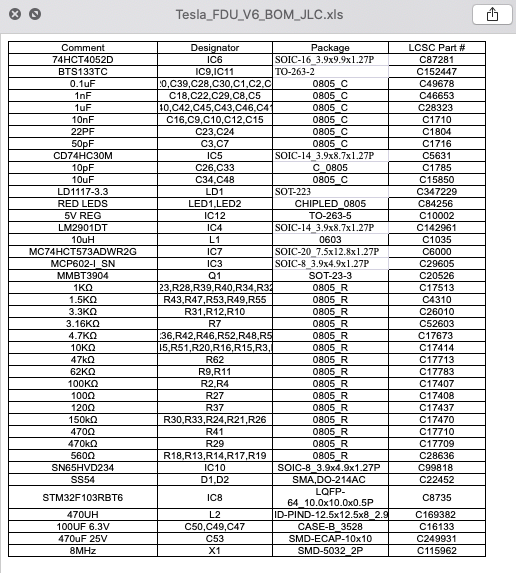

Please see the previous posts on how to tell if the wrong resistor has been fitted.

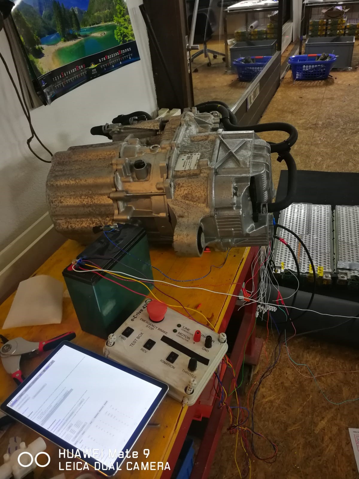

Bad news from my side!
I changed resistor to 3k17 but dinocur still on error!
anyone with better results?

Can you repeat all the previous measurements and post the results with the changed resistor?

Ok here my measures of today!
before resistor change:
C11 =3.31V to 3.31V
C14 =1.85V 1.19V
C5= 3.8V 2.65V
C8=3.8V 2.65V
R7=4.6V 2.58V
now will try to reload parameters:)

Update:
Parameters reloaded.
Error alive.
Messages: Clear
[1]: WARN - PWMSTUCK
[10]: WARN - HICUROFS1
[10]: WARN - HICUROFS2

Right, let's examine what these voltages mean.
C11 = 3.31V - upper current limit setting. IF the voltage from either current sensor exceeds this we trigger an ocurlim and shutdown.
C14 = 1.19V - lower current limit setting. IF the voltage from either current sensor drops below this we trigger an ocurlim and shutdown.
C5= 2.65V - output from current sensor 1
C8= 2.65V - output from current sensor 2
R7= 2.58V - midpont reference voltage for the current sensor amplifier. This decides the center point for zero amps.
Now in the above case I still suspect R7. If we pop 4k7 3k16 into a calculator such as here :
https://www.electronics2000.co.uk/calc/ ... ulator.php
We should see around 2v , not 2.58v.

Can anyone with the V6 board confirm if C5 is meant to be blank?
I just did a quick look over with a magnifying glass last night and noticed C5 was empty.
Martin
Martin

Looking at the schematic a 1nF is required on C5. Anyone else have parts missing? Did you take care of them yourself?
Martin
Martin

Yeah,my SDU got first LV testing and is alive......many thanks to all who try helping!!
At the moment i have no shaft stumps for higher rpm or can i run it without??

You'll have no oil and I wouldn't recommend it. Also remember that you need cooling if running for anything other than a few seconds... the inverter has little thermal mass and no protection on the power stage

Thank you Kevin. The pads look like the capacitor has been on there but maybe got knocked off in transi. Oh well, good opportunity to learn how to install one!Kevin Sharpe wrote: ↑Thu Feb 20, 2020 7:08 pmLooking at the JLC BOM on Damien's GitHub (here) C5 is required.
Martin
