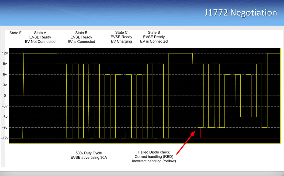

DrJeff wrote: Wed Oct 30, 2019 3:04 amWhen connected to the Proximity line on the controller card, I'm getting +9-12V which is consistent with the EV Connected Ready signal. When I disconnect from the Gen2V3 card (so EVSE connected to nothing I get +12V - no square wave.
As you say those are states A and B and are correct (see image below). Can you also confirm that you get a 1kHz pilot signal with a swing +6V / -12V during charging? Also verify the duty cycle during charging is 66%?
DrJeff wrote: Wed Oct 30, 2019 3:04 amTomorrow I'm going to check the consistency between the GND connections in the garage (I saw a slight difference when measuring yesterday which used a GND from a separate line. All the lines are all feed from the same sub-panel.
I'd recommend using a single car battery to power the BMS and charger. I know this seems like a none issue but the two things I can see that are different in your setup are power supply and 40A single phase :?

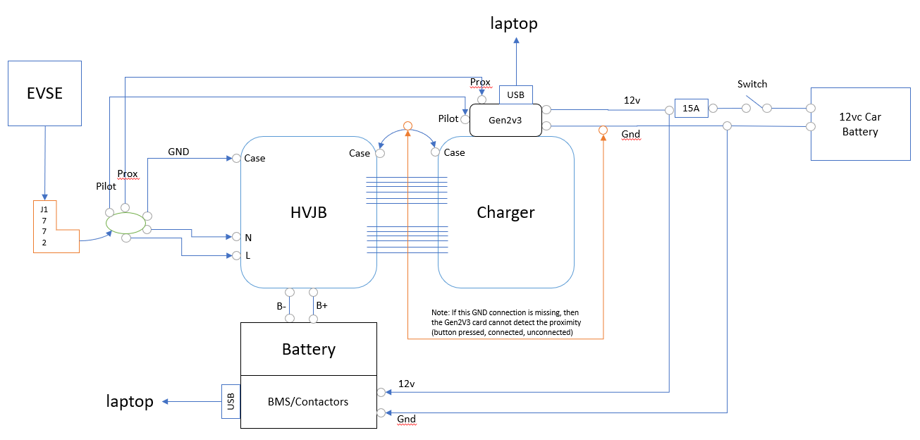

I haven't been able to get me tesla gen 2 charger working. I've set the ac current to 5amps, single phase, and termination / dc voltage to 380v. The pack voltage is 340v. When i plug in my j1772 charger, the 3 modules light up and I hear a click, but then a couple seconds later, there is another click and the 3 modules no longer light up. The j1772 charger says it is charging, but no current flows at all. Any ideas on what it could be? Faulty charger?
DrJeff
Posts: 26
Joined: Wed Mar 20, 2019 7:12 pm
Post by DrJeff »
PROGRESS!!! 2/3, but still better :)
Thanks guys for the help - finally some progress that points towards a cause !!!
I replaced both PSUs (feeding the 12v/GND for the Charger AND 12v/GND to the Contactors controller) with a single car battery, feed through a switch and a 15A fuse. This allows 2 out of 3 modules to charge (any two modules concurrently charging, but not three). So the charger must be doing some kind of check (current leakage? power availability?) that if not passed prevents the requested charging from initiating. As additional modules are requested either the sensitivity of the test is increased or more likely whatever 'error' the charger is testing for passes a threshold. It could be that swapping from PSU to Car Battery made the difference or just messing with the cables and connections was sufficient.
The odd need for a ground connection between the charger/HVJB cases (grounded to the EVSE) and the GND from the car battery is still necessary for the Gen2V3 card to be able to tell if the EVSE button is pressed, connected, or unconnected. When that ground is missing - the Gen2V3 card oscillates from Pressed to Connected. I suspect that the GND connection from the EVSE is connected to the Model S grounds just after the charge port. So while this looks like an odd ground connection in my setup, it is normal for the Model S (EVSE ground connects to car's body ground rather than to the HVJB case).
Also, I have a laptop with USB connections to the Gen2V3 charger card, and also to my Battery Contactors controller. The 2/3 charging symptom occurred whether or not the laptop was also plugged into 120v power (i.e. battery vs wall plug).
So some things to follow up on next...
1. Further cleaning up / increasing cable size on the 12v lines.
Posts: 2962
Has thanked: 330 times
Been thanked: 848 times
Correctly grounding the charger case, 12V ground and EVSE/AC ground to the same point is curcial for this all to work.
All EVSE signals are ground referenced, also the modulels have leakage detections and earthing checks.

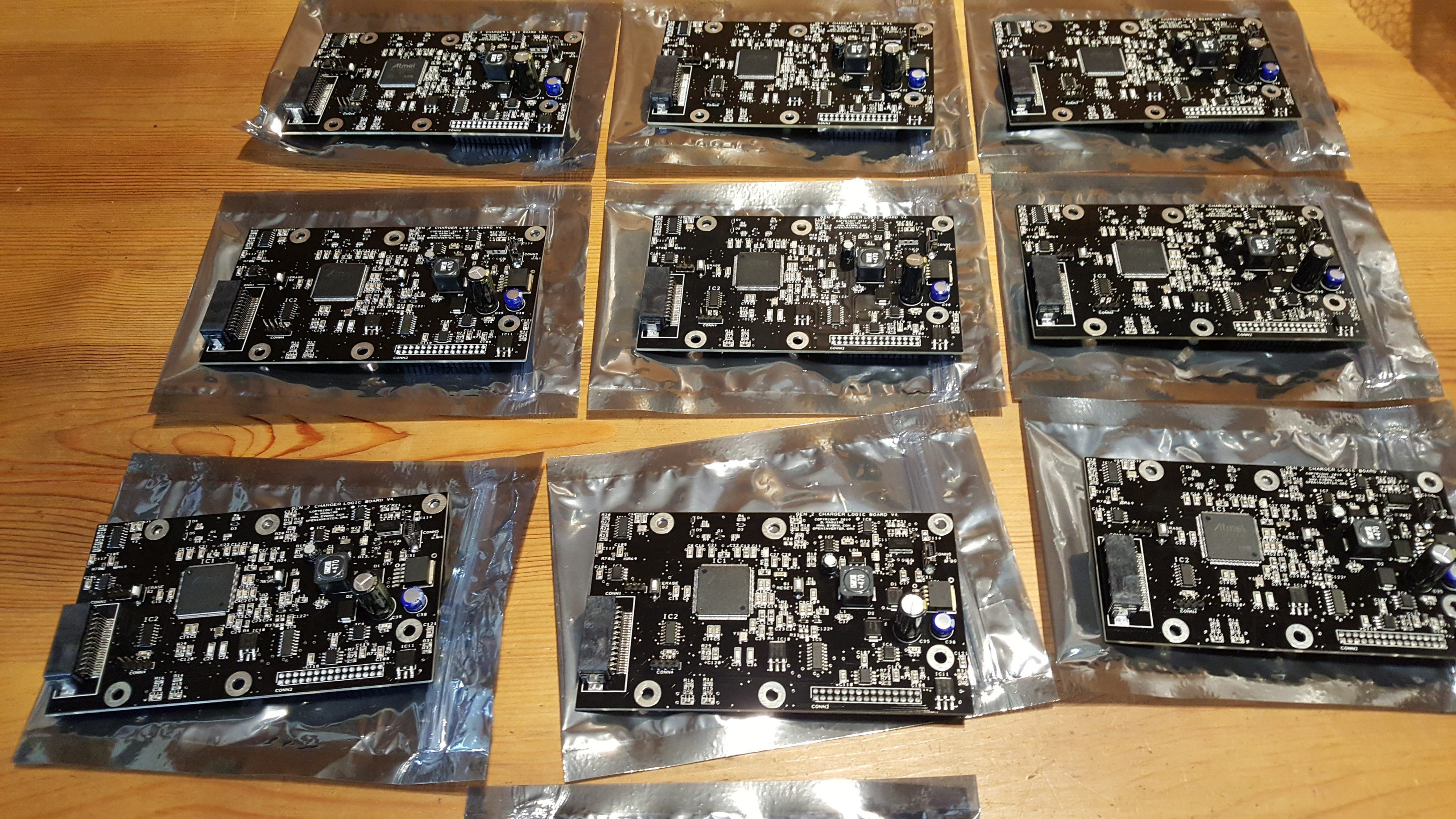

Some good news on board supply. I have now acquired a much more reliable pcb manufacturer here in Ireland and boards will be in stock for immediate dispatch. No more silly delays and boards are being built on an automated smd line so quality is much improved.

Post by DrJeff »
tom91 wrote: Sun Nov 03, 2019 1:58 pm Correctly grounding the charger case, 12V ground and EVSE/AC ground to the same point is curcial for this all to work.
SUCCESS!! All 3 modules Charging.
Some additional changes this morning - now all 3 modules are charging...
1. Created a 'ground bar' to which all the GNDs connect (EVSE, HVJB Case, Charger Case, Battery Mgt System [Contactors], Charger inputs]
2. Wired the EVSE ground directly to the ground bar (not to the HVJB case)
3. Cleaned up the connections from the 12V car battery to the Charger controller
A few little things to follow up on...
1. The Gen2V3 controller is still oscillating between button pressed/connected, but charging still works? (I guess it catches a connected state). This may say something about the ground connection between the charger controller card and the charger.
YouTube video here

Firstly I'm delighted Jeff has his charger up and running. We spent a lot of time going back and forth as to what would be causing the problem.
On the subject of grounding. I have mentioned this multiple times on multiple platforms. The Tesla chargers are very sensitive to grounding. The case MUST be connected to vehicle 12v ground AND evse earth/ground when charging. Otherwise problems arise. The open source logic boards do not implement ground on the screw holes. Yes I do know that Tesla do. My reasoning is born of many long days and nights spent chasing ground loops and emi. I have 2 Gen 2 chargers in 2 of my cars charging almost daily with no problems. Is this exhaustive proof of a working design? No, of course not. If people feel this is necessary then please by all means download the design files, make the modification, make some boards , do some testing and report back.
Posts: 2962
True, at Zero-EV having the three grounds (AC inlet (EVSE), Charger Case and 12V ground) properly connected works every time.
Anytime the chargers are behaving weirdly checking grounds should be a first checking point. We usually bolt a ground strap to the case of the chargers and back to car/vehicle body so we do not have to rely on the bolting interface.
