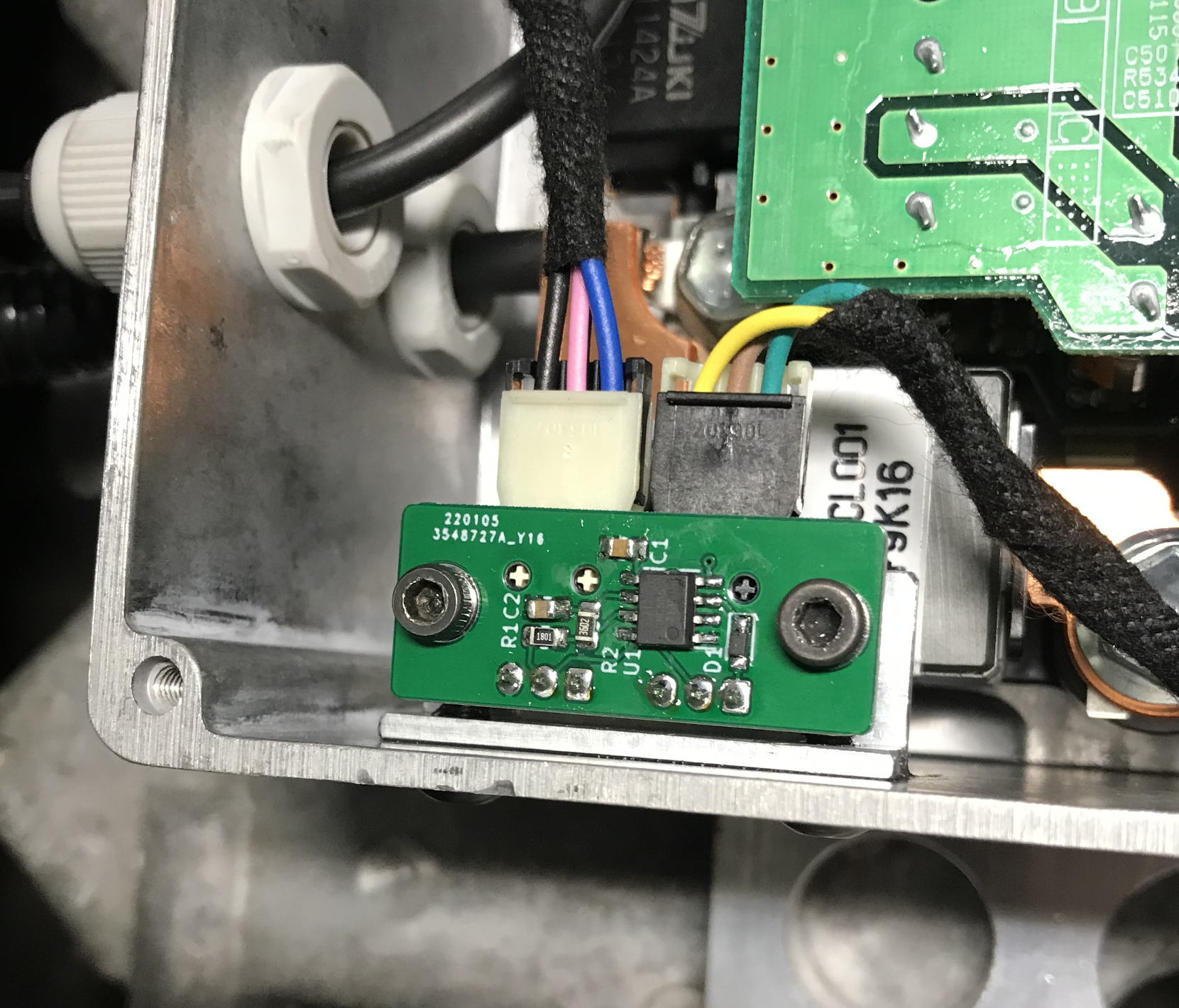

Yes, the backplate is from the the converter you sent. The electronic is from my inverter.
In the converter you sent me the 30A fuse on the PCB is blown. I haven't found a suitable replacement fuse yet. Might look into this more when I have the car on the road again...

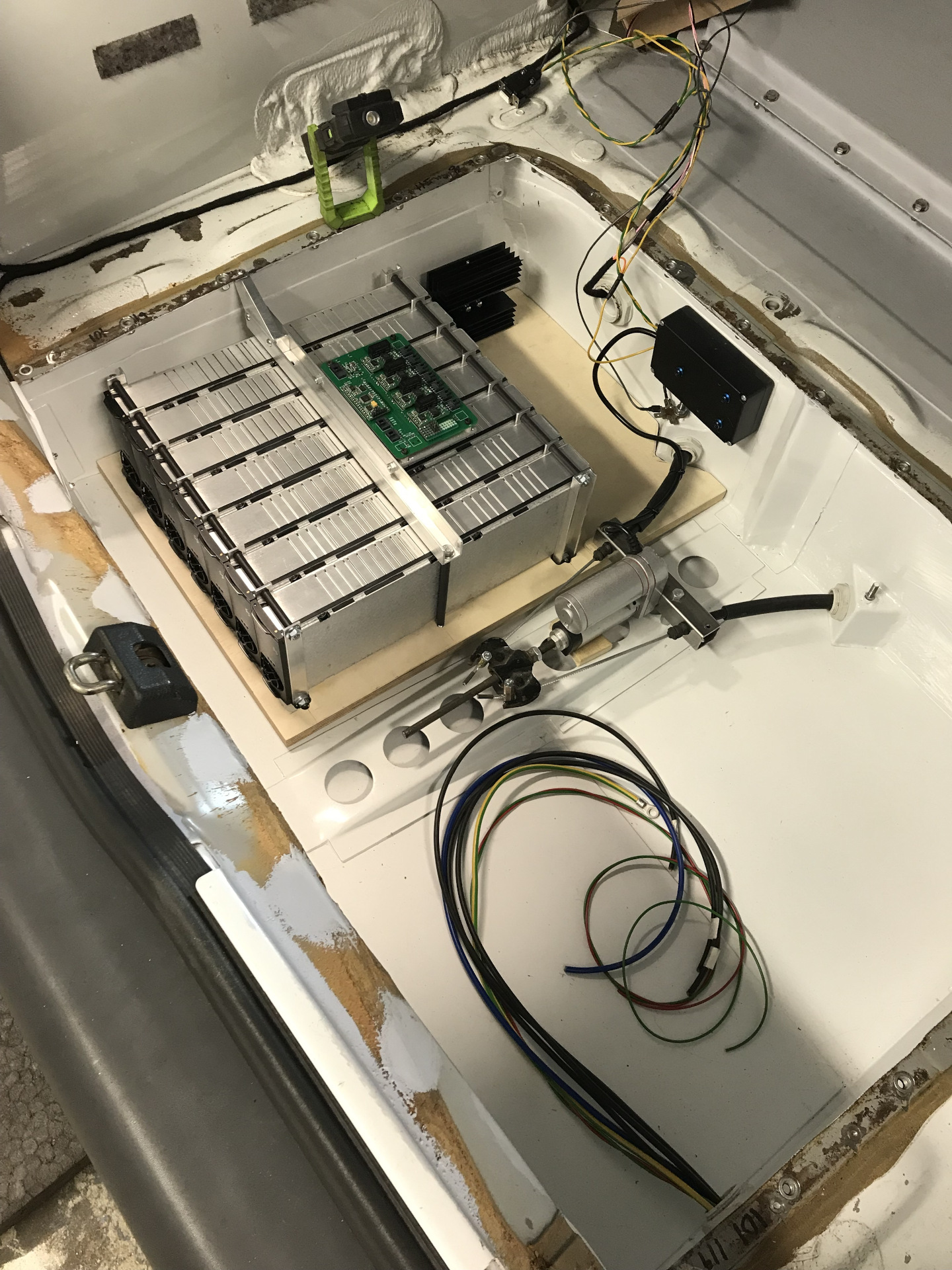

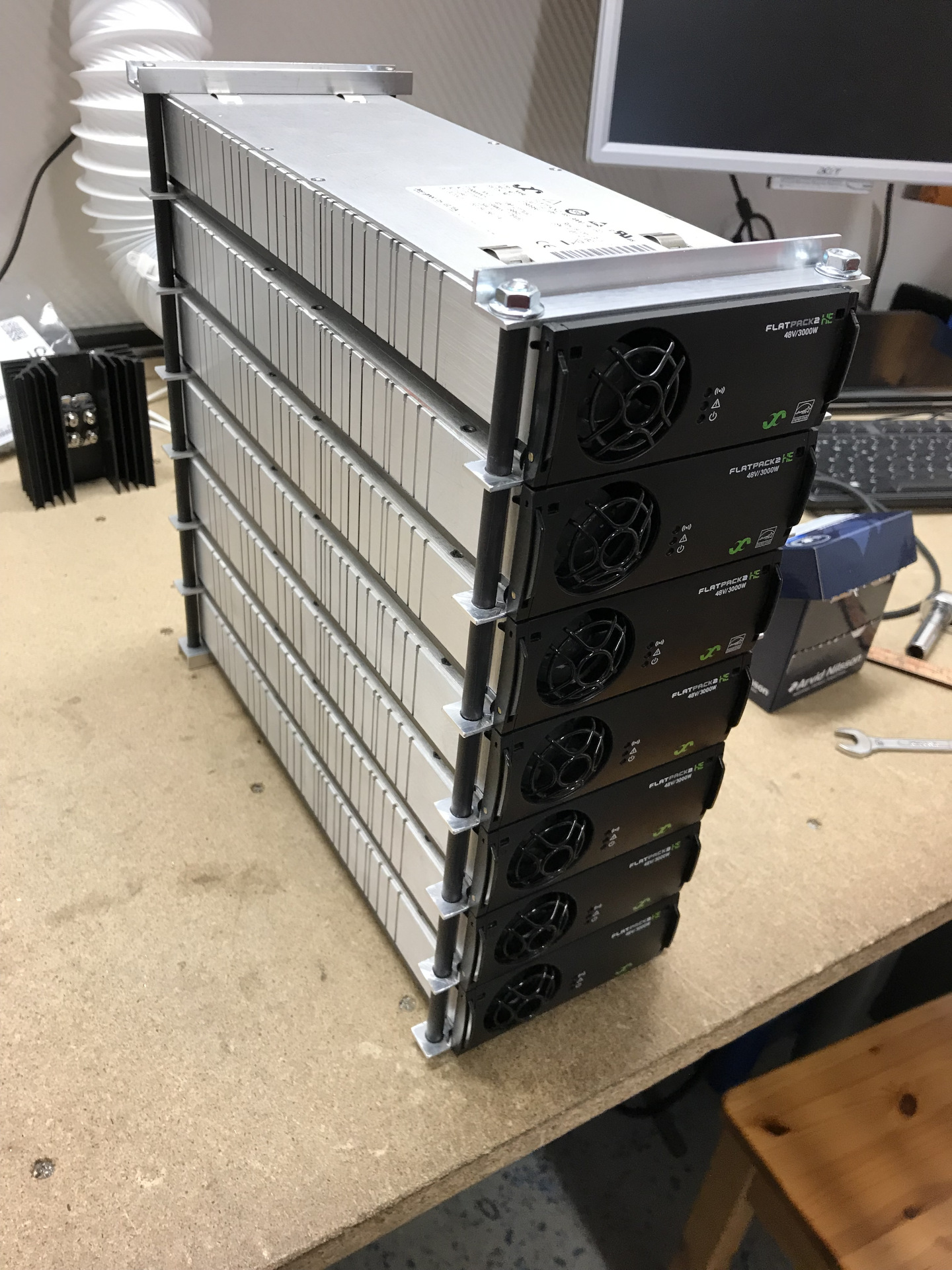

While waiting for the last parts for the DC/DC I have been working on the charger.
Will be using 7pc of Eltek FlatPack 2 HE 48V power supplies.
Stacked.
Stacked.
Inside car with control board on top.

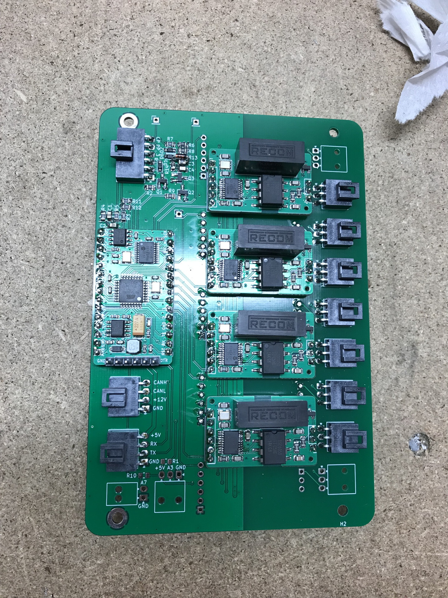

Modular control board.

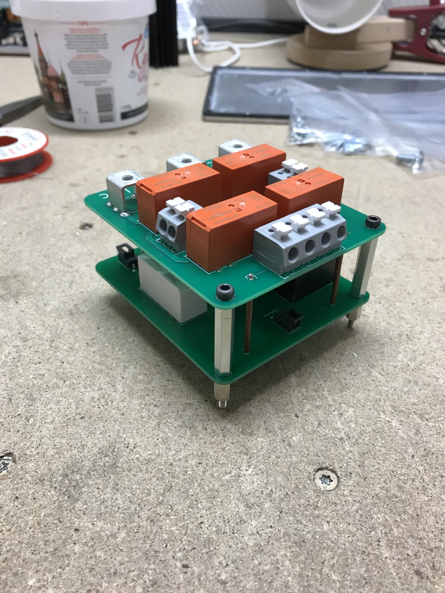

Will also have detection if 1- or 3-phases is available. With planed configuration I will be able to charge up to 17kW if 32A 3-phase is available and down to 2,3kW if only 10A 1-phase is available.
Board for 1/3-phase switching and 12V supply from 230Vac.

The shift between 1- to 3-phase is done by four relays. Two would suffice but I could only find PCB mountable relays for 16A with resonable price. The relays are of "type c" NO/NC.
Relay connection
Relay connection
L2 is Line 2 and L2sens is basically Neutral (via a opto coupler). Should result in the relay coil is magnetized if the L2 is present.
If coil is magnetized the FlatPack is powered from L2c, if coil is not magnetized the FlatPack is powered from L1c. L2c and L1c is Line 2 and Line 1 after the main contactor in the car.
In my case I have two shifting relays and hence two FlatPacks connected on L2 and two relays and FlatPacks on L3. The remaining three FlatPacks are connected to L1 permanently.
This is still untested but will be tested soon.

Where did you source your flat packs from and for roughly how much? Also whats the combined weight and size?
bexander
Posts: 897
Location: Gothenburg, Sweden
Has thanked: 78 times
Been thanked: 102 times
Re: Renault Clio Electrique -97
Post by bexander »
Some of them at two different occasions from private persons in Sweden. For the first three I paid 1500 SEK a piece and the remaining four I got as a thank you for helping a friend with some other stuff. I would turn to ebay or similar website to find them. You will also need a PCB to connect to them as there is only a slot at the back, no externa connectors.
The datasheet states 109x41.5x327 and 1.95kg.
My stack takes about 140x330x327 an then with above mentioned PCB in the back the length will increase a further 60mm or so. I have not weight the tack but I guess 15kg is a resonable guess.

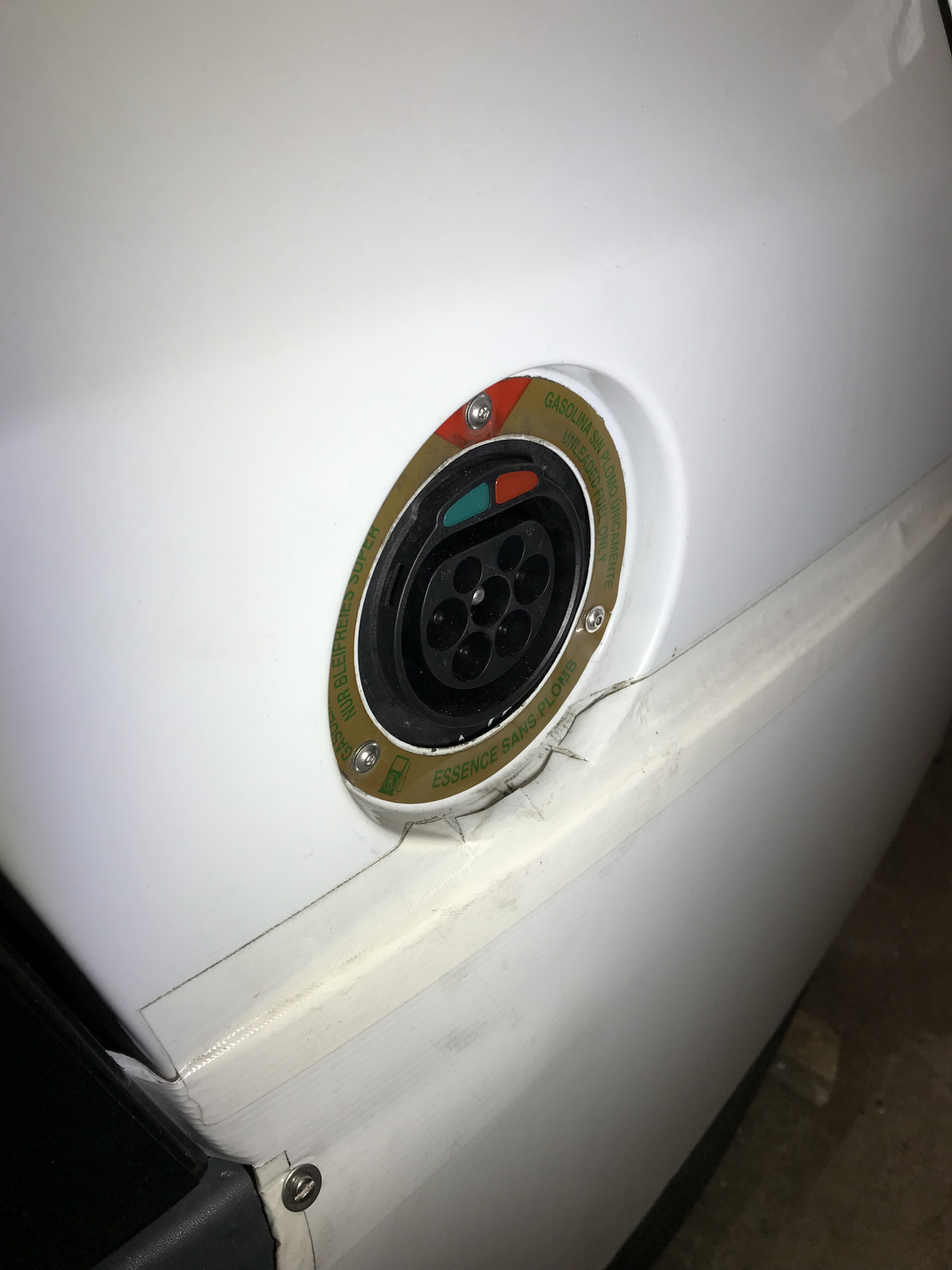

Type 2 inlet.
Type 2 inlet.
Anyone have a good idea for a cover for the type 2 inlet? The lid that came with the inlet sticks out outside the car so not good without modification. The cars stock one will not work as it is also the filler cap and at an angle.

Plastic print one then cover with metal and paint you could print a ring which fixes around the socket and uses those 3 screws for mounting and implement a nice hinge
I'd look to modify the original too for aesthetics once closed.

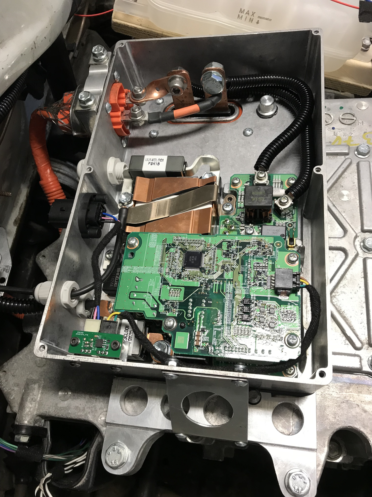

Last parts for the DC/DC have arrived and are in place.
It's a NE555 to provide PWM signal to the DCDC for a solid 14,0V output.
Plan is to also have the relay for the cabin heater PTC inside the DC/DC enclosure but that has lower priority and will have to wait until the car is running.
Is that a prius DCDC liberated?
bexander
Posts: 897
Post by bexander »
Yes, that is correct. It is the contents of a Prius Gen3 DC/DC.

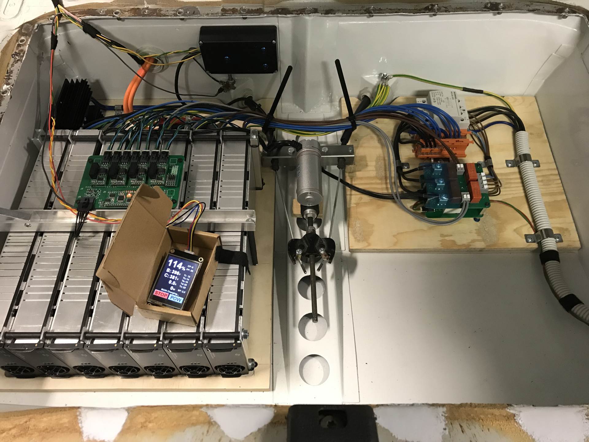

The full charger installation. The low voltage wiring to the left is temporary.
Working with improvments to charger SW and BMS SW at the moment.
Have done more driving but the wether was wet, cold and windy so not to concerned about 1,02kWh/10km. This will most likely improve with better weather.
