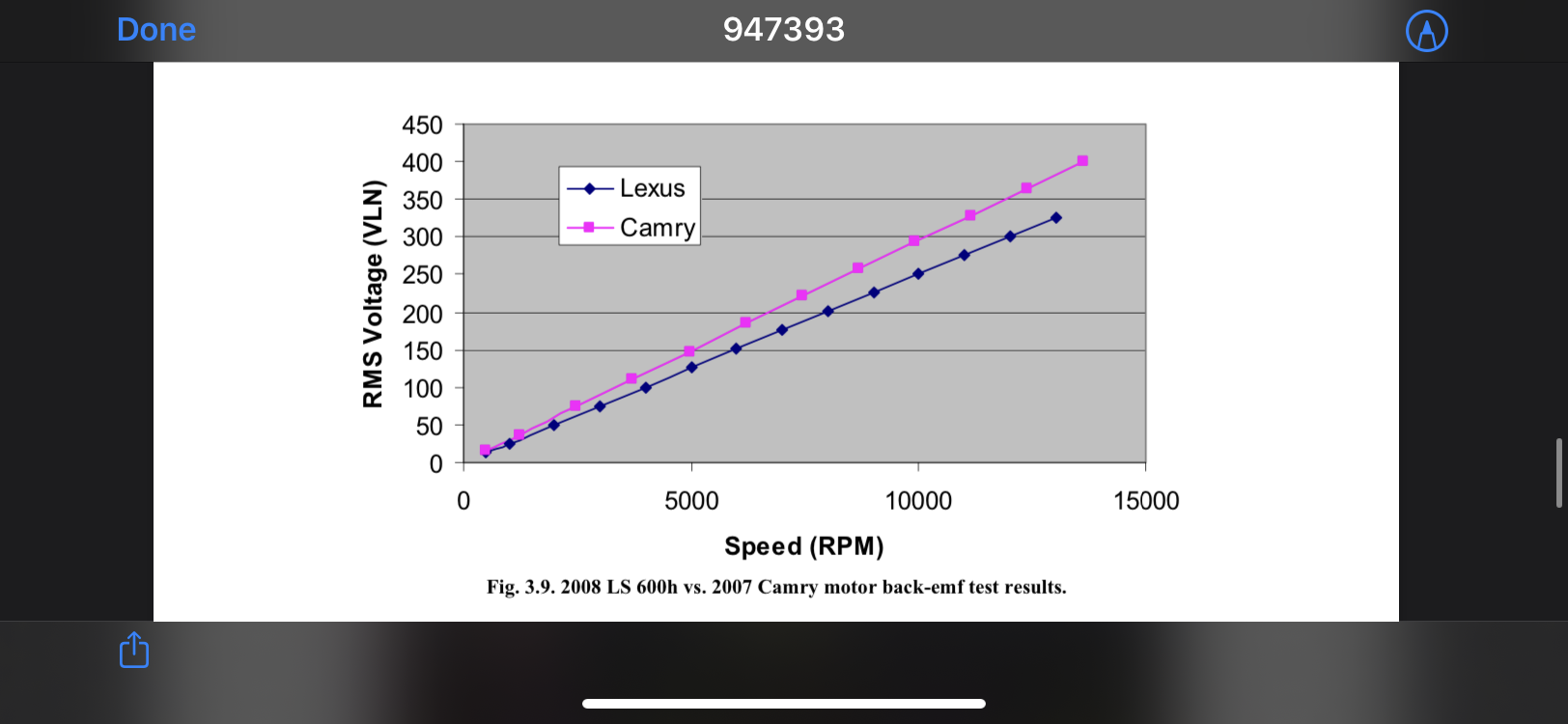

Also it appears (just as Damien said) that voltage won’t be an issue to run the full 10,230 rpms. Here are the back-EMF test results.
Re: The SuperYacht BMW E65 7 Series
Ah, that's interesting, I missed that bit.
I can't understand why they bothered to run 650v in the actual car, it seems unnecessary.
Unless the high voltage actually for MG1 rather than MG2. I think in the Prius MG1 is very low torque but high RPM.
I estimated that with the input shaft locked in the GS450h transmission, MG1 should be running in the region of 2.5x the speed of MG2 due to the planetary.
