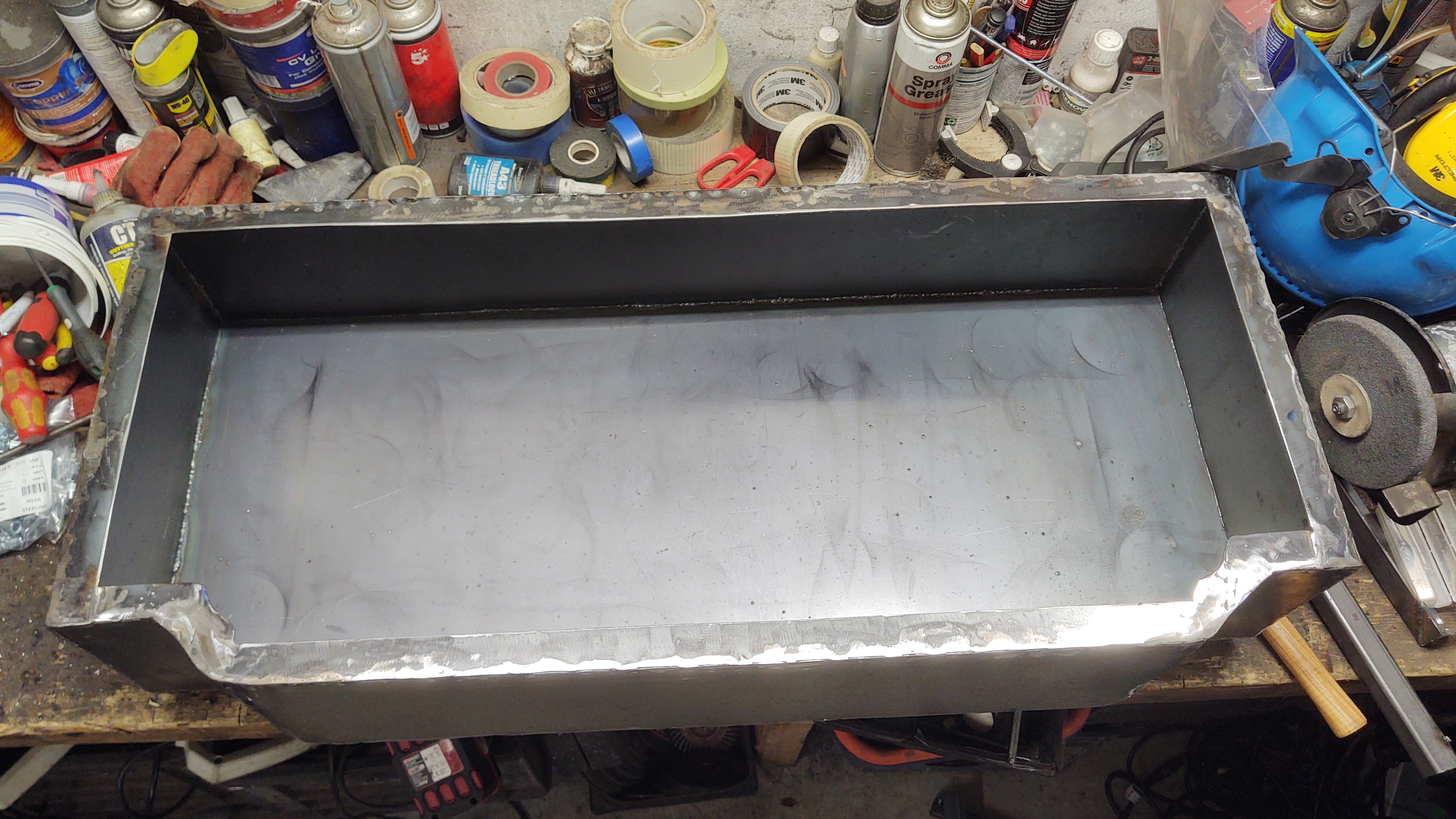

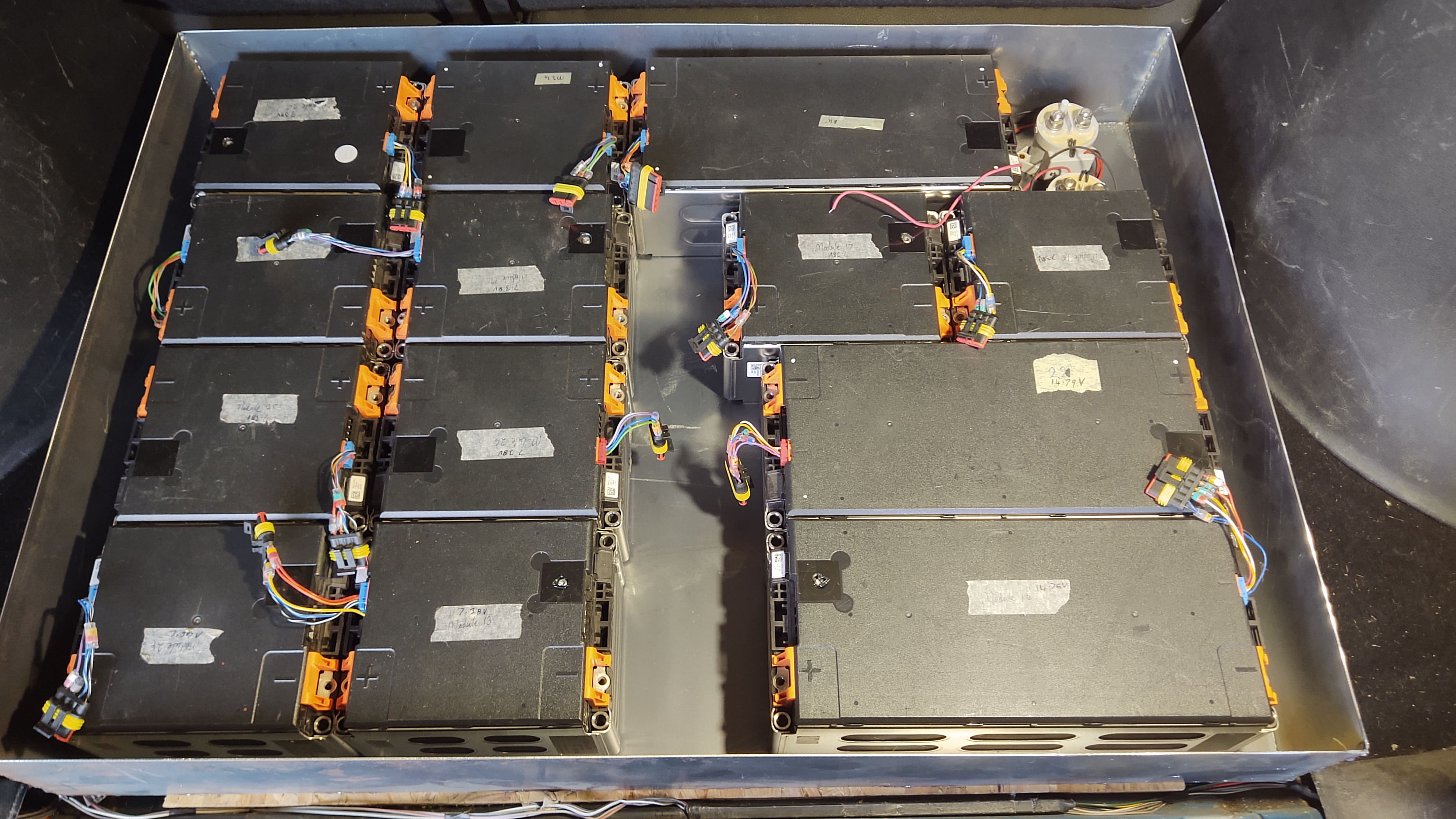

If I was doing this again from scratch I'd change many things but as you say it's "good enough" however I have made one biggish change recently.
I've ditched the fuel tank battery box as it is just too much trouble and made two rear battery boxes the same way. I've one large one in the boot and a smaller one under the boot. That way the cables can go directly from one box to the other so no need for fuses or contactors between them.

That's a good idea, if you don't need all the boot then fueltank batteries can live there. I think I will also try to make a 5cm overlap for my boxes too, so cables would just go through.

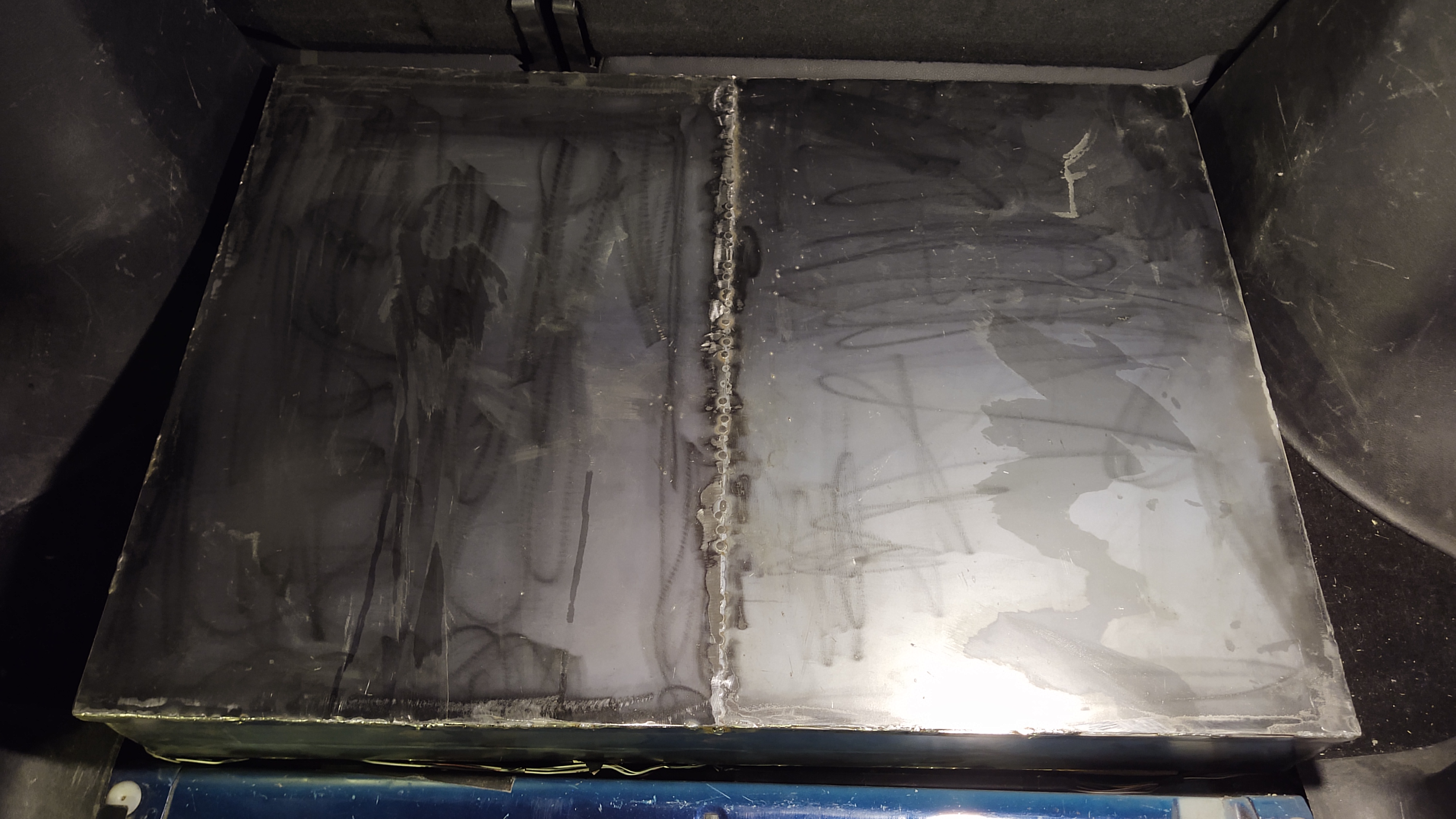

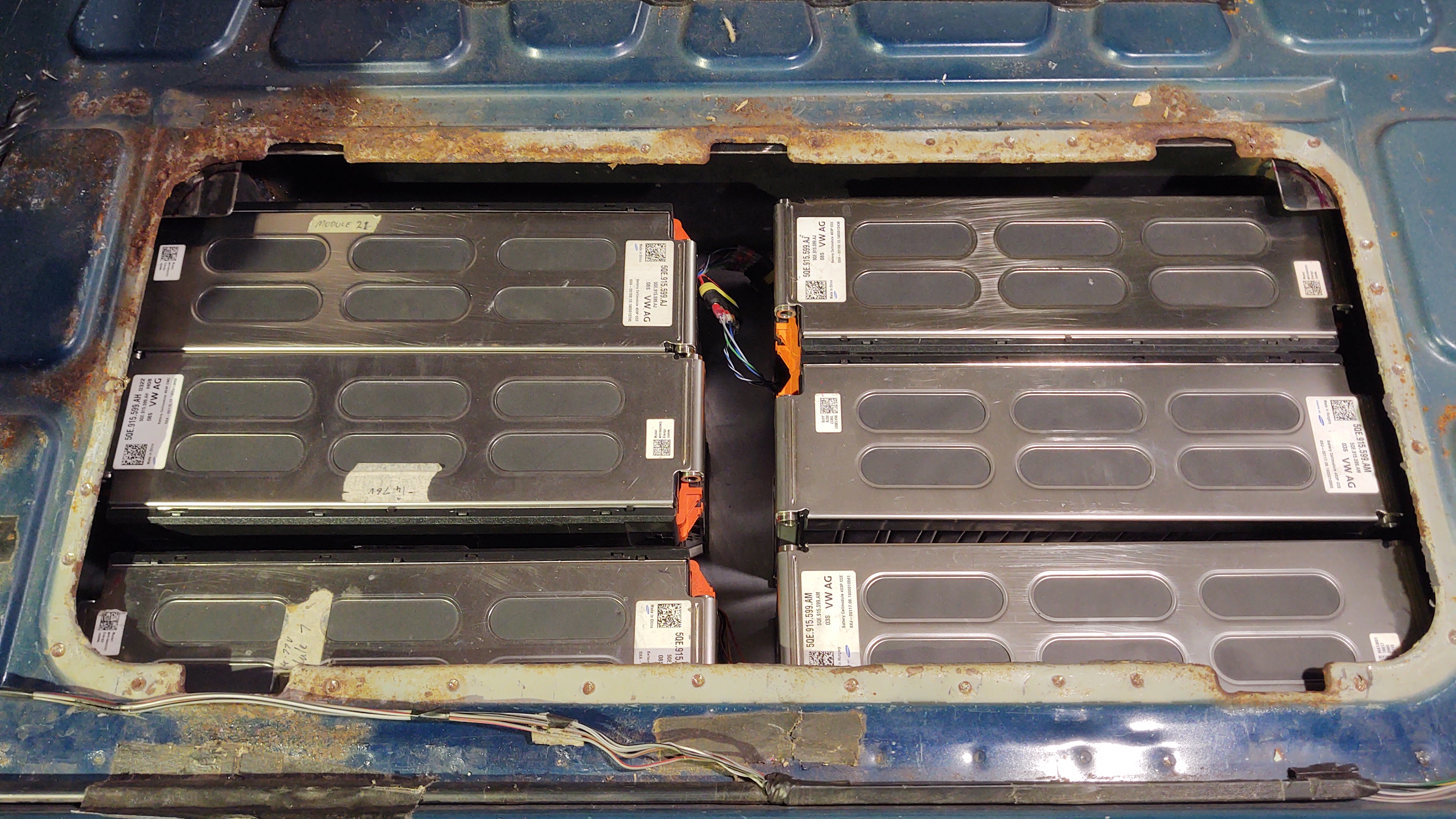

This is my bottom box which fits under the boot floor.
And in position. Freelanders have a storage box under the boot floor so this hole is normal. I removed the bottom of it so my modules can fit.
And this is the box in the boot.
I still need to secure the modules and cut holes for cables.
