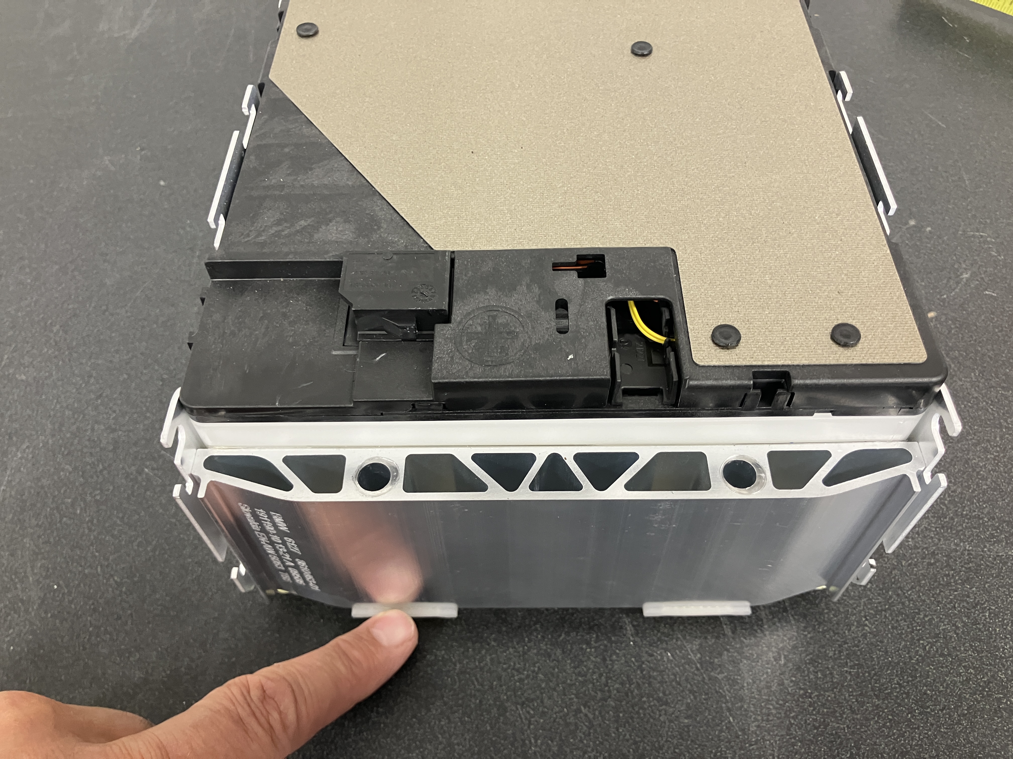

this is the new SP41 module with the BMS slave module attached weighing in at 28.2 freedom pounds, the truck will be equipped with a dozen of these beauties
the module is approximately 7 inches wide
the length is a bit tricky so hear me out, with the slave BMS module it appears to be 15 1/2 inches long
height looks like 4 1/4 inches

something to look out for or account for are these pesky plastic feets that stick out about 1/8th of an inch on each side, now you can grind these flat, I did that on my first pack cause I did not account for them space wise, so I avoided a close call there

Thank you! Wow, that is pretty good. Guess it works out to 14.1 lb/kwh including BMS.. I like it!

Would you have any dimensions for the cell hold down bolt holes?

center of bolt hole to center width wise is 87 mm
center of bolt hole to center length wise is 14 1/8 inches (sorry I did not have a metric measuring tape that long)
the holes appear to be 8 mm in diameter, but the bolts are only 5 mm
