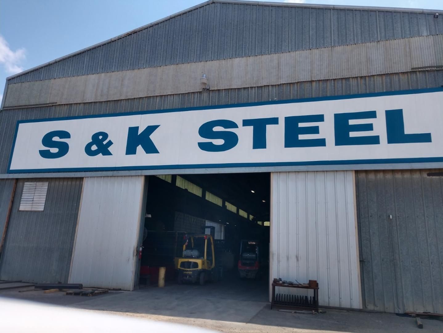

and then it was S&K Steel Time aka SKST
so this is the kind of remnants they have, and at first I thought this frisbie disc would work but turns out it was not sliced straight
so then I spied this 1/2" thick by 10" wide and about 30" long plate which I had cut into two squares for a crisp Ulysses S. Grant !

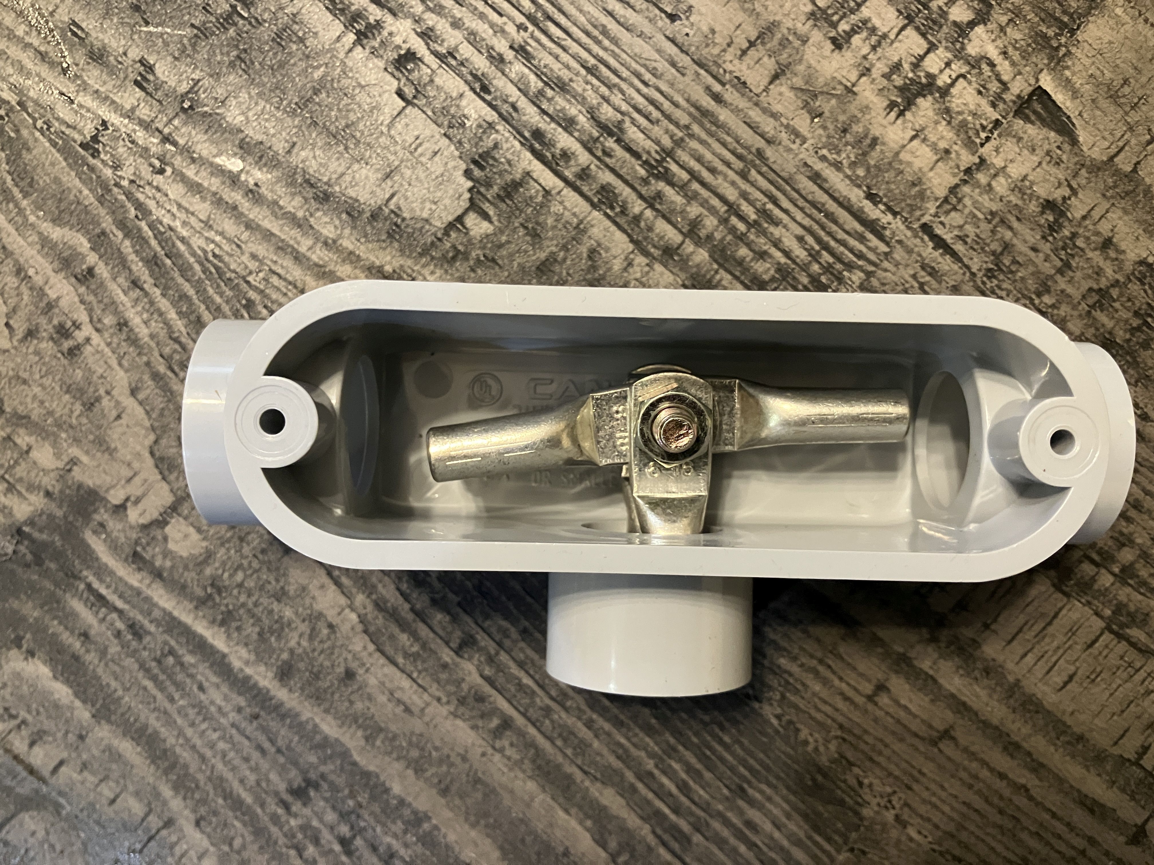

then it was off to Home Depot to think on how I was going to connect the two negative battery pack cables into one input terminal on the BMW Safety Box
hmmm I wonder if these T Type Conduit can do it (see what I did there?)
not knowing which one would be more better I procured them both and proceeded to the Goldilocks phase of the project

but soon order was restored, and here's the general idea
these be just reducers to make for a tighter hole opening for the orange cables to fit snugger and maybe even water tight, I plan to glue them in with the special rubber cement for gray plastics

gentlemen I am extremely proud of this Negative Lead T Connection so please precipitate on my parade lightly
