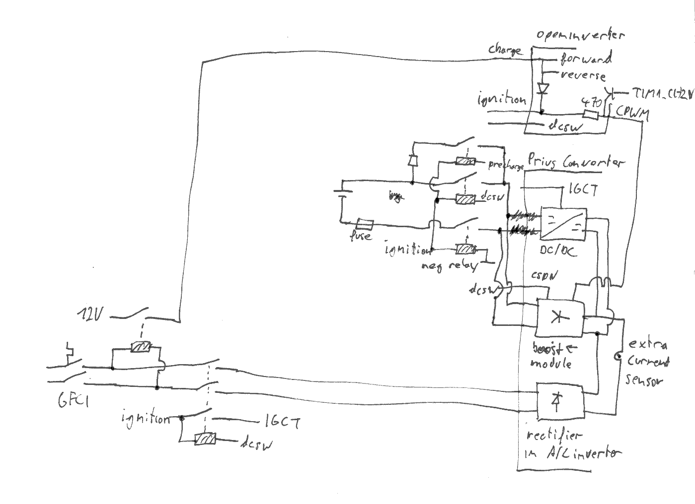

Do you keep the AC precharge pulled to GND as in the diagram I made? I don't see it's relevance.
Been thanked: 1914 times
Re: Prius Gen2 Adapter Board for CHARGING
Here is my current setup.
Sorry, first I connected HV battery to DC-DC converter :?
I don't actually use the triple-pole relay for switching 230V AC since it is too weak, but I enable a second relay. But for simplification I omitted that
Triple pole relay also activates DC-DC converter during charging and driving

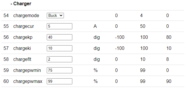

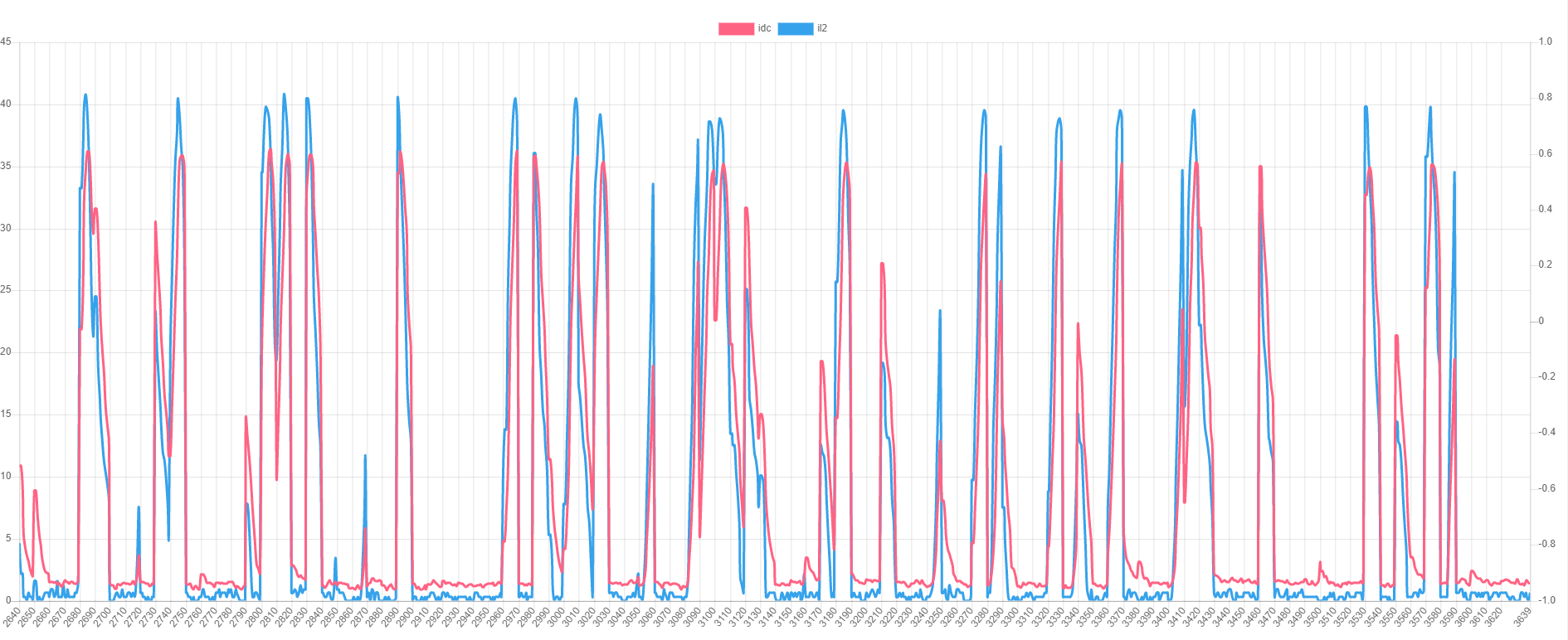

I've bypassed EVSE and it seems quite stable now.
I think I might need to look at current and voltage calibration as it doesn't match up too well right now. But voltage does move with pwm min and max.
The graph is looking a bit irregular as well/
charge settings.png (9.55 KiB) Viewed 6071 times
Edit:
Current draw from the mains seems to stay constant at 2.7Amps. This doesn't change with charge amps, even though there is a noticeable difference in the heating element.
LRBen wrote: Thu Mar 24, 2022 3:56 pm The graph is looking a bit irregular as well/
There's almost no capacity in the system, so basically your battery current is sinusoidal, of course with the negative flipped to the positive. Regular chargers have a lot of elcaps and a PFC stage to be able to supply smooth DC. To my knowledge batteries don't mind being charged that way though.

johu wrote: Thu Mar 24, 2022 7:26 pm
I did read an article somewhere that said pulse charging can result in the battery taking more charge than smooth CCCV. I was more worried that the peaks are not that regular.
I also had a thought while driving home, I don't actually need any bucking since my 80s cells needs 336v to be fully charged. I'm getting 325v on the HV bus which is 80/85% SoC ish. Can I just charge the battery from the HV bus connections and skip any bucking or boosting stages? I'm assuming I would lose current control, but with a granny charger that's no big deal.
