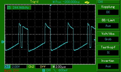

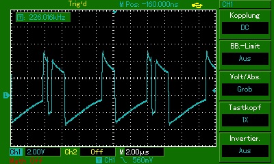

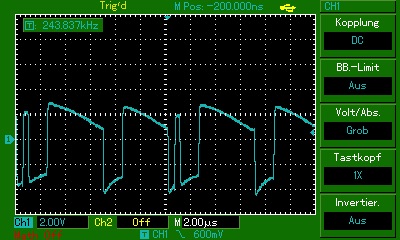

My Oscilloscope has a bandwidth of 50 MHz.
The measurement above on the secondary was already done without reference to GND of the MAX 17841B. I will attach a new measurement :) I connected the probe to sec2_3 and the "gnd" of the probe to sec2_1. Hope that is correct. I don`t have special differential probes :S
Sec2_1 to Sec2_3.jpg (55.56 KiB) Viewed 18379 times
The same measurement taken between sec1_1 and sec1_3 is also attached.
Sec1_1 to Sec1_3.jpg (48.94 KiB) Viewed 18379 times

Yes, that is the measurement I suggested. A word of caution though. While doing this "differential" measurement, make sure not to connect another probe to gnd or other reference. That might short the oscilliscope or other parts of the circuit. Use only one probe.
Looks like I was wrong, this is a HW issue to my understanding. The signal is sent out on sec2_x but no response is received on sec1_x.
Check communication wiring for continuity, check that all plugs are connected. Is it possible to measure incomming/outgoing com on every slave to try and locate where the com is lost?

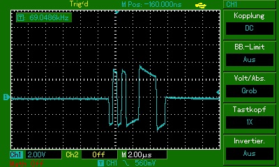

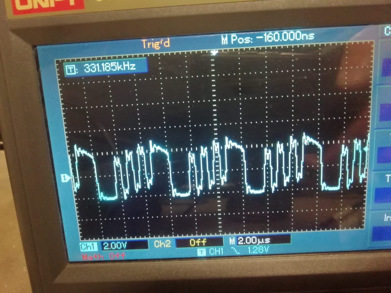

Yes, only one probe was used :)

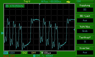

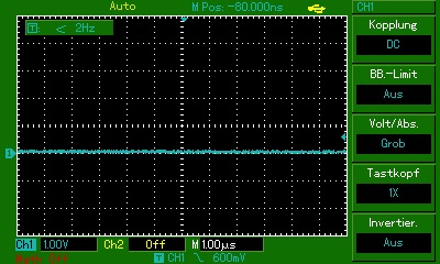

With one Module connected it looked like that:
Module 1 in:
Slave1 - Rosa Orange.jpg (54.6 KiB) Viewed 18334 times
Module 1 Out:
Slave 1 - Gelb Weiß.jpg (52.48 KiB) Viewed 18334 times
After loop:
Module 1 in:
Slave 1 - Grün Braun.jpg (52.77 KiB) Viewed 18334 times
After that there was nothing measurable.
So no input into the transformer to the Master.
Tried measuring with two modules now, but have to give up for today and calm down :D I have to put in needles because the plugs are so small. I will upload the new measurements tomorrow.
Thanks already for your help!

Communication
Communication

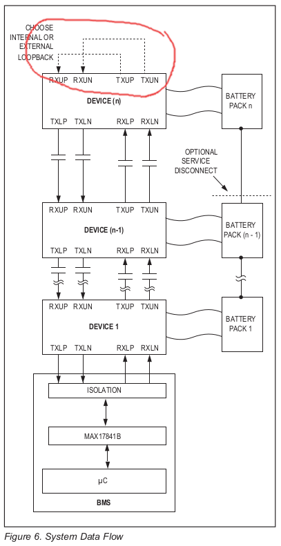

When testing with different number of slaves connected, are you moving the loopback so it is placed on the final slave in the chain?

After reading your post again.
So there is no output from the slave module on TXLP/TXLN but input on RXUP/RXUN, correct? If so, test with another slave board.

Yes, on my first try month ago, i forgot it. After putting the loopback to the system, it worked with two modules.
But after some weeks i tried it again and it failed.

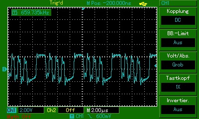

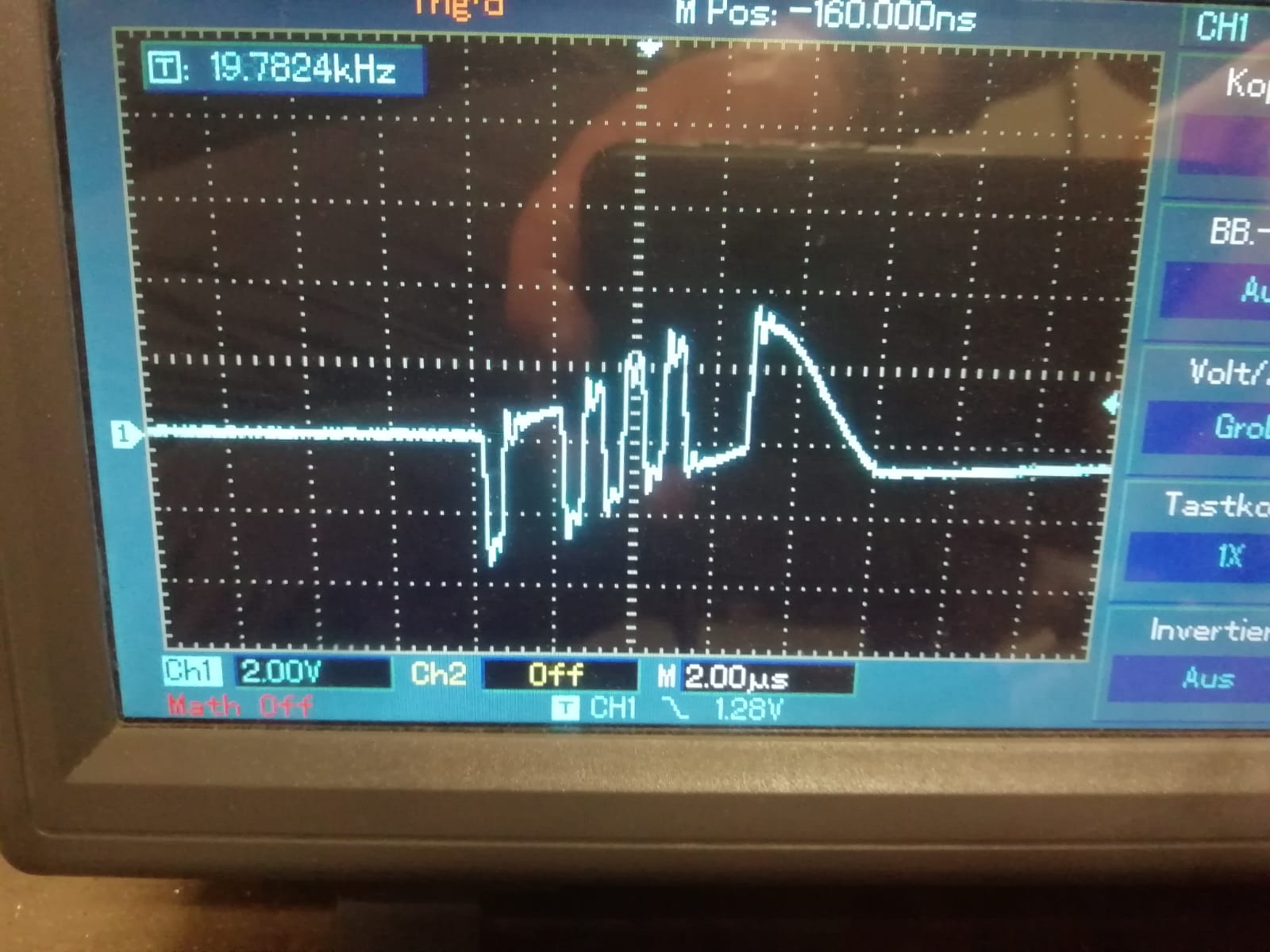

Hi!
The transformers should be ok..i measured 0,5 ohm on every transformer.
I got a small breaktrough. It started communicating with one slave. Serial Monitor messages in the attachment.
Error2.txt
(3.36 KiB) Downloaded 623 times
Master receiving - SEC1.1_Sec1.3.jpg (53.43 KiB) Viewed 18205 times
2.Master receiving - SEC1.1_Sec1.3.jpg (51 KiB) Viewed 18205 times
Now is the question: Why isn`t it working with the other ones?
On some Modules i removed the BMS Board. It is clipped on the BatteryModule.
I checked continuity between the Pins of the Battery Module and the PCB. Everything fine.
Maybe it has to be waked up after removing from the Batterievoltage? I will look at the data sheet.
Thank you already very very much for your support. Would never have come so far without your help!

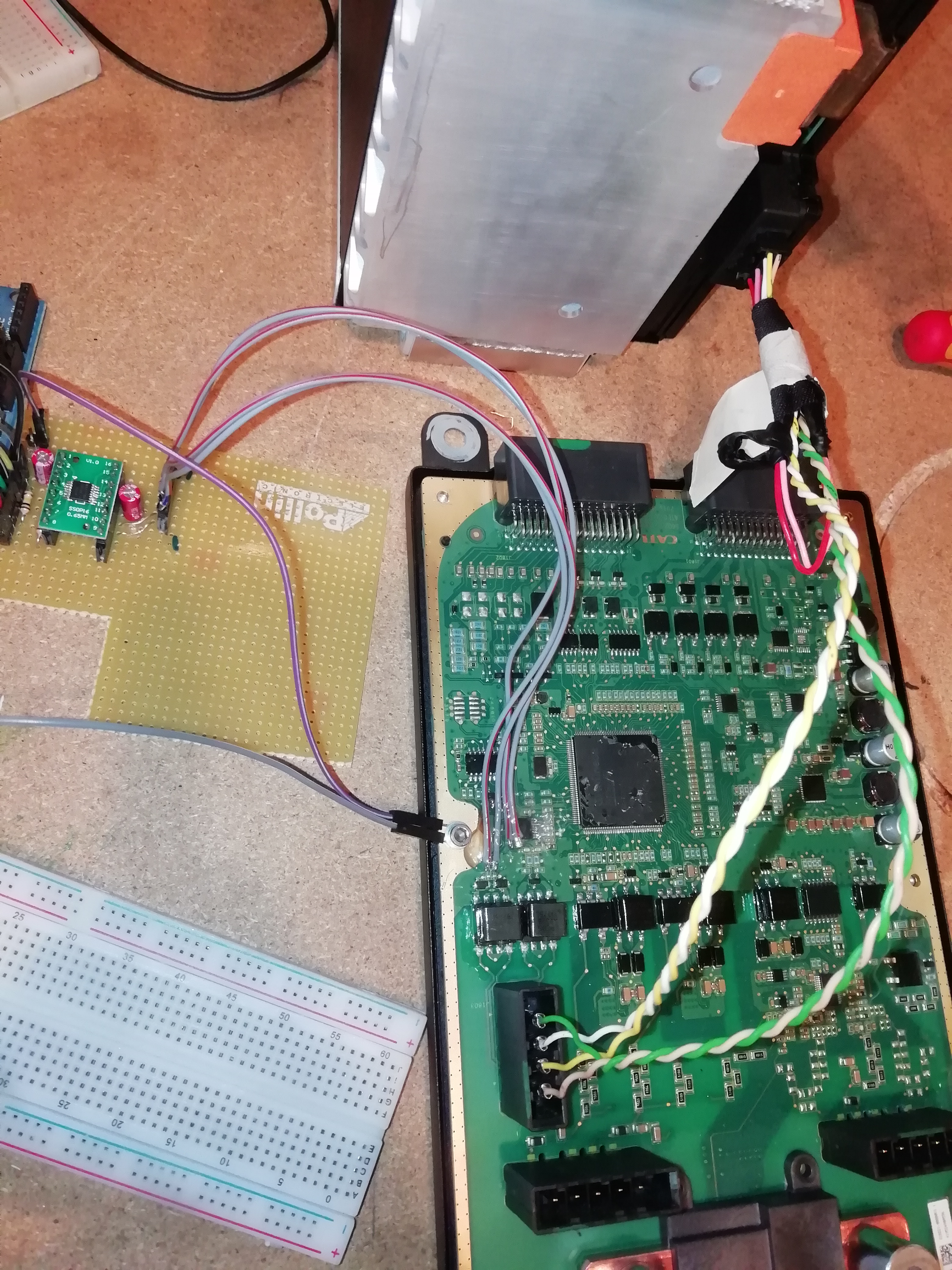

EDIT: Forgot the circuit:

Update: I soldered a wire to the SHDNL Pin of the BMS. Afer putting the PCB back in the battery and starting the program and a small delay the voltage rises from 0V to 9V. So the MAX17823B has turned on, as it seems.
I will dismantle the complete battery from the car in the next days and check, if the battery modules are communicating correctly with 14 BMS in series.

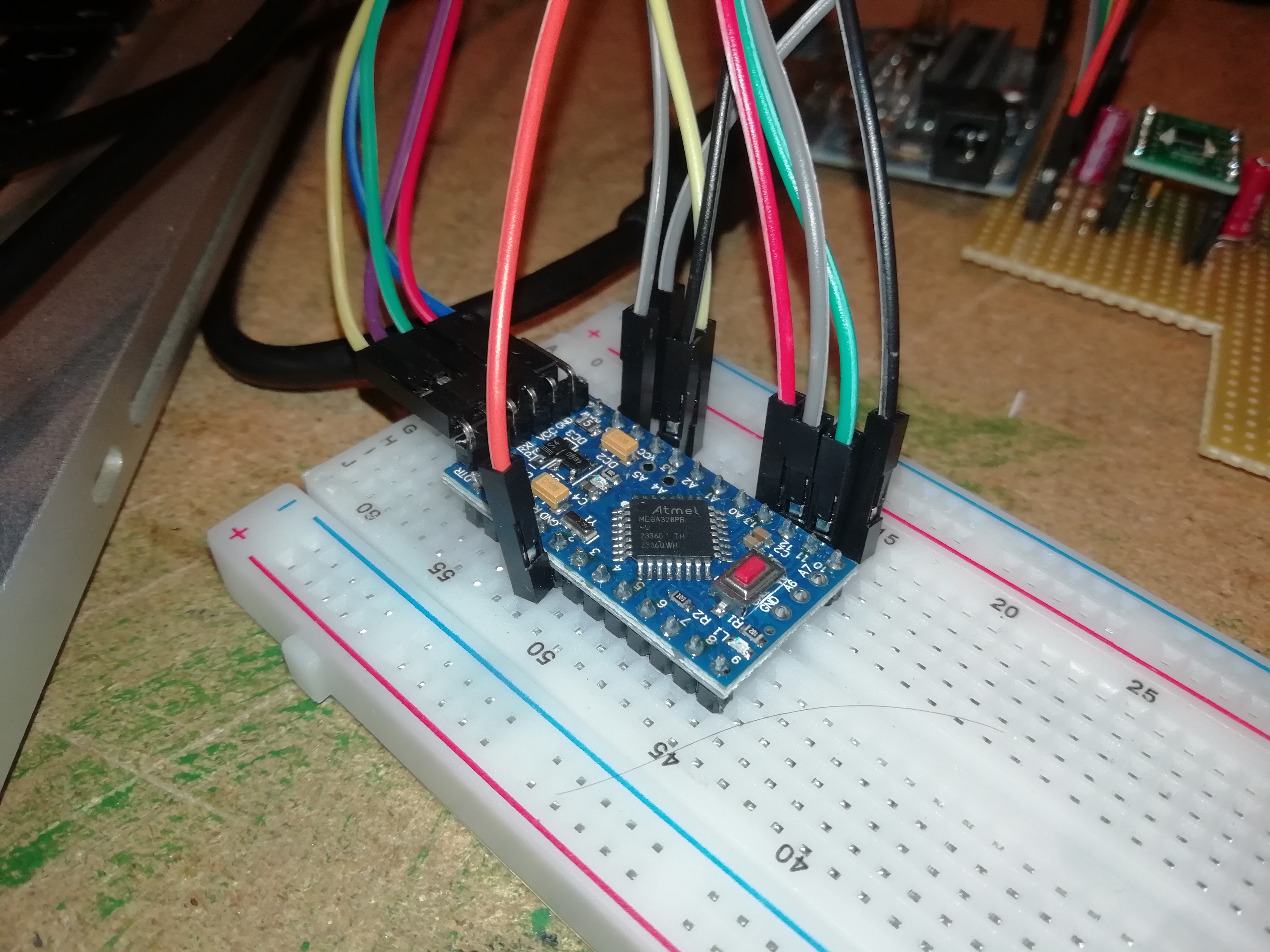

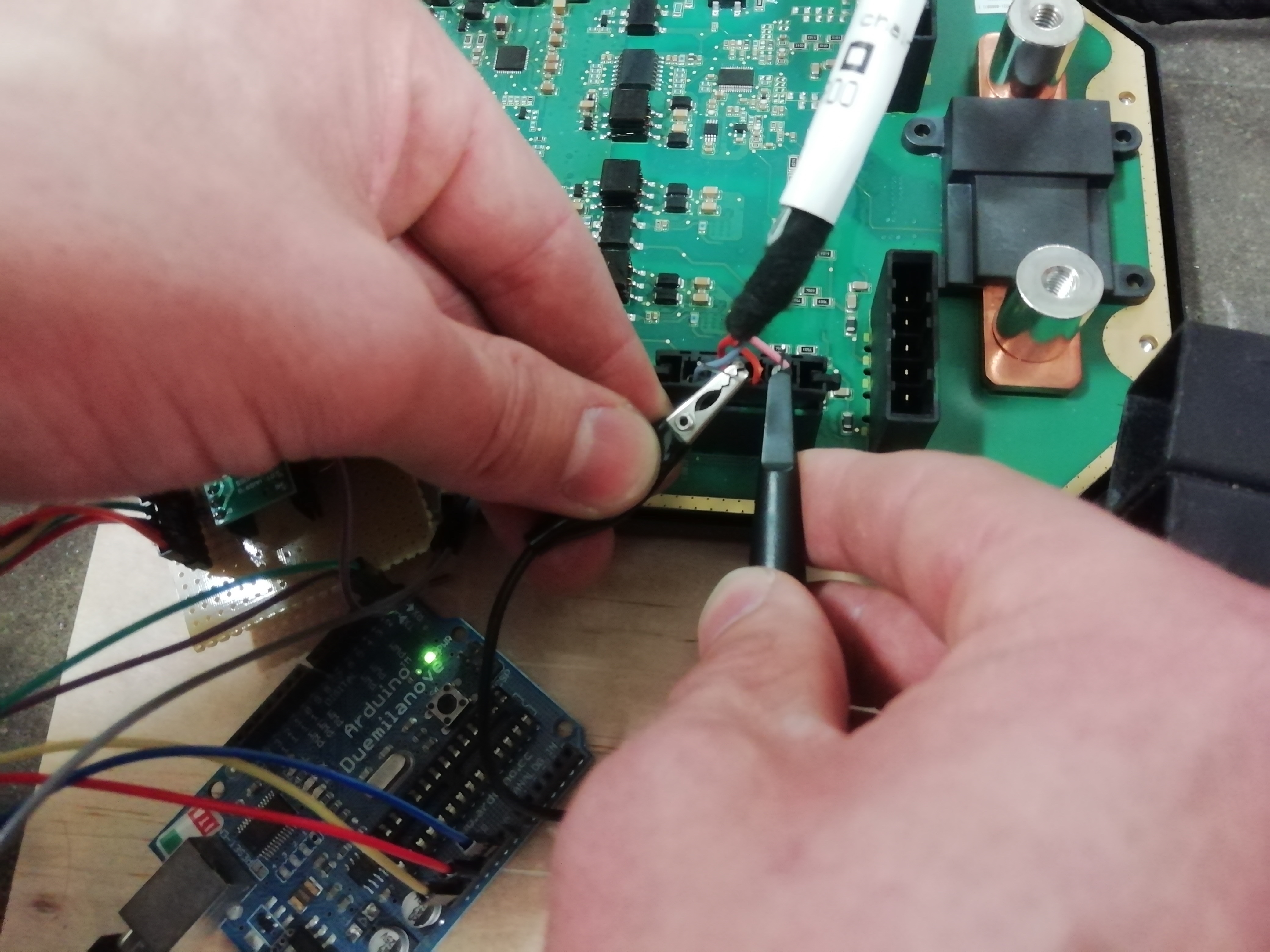

Hi!
No problem. Its still not working so i have to use Plan B now..Will connect Mitsubishi Outlander CMUs to the battery for monitoring.
First: I know the slaves have to be connected to the battery :) I meant, that i disconnected the BMS PCBs and connected them afterwards again.

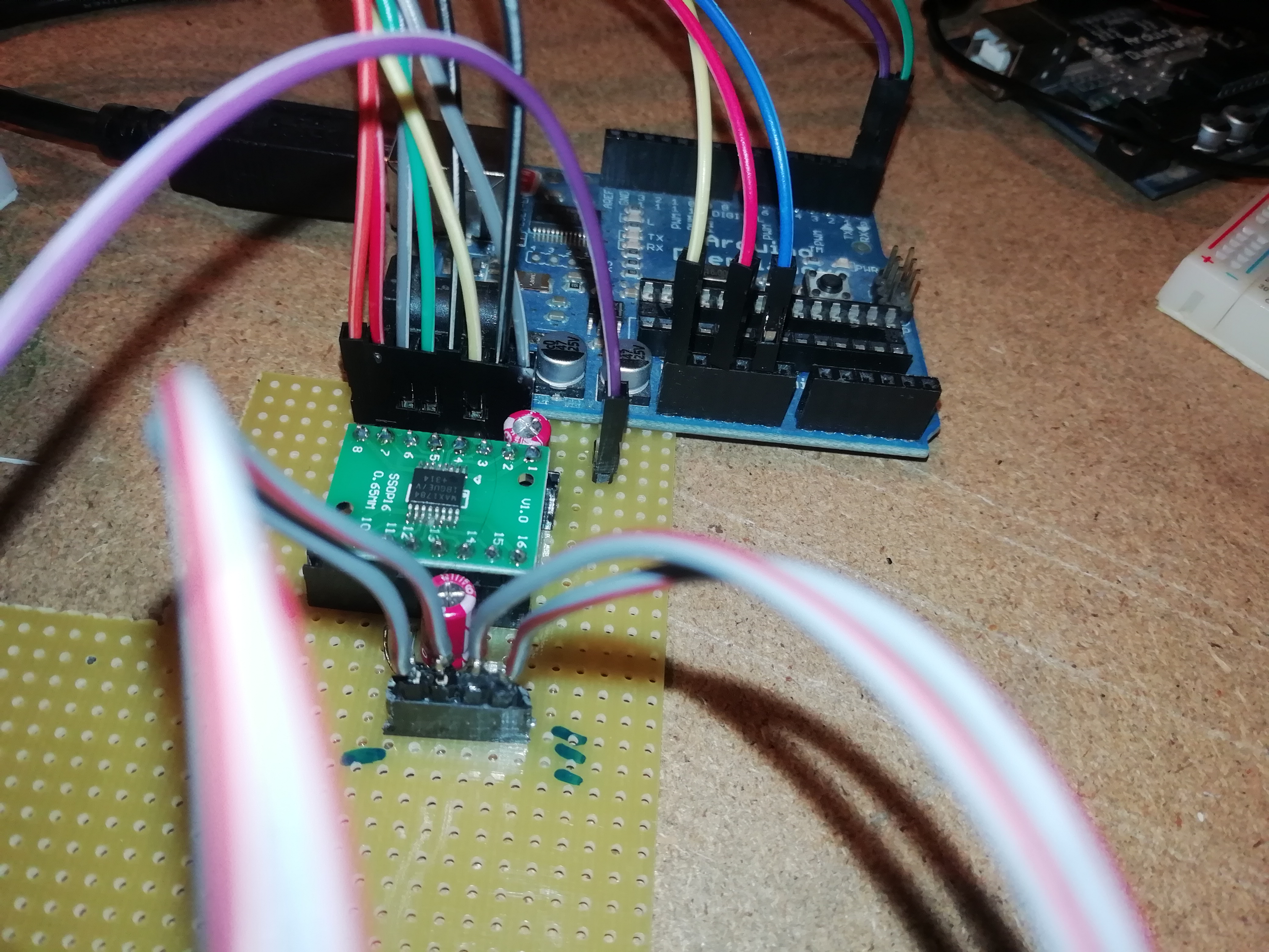

Yesterday i tried again and had some odd behaviour: I connected everything and it was not communicating. After connecting the oscilloscope with the probes to the transformer, the communication changed. I just dont know where the problem is :S
Before connecting the oscilloscope:
After connecting the osci:
How i connected the osci:
Furthermore it was just working with one cable between the transformer-board and the slave. With the other cable i could not repeat the result.
Maybe it has something to to with the capacitance of the connected cables or someting else. thats way over my knowlege :D
I will try to get it to work in the future, but now i use the outlanders cmus because next week the car has its technical inspection.
VW T2 Bus 1978 with Citroen C-Zero Motor, original battery and Opel Corsa E additional battery.

Looking at your setup, you are using experimental board wire and they are a soure of error due to bad contact. Double check all wiring with multimeter or better solder the wires and/or use proper connectors.
In Error2.txt communication is somewhat working but maybe disturbance on the bus as it can't clear the receive buffer successfully?

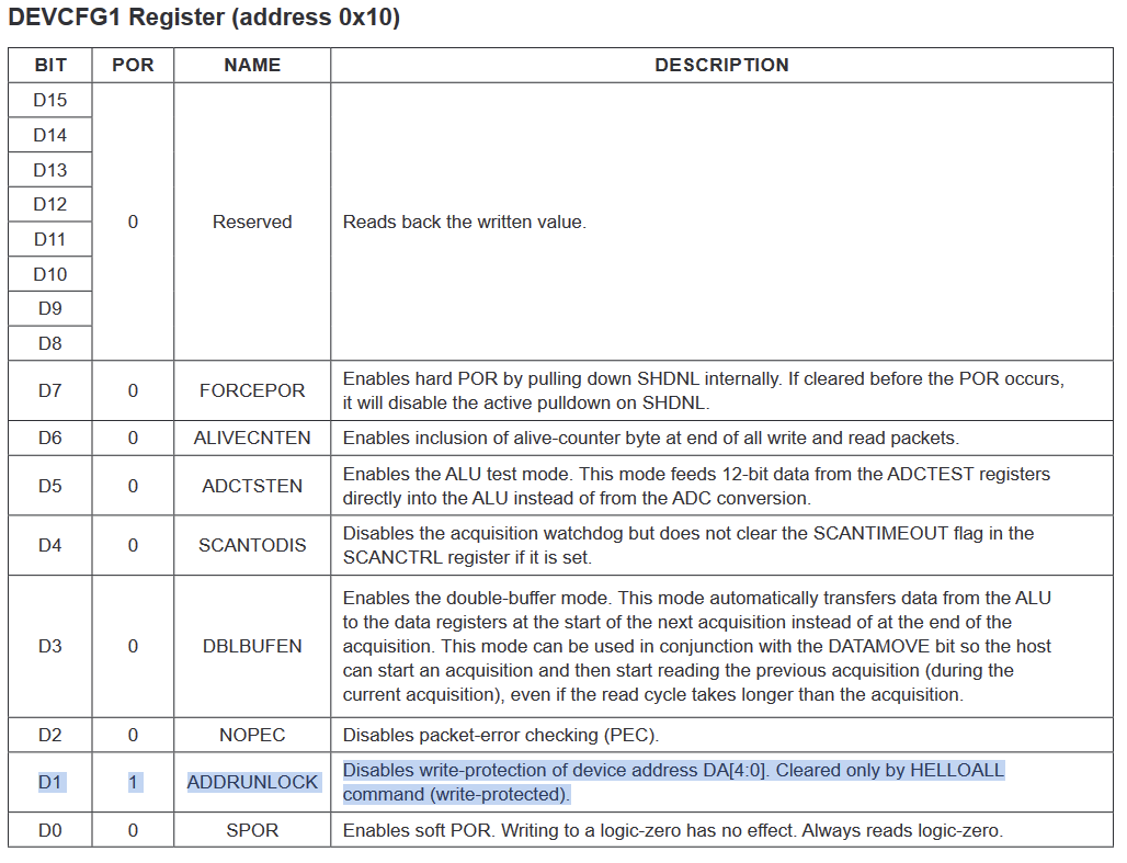

Re: Kia Niro BMS
Post by evdc »
I think DEVCFG1 should fix this, unless it's already fixed: ADDRUNLOCK Disables write-protection of device address DA[4:0]. Cleared only by HELLOALL
